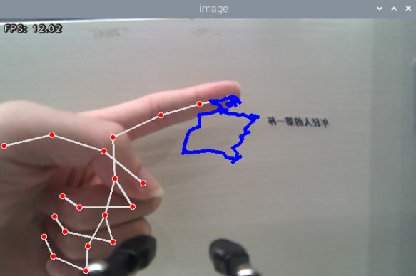

6.5 MediaPipe Gesture Interaction
6.5.1 Project Process
Firstly, initialize the nodes and the servos of robotic arm, subscribe to the camera image topic, and create HandGestureNode class.
Next, perform image processing to detect and recognize gestures.
Then invoke the corresponding action group to execute the interaction of robotic arm.
6.5.2 Operations
When entering commands, be sure to use correct case and spacing. You can use the Tab key to auto-complete keywords.
  1. Refer to the tutorial 1. ArmPi Ultra User Manual ->1.6 Development Environment Setup and Configuration to establish a connection between the robotic arm and the remote desktop tool.
  2. Click the terminal icon in the system desktop to open a command-line window. Enter the following command and press Enter to stop the auto-start service:
  1. Enter the following command and press Enter to start the feature.
ros2 launch example hand_gesture.launch.py
  1. To stop the program, press Ctrl + C in the terminal window. If the program does not stop immediately, repeat this step until it terminates.
  2. After completing the feature, you need to initiate the app service. Otherwise, future APP features may not function properly. In the terminal, enter the following command and press Enter to start the app service. Wait a few seconds for it to initialize.
ros2 launch bringup bringup.launch.py
  1. Once the APP service is successfully started, the robotic arm will return to its initial pose, and the buzzer will beep once.
6.5.3 Project Outcome
The robotic arm can detect key points on the hand and connect them to recognize gestures, and execute a corresponding action group for interactive movements. The gesture “one” triggers the action group “one.d6a”, the gesture “two” triggers the action group “two.d6a”, and so on. Regarding the edition and execution of action groups, please refer to “2.4.2 Action Group Editing and Execution”.

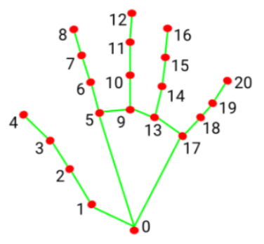

(3) hand_angle Function
61
def hand_angle(landmarks):
    计算各个手指的弯曲角度(calculate the blending angle of each finger)
    :param landmarks: 手部关键点(hand key point)
    :return: 各个手指的角度(the angle of each finger)
    angle_list = []
    # thumb (大拇指)
    angle_list.append(angle_)
    # index finger (食指)
    # middle finger (中指)
    # ring finger (无名指)
    # pinky finger (小拇指)
    return angle_list
To determine the type of finger, for example, thumb and index finger, the keypoints need to be processed logically by analyzing the angles between them. The hand_angle function takes a set of keypoints named landmarks(results) and calculates the angles between the relevant points using the vector_2d_angle function. The elements of the landmarks set correspond to specific keypoints as shown in the diagram.
Taking the thumb as an example, the vector_2d_angle function is used to calculate the angles between its joints. The keypoints landmarks[3], landmarks[4], landmarks[0], and landmarks[2] correspond to points 3, 4, 0, and 2 in the hand keypoint diagram. By calculating the angles formed by these joint points at the fingertip, the posture features of the thumb can be determined. The processing logic for the joints of the other fingers is similar.
To ensure accurate recognition, the parameters and basic logic of angle addition and subtraction in the hand_angle function can be kept at their default settings.

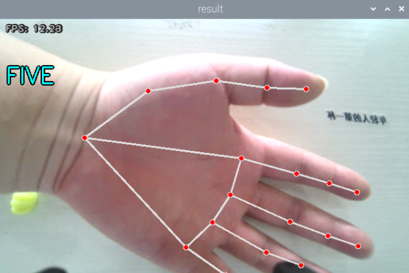

def h_gesture(angle_list):
    Determine the gesture formed by the fingers through two-dimensional features(通过二维特征确定手指所摆出的手势)
    :param angle_list: 各个手指弯曲的角度(the blending angle of each finger)
    :return : Gesture name string (手势名称字符串)
    thr_angle, thr_angle_thumb, thr_angle_s = 65.0, 53.0, 49.0
        gesture_str = "fist"
        gesture_str = "gun"
        gesture_str = "hand_heart"
        gesture_str = "one"
After identifying the types of fingers on the hand and determining their positions in the image, different gestures can be recognized by implementing the h_gesture function.
In the example h_gesture function shown above, the parameters thr_angle = 65, thr_angle_thenum = 53, and thr_angle_s = 49 are the angle thresholds used to determine the gesture logic points. These values were chosen based on testing, as recognition is most stable at these settings. It is not recommended to change them. If the recognition results are unsatisfactory, adjustments within ±5 degrees are acceptable. The angle_list[0,1,2,3,4] corresponds to the types of the five fingers of the hand.
Taking the “one” gesture as an example:
The code above shows the logic for recognizing the “one” gesture based on finger angles. angle_list[0] > 5 checks whether the thumb’s joint angle in the image is greater than 5. angle_list[1] < thr_angle_s checks whether the index finger’s joint angle is smaller than the preset threshold thr_angle_s. angle_list[2] > thr_angle checks whether the middle finger’s joint angle is greater than the preset threshold thr_angle. The remaining two fingers, angle_list[3] and angle_list[4], are processed using similar logic. When all these conditions are met, the current hand gesture is recognized as “one”. The recognition of other gestures follows a similar approach.
Each gesture has its own logic, but the overall framework is largely the same, and other gestures can be referenced based on this method.

6.6.3 Project Outcome
The robotic arm can detect hand keypoints and connect them with lines. When you extend your index finger and move it, the trajectory can be drawn in real time.
When you open all five fingers, the trajectory map will be recorded, and the detected shape will be displayed.
    if (angle_list[0] < thr_angle_s) and (angle_list[1] < thr_angle_s) and (angle_list[2] < thr_angle_s) and (
        gesture_str = "five"

                            self.start_count += 1
                            if self.start_count > 20:
                                self.state = State.TRACKING
                                self.points = []
                            self.start_count = 0
                    elif self.state == State.TRACKING:
                        if gesture == "five": # Finish drawing when all five fingers are spread out (伸开五指结束画图)
                            self.state = State.NULL
                            # Generate a black and white trajectory image (生成黑白轨迹图)
                            track_img = get_track_img(self.points)
                            contours = cv2.findContours(track_img, cv2.RETR_EXTERNAL, cv2.CHAIN_APPROX_NONE)[-2]
                            contour, area = get_area_max_contour(contours, 300)
                            # Identify the drawn shape based on the trajectory image (按轨迹图识别所画图形)
                            track_img = cv2.fillPoly(track_img, [contour, ], (255, 255, 255))
                            for _ in range(3):
                                track_img = cv2.erode(track_img, cv2.getStructuringElement(cv2.MORPH_RECT, (5, 5)))
                                track_img = cv2.dilate(track_img, cv2.getStructuringElement(cv2.MORPH_RECT, (5, 5)))
                            h, w = track_img.shape[:2]
                            track_img = np.full([h, w, 3], 0, dtype=np.uint8)
                            track_img = cv2.drawContours(track_img, [contour, ], -1, (0, 255, 0), 2)
                            approx = cv2.approxPolyDP(contour, 0.026 * cv2.arcLength(contour, True), True)
                            track_img = cv2.drawContours(track_img, [approx, ], -1, (0, 0, 255), 2)
                            print(len(approx))
                            # Determine the shape based on the number of vertices in the contour envelope (根据轮廓包络的顶点数确定图形)
                            if len(approx) == 3:
                                cv2.putText(track_img, 'Triangle', (10, 40),cv2.FONT_HERSHEY_SIMPLEX, 1.2, (255, 255, 0), 2)
                            if len(approx) == 4 or len(approx) == 5:
                                cv2.putText(track_img, 'Square', (10, 40),cv2.FONT_HERSHEY_SIMPLEX, 1.2, (255, 255, 0), 2)
                            if 5 < len(approx) < 10:
                                cv2.putText(track_img, 'Circle', (10, 40),cv2.FONT_HERSHEY_SIMPLEX, 1.2, (255, 255, 0), 2)
                            if len(approx) == 10:
                                cv2.putText(track_img, 'Star', (10, 40),cv2.FONT_HERSHEY_SIMPLEX, 1.2, (255, 255, 0), 2)
                            cv2.imshow('track', track_img)
                            if len(self.points) > 0:
                                if distance(self.points[-1], index_finger_tip) > 5:
                                    self.points.append(index_finger_tip)
                        draw_points(result_image, self.points)
                        pass
                        if time.time() - self.no_finger_timestamp > 2:
                            self.points = []
            except Exception as e:
            self.fps.update()
            self.fps.show_fps(result_image)
            cv2.imshow('image', result_image)
            key = cv2.waitKey(1)
            if key == ord(' '): # Press the space key to clear the recorded trajectory. (按空格键清空已记录的轨迹)
                self.points = []
