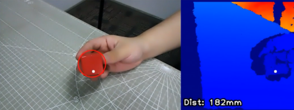

9.2 Distance Ranging
9.2.1 Program Flow
First, initialize the node and obtain the RGB image and depth map topic messages.
Next, process the image to obtain the pixel distance.
Publish the processed color image and the pseudo-color image, and allow mouse clicks to read or clear the distance at the clicked point.
9.2.2 Operation Steps
When entering commands, be sure to use correct case and spacing. You can use the Tab key to auto-complete keywords.
  1. Click the terminal icon in the system desktop to open a command-line window. Enter the following command and press Enter to stop the auto-start service:
  1. Enter the following command and press Enter to start the feature.
ros2 launch example distance_measure.launch.py
  1. To stop the program, press Ctrl + C in the terminal window. If the program does not stop immediately, repeat this step until it terminates.
  2. After completing the feature, you need to start the APP service. Otherwise, future APP features may not function properly. In the terminal, enter the following command and press Enter to start the app service. Wait a few seconds for it to initialize.
ros2 launch bringup bringup.launch.py
  1. Once it is successfully started, the robotic arm will return to its initial pose, and the buzzer will beep once.
9.2.3 Project Outcome
Once the feature is activated, the robotic arm streams both the RGB image and the depth image to the screen. On the depth image, the nearest point and its distance are highlighted. By left-clicking with the mouse, you can mark a point and obtain its distance. A double left-click or a middle-click cancels the mark and restores the minimum-distance measurement.

    def click_callback(self, event, x, y, flags, params):
        if event == cv2.EVENT_RBUTTONDOWN or event == cv2.EVENT_MBUTTONDOWN or event == cv2.EVENT_LBUTTONDBLCLK:
            self.target_point = None
        if event == cv2.EVENT_LBUTTONDOWN and self.last_event != cv2.EVENT_LBUTTONDBLCLK:
            if x >= 640:
                self.target_point = (x - 640, y)
                self.target_point = (x, y)
        self.last_event = event
Mouse interaction callback:
Left-click: Sets the target point for measurement. Clicking on either the RGB image or depth map is supported, with coordinates automatically mapped. Right-click / middle-click or double left-click: Clears the target point and reverts to automatic nearest-point measurement.
Calls the client’s asynchronous request method call_async, sends a message, and returns a future object representing the result.

    def main(self):
        while self.running:
                ros_rgb_image, ros_depth_image = self.image_queue.get(block=True, timeout=1)
            except queue.Empty:
                if not self.running:
                    self.get_logger().info('\033[1;31m%s\033[0m' % 'sdsdfsd')
                    continue
                rgb_image = np.ndarray(shape=(ros_rgb_image.height, ros_rgb_image.width, 3), dtype=np.uint8, buffer=ros_rgb_image.data)
                depth_image = np.ndarray(shape=(ros_depth_image.height, ros_depth_image.width), dtype=np.uint16, buffer=ros_depth_image.data)
                h, w = depth_image.shape[:2]
                depth = np.copy(depth_image).reshape((-1, ))
                depth[depth<=0] = 55555
                min_index = np.argmin(depth)
                min_y = min_index // w
                min_x = min_index - min_y * w
                if self.target_point is not None:
                    min_x, min_y = self.target_point
                sim_depth_image = np.clip(depth_image, 0, 2000).astype(np.float64) / 2000 * 255
                depth_color_map = cv2.applyColorMap(sim_depth_image.astype(np.uint8), cv2.COLORMAP_JET)
                txt = 'Dist: {}mm'.format(depth_image[min_y, min_x])
                cv2.circle(depth_color_map, (int(min_x), int(min_y)), 8, (32, 32, 32), -1)
                cv2.circle(depth_color_map, (int(min_x), int(min_y)), 6, (255, 255, 255), -1)
                cv2.putText(depth_color_map, txt, (11, 380), cv2.FONT_HERSHEY_PLAIN, 2.0, (32, 32, 32), 6, cv2.LINE_AA)
                cv2.putText(depth_color_map, txt, (10, 380), cv2.FONT_HERSHEY_PLAIN, 2.0, (240, 240, 240), 2, cv2.LINE_AA)
                # Color space conversion(颜色空间转换)
                bgr_image = rgb_image  # No conversion needed here(无需转换)
                # bgr_image = cv2.cvtColor(rgb_image, cv2.COLOR_RGB2BGR)  # Uncomment if conversion is required(如需转换可取消注释)
                # Ensure consistent dimensions(确保尺寸一致)
                depth_color_map = cv2.resize(depth_color_map, (rgb_image.shape[1], rgb_image.shape[0]))
                # Ensure depth_color_map is in BGR format(确保 depth_color_map 是 BGR 格式)
                if len(depth_color_map.shape) == 2:
                    depth_color_map = cv2.cvtColor(depth_color_map, cv2.COLOR_GRAY2BGR)
                cv2.circle(bgr_image, (int(min_x), int(min_y)), 8, (32, 32, 32), -1)
                cv2.circle(bgr_image, (int(min_x), int(min_y)), 6, (255, 255, 255), -1)
                cv2.putText(bgr_image, txt, (11, h - 20), cv2.FONT_HERSHEY_PLAIN, 2.0, (32, 32, 32), 6, cv2.LINE_AA)
                cv2.putText(bgr_image, txt, (10, h - 20), cv2.FONT_HERSHEY_PLAIN, 2.0, (240, 240, 240), 2, cv2.LINE_AA)
                self.fps.update()
                # bgr_image = self.fps.show_fps(bgr_image)
                result_image = np.concatenate([bgr_image, depth_color_map], axis=1)
                result_image = self.fps.show_fps(result_image)
                cv2.imshow("depth", result_image)
                key = cv2.waitKey(1)
            except Exception as e:
                self.get_logger().info('error: ' + str(e))
        rclpy.shutdown()
Main logic thread that continuously processes image queue data, reads synchronized RGB and depth images, converting them into NumPy arrays. Measurement logic: If no target point is manually selected, automatically detects the nearest point in the depth image with the minimum depth value. If a target is selected, uses the depth value of that point. Depth visualization: Maps the depth range of 0–2000 mm to a pseudocolor image JET colormap, draws a marker at the measurement point, and displays the distance text in mm. Image stitching: Horizontally concatenates the RGB image and the pseudocolor depth image, overlays FPS, and displays them in an OpenCV window named depth, with real-time interaction support.

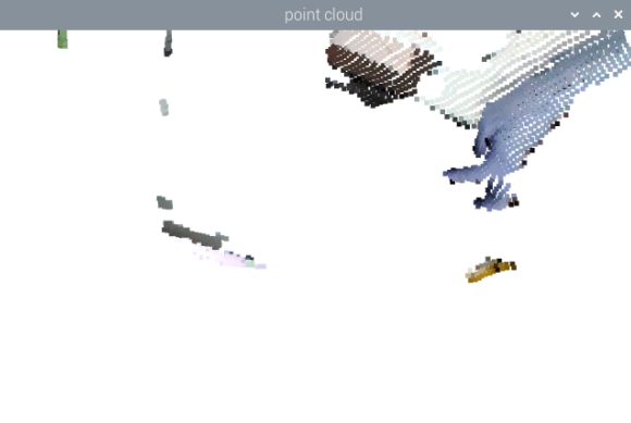

9.3 Depth Map Conversion
9.3.1 Program Flow
Next, process the image to integrate the RGB image and depth map into RGBD image. Then convert the RGBD image into point cloud data.
Lastly, crop and transmit the point cloud data.
9.3.2 Operation Steps
ros2 launch example rgb_depth_to_pointcloud.launch.py
  2. After completing the feature, you need to start the APP service . Otherwise, future APP features may not function properly. In the terminal, enter the following command and press Enter to start the app service. Wait a few seconds for it to initialize.
9.3.3 Project Outcome
Once the feature is enabled, the robotic arm converts the cropped point cloud data into a depth image and feeds it into the visualization window. In the returned display, the depth image is shown. You can press and hold the left mouse button or use the scroll wheel to rotate and view the point cloud from different angles, and use the scroll wheel to zoom in for a closer look.
9.3.4 Program Brief Analysis

Core logic for processing synchronized data and converting images to point clouds. Receives synchronized RGB images, depth images, and camera intrinsics, converts them to NumPy arrays, and resizes them according to the scale factor to reduce computation. Creates an Open3D camera intrinsic object PinholeCameraIntrinsic using the camera intrinsics, and converts the RGB and depth images into an Open3D RGBD image. Generates the point cloud create_from_rgbd_image, segments planes using RANSAC, mainly to remove the floor, and retains non-plane points as the target point cloud target_cloud. Transforms the point cloud coordinates by rotating 180 degrees around the X-axis for visualization, and stores the processed point cloud in the queue pc_queue for visualization by the main thread.

            if self.haved_add:
                    point_cloud = self.pc_queue.get(block=True, timeout=2)
                    print("Point cloud dequeued") # Confirm point cloud is dequeued(确认点云已出队)
                except queue.Empty:
                    continue
                # Refresh (刷新)
                points = np.asarray(point_cloud.points)
                print(f"Points array shape: {points.shape}")  # Confirm the shape of the points array(确认 points 数组的形状)
                if len(points) > 0:
                    twist = Twist()
                    min_index = np.argmax(points[:, 2])
                    min_point = points[min_index]
                    if len(point_cloud.colors) < min_index:
                        continue
                    point_cloud.colors[min_index] = [255, 255, 0]
                    if self.display:
                        vis.update_geometry(point_cloud)
                        # o3d.io.write_point_cloud("output.ply", point_cloud)  # (可选)保存点云到文件
                        vis.poll_events()
                        vis.update_renderer()
                time.sleep(0.01)
        # Destroy all displayed geometries (销毁所有显示的几何图形)
        vis.destroy_window()
        self.get_logger().info('\033[1;32m%s\033[0m' % 'shutdown')
        rclpy.shutdown()
Main logic thread responsible for point cloud visualization and target tracking: if display is enabled display=True, create an Open3D visualization window vis. Continuously fetch point clouds from the queue. For the first fetch, add the point cloud to the visualization window. For subsequent updates, find the point with the largest Z-axis value, usually the closest point, and mark it in yellow ([255, 255, 0]). Refreshes the visualization window in real time until running is False, then destroys the window and shut down ROS.
9.4 Height Detection and Gripping
9.4.1 Program Flow
Then, perform image processing to determine the pixel coordinates of the tallest object within the field of view.
Afterward, convert these pixel coordinates into the world coordinates of the robotic arm through a coordinate system transformation.
Finally, conclude the process by planning the trajectory of the robotic arm for grasping and placing the large wooden block.
9.4.2 Operation Steps
ros2 launch example remove_too_high.launch.py
  1. After starting the feature, press S in the image display window to start the robotic arm’s grasping action. Press A to stop the robotic arm from grasping.
9.4.3 Project Outcome
Once the feature begins, place a 30x30mm block and a 40x40mm block within the recognition area on the map. Subsequently, the robotic arm will assess their heights and pick up the larger of the two.
9.4.4 Program Brief Analysis

5.3 Project Outcome
Once the operation is started, the robotic arm raises the depth camera to face forward, detects colored blocks in the air, which is set to red by default, tracks the blocks, obtains their poses, picks them up, and places them at designated locations.
If the item is placed within the minimal detection range, the camera cannot measure the item’s distance. In this scenario, the measurement result will be set to 0, and the terminal will display ‘TOO CLOSE !!!’. To resolve this issue, ensure the target block is positioned away from the camera for proper gripping.

                                roi[1] = min(h, roi[1])
                                roi[2] = max(0, roi[2])
                                roi[3] = min(w, roi[3])
                                roi_distance = depth_image[roi[0]:roi[1], roi[2]:roi[3]]
                                valid_depths = roi_distance[np.logical_and(roi_distance > 0, roi_distance < 10000)]
                                if valid_depths.size == 0:
                                    self.get_logger().warn("No valid depth data in ROI. Skipping calculation.")
                                    dist = 0.20  # Or set a default value, e.g., dist = 0.15 (或设置一个默认值,如 dist = 0.15)
                                    dist = round(float(np.mean(valid_depths) / 1000.0), 3)
                                self.get_logger().info("DISTANCE: " + str(dist))
                                # dist += 0.015 # Object radius compensation (物体半径补偿)
                                # dist += 0.015 # Error compensation (误差补偿)
                                K = depth_camera_info.k
                                self.get_endpoint()
                                position = depth_pixel_to_camera((center_x, center_y), dist, (K[0], K[4], K[2], K[5]))
                                position[0] -= 0.01  # RGB camera and depth camera TF have 1cm offset (rgb相机和深度相机tf有1cm偏移)
                                pose_end = np.matmul(self.hand2cam_tf_matrix, common.xyz_euler_to_mat(position, (0, 0, 0)))  # Converted end-effector relative coordinates (转换的末端相对坐标)
                                world_pose = np.matmul(self.endpoint, pose_end)  # Convert to robotic arm world coordinates (转换到机械臂世界坐标)
                                pose_t, pose_R = common.mat_to_xyz_euler(world_pose)
                                self.stamp = time.time()
                                self.moving = True
                                threading.Thread(target=self.pick, args=(pose_t,)).start()
                        dist = depth_image[int(center_y),int(center_x)]
                        if dist < 200:
                            txt = "TOO CLOSE !!!"
                            txt = "Dist: {}mm".format(dist)
                        cv2.circle(result_image, (int(center_x), int(center_y)), 5, (255, 255, 255), -1)
                        cv2.circle(depth_color_map, (int(center_x), int(center_y)), 5, (255, 255, 255), -1)
                        cv2.putText(depth_color_map, txt, (10, 400 - 20), cv2.FONT_HERSHEY_PLAIN, 2.0, (0, 0, 0), 10, cv2.LINE_AA)
                        cv2.putText(depth_color_map, txt, (10, 400 - 20), cv2.FONT_HERSHEY_PLAIN, 2.0, (255, 255, 255), 2, cv2.LINE_AA)
                        self.last_pitch_yaw = p_y
                if self.enable_disp:
                    #result_image = cv2.cvtColor(result_image[40:440, ], cv2.COLOR_RGB2BGR)
                    result_image = result_image
                    result_image = np.concatenate([result_image, depth_color_map], axis=1)
                    if key == ord('q') or key == 27:  # Exit by pressing q or esc (按q或者esc退出)
                        self.running = False
                self.get_logger().info('error1: ' + str(e))
        rclpy.shutdown()
