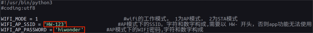

  • Configuring the Leader Robot Network
  1. First, select one robot as the leader, power it on, and then remotely connect to its system desktop.
  1. Open a terminal and input the following command to navigate to the directory where the file is located.
cd wifi_manager
  1. Next, input the command below to open the Wi-Fi configuration file using the vim editor.
vim wifi_conf.py
  1. Press the i key to enter edit mode. Locate the two lines of code highlighted in the image below and modify the leader hotspot password.
  1. Once the changes are complete, press the Esc key to exit the edit mode. Then input :wq to save the changes and exit.
:wq
  1. Finally, input the command to reboot the leader robot.
sudo reboot
  1. After the leader robot restarts, when reconnecting to the Wi-Fi, enter the Wi-Fi password hiwonder.

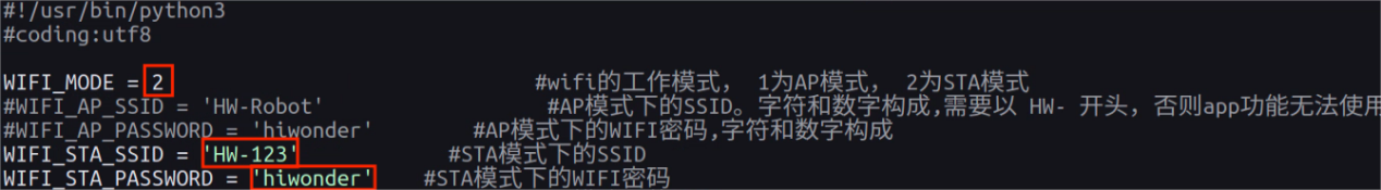

  • Configuring the Follower Robot Network
  1. Power on the follower robot and remotely connect to its system desktop.
cd wifi_manager
vim wifi_conf.py
  1. Press the i key to enter the edit mode, then modify the Wi-Fi name and password lines as shown in the image below. Locate the three highlighted lines of code.
Set the follower robot’s network mode to 2 for LAN mode. HW-123 and hiwonder are the Wi-Fi name and password configured for the leader robot network.
  1. Once the changes are complete, press the Esc key to exit the edit mode. Then input the command to save and exit.
:wq
  1. Finally, input the command to reboot the robot. This step cannot be skipped!
sudo reboot
