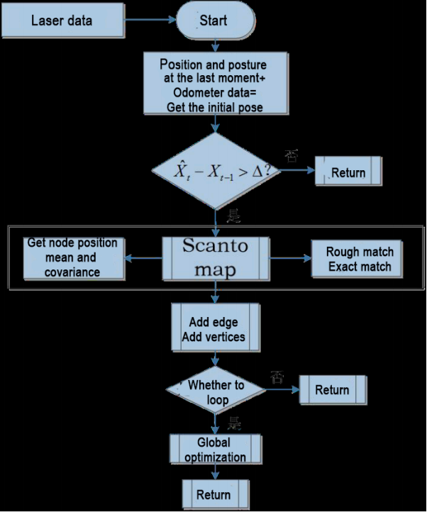

KARTO:
Karto_SLAM is based on the concept of graph optimization, using highly optimized and non-iterative Cholesky decomposition to decouple sparse systems as a solution. The graph optimization method represents the map using the mean of the graph, where each node represents a position point in the robot’s trajectory and a set of sensor measurements. Each new node added triggers a computational update.
The ROS version of Karto_SLAM employs Sparse Pose Adjustment (SPA) related to scan matching and loop closure detection. The more landmarks there are, the higher the memory requirement. However, compared to other methods, the graph optimization approach has greater advantages in large environments because it only includes the robot pose in the graph. After obtaining the poses, the map is generated.
The algorithmic framework of Karto_SLAM is as shown below:
From the figure above, the process is actually quite simple. Following the traditional soft real-time operation mechanism of SLAM, each incoming frame of data is processed immediately and then returned.

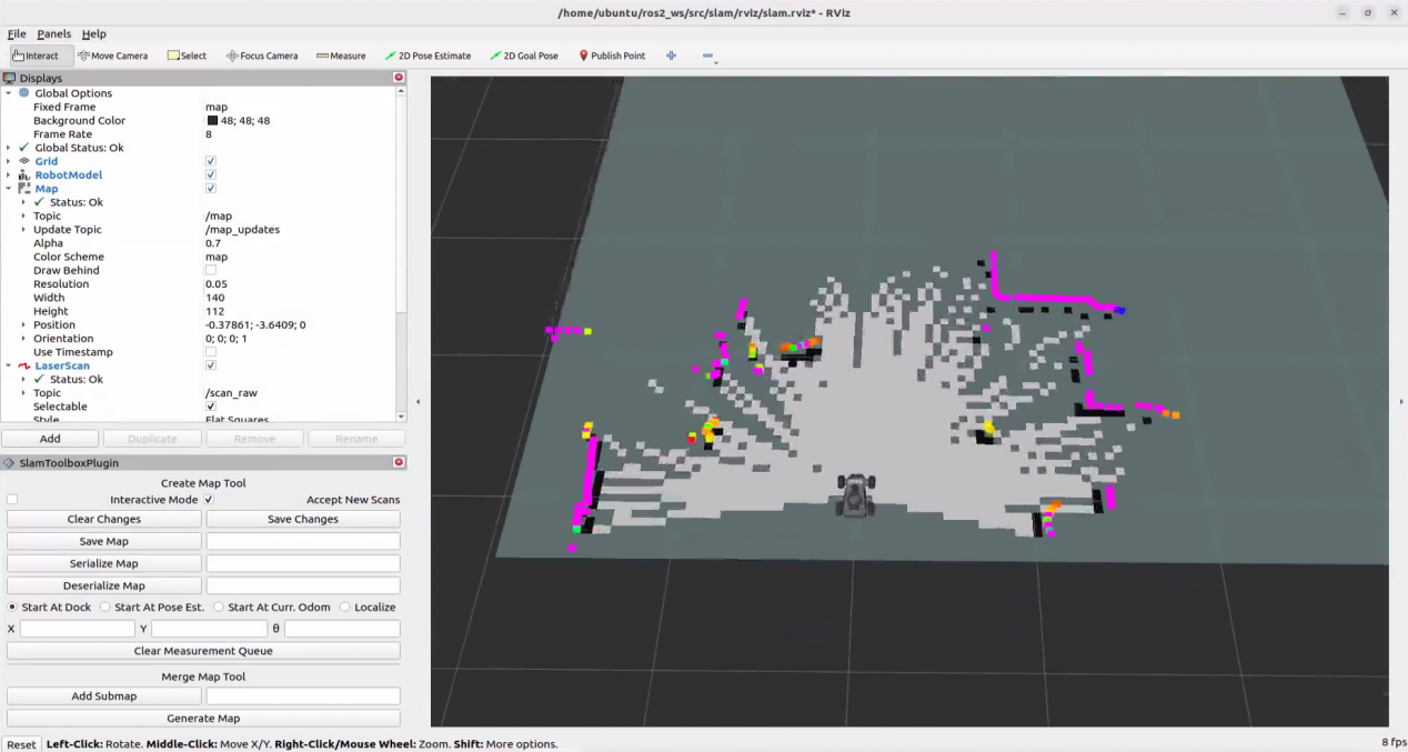

Enter the command to start mapping.
ros2 launch slam slam.launch.py

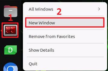

Right-click the system terminal icon and select New Window to open a new terminal window.
Enter the following command to launch RViz and display the mapping result.
ros2 launch slam rviz_slam.launch.py

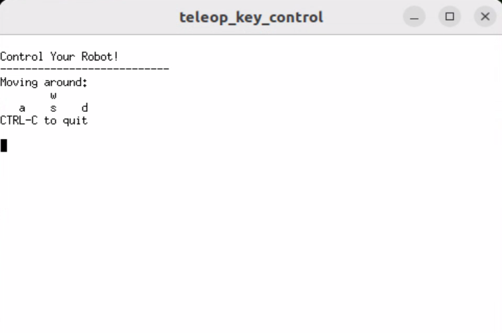

Next, enter the following command to start the keyboard control node, then press Enter:
ros2 launch peripherals teleop_key_control.launch.py
If the prompt shown below appears, the keyboard control service has started successfully.
Control the robot to move around the current area to build a more complete map. The table below lists the keyboard keys used to control robot movement and their corresponding functions:
| Keyboard Key | Robot Action |
| W | Press once to switch to forward mode and continue moving forward |

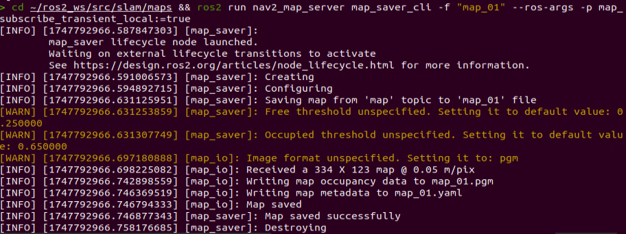

5.1.4.3 Save Map
Right-click the system command-line terminal icon and select New Window to open a new command-line terminal.
Enter the command to save the map and press Enter:
cd ~/ros2_ws/src/slam/maps && ros2 run nav2_map_server map_saver_cli -f "map_01" --ros-args -p map_subscribe_transient_local:=true**
If the prompt shown above appears, the map has been saved successfully.
5.1.4.4 Exit Mapping
Right-click the system command-line terminal icon and select New Window to open another command-line terminal.
Then enter the command and press Enter to execute the program for all ROS nodes in the current system environment. If it does not close successfully, repeat the command as needed.

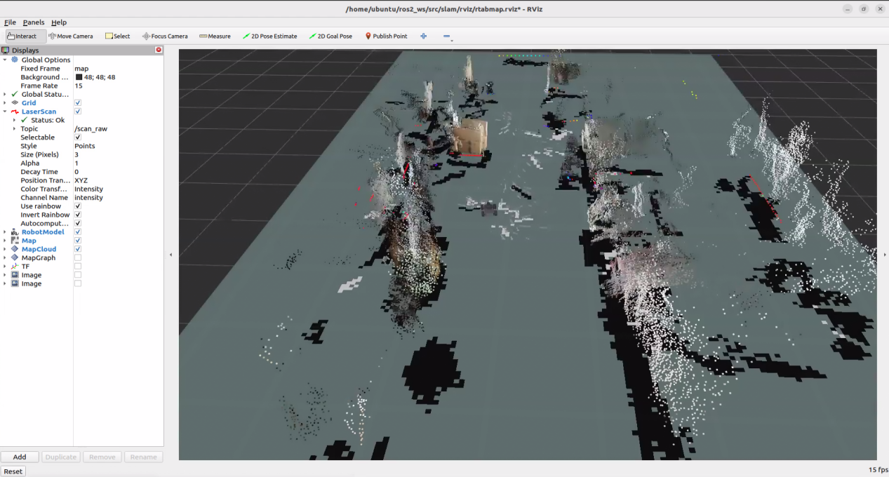

5.1.5.3 3D Mapping Steps

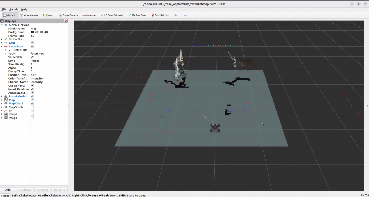

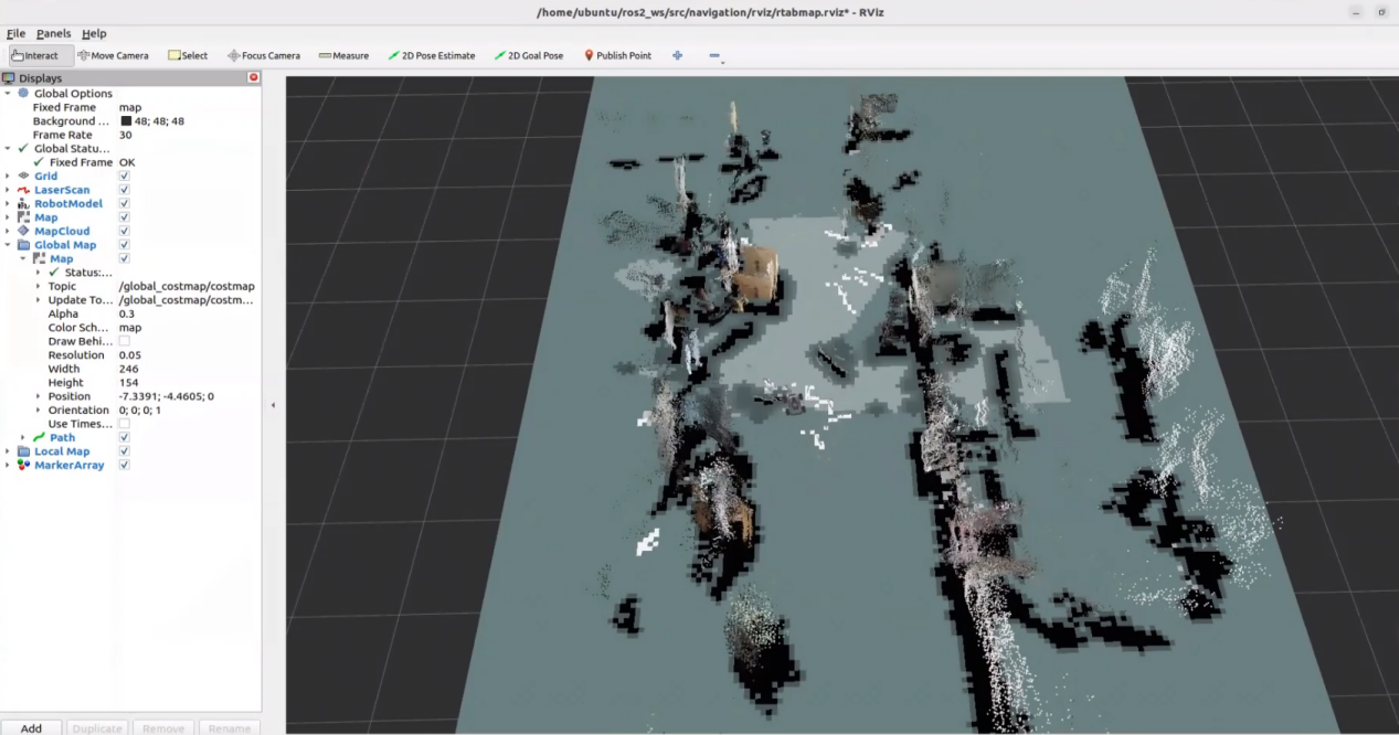

Start the robot and connect it to the remote control software NoMachine. For connection instructions, refer to 1.7.2 AP Mode Connection Steps.
Click the terminal icon
in the system desktop to open a ROS2 command-line window. Enter the command to disable the app auto-start service.
Entering the following command to start mapping.
ros2 launch slam rtabmap_slam.launch.py
Press Ctrl + Shift + E to open a new command-line terminal, then enter the command to start the RVIZ tool for displaying the mapping process.
ros2 launch slam rviz_rtabmap.launch.py
Press Ctrl + Shift + O to open another command-line terminal, then enter the command to start the keyboard control node and press Enter.
Control the robot to move within the current space to build a more complete map. Table of keyboard keys and the robot action functions.

5.1.5.4 Save Map
After completing the mapping, press Ctrl + C in each command-line terminal window to stop the currently running program.
For 3D mapping, manual map saving is not required. When the mapping command is stopped using Ctrl + C, the map is automatically saved.

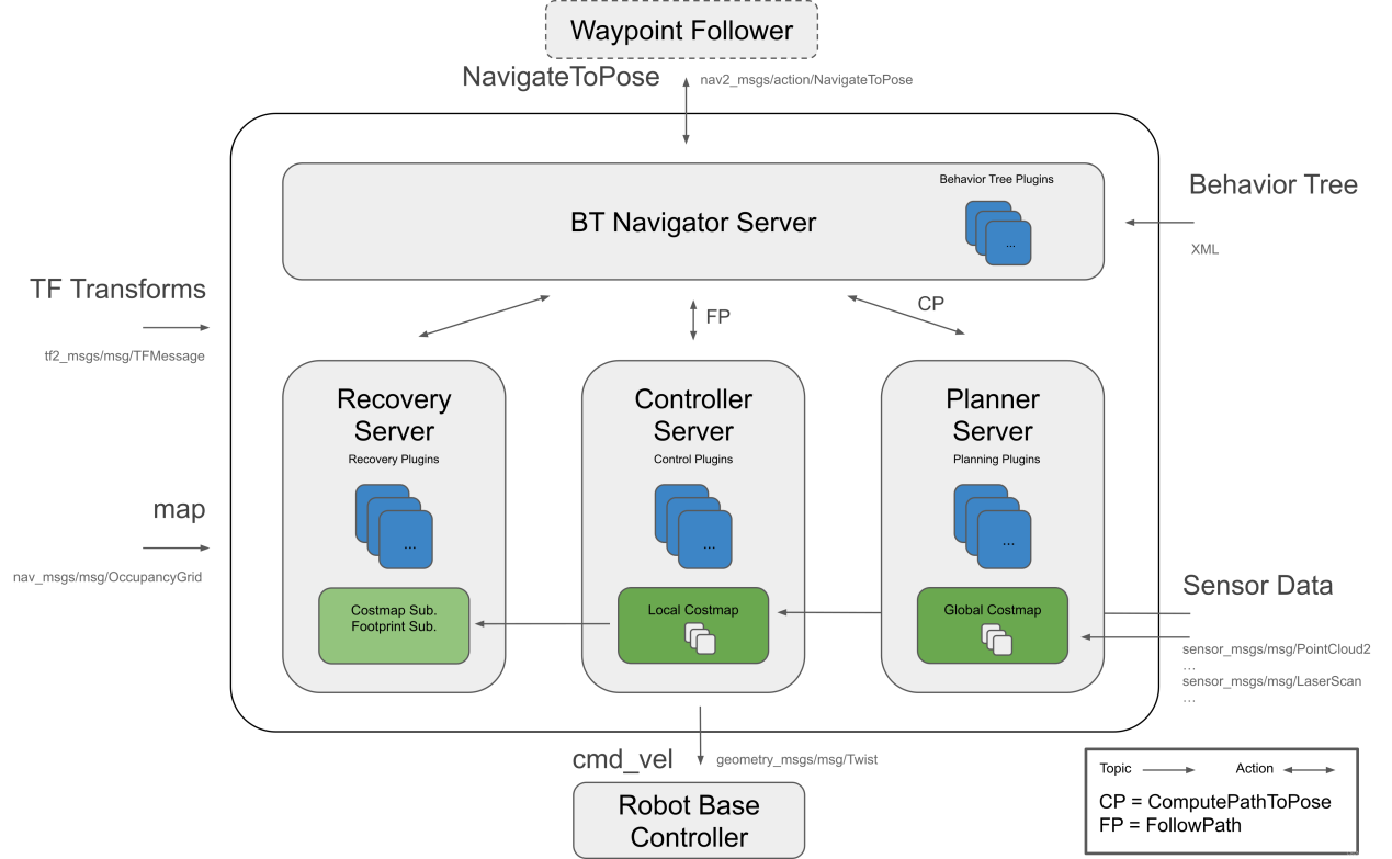

Principle and Framework Overview
The Nav2 project extends the ROS navigation stack, providing a secure framework for enabling robots to move from point A to point B. It supports advanced functions such as dynamic path planning, velocity control, obstacle avoidance, and recovery behaviors.
Nav2 adopts a behavior tree architecture to manage modular action servers. Actions can include path planning, control, recovery, or other navigation-related operations. All of these are implemented as independent nodes that communicate with the behavior tree (BT) through ROS Action servers. The following diagram provides an overview of the Nav2 architecture:
It is composed of one main module and three submodules.
Main Module:
The BT Navigator Server is the navigation behavior tree service, responsible for organizing and coordinating the three subordinate services below.
Three Submodules:
1.Planner Server: The planning server is responsible for computing paths that satisfy defined objective functions. Depending on the selected algorithm, the computed path may also be referred to as a route. Its function is essentially to determine a navigable path on the map.
2.Controller Server: The control server, also known as the local planner in ROS1, executes motion commands to follow the global path or perform local navigation tasks. Its function is to control the robot’s movement along the planned path.
3. Recovery Server: The recovery server serves as the core of the fault-tolerance system. Its purpose is to detect and autonomously handle unexpected situations or system faults. In other words, it enables the robot to recover from unexpected situations, such as navigating out of a pit or obstacle.
Autonomous navigation is achieved by continuously switching between path planning, motion control along the path, and recovery from unexpected situations. During this process, a static SLAM-generated map alone is insufficient, as new obstacles may appear and some previously mapped obstacles may disappear. Therefore, navigation relies on a dynamic map, which is maintained and updated in real time. Based on update frequency and usage, dynamic maps can be classified into the following two types:

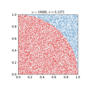

The Monte Carlo localization process simulates particle updates for a one-dimensional robot. First, a set of particles is randomly generated with position, orientation, or other state variables to be estimated. Each particle is assigned a weight that represents how closely it matches the actual system state. Next, the state of each particle is predicted for the next time step. This prediction moves the particles based on the expected behavior of the real system. Next, the particles’ weights are updated based on measurements. Particles that match better with the measurements are given higher weights. Then resampling is performed, discarding unlikely particles and replacing them with more probable ones. Finally the weighted average and covariance of the particle set are calculated to obtain the state estimate.
The Monte Carlo method varies, but generally follows a specific pattern:
Define the domain of possible inputs.
Randomly generate inputs based on the probability distribution over the domain.
Perform deterministic calculations on the inputs.
Summarize the results.
There are two important considerations:
(1) If the points are not uniformly distributed, the approximation will be poor.
(2) The process requires many points. If only a few points are randomly placed across the entire square, the approximation will generally be inaccurate. On average, as more points are added, the accuracy of the approximation improves.
The Monte Carlo particle filter algorithm has many applications across a wide range of fields, including physical sciences, engineering, climatology, and computational biology.

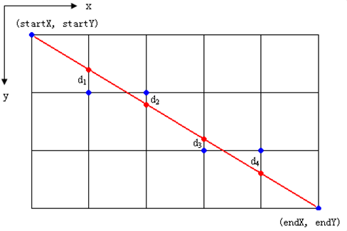

Before introducing costmap_2d, the Bresenham algorithm must be explained first. The Bresenham line algorithm is used to draw a straight line between two points. It calculates the closest points along a line segment on an n-dimensional raster. This algorithm only requires fast integer addition, subtraction, and bit-shifting, so it is commonly used for drawing lines in computer graphics. It was one of the first algorithms developed in computer graphics.
The algorithm constructs a virtual grid of lines through the pixel centers of each row and column, as shown in the diagram above. It calculates the intersection points of the line with each vertical grid line, and based on the error term’s sign, determines the pixel closest to this intersection in each column.
Core Idea of the Algorithm: Assume that k=dy/dx Since the starting point of the line is at the pixel center, the initial error term d0=0.
For each increment of X, the value of d increases according to the slope k, so d=d+k. Once d≥1, subtract 1 to keep d between 0 and 1. When d≥0.5, the pixel closest to the current position is (x+1,y+1). When d<0.5, the closer pixel is (x+1,y). For easier calculation, let e=d−0.5, with an initial value of e=−0.5 and an increment of k. When e≥0, select the pixel at (x+1,y+1). When e<0, select the pixel at (x+1,y). To avoid division, integers are used instead of floating-point values. Since the algorithm only uses the sign of the error term, it can be replaced with e1 = 2*e*dx.

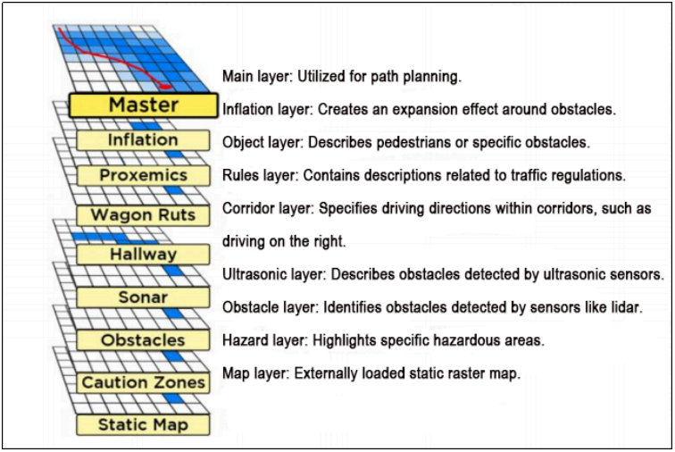

The Costmap2D class maintains the cost value for each grid. The Layer class is a virtual base class that standardizes the interface for the various plugin costmap layers. The key interface functions include:
The initialize function calls the onInitialize function to initialize each costmap layer individually.
The matchSize function, found in the StaticLayer and ObstacleLayer classes, calls the matchSize function of the CostmapLayer class to initialize each costmap layer’s size, resolution, origin, and default cost value, ensuring consistency with the layered_costmap. For the InflationLayer class, a cost table is calculated based on the inflation radius, with cost values changing according to distance. This allows for querying the inflated grid’s cost based on distance. Additionally, a seen_ array is defined to track whether a grid cell has been visited. For the VoxelLayer class, the size of the voxel grid is initialized.
The updateBounds function adjusts the size range that needs to be updated for the current costmap layer. For the StaticLayer class, the update range of the costmap is determined by the size of the static map. Note that the static layer is typically only used in the global costmap. For the ObstacleLayer class, the function iterates over the sensor data in clearing_observations to determine the boundaries of obstacles.
The initialize and matchSize functions are each executed only once. The updateBounds and updateCosts functions are executed periodically, with the frequency of execution determined by the map_update_frequency parameter.
The CostmapLayer class inherits from both the Layer and Costmap2D classes, providing several methods to update the cost values. Both the StaticLayer and ObstacleLayer classes need to store the cost values of the instantiated costmap layers, so they inherit from the CostmapLayer class. The StaticLayer class uses static grid map data to update its costmap. The ObstacleLayer class uses sensor data to update its costmap. The VoxelLayer class, compared to ObstacleLayer, also considers data along the z-axis. The main difference in functionality lies in how obstacles are cleared. The ObstacleLayer clears obstacles in 2D, while the VoxelLayer clears obstacles in 3D.
Costmap provides flexible obstacle measurement, allowing specific layers to be created based on requirements to maintain relevant obstacle information. If the robot is equipped only with a LiDAR, an Obstacles layer can be created to store the obstacle data from LiDAR scans. If the robot is also equipped with ultrasonic sensors, a new Sonar layer should be created to manage obstacle data from the sonar sensors. Each layer can have its own set of obstacle update rules, such as adding or removing obstacles, or updating the confidence of detected obstacles. This greatly enhances the scalability of the navigation system.

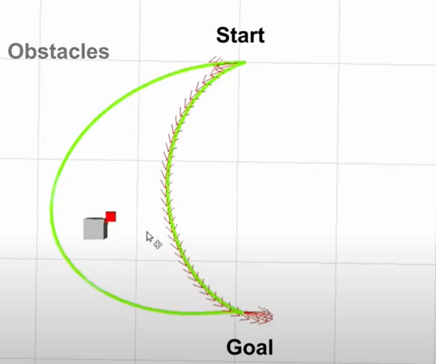

5.2.3 Local Path Planning
Global path planning takes the start and goal points as input and uses the obstacle information described in the global map to plan a global path from the start to the goal. The global path consists of a series of discrete waypoints and only considers static obstacle information. Therefore, the global path cannot be directly used for navigation control but serves as a macro-level reference for navigation.

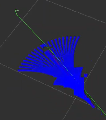

5.2.3.1 DWA Algorithm
Description

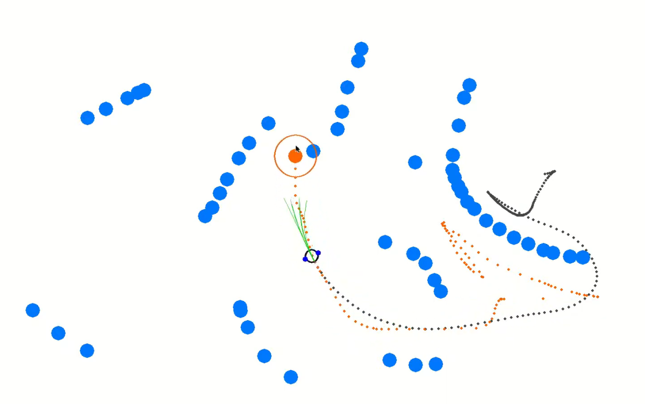

The DWA algorithm, also known as the Dynamic Window Approach, is a classic algorithm for mobile robot path planning and motion control. DWA works by searching for the optimal combination of speed and angular velocity in the state space of velocity and angular velocity, enabling the robot to navigate safely on a known map. Here is the basic description and some formulas of the DWA algorithm:
The core concept of the DWA algorithm is that, at each moment, the robot considers its current state and sensor information, then generates a set of possible motion trajectories (also known as the dynamic window) in the state space of velocity and angular velocity, and evaluates these trajectories to select the optimal one. The evaluation criteria typically include avoiding obstacles, maximizing forward velocity, and minimizing angular velocity. By repeatedly performing this process, the robot can plan its motion trajectory in real time to adapt to dynamic environments and obstacles.
Formulas
The robot state: position (x, y) and orientation θ.
Motion control parameters: linear velocity
Vand angular velocityω.Sampling ranges for velocity and angular velocity: Vmin, Vmax, ωmin, and ωmax.
Time step: Δt
The formula is as follows:
Velocity sampling: The DWA algorithm first samples in the state space of velocity and angular velocity to generate a set of possible velocity-angular velocity pairs, which are referred to as the dynamic window.
Vsamples = [vmin, vmax]
ωsamples = [-ωmax, ωmax]
Where, (Vsamples) represents the velocity sampling range, and (ωsamples) represents the angular velocity sampling range.
Motion simulation: For each velocity-angular velocity pair, the DWA algorithm performs a motion simulation to calculate the trajectory of the robot when using these velocity-angular velocity combinations from the current state.
x(t+1) = x(t) + v * cos(θ(t)) *Δt
y(t+1) = y(t) + v * sin(θ(t)) *Δt
θ(t+1) = θ(t) + ω * Δt
Where, x(t) and y(t) represent the robot’s position, θ(t) represents the robot’s orientation, (v) represents the linear velocity, (ω) represents the angular velocity, and (Δt) represents the time step.
Trajectory evaluation: For each generated trajectory, the DWA algorithm evaluates the trajectory using evaluation functions, such as obstacle avoidance evaluation, maximum speed evaluation, and minimum angular velocity evaluation.
Obstacle avoidance evaluation: Detects whether the trajectory intersects with any obstacles.
Maximum speed evaluation: Checks whether the maximum linear velocity along the trajectory is within the allowed range.
Minimum angular velocity evaluation: Checks whether the minimum angular velocity along the trajectory is within the allowed range.
The evaluation functions can be defined and adjusted according to task requirements.
Selecting the best trajectory: The DWA algorithm selects the trajectory with the best evaluation score as the robot’s next movement.

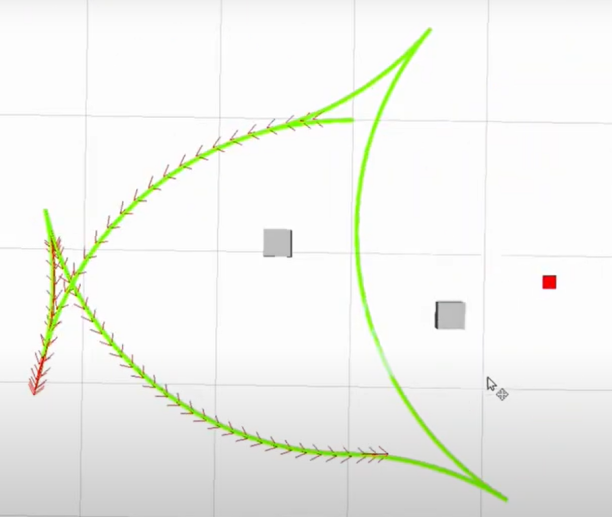

5.2.3.2 TEB Algorithm
Description
The Timed Elastic Band (TEB) algorithm is a path and motion planning algorithm primarily used in applications such as robotics and autonomous vehicles. The core concept of the TEB algorithm is to model the path planning problem as an optimization problem, where the goal is to generate an optimal trajectory within a given time frame while satisfying the robot or vehicle’s dynamic constraints and obstacle avoidance requirements. Key features of the TEB algorithm:
Time Hierarchical Representation: The TEB algorithm introduces time hierarchy. It divides the trajectory into multiple time steps. Each step corresponds to a position of the robot or vehicle along the path. This helps establish time constraints and avoid collisions.
Trajectory Parameterization: The TEB algorithm parameterizes the trajectory as a series of displacements and velocities, making optimization easier. Each time step has its own displacement and velocity parameters.
Constraint Optimization: The TEB algorithm considers the robot’s dynamic constraints, obstacle avoidance constraints, and trajectory smoothness constraints. These constraints are modeled as part of the objective function in the optimization problem.
Optimization Solving: The TEB algorithm uses optimization techniques, such as Quadratic Programming (QP) or Nonlinear Programming (NLP), to solve for the optimal trajectory parameters that satisfy the constraints.

The following diagram describes the optimization objective function in the TEB algorithm:
Where:
(1) J(x) is the objective function, and x represents the trajectory parameters.
(2) wsmooth and wobstacle are the weights for smoothness and obstacle avoidance, respectively.
(3) H is the smoothness penalty matrix.
(4) f(xi,oj) represents the obstacle cost function between trajectory point xi and obstacle oj.

2. Objective Function:
The core of the TEB algorithm is an optimization problem, with the goal of minimizing an objective function composed of multiple components:
Where:
(1) Jsmooth(x): The smoothness objective function, used to ensure the generated trajectory is smooth.
(2) Jobstacle(x): The obstacle avoidance objective function, used to avoid collisions with obstacles.
(3) Jdynamic(x): The dynamics objective function, used to ensure the robot’s dynamic constraints are satisfied.
3. Smoothness Objective Function Jsmooth(x): The smoothness objective function typically involves the trajectory’s curvature to ensure the generated trajectory is smooth. It can be expressed as:
where k(t) is the curvature.
4. Obstacle Avoidance Objective Function Jobstacle(x):
The obstacle avoidance objective function calculates the distance between trajectory points and obstacles, penalizing trajectory points that are close to obstacles. The specific obstacle cost function f(x,o) can be defined as needed.
5. Dynamics Objective Function Jdynamic(x):
The dynamics objective function ensures that the generated trajectory satisfies the robot’s dynamic constraints, which can be defined based on the robot’s kinematic and dynamic models. Typically, this involves constraints on velocity and acceleration.
6. Optimization:
Finally, the TEB algorithm formulates the above objective functions as a constrained optimization problem, where the optimization variables include trajectory parameters, time allocation, and control inputs. This optimization problem is typically a Nonlinear Programming (NLP) problem.

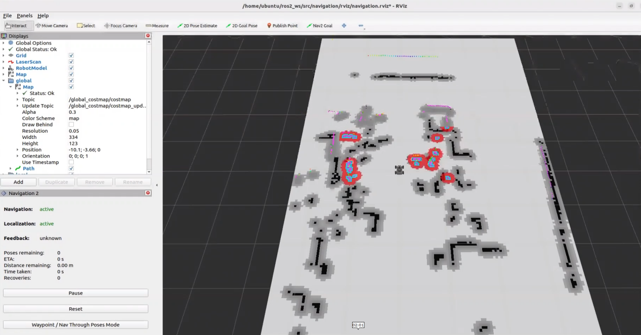

5.2.4 Single/Multi-Point Navigation and Obstacle Avoidance
in the system desktop to open a command-line window. Enter the command to disable the app auto-start service.
Entering the following command and press Enter to start the navigation service.
ros2 launch navigation navigation.launch.py map:=map_01
The map_01 at the end of the command is the map name. Modify this parameter as needed. The map is stored in /home/ubuntu/ros2_ws/src/slam/maps.
Open a new terminal and enter the following command to launch RViz and display navigation:

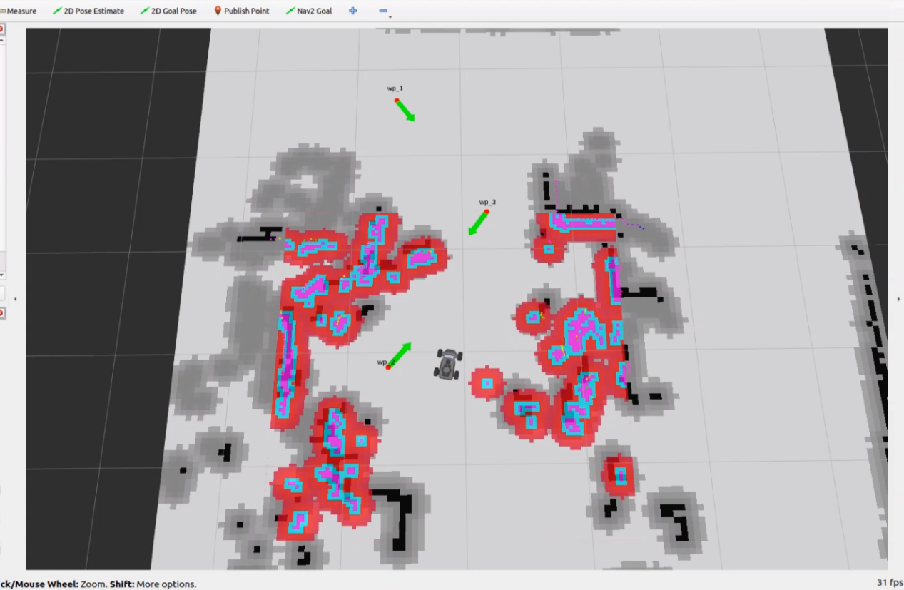

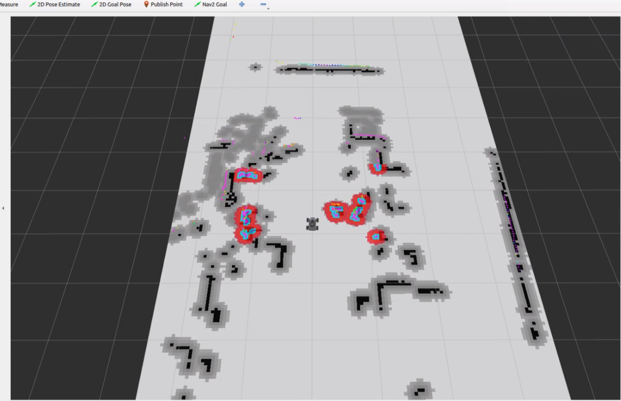

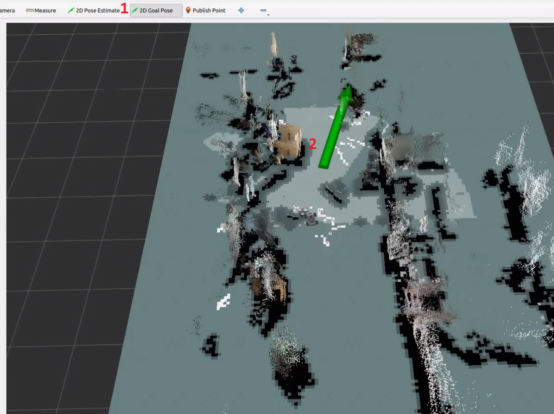

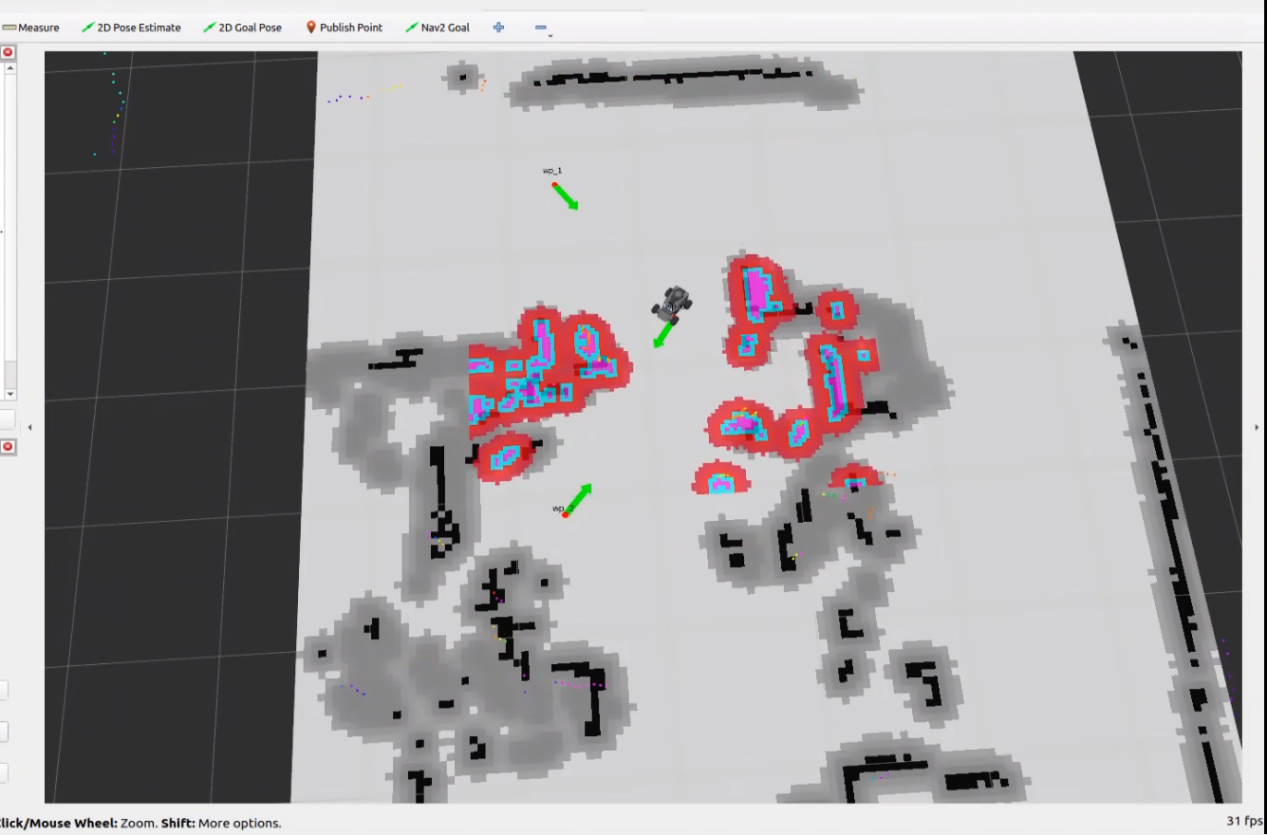

5.2.4.1 Single-Point Navigation

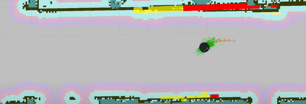

In the software menu bar, 2D Pose Estimate is used to set the robot’s initial position, and 2D Nav Goal is used to set a single target point for the robot.
To set the robot’s initial position, click on
in the software interface, select a location on the map, then click and drag the mouse to choose the robot’s pose.
After setting the robot’s initial position, the result is as shown below where the robot’s LiDAR point cloud data overlaps with the obstacles in the map.

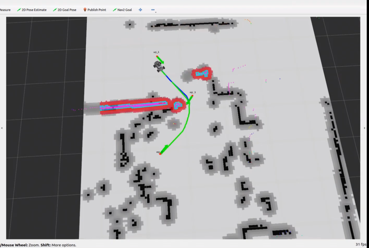

Click the icon
and select a target point on the map. Simply click once at the target point on the map. After the selection, the robot will automatically generate a route and move toward the target point.
Once the target point is set, the map displays two paths. The green line represents the straight path between the robot and the target point. The dark blue line represents the robot planned path.
When the robot reaches the set target point, navigation is complete.

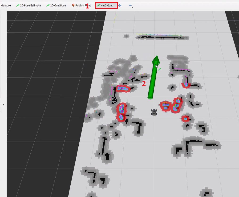

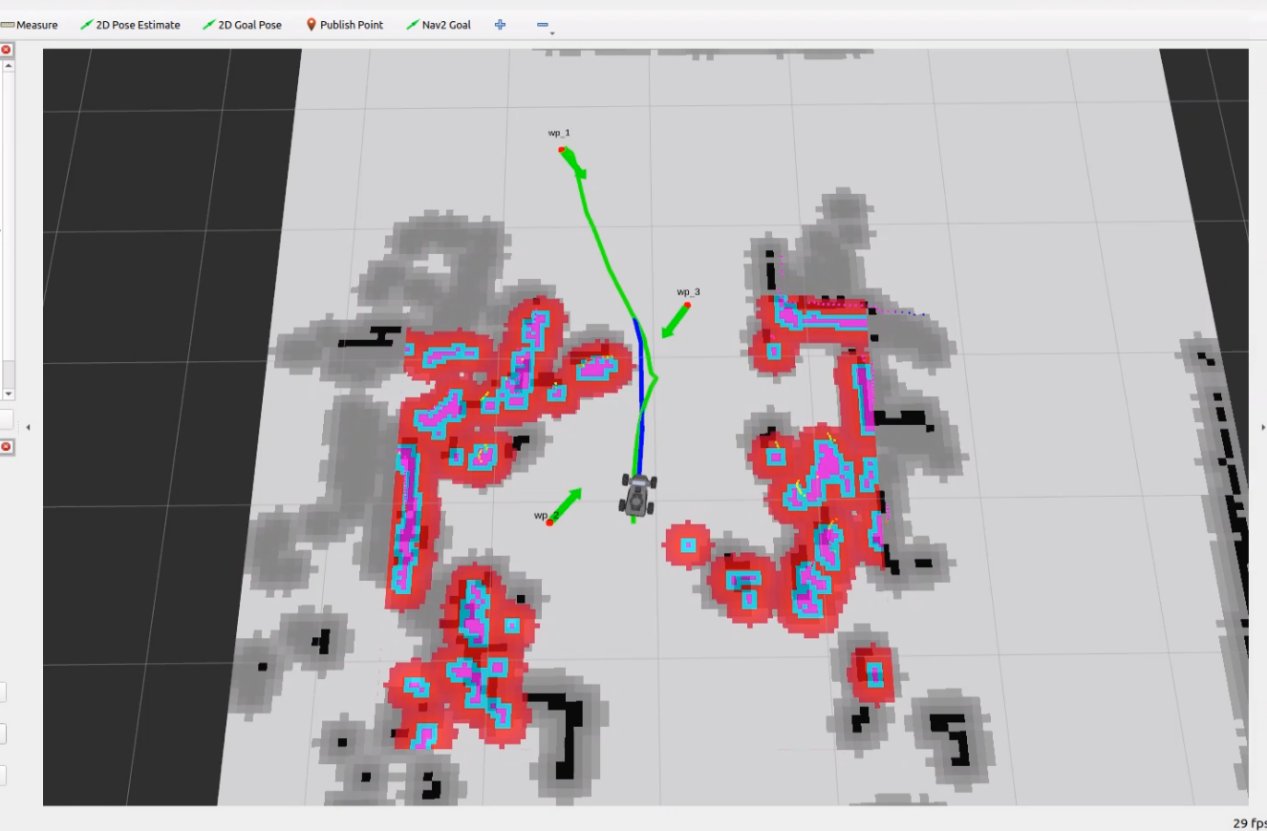

5.2.4.2 Multi-Point Navigation

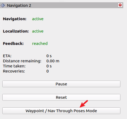

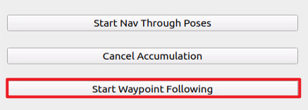

In the RViz2 software tool, find the navigation toolbar in the lower left corner, then click the Waypoint button to enter multi-point navigation mode.
Click the Nav2 Goal button to set the goals.
Next, set the robot’s navigation points in the non-obstacle areas of the map:
The setting method involves left-clicking to set a target point, then dragging the mouse to set the robot’s orientation. The direction indicated by the arrow is the robot’s forward direction. The example below shows three target points set for the robot.
Finally, click Start Nav Through Poses or Start Waypoint Following to enable navigation. Start Nav Through Poses will control the robot’s posture at each navigation point. Start Waypoint Following will not focus on the robot’s posture at each navigation point. It is recommended to use Start Waypoint Following for navigation.
The result of multi-point navigation is shown in the image below, with the robot reaching the target points in sequence.
When the robot reaches the last set target point, it indicates that the multi-point navigation is complete.
5.2.4.3 Exit Navigation
Right-click on the system command terminal icon, then click New Window to open a new command terminal.
Next, enter the following command and press Enter to execute the program for all ROS nodes in the current system environment. If it does not close successfully, try a few more times.

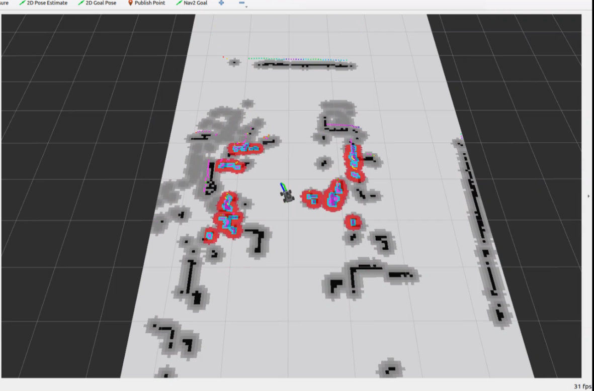

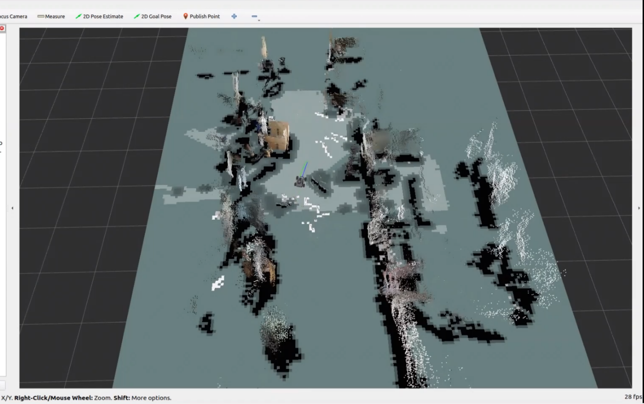

5.2.5 RTAB-VSLAM 3D Navigation
5.2.5.1 Algorithm Introduction and Principles
For an introduction to the RTAB-VSLAM algorithm and its principles, refer to the section 5.1.5 RTAB-VSLAM 3D Mapping in this tutorial for learning and reference.
5.2.5.2 Operating Steps
Enter the following command and press Enter to start the navigation service.
ros2 launch navigation rtabmap_navigation.launch.py
ros2 launch navigation rviz_rtabmap_navigation.launch.py
The program will appear as shown below after starting successfully.

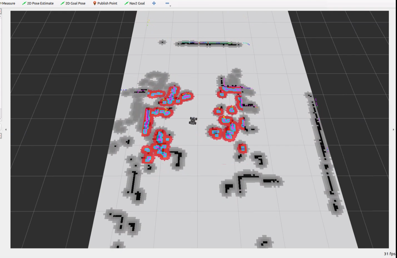

Click on the target point setting icon
at the top of the software to set a navigation target point for the robot.Select a location on the map and click once with the mouse at the desired target point on the map interface. After the selection, the robot will automatically generate a route and move toward the target point.
Once the target point is set, the map will display two paths. The robot will move towards the target along these two paths.
The green path is the global path planned by the global planner.
The blue path is the local path planned by the local planner.
When encountering obstacles, the robot will bypass them while continuously adjusting its posture and trajectory.

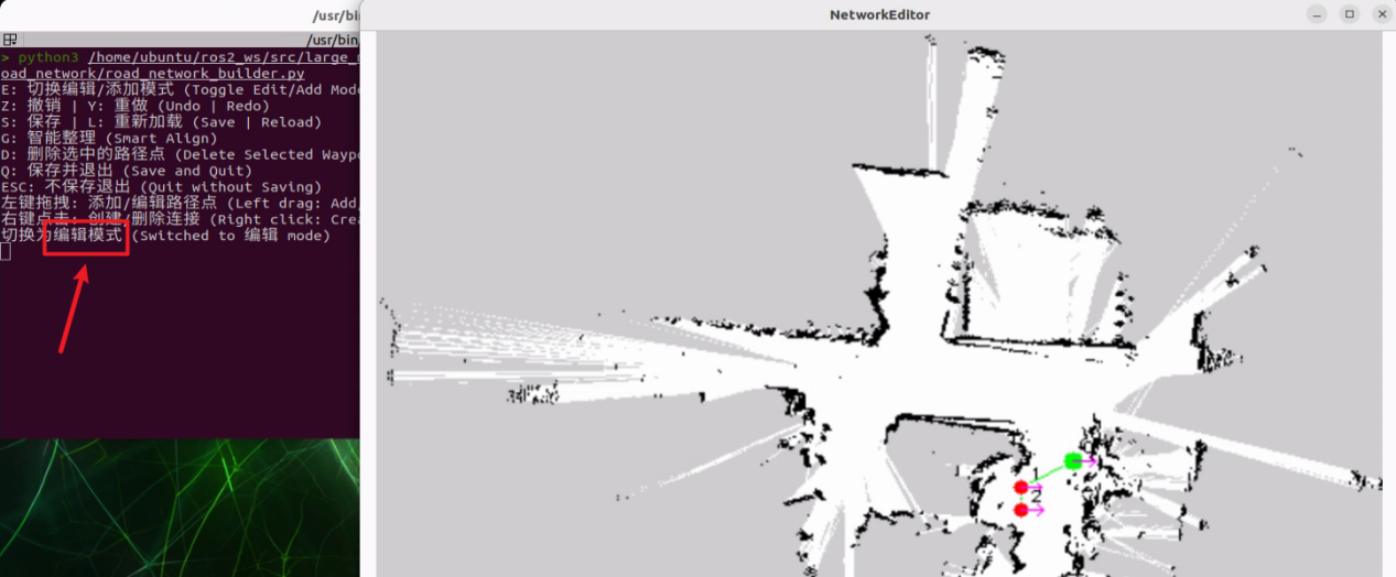

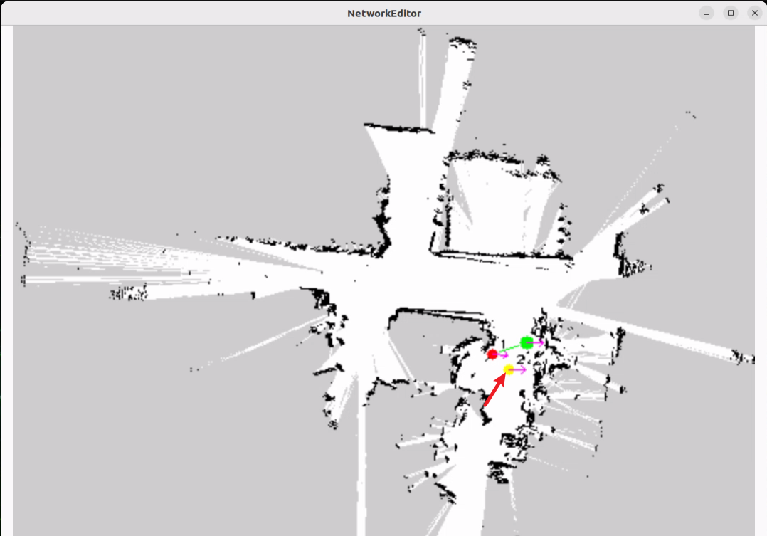

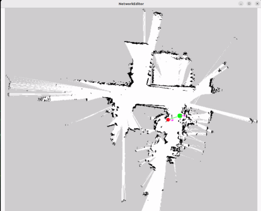

Editing the Waypoint Network
on the system desktop to open a terminal. Run the following command to stop the app auto-start service:sudo systemctl stop start_app_node.service
Run the following command to open the graphical editor for route-network waypoint editing:
python3 /home/ubuntu/ros2_ws/src/large_models_examples/large_models_examples/road_network/road_network_builder.py

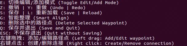

Command references can be viewed in the terminal.

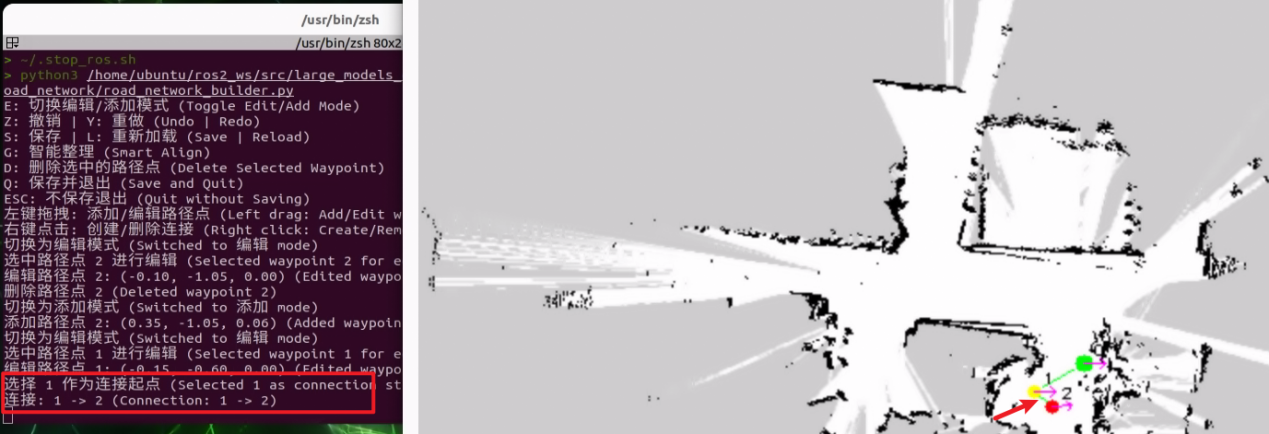

Click the graphical editor, then press E to switch to Edit Mode.
In Edit Mode, left-click waypoint 2 to select it, then press D to delete the waypoint.
Press E again to enter Add Mode. In Add Mode, left-click and drag the mouse to create a new waypoint.
Press E again to return to Edit Mode. Right-click waypoint 1 and select it as the connection point. Then right-click waypoint 2 to connect waypoints 1 and 2.
For other operations, refer to the command references shown in the terminal.
Press Q to save the data and quit. Press Esc to exit without saving.
Default save path: /home/ubuntu/ros2_ws/src/large_models_examples/large_models_examples/road_network/config/road_network.yaml

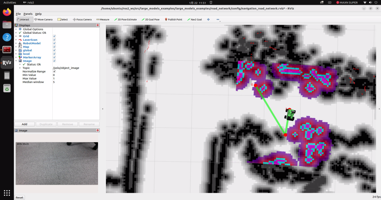

5.2.6.3 Operational Steps

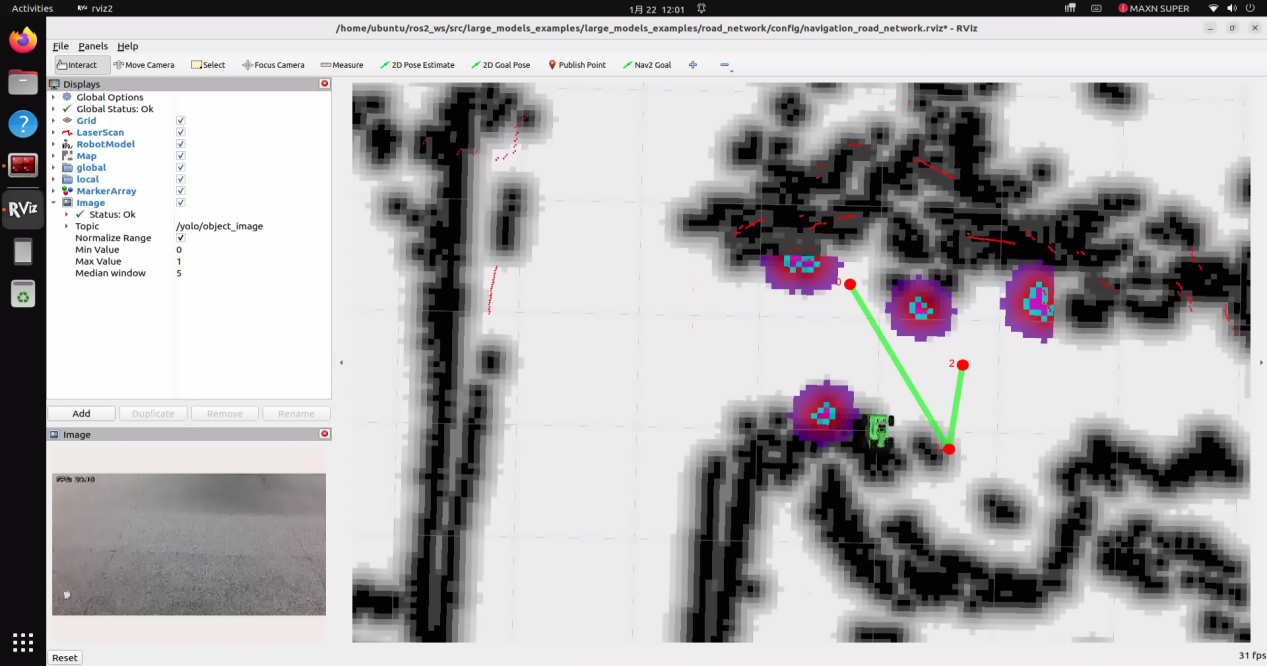

Run the following command to start route planning:
ros2 launch large_models_examples road_network.launch.py
Open another terminal and run the following command to send the robot to waypoint 2.
Publish the waypoint ID to the
/request_waypointtopic:ros2 topic pub /request_waypoint std_msgs/msg/Int32 "data: 2" --once
The robot will move to waypoint 2.

p1 = Point(x=float(start_pose[0]), y=float(start_pose[1]), z=0.0)
p2 = Point(x=float(end_pose[0]), y=float(end_pose[1]), z=0.0)
edge_marker.points.append(p1)
edge_marker.points.append(p2)
marker_array.markers.append(edge_marker)
# Draw numbers - Text & Fill sphere points
for nid, pose_data in self.waypoints.items():
# === A. Create red flat disk - simulated with cylinder ===
disk_marker = Marker()
disk_marker.header.frame_id = self.frame_id
disk_marker.ns = "node_disks" # Namespace
disk_marker.id = nid
disk_marker.type = Marker.CYLINDER # Use cylinder
disk_marker.action = Marker.ADD
# Set position
disk_marker.pose.position.x = float(pose_data[0])
disk_marker.pose.position.y = float(pose_data[1])
disk_marker.pose.position.z = 0.01 # Slightly off the ground to prevent overlap flickering
# Set orientation - default vertical up is fine
disk_marker.pose.orientation.w = 1.0
# Set size - squash the cylinder
disk_marker.scale.x = 0.10 # Diameter
disk_marker.scale.y = 0.10 # Diameter
disk_marker.scale.z = 0.01
# Set color - red
disk_marker.color.r = 1.0
disk_marker.color.g = 0.0
disk_marker.color.b = 0.0
disk_marker.color.a = 1.0
marker_array.markers.append(disk_marker)
# === B. Create text numbering ===
text_marker = Marker()
text_marker.header.frame_id = self.frame_id
text_marker.ns = "node_ids"
text_marker.id = nid
text_marker.type = Marker.TEXT_VIEW_FACING
text_marker.action = Marker.ADD
text_marker.text = str(nid)
text_marker.scale.z = 0.10
text_marker.color.r = 1.0
text_marker.color.g = 0.0
text_marker.color.b = 0.0
text_marker.color.a = 1.0
text_marker.pose.position.x = float(pose_data[0])
text_marker.pose.position.y = float(pose_data[1])+0.1
text_marker.pose.position.z = 0.05
marker_array.markers.append(text_marker)
self.marker_pub.publish(marker_array)
Draw the road network connections with a green LINE_LIST.
Draw the waypoint disks with red CYLINDER markers at each waypoint position.
Draw the waypoint IDs with TEXT_VIEW_FACING above each waypoint.
Finally, publish the complete MarkerArray.
