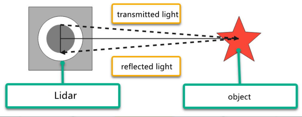

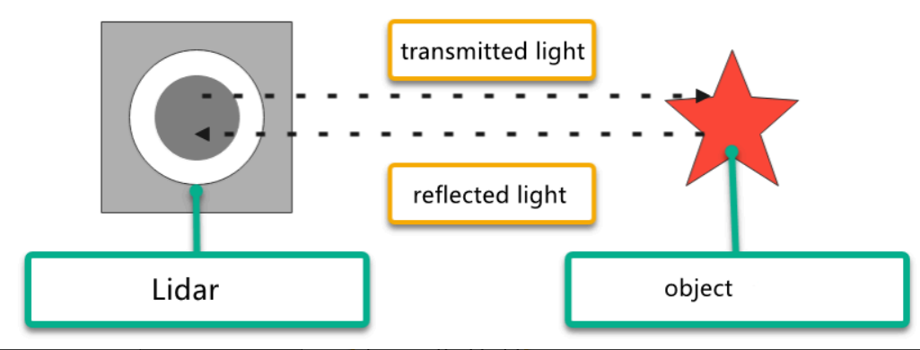

There are two common methods for LiDAR to obtain the distance to a target. One is triangulation, and the other is time of flight, or TOF.
ToF ranging can be understood by referring to the diagram below. The LiDAR first shines light onto the object, which then reflects the light directly back to the LiDAR. The LiDAR calculates the time it takes for the light to return, multiplies this time by the speed of light, and divides the result by two to determine the distance between the object and the LiDAR.
Triangulation can be understood with the figure below. During manufacturing, the LiDAR is adjusted so that the light does not strike the object directly, but instead reaches it at a fixed angle. This angle is preset and does not change during operation. The distance from the object to the LiDAR can then be calculated by applying trigonometric relationships to that angle.

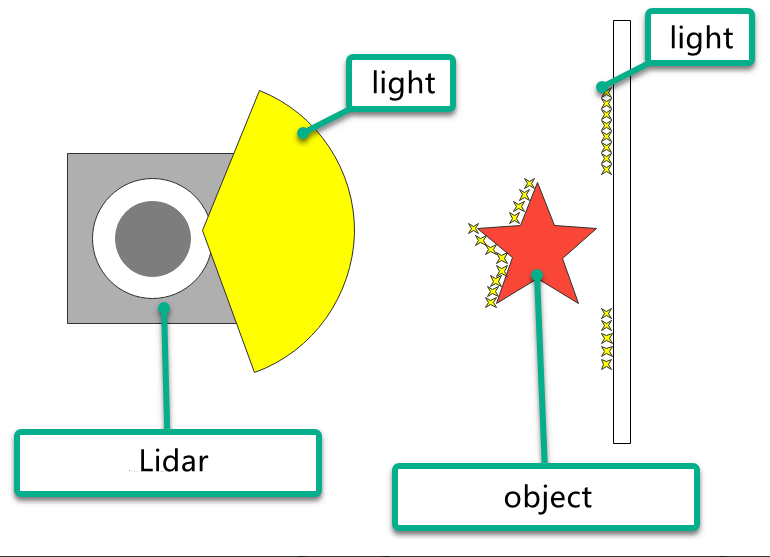

3.2.2 LiDAR Performance
The figure below illustrates the LiDAR effect. The LiDAR emits light that falls on the surface of an object. When the reflected light returns to the LiDAR, the contour of the object is marked at the positions reached by the light.
