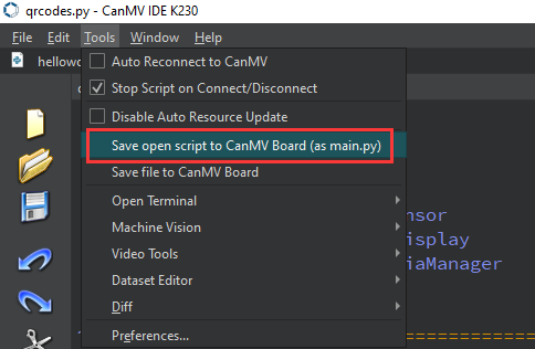

After connecting, drag the program Sensor.py into the CanMV IDE K230 code editor, click Tools in the toolbar, and select Save open script to CanMV Board (as main.py), as shown below:
Then click Yes.
Once the file is written, click OK to confirm and complete saving the MicroPython file to the K230 development board.
With this method, the K230 development board will automatically run the MicroPython file upon power-up without connection, enabling offline execution.

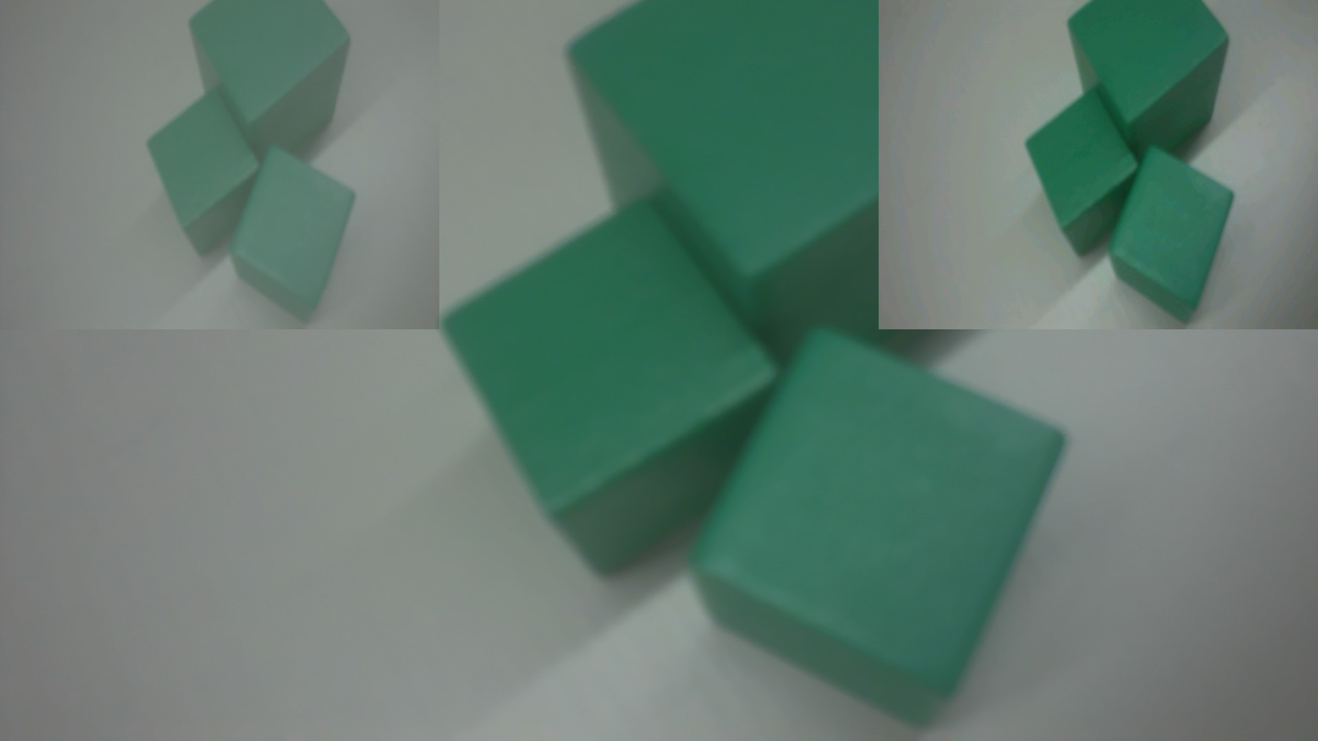

The same camera feed is simultaneously sent to three display areas on the HDMI screen in three different resolutions/formats for real-time comparison.

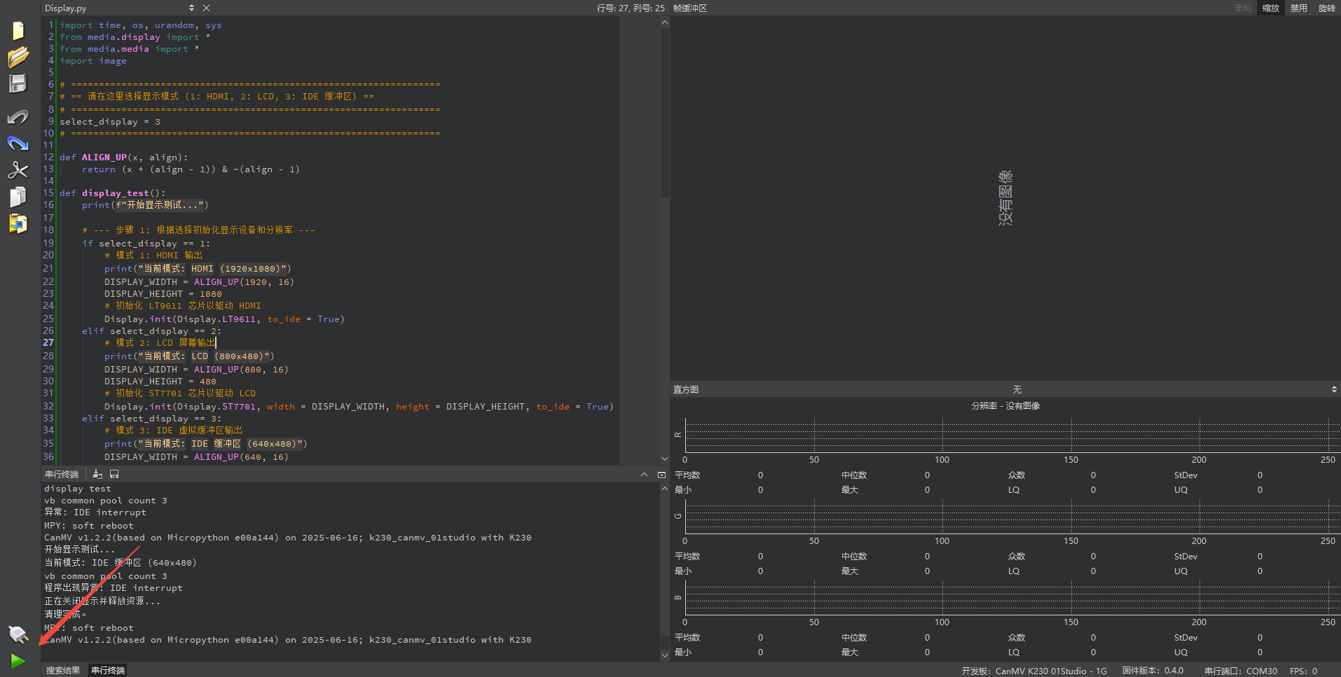

3.2.3 Program Execution and Download
Display Mode Configuration:
The program can use the select_display="" parameter to choose the display mode: HDMI, LCD, or IDE virtual.
The K230 program supports two operation modes: online execution and offline execution.
Online Execution:
After connecting, drag the program Display.py into the CanMV IDE K230 code editor, then click the run button
in the lower left corner to execute the program online, as shown below:
Programs run using this method will be lost after disconnecting or powering off, and will not be saved on the development board.
Offline Execution:
After connecting, drag the program Display.py from the same directory into the CanMV IDE K230 code editor, click Tools in the toolbar, and select Save open script to CanMV Board (as main.py), as shown below:
Then click Yes.

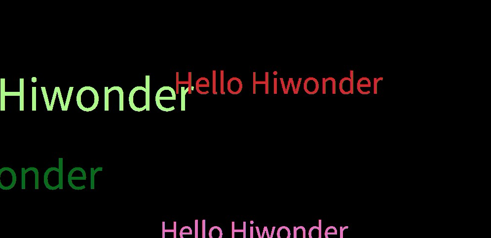

3.2.4 Program Outcome
On the screen, ten “Hello Hiwonder” strings appear every second, with their size, color, and position completely random. This creates a colorful, continuously flickering, dynamic text kaleidoscope effect.

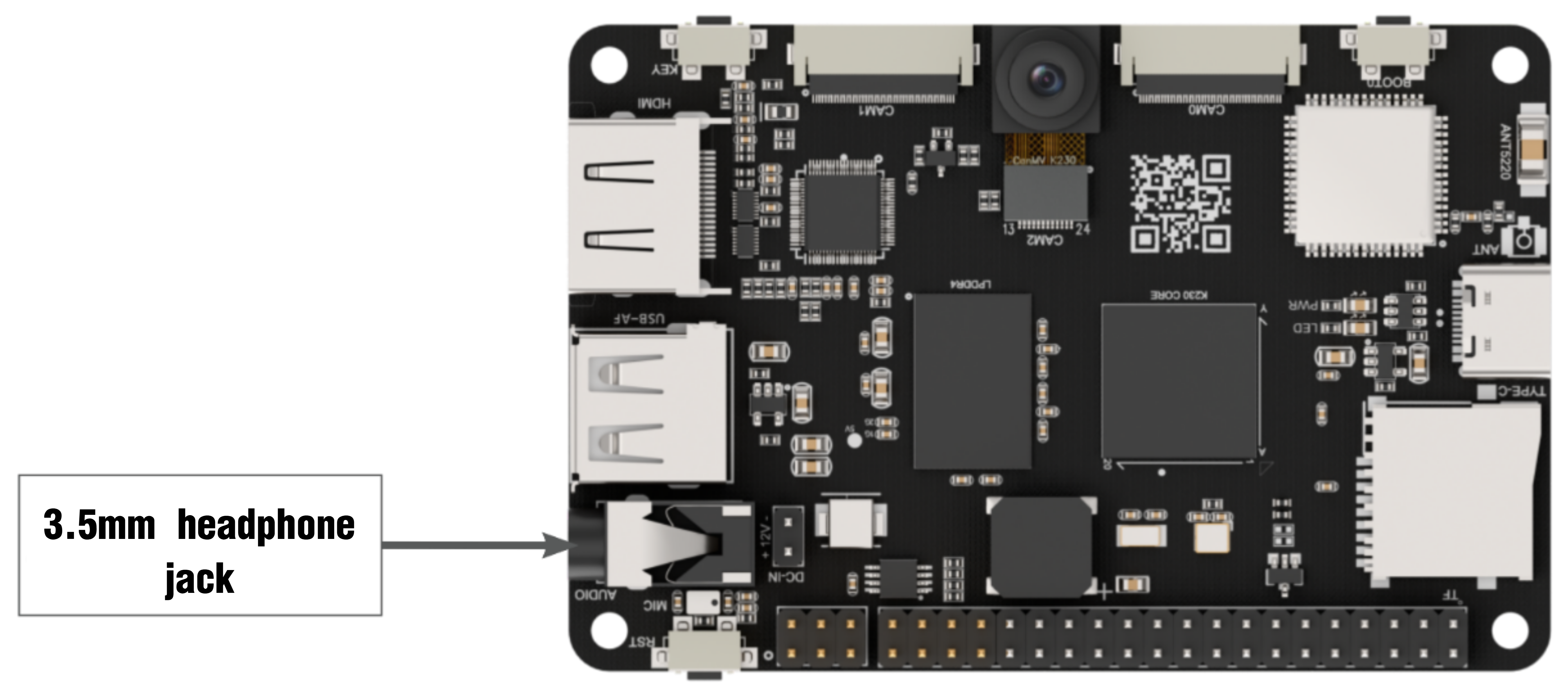

Hiwonder does not provide a built-in audio output device, so please prepare your own. For external speakers, connect them to the 3.5-millimeter headphone jack as shown in the figure below.

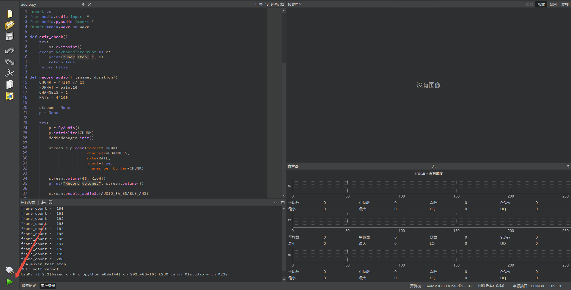

After connecting, drag the program audio.py into the CanMV IDE K230 code editor, then click the run button

After connecting, drag the program Video_Recording.py into the CanMV IDE K230 code editor, then click the run button

Offline Execution:
After connecting, drag the program audio.py from the same directory into the CanMV IDE K230 code editor, click Tools in the toolbar, and select Save open script to CanMV Board (as main.py), as shown below:
Then click Yes.

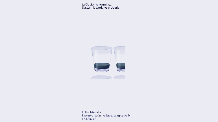

3.5.4 Program Outcome
Run the program on the K230 platform to display English text and dynamic animations in the LVGL graphical interface.
