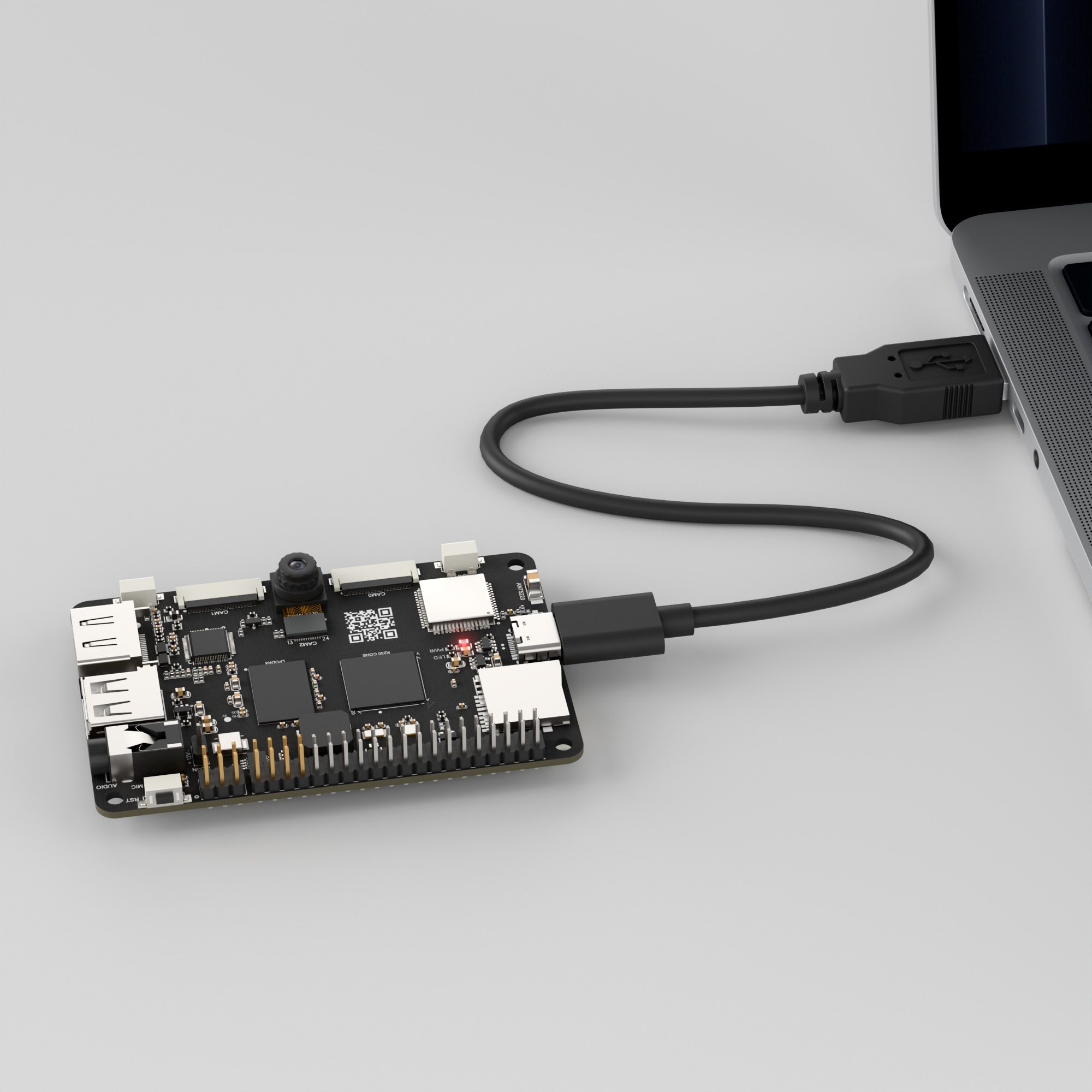

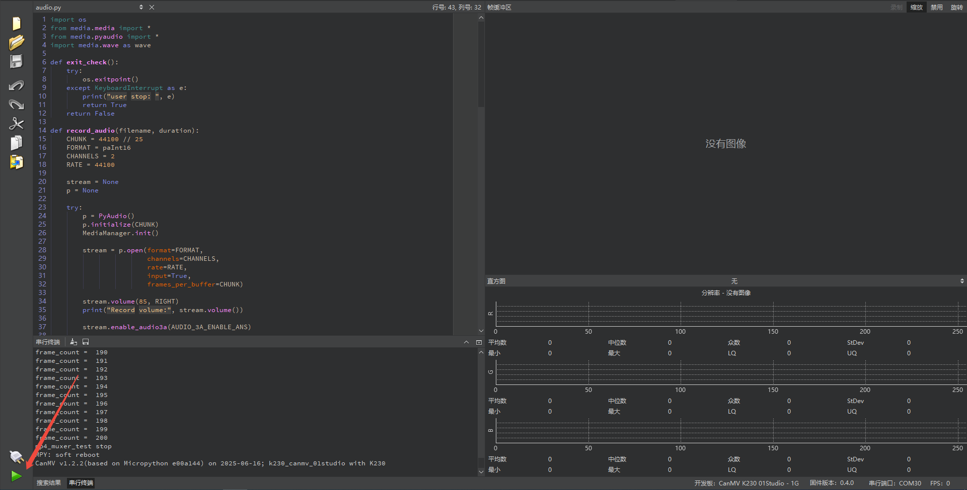

  1. Connect the K230 development board to your PC using a Type-C data cable, as shown in the figure below:
  1. Double-click to open CanMV IDE K230.
  1. Click the connection button in the lower left corner.
  1. When connected successfully, the lower left corner of the CanMV IDE software will display the icon shown below.
  1. If the connection takes more than 10 seconds, it indicates a connection failure. Click the Cancel button, and a pop-up window will appear. Click OK and recheck the connection.

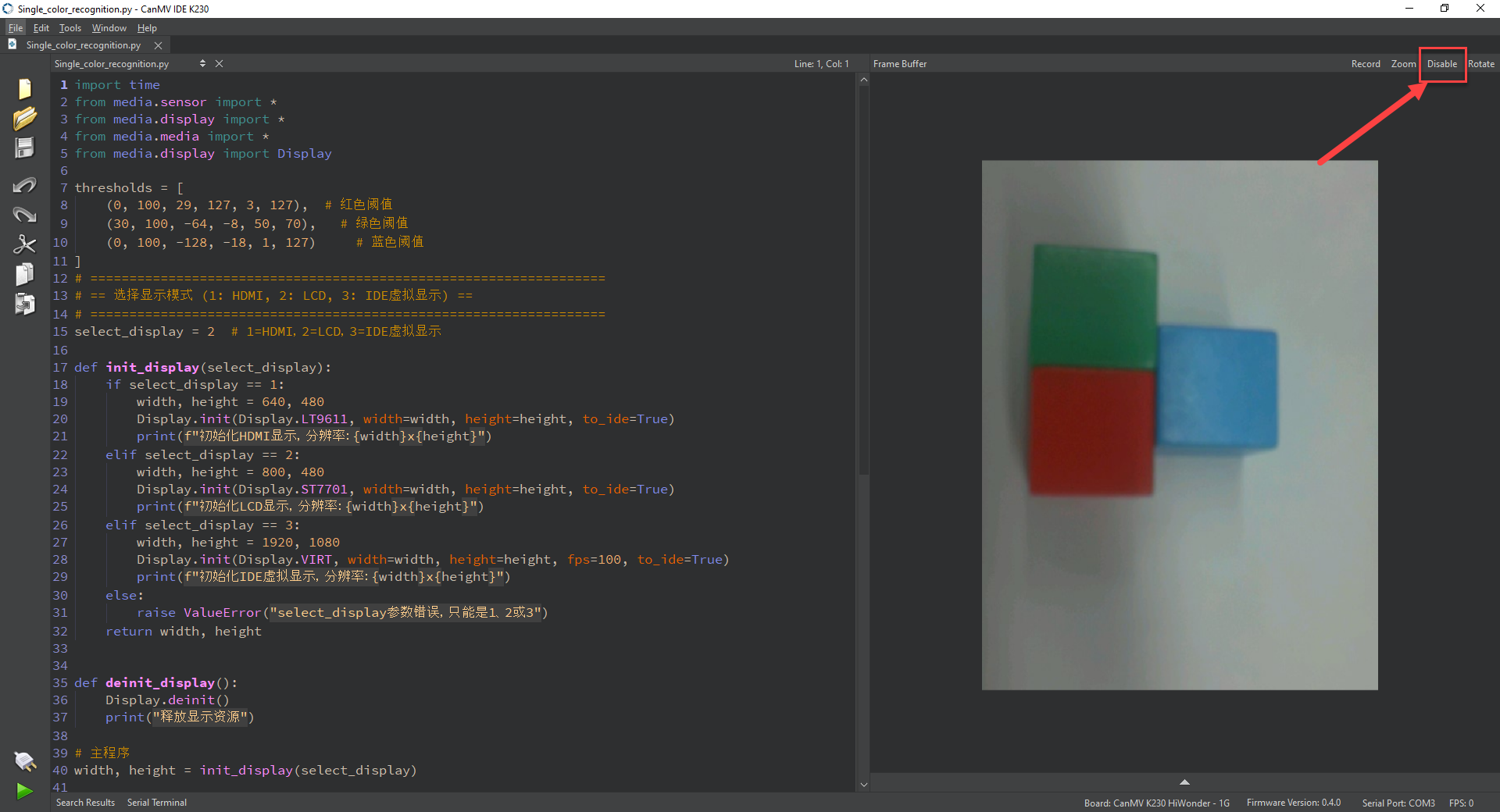

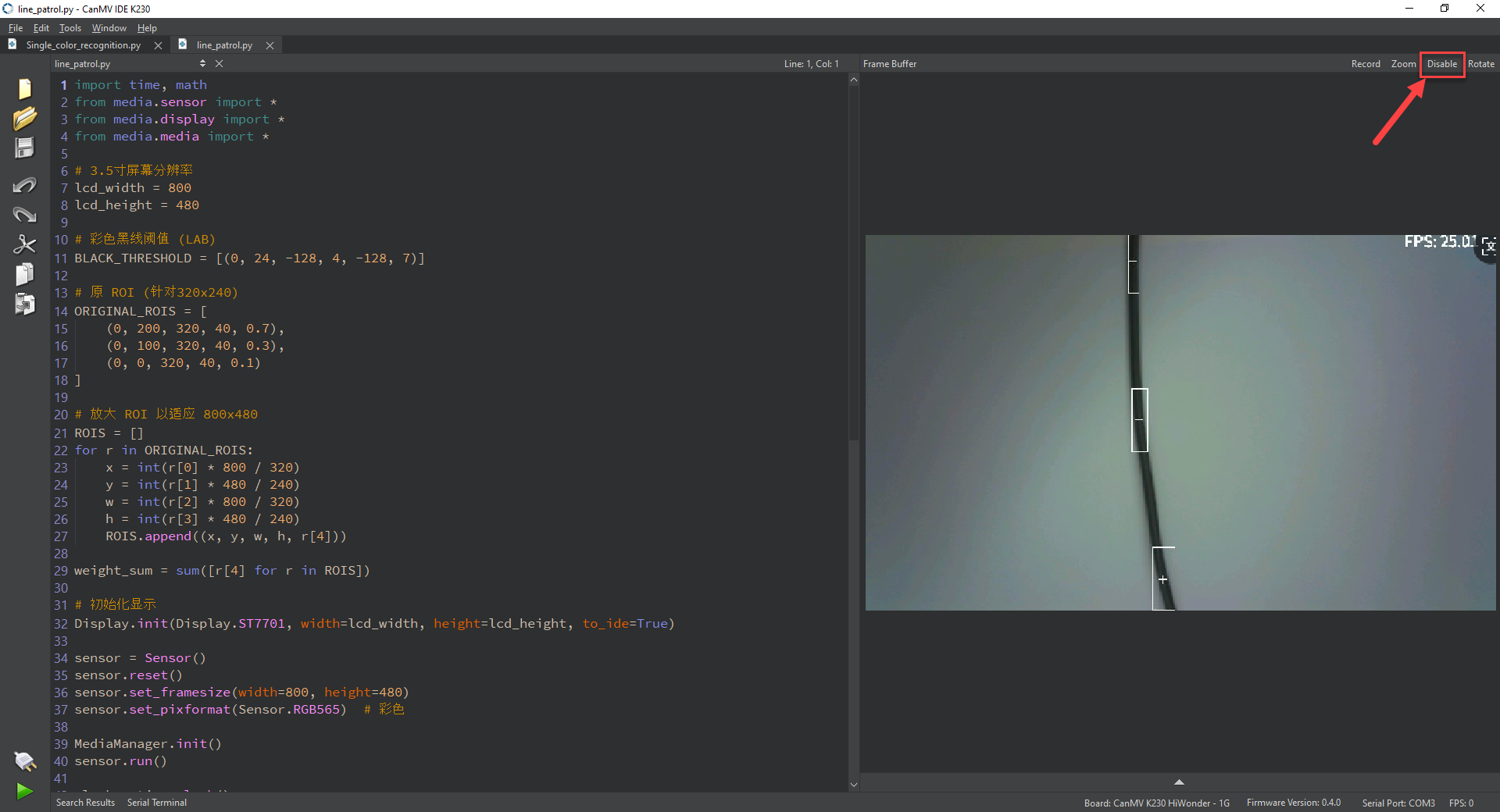

(2) Disable frame buffer.
Place the target color block in front of the camera, then click the button Disable in the upper right corner to capture the image.

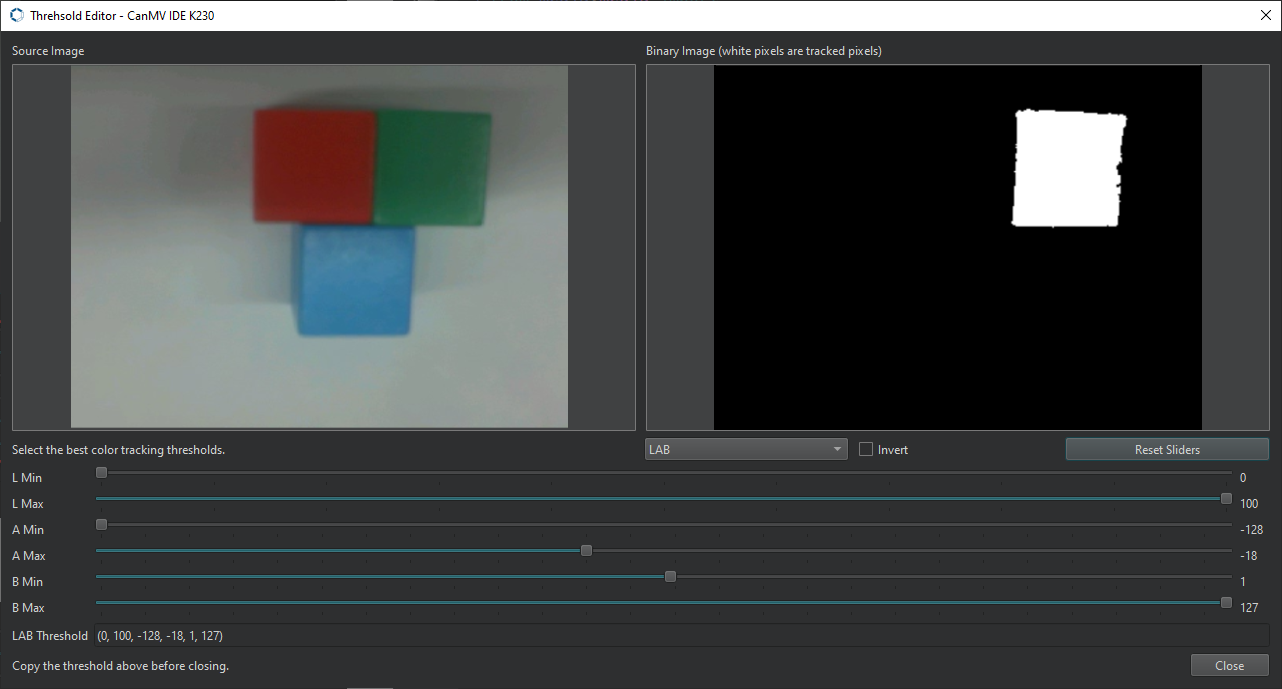

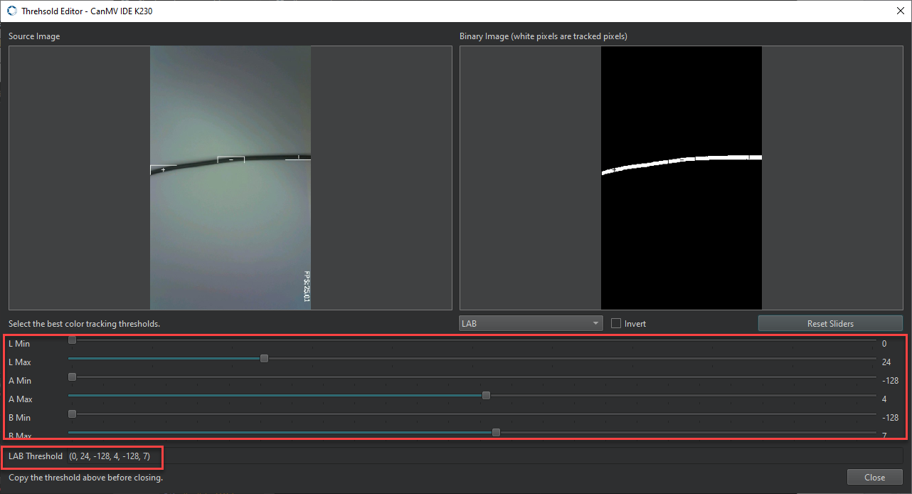

(3) Color threshold adjustment.

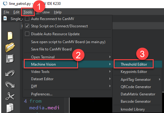

  1. Click Tools in the upper-left corner, then select Machine Vision and open the Threshold Editor.
  1. Select Frame Buffer.
  1. Drag the sliders until only the target color is detected in the processed image. In the preview on the right, the areas containing the desired color should appear in white, and all other areas should appear in black.
Black areas indicate colors that are not detected — the current LAB thresholds do not recognize those regions. White areas indicate colors that are detected — the current LAB thresholds can recognize those regions.
(4) Modify color recognition threshold.
  1. Copy the adjusted LAB threshold values.
  1. Paste the adjusted LAB threshold values into the corresponding color threshold.

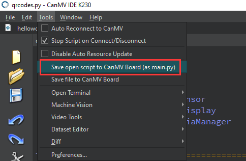

Offline Execution:
  1. After connection, drag the program Color_recognition.py from this section’s directory to the CanMV IDE K230 code editing area. Click Tools on the toolbar, then select Save open script to CanMV Board (as main.py) as shown below:
  1. Then click Yes.
  1. Once the file is written, click OK to confirm and complete saving the MicroPython file to the K230 development board.
With this method, the K230 development board will automatically run the MicroPython file upon power-up without connection, enabling offline execution.

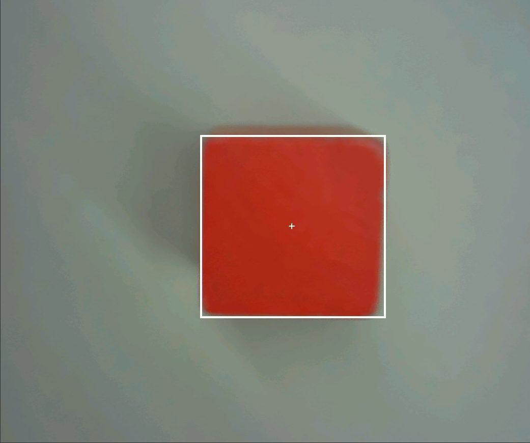

4.1.4 Program Outcome

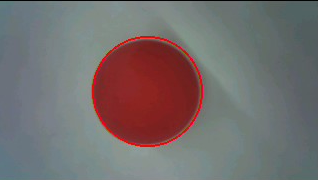

You can see a real-time video feed on the display. Whenever a red object enters the camera’s field of view, it is immediately detected and locked onto with a white crosshair.

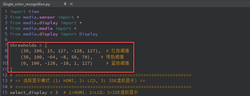

  • Thresholds (thresholds)
thresholds = [
    (0, 100, 29, 127, 3, 127),  # Red threshold
    (30, 100, -64, -8, 50, 70),   # Green threshold
    (0, 100, -128, -18, 1, 127)     # Blue threshold
# == Select display mode (1: HDMI, 2: LCD, 3: IDE Virtual Display) ==
select_display = 1  # 1=HDMI, 2=LCD, 3=IDE Virtual Display
  1. thresholds: This is a list containing threshold definitions for two colors in the format (L Min, L Max, A Min, A Max, B Min, B Max), defined in the LAB color space.
  2. thresholds[0]:(30, 100, 15, 127, -128, 127) is the threshold for red.
  3. thresholds[1]: (30, 100, -64, -8, 50, 70) is the threshold for green.
  4. thresholds[2]: (0, 100, -128, -18, 1, 127) is the threshold for blue.

        img = sensor.snapshot()
        blobs = img.find_blobs([thresholds[0]])
        if blobs:
            for b in blobs:
                img.draw_rectangle(b[0:4], thickness=4)
                img.draw_cross(b[5], b[6], thickness=2)
        img.draw_string_advanced(0, 0, 30, 'FPS: {:.3f}'.format(clock.fps()), color=(255, 255, 255))
        Display.show_image(img)
        print(clock.fps())
  1. img = sensor.snapshot() captures one frame.
  2. find_blobs() returns a collection of detected red regions, with each element containing rectangle position, center point, area, and other information.

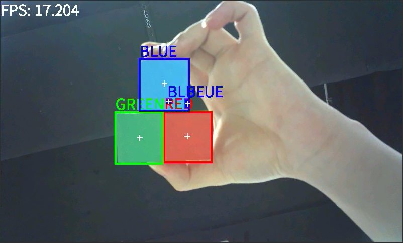

A real-time video feed is displayed, and any object in red, green, or blue entering the field of view will be detected.

  • Main Loop for Image Acquisition and Color Detection
            clock.tick()
            for i in range(3):
                blobs = img.find_blobs([thresholds[i]])
                if blobs:
                    for b in blobs:
                        img.draw_rectangle(b[0:4], thickness=4, color=colors1[i])
                        img.draw_string_advanced(b[0], b[1]-35, 30, colors2[i], color=colors1[i])
            print(clock.fps())
    except KeyboardInterrupt:
        print("User interrupted program")  # User interrupted program
  1. img = sensor.snapshot() captures one frame of data.
  2. blobs = img.find_blobs([thresholds[i]]) iterates through the three colors: red, green, and blue.
  3. img.draw_rectangle(), img.draw_cross(), and img.draw_string_advanced() draw the corresponding annotations.
  4. img.draw_string_advanced(0, 0, 30, 'FPS: {:.3f}'.format(clock.fps()), color=(255, 255, 255)) displays the frame rate.

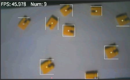

4.3.4 Program Outcome
Run the program to enable threshold-based counting of yellow jumper caps on the K230 board.

  • Display Initialization
select_display = 2  # 1=HDMI, 2=LCD, 3=IDE Virtual Display
Where 1 is HDMI display output, 2 is LCD screen display output, and 3 is IDE virtual display output.
  • Camera Initialization
    # Initialize display and get width and height
    width, height = init_display(select_display)
    sensor = Sensor()
    sensor.reset()
    sensor.set_framesize(width=width, height=height)
    sensor.set_pixformat(Sensor.RGB565)

  • Main Loop: Image Capture and Detection
            clock.tick()
            if blobs:
                for b in blobs:
                    img.draw_rectangle(b[0:4])
                    img.draw_cross(b[5], b[6])
            # Display FPS and count
            img.draw_string_advanced(0, 0, 30, f'FPS: {clock.fps():.3f}    Num: {len(blobs)}', color=(255, 255, 255))
            print(clock.fps())
  1. img = sensor.snapshot() captures one frame of image.
  2. blobs = img.find_blobs([thresholds[0]]) searches the image for color blocks that match the yellow threshold and returns them as a list.
  • Draw Detection Results
            print(clock.fps())
  1. FPS: Real-time processing frame rate.
  2. Num: Number of detected yellow objects, which is the result of len(blobs).
  3. Send the annotated image to the LCD display.

4.4.3 Color Threshold Configuration
  • Connect to the K230 board for online execution.

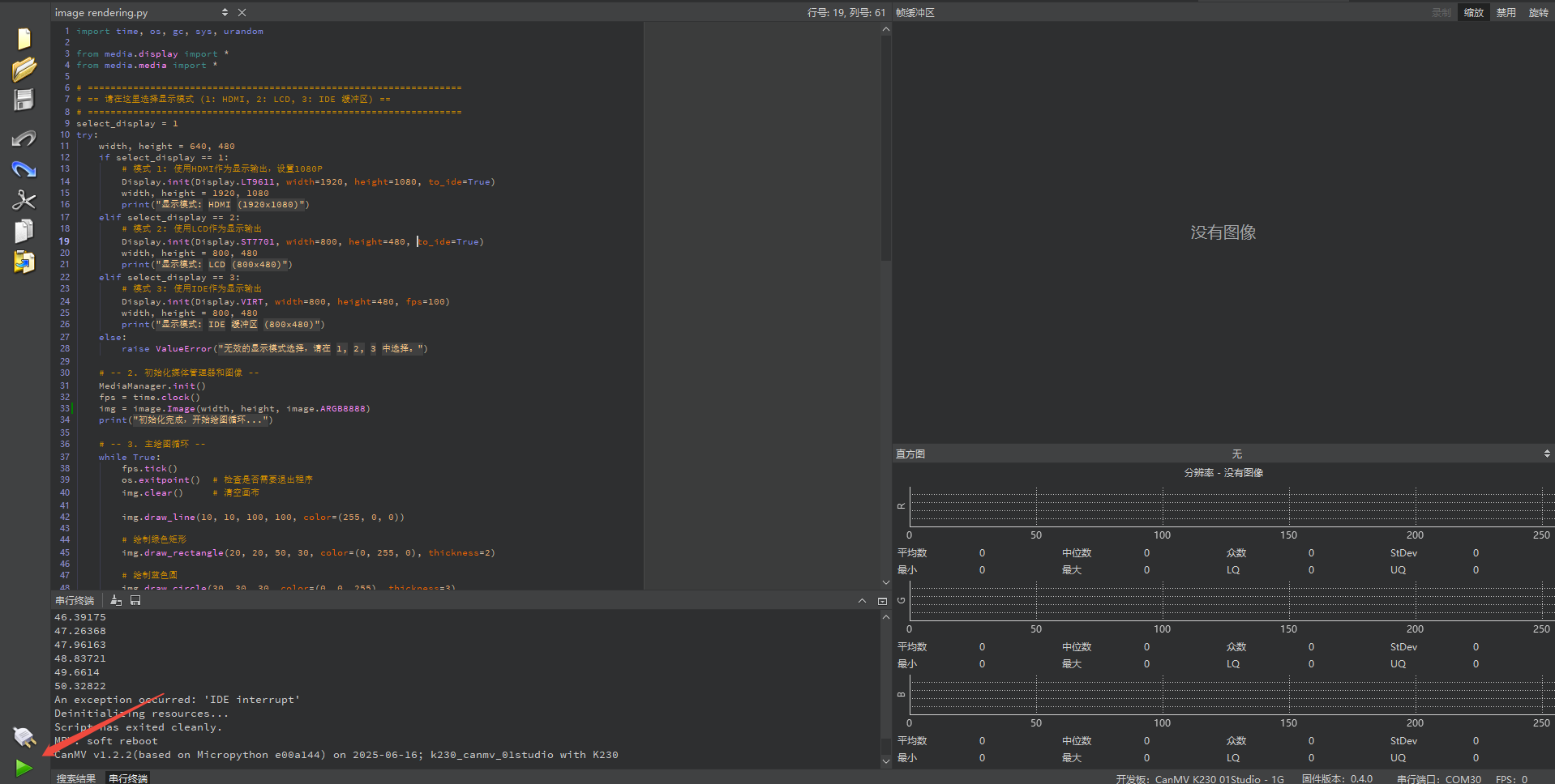

Online Execution:
After connection, drag the program line_patrol.py from this section’s directory to CanMV IDE K230 code editing area, then click the run button in the lower left corner to run the program online, as shown below:
Programs run this way will be lost after disconnection or power-off and are not saved to the development board.
  • Disable Frame Buffer
  • Color Threshold Adjustment
  • Modify Color Recognition Threshold

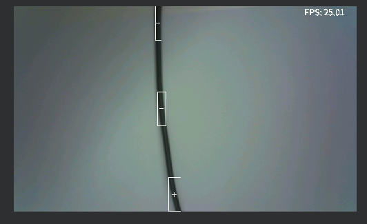

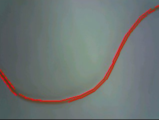

4.4.5 Program Outcome
Run the program to implement visual line following with the K230.
4.4.6 Program Analysis
  • Import Required Libraries
import time, math
from media.sensor import *
from media.display import *
from media.media import *

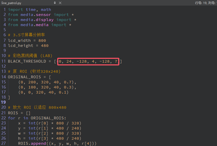

  • Initialize Parameters
# 3.5-inch screen resolution
lcd_width = 800
lcd_height = 480
# Color black line threshold (LAB)
BLACK_THRESHOLD = [(0, 24, -128, 4, -128, 7)]
  1. lcd_width = 800, lcd_height = 480 initializes the screen resolution.
  2. BLACK_THRESHOLD = [(0, 24, -128, 4, -128, 7)] sets the line following threshold.
# Original ROI for 320x240
ORIGINAL_ROIS = [
    (0, 200, 320, 40, 0.7),
    (0, 100, 320, 40, 0.3),
    (0, 0, 320, 40, 0.1)
# Scale ROI to fit 800x480
ROIS = []
for r in ORIGINAL_ROIS:
    x = int(r[0] * 800 / 320)
    y = int(r[1] * 480 / 240)
    w = int(r[2] * 800 / 320)
    h = int(r[3] * 480 / 240)
    ROIS.append((x, y, w, h, r[4]))
weight_sum = sum([r[4] for r in ROIS])
  1. ORIGINAL_ROIS = [] initializes ROI and sets line following weights.
  • Camera and Display Initialization
Display.init(Display.ST7701, width=lcd_width, height=lcd_height, to_ide=True)
sensor = Sensor()
sensor.reset()
sensor.set_framesize(width=800, height=480)
sensor.set_pixformat(Sensor.RGB565)  # Color mode
MediaManager.init()
sensor.run()
clock = time.clock()
fps_list = []  # For smoothing FPS
  1. Display.init() initializes the LCD display screen.
  2. sensor = Sensor() creates a sensor object.
  3. sensor.reset() resets the sensor.
  4. sensor.set_framesize(width=800, height=480) sets the resolution to 800x480.
  5. sensor.set_pixformat(Sensor.RGB565) sets to color mode.
  6. MediaManager.init() initializes the multimedia manager.
  7. sensor.run() starts camera capture.
  8. clock = time.clock() creates a clock object for FPS calculation.
  • Main Loop Process
    clock.tick()
    centroid_sum = 0
    for r in ROIS:
        blobs = img.find_blobs(BLACK_THRESHOLD, roi=r[0:4], merge=True)
        if blobs:
            # Get the blob with maximum area
            largest_blob = max(blobs, key=lambda b: b.pixels())
            # Draw rectangle and center point
            img.draw_rectangle(largest_blob[0:4])
            img.draw_cross(largest_blob[5], largest_blob[6])
            centroid_sum += largest_blob.cx() * r[4]
    # Calculate smoothed FPS
    fps = max(clock.fps(), 0)
    fps_list.append(fps)
    if len(fps_list) > 10:
        fps_list.pop(0)
    avg_fps = sum(fps_list) / len(fps_list)
    # Display FPS in upper right corner
    fps_text = 'FPS: %.2f' % avg_fps
    text_width = len(fps_text) * 12  # Estimate text width, 12 is approximate font size
    img.draw_string_advanced(lcd_width - text_width - 2, 2, 20, fps_text, color=(255, 255, 255))
    # Center the display image
    x_offset = round((lcd_width - sensor.width()) / 2)
    y_offset = round((lcd_height - sensor.height()) / 2)
    Display.show_image(img, x=x_offset, y=y_offset)
    print("FPS: %.2f" % avg_fps)
  1. clock.tick() records the frame start time.
  2. img = sensor.snapshot() captures an image.
  3. for r in ROIS: Iterates through each ROI region.
  4. blobs = img.find_blobs(BLACK_THRESHOLD, roi=r[0:4], merge=True) searches for regions matching the threshold of black lines within each ROI.
  5. if blobs: If black regions are found.
  6. largest_blob = max() gets the blob with maximum area.
  7. img.draw_rectangle() draws the corresponding three rectangles.
  8. img.draw_cross() draws the center point of the rectangles.

After connection, drag the program qrcodes.py to CanMV IDE K230 code editing area, then click the run button in the lower left corner to run the program online, as shown below:
Offline Execution:
  1. After connection, drag the program qrcodes.py from this section’s directory to the CanMV IDE K230 code editing area. Click Tools on the toolbar, then select Save open script to CanMV Board (as main.py) as shown below:
  1. Then click Yes.

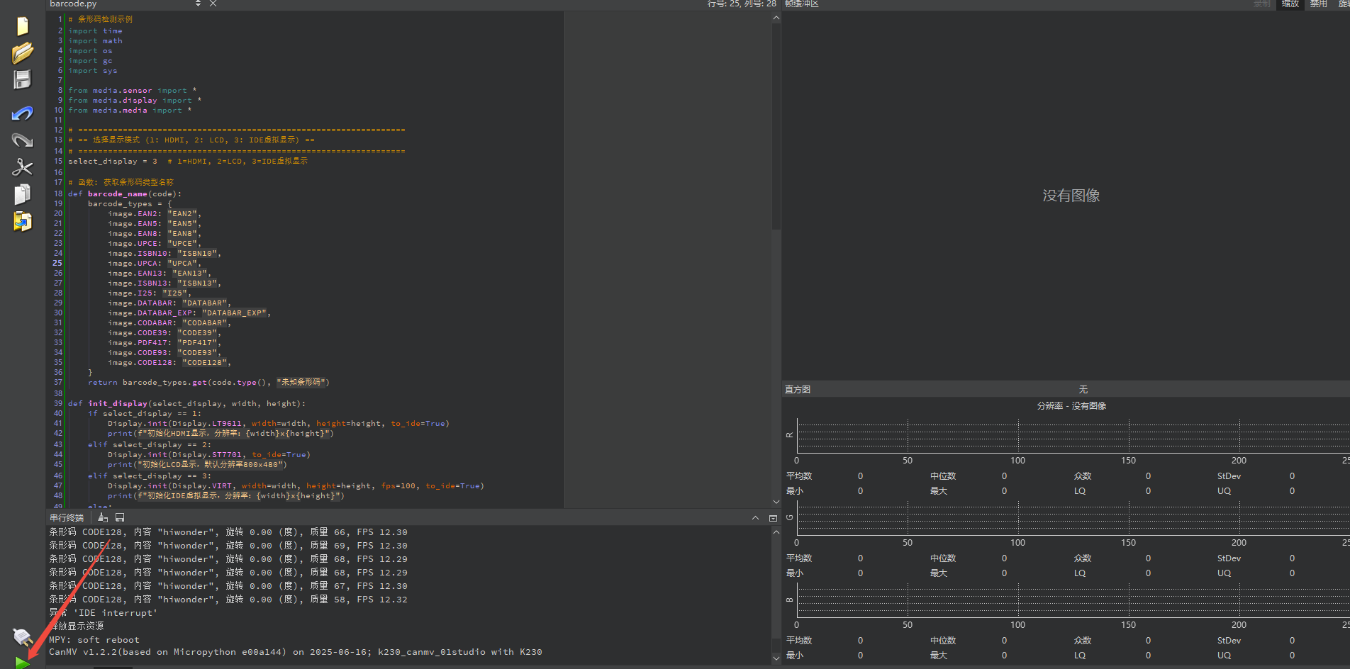

4.6.3 Program Execution and Download
Display Effect Modification
The program can use the select_display="" parameter to choose the display mode: HDMI, LCD, or IDE virtual.
The K230 program supports two operation modes: online execution and offline execution.
Online Execution:
After connection, drag the program barcode.py to CanMV IDE K230 code editing area, then click the run button in the lower left corner to run the program online, as shown below:
Offline Execution:
  1. After connection, drag the program barcode.py from this section’s directory to the CanMV IDE K230 code editing area. Click Tools on the toolbar, then select Save open script to CanMV Board (as main.py) as shown below:
  1. Then click Yes.

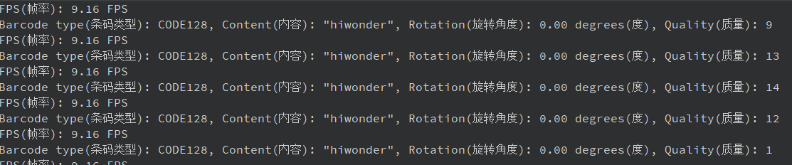

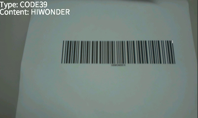

4.6.4 Program Outcome
Original image:
When the camera faces the barcode, upon successful recognition, a box will appear around the image, and the barcode information will be printed in the serial terminal.

sensor.set_framesize(width=CAM_WIDTH, height=CAM_HEIGHT)
# Set output image format to RGB565, default channel 0
init_display(select_display, CAM_WIDTH, CAM_HEIGHT)
MediaManager.init()
# Start camera
sensor.run()
# Create clock object for frame rate calculation
  1. sensor.reset() resets the camera.
  2. fps_clock = time.clock() creates a clock object for frame rate calculation.
  • Main Loop
    # Main loop
        clock.tick() # Update clock for frame rate calculation
        img = sensor.snapshot() # Capture an image
        codes = img.find_barcodes() # Find all barcodes in the image
        # Iterate through all found barcodes
        for code in codes:
            # Draw rectangle to mark barcode, default color white, line width 2 pixels
            img.draw_rectangle(code.rect(), thickness=2)
            # Print barcode information to console, using Chinese description and f-string formatting
            # rotation() returns radians, convert to degrees
            # Print barcode-related information to the console using text descriptions and f-string formatting
            print(f"Barcode type: {barcode_name(code)}, Content: \"{code.payload()}\", Rotation angle: {(180 * code.rotation()) / math.pi:.2f} degrees, Quality: {code.quality()}")
            # Barcode type, Content, Rotation angle, degrees, Quality
            img.draw_string_advanced(0, 0, 30, f"Type: {barcode_name(code)}", color = (255, 255, 255))  # Type
            img.draw_string_advanced(0, 30, 30, f"Content: {code.payload()}", color = (255, 255, 255))  # Content
        Display.show_image(img) # Display processed image on screen
        print(f"Frame rate: {clock.fps():.2f} FPS") # Print current frame rate to console
  1. Call fps_clock.tick() to update the clock for FPS calculation.
  2. img = sensor.snapshot() captures one frame of image.
  3. Display.show_image(img) displays the image to the screen.
  • Exception Handling and Program Exit
    print("Program interrupted, releasing resources...")  # Program interrupted, releasing resources
finally:
    deinit_display()
    sensor.stop() # Stop camera
    print("Resources released, program exited.")  # Resources released, program exited

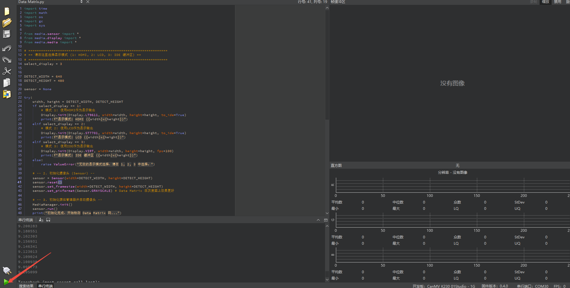

  • Module Connection
Connection Failure Causes and Solutions:
  • Cable is not a data cable: Some Type-C cables are charging-only cables without data transfer capability. Please use a Type-C cable with data transfer functionality. The factory-supplied cable is a Type-C data cable.
  • Other K230 firmware was flashed: Re-flash the factory firmware, then reconnect.
4.7.3 Program Execution and Download
Display Mode Configuration:
Online Execution:
After connection, drag the program Data Matrix.py to CanMV IDE K230 code editing area, then click the run button in the lower left corner to run the program online, as shown below:
Offline Execution:
  1. After connection, drag the program Data Matrix.py from this section’s directory to the CanMV IDE K230 code editing area. Click Tools on the toolbar, then select Save open script to CanMV Board (as main.py) as shown below:
  1. Then click Yes.
4.7.4 Program Outcome
Original image:
A red box will be used to highlight the Data Matrix code on the video feed. The decoded data within the code will be displayed, including the following details: dimensions (rows x columns), decoded content, rotation angle, and the current program’s frame rate (FPS).

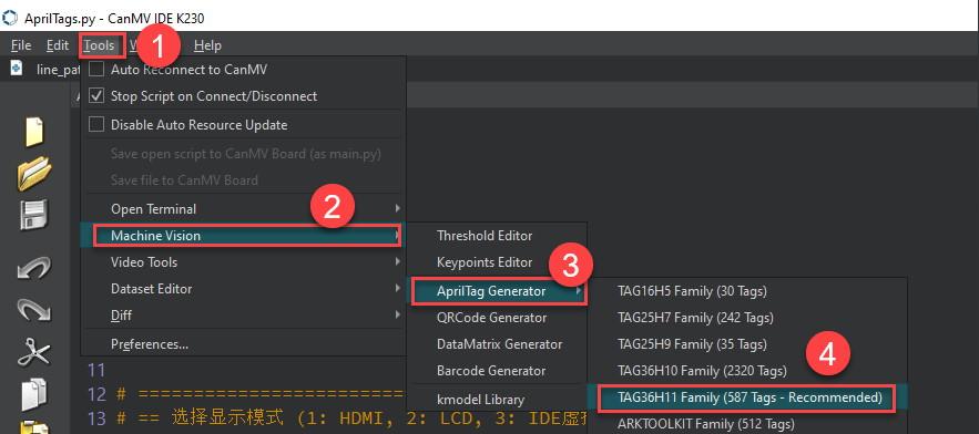

4.8.3 AprilTag Generation
In the CanMV IDE, generate an AprilTag by selecting Tools > Machine Vision > AprilTag Generator > TAG36H11 Family.
The minimum input is 0, and the maximum input is 9, creating 10 tags with IDs ranging from 0 to 9.
Click OK, then select the folder where the generated files are stored.

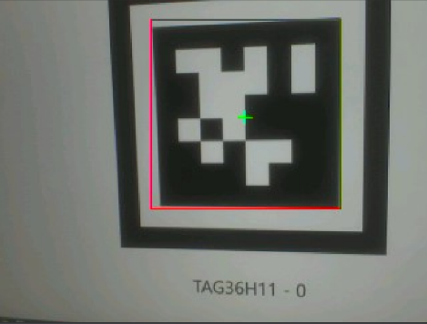

4.8.5 Program Outcome
Original image:
A red box will be used to highlight the four corners of the tag in the video feed. A green cross will be drawn at the center of the tag. The detailed information of the tag, including its tag family, ID number, and rotation angle, will be printed.
4.8.6 Program Analysis
import time
import math
import gc
import sys
import image
  • family_name Function
# Function: Get tag family name
def family_name(tag):
    family_dict = {
        image.TAG16H5: "TAG16H5",
        image.TAG25H7: "TAG25H7",
        image.TAG25H9: "TAG25H9",
        image.TAG36H10: "TAG36H10",
        image.TAG36H11: "TAG36H11",
        image.ARTOOLKIT: "ARTOOLKIT",
    return family_dict.get(tag.family(), "Unknown tag family")  # Unknown tag family
def main():
    sensor = None # Initialize sensor variable
The find_apriltags() function returns a tag object that has a family() method. This method converts the numeric constant into a human-readable string, for example, converting image.TAG36H11 to “TAG36H11”.
  • Main Loop
            fps_clock.tick()
            os.exitpoint() # Check if should exit
            for tag in img.find_apriltags(families=tag_families):
                img.draw_rectangle([v for v in tag.rect()], color=(255,0,0))
                img.draw_cross(tag.cx(), tag.cy(), color=(0,255,0))
                print_args = (family_name(tag), tag.id(), (180 * tag.rotation()) / math.pi)
                print("Tag family %s, Tag ID %d, Rotation %f (degrees)" % print_args)  # Tag family, Tag ID, Rotation, degrees
            gc.collect()
  1. img = sensor.snapshot() captures one frame from the camera.
  2. for tag in img.find_apriltags(families=tag_families) calls the image library function with the previously defined tag_families to analyze the image and find all supported AprilTags.
  3. img.draw_rectangle() draws a red box on the image to mark the tag position.
  4. img.draw_cross() draws a green cross on the image to mark the tag center.
  5. Display.show_image() displays the processed (marked) image.

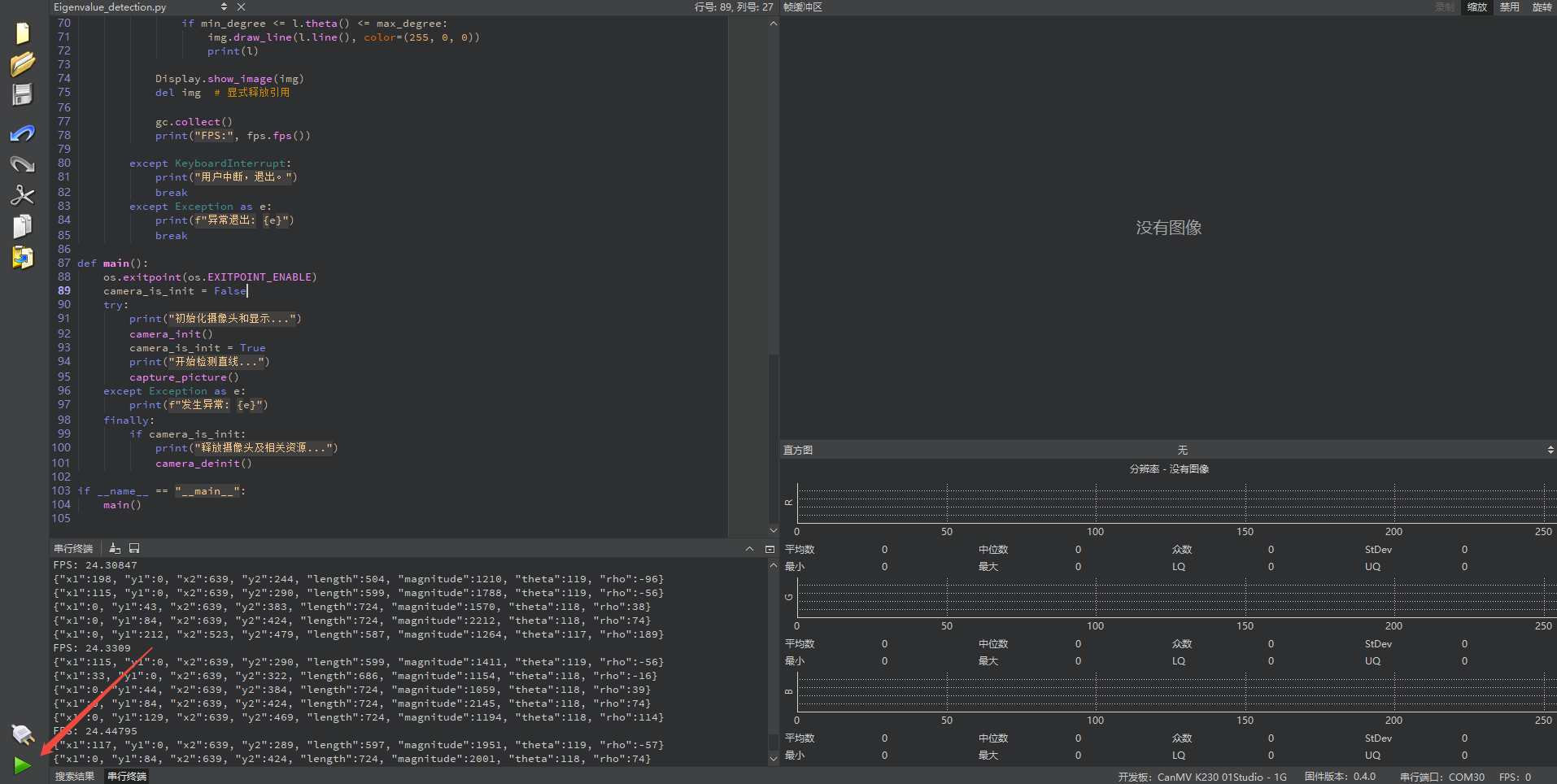

4.9.4 Program Outcome
A red line will be used to mark the outer boundaries of the detected object in the video feed. The data contained within the line segment will be printed, including the line segment’s coordinates, length, and the current program’s frame rate (FPS).
4.9.5 Program Analysis
import time
from media.sensor import *  # Import sensor module for camera-related interfaces
from media.display import *  # Import display module for display-related interfaces
from media.media import *  # Import media module for media-related interfaces
  • Main Loop
            clock.tick()
            if enable_lens_corr:
                img.lens_corr(1.8)  # for 2.8mm lens...
            for l in img.find_line_segments(merge_distance=0, max_theta_diff=5):
                img.draw_line(l.line(), color=(255, 0, 0), thickness=2)
                print(l)
            x_offset = round((width - sensor.width()) / 2)
            y_offset = round((height - sensor.height()) / 2)
            print(f"FPS: {clock.fps():.2f}")
  1. clock.tick(): Timer for calculating frame rate.
  2. img = sensor.snapshot(): Core step, captures one frame from the camera.
  3. Use for l in img.find_line_segments() and img.draw_line() to draw red line segments on the object surface.
  4. print(l) prints line information (including start point, end point, angle, etc.).
  5. x_offset = round((width - sensor.width()) / 2); y_offset = round((height - sensor.height()) / 2) calculates the offset for centered display.
  6. Display.show_image(img, x=x_offset, y=y_offset) displays the image to the center of the screen.
  7. print(f"FPS: {clock.fps():.2f}") prints the current frame rate to two decimal places.

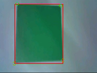

4.10.4 Program Outcome
A red rectangle will be used to highlight the outer boundaries of the detected rectangular object in the video feed, and green circles will be drawn at the four corners of the rectangle. The data contained within the rectangle will be printed, including the rectangle’s coordinates, dimensions, and the current program’s frame rate (FPS).

            # Set threshold to filter noise, only detect rectangles with strong brightness
            for r in img.find_rects(threshold=10000):
                # Draw detected rectangle border, red color, line width 2
                img.draw_rectangle(r.rect(), color=(255, 0, 0), thickness=2)

4.11.4 Program Outcome
A red circle will be used to highlight the outer boundaries of the detected circular object in the video feed, and green circles will be drawn at the four corners of the rectangle. The data contained within the circle will be printed, including the circle’s coordinates, radius, and the current program’s frame rate (FPS).
4.11.5 Program Analysis

4.12.4 Program Outcome
When a clear straight line appears in the camera’s field of view, such as the edge of a table, window frame, paper boundary, ruler, etc., the program will immediately overlay a bright red line on that straight line.
4.12.5 Program Analysis

4.13.4 Program Outcome
When a clear object appears in the camera’s field of view, the program will immediately draw a white line around the object’s edges to outline it.
