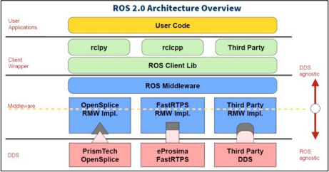

ROS2 is the second generation of Robot Operating System, an upgraded version of ROS1, which addressing some of the issues present in ROS1. The earliest version of ROS2, Arden, was introduced in 2017. With iterative updates and optimizations, it has now released the stable versions. Similar to ROS1, the choice between Linux version and ROS2 version is also correlated. The corresponding versions for both are as follows:
ROS2 version Ubuntu version
Foxy Ubuntu20.04
Galactic Ubuntu20.04
Humble Ubuntu22.04
10.1.2 ROS2 Features
  1. Distributed architecture: ROS2 adopts a distributed architecture, allowing different nodes to run on multiple computers. This enables ROS2 to operate in larger-scale robotic systems and support higher-level parallel processing and communication.
  2. Multi-language Support: ROS5 supports various programming language, encompassing C++, Python, Java, and others. This allows developers to write ROS applications in their preferred language, enhancing development efficiency and flexibility.
  3. Enhanced Communication Mechanism: ROS2 introduces a refresh communication system called Distribution Service (DDS). It is a high-performance and real-time messaging protocol that enables implement reliable data communication with ROS2.
  4. System-level Tools: ROS2 comes with a set of system-level tools for managing and monitoring ROS2. The tools include management tools (such as Colcon), logging tools (such as Rosout), diagnostic tools (such as Rqt) and others, making it easier for developers to build, test, and debug robotic systems.
  5. Real-time Performance: The design of ROS2 takes into account the real-time performance. It provides several real-time performance tools and libraries, such as Real-Time Executor(RTE), Real-Time Publisher(RTPS), and etc. This allows ROS2 to be used in application scenarios where real-time performance requirements are high.
  6. Ease of Extensibility and Integration: ROS2 supports a modular architecture, allowing developers to easily add new functions and extend ROS2. Furthermore, ROS2 integrates with other commonly uses roboti software and libraries, such as Gazebo simulator and MoveIt robot motion planning library.

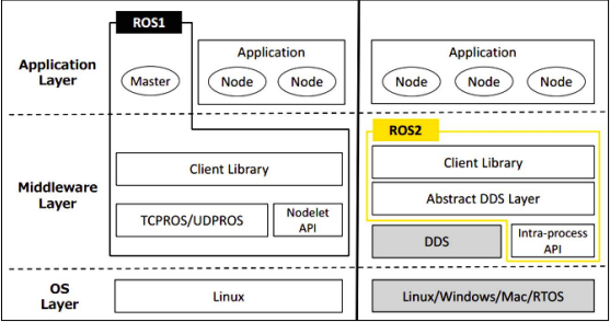

  • Middleware
In ROS1, it is necessary to start roscore before initiating, which acts as master node managing communication between all nodes. However, in ROS2, there is no equivalent to roscore; instead, there is only an abstract intermediate interface for data transmission. Currently, all implements of this interface are based on the DDS (Data Distribution Service) standard. This allows ROS2 to provide various high-quality QoS service strategies, improving communication in different network environments.

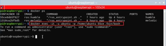

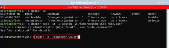

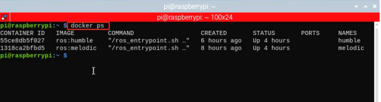

  1. Enter “docker ps” to view the ID of the newly created container.
  1. Enter the command “docker exec -it 55ce /bin/bash” to enter the container (the container’s ID can be abbreviated as long as it uniquely identifies the container).

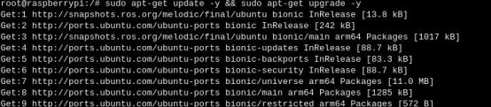

  1. Enter “sudo apt-get update -y && sudo apt-get upgrade -y” to update the list of available software packages and upgrade the installed software packages on the system.

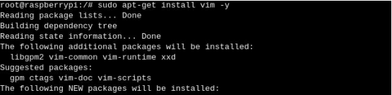

  1. Enter “sudo apt-get install vim -y” to install Vim text editor.

  1. Enter “docker exec -it -u ubuntu -w /home/ubuntu 55ce /bin/bash” to enter the container. (Note: 55ce is the container ID with the ROS2 environment installed.)

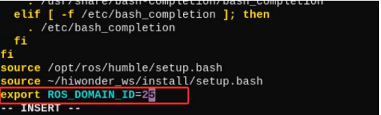

  1. The step 2 needs to be executed every time to load the workspace when you open the terminal, you can enter “echo “source /opt/ros/humble/setup.bash” >~/.bashrc” to write this command into the .bashrc file.
  1. Enter “source ~/.bashrc” to make the .bashrc file take effect. In this way, there is no need to load the workspace environment for each operation.

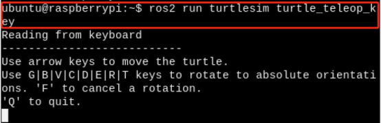

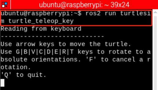

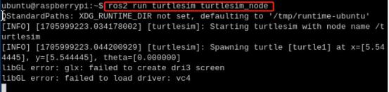

  1. Enter “ros2 run turtlesim turtlesim_node” to start the TurtleSim GUI interface. If it launches successfully, it indicates that ROS2 has been installed successfully.

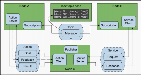

10.3.2 Get to Know ROS2 Basic Terms
The following table will introduce you some basic terms in ROS2:
Term Instruction
Underlyingcommunication layer(DDS) It provides high-performance, reliable, real-time data communication and integration capabilities, thereby establishing fundamental support formessaging and service invocation between nodes in ROS2.
Node Node is the smallest unit of processing running in ROS. It is typically an executable file. Each node can use topics or services to communicate withother nodes.
Message The variables of data types such as int, float and boolean.
Topic A one-way asynchronous communicationmechanism. By publishing messages to topics or subscribing to topics, the data transmissionbetween nodes can be realized. The topic type isdetermined by the type of corresponding message.
Publishing Send data with a message type corresponding to the topic content.
Publishers For publishing to take place,the publisher node registers various information such as its topics on the master node, and transmits messages tosubscribing nodes that wish to subscribe.
Subscribing Receive data with a message type corresponding topic content.
Subscribers For subscription to take place, the subscribing node registers various information such as itstopics on the master node. Subsequently, itreceives all messages from publisher nodes that have published topics of interest to this node, via the master node.

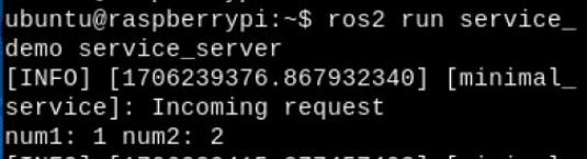

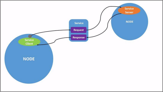

Services A bidirectional synchronous communicationmechanism where the service is provided to the client request corresponding to a specific task and service servers gives the service response.
Service Servers A node taking requests as input, and providing responses as output.
Service Clients A node taking responding as input, and providing requests as output.

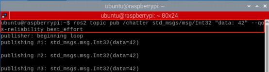

ros2 topic pub Publish a message to a specific topic through command-line.

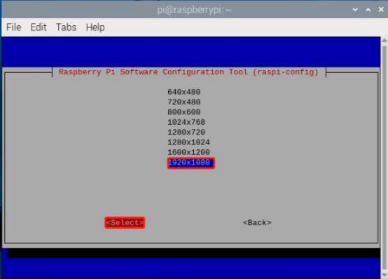

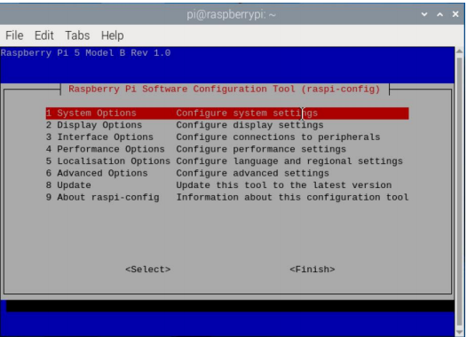

10.4.1 Adjust Resolution

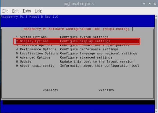

  1. Press “Ctrl+Alt+T” to open a command-line terminal and input the command “sudo raspi-config”, then press Enter.
  1. Select “2. Display Options” using “ ↑ ↓” keys and press “Enter” to confirm.
Esc” key can be used to go back to the previous level.

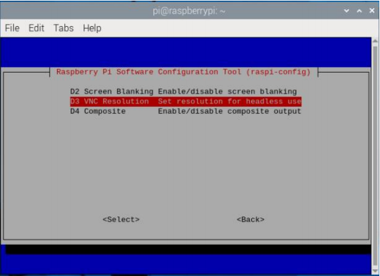

  1. Select “D3 VNC Resolution”, and then press “Enter” to confirm.
  1. Select “1920*1080” and “<Select>” in sequence, then press “Enter” to confirm.
  1. When the modification is completed, Raspberry will restart.

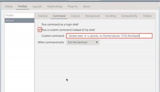

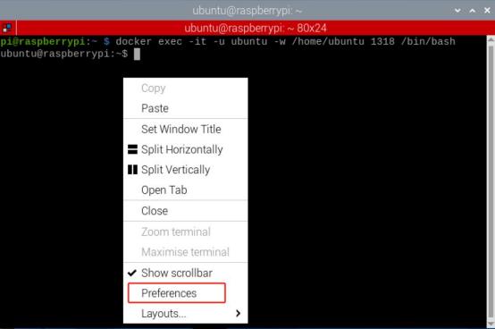

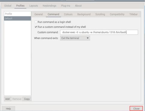

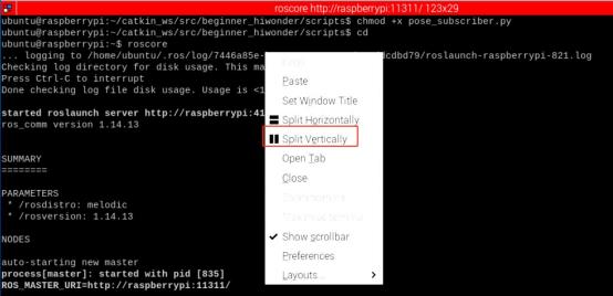

During the subsequent ROS development, it is necessary to open multiple terminals. In this point, terminator tool will be utilized.

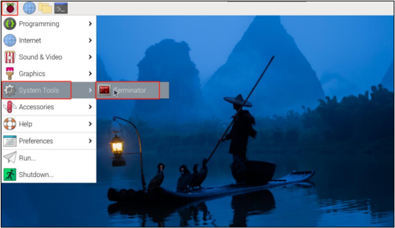

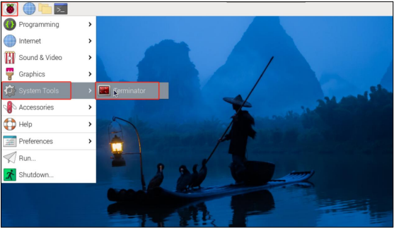

  1. Click in the upper-left corner, and select System Tools and Terminator in sequence.
  1. Enter “docker exec -it -u ubuntu -w /home/ubuntu 1318 /bin/bash” to enter the container.
Every time before entering the container, it is inconvenient to enter command in the terminator terminal. You can set the command to enter the container in the terminator tool.
  1. Right-click on the terminator window, and then select “Preference” .
  1. Select Profiles→Command in sequence.
  1. Check the “Run a custom command instead of my deal” option, and then enter the accessible command of container “docker exec -it -u ubuntu -w /home/ubuntu 1318 /bin/bash” . (Note: 1318 is the container ID containing ROS2 environment.)
  1. Click “Close” . This way, every time you open the terminal, you can directly enter the container with ROS2 environment.

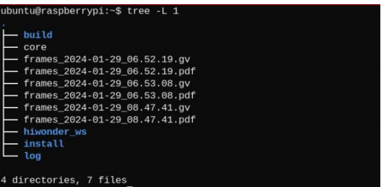

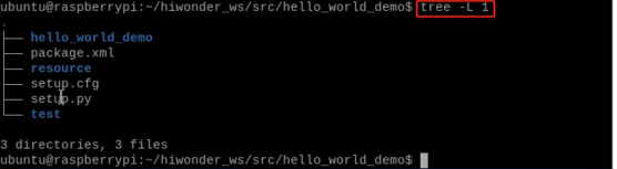

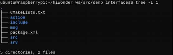

10.4.3 Tree Tool Installation
The Tree is a command-line tool, used to list the hierarchical structure of directories and files in a tree-like format. It helps users visualize the directory
structure of the file system in a clear manner, including files and sub-directories.
  1. Click in the upper-left corner, select System Tools and Terminator in sequence.
  1. Enter “sudo apt-get install tree” to install Tree tool.
  1. After installation, enter “tree -L 1” to display the first-level directories structure of the current folder.

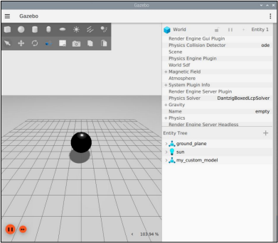

10.4.7 Gazebo Installation
Gazebo is a powerful open-source 3D robot simulation software that helps us quickly create and test various real-world scenarios on a computer. It comes with a built-in precise physics engine to simulate the interactions of dynamic objects in the scene, such as gravitational forces and friction. It also provides excellent 3D visualization effects, allowing us to clearly see the simulation process through a visual client. Most importantly, Gazebo integrates
seamlessly with ROS, allowing us to develop and test ROS nodes directly within it. This enables us to easily transfer simulation code to physical robots.
Enter “sudo apt-get install ros-humble-ros-gz” to install Gazebo (humble is a ROS number for ROS2.)

  1. Clickin the upper left corner, then select System Tools and Terminator in sequence.
  1. Enter “docker ps” to list the currently running containers
  1. Enter “docker exec -it -u ubuntu -w /home/ubuntu 55ce /bin/bash” (the container ID can be abbreviated as long as it uniquely identifies the container) to enter the contain with ROS2 installed.
  1. Enter “mkdir -p ~/hiwonder_ws/src” to create a workspace called “mkdir -p ~/hiwonder_ws/src” .
  1. Enter “cd hiwonder_ws” to switch to the workspace named “hiwonder_ws”.
  1. Enter “colcon build” to compile the workspace.
  1. Enter “source ~/hiwonder_ws/install/setup.bash” to load the workspace environment in ROS2.
  1. Every time yon open a nrew terminal, step 7) will be executed to load the workspace. However, you can enter the command “echo “source ~/hiwonder_ws/install/setup.bash” >~/.bashrc” to append the specified command to the .bashrc file.
  1. Then enter “source ~/.bashrc” to make the .bashrc file take effect, thereby there is no need to load the workspace environment for each operation.
10.5.3 Introduction to Workspace
After compilation, enter the command “tree -L 1” to view the root directory of the workspace.
A typical workspace structure in ROS system is shown as above. The “hiwonder_ws” is the root directory of the workspace, which contains four sub-directories, or sub-spaces.

  1. Clickin the upper-left corner, then select “System Tools and Terminator” in sequence.

  1. After successful compilation, enter “cd src/hello_world_demo/” to enter the directory where the package is located, and press Enter to verify whether the package is created successfully.
10.6.3 Package Instruction
In ROS system, the structure of a typical package is shown above. The “hello_world_demo” is the root directory of the package, there will be 6 files or subdirectories inside.
Name Instruction
hello_world_demo Package directory: Python source file directory
package.xml Package information, such as package name, version, author, dependencies.
resource Resource directory
setup.cfg Package basic configuration file
setup.py Similar to CMakeLists.txt file for C++ packages
test Store test-related files

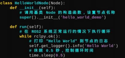

10.7.2 Create Node
  1. Clickin the upper left corner, and then select “System Tools and Terminator” in sequence.
  1. Enter the command “cd hiwonder_ws/src/hello_world_demo/hello_world_demo” and press Enter to switch to the path of the “hello_world_demo” package.

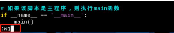

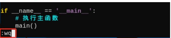

  1. Enter command “package” to edit program. Copy the below program.
You can press “i” to edit the program. After modification, press “Esc” and enter “ :wq” to save and exit the program.

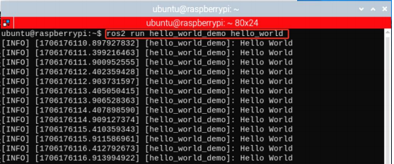

  1. After granting the executable permission, enter the command “cd ~/hiwonder_ws/” to switch to the directory of the workspace.
  1. Enter the command “colcon build” and press Enter to compile the package within the workspace.
  1. Enter the command “colcon build” and press Enter to make the environment variables take effect.
  1. Enter command “ros2 run hello_world_demo hello_world” and press Enter to start hello_world node.
10.7.4 Program Analysis

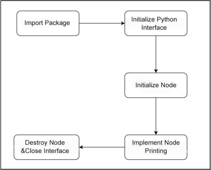

According to the realization result, the logic progress for the program is shown as pictured:
Create a node named HelloWorld Node, and print “Hello World” to the node’s log every 0.5 seconds in the main loop of the node. During program execution, the ROS2 Python interface is initialized first, then a node instance is created and its main loop is run. When the program is interrupted, the node object is destroyed, and the ROS2 Python interface is shut down.
  • Main function
First, invoke the rclpy.init() function to initialize ROS2 Python interface.
Then instantiate the HelloWorkd Node file. Finally, execute the node.run() function.
  1. HelloWorld Node Class
First, create a node named HelloWorld Node, then print “ Hello World” to the node’s log at intervals of 0.5 seconds in the node’s main loop.

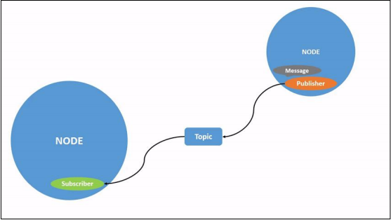

Topic communication is the most common way of communication in ROS2. Publishers publish data on specific topics, and subscribers who subscribe to those topics can receive the data.
Topic communication is based on publish and subscribe models as pictured:
The characteristic of the topic data transmission is from one node to another. The object sending data is called the publisher, while the object receiving data is called the subscriber. Each topic requires a name, and the transmitted data also requires a fixed data type.

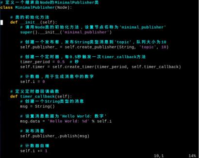

  1. Enter the command “vim topic_pub.py” to edit the program, copy the following program. If modification is required, you can press “i” to modify the program. After modification, press “ Esc” and eneter “:wq” to save and exit.
import rclpy
from rclpy.node import Node
from std_msgs.msg import String
# Define a NinimalPublisher class inhering from the Node.
class MinimalPublisher(Node):
	# The initialization method of the Class
	def __init__(self):
		# Call the initialize method of the Node class to set the node name as "minimal_publisher" .
		super().__init__('minimal_publisher')
	# Create a publisher to publish messages of String type to "topic", with a queue size of 10.
	self.publisher_ = self.create_publisher(String, 'topic', 10)
	# Create a timer to trigger the time_callback method every 0.5 seconds.
    timer_period = 0.5    # second
	self.timer = self.create_timer(timer_period, self.timer_callback)
	# Counter, used to generate numbers in the message
    self.i = 0
# Define timer callback function
def timer_callback(self):
	# Create a message of type String
    msg = String()
	# Set the message data as "Hello World: number"
    msg.data = 'Hello World: %d' % self.i
	# Publish message
	self.publisher_.publish(msg)
	# Increment the counter
	self.i += 1
# Main function

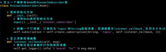

  1. Enter the command “vim topic_sub.py” to edit the program. Copy the following program. If modification is required, you can press “i” to modify the program. After modification, press “Esc” and eneter “:wq” to save and exit.
import rclpy
class MinimalSubscriber(Node):
    def __init__(self):
		# Call the initialization method of the Node class
        super().__init__('minimal_subscriber')
		# Create a subscriber to subscribe to the messages of String type on the "topic", Set the callback function to listener_callback and the queue size to 10.
		self.subscription       =       self.create_subscription(String,        'topic', self.listener_callback, 10)
# Define message callback function
	def listener_callback(self, msg):
	# Get the logger and print the received message.
    self.get_logger().info('I heard: "%s"' % msg.data)
# Main function

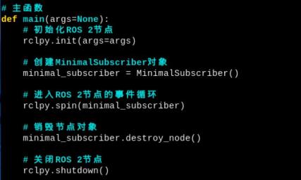

def main(args=None):
	# Initialize ROS2 node
	rclpy.init(args=args)
	# Create MinimalSubscriber object
	minimal_subscriber = MinimalSubscriber()
	# Enter the event loop of ROS2 node
    rclpy.spin(minimal_subscriber)
	# Destroy node object
	minimal_subscriber.destroy_node()
	# Shut down ROS2 node
	rclpy.shutdown()
# If this script is the main program, the main function is executed.
if __name__ == '__main__':
	main()

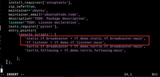

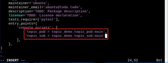

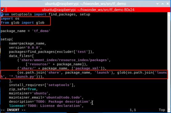

10.8.3 setup.py File Settings
The setup.py file defines the metadata and build configuration for a ROS2 package, providing information such as package metadata, dependencies, build configuration, and installation logic. It helps developers correctly build, install, and use ROS2 packages. It is necessary to write the program entry points for topic_pub.py and topic_sub.py into the setup.py file.
  1. Enter the command “cd ..” to switch to the parent directory.
  1. Enter the command “vim setup.py” and press Enter to open the setup.py file.

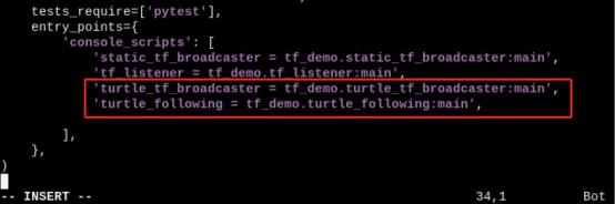

  1. Press “i” to enter the editing mode, and then enter the following code to the corresponding position.
    'topic_pub = topic_demo.topic_pub:main',
    'topic_sub = topic_demo.topic_sub:main'
4) Enter “:wq” to save and exit the file.

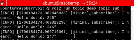

10.8.4 Compilation and Execution
  1. Enter the command “colcon build” and press Enter to compile the packages within the workspace.
  1. Enter the command “source ./install/setup.bash” and press Enter to make the environment variables take effect.
  1. Enter the command “ros2 run topic_demo topic_pub” and press Enter to start topic_pub topic publishing node.

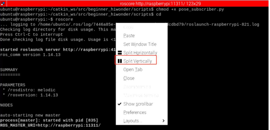

  1. Right click to select “Split Vertically” to create a new terminal window.
  1. Enter the command “ros2 run topic_demo topic_sub” and press Enter to start the topic_sub topic publishing node.

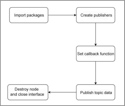

10.8.5 Program Analysis

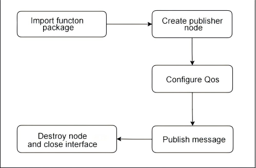

  • Publish Topic
Create a publisher named as minimal_publisher. This publisher publishes a message with an incremental number every to the “topic” topic every 0.5 seconds. During program execution, ROS 2 node is initialized first. Then, a MinimalPublisher object is created, and the program enters the ROS 2 node’s event loop. When the program is interrupted, the node object is destroyed, and the ROS 2 node is shut down.

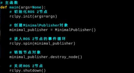

1. Main Function
First, invoke the rclpy.init() function to initialize ROS2 Python interface. Then instantiate the MinimalPublisher() file. Finally, execute the minimal_publisher within the event loop of the ROS2 node.
2. MinimalPublisher Class
First, create a node named minimal_publisher, then create a publisher named “publisher_” . The timier_callback() callback function prints a message with an incremental number to the node’s log at intervals of 0.5 second.

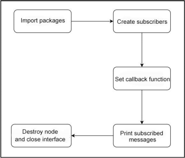

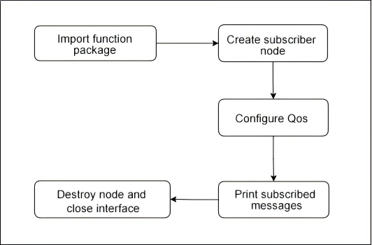

  • Subscribe to Topic
Create a subscriber named as minimal_sub lisher. This subscriber prints the subscribed messages to logger. During program execution, ROS 2 node is initialized first. Then, a MinimalPublisher object is created, and the program enters the ROS 2 node’s event loop. When the program is interrupted, the node object is destroyed, and the ROS 2 node is shut down.
1. Main Function
2. MinimalSub lisher Class
First create a node named minimal_sub lisher. Then create a subscriber named subscription. In the listener_callback() callback function, the received message content is printed to the logger.

  1. Enter the command “cd ~/hiwonder_ws/src/” to switch to the src folder wthin the hiwonder_ws workspace.
  1. Enter the command “ros2 pkg create demo_interfaces –build-type ament_cmake –dependencies rclcpp” and press Enter to create a
package named “demo_interfaces”.
  1. Enter the command “demo_interfaces” to enter the custom interface package.
  1. Enter the command “mkdir msg” to create a folder.
  1. Enter the command “cd msg” to enter the msg folder.
  1. Enter the command “vim String.msg” to edit the program. Enter “string data”. If you need to make modifications, you can press “i” . After modification, enter “ :wq” to save and exit.

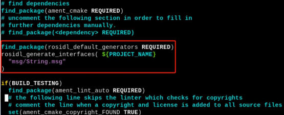

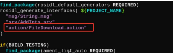

  1. Enter “cd ..” to navigate back to the parent directory, then enter “vim CMakeLists.txt” to open the file using the Vim text editor. Copy the following program and paste it into the specific location as pictured.If you need to make modifications, press “i” to enter insert mode. Once you’ve finished editing, press “Esc”, then type “:wq” to save and exit.
find_package(rosid l_default_generators REQUIRED)
rosid l_generate_interfaces( ${PROJECT_NAME} "msg/String.msg"

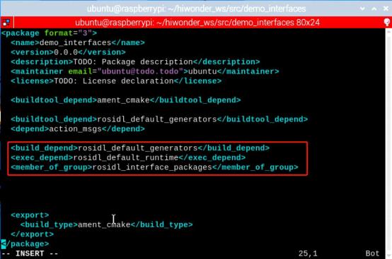

  1. Enter the command “vim package.xml” again to open the file using the Vim text editor. If you need to make modifications, press “i” to enter insert mode. Once you’ve finished editing, press “Esc”, then type “:wq” to save and exit.
<build_depend>rosid l_default_generators</build_depend>
<exec_depend>rosid l_default_runtime</exec_depend>
<member_of_group>rosid l_interface_packages</member_of_group>

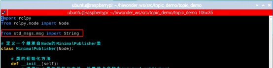

  1. Reference the step (1), (2) and (3) in “10.8.4 Compilation and Execution” to compile the workspace.

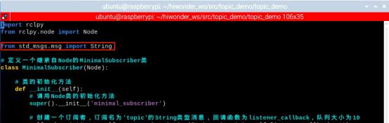

  2. Modify the code inside the red box below, replace it with the statement “from demo_interfaces.msg import String” . This change enables the use of custom messages and maintains the same functionality as before.

Service communication is a communication model based on request and respond. During the mutual communication, the client sends request data to the server, and the server responds with results to the client.
From the perspective of service implementation, the request- respond form is called the client/server model, abbreviated as CS mode. In this model, when the client requires certain data, aiming at a specified service, a request message targeting a specific service will be sent. Upon receiving the request, the server processes it and provides a respond.
This communication mechanism is common in our daily life. For example, when we browse various web pages, your computer browser acts as the client, it sends requests to the website using domain names or other operations. The server returns the necessary page data to be displayed upon receiving these requests.

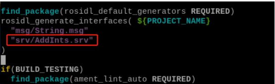

"srv/AddInts.srv" )

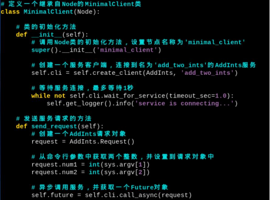

10.9.3 Create Service
  • Create Server
  1. Clickand select “System Tools ->Terminator” in sequence.
  1. Enter the command “cd hiwonder_ws/src/” to switch to the src folder within hiwonder_ws workspace.

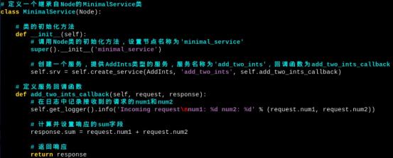

import rclpy
from demo_interfaces.srv import AddInts
# Define a MinimalService class inhering from the Node.
class MinimalService(Node):
	def __init__(self):
	# Call the initialize method of the Node class to set the node name as "minimal_service"
	super().__init__('minimal_service')
	# Create a service that provides a service of type AddInts. Set theservice name as ‘add_two_ints' , and the callback function as ‘add_two_ints_callback' .
self.srv         =          self.create_service(AddInts,          'add_two_ints', self.add_two_ints_callback)
	# Define service callback function
	def add_two_ints_callback(self, request, response):
		# Log the received requests num1 and num2 in the logs.
		self.get_logger().info('Incoming  request\nnum1:  %d  num2:  %d'  % (request.num1, request.num2))
		# Calculate and set the respond field ‘sum' .
		response.sum = request.num1 + request.num2
		# Return respond
        return response

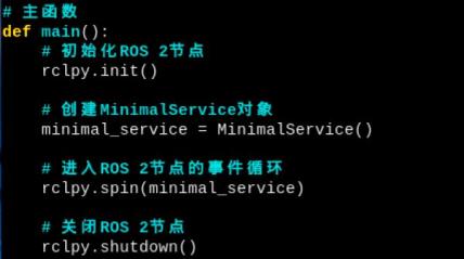

def main():
	rclpy.init()
	# Create MinimalService object
	minimal_service = MinimalService()
	rclpy.spin(minimal_service)
	rclpy.shutdown()
# If this script is the main program, main function is executed.
	main()

  1. Enter the command “vim service_client.py” to edit the program. Copy the following program. If you need to make modifications, you can press “i” to modify the program. After modification, press “Esc” and eneter “:wq” to save and exit.
import sys
import rclpy
from rclpy.logging import get_logger
# Define a MinimalClient class inhering from the Node.
class MinimalClient(Node):
	def __init__(self):
		# Call the initialization method of the Node class. Set the node name as "minimal_client"
		super().__init__('minimal_client')
		# Create a server and connect to the AddInts service named as "add_two_ints" .
		self.cli = self.create_client(AddInts, 'add_two_ints')
		# Wait for the service connection, with a maximum wait time of 1 second.
        while not self.cli.wait_for_service(timeout_sec=1.0):
			self.get_logger().info('service is connecting...')
	# Send service request method
	def send_request(self):
		# Create an Addlnts request object.
		request = AddInts.Request()
		# Get two integers from the command-line arguments and set them into the request object.
		request.num1 = int(sys.argv[ 1])
		request.num2 = int(sys.argv[2])
		# Asynchronously call the service and retrieve a Future object.
		self.future = self.cli.call_async(request)

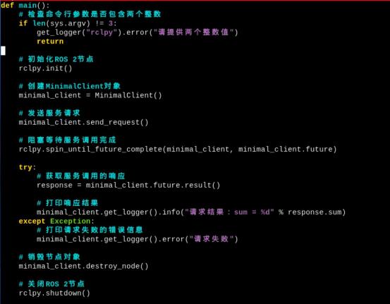

# Main function
def main():
	# Check if the command-line augments contain two integers.
	if len(sys.argv) != 3:
		get_logger("rclpy").error("Please provide two integers")
		return
2) Enter the command “chmod +x service_client.py” and press Enter to grant the executable permission to the saved service_client.py file.
10.9.4 setup.py File Settings
The setup.py file defines the metadata and build configuration for a ROS2 package, providing information such as package metadata, dependencies, build configuration, and installation logic. It helps developers correctly build, install, and use ROS2 packages. It is necessary to write the program entry points for service_client.py and service_server.py into the setup.py file.
'service_server = service_demo.service_server:main', 'service_client = service_demo.service_client:main'
  1. Enter “:wq” to save and exit the file.

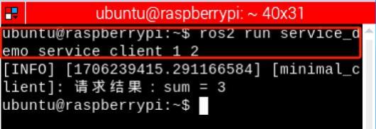

  1. Enter the command “ros2 run service_demo service_server” and press Enter to start service_server server.
  1. Enter the command “ros2 run service_demo service_client 1 2” and press Enter to start the service_client client to send the calculation request for numbers 1 and 2. Once the server receives the calculation request for numbers 1 and 2, it will send back the result to the client.

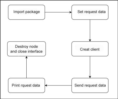

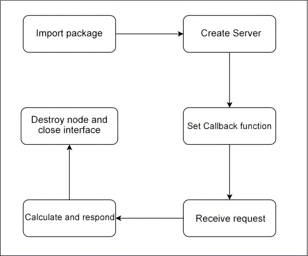

10.9.6 Program Analysis
  • Server
Create a server named “minimal_service” which will receive requests, perform calculations on them, and respond with the result. During program execution, ROS 2 node is initialized first. Then, a MinimalPublisher object is created, and the program enters the ROS 2 node’s event loop. When the program is interrupted, the node object is destroyed, and the ROS 2 node is shut down.
1. Main Function
First, invoke the rclpy.init() function to initialize ROS2 Python interface. Then instantiate the MinimalService(). Finally, execute the minimal_service within the event loop of the ROS2 node.
2. MinimalService Class
First, a node named minimal_service is created. Then, a service is created to provide a service of type AddInts, with the service name ‘add_two_ints’.
Inside the add_two_ints_callback() callback function, the two data from the request are received, processed for calculation, and the result of the calculation is responded back.
  • Client
A client named minimal_client is created, which connects to the AddInts service named add_two_ints. It sends the two requested data. During program execution, it initializes the ROS2 node, creates a MinimalClient object, sends the service request, prints the response result, and upon interruption, it destroys the node object and closes the ROS 2 node.
1. Main Function
First, invoke the rclpy.init() function to initialize ROS2 Python interface. Then instantiate the MinimalClient() file and send the service request. Finally, process the respond data.
2. MinimalClient Class
First, a node named minimal_client is created. Then, a service client is created to connect to the AddInts service named add_two_ints . In the send_request() function, the two command-line augments are used as the data for the request object, and the request is sent.
10.10 ROS2 Action

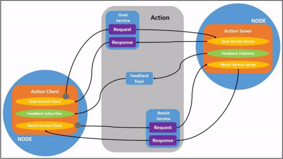

10.10.1 Introduction to Action Communication
The action communication is a communication with continuous feedback.
In this model, the client sends request data to the server, and the server responds with results to the client. However, during the process from receiving the request on the server to generating the final response, continuous feedback messages are sent to the client.
The action communication client/server model is as follow:

  1. Click and select “System Tools ->Terminator” in sequence.
rosid l_generate_interfaces( ${PROJECT_NAME} "msg/Student.msg"
"srv/AddInts.srv"
"action/FileDownload.action" )

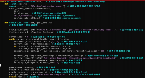

  1. Enter the command “vim action_server.py” to edit the program, copy the program below. If you need to make modifications, press “i” to enter insert mode. Once you’ve finished editing, press “Esc”, then type “:wq” to save and exit.
import rclpy    # Import rclpy module
from rclpy.node import Node    # Import Node class
from rclpy.action import ActionServer   # Import ActionServer class
from demo_interfaces.action import FileDownload   # Import FileDownload action interface
import random   # Import random module
class FileDownloadActionServer(Node):   # Define a FileDownloadActionServer class inhering from the Node.
	def __init__(self):
		super().__init__('file_download_action_server')   # Invoke the constructor of the parent function to initialize node
		self._action_server = ActionServer(
            self,
			FileDownload,   # Use FileDownload action interface
			'file_download',   # Define the action name as file_download
			self.execute_callback)   # Set the callback function to execute_callback
	def execute_callback(self, goal_handle):
		# The callback function executed by the server
		self.get_logger().info(f'Start file download for{goal_handle.request.file_size} bytes...')   # Print the log for the start of the download file
		feedback_msg = FileDownload.Feedback()    #  Create  an  object of type Feedback message
		current_size = 0    # Initialize the current file size of the download to 0
        while current_size < goal_handle.request.file_size:
			increment_size = random.randint(1, 10)    # Simulate randomly increasing the download size.
			current_size += increment_size   # Update the current download file size
			if current_size > goal_handle.request.file_size:
				current_size = goal_handle.request.file_size
			completion_percentage              =              (current_size              /goal_handle.request.file_size)  *  100      #  Calculate  the  download  progress percentage
				feedback_msg.completion_percentage =
completion_percentage   #    Update the download progress within Feedback message
				self.get_logger().info(f'Publishing feedback:{completion_percentage:.2f}% downloaded')   # Print the feedback message
				goal_handle.publish_feedback(feedback_msg)   # Publish a feedback message
				rclpy.spin_once(self, timeout_sec=1.0)   # Simulate the passage of the time.
			goal_handle.succeed()   # Indicates the goal is completed
			result = FileDownload.Result()   # Create an object of type Result message.
			result.current_size = current_size    # Set current file size of Result message
			self.get_logger().info('File download completed!')   # Print a log for the completed file download
			return result   # Return results
	rclpy.init(args=args)   # Initialize ROS node
	server = FileDownloadActionServer()   # Create FileDownloadActionServer object
	rclpy.spin(server)   # Enter a main loop
	server.destroy_node()   # Destroy the node
    rclpy.shutdown()   # ROS Shut down ROS
	main()

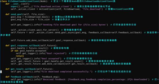

  • Create Client
  1. Enter the command “vim action_client.py” to edit the program. Copy the following program. If you need to make modifications, press “i” to enter insert mode. After modification, press “Esc” and eneter “:wq” to save and exit.
from rclpy.action import ActionClient   # Import ActionClient class
class FileDownloadActionClient(Node):   # Define a FileDownloadActionClien
class inhering for the Node class
	def __init__(self):
		super().__init__('file_download_action_client')   #    Invoke the constructor of the parent function to initialize node
		self._action_client = ActionClient(self, FileDownload, 'file_download')# Create ActionClient object
	def send_goal(self, file_size):
		goal_msg = FileDownload.Goal()   # Create an object of Type Goal message
		goal_msg.file_size = file_size   # Set file size
		self.get_logger().info(f'Sending file download goal for {file_size} bytes')
# Print a log indicating the target is sent
		self._action_client.wait_for_server()   # Wait for the server to be available.
		self.future = self._action_client.send_goal_async(goal_msg,    feedback_callback=self.feedback_callback)   # Send an asynchronous request for a goal,
        self.future.add_done_callback(self.goal_response_callback)      #Add a callback function to handle the response after sending a goal request
        def goal_response_callback(self,future):
			goal_handle = future.result()   # Get goal handle
			if not goal_handle.accepted:
			self.get_logger().info("Goal rejected")   # Print a log indicating the goal is rejected
			return
		self.get_logger().info("Goal accepted")   # Print a log indicating the goal is accept
		self._get_result_future = goal_handle.get_result_async()   # Retrieve an asynchronous request for a goal,
		self._get_result_future.add_done_callback(self.get_result_callback)# Add the callback function to retrieve the results
	def get_result_callback(self,future):
		self.get_logger().info("File  download  completed  successfully.")      # Print a log indicating the file download is successful.
	def feedback_callback(self, feedback_msg):
		self.get_logger().info(f'Received                                           feedback:{feedback_msg.feedback.completion_percentage:.2f}% downloaded')   # Print the retrieved feedback information.
	rclpy.init(args=args)   # Initialize ROS2 node
	client = FileDownloadActionClient()   # Create FileDownloadActionClient object
	result = client.send_goal(100)    # Send goal
	rclpy.spin(client)   # Enter main loop
	client.destroy_node()   # Destroy node
	rclpy.shutdown()   # Shut down ROS
	main()
  1. Enter the command “chmod +x service_client.py” and press Enter to grant the executable permission to the saved action_client.py file.

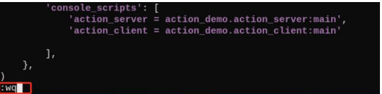

10.10.4 setup.py File Settings
  1. Press “i” to enter insert mode, and then enter the code below to the corresponding location.
'action_server = action_demo.action_server:main', 'action_client = action_demo.action_client:main'

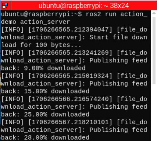

10.10.5 Compilation and Execution
  1. After granting the executing permission, enter the command “cd ~/hiwonder_ws/” to switch to the directory of the workspace.

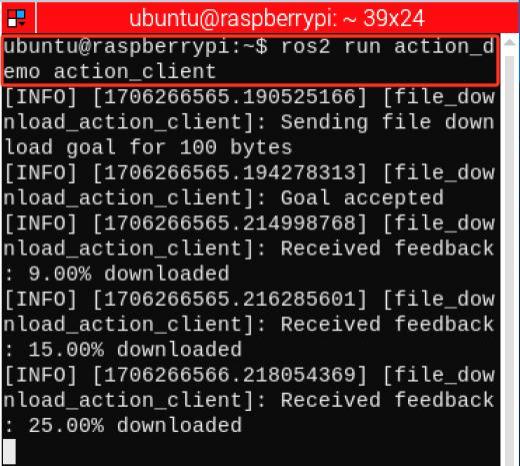

  1. Enter the command “ros2 run action_demo action_server” and press Enter to start the action server “action_server” .
  1. Enter the command “ros2 run action_demo action_client” and press Enter to tart “action_client” action client. At this point, the server also receive the requests.
10.10.6 Program Analysis
  • Server

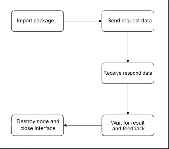

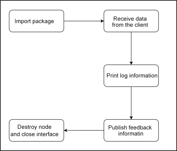

First, define a node named FileDownloadActionServer to construct an ActionServer of the FileDownload action type to provide task services. This execution callback function within ActionSeriver is responsible for simulating the process of executing real download tasks. It randomly increases the download progress to simulate file download while continuously publishing download feedback to the client through the goak_handle object. After the task is completed, the task status is set to success, and the download result is returned.
1. Main Function
First, invoke the rclpy.init() function to initialize ROS2 Python interface. Then instantiate the FileDownloadActionServer(). Finally, execute the server within the event loop of the ROS2 node.
2. FileDownloadActionServer Class
This callback function is invoked to execute the file download task. Within this function, a while loop is used to simulate the real-time file download process by randomly increasing the current download amount. During the download process, it continuously publishes the current download progress as feedback information through the goal_handle object. Once the task download is completed, it uses the goal_handle to set the task status to success and returns the final download result.
A FileDownloadActionClien class is defined, which creates an ActionClient object in the constructor and configures it for file download task type. The client provides a send_goal method to send the target file size as the action Goal. Additionally, it registers three callback functions to handle Goal status responses, task process feedback, and the final task. In the main function, an instance of the client is created, send_goal is called to send the download task, and rclpy.spin() to obtain the full process of task execution status changes.
Main Function
First, invoke the rclpy.init() function to initialize ROS2 Python interface. Then instantiate the FileDownloadActionClient(). Finally, execute the client within the event loop of the ROS2 node.
◆ FileDownloadActionClient Class
A ActionClient object is created to communicate with the task service. The client provides a send_goal method to send the download target, and registers three callback functions to handle the status changes “feedback” at the different stages of the task. After sending the Goal, the send_goal method adds callback functions through the future object to wait for the ActionServer’s response. These three callback functions are used to obtain the Goal reception result, update the task progress, and obtain the completion result, covering the entire lifecycle of the task.

In the ROS system, regardless of topics, services or actions, they all rely on an significant concept –communication interface.
Communication isn’t a monologue but rather an exchange between two or more parties. What is being exchanged? To ensure mutual understanding, we can define a standardized structure for the data being transmitted, and this is what we call a communication interface.
Interfaces help reduce dependencies between programs, making it easier for us to use others’ code and for others to use our code. This is the core goal of ROS, which is to reduce redundant efforts.
ROS has three commonly used communication mechanisms, namely topics, services, and actions. Through the interfaces defined by each communication mechanism, various nodes can be interconnected.
  1. Enter the command “cd hiwonder_ws/src/demo_interfaces” to switch to the “”demo_interfaces” custom interface package.
  1. Enter “tree -L 1” and press Enter to view the root directory of the package.
The demo_interfaces package has action, msg and srv folders for storing custom interface files. Following provides an explanation for each folder:

  1. Clickand select “System Tools Terminator” in sequence.

		main()
  1. Enter the command “chmod +x param_demo.py” and press Enter to grant the executable permission to the saved param_demo.py file.

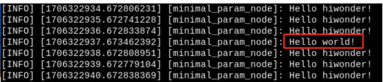

  1. Enter the command “ros2 run param_demo param_demo” and press Enter to start the param_demo node.
  1. Enter the command “ros2 param set minimal_param_node my_parameter world” and press Enter to modify the parameter my_parameter of the node minimal_param_node to “world” .
At this point, you can notice that the output from the param_demo node is “Hello world!” , indicating the parameter are modified successfully.

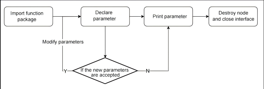

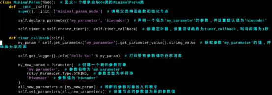

10.12.5 Program Analysis
Create a MinimalParam class, declare a string parameter “my_parameter” in the constructor, and create a timer with a 1-second interval. The timer callback function is called every 1 second. Inside the callback, it first retrieves the current value of the parameter, then prints a log, creates a new parameter object, sets a new value, and finally calls the set_parameters function to modify the parameter value in the parameter server.
  • Main Function
First, invoke the rclpy.init() function to initialize ROS2 Python interface. Then instantiate the MinimalParam. Finally, execute the node.run() function**.**
  • MinimalParam Class
First, a string parameter named my_parameter is declared, and a timer with a 1-second period is created. The timer callback function, timer_callback, is called every second. It first retrieves the current value of the my_parameter parameter and then prints a log output. Next, the callback function creates a new parameter object with the same name but with a value of “hiwonder”.
Afterward, it calls the set_parameters function to modify the parameter value.

  1. Click and select “System Tools Terminator” in sequence.
  1. Enter the command “vim ~/.bashrc” to open the bashrc file suing VIM text editor.
  1. Press “i” to enter the insert mode, and enter “export ROS_DOMAIN_ID=25” in corresponding location. After you’ve finishing modifications, press “ Esc” and enter “ :wq” to save and exit.
  1. Enter the command “source ~/.bashrc” to make the environment variables make effect.
Add the statement “export ROS_DOMAIN_ID=25” to the barshrc files of other terminals to assign them to the same group (i.e., domain ID 25), enabling distributed communication. If different domain IDs are assigned, communication between them will not be possible.

10.14.2 The Application of DDS in ROS
The position of DDS within the ROS 2 system is crucial, as all upper-level constructs are built upon it. In the architectural diagram of ROS 2, the blue and red sections represent DDS.
In the four major components of ROS, the addition of DDS significantly improves the comprehensive capability of the distributed communication system. Consequently, in the process of developing robots, we are relieved from the burden of grappling with communication intricacies, enabling us to allocate more time to application development in other domains.

10.14.4 DDS Configuration in Command-line
  1. Click in sequence. in the upper-left corner to select “System Tools →Terminator

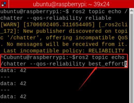

  1. Enter the command “ros2 topic pub /chatter std_msgs/msg/Int32 “data: 42” –qos-reliability best_effort” to publish a topic named “/chatter” using the message type “std_msgs/msg/Int32” , sending an integer message with the data 42. Through adding the option of “–qos-reliability best_effort”, the publisher specifies the use of best effort reliability.
  1. Right click on a blank area to select “Split Vertically” to create a new terminal window.
  1. Enter the command “ros2 topic echo /chatter –qos-reliability reliable” to subscribe to a topic named “/chatter” and print the received messages. If the publisher uses the reliable QoS policy for publishing while the subscriber uses the best effort policy for subscribing, data communication cannot be achieve. Only when the publisher and receiver use the same QoS policy can the correct correct transmission of data be ensured.
  1. Enter the command “ros2 topic echo /chatter –qos-reliability best_effort” and subscribe to a topic named “/chatter” and print the received messages. By adding the “–qos-reliability reliable” option, modify it to the same “best_effort” in order to achieve data transmission

  1. Click in the upper-left corner to select “System Tools→Terminator” in sequence.

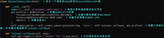

  • Create Subscriber
  1. Enter the command “vim DDS_qos_sub.py” to edit the program using VIM editor, copy and paste the program below. If you need to make modifications, you can press “i” to enter the insert mode. Once you’ve finished the modifications, you can press “Esc” and enter “:wq” to save and exit.
from std_msgs.msg import String    # Import String message type
from rclpy.qos import QoSProfile, QoSReliabilityPolicy, QoSHistoryPolicy    # Import the QoSProfile, QoSReliabilityPolicy and QoSHistoryPolicy classes
class MinimalSubscriber(Node):   # Define the MinimalSubscriber class inhering from the Node class
	def __init__(self):
		super().__init__('minimal_subscriber')    # Call the parent constructor to initialize the node.
		qos_profile = QoSProfile(    # Create QoSProfile object
			reliability=QoSReliabilityPolicy.RELIABLE,   #Set the reliability policy as RELIABLE
			history=QoSHistoryPolicy.KEEP_LAST,   # Set the history policy as KEEP_LAST
			depth=1   # Set the depth to 1
self.listener_callback, qos_profile)   # Set the subscriber object and set the callback function as listener_callback
		self.get_logger().info('I heard: "%s"' % msg.data)    # Print thereceived message
	minimal_subscriber = MinimalSubscriber()   # Create MinimalSubscriber object
	rclpy.spin(minimal_subscriber)   # Enter the main loop
	minimal_subscriber.destroy_node()   # Destroy node
	main()
  1. Enter the command “chmod +x DDS_qos_sub.py” and press Enter to grant the executable permission to the saved file topic_sub.py.

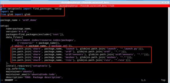

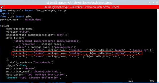

10.14.6 setup.py File Settings
  1. Enter the command “cd ..” to navigate to the parent directory.
