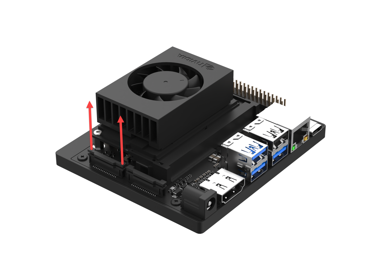

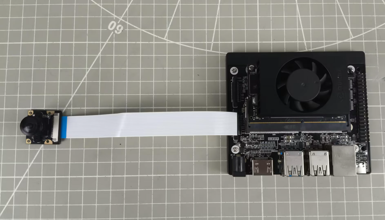

  • Assembly

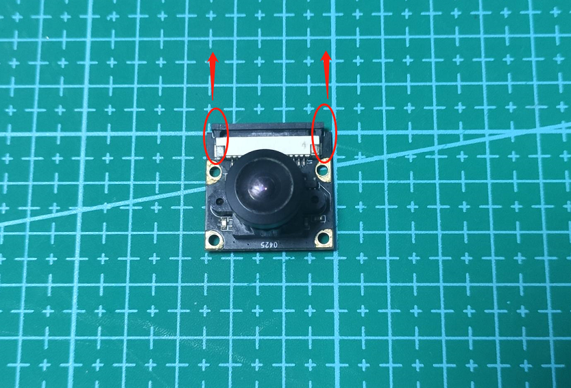

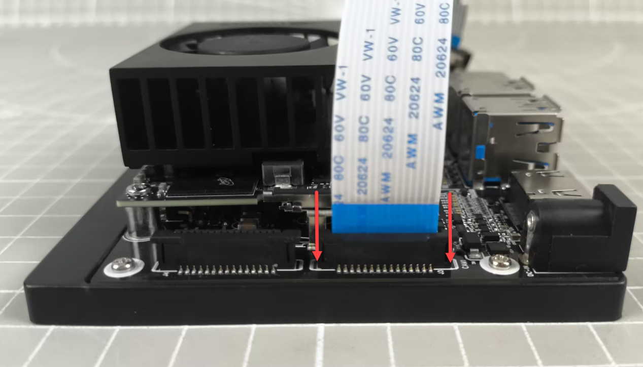

  1. Gently pull up on the edges of the CSI port’s plastic clip.
  1. Insert the ribbon cable into the interface; make sure the connectors at the ribbon cable are facing the contacts in the port. Then push the collar back into place.

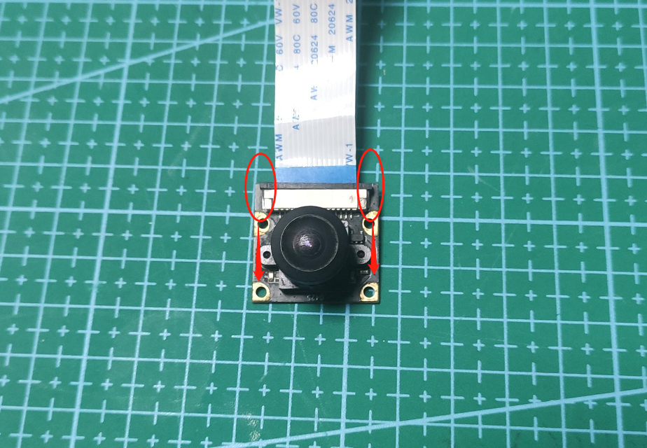

  1. Lift the collar on the camera module.
  1. Connect the other end of the ribbon cable into the interface of the CSI camera module with the conductors facing in the same direction as the camera’s lens. Then, press the collar down again.
  1. The installation effect is shown in the figure below:

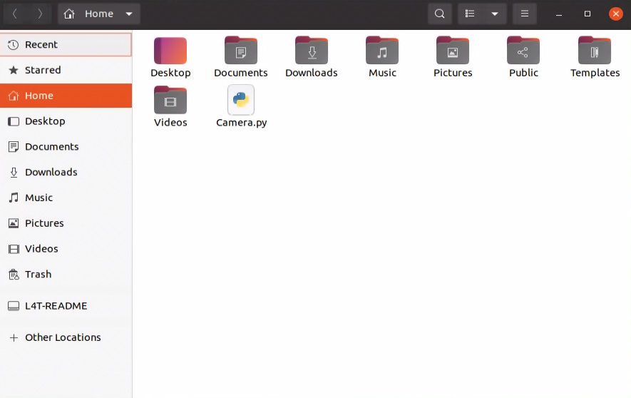

  2. Import the program file “Camera.py” under the same folder with this document to the home directory of the board system.
  1. Double click or use the shortcut key “Ctrl+Alt+T” to open the terminal.
  2. Enter the command and press Enter to start the game.
python3 Camera.py

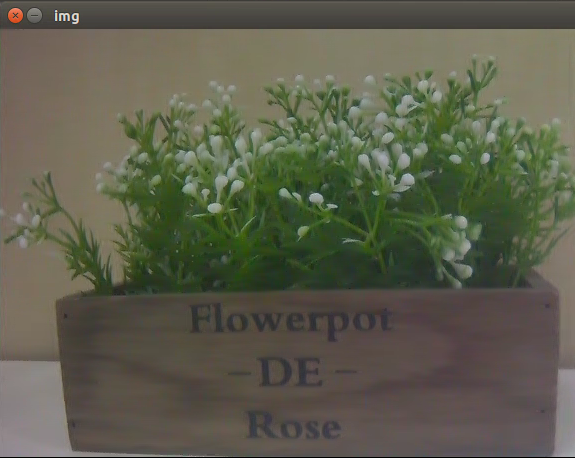

7.2.2 Program Outcome
After the game starts, the screen will display the transmitted image.

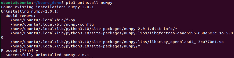

  1. Enter the command to uninstall Numpy.
pip3 uninstall numpy
If Numpy is higher than 2.0 version, it can not be used with Mediapipe, and the version needs to be downgraded. After entering this command, if it shows that NumPy version is 1.x, you can type “n” in the subsequent prompt to cancel uninstallation.
  1. Run the command to install NumPy.
pip3 install numpy==1.21.5

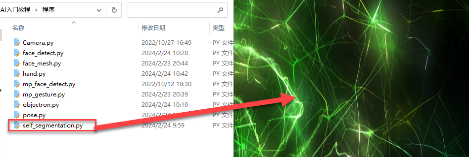

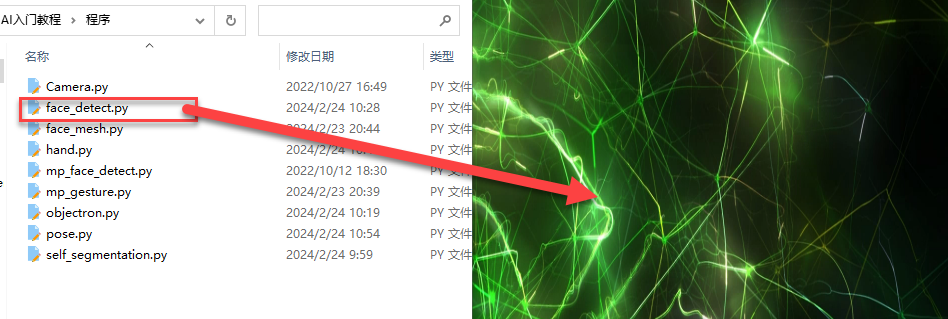

  3. When entering the system desktop, drag the program file “self_segmentation.py” under the same directory to the remote desktop.

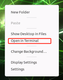

  1. Then right click on the blank area of the system desktop, and select “Open in Terminal” to open the command-line terminal:
  1. Enter the following command and press Enter to run the background segmentation detection program.

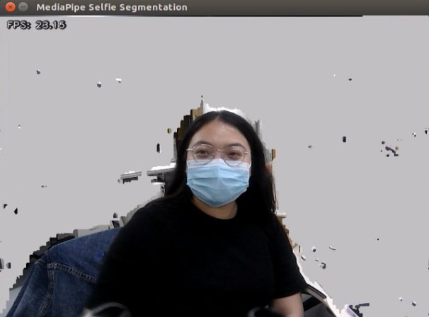

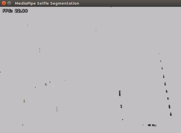

7.4.3 Program Outcome
After the program starts, the frame turns into a completely gray virtual background. When a person enters the frame, they will segmented from the background.

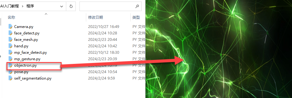

  3. When entering the system desktop, drag the program file “objectron.py” under the same directory to the remote desktop.

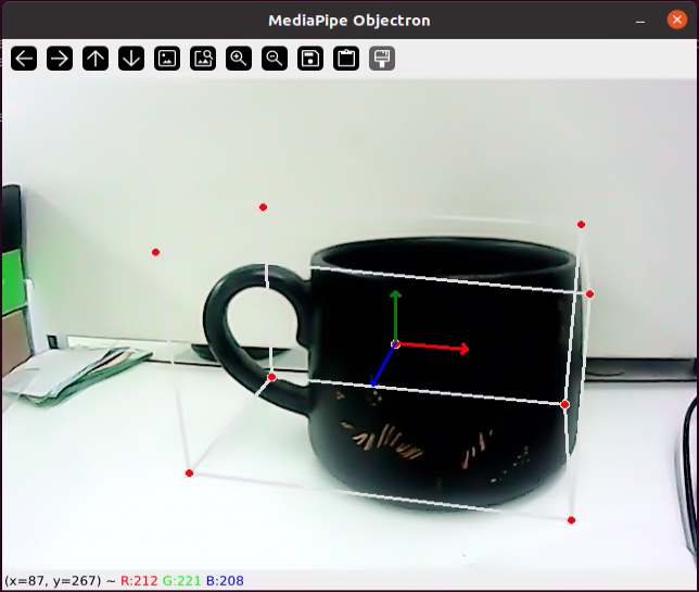

  1. After starting the program, 3D bounding boxes will appear around objects in the image. Currently, we support the detection of four types of objects: cups (with handles), shoes, chairs, and cameras. The example here uses a cup, as shown in the image below:

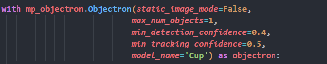

with mp_objectron.Objectron(static_image_mode=False,
                                max_num_objects=1,
                                min_detection_confidence=0.4,
                                min_tracking_confidence=0.5,
                                model_name='Cup') as objectron:
The first parameter, static_image_mode=False, specifies whether the image is in static mode. If set to false, the input image is treated as a video stream. If set to true, object detection runs on each input image, which is suitable for processing a batch of static, potentially unrelated images. The default is false.
The second parameter, max_num_objects=1, specifies the maximum number of objects to detect, with the default value being 5.
The third parameter, min_detection_confidence=0.4, is the minimum detection confidence. This value ([0.0, 1.0]) determines the confidence threshold for successful detections from the object detection model. The default is 0.5.
The fourth parameter, min_tracking_confidence=0.4, is the minimum confidence for object tracking. Setting this to a higher value can improve the robustness of the solution but may increase latency.
The fifth parameter, model_name='Cup', specifies the name of the 3D bounding box model. This name determines which 3D bounding box marker model to display. Currently supported models are {‘Shoe’, ‘Chair’, ‘Cup’, ‘Camera’}, with the default being ‘Shoe’.

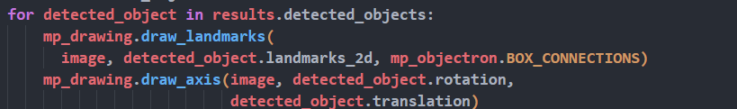

  • Draw 3D Bounding Boxes
After detecting the 3D shape of objects, iterate through the identified objects and use mp_drawing.draw_landmarks() and mp_drawing.draw_axis() to draw 3D bounding boxes around them.

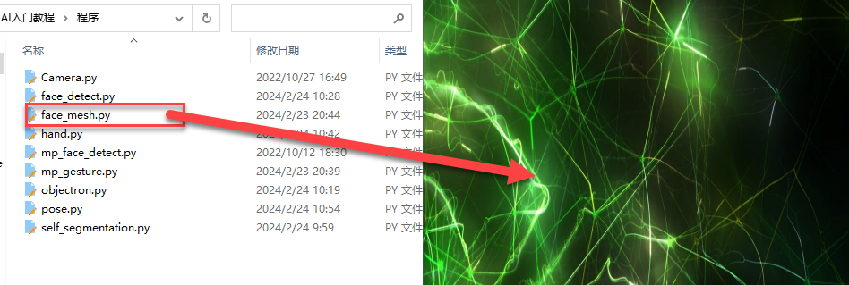

  3. When entering the system desktop, drag the program file “face_detect.py” under the same directory to the remote desktop.

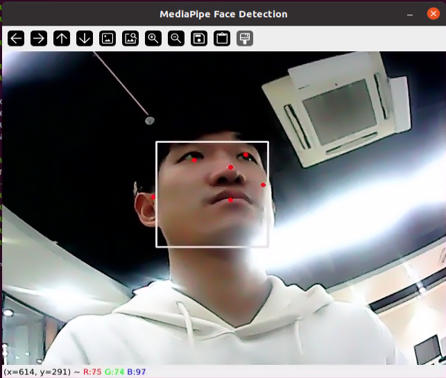

7.6.3 Program Outcome
After starting the program, if the face is detected, it will draw a bounding box around the face in the returned feed.

  • Face Detection
Based on the previously built face detection model, detect faces in the image.
  • Draw the Face
Use the mp_drawing.draw_detection() function to draw a bounding box around the detected face in the image.
  • Display the Transmitted Image
Use the imshow() function from the cv2 library to display the camera feed in a specified window.
The first parameter inside the function’s parentheses, 'MediaPipe Face Detection', is the window name, and the second parameter, image, is the image to be displayed.

7.7.2 Operation Steps
The input command should be case sensitive, and “Tab” key can be used to complement the key words.
If you use the system image we provide, you can find the corresponding program in the folder “3. Basic Operation Course -> 3.2 Introduction to System Desktop .”
  1. Power on Jetson Orin Nano board, and connect it to the remote system desktop using NoMachine.
  2. Connect it to the network. For specific operations, please refer to the tutorials located in “3. Basic Operation Course -> 3.3 Network Configuration (Wired and Wireless)” to access the network. Some models may need to be re-downloaded.
  3. When entering the system desktop, drag the program file “face_mesh.py” under the same directory to the remote desktop.
  1. Enter the following command and press Enter to run 3D object detection.
python3 face_mesh.py
  1. To close the program, please use the shortcut key “Ctrl+C” to exit the program.

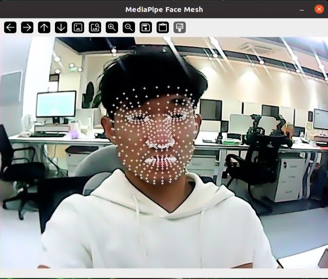

7.7.3 Program Outcome
After starting the program, if the camera detects a face, it will display the 3D outline of the face in the transmitted image.

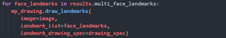

  • Draw Facial Mesh
Use the mp_drawing.draw_landmarks() function to draw the facial mesh of the detected face in the image.

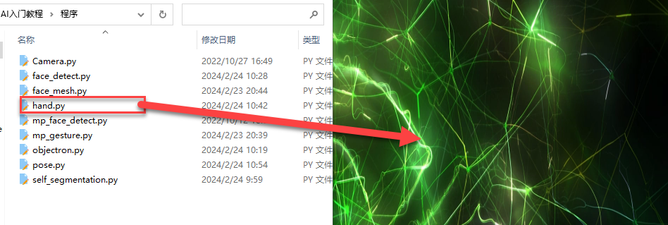

  3. When entering the system desktop, drag the program file “hand.py” under the same directory to the remote desktop.

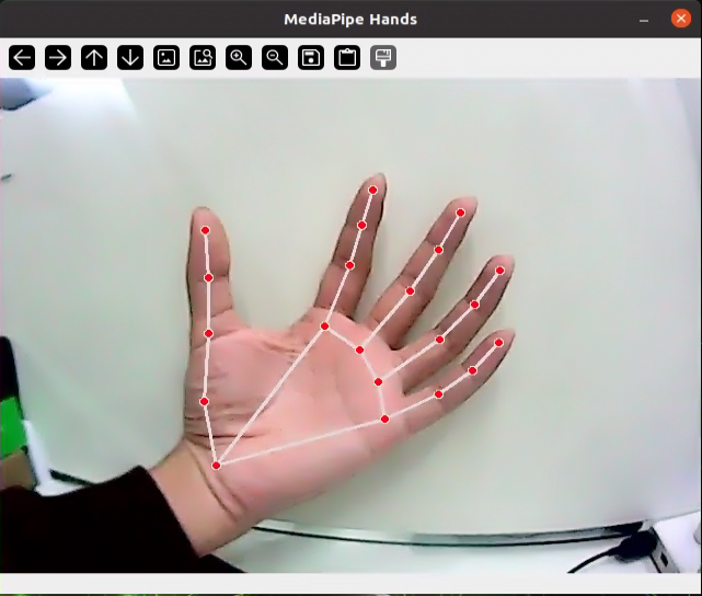

After starting the program, if the camera detects a hand, it will display the hand’s key points and the connections between the key points in the transmitted camera.

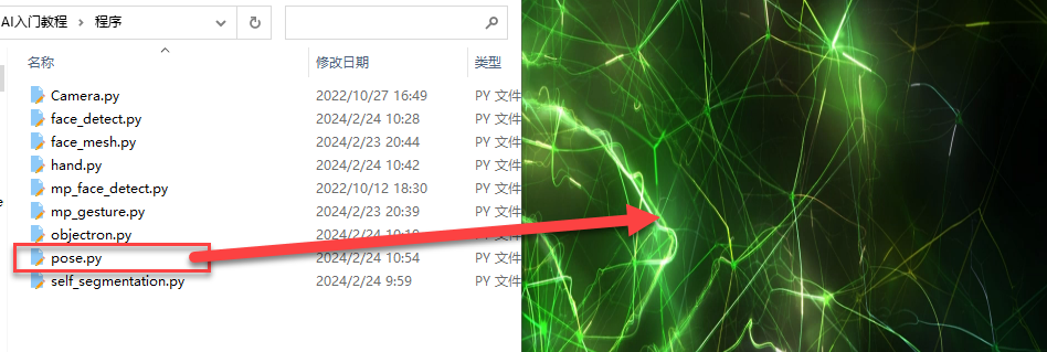

7.9.2 Operation Steps
  2. Connect it to the network. For specific operations, please refer to the tutorials located in “3. Basic Operation Course -> 3.3. Network Configuration (Wired and Wireless)” to access the network. Some models may need to be re-downloaded.
  3. When entering the system desktop, drag the program file “pose.py” under the same directory to the remote desktop.
  1. Enter the following command and press Enter to run the program.
python3 pose.py

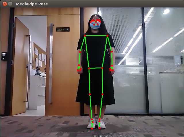

After starting the program, if the camera detects a human pose, it will display the human body key points and the connections between them in the transmitted image.
