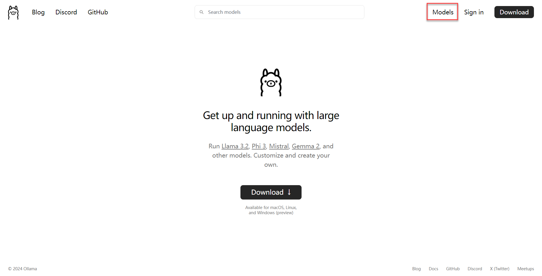

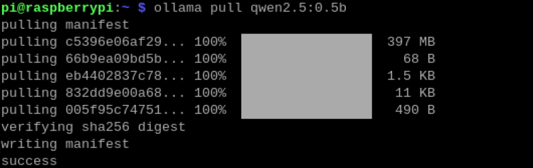

Before using a model, you need to install it. Start by visiting the Ollama website from the browser on your Raspberry Pi:
Ollama website: https://ollama.com/
  1. In the top-right corner, click on Models to browse available models.

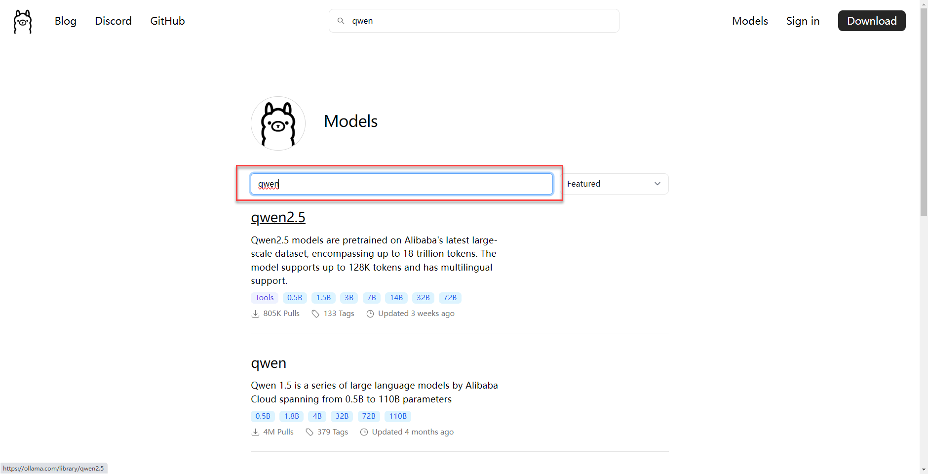

  1. You can also use the search bar to find a specific model. For example, let’s take the Qwen model.
  1. On the model’s page, you’ll find details about all available versions.
  1. Once you’ve chosen the right model, you can use the following command to pull it. For example, to pull qwen2.5:0.5b:
    ollama pull qwen2.50.5b
To download other models, you may repeat the same steps.

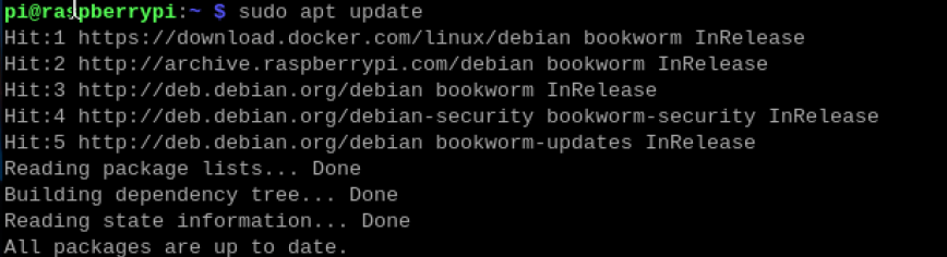

  1. Update the local package list:
    sudo apt update
  1. Upgrade the installed packages:
    sudo apt upgrade

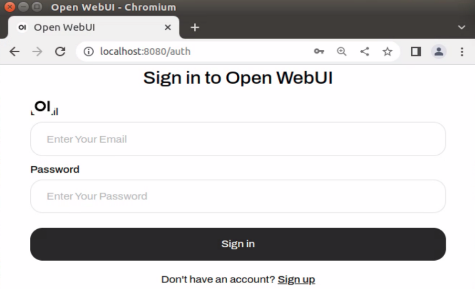

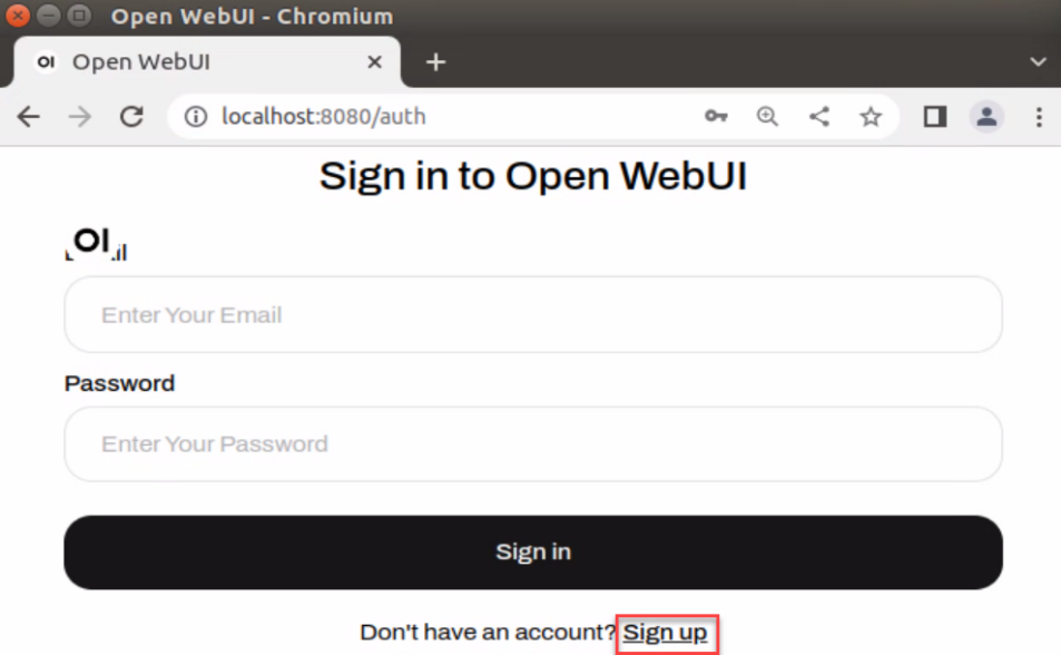

  1. Once successfully started, open your system’s browser and visit the following URL:
http://localhost:8080/

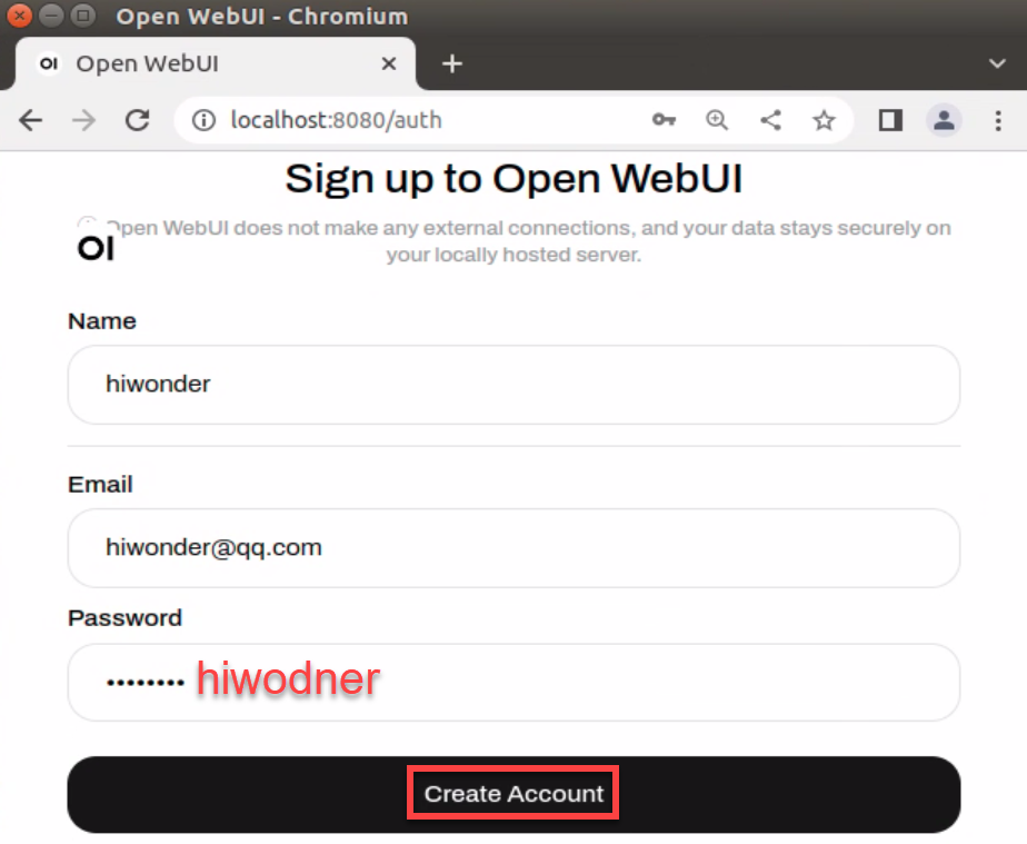

  1. For first-time use, you need to register an account. This account will be the administrator account, and you can fill in the required information as needed. Taking hiwonder as an example:
Username: hiwonder
Email: hiwonder@qq.com
Password: hiwonder
IMG_256

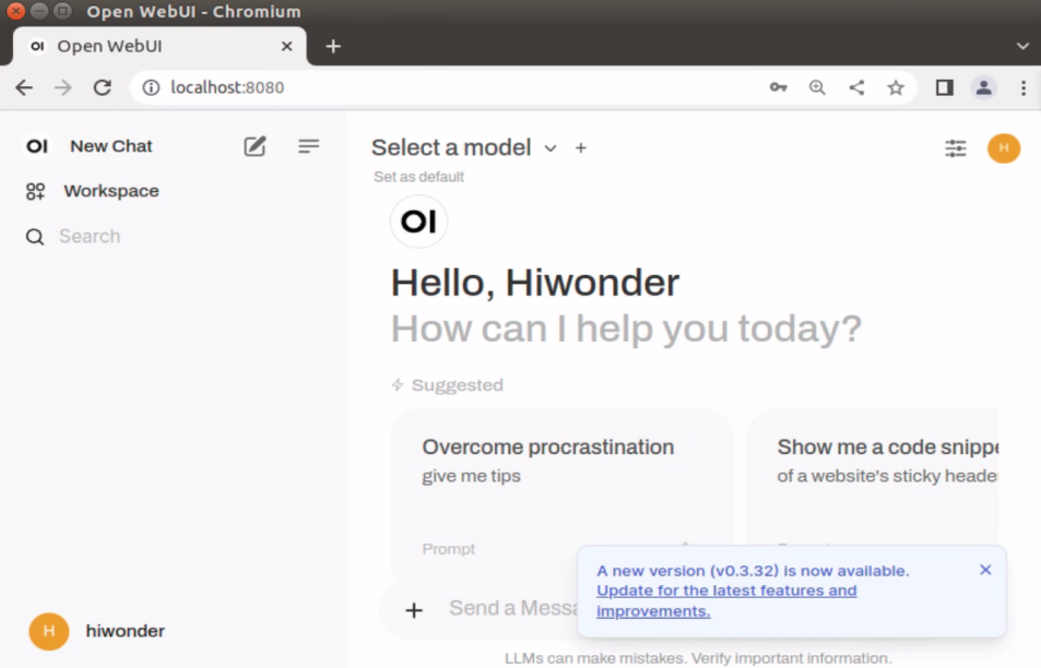

  1. Once logged in successfully, the interface will appear as shown below.

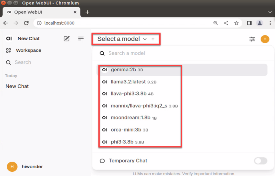

2. Switching Models
If you have downloaded multiple models, you can click on Select a model to choose a specific model for conversation. Models pulled using Ollama will automatically be added to the model options in Open WebUI.

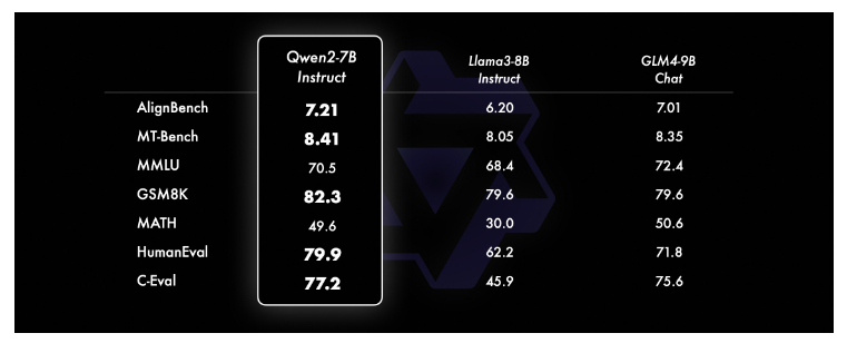

The Qwen 2 model is an open-source large language model developed by Alibaba Cloud’s Tongyi Qianwen team. It includes multiple pre-trained and instruction-tuned models of varying sizes, such as Qwen 2-0.5B, Qwen 2-1.5B, Qwen 2-7B, Qwen 2-57B-A14B, and Qwen 2-72B. This series of models has shown excellent performance across several benchmark tests, particularly excelling in areas such as language comprehension, text generation, multilingual capabilities, programming, mathematics, and reasoning. It competes effectively with proprietary models in these fields.
  • Model Specifications
Qwen 2 comes in multiple versions, allowing you to choose based on the board’s configuration.
Model Specifications Compatible Boards
Qwen2 Raspberry Pi 5 (4GB) Raspberry Pi 5 (8GB)
1.5B
7B ×
72B × ×
  • Performance

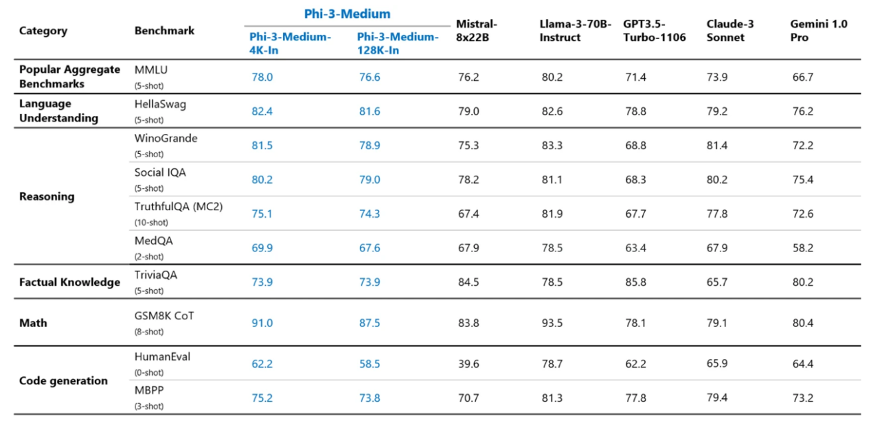

The Phi-3 model is a series of compact language models (SLMs) developed by Microsoft Research, designed to offer language understanding and reasoning capabilities comparable to larger models, while maintaining a smaller parameter size. The Phi-3 series includes three versions with different sizes: phi-3-mini, phi-3-small, and phi-3-medium. Each version is tailored for specific use cases and requirements.
Phi-3 comes in multiple versions, allowing you to choose based on the board’s configuration.
Phi-3.5 Raspberry Pi 5 (4GB) Raspberry Pi 5 (8GB)
3.8B
14B × ×
  • Performance

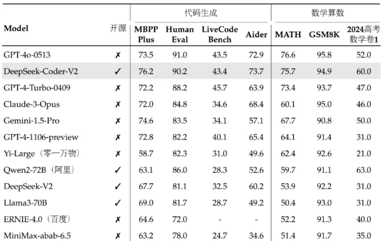

The DeepSeek Coder model is based on DeepSeek V2.5, which significantly outperforms the previous versions in both general capabilities and coding proficiency. DeepSeek Coder V2 and DeepSeek V2 Chat have been merged and upgraded to DeepSeek V2.5. The new model has been optimized across various tasks, including writing tasks and instruction-following, aligning more closely with human preferences.
DeepSeek Coder comes in multiple versions, allowing you to choose based on the board’s configuration.
DeepSeek Coder Raspberry Pi 5 (4GB) Raspberry Pi 5 (8GB)
1.3B
6.7B ×
33B × ×
  • 1.2 Performance

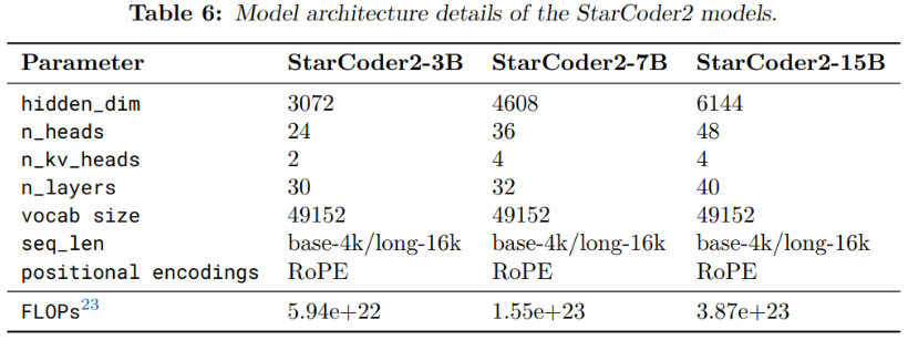

StarCoder2 Raspberry Pi 5 (4GB) Raspberry Pi 5 (8GB)
3B
7B ×
15B × ×
  • Performance

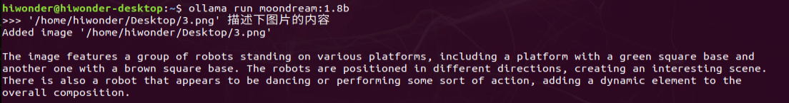

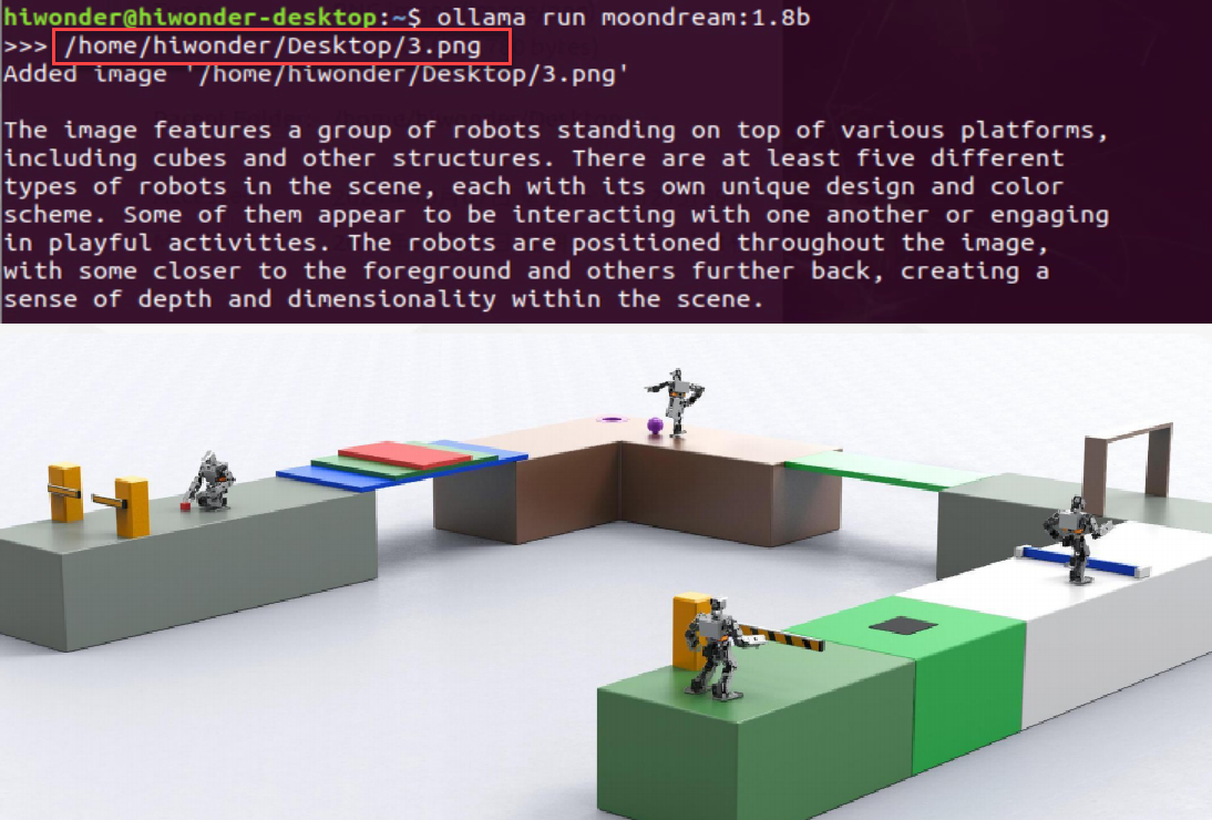

The Moondream model is primarily designed for image-based question answering and image description tasks.
  1. Run the moondream:1.8b model using the following command. If the model has not been pulled yet, it will be downloaded first.
    ollama run moondream:1.8b
  1. Press Enter after entering the image path and file name to send it. Response time depends on the hardware configuration, so please be patient!
    You can drag an image directly into the terminal.
    /home/hiwonder/Desktop/3.png
  1. To end the conversation, enter the following command:
    /bye
