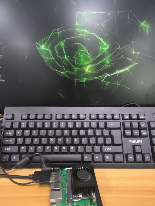

3.1 Start Jetson Orin Nano

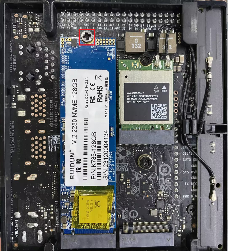

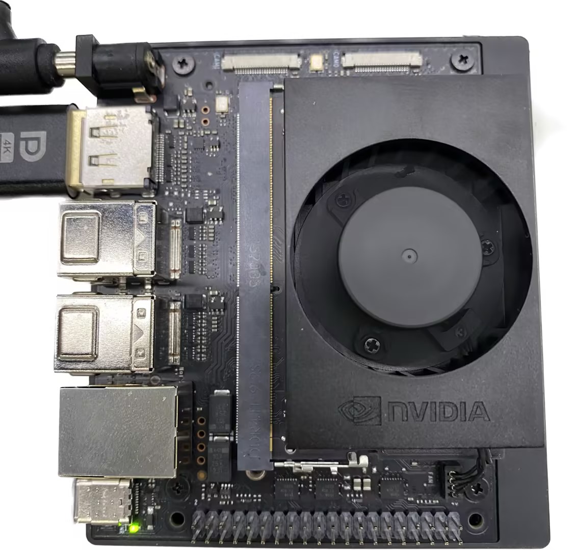

Insert the SSD that has flashed the system into the SSD slot on the main board and screw the slot firmly.
Connect the power supply and the HDMI cable to the monitor.

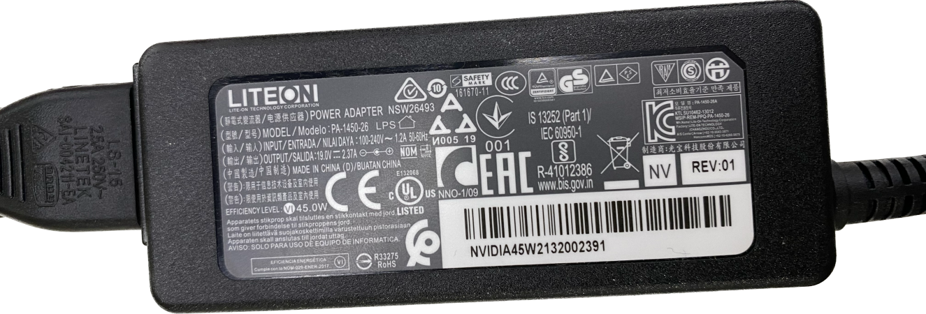

Use the provided official 19V 2.37A round-head DC connector power adapter to power the Jetson Orin Nano.
The power supply does not have a switch and it will powers on automatically, with DS1 indicator lighting up. Wait for the system to boot into the desktop; this process will be displayed on the screen.

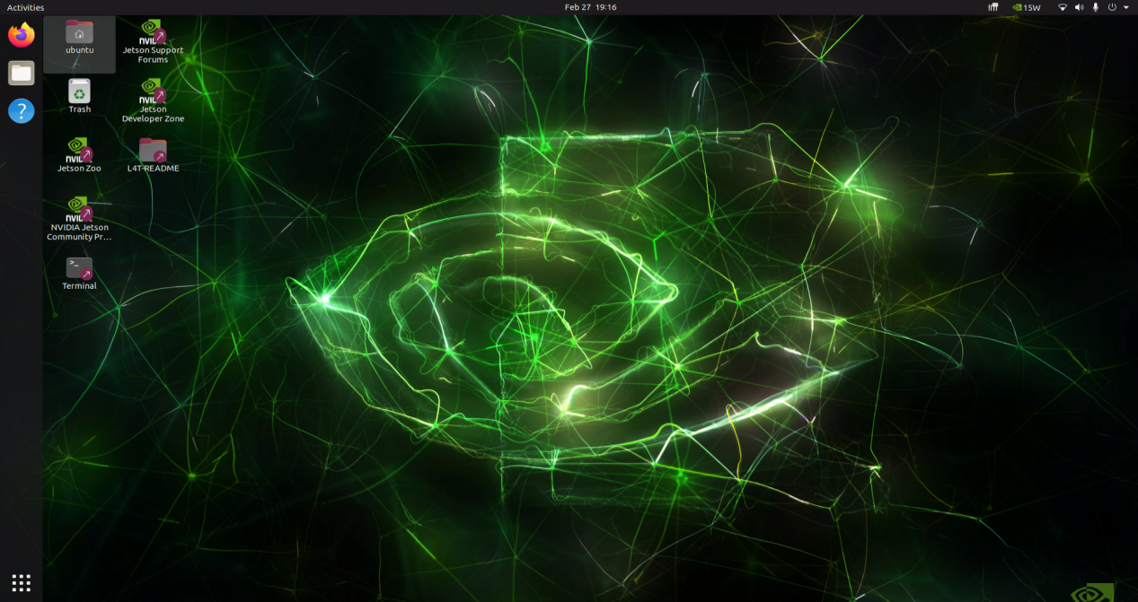

3.2 Introduction to System Desktop
The Jetson Orin Nano system desktop is shown in the figure below:
3.2.1 Taskbar
The left-side of the system desktop is the taskbar. The table below outlines the related functions:

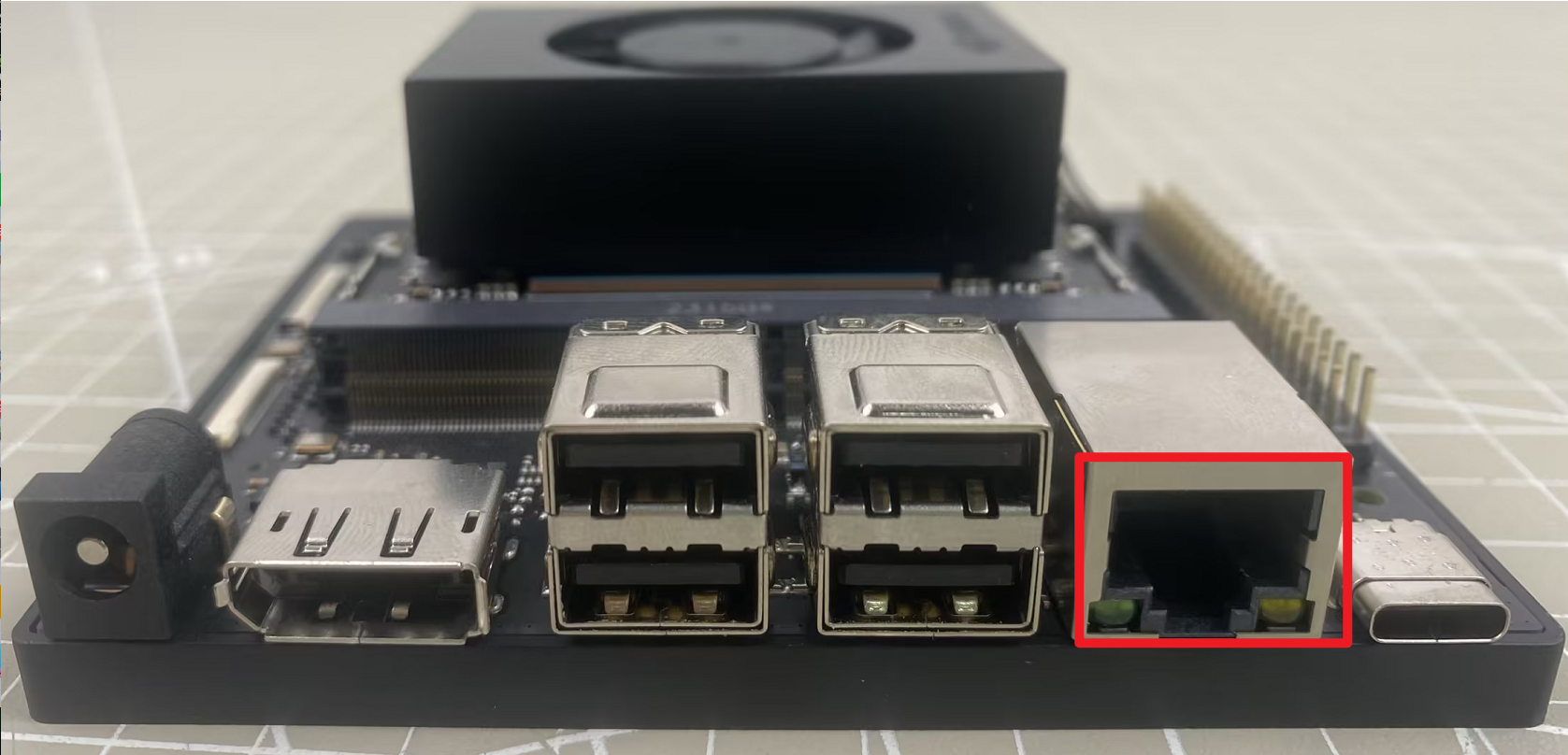

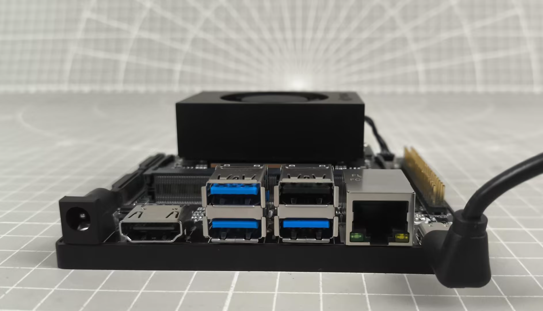

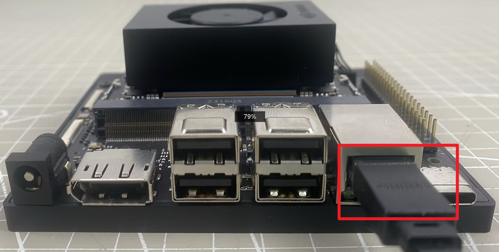

Connect the Ethernet cable to the RJ45 interface highlighted in the red box in the figure below:
The connection result is as follow. When the indicator in the yellow cable connection port flashes quickly, indicating a successful network connection.

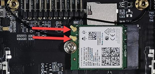

Network Card Installation

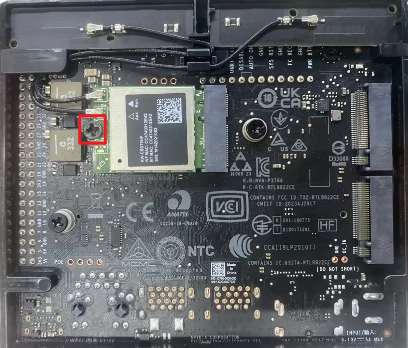

The network card has pre-installed before the shipment. This method requires connecting a monitor.

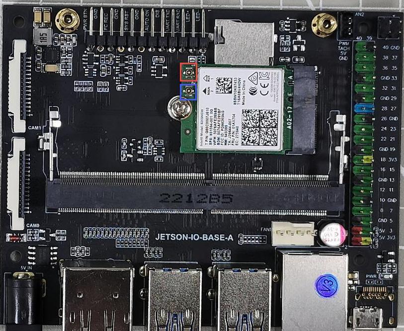

Prepare yourself the Jetson Orin Nano board, screwdriver, network card, and antenna. Loose the screws to install as pictured:

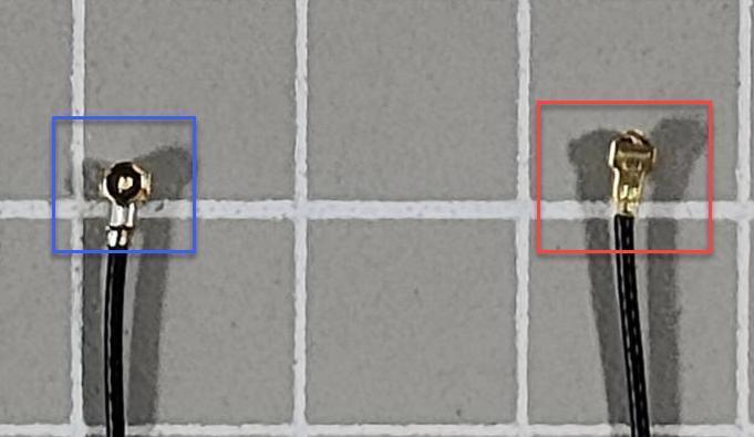

Designate the red box as slot 1 and the blue box as slot 2 for connecting the antenna.
The antenna has a front and back side, as shown in the image below. The blue box indicates the back side, and the red box indicates the front side. You need to connect the back side to the corresponding position.
When installing the antenna, it needs to be aligned with the slot properly to be installed correctly.

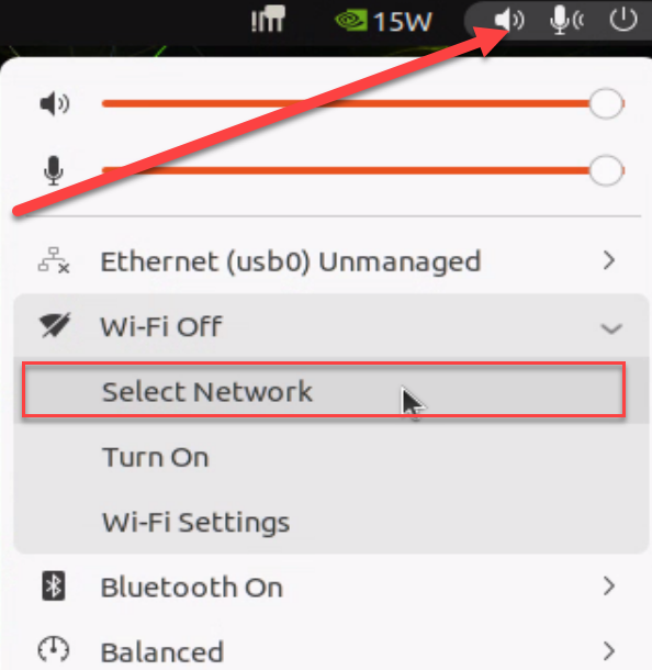

Power on the Jetson Orin Nano and connect it to a monitor.

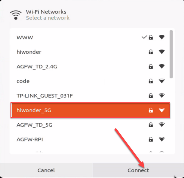

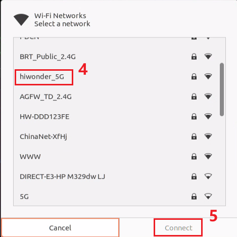

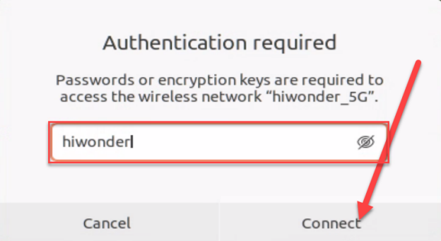

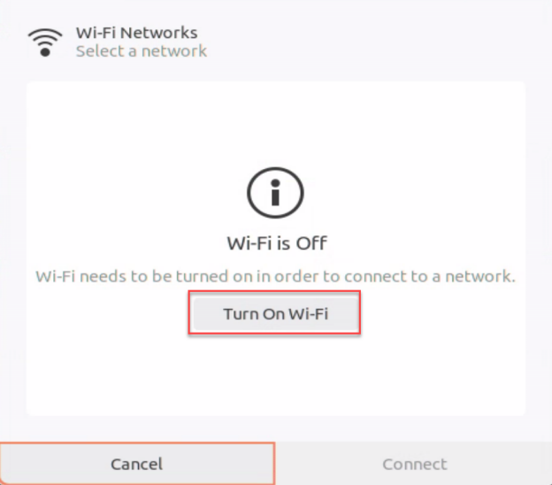

Click on the symbol group at the top -> Click the drop-down menu -> Select ‘Network,’ -> Choose the network -> Click ‘Connect’ and then enter the password. In this case, ‘hiwonder_5G’ network has already been connected. .

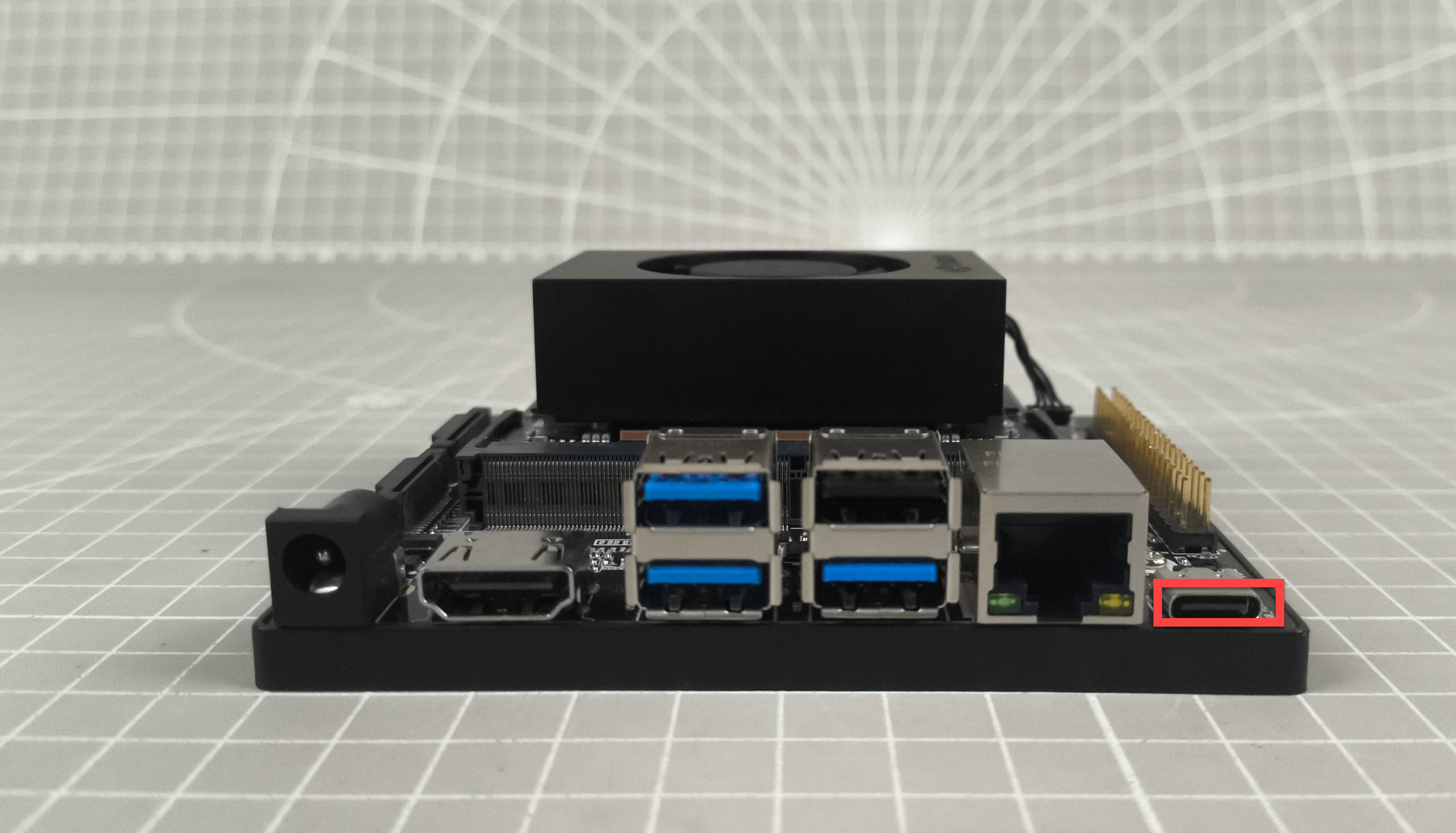

3.3.4 Control Jetson Orin Nano via USB Cable
This method only provides a connection between the computer and the Jetson Orin Nano board within a local network. If the local network itself is not connected to a public network, the Jetson Orin Nano will still be unable to access external resources. Additionally, make sure to connect the Jetson Orin Nano to the power supply and wait for it to boot up before connecting the USB cable.

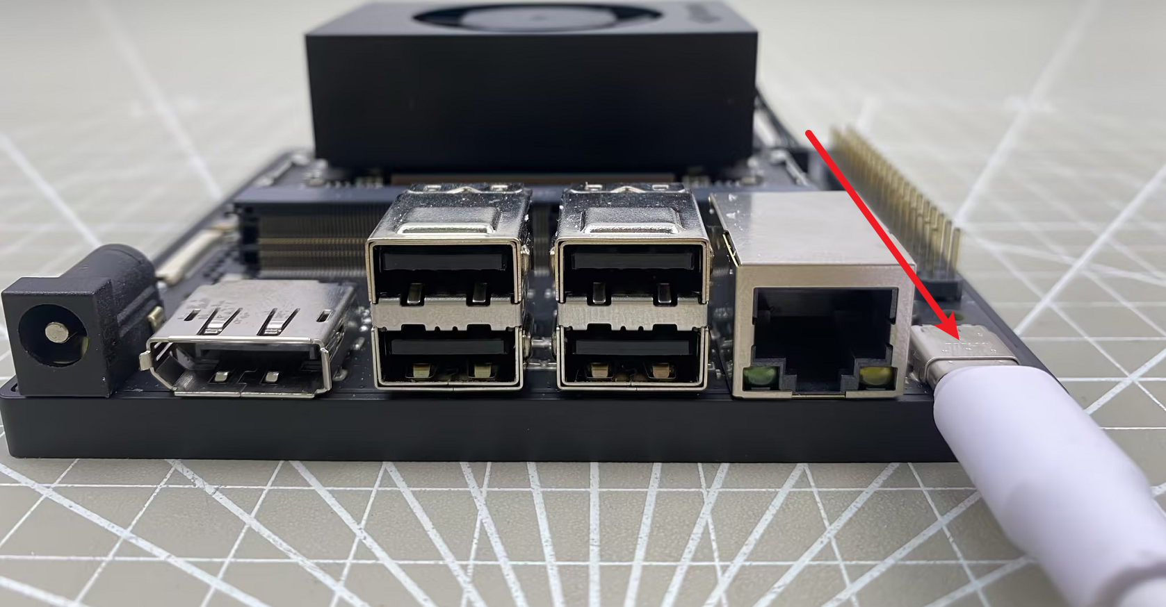

Connection

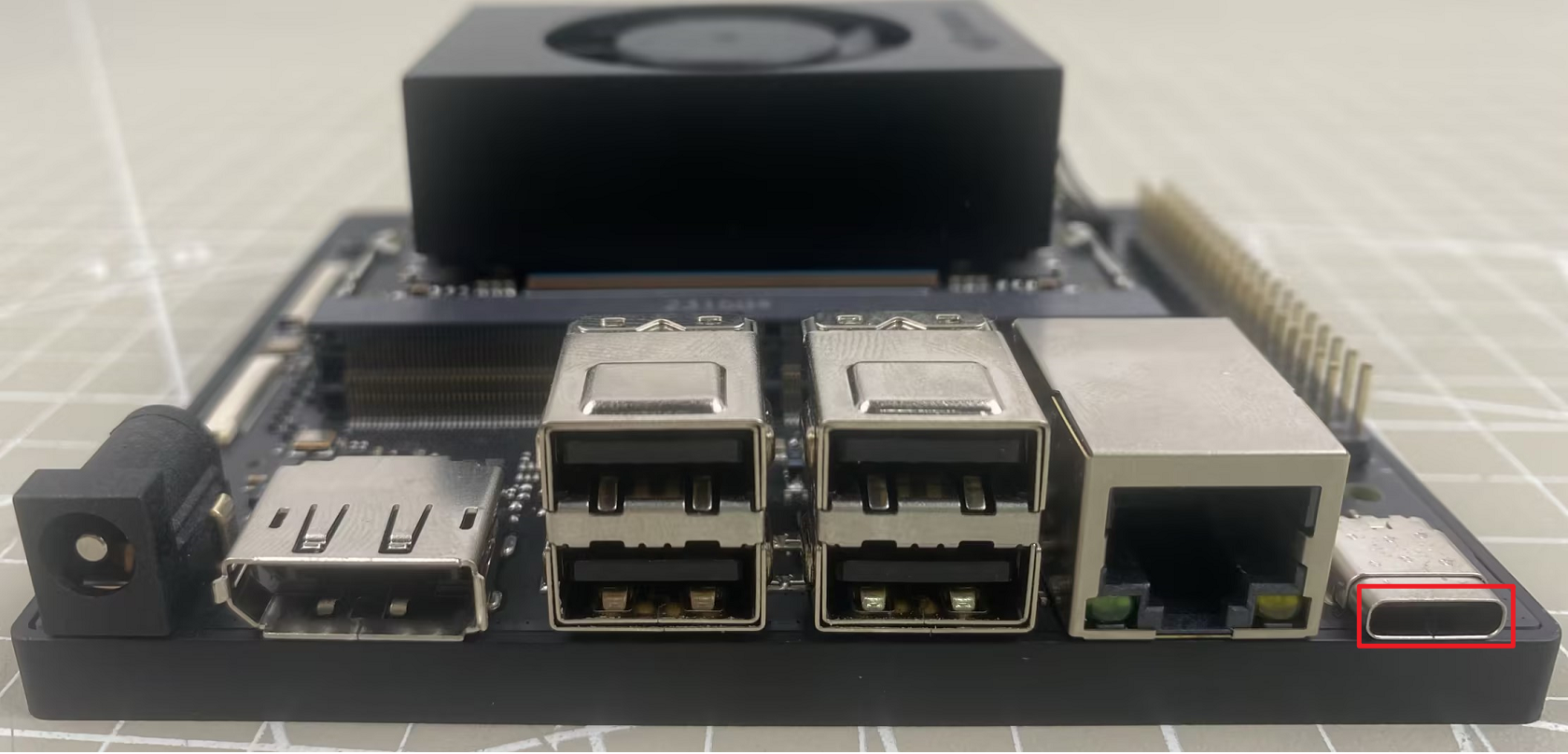

Power on the Jetson Orin Nano, then connect a USB cable to the location highlighted in the red box on the Jetson Orin Nano, and connect the other end to the computer.
The installation result is as follow:

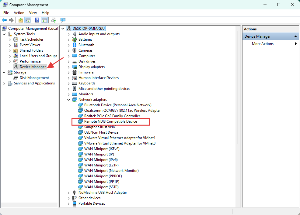

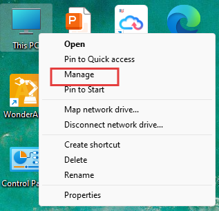

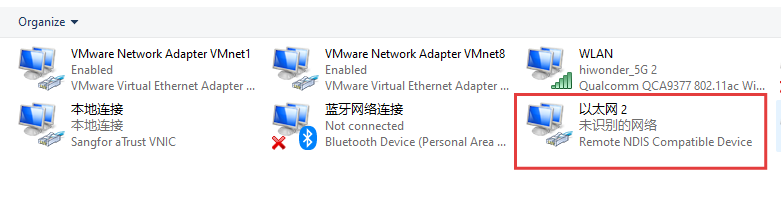

Power on Jetson Orin Nano, right-click “This PC”, and select “Manage”.
Click “Device manger”. If you find “Remote NDIS Compatible Device”, which means device is connected.

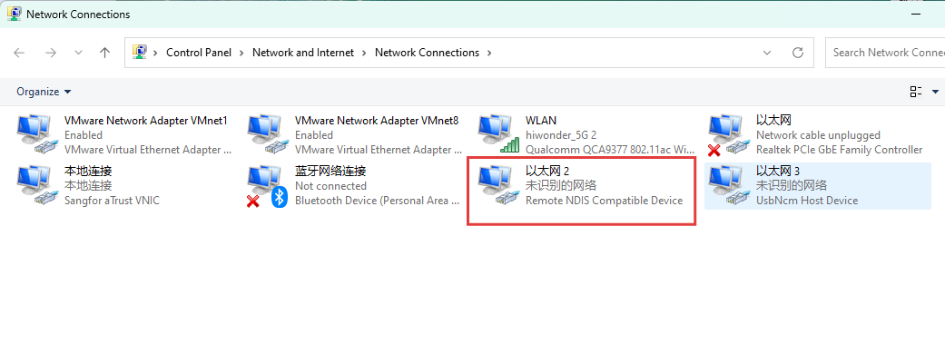

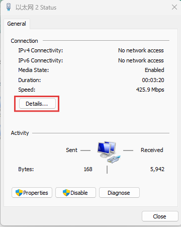

Check Device IP Address

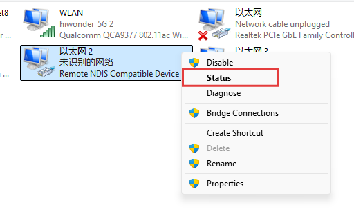

Right-click on the network connection as shown in the image below and select ‘Open Network and Internet settings’.
Click ‘Change adapter options’ to view the network adapters.
The adapter within the red box is the one we need to use.
Right-click on ‘Status’.
Click ‘Details’.
If the information shown in the image appears, it means we can remotely access the Jetson Nano via 192.168.55.1.

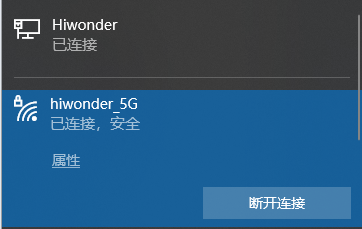

Create a hotspot on your phone. Here uses the hotspot name (hiwonder_5G) and the password (hiwonder).
Connect the PC to the created hotspot.

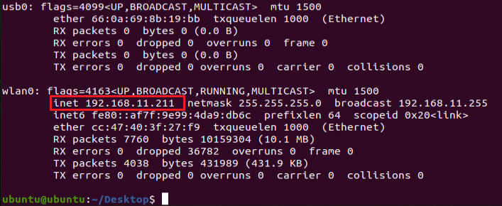

Power on the development board (it needs to be connected to a screen), and connect it to the same WI-FI as your computer.

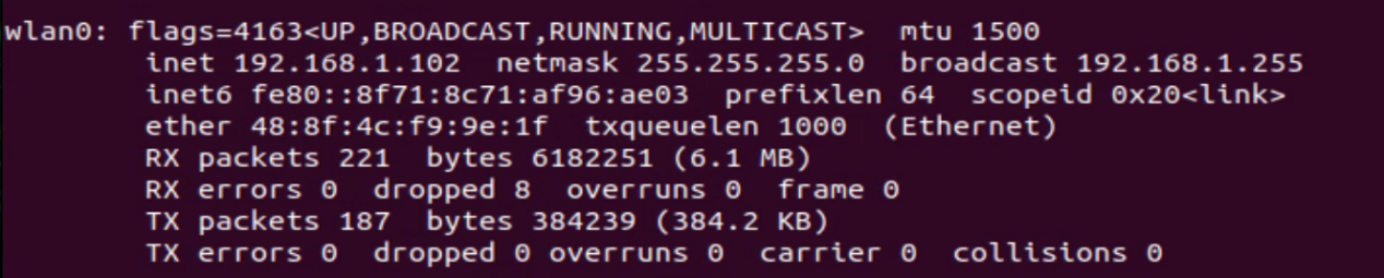

After a successful connection, you need to obtain the IP address of the development board. Double click
to open the terminal. Enter the following command and press Enter.
ifconfig
The device “wlan0” in the image below displays the current status of the current development board’s network adapter. After connecting to the hotspot, the assigned IP address is “192.168.1.102”. Please record the IP address.

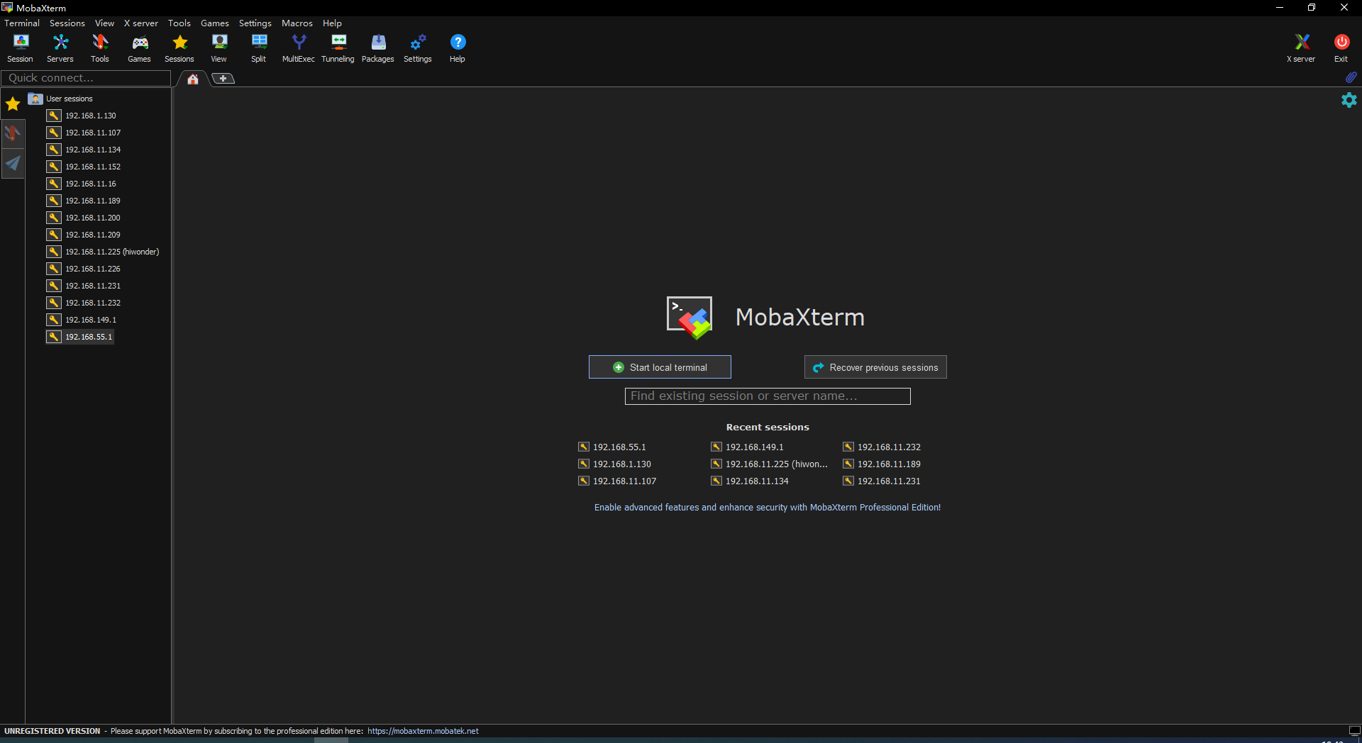

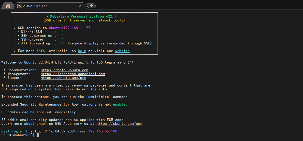

After the above preparations are complete, open the MobaXterm on your computer.
Click “Session” to create a session.

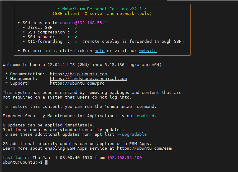

Click “SSH”, input the IP address of the development board “192.168.1.102”, and then click “OK”.
Your computer and the development board need to remain on the same network.
The interface will prompt you to enter a username and password (default username: ubuntu, password: ubuntu; use the credentials you set up). After entering, press the Enter key. Please note that as in Linux systems, the password will not be visually displayed as you type it.
The username name must be input in the lowercase mode. Even if the username includes uppercase letters, it must be entered in lowercase during login.
If the password is entered correctly, you will successfully login the system. The system interface will appear as shown in the image below:

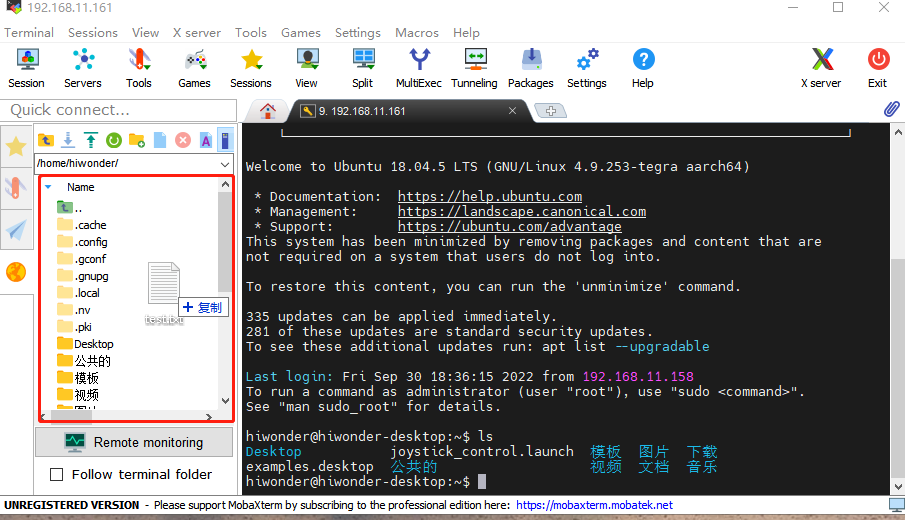

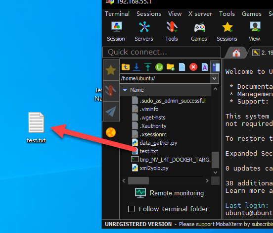

Transfer Files from PC to Jetson Orin Nano
After connecting via SSH, drag the target file into the MobaXterm file area.
The file will be automatically transferred to the home directory of Jetson Orin Nano system. The command “ls” is entered to view all files.
Transfer Files from Jetson Orin Nano to PC
After connecting via SSH, drag the target file in the MobaXterm file area to your computer desktop. The file will be automatically transferred to the desktop.

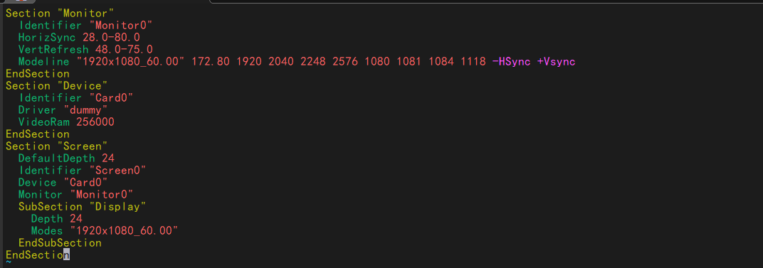

Copy the code below into the file, then click the middle mouse in the command-line window after copying:
Section "Monitor"
Identifier "Monitor0"
HorizSync 28.0-80.0
VertRefresh 48.0-75.0
Modeline "1920x1080_60.00" 172.80 1920 2040 2248 2576 1080 1081 1084 1118 -HSync +Vsync
EndSection
Section "Device"
Identifier "Card0"
Driver "dummy"
VideoRam 256000
EndSection
Section "Screen"
DefaultDepth 24
Identifier "Screen0"
Device "Card0"
Monitor "Monitor0"
SubSection "Display"
Depth 24
Modes "1920x1080_60.00"
EndSubSection
EndSection

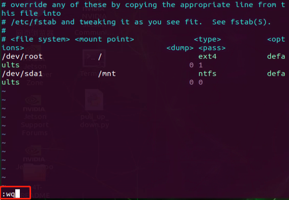

It will appear as the image shown below after entering:
Once done, press “Esc” and input “:wq”, press Enter to save and exit.

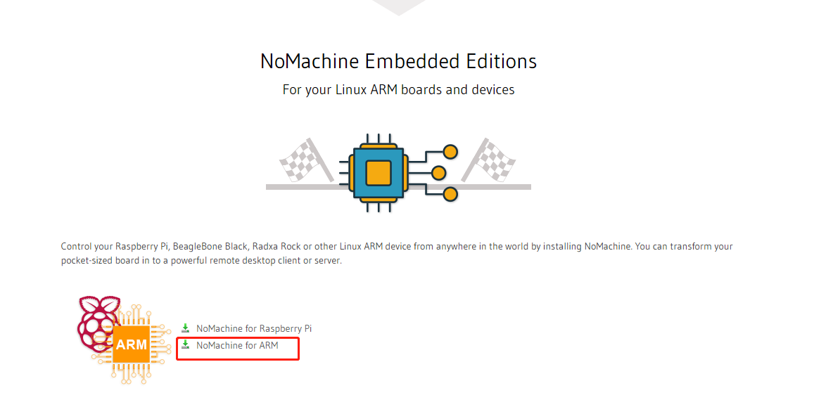

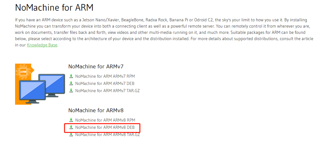

Enter the URL “https://www.nomachine.com/download” in a web browser on your computer to go the NoMachine download page.
Find “NoMachine for ARM” on the page, and click it to enter the ARM version download page.

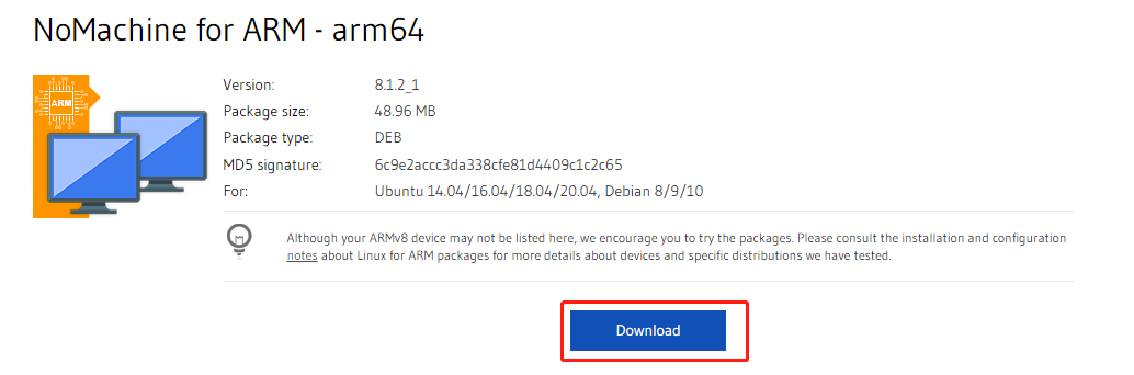

Then click “NoMachine for ARM ARMv8 DEB” to go to the download page.
Click “Download” to begin downloading Nomachine.

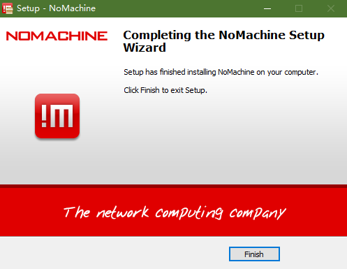

NoMachine Installation and Operation

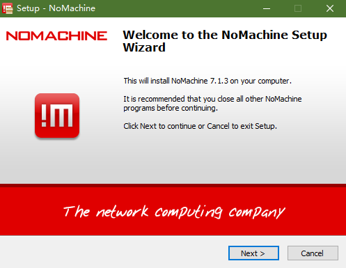

1. Install NoMachine
Navigate to the directory where you extract NoMachine installation package. Double click to open the NoMachine installation package “nomachine_7.1.3_1.exe”.
Click “Next”.
Select the installation language as “English”, check “I accept the agreement” and click “Next”.
Keep the default installation path, then click “Next”.
When the following prompt appears, click “Finish”.
Click “Yes” to restart your computer. (Do not skip this step!)

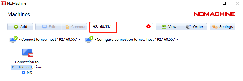

2. NoMachine Operations

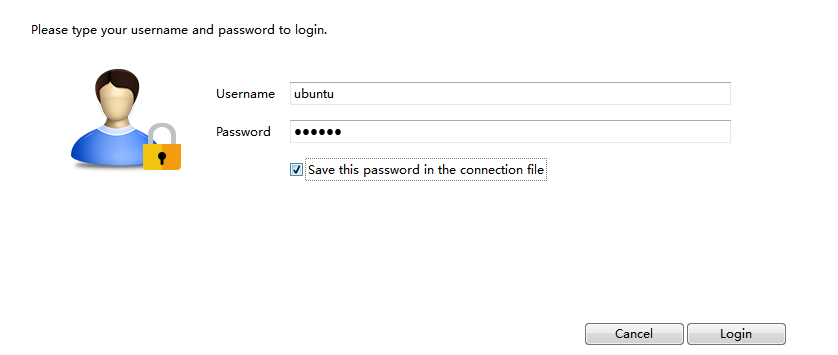

Open NoMachine, enter the obtained IP address “192.168.1.102” in the search bar, and click “Connect to new host 192.168.1.102” to create a connection to this address.
Set the username and password for login. Then click “login”, and you will see the remote desktop of the development board.
Connect Using a Data Cable
You can improve performance by enabling a remote NDIS compatible device. The specific steps are as follows:
If you need to use this method to connect the development board, you will need to use another method to enter the system for configuration.
Open a terminal and enter the command: sudo sed -i ‘s#exit 0#echo device > /sys/class/usb_role/usb2-0-role-switch/role\nexit 0#g’ /opt/nvidia/l4t-usb-device-mode/nv-l4t-usb-device-mode-start.sh
Or use our pre-configured image. You can refer to the content”2. Conifiguration Guide -> 2.3 Flashing the System Using an SSD” to perform the system flashing.
Power on the Jetson Orin Nano, then connect a USB cable (a standard Type-C data cable will work) to the location highlighted in the red box on the Jetson Orin Nano as shown in the image below, with the other end connected to your computer.
The connection result is as pictured:
After completing the driver installation, open NoMachine. Enter the IP address “192.168.55.1” to establish a connection.
3.4.4 Control Jetson Orin Nano via a USB Cable
This method only provides a connection between the computer and the Jetson Orin Nano board within the local network. If the local network is not connected to the public internet, the Jetson Orin Nano will still be unable to access external resources. Additionally, please connect the Jetson Orin Nano to the power supply first, and wait for it to boot up before connecting the USB cable.
Or use our pre-configured image. You can refer to the content”2. Conifiguration Guide -> 2.3 Flashing the System Using an SSD” to perform the system flashing”.
Connection
As shown in the image, right-click the network connection icon and select ‘Open ‘Network & Internet’ settings.
Click on “Change adapter options” to view the adapters.
The adapter inside the red box is the one we need to use.
Right-click on “Status.”
Click on “Details.”
If the information shown in the image below appears, it indicates that we can remotely access the development board via “192.168.55.1” (this IP can be used for “1 SSH Remote Connection and 3 Remote Desktop Configuration and Use”).

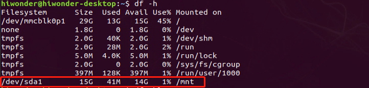

Next, enter the command “sudo mount /dev/sda1 /mnt” to mount the USB drive to the “/mnt” directory. You can change this directory to any other existing directory if needed.
Finally, enter the command “df -h” to check if the mounting was successful.
df -h
When you see the following information, it indicates that the mounting was successful.

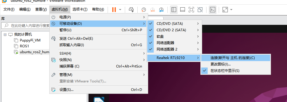

Connect the Hard Disk to Virtual Machine
According to the image below, connect the hard drive to the virtual machine. The device name ‘Realtek RTL9210’ may vary depending on the type of SSD enclosure used. Make sure the corresponding device is connected to the virtual machine.

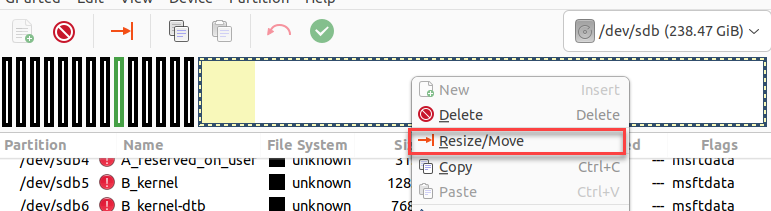

Resize the Image
Open a new terminal and open the gparted by run the command:
sudo gparted
Enter the password when the following prompt appears: ubuntu

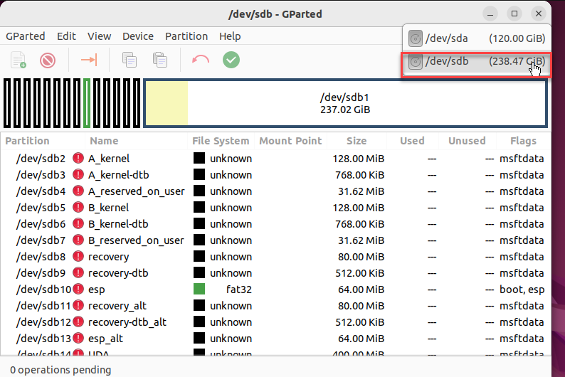

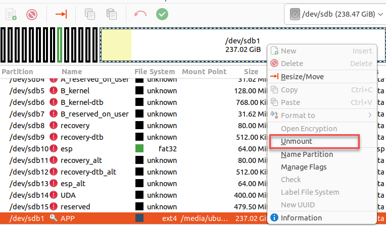

Choose the corresponding hard disk.
Unmount the hard disk

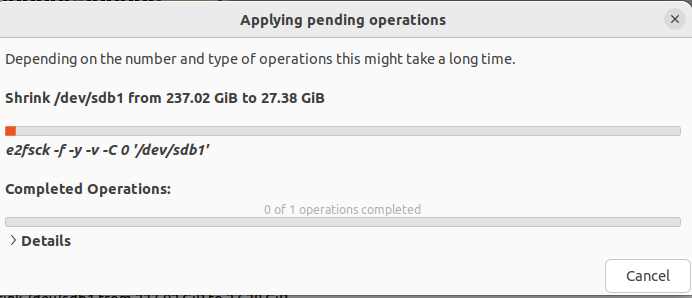

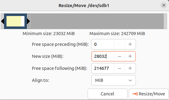

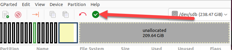

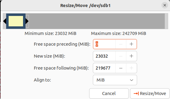

Resize the image.
Slide the bar to the far left until it cannot move further to determine that the current hard drive usage is 23032M. Then, add 5000M as extra space. (If you directly enter 23032M, it may prevent the system from booting, so adjust the slider accordingly and then press ‘Resize/Move.’)

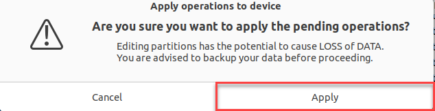

Click

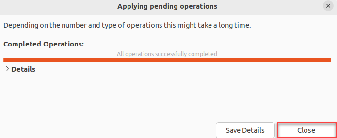

and select “Apply” to confirm and apply the changes.

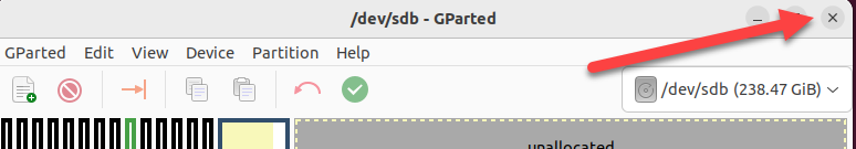

Wait for the partition to complete, then click “Close”.
Close the gparted.

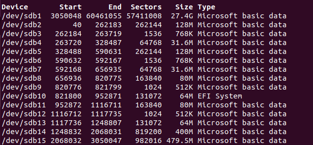

Enter the following command to confirm the image size:
sudo fdisk -l
You can see that the image size is 27.4G. We need to record the number under ‘End’: 60461055.
Run the following command to out the image:
sudo dd if=/dev/sdb of=./orin_nano.img bs=512 count=60461056
This output shows data for the device /dev/sdb. The image is located in the current directory with the name orin_nano.img. The block size is 512, and the total size is 60461056. Originally, the total size was 60461055, so we need to add a little extra space to ensure the image will boot correctly. Therefore, we need to increase the total size by 1.

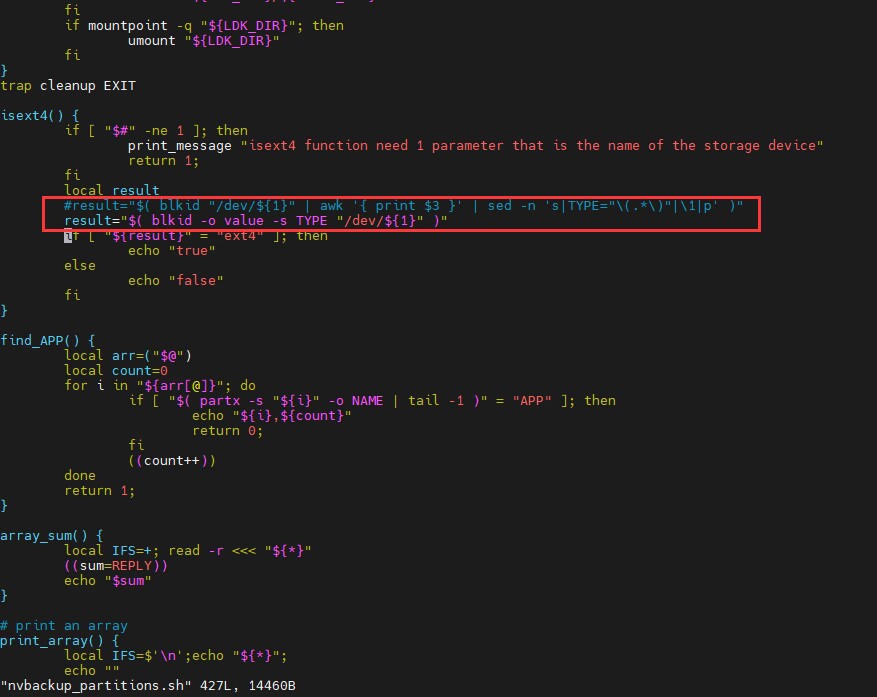

cd /home/ubuntu/nvidia/nvidia_sdk/JetPack_6.0_Linux_JETSON_ORIN_NANO_TARGETS/Linux_for_Tegra/tools/backup_restore
Enter the command to modify the script and change the read location.
vim nvbackup_partitions.sh
Locate the position shown in the image below and change it to the content highlighted in the red box. After making the changes, press the ‘ESC’ key, type “:wq”, and press Enter to save and exit.

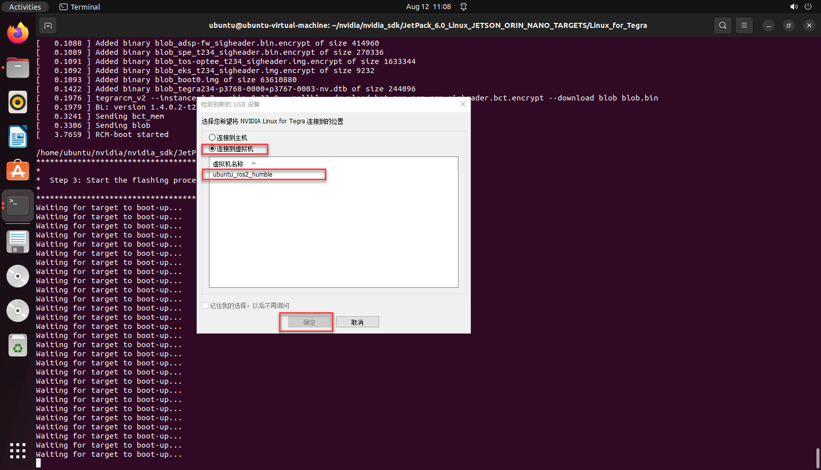

During the flashing process, the motherboard will reboot. The virtual machine will display ‘Waiting for target to boot-up…’. You need to select the device to connect to the virtual machine according to the content shown in the image below.
