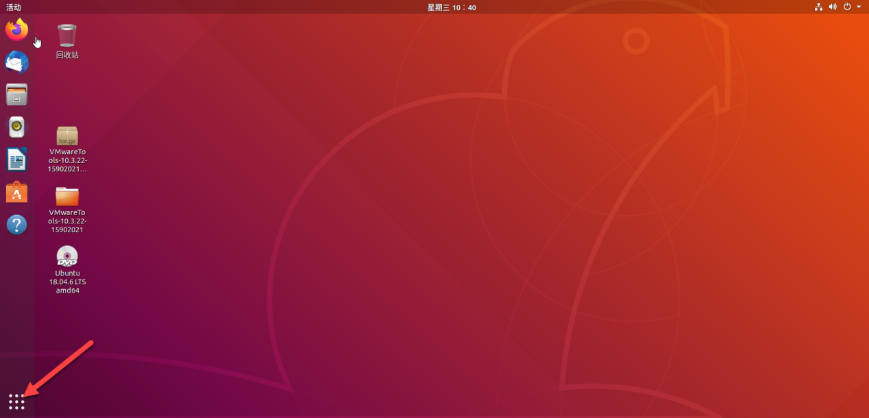

  1. Start virtual machine, and click , and then click or press “Ctrl+Alt+T” to open command line terminal.

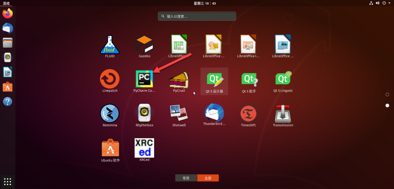

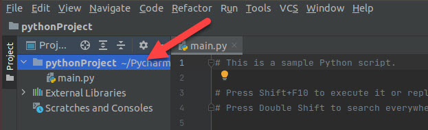

  • Open pyCharm
  1. Open menu and find pyCharm

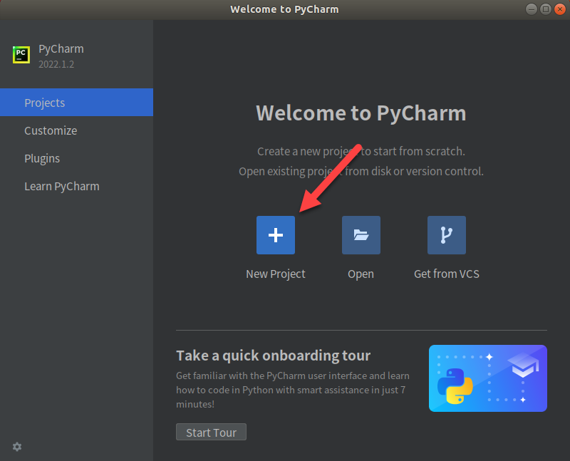

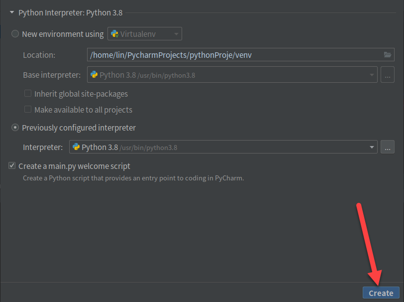

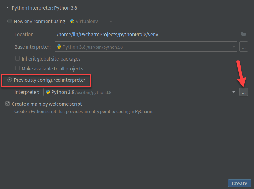

  1. Create new pyCharm project and configure. Click “New Project”.

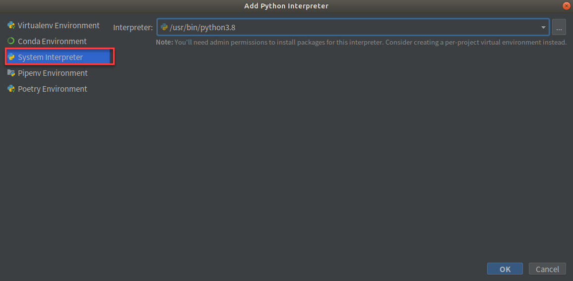

  1. Select “Previously configured interpreter” and click .
  1. Select “System interpreter
  1. Click “create

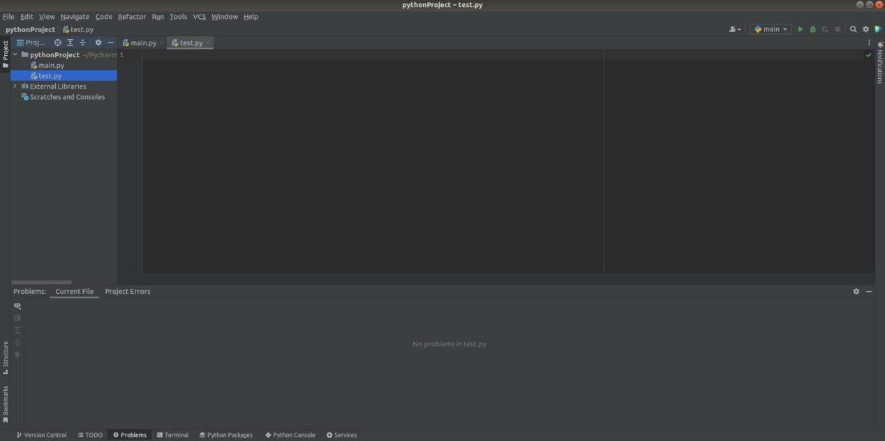

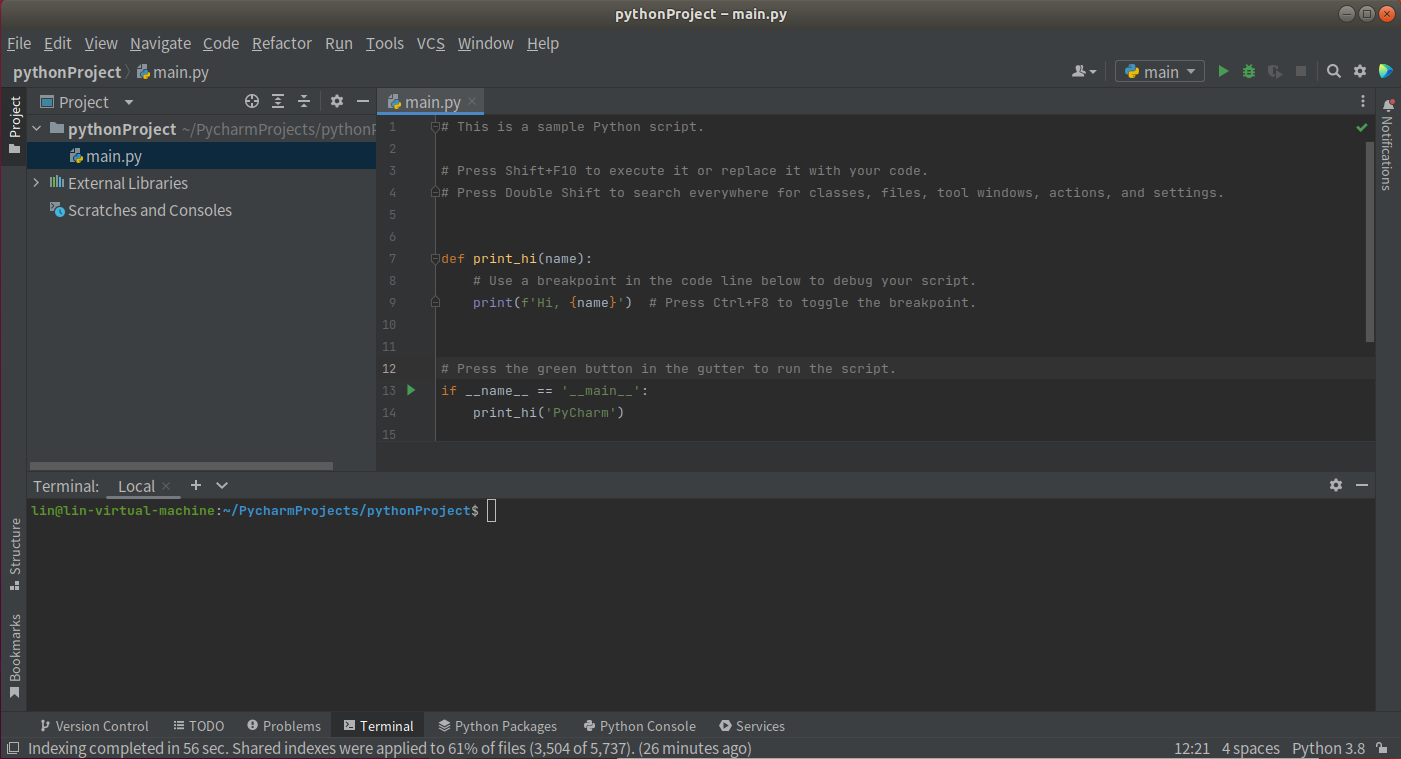

  1. Lastly, you will enter this interface.
  • Usage of pyCharm

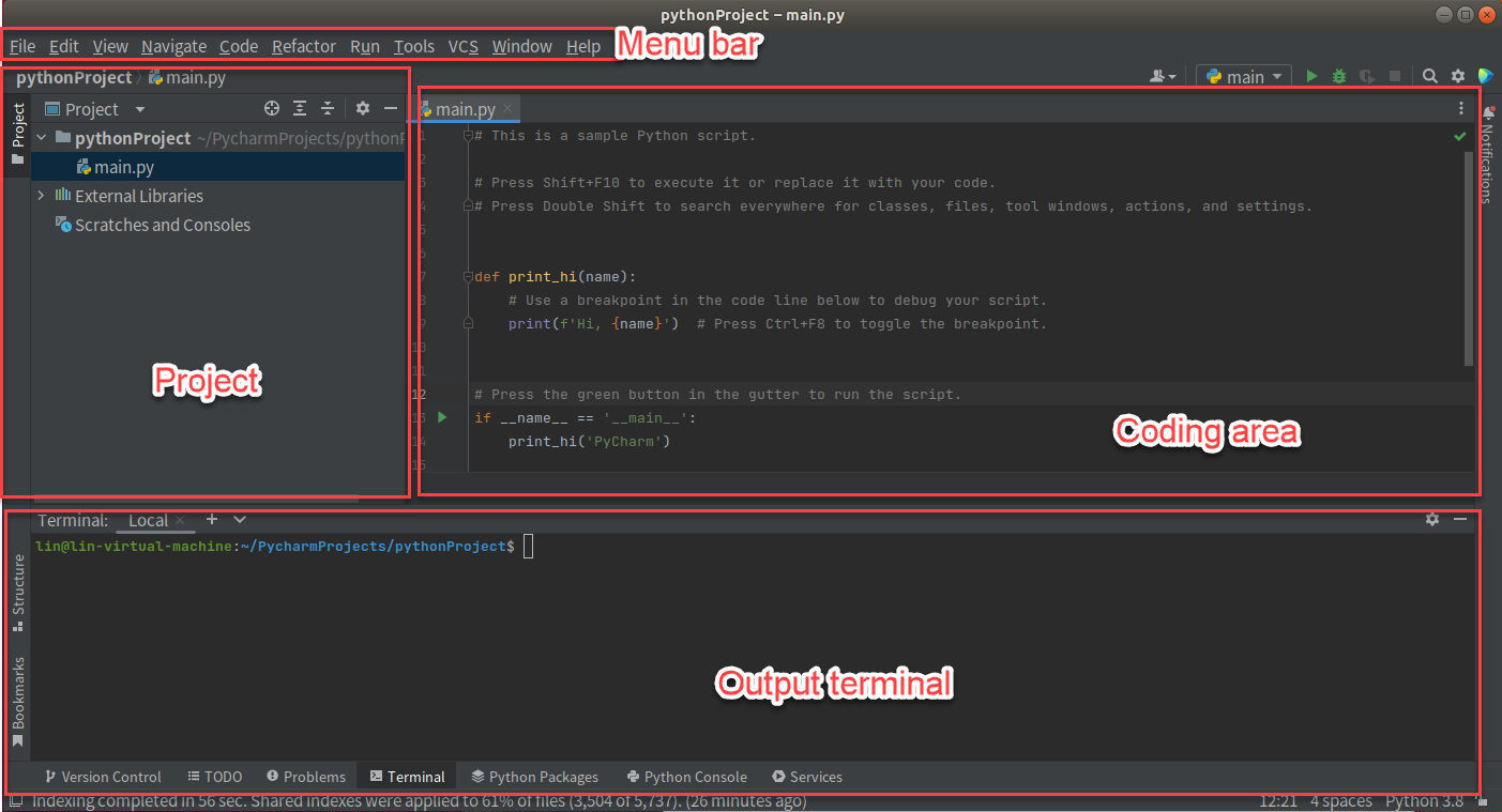

  1. The user interface of pyCharm is as follow.
  1. Create a .py file. Right click the project folder.

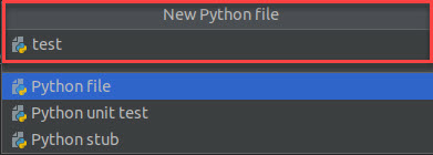

  1. Click “New>Python file
  1. Name python file you created.
  1. The python is created.

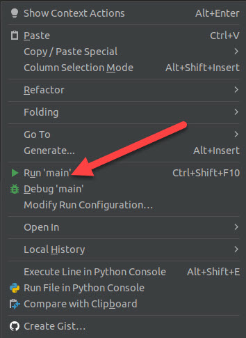

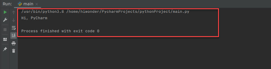

  1. Right click coding area to select “run”. You can check the output result on the output terminal.

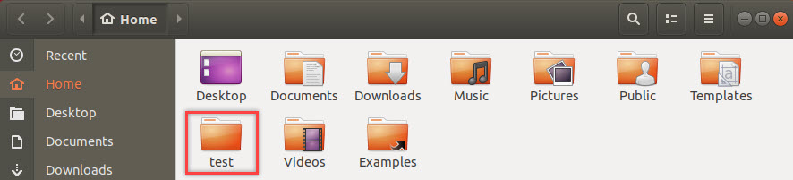

  1. Input “mkdir test” command and press Enter to build a folder named “test” under the current directory.
mkdir test

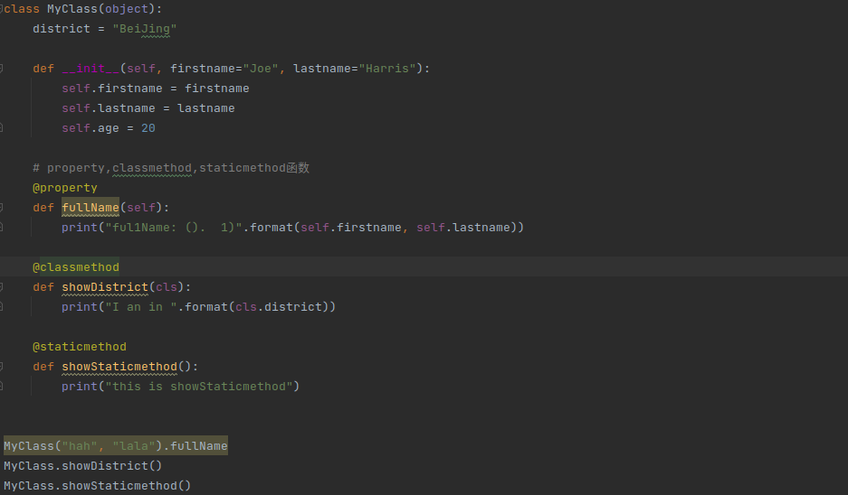

4.3.2 Indentation Rules
Python uses indentation and colon symbol (:) for showing where blocks of code begin and end
In Python, for class definitions, function definitions, flow control statements, exception handling statements, etc., the colon at the end of the line and the indentation of the next line represent the beginning of the next code block. And when indentation ends, a block of code ends.
Each red frame in the picture below represents one block of code.
Block of code at the same level should be indented consistently. We can use “Tab” key or input 4 spaces to indent.
Python uses 4 spaces as indentation by default. In general, one “Tab” is equal to 4 spaces.

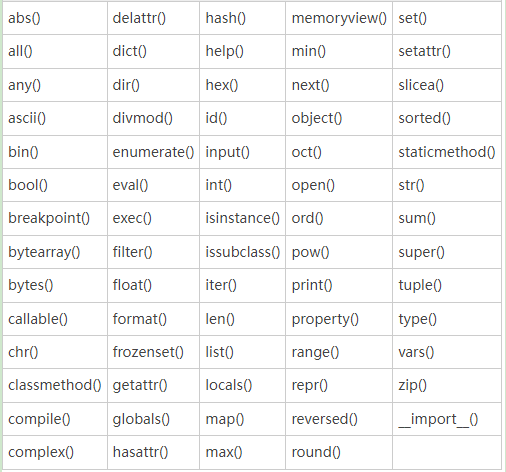

Reserved word, also called keyword, is a word with special meaning in Python. And they cannot be used as variable names, function names, class names, module names or any other object names
In Python interactive programming environment, we can check the reserved words according to the steps below.
  2. Input “python3” command and press Enter to enter Python interactive programming environment.
  1. Input “import keyword” command and press Enter to import “keyword” module.
  1. Input “keyword.kwlist” commend and press Enter to view all reserved words in Python.
Reserved words are also case sensitive. For example, “if” is reserved word, while “IF”, “iF” and “If” are not.

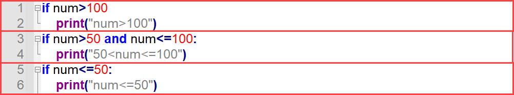

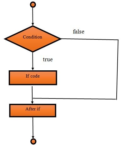

  • Selection Statement
There are three types of selection statements, including single-branch selection structure, double-branch selection structure and multi-branch selection structure.
1. Single-branch selection structure
The syntax and execution process of single-branch selection structure are as follow.
Syntax Execution Process
If the condition of “if statement” is true, block of code 1 and 2 will be executed in sequence. Otherwise, skip block of code 1 and directly execute block of code 2.
2. Double-branch selection structure
The syntax and execution process of double-branch selection structure are as follow.
If the condition of “if statement” is true, block of code 1 will be executed. Otherwise, block of code 2 will be executed.
3. Multi-branch selection structure
The syntax and execution process of multi-branch selection structure are as follow.
If the condition of if statement is true, block of code 1 will be executed.
If the condition of if statement is false, conditions of elif statements will be judged in sequence. When the condition is true, the corresponding block of code will be executed.
If neither conditions of if statement nor elif statement are false, block of code n+1 will be executed.

  1. Start virtual machine, and click “”, and then click “” or press “Ctrl+Alt+T” to open command line terminal.
  2. Input “cd /mnt/hgfs/Share/” command and press Enter to enter the shared folder.

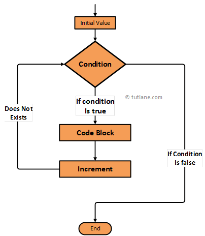

4.5 Python Loop Statement
In the program, some steps of the algorithm will be executed repeatedly under certain condition, which is loop statement. In this lesson, Python statement will be explained combining with the related routines.
4.5.1 Loop Statement Introduction

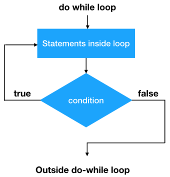

Loop statement includes “while” and “for”, which is used to repeat some steps.
  • while loop
The format and execution process of while loop are as follow.
When the loop condition is True, the block of code in while loop will be executed till the loop condition is False. When the loop condition is always True, it will fall into “dead loop”.

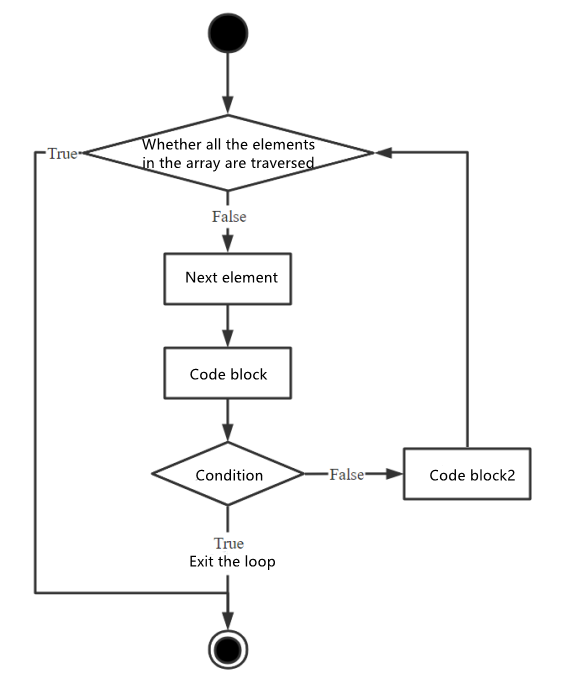

  • for loop
The syntax and execution process of for loop are as follow.
Target can be string, list, tuple, dictionary and other sequence type, while loop variable is used to store the elements read from the variable of the sequence type
After entering for loop, traverse the elements within target and execute the block of code within for loop till the traversal ends.

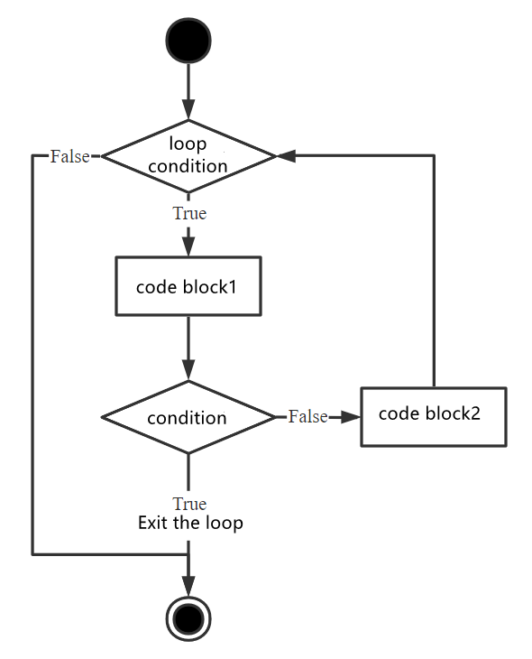

4.5.2 Loop Control Statement Introduction
Loop control statement can be used to interrupt the loop, or skip the current loop to execute the next loop. Loop control statement contains “break”, “continue” and “pass”.
  • break Statement
break statement is used to get out of the whole loop. The syntax and execution process are as follow.
When the judgement condition is executed and is “True”, the loop will end. If the judgement condition is “False”, the block of code 2 will be executed and the loop will continue.

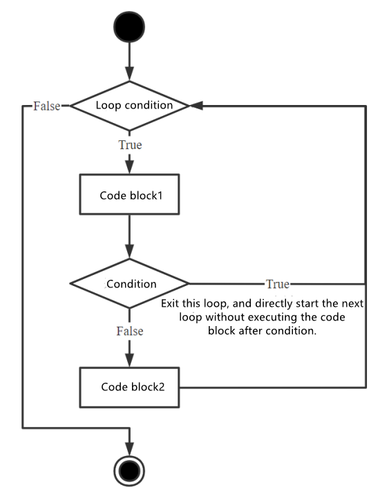

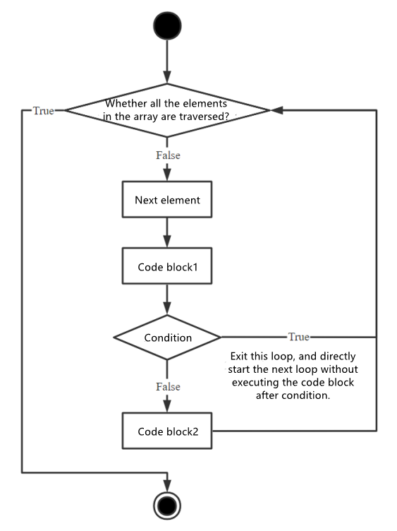

  • continue statement
continue statement is used to get out of this round of loop and carry out the next round of loop. The syntax and execution process are as follow.
When the judgement statement is executed and is “True”, this round of loop is complete and next round of loop starts. If the judgement condition is “False”, the block of code 2 is executed and the second round of loop is done.

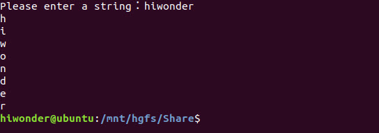

4.5.4 Program Outcome
Input one integer and press Enter, and then the terminal will print its factorial.
Input a string and press Enter, and then the terminal will print the elements of this string.

In Python, function is divided into built-in function and user-defined function.
Built-in function that readily comes with Python can be directly called without importing any function libraries. The common built-in functions include print(), input(), range(), etc.
User-defined function will define a piece of regular and reusable code as function to elevate the reuse rate and maintenance of the codes.

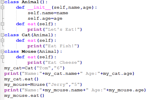

4.8.3 Class Definition
  1. Defined by class keywords, class name usually starts with capital letter.
  2. _init_ function initializes class, which is equal to constructor. Whenever creating instance based on class, this function will be ran automatically in Python.
  3. self function, implicit parameter and the object itself, is equivalent to this function.
  4. Properties correspond to member variables.
4.8.4 Instance Creating
  1. Create the class name, and input the required properties.
  2. These properties and methods can be called directly.
4.8.5 Property of Class and Instance
  1. Instance property are defined within __init__ of a class, and class property are defined outside __init__ of a class. An instance of a class created outside the class can define its own properties.
  2. Personal variable: if don’t want the external to access some properties, we can start the property name with double subscripts (__). Therefore, these properties will not be accessed by original variable name, that is, they can not be called from an instance.
4.8.6 Class Inheritance and Polymorphism
  1. Inheritance: when creating a class, you can write the name of the parent class in parentheses, so that the properties and methods of the parent class are inherited to the child class. If the child class does not have an initialization method, the initialization method of the parent class will be called.
  2. Method rewriting: If the name, return type and parameter list of a method defined in a child class exactly match those of a method in the parent class, the method of child class rewrites that of parent class.
  3. Polymorphism: the behaviors of multiple child classes derived from one parent class are different, which is called polymorphism. In other words, child class rewrite the methods of parent class to let it has methods different from the parent class. When child class have the same method as parent class, the priority will be given to the method of child class, that is, the child class overrides the parent class.
After execution, the instance of child class will automatically call the construction method of parent class, and the child class will override the parent class method with the same name.

4.10.2 Built-in Function List
  • Operation Type
  1. abs(x):abs function is used to return the absolute value of a value. The input x parameter can be the floating point number of the integer, and also can be complex number.
  2. max(x,key=None:The parameter x of the max function is an iterable object or multiple parameters, and max function will return the maximum element among them. max function can return the maximum value through designating the key parameter. If there are multiple maximum values, the first value will be returned.
  3. min(x,key=None):The usage of min function is the same as that of max function. min function will return the minimum value of an iterable object or multiple parameters.
  1. pow(x,y, mod): When pow function only has x and y parameters, its function is to return x to the y power. When the third parameter mod exits, the pow function takes the remainder of mod on the basis of x raised to the y power.
  2. round(number,ndigits):Return the value of number rounded to ndigits of precision after the decimal point. If ndigits is omitted, the integer closest to the number is returned.
  3. sum(x, start=0): sum function is to sum the values in x from left to right. Then add the value of start, sum and return the total value.
  4. divmod(a, b): divmod function takes a and b as arguments, and return the quotient and remainder of a/b.
  • Convert the Type

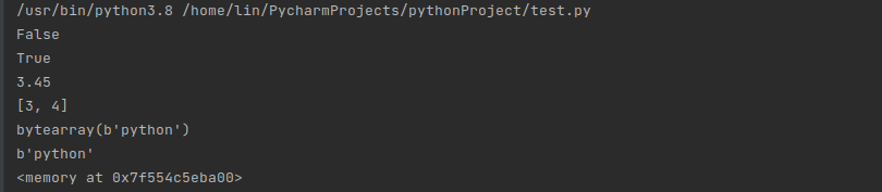

  1. int(x): If x is a number or string, the integer of x will be returned. If x is empty, 0 will be returned.
  2. float(x): If x is a number or string, the floating point number of x will be returned. If x is empty, 0 will be returned.
  3. complex(real, imag): It will return the complex form of real + imag*1j, or converts a string or number to the complex form. If the first parameter “real” is a string, the second parameter “imag” should be omitted.

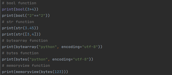

  1. bool(x): Determine parameter x is true or false, and return True or False.
  2. str(x): Convert the input x to string and return the result.
  3. bytearray(x, encoding="utf-8"): bytearray converts the input x to ordered and mutable array composed of bytes, and return the array.
  4. bytes(x, encoding="utf-8"): bytes convert the passed in parameter x to an immutable array of bytes, and return this array.
  5. memoryview(x): it returns the memory view object of the parameter x, and the memory view object allows the data that supports the buffer protocol to be packaged, and the returned object is a list of tuples.
Note: the incoming parameter x must be bytes.
  • Base Conversion
  1. bin(x): Convert the input integer x to a binary string prefixed with “0b”
  2. oct(x): Convert the input integer x to an octal string prefixed with “0o”
  3. hex(x): Convert the input integer x to a hexadecimal string prefixed with “0x”.
  4. ord(x): For the input single Unicode character, its corresponding Unicode integer will be returned.
  5. chr(x): The chr function is the inverse of the ord function, and is used to return the corresponding single Unicode character for the input integer x.
  • Numerical Operations

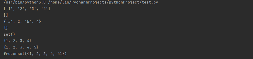

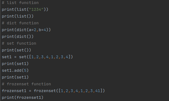

  1. list(x): list function changes the incoming parameters to a new list and returns it. In addition, the list itself is also a mutable object.
  2. dict(x): dict function changes the incoming parameter x into a new dictionary object and returns it. The dictionary object is immutable.
  3. set(x): set function is used to change the input parameter x to a new collection object and return it. The set object is mutable, and its internal elements are not repeatable.
  4. frozenset(x): frozenset function can also complete the function of the set function, but the frozenset object is immutable. Therefore it is not possible to insert values into the frozenset object.

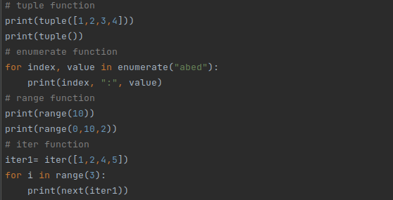

  1. tuple(x): tuple function changes the incoming parameter x into a new tuple object and returns it. The tuple object is immutable.

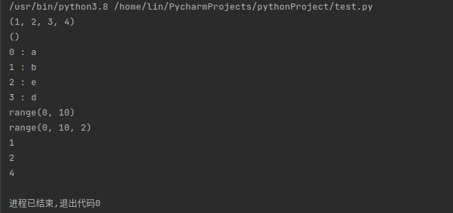

  2. enumerate(x): It returns an enumeration object, and the input parameter x is an iterable object. Through __next__(), the returned enumeration object returns a tuple containing the count value and the value in x obtained by iteration.
  3. range(x): The range function generates an immutable sequence of numbers from an input x, typically used to loop a specified number of times in a for loop
  4. iter(x): The iter function generates an iterable object based on the input parameter x and returns the iterable object.

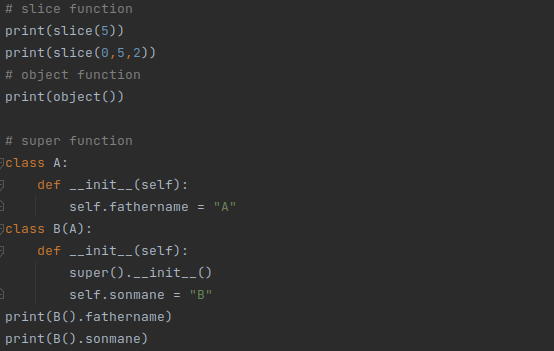

  1. slice(x): The slice function is mainly used as flexible constructed slices, and it also returns a slice object.
  2. object(): In Python, the object class is the base of all classes. The object function does not accept any parameters and returns an object without any characteristics.
  3. super(): The super function is often used in Python class objects. In the inheritance of child classes from the parent class, the child class is used to refer to the objects and methods in the parent class without explicitly specifying the name of the parent class.
  • Sorting Operation
  1. sorted(x, key=None, reverse=False): Sort the iterable object x and return a new sorted object. The key parameter can specify how to compare, and when reverse is True, it indicates sorting in descending order.
  2. reversed(seq ): Reverse the input sequence seq to generate a new iterable object and return.
  • Sequence Operation

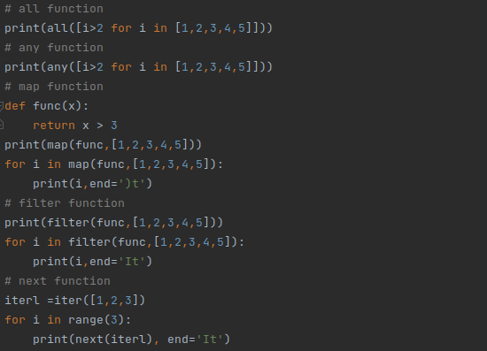

  1. all(x): Determine whether each element of the iterable object x is true, and if one element is False (0), return False.
  2. any(x): Same as the all function, the any function determines whether each element in x(iterable object) is True, and returns True as long as one element is True.
  3. map(func, iter): The map function returns an iterator in which the func function will be applied to each element in the iterable object iter
  4. filter(func, iter): Filter the element values in the iterable object iter through the func function, and return a new iterator composed of the filtered elements.
  5. next(iter): The next function returns the next element in the iterable object.
  1. zip(*iter): According to multiple different iterators, the aggregation of elements in corresponding position is performed, and a new iterator is returned.

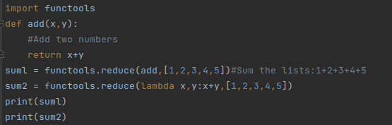

  1. reduce(func,sequence[,initial]):The two-argument function func is applied iteratively to each element in the sequence seq from left to right, and finally returns a single value as the result. It is a built-in function in Python2.x, and in Python3.x, you need to import the reduce function from functools first.
  • Object Element Operation
  1. help(object): The help function can help users to query the information of different objects, including built-in methods, properties and other information.
  2. id(object): Returns the identity value of the object, which is an integer and remains unique in the object’s life cycle.

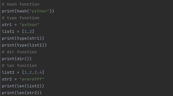

  1. hash(object): If the object has a corresponding hash value, the corresponding hash value is returned.
  2. type(object): The type function is used to return the type of the object.
  3. dir(object): If there is no argument object, the dir function returns a list of names in the current local scope. If there is an argument object, the function attempts to return a list of valid properties for that object
  4. len(object): Return the length of the object or the number of elements it contains.

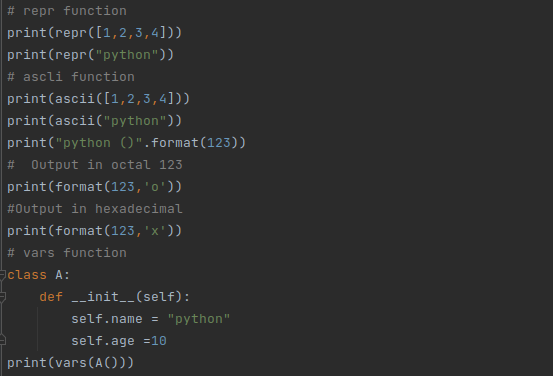

  1. repr(object): The repr function returns a string containing a printable representation of an object.
  2. ascii(object): The ascii function is similar to the repr function, the ascii function returns a string containing a printable representation of an object. However unlike the repr function, ascii() escape non-ASCII encoded characters.
  3. format(value,format_spec): format function converts value into a “formatted” representation controlled by the format_spec parameter, and is mostly used in string formatting.
  4. vars(object): The function returns objects with a _dict__ attribute, such as modules, classes, instances, etc.
  • Property Operation

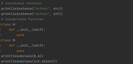

  1. isinstance(object, classinfo): The function is used to determine whether the object belongs to the type of classinfo, if it is, it returns True, otherwise it returns False
  2. issubclass(class, classinfo): If class is a child class of classinfo class, the function returns True, otherwise it returns False.

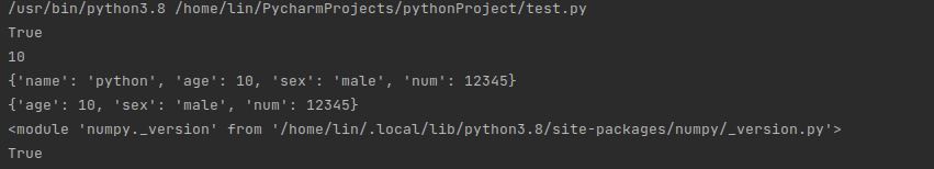

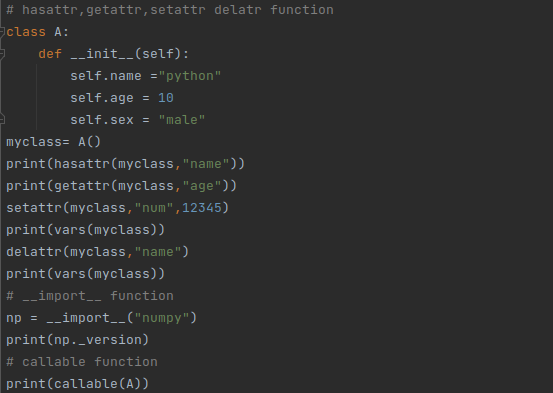

  1. hasattr(object, name): Return True if the name string is the name of one of the properties of the object object, False otherwise.
  2. getattr(object, name): Return the value of the named property of the object. name must be a string. If the string name is one of the properties of the object, the value of that property is returned.
  3. setattr(object, name, value): The string name refers to an existing property or a new property of the object. As long as the setattr operation is allowed by the object, the function will assign the value to the attribute.
  4. delattr(object, name): The string name must be the name of an property of the object. If the deleting property is allowed by object, the delattr function will delete the specified name property.
  5. **import(name)**: import modules dynamically
  6. callable(object): If object can be called, True will be returned, otherwise False.
  • Variable Operation
  1. globals(): Return a dictionary composed of global variables and their values in the scope
  2. locals(): Return a dictionary consisting of local variables and their values in the current scope.
  • Human-computer Operation

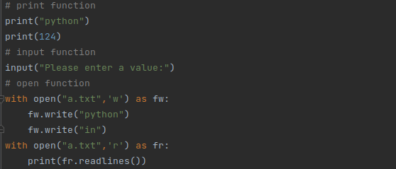

  1. print(*objects, end='\n', file=sys.stdout): Print the contents of objects to the text stream specified by file, and end with end.
  2. input(): read the value input by user
  3. open(file, mode='r'): Open the file and return the corresponding file object, mode corresponds to the operation of reading or writing to the file. If the file cannot be opened, the program will throw OSError.
  • Compilation Operation

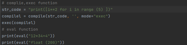

  1. compile(source,, mode): The function compiles the source into code which is then executed by the exec function or the eval function. The mode parameter indicates the mode adopted in compiling the code.
  2. exec(object): The exec function supports dynamic execution of Python code, where object must be a string or a code object. If it is a string, the string will be parsed into a Python statement to execute, and if the two u fruit is coded, it will be executed directly.
  3. eval(expression): The eval function evaluates the string expression as a valid expression and returns the result. The eval function can only evaluate a single expression, not complex code logic or assignment operation.
  • Decorator Function
  1. classmethod(): It is used to to encapsulate a method into a class method, and the method modified by the decorator can be called without creating a class object.
  2. staticmethod(): The staticmethod method is to convert the method in the class into a static method. The static method does not accept implicit parameters, and the static method can also be called without creating a class object.
  3. property(): As a decorator, property can convert class methods into class properties for use.

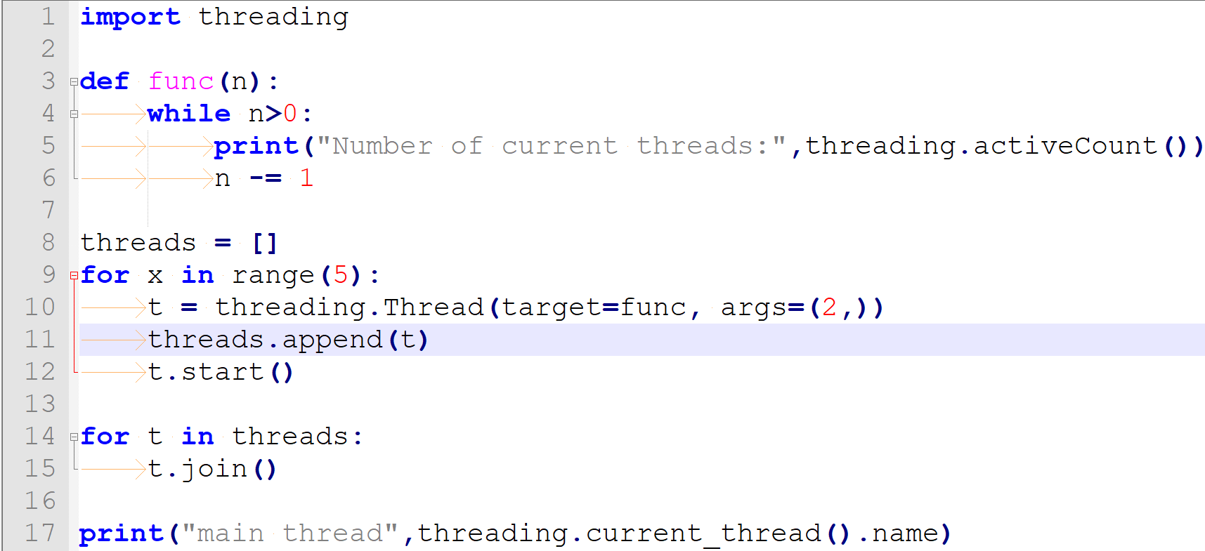

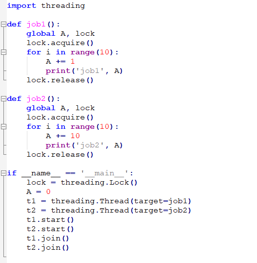

4.11 Python Multithreading
4.11.1 Process and Thread
A process is the carrier to execute the program. A process is started whenever we open software and game, and execute Python script.
A thread is the smallest unit that performs operations in a process, and an entity in a process. It also is a basic unit that is independently scheduled and dispatched by the system. For example, the production in the workshop is a process, and each assembly line is one of its threads.

4.11.5 Multithreading
Multithreading is similar to workshop production where the efficiency of production can be improved by the simultaneous operation of several assembly lines. Create Thread objects and let them run. Each Thread object represents a thread. In each thread, the programs can handle different tasks, which is multi-threaded programming.
For example, create 7 threads to execute tasks, and then call join method to wait for the thread execution to end, which is faster than a single main thread execution.

Multiple threads modifying a data together will lead to unpredictable results. In order to ensure the accuracy of data, multiple threads need to be synchronized. Simple thread synchronization can be achieved by using the Lock and Rlock of the Thread object.
  • LOCK
  1. acquire(blocking=True, timeout=-1): Puts the thread into a synchronously blocked state to acquire a lock. If the parameter blocking is set as True during calling, blocking will last until the lock is released, then lock the LOCK and return True. When the parameter blocking is set as False, no blocking will occur.
  2. release():elease the lock. The lock must be acquired before using the thread, otherwise an exception will be thrown.
release() is only called under the locked state. It changes the state to unlocked and returns immediately. A RuntimeError exception will be triggered if an attempt is made to release a non-locking lock. For the Lock object, if a thread releases twice in a row, it will cause deadlock. Therefore, Lock is not commonly used, while Rlock is generally used to set thread locks.
After execution, t1 first obtains the lock, and then releases the lock after the execution ends. t2 obtains the lock again, and continues to execute before releasing the lock, so as to avoid simultaneous processing and data errors.

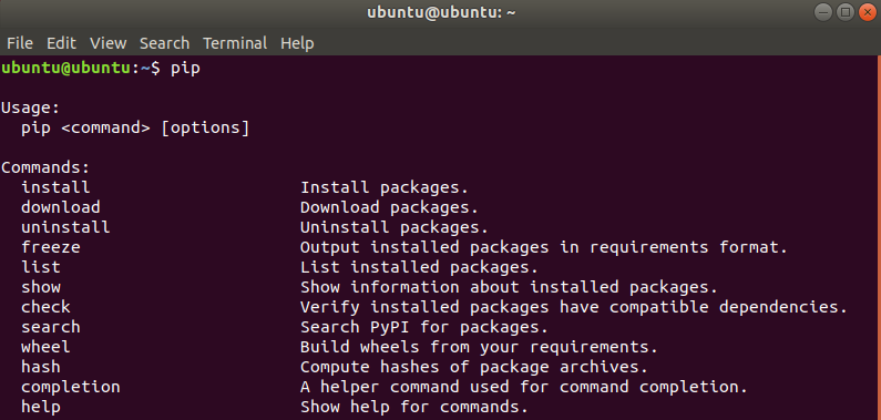

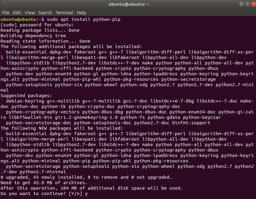

Open command line terminal, and then input “pip”. When the following message pops up, pip has been installed already.
If pip is not installed, input command “sudo apt install python-pip” to install. After the command is executed, you will be required to input the password, and then select “y” to continue installation.

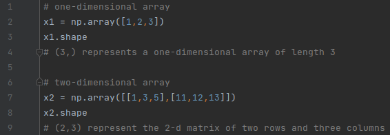

  1. In some ways, Numpy arrays are greatly similar to built-in lists in Python. It is an essential tool for Python data science.
  2. A numpy one-dimensional array can be considered as a vector, and a two-dimensional array is a data frame (precisely corresponding to the matrix in R).
  3. The biggest difference between numpy arrays and lists in python is that the type of the data contained in the former should be the same, but there is no restriction on the latter.
4.13.2 Numpy Importing

4.13.3 Create Array
  1. np.array(): Create directly
  • Take Fixed Value
  1. np.zeros(n, dtype=int): Create a one-dimensional array of integers of length n and all zeros
  2. np.ones((a,b), dtype=float): Create a two-dimensional floating-point array with “a” row and “b” column, and all 1.
  3. np.full((a,b),x, dtype=int/float): Create a two-dimensional array with “a” row and “b” column, and all x.

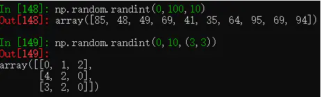

  1. np.random.randint(): Random integer
  1. np.random.random(10): A one-dimensional array with a length of 10 and distributed uniformly from 0 to 1.
  2. np.random.normal(0, 1, c(2,3)): A two-dimensional array normally distributed with two rows and three columns, a mean of 0 and a standard deviation of 1.

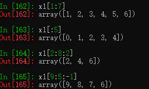

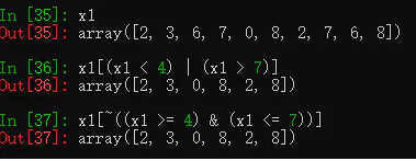

  • Slice Takes Subset

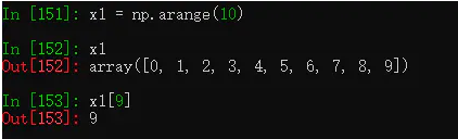

  1. For the one-dimensional array x1 of the length of 10, x1[0:5] represents the subset from index0 to index4, and the step size is 1 by default.
  2. When a of [a:b:c] is 0, a can be omitted. When both a and b are omitted, it represents the complete set.
  3. When the step size is negative, it represents take subset in reversed order.

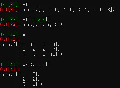

  • Multiple Index of the List Take Subset
Take the subset in sequence according to the index.
  • Logical Boolean Takes Subset

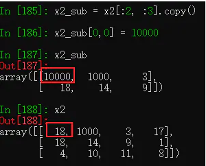

  • Create Unrelated Subset Replicas
copy() can create unrelated subset replicas

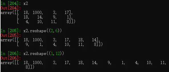

4.13.5 Array Dimension Transforming
  1. Transpose matrix with T():Transform row and column
  1. Transform dimension with reshaple(): transform the dimension according to your desire.

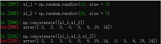

  1. concatenate(): Connect two one-dimensional array or merge two two-dimensional arrays according to row and column.

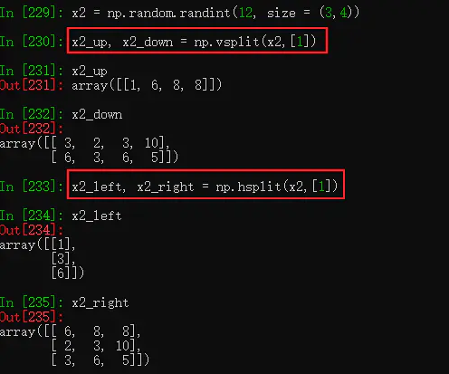

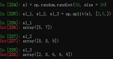

  • Split Array
  1. split(): Split one-dimensional array. Where to split will be designated by the index of the parameter. When the function returns multiple objects, we need to set the corresponding numbers of object names in front of the equal sign. When the function result returns multiple objects, set the corresponding number of object names before the equal sign
  1. vsplit(): Split a two-dimensional array horizontally. And hsplit() splits a two-dimensional array vertically.
