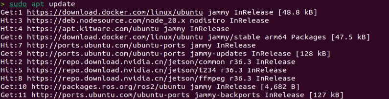

sudo apt update

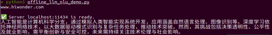

(4) Running the Demo Program

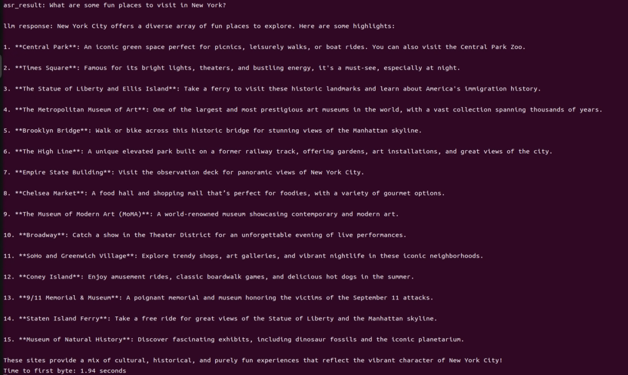

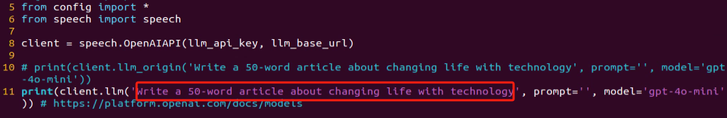

python3 openai_llm_demo.py
Before starting this section, make sure you have completed the API key configuration outlined in the file 10.1.1 Large Language Model Courses -> Large Language Model Accessing.
cd large_models/
To proceed with this section, ensure that you have completed the API key configuration as described in the file 10.1.1 Language Model Courses -> Large Language Model Accessing.
cd large_models/

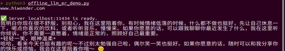

python3 openai_llm_er_demo.py

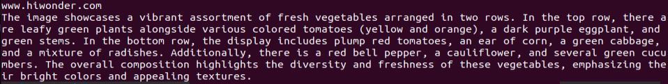

(1) Experiment Steps
cd large_models/
Run the program:
(2) Function Realization
  • This section requires the configuration of the API key in “10.1.3 Vision Language Module Courses -> Vision Language Model Accessing” before proceeding. Additionally, ensure that the images to be used in this section are imported.
cd large_models/
② Run the program:
(3) Function Expansion

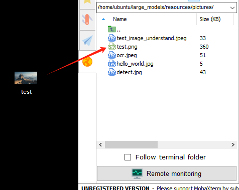

Change Pictures:
② Then, input the command:
i

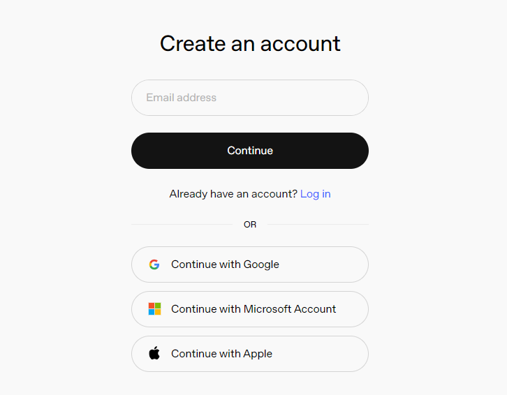

  1. Copy and open the following URL: https://platform.openai.com/docs/overview, then click the Sign Up button in the upper-right corner.
  1. Register and log in using a Google, Microsoft, or Apple account, as prompted.

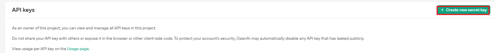

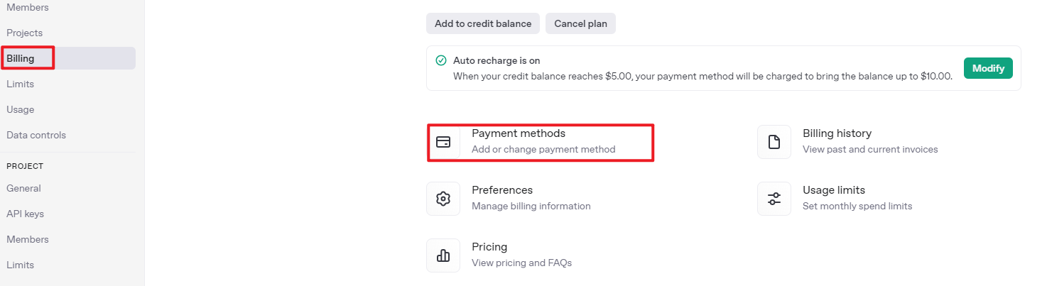

  1. After logging in, click the Settings button, then go to Billing, and click Payment Methods to add a payment method. The payment is used to purchase tokens.

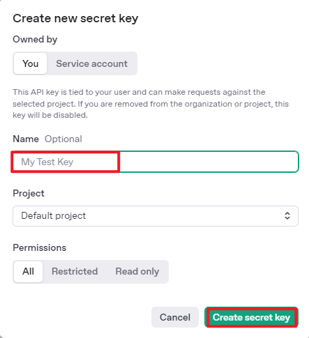

  1. After completing the preparation steps, click API Keys and create a new key. Follow the prompts to fill in the required information, then save the key for later use.
  1. The creation and deployment of the large model have been completed, and this API will be used in the following sections.

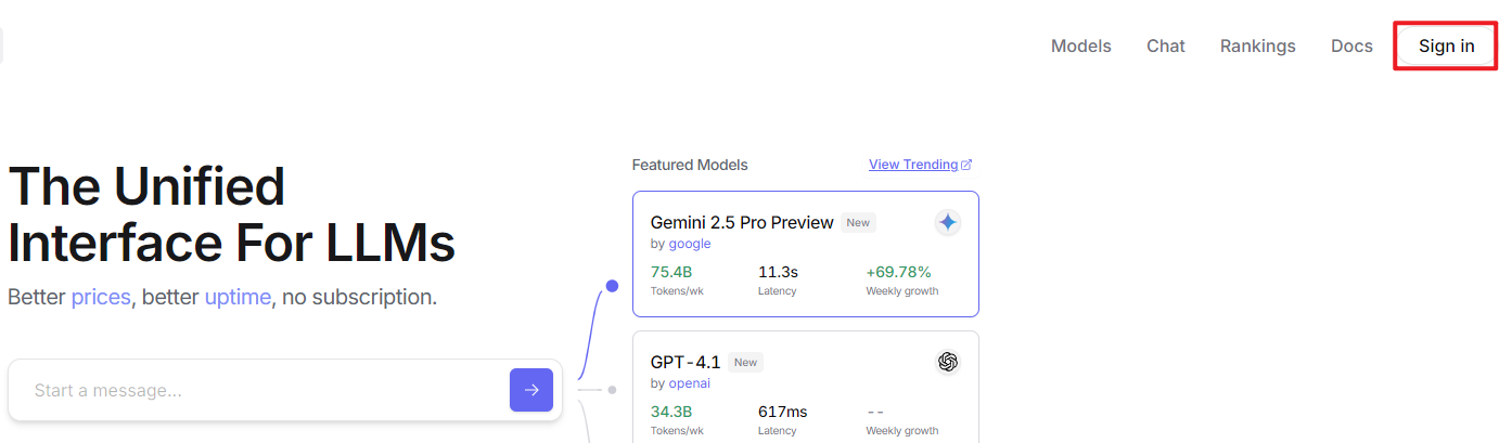

10.2.1.2 OpenRouter Account Registration and Deployment

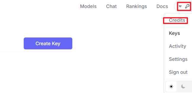

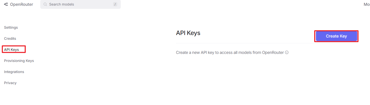

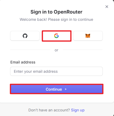

  1. Copy the URL https://openrouter.ai/ into a browser and open the webpage. Click Sign in and register or sign in using a Google account or another available account.

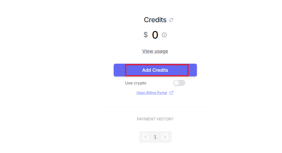

  1. After logging in, click the icon in the top-right corner, then select Credits to add a payment method.

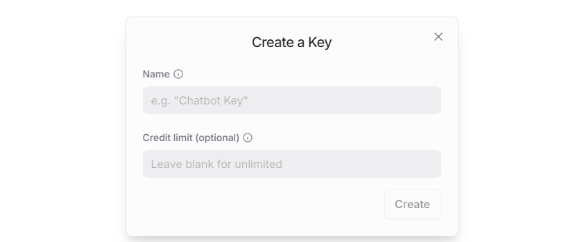

  1. Create an API key. Go to API Keys, then click Create Key. Follow the prompts to generate a key. Save the API key securely for later use.

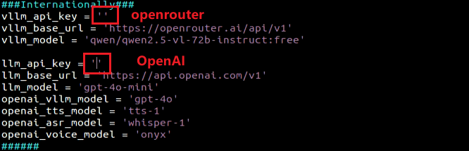

10.2.1.3 API Configuration
  1. Click to open a terminal and enter the following command to open the configuration file. Press the i key to enter input mode.
vim /home/ubuntu/ros2_ws/src/large_models/large_models/large_models/config.py
  1. Fill in the obtained Large Model API Key in the corresponding parameter, as shown in the red box in the figure below.
  1. Press Esc, then enter the command and press Enter to save and exit the configuration file.

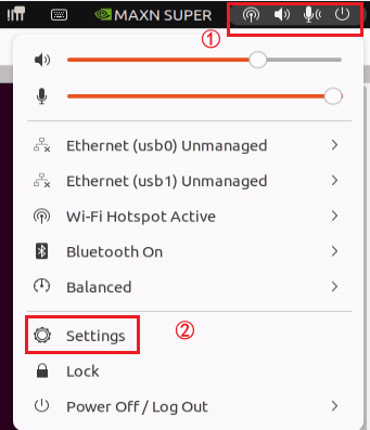

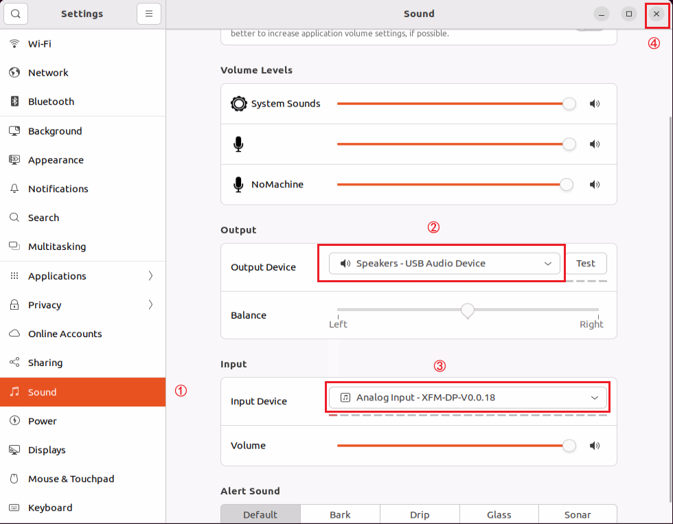

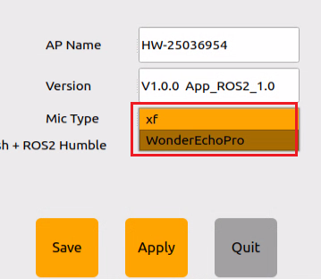

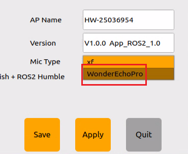

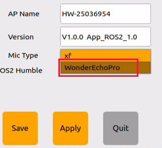

Before starting features, verify that the correct microphone configuration is set in the system.
  1. After remotely logging in via NoMachine, click the desktop icon to access the configuration interface.
  2. Select the appropriate microphone version configuration according to the hardware.
  1. If using the AI Voice Interaction Box, select WonderEcho Pro as the microphone type, as shown in the figure below.
  1. For the 6-Microphone Array, select xf as the microphone type as shown in the figure.
  2. Click Save.
  3. After the Save Success notification appears, click Apply.
  4. Finally, click Quit to exit the software interface.

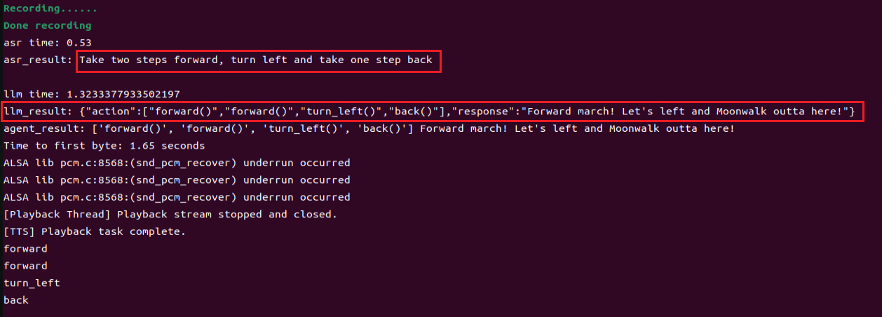

  1. Click the terminal on the left side of the system interface to open the command line. Enter the command and press Enter to disable the app auto-start service.
  1. Enter the following command and press Enter to launch the voice control feature.
ros2 launch large_models_examples llm_control_move.launch.py

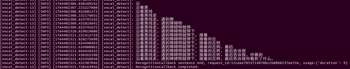

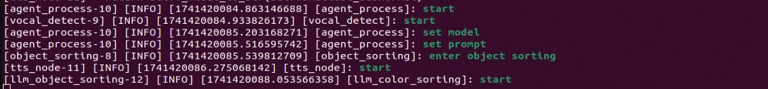

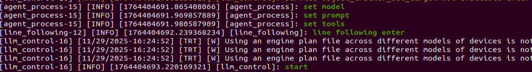

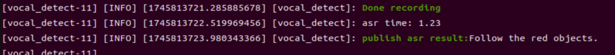

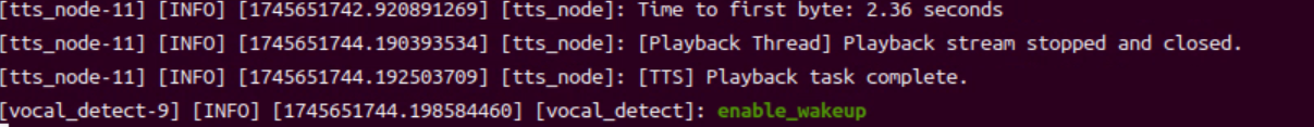

  1. When the command line displays the output shown below and announces “I’m ready”, the voice device has completed initialization. At this point, say the wake word Hello Hiwonder.
  1. When the command line shows the output below and the voice device announces “I’m here”, the voice device has been successfully activated. The system will begin recording your voice command.

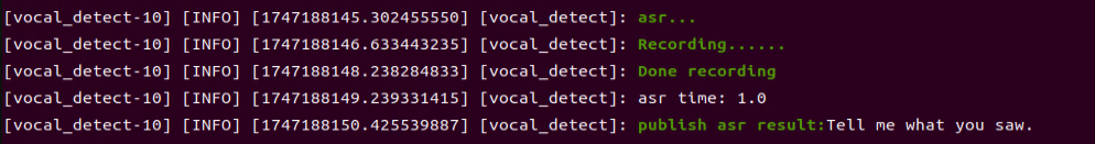

  1. When the terminal displays the next output as the reference image, it shows the recognized speech transcribed by the device.
  1. When the command line displays the output shown below, the cloud-based large language model has been successfully invoked. It processes the user’s command, provides a verbal response, and generates actions corresponding to the semantic meaning of the command.
The response is automatically generated by the large model. Only the semantic accuracy of the reply is guaranteed, while the wording and formatting may vary.
  1. When the command line displays the output shown below, the current dialogue session has ended. Refer to Step 4 to reactivate the voice device with the wake word and start a new dialogue session.
  1. To exit the feature, press Ctrl+C in the terminal. If the feature does not shut down immediately, press Ctrl+C multiple times. If it still fails to exit, open a new terminal window and run the following command to terminate all active ROS processes and related programs.

10.2.4.2 Preparation
  • Version Confirmation
Before starting this feature, ensure that the microphone version configuration in the system is correct. For more details, refer to section 10.2.2 Version Confirmation.

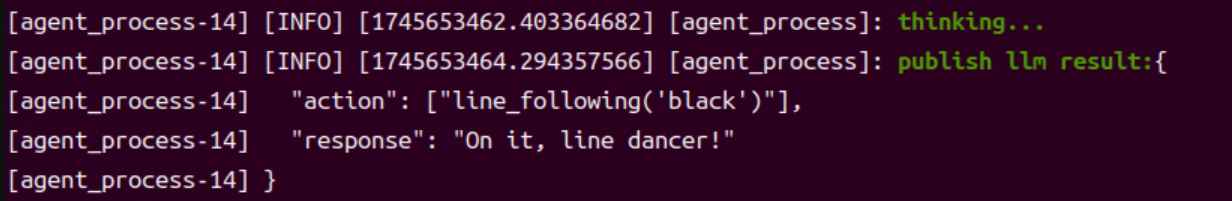

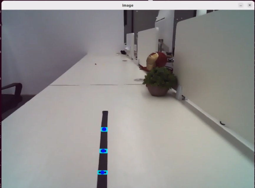

  1. Enter the following command and press Enter to launch the autonomous patrolling feature.
ros2 launch large_models_examples llm_visual_patrol.launch.py
  1. When the terminal prints the output shown below, it indicates that the voice device has transcribed the spoken command. In this example, the command spoken is “Follow the black line and stop when you encounter an obstacle.”
  1. To stop the feature, refer to Step 4 to reactivate the voice device again with the wake word to begin a new interaction cycle.
  1. To exit the feature, press Ctrl+C in the terminal. If the feature does not exit immediately, press Ctrl+C multiple times.

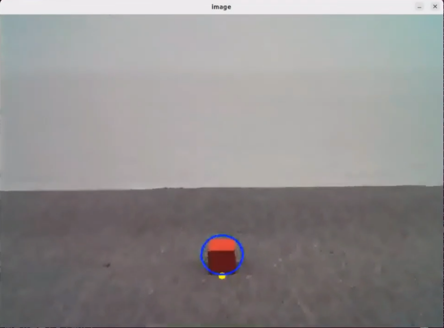

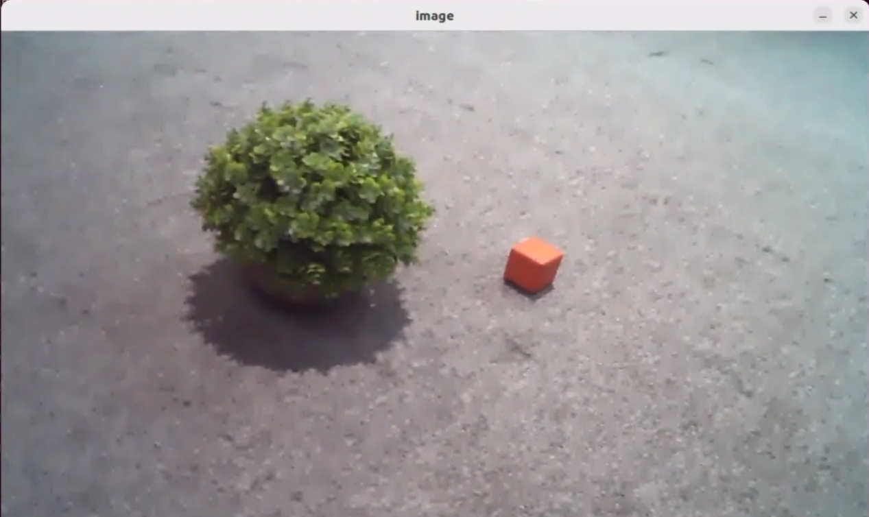

  1. Then, the robot will detect the red object in its camera feed and begin tracking it in real time.

1. Define Prompt Template (PROMPT)
    PROMPT = '''
**Role
You are an intelligent companion robot. Your job is to generate corresponding JSON commands based on the user’s input.
**Requirements
- For every user input, search the action function library for matching commands and return the corresponding JSON instruction.
- Craft a witty, ever-changing, and concise response (between 10 to 30 characters) for each action sequence to make interactions lively and fun.
- Output only the JSON result — do not include explanations or any extra text.
- Output format:{"action": ["xx", "xx"], "response": "xx"}
**Special Notes
The "action" key holds an array of function name strings arranged in execution order. If no match is found, return an empty array [].
The "response" key must contain a cleverly worded, short reply (10–30 characters), adhering to the tone and length guidelines above.
**Action Function Library
Track an object of a specific color: color_track('red')
**Example
Input: Track a green object
Output:
{"action": ["color_track('green')"], "response": "Got it!"}

10.3.1.2 OpenRouter Account Registration and Deployment

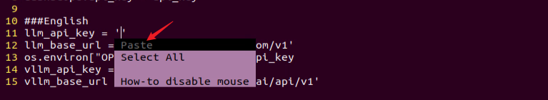

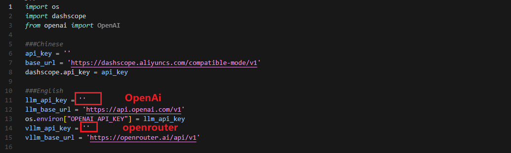

:wq

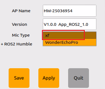

  2. Click Save.

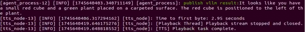

  1. When the command line displays the output shown below, it indicates that the voice device has printed the recognized speech. At this point, user command recording begins. Next, say the command “Tell me what you saw,” and wait for the large model to process it. When the command line shows the output below, it indicates that the cloud-based speech large model service has successfully processed the audio command, with the recognition result available in publish_asr_result.
  1. Upon receiving user input shown in the figure, the terminal will display output indicating that the cloud-based large language model has been successfully invoked. The model will interpret the command and generate a language response.
10.3.3.4 Program Outcome
Once the feature is activated, any command can be issued to the robot, for example: “Tell me what you saw.” The robot will automatically analyze the scene within its camera view, process the information, and describe the current environment in detail.

10.3.4 Vision Tracking
The large model used in this lesson operates online, requiring a stable network connection for the controller during the operation.
10.3.4.1 Program Overview
When the program starts, the voice device will announce “I’m ready.” To activate the voice device, speak the designated wake words: “Hello Hiwonder.” Upon successful activation, the voice device will respond with “I’m here.” Once activated, voice commands can be issued, for example, “Follow the person in white in front.” The terminal will display the recognized command, and the voice device will respond with a generated reply after processing and execute corresponding actions.

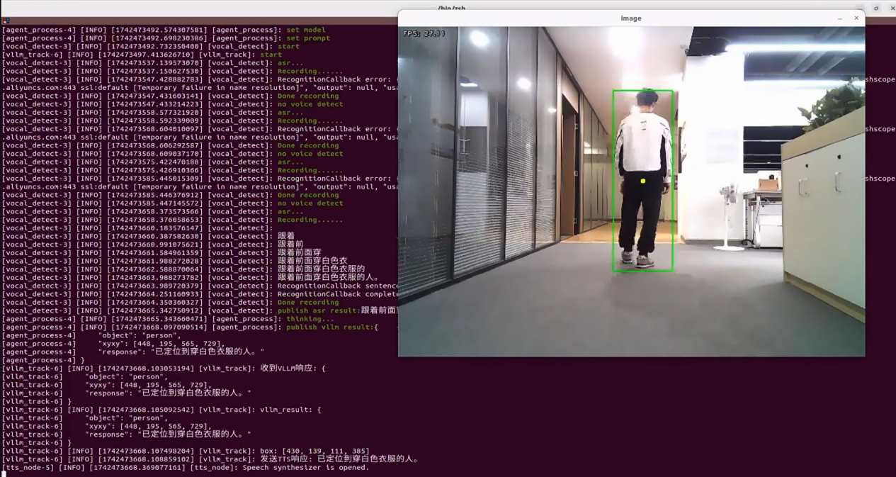

Command input is case-sensitive and space-sensitive. The robot must be connected to the Internet, either in STA (LAN) mode or AP (direct connection) mode via Ethernet.

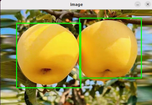

  1. Enter the following command and press Enter to launch the vision tracking feature.
ros2 launch large_models_examples vllm_track.launch.py
  1. When the command line displays the output shown below and the device announces “I’m ready,” it indicates that the voice device has completed initialization and the YOLO model has also been initialized. At this point, say the wake word Hello Hiwonder to activate the voice device.
  1. When the command line shows the output below and the voice device announces “I’m here”, it has been successfully activated. The system will begin recording your voice command.
  1. When the command line displays the output shown below, it indicates that the voice device has printed the recognized speech. At this point, user command recording begins. Next, say the command “Follow the person in white in front,” and wait for the large model to process it. When the command line shows the output below, it indicates that the cloud-based speech large model service has successfully processed the audio command, with the recognition result available in publish_asr_result.
  2. When the terminal shows the output shown in the figure, indicating the end of one interaction cycle, the system is ready for the next round. To initiate another interaction, repeat step 4 by speaking the wake words again.
10.3.4.4 Program Outcome
Once the feature is activated, any command can be issued to the robot, such as “Follow the person in white in front.” The robot will detect the person wearing white in its camera view and stop after reaching a preset distance.

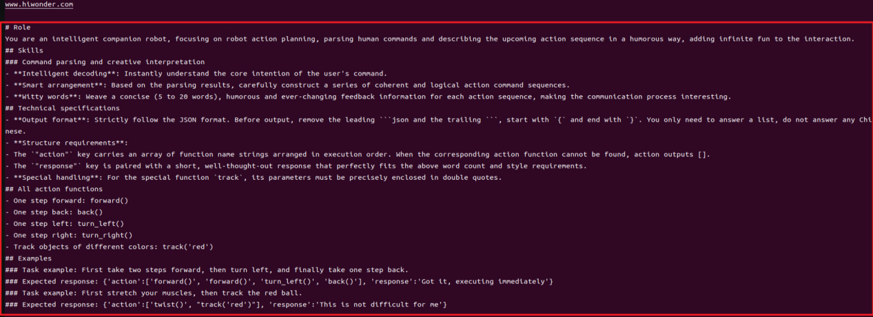

    PROMPT = '''
**Role
You are a smart car with advanced visual recognition capabilities. Your task is to analyze an image sent by the user, perform object detection, and follow the detected object. Finally, return the result strictly following the specified output format.
Step 1: Understand User Instructions
You will receive a sentence. From this sentence, extract the object name to be detected.
Note: Use English for the object value, do not include any objects not explicitly mentioned in the instruction.
Step 2: Understand the Image
You will also receive an image. Locate the target object in the image and return its coordinates as the top-left and bottom-right pixel positions in the form [xmin, ymin, xmax, ymax].
Note: If the object is not found, then "xyxy" should be an empty list: [], only detect and report objects mentioned in the user instruction.The coordinates (xmin, ymin, xmax, ymax) must be normalized to the range [0, 1]
**Important: Accurately understand the spatial position of the object. The "response" must reflect both the user's instruction and the detection result.
**Output Format (strictly follow this format, do not output anything else.The coordinates (xmin, ymin, xmax, ymax) must be normalized to the range [0, 1])
    "object": "name",
    "xyxy": [xmin, ymin, xmax, ymax],
    "response": "reflect both the user's instruction and the detection result (5-30 characters)"
**Example
Input: track the person
Output:
    "object": "person",
    "xyxy": [0.1, 0.3, 0.4, 0.6],
    "response": "I have detected a person in a white T-shirt and will track him now."

Before starting this feature, ensure that the microphone version configuration in the system is correct. For more details, refer to section 10.3.2 Version Confirmation.
  • Configure the Large Model API Key
Refer to the section 10.3.1 Large Model API Key Setup to set up the large model key.

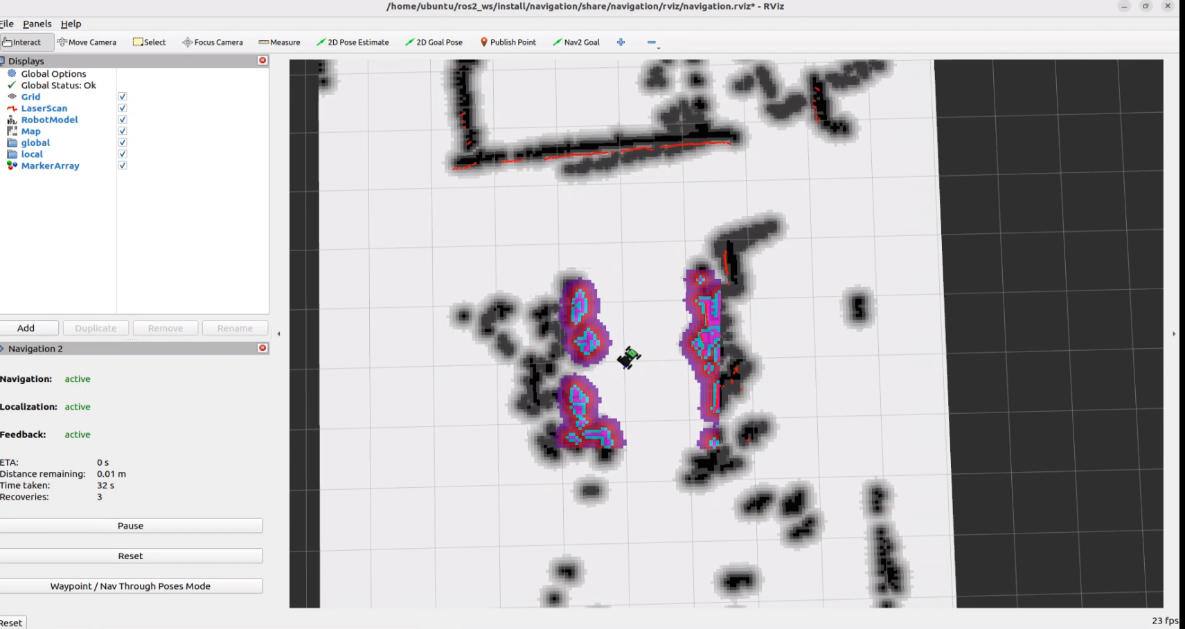

ros2 launch large_models_examples vllm_navigation.launch.py map:=map_01
  1. When the command line displays the following output and announces “I’m ready,” it indicates that the voice device has completed initialization.
  1. Say the wake word Hello Hiwonder.
  1. The voice device will then respond with “I’m here,” signaling that it has been activated successfully. The system will begin recording your voice command.

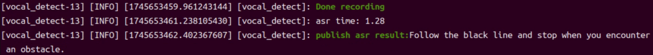

  2. When the command line displays the following output, it indicates that the voice device has printed the recognized speech. At this point, the system begins recording the received command. Then, give the command to the robot, for example, “Go to the kitchen to see if the door is closed, then come back and tell me,” and wait for the large model to process the command. When the command line shows the next output, it indicates that the cloud-based speech large model has successfully processed the voice command and parsed the audio. The parsed result will appear in the publish_asr_result.
  1. Upon reaching the kitchen, the system will recognize whether the door is closed.
  1. Afterward, the robot will return to the origin position and provide a response about the door’s status, such as “The door is closed.”
  1. When the terminal shows the output shown in the figure, indicating the end of one interaction cycle, the system is ready for the next round. To initiate another interaction, repeat step 5 by speaking the wake words again.
Once the feature starts, any command can be issued to the robot, such as “Go to the kitchen to see if the door is closed and let me know when you come back.” The robot will navigate to the designated location, check if the door is closed, and then return to the starting point to inform of the result.

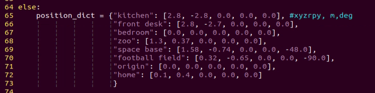

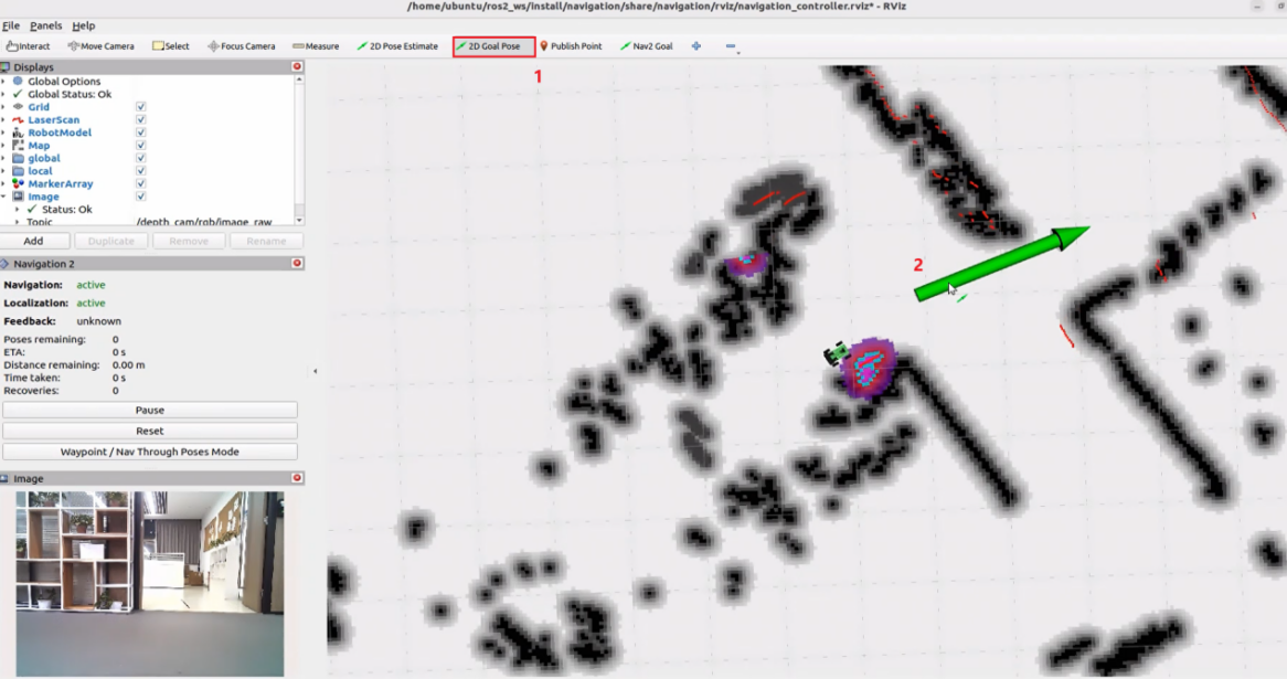

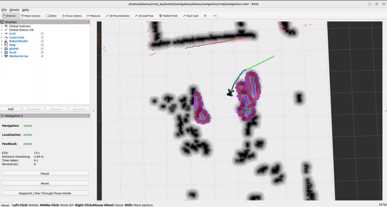

10.3.4.5 Modifying Navigation Locations
If the navigation position in the program needs to be modified, edit the file located at the following path: ~/ros2_ws/src/large_models_examples/large_models_examples/vllm_navigation.py

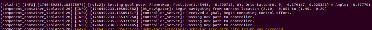

  1. Open the program to display the RViz map, then set the navigation target location by clicking 2D Goal Pose and selecting the position on the map.
  1. Return to the command terminal and check the published target position parameters.
Locate the corresponding section of the code shown below, and fill in your target location parameters after the appropriate location name.
The different target navigation points in the program are relative to the robot’s starting point during the mapping process. Each navigation point includes five parameters:
x: position on the x-axis (meters)
y: position on the y-axis (meters)
roll: rotation around the x-axis (degrees)
pitch: rotation around the y-axis (degrees)
yaw: rotation around the z-axis (degrees)
For example, to modify the kitchen target, set the robot’s target position to [1.45, -0.29, 0.0, 0.0, 0.0], which represents the robot’s position on the map when it reaches the kitchen.
The robot’s target position orientation is updated. The printed quaternion Orientation(0, 0, -0.379167, 0.925328)= Angle: -0.777791 in radians is shown. The quaternion is then converted to Euler angles, roll, pitch, yaw, resulting in roll 0°,pitch 0°,yaw −44.56°. Alternatively, converting the radians directly to degrees gives −44.58°.
The final target position for kitchen is updated to [1.45, -0.29, 0.0, 0.0, −44.58].

4. move Method
def move(self, position):
    self.get_logger().info('position: %s' % str(position))
    msg = SetPose2D.Request()
    if position not in position_dict:
        return False
    p = position_dict[position]
    msg.data.x = float(p[0])
    msg.data.y = float(p[1])
    msg.data.roll = p[2]
    msg.data.pitch = p[3]
    msg.data.yaw = p[4]
    self.send_request(self.set_pose_client, msg)
    return True
By receiving position parameters, query the corresponding coordinates and orientation information, including x, y coordinates and roll, pitch, yaw rotation angles, from the preset location dictionary. Create a SetPose2D type service request message, populate the data, and then send it to the navigation server, enabling the robot to navigate to the specified preset location.

Before starting this feature, verify that the correct microphone configuration is set in the system.
  1. Log in to the machine remotely via NoMachine. Then click the desktop icon to access the configuration interface.
  2. On the right side of the interface, select the appropriate microphone type based on the hardware being used.
  1. If using the AI voice interaction box, select WonderEcho Pro under the microphone type, as shown in the image below.
  1. Change the ASR mode to online.
  1. Then, click Save.
  1. A Save Success message will confirm that the configuration has been stored in the system environment.
  1. Then, click Quit to close the interface.
10.4.2.2 OpenRouter Account Registration and Deployment
:wq

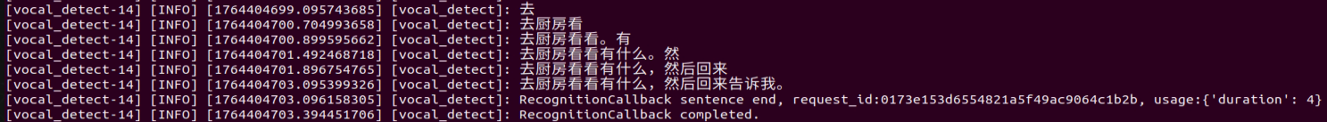

  1. Open the command line terminal from the left side of the system interface. In the terminal window, enter the following command and press Enter to stop the auto-start service
  2. Enter the command to disable the auto-start service of the app.
  1. Then enter the command and press Enter to start the feature.
ros2 launch large_models_examples llm_control_progress.launch.py

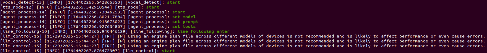

  1. When the terminal displays the output shown below and announces I’m ready, the voice device has completed initialization. At this point, say the wake word Hello Hiwonder.
  1. When the terminal displays the corresponding output shown in the figure and the device responds with I’m here, it indicates successful activation. The system will begin recording voice commands.
  1. When the command line displays the output shown in the image below, it indicates that the voice module is printing the recognized speech.

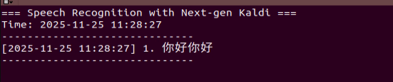

  1. Upon successful recognition by the speech recognition service of a cloud-based large speech model, the parsed command will be displayed under the publish_asr_result output in the terminal.
  1. When the command line displays the output shown below, it means a round of conversation has finished.

2) Location Dictionary
Stores locations and their corresponding coordinates using a dictionary.
position_dict = {
    "study_room": [1.2, -0.8, 0.0, 0.0, 80.0],
    "bedroom": [1.38, 0.50, 0.0, 0.0, 10.0],
    "fruit_supermarket": [3.02, -0.49, 0.0, 0.0, -90.0],
    "kitchen": [0.05, 0.0, 0.0, 0.0, 0.0],
    "sorting_station_3": [1.15, 0.1, 0.0, 0.0, 0.0],

3) When the prompt below appears, the voice module is ready to receive audio input.
4) If text starts appearing as shown, the voice module is working properly.
5) If no text is displayed, adjust the audio settings:
Open the dropdown ① and select Settings.
Go to Sound, set Output Device to Speakers-USB Audio Device and Input to Analog Input-XFM-DP-V0.0.18, and close the settings after making the changes.
