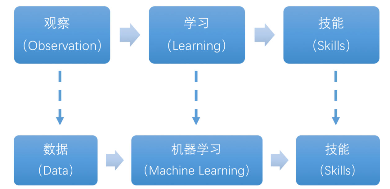

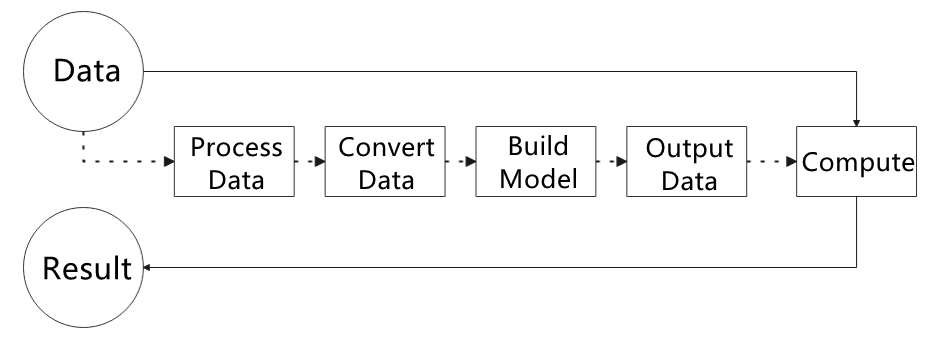

7.1.1.3 MediaPipe Usage Workflow
The figure below shows how to use MediaPipe. The solid line represents the part to be coded, and the dotted line indicates the part not to be coded. MediaPipe can offer the result and the function realization framework quickly.
  • Dependency
MediaPipe relies on OpenCV for video processing and FFMPEG for audio data processing. It also has other dependencies, such as OpenGL/Metal, TensorFlow, Eigen, and others.
It is recommended to gain a basic understanding of OpenCV before starting with MediaPipe. Information about OpenCV can be found in the folder: Basic Course / OpenCV Computer Vision Lesson.
  • MediaPipe Solutions
Solutions are based on the open-source pre-constructed sample of TensorFlow or TFLite. MediaPipe Solutions is built upon a framework, which provides 16 Solutions, including face detection, Face Mesh, iris, hand, posture, human body, and so on.

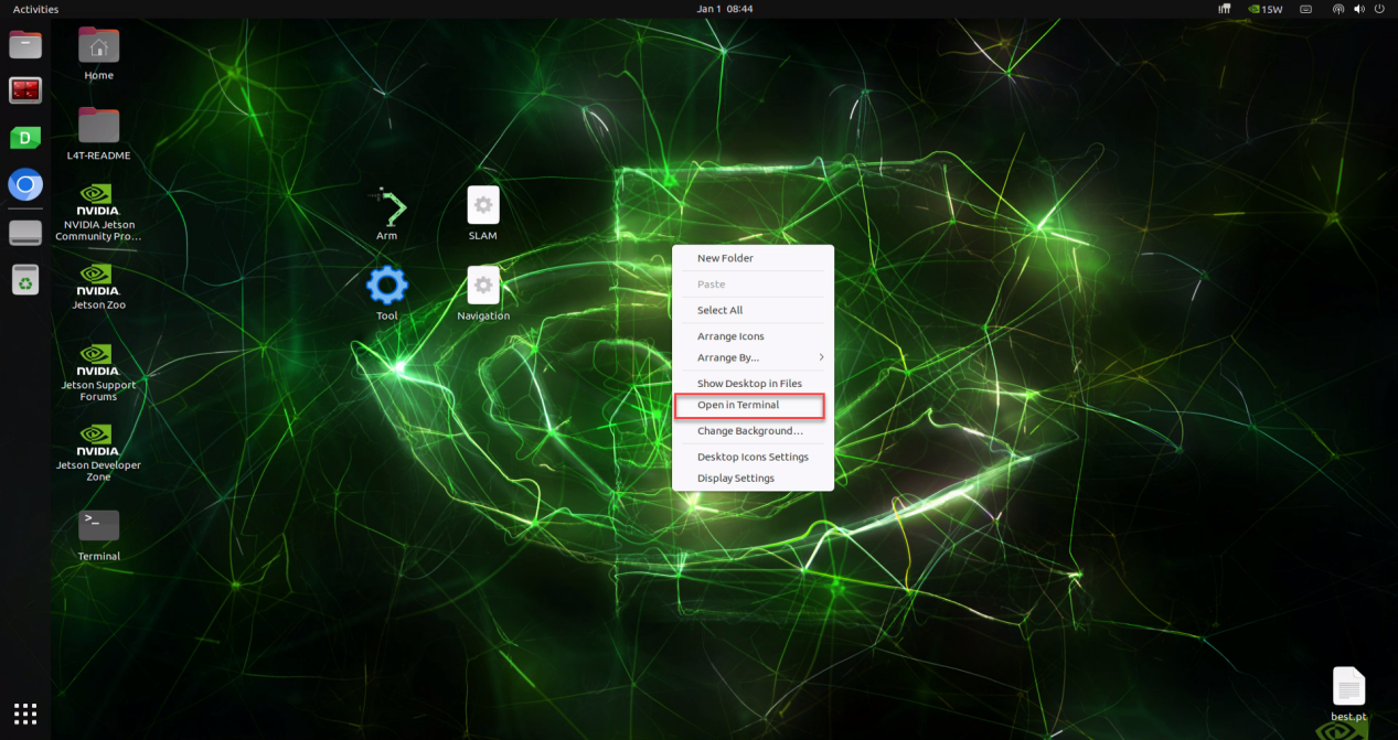

Power on the robot and connect it via the NoMachine remote control software. For detailed information, please refer to the section 1.7.2 AP Mode Connection Steps in the user manual.
  1. Click the terminal icon in the system desktop to open a command-line window.

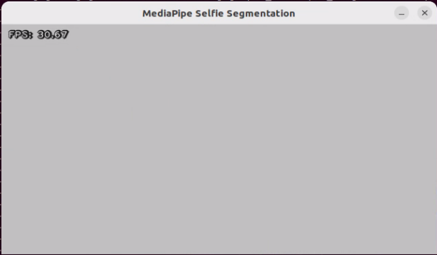

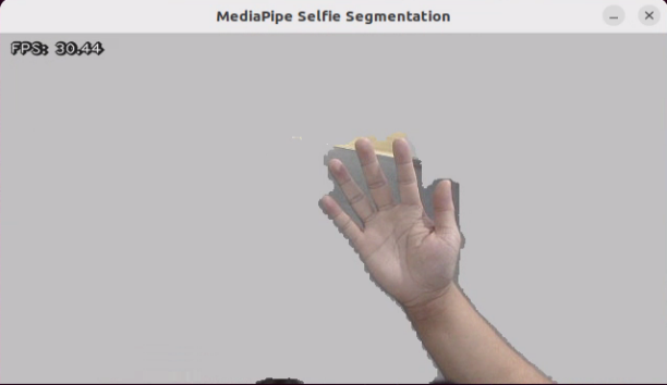

7.1.2.3 Project Outcome
After starting the feature, the entire returned image is transformed into a uniform gray virtual background. Once a real hand enters the camera’s field of view, the system immediately and accurately detects and separates the hand from the background.

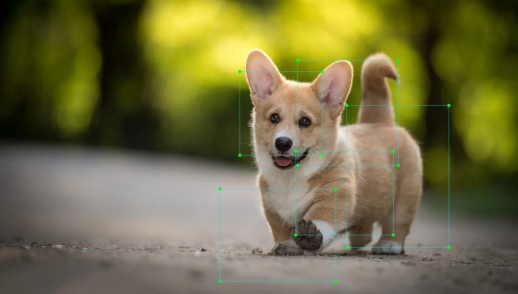

7.1.3 3D Object Detection
7.1.3.1 Experiment Overview
First, import MediaPipe’s 3D Objection and subscribe to the topic messages to obtain the real-time camera feed.
Next, apply preprocessing steps such as image flipping, and then perform 3D object detection on the images.
Finally, draw 3D bounding boxes on the detected objects in the image. In this section, a cup is used for demonstration.

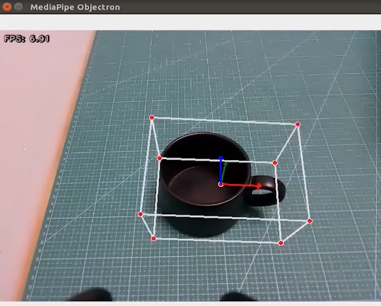

7.1.3.3 Project Outcome
Once the program starts, a 3D bounding box will appear around the detected object in the camera view. Currently, four types of objects are supported: a cup with a handle, a shoe, a chair, and a camera. For example, when detecting a cup, the effect is shown as follows:

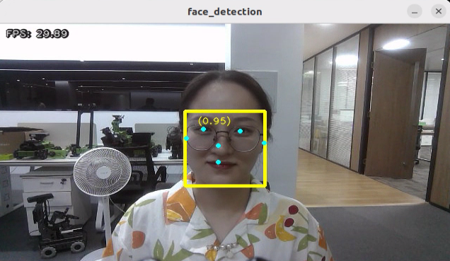

7.1.4 3D Face Detection
In this program, MediaPipe’s face detection model is utilized to detect a human face within the camera image.
MediaPipe Face Detection is a high-speed face detection solution that provides six key landmarks and supports multiple faces. Based on BlazeFace, a lightweight and efficient face detector optimized for mobile GPU inference.
7.1.4.1 Experiment Overview
First, import the MediaPipe face detection model and subscribe to the topic messages to obtain the real-time camera feed.
Next, use OpenCV to process the image, including flipping and converting the color space.
Next, the system compares the detection confidence against the model’s minimum threshold to determine if face detection is successful. Once a face is detected, the system will analyze the set of facial features. Each face is represented as a detection message that contains a bounding box and six key landmarks, including right eye, left eye, nose tip, mouth center, right ear region, and left ear region.
Finally, the face will be outlined with a bounding box, and the six key landmarks will be marked on the image.

7.1.4.3 Project Outcome
Once the feature is activated, the depth camera is immediately powered on and the face detection algorithm is executed. As soon as a face is detected, the robot accurately highlights the face region in the returned image with a prominent frame.
7.1.4.4 Program Analysis

Main:
    def main(self):
        while self.running:
            except queue.Empty:
                if not self.running:
                    continue
            image = cv2.flip(image, 1)
            detection_result = self.detector.detect(mp_image)
            annotated_image = visualize(image, detection_result)
            self.fps.update()
            result_image = self.fps.show_fps(cv2.cvtColor(annotated_image, cv2.COLOR_RGB2BGR))
            cv2.imshow('face_detection', result_image)
            key = cv2.waitKey(1)
            if key == ord('q') or key == 27:  # Press Q or Esc to quit
        cv2.destroyAllWindows()
        rclpy.shutdown()
Loads the model from MediaPipe, feeds the image into it, and uses OpenCV to draw facial keypoints and display the returned video feed.

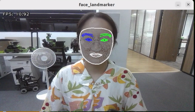

7.1.5.3 Project Outcome
Once the feature is started, the depth camera detects a face and highlights it with a bounding box in the returned video feed.
7.1.5.4 Program Analysis

Main :
    def main(self):
        while self.running:
            except queue.Empty:
                    continue
            annotated_image = draw_face_landmarks_on_image(image, detection_result)
            self.fps.update()
            cv2.imshow('face_landmarker', result_image)
        rclpy.shutdown()

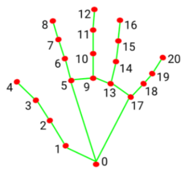

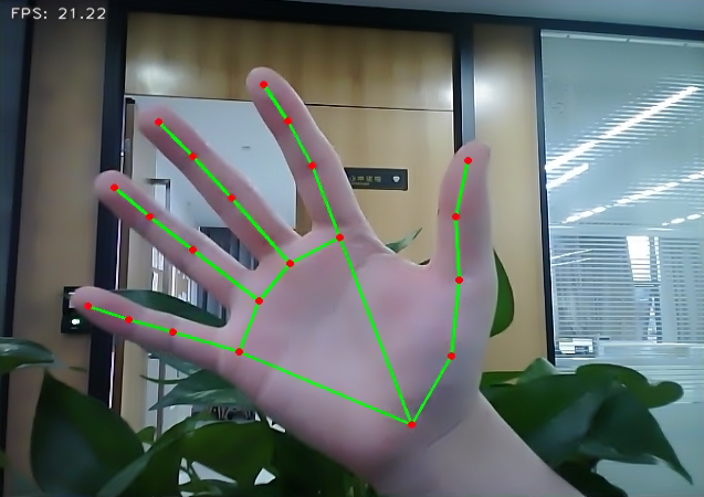

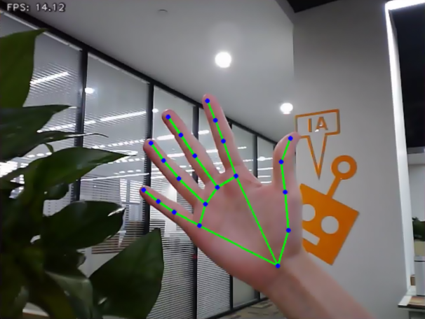

7.1.6 Hand Keypoint Detection
In this lesson, MediaPipe’s hand detection model is used to display hand keypoints and the connecting lines between them on the returned image.
MediaPipe Hands is a high-fidelity hand and finger tracking model. It uses machine learning (ML) to infer 21 3D landmarks of a hand from a single frame.
7.1.6.1 Experiment Overview
First, it’s important to understand that MediaPipe’s palm detection model utilizes a machine learning pipeline composed of multiple models, which is a linear model, similar to an assembly line. The model processes the entire image and returns an oriented hand bounding box. The hand landmark model then operates on the cropped image region defined by the palm detector and returns high-fidelity 3D hand keypoints.
After importing the hand detection model, the system subscribes to topic messages to acquire real-time camera images. The images are then processed with flipping and color space conversion, which greatly reduces the need for data augmentation for the hand landmark model.
In addition, the pipeline can generate crops based on the hand landmarks recognized in the previous frame. The palm detection model is only invoked to re-locate the hand when the landmark model can no longer detect its presence.
Next, the system compares the detection confidence against the model’s minimum threshold to determine if hand detection is successful.
Finally, it detects and draws the hand keypoints on the output image.
7.1.6.2 Operation Steps
  2. Enter the command to disable the app auto-start service.
  1. Enter the command to start the camera node:
  1. Open a new command-line terminal, enter the command, and press Enter to run the program.
cd ~/ros2_ws/src/example/example/mediapipe_example && python3 hand.py
  1. To exit this feature, press the Esc key in the image window to close the camera feed.
  2. To exit the feature, press Ctrl+C in the terminal. If the program does not close successfully, try pressing Ctrl+C again.
7.1.6.3 Project Outcome
Once the feature is activated, the depth camera is immediately powered on, and the hand detection model is triggered for hand detection. Once a hand is successfully detected, the system intelligently marks the key points of the hand in the returned image and automatically draws the connecting lines between these points.
7.1.6.4 Program Analysis
The program file of the feature is located at: /ros2_ws/src/example/example/mediapipe_example/hand.py
  • Functions
Main:
def main():
    node = HandNode('hand_landmarker')
        rclpy.spin(node)
    except KeyboardInterrupt:
        node.destroy_node()
        rclpy.shutdown()
        print('shutdown')
    finally:
        print('shutdown finish')
Used to launch the 3D face detection node.
  • Class
HandNode:
class HandNode(Node):
    def __init__(self, name):
        rclpy.init()
        super().__init__(name)
        self.running = True
        self.bridge = CvBridge()
        model_path = os.path.join(os.path.abspath(os.path.split(os.path.realpath(__file__))[0]), 'model/hand_landmarker.task')
        base_options = python.BaseOptions(model_asset_path=model_path)
        options = vision.HandLandmarkerOptions(base_options=base_options, num_hands=2)
        self.detector = vision.HandLandmarker.create_from_options(options)
        self.fps = fps.FPS()
        self.image_sub = self.create_subscription(Image, '/depth_cam/rgb0/image_raw', self.image_callback, 1)
Init:
        rclpy.init()
        self.running = True
        if self.image_queue.full():
            # If the queue is full, remove the oldest image
            self.image_queue.get()
Initializes the parameters required for hand keypoints detection, calls the image callback function, and starts the model inference function.
image_callback:
The image callback function is used to read data from the camera node and enqueue it.
Main :
    def main(self):
        while self.running:
            except queue.Empty:
                    continue
            annotated_image = draw_hand_landmarks_on_image(image, detection_result)
            self.fps.update()
            cv2.imshow('hand_landmarker', result_image)
        rclpy.shutdown()
Loads the model from MediaPipe, feeds the image into it, and uses OpenCV to draw the hand’s keypoints and display the returned video feed.

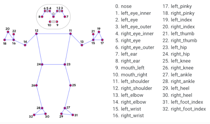

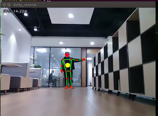

7.1.7 Body Keypoint Detection

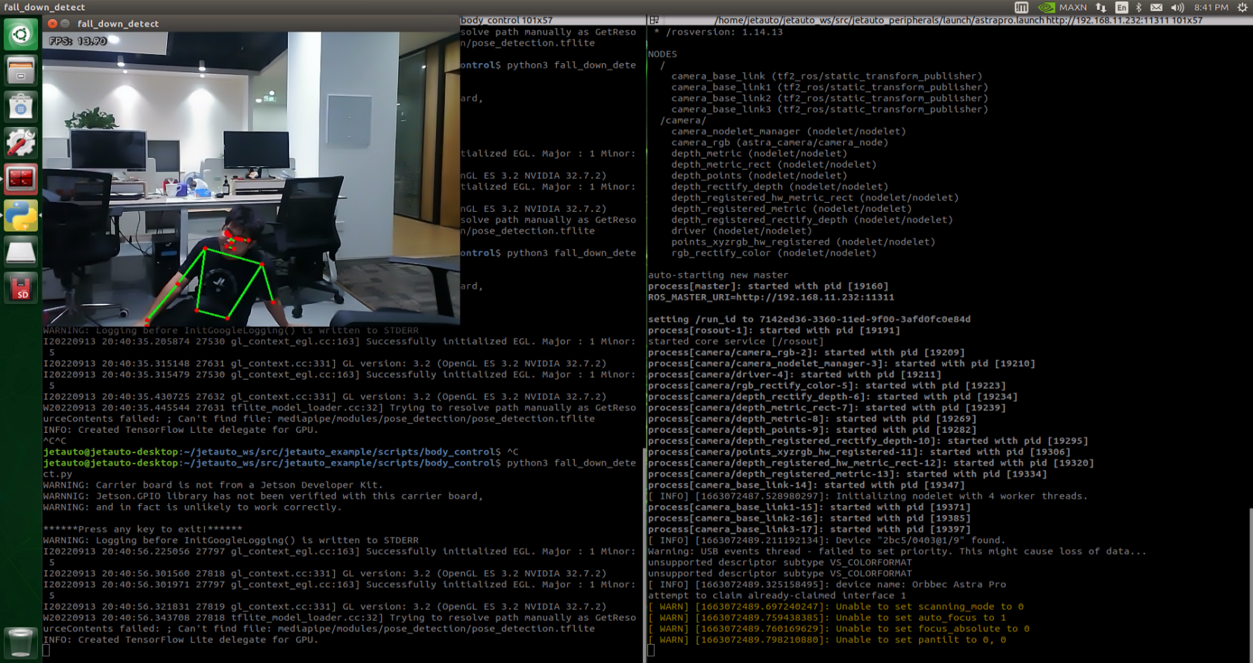

In this lesson, MediaPipe’s pose detection model is used to detect body landmarks and display them on the video feed.
MediaPipe Pose is a high-fidelity body pose tracking model. Powered by BlazePose, it infers 33 3D landmarks across the full body from RGB input. This research also supports the ML Kit Pose Detection API.
7.1.7.1 Experiment Overview
First, import the pose detection model.
Then, the program applies image preprocessing such as flipping and converting the color space. By comparing against a minimum detection confidence threshold, it determines whether the human body is successfully detected.
Next, it uses a minimum tracking confidence threshold to decide whether the detected pose can be reliably tracked. If not, the model will automatically re-invoke detection on the next input image.
The pipeline first identifies the region of interest (ROI) containing the person’s pose in the frame using a detector. The tracker then uses the cropped ROI image as input to predict pose landmarks and segmentation masks within that area. For video applications, the detector is only invoked when necessary—such as for the first frame or when the tracker fails to identify a pose from the previous frame. For all other frames, the ROI is derived from the previously tracked landmarks.
After importing the MediaPipe pose detection model, you can subscribe to the topic messages to obtain the real-time video stream from the camera.
Finally, it identifies and draws the body landmarks on the image.

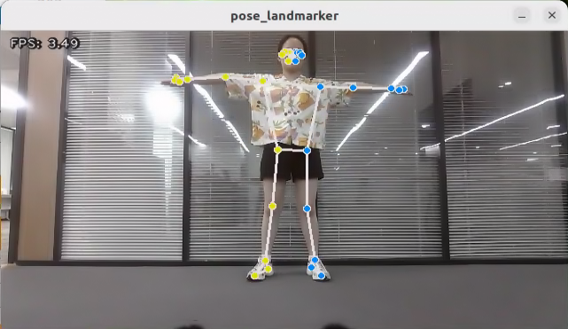

7.1.7.3 Project Outcome
Once the feature is activated, the depth camera is immediately powered on, and human pose detection is initiated. Once the human body is successfully detected, the system quickly and accurately marks the key body points in the returned image and automatically draws the connecting lines between these points, forming a human pose skeleton.
7.1.7.4 Program Analysis

7.1.8 Fingertip Trajectory Recognition
The robot uses MediaPipe’s hand detection model to recognize palm joints. Once a specific hand gesture is detected, the robot locks onto the fingertip in the image and begins tracking it, drawing the movement trajectory of the fingertip.
7.1.8.1 Experiment Overview
First, the MediaPipe hand detection model is called to process the camera feed.
Next, the image is flipped and processed to detect hand information within the frame. Based on the connections between hand landmarks, the finger angles are calculated to identify specific gestures.
Finally, once the designated gesture is recognized, the robot starts tracking and locking onto the fingertip, while displaying its movement trajectory in the video feed.
7.1.8.2 Operation Steps
cd ~/ros2_ws/src/example/example/mediapipe_example && python3 hand_gesture.py
  1. The program will launch the camera image interface. For details on the detection steps, please refer to section 7.1.8.3 Project Outcome in this document.
  2. To exit this feature, press the Esc key in the image window to close the camera feed.
  3. To exit the feature, press Ctrl+C in the terminal. If the program does not close successfully, try pressing Ctrl+C again.

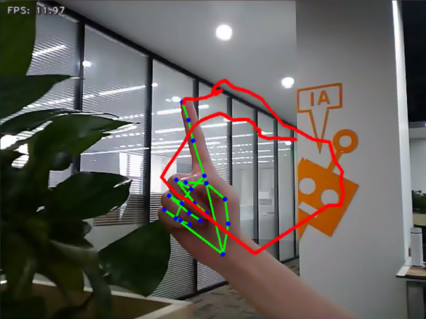

After starting the feature, place your hand within the camera’s field of view. Once the hand is detected, key points of the hand will be marked in the returned image.
If the gesture 1, which involves extending the index finger, is detected, the robot will immediately enter recording mode. The system will track and display the movement of the fingertip in real time on the returned image using dynamic lines. This feature enables free drawing in the virtual space with simple gestures.
On the other hand, if the gesture 5, which involves an open hand forming the shape of the number 5, is detected, a clear command will be triggered. At this point, the recorded fingertip movement will be immediately erased, and the image will return to a state without any trace.

get_hand_landmarks:
def get_hand_landmarks(img, landmarks):
    Convert landmarks from normalized output of Mediapipe to pixel coordinates.
    :param img: Image corresponding to pixel coordinates.
    :param landmarks: Normalized key points.
    :return:
    h, w, _ = img.shape
    landmarks = [(lm.x * w, lm.y * h) for lm in landmarks]
    return np.array(landmarks)
Converts the normalized data from MediaPipe into pixel coordinates.

After extracting the hand keypoints into the results variable, the keypoints need to undergo logical processing. By analyzing the angular relationships between the keypoints, the specific type of finger, such as the thumb or index finger, can be identified. The hand_angle function takes the landmarks of the results as input, and the vector_2d_angle function is used to calculate the angles between the corresponding keypoints. The following diagram shows the keypoints corresponding to the elements in the landmarks set:
Taking the thumb’s angle as an example: vector_2d_angle The function is used to calculate the angle between the keypoints. The keypoints, landmarks[3], landmarks[4], landmarks[0], and landmarks[2] correspond to the points 3, 4, 0, and 2 in the hand feature extraction diagram. By calculating the angles between these key joints, the posture features of the thumb can be determined. Similarly, the processing logic for the remaining finger joints follows the same approach.
To ensure accurate recognition, the parameters and basic logic of angle addition and subtraction in the hand_angle function can be kept at their default settings.

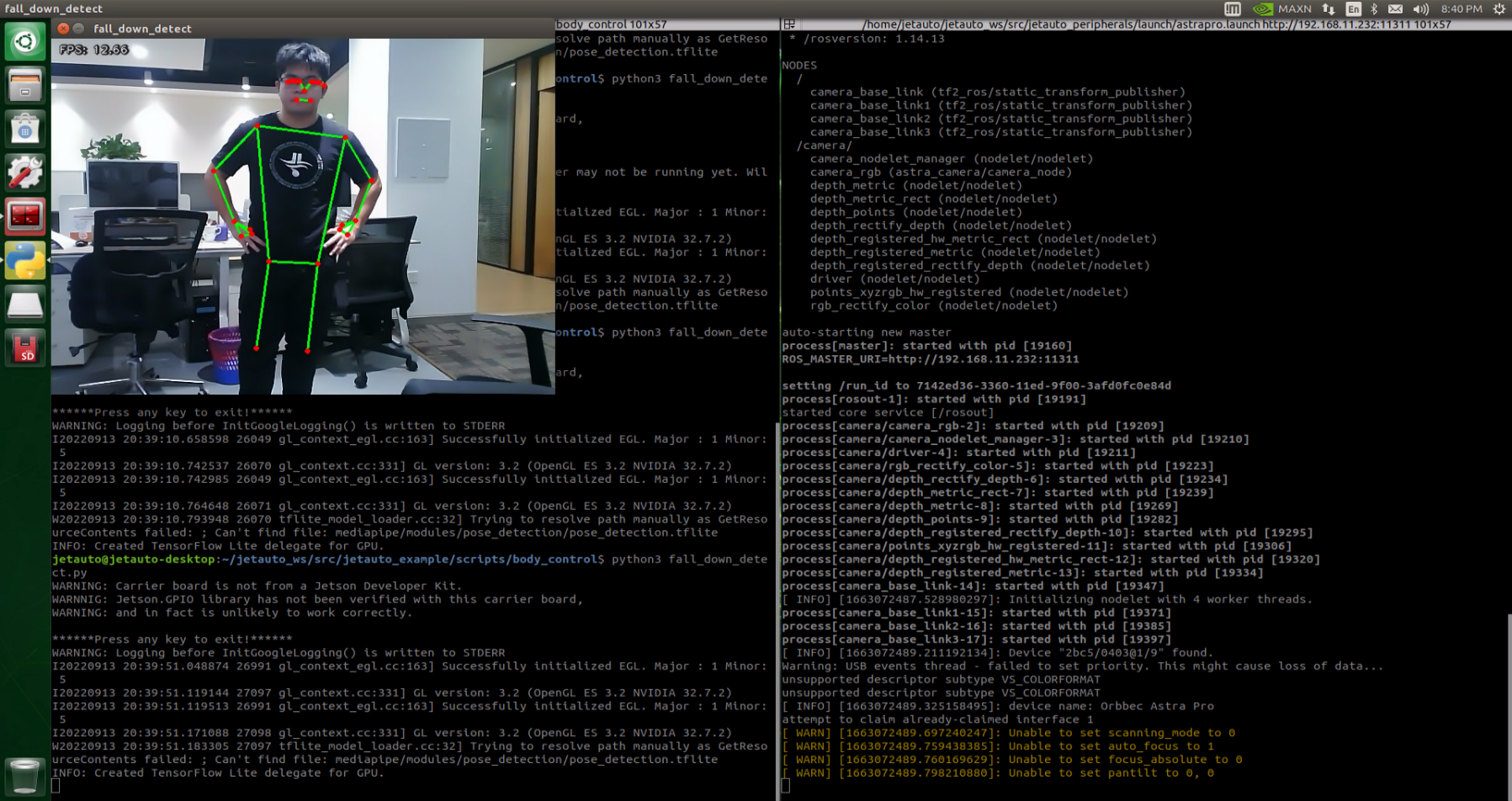

7.1.9 Body Gesture Control

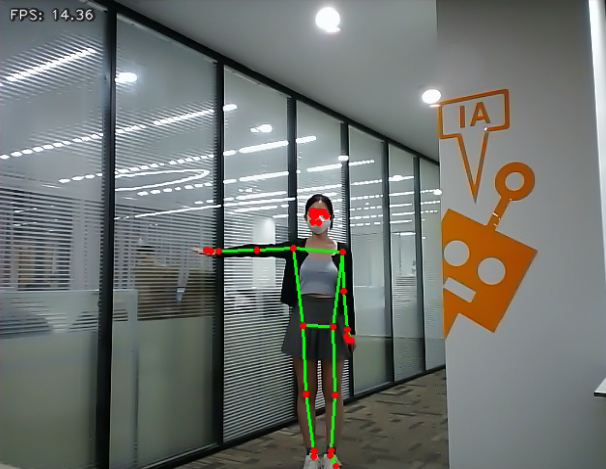

Using the human pose estimation model trained with the MediaPipe machine learning framework, the system detects the human pose in the camera feed and marks the relevant joint positions. Based on this, multiple actions can be recognized in sequence, allowing direct control of the robot through body gestures.
From the robot’s first-person perspective:
Raising the left arm causes the robot to move a certain distance to the right. Raising the right arm causes the robot to move a certain distance to the left. Raising the left leg causes the robot to move forward a certain distance. Raising the right leg causes the robot to move backward a certain distance.
7.1.9.1 Experiment Overview
First, the MediaPipe human pose estimation model is imported, and the camera feed is accessed by subscribing to the relevant topic messages.
MediaPipe is an open-source framework designed for building multimedia machine learning pipelines. It is cross-platform and can run on mobile devices, workstations, and servers, with support for mobile GPU acceleration. It also supports inference engines for TensorFlow and TensorFlow Lite.
Next, using the constructed model, key points of the human torso are detected in the camera feed. These key points are connected to visualize the torso, allowing the system to determine the body posture.
Finally, if the user performs a specific action, the robot responds accordingly.
7.1.9.2 Operation Steps
  1. Enter the following command and press Enter to start the feature.
ros2 launch example body_control.launch.py

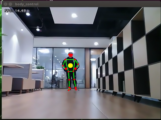

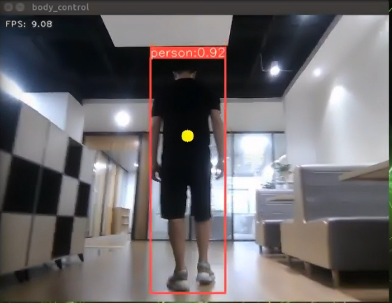

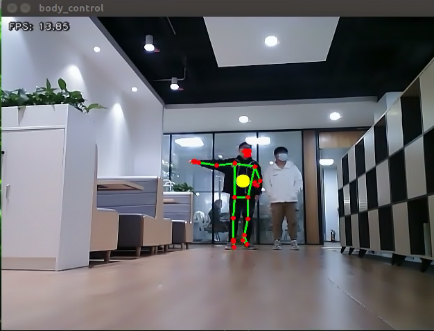

7.1.9.3 Project Outcome
After starting the feature, stand within the camera’s field of view. When a human body is detected, the returned video feed will display the key points of the torso along with lines connecting them.
An intuitive body posture control logic has been designed for the robot, allowing control through simple body movements. The control instructions are as follows:
Right movement: Raise the left arm, and the robot will move to the right.
Left movement: Raise the right arm, and the robot will move to the left.
Forward movement: Raise the left leg, and the robot will move forward.
Backward movement: Raise the right leg, and the robot will move backward.

get_joint_landmarks:
def get_joint_landmarks(img, landmarks):
    Convert landmarks from medipipe's normalized output to pixel coordinates
    :param img: Picture corresponding to pixel coordinate
    :param landmarks: Normalized keypoint
    :return:
    h, w, _ = img.shape
Converts the detected information into pixel coordinates.
joint_distance:
def joint_distance(landmarks):
    distance_list = []
    d1 = landmarks[LEFT_HIP] - landmarks[LEFT_SHOULDER]
    d2 = landmarks[LEFT_HIP] - landmarks[LEFT_WRIST]
    dis1 = d1[0]**2 + d1[1]**2
    dis2 = d2[0]**2 + d2[1]**2
    distance_list.append(round(dis1/dis2, 1))
    d1 = landmarks[RIGHT_HIP] - landmarks[RIGHT_SHOULDER]
    d2 = landmarks[RIGHT_HIP] - landmarks[RIGHT_WRIST]
    d1 = landmarks[LEFT_HIP] - landmarks[LEFT_ANKLE]
    d2 = landmarks[LEFT_ANKLE] - landmarks[LEFT_KNEE]
    d1 = landmarks[RIGHT_HIP] - landmarks[RIGHT_ANKLE]
    d2 = landmarks[RIGHT_ANKLE] - landmarks[RIGHT_KNEE]
    return distance_list
Calculates the distances between joints based on pixel coordinates.

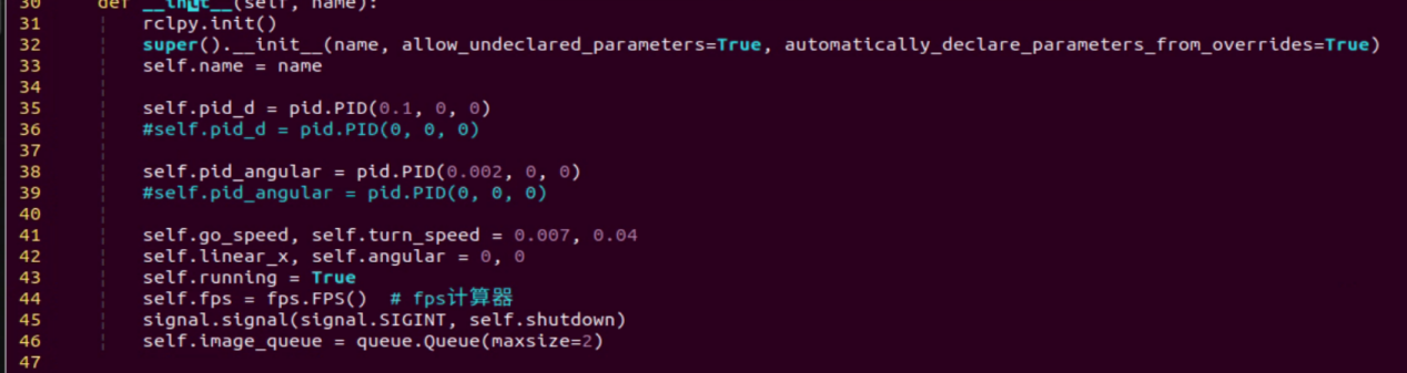

class BodyControlNode(Node):
        rclpy.init()
        self.name = name
        self.body_detector = mp_pose.Pose(
            static_image_mode=False,
            min_tracking_confidence=0.7,
            min_detection_confidence=0.7)
        self.running = True
        self.fps = fps.FPS()  # FPS calculator
        self.move_finish = True
        self.stop_flag = False
        self.left_hand_count = []
        self.right_hand_count = []
        self.left_leg_count = []
        self.right_leg_count = []
This class represents the body control node.

7.1.10 Human Tracking
This feature is intended for indoor use, as outdoor environments can significantly interfere with its performance. The monocular camera version does not support this feature yet.
Human detection is enabled through a pose estimation model trained using the YOLOv11 framework. The center point of the human body will be marked in the live feed. When the human gets closer, the robot will move backward. When the human moves away, the robot will move forward, maintaining a distance of approximately 3 meters between the human and the robot.
7.1.10.1 Experiment Overview
First, import the YOLOv11 human pose estimation model and subscribe to the topic to receive real-time camera feed.
Next, using the trained model, detect the keypoints of the human body in the frame and calculate the coordinates of the human’s center point based on these keypoints.
Finally, update the PID controller based on the coordinates of the human’s center point and the frame’s center point, allowing the robot to move in response to the human’s movement.
7.1.10.2 Operation Steps
  1. Power on the robot and connect it via the NoMachine remote control software. For detailed information on connecting to a remote desktop, please refer to the section 1.7.2 AP Mode Connection Steps in the user manual.
  3. Enter the command to disable the app auto-start service.
  1. In the terminal, enter the following command and press Enter:
ros2 launch example body_track.launch.py
7.1.10.3 Project Outcome
After the feature is enabled, a person stands within the camera’s field of view. When detected, the center point of the person’s body will be marked in the live feed.
Using the depth camera, the robot can sense the distance to the person in real-time and automatically adjust its position to maintain a safe and comfortable distance of approximately 3 meters. When the person approaches, the robot will move backward. When the person moves away, the robot will move forward.
7.1.10.4 Program Analysis

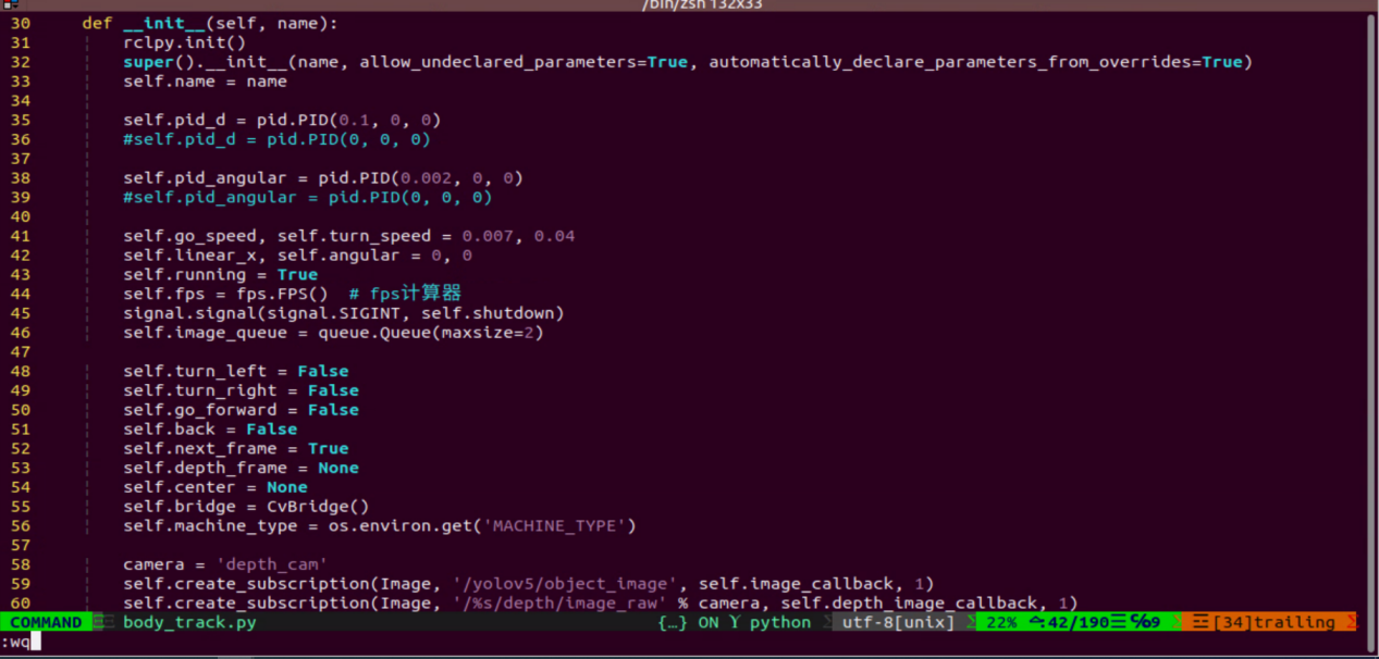

7.1.10.5 Feature Extension
By default, the tracking speed is fixed. To modify the robot’s tracking speed, adjust the PID parameters in the program.
  1. Open the terminal and enter the command to navigate to the directory where the program is stored.
cd ~/ros2_ws/src/example/example/body_control/include/
  1. Then, use the command to open the program file.
vim body_track.py

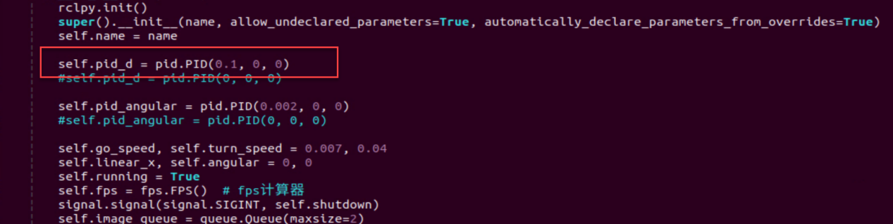

  1. Locate the self.pid_d and self.pid_angular functions, where the values inside the parentheses correspond to the PID parameters. One controls the tracking linear velocity PID, and the other controls the tracking angular velocity PID.
The three PID parameters—proportional, integral, and derivative—serve different purposes: the proportional adjusts the response level, the integral smooths the response, and the derivative helps control overshoot.
  1. To adjust the tracking speed, press the i key to enter edit mode, then increase the values. For example, set the linear velocity PID to 0.05 to boost the tracking speed.
It’s recommended not to increase the parameters too much, as doing so can cause the robot to track too quickly and negatively impact the feature.
  1. After making the changes, press Esc to exit edit mode, then type :wq to save and exit.

7.1.11 Body Gesture Control with RGB Fusion
The depth camera is fused with RGB, allowing the system to perform both color recognition and body-gesture control. Based on the section Body Gesture Control in this document, this session incorporates color recognition to determine the control target. Only when a person wearing a specified color is detected, which can be set through color calibration, can their body gestures be used to control the robot.
If a person wearing the specified color is not detected, the robot cannot be controlled. This allows precise targeting of the person who can control the robot.
7.1.11.1 Experiment Overview
Next, based on the constructed model, the key points of the human torso in the camera feed are detected, and lines are drawn between the key points to visualize the torso and determine the body posture. The center of the body is calculated based on all key points.
Finally, if the detected posture is “hands on hips,” the system uses the clothing color to identify the control target, and the robot enters control mode. When the person performs specific gestures, the robot responds accordingly.
7.1.11.2 Operation Steps
ros2 launch example body_and_rgb_control.launch.py
7.1.11.3 Project Outcome
After starting the feature, stand within the camera’s field of view. When a person is detected, the camera feed will display the torso key points, lines connecting the points, and the body’s center point.
Step 1: Adjust the camera slightly higher and maintain a reasonable distance to ensure the full body is captured.
Step 2: When the person who will control the robot appears in the camera feed and strikes a hands-on-hips pose, wait for the buzzer to sound briefly. This indicates that the robot has completed the body center and clothing color calibration and is now in control mode.
Step 3:
Step 4: If someone wearing a different color enters the camera’s field of view, they will not be able to control the robot.

7.1.12 Human Pose Detection
In this program, a human pose estimation model from the MediaPipe machine learning framework is used to detect human poses. When the robot detects that a person has fallen, it will trigger an alert and perform a left-right twisting motion.
7.1.12.1 Experiment Overview
Next, the image is flipped and processed to detect human body information within the frame. Based on the connections between human keypoints, the system calculates the body height to determine body movements.
Finally, if a fall is detected, the robot will trigger an alert and move forward and backward.
7.1.12.2 Operation Steps
ros2 launch example fall_down_detect.launch.py
7.1.12.3 Project Outcome
After starting the feature, make sure the person is fully within the camera’s field of view. When a person is detected, the keypoints of the body will be marked on the live feed.
When the person appears with a significantly low height in the camera feed, the robot will recognize it as a falling posture and initiate an emergency response. The robot will emit a continuous alarm sound and move rapidly back and forth.

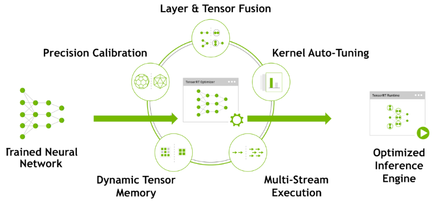

7.3.2 TensorRT Acceleration
7.3.2.1 Introduction to TensorRT
TensorRT is a high-performance deep learning inference SDK developed by NVIDIA. It includes a deep learning inference optimizer and runtime that enables low-latency and high-throughput deployment of inference applications.
TensorRT now supports deep learning frameworks such as TensorFlow, Caffe, MXNet, and PyTorch. By integrating TensorRT with NVIDIA GPUs, fast and efficient inference deployment can be achieved across most frameworks.
There are many optimization methods for deep learning models, such as weight quantization, weight sparsity, and channel pruning, which are typically performed during the training phase. In contrast, TensorRT optimizes already-trained models by improving the efficiency of the computational graph.
7.3.2.2 Optimization Methods
TensorRT employs the following optimization strategies:
  • Precision Calibration
  • Layer & Tensor Fusion
  • Kernel Auto-Tuning
  • Dynamic Tenser Memory
  • Multi-Stream Execution
  • Precision Calibration for Weights and Activations
Most deep learning frameworks use 32-bit floating-point (FP32) precision for network tensors during training. After training, because inference does not require backpropagation, data precision can be reduced to formats like FP16 or INT8. Lowering data precision reduces memory usage and latency and shrinks the model size.
The following table shows the dynamic ranges for different precisions:
Precision Dynamic Range
FP32 −3.4×1038 ~ +3.4×1038
FP16 −65504 ~- +65504
INT8 −128 ~ +127
INT8 has only 256 distinct values. Using INT8 to represent FP32 values may result in information loss and degraded performance. However, TensorRT provides a fully automated calibration process to optimally convert FP32 data to INT8 with minimal performance loss.
  • Layer and Tensor Fusion
Although CUDA cores compute tensors quickly, significant time can still be spent on kernel launches and input/output tensor read-write operations per layer, which wastes GPU resources and creates memory bandwidth bottlenecks.
TensorRT optimizes model structure by horizontally or vertically merging layers to reduce the total number of layers and the CUDA cores they occupy.
Horizontal fusion combines convolution, bias, and activation into a CBR structure, which occupies only one CUDA core. Vertical fusion merges layers with the same structure but different weights into a wider layer, also using only one CUDA core.
Additionally, for multi-branch merges, TensorRT can direct outputs to the correct memory address without copying, eliminating the concat layer and reducing memory access operations.
During inference, the network model performs calculations using CUDA kernels on the GPU. TensorRT automatically tunes CUDA kernels based on different algorithms, network models, and GPU platforms to ensure optimal performance on a given platform.
  • Dynamic Tensor Memory
TensorRT assigns memory to each tensor only during its usage period to avoid redundant memory allocation. This reduces memory usage and improves memory reuse efficiency.
By utilizing CUDA streams, TensorRT enables parallel computation across multiple branches of the same input, maximizing parallel operation.

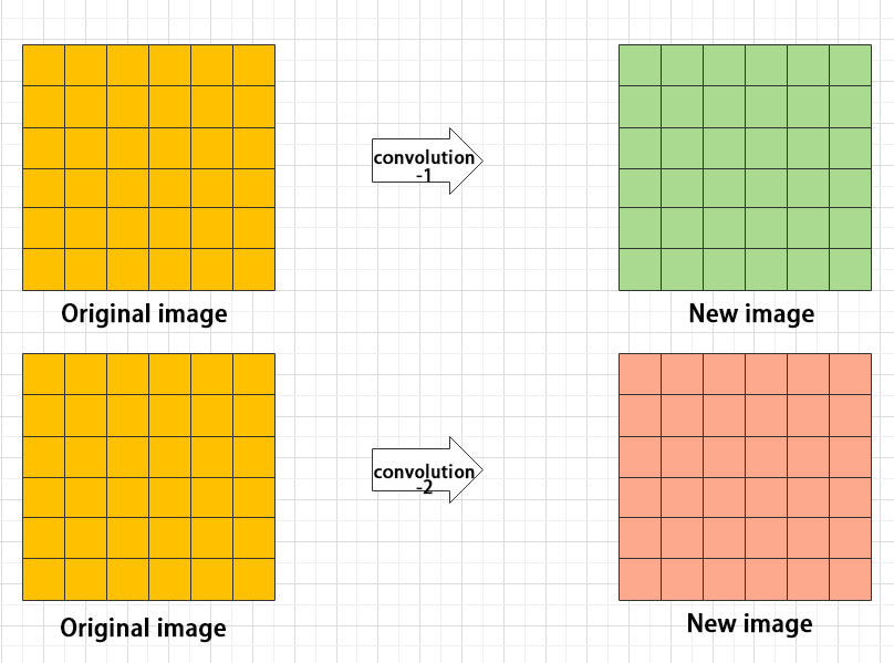

  1. Convolutional Layer: Feature Extraction

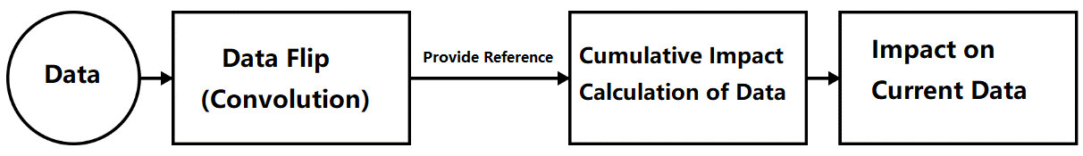

Convolution is the process where an entity at multiple past time points does or is subjected to the same action, influencing its current state. Convolution can be divided into convolution and multiplication.
Convolution can be understood as flipping the data, and multiplication as the accumulation of the influence that past data has on the current data. The data flipping is done to establish relationships between data points, facilitating the calculation of accumulated influence with a proper reference.

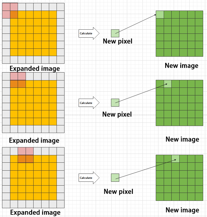

In YOLOv11, the data to be processed are images, which are two-dimensional in computer vision. Accordingly, the convolution is a two-dimensional convolution. The purpose of 2D convolution is to extract features from images. To perform a 2D convolution, it is necessary to understand the convolution kernel.

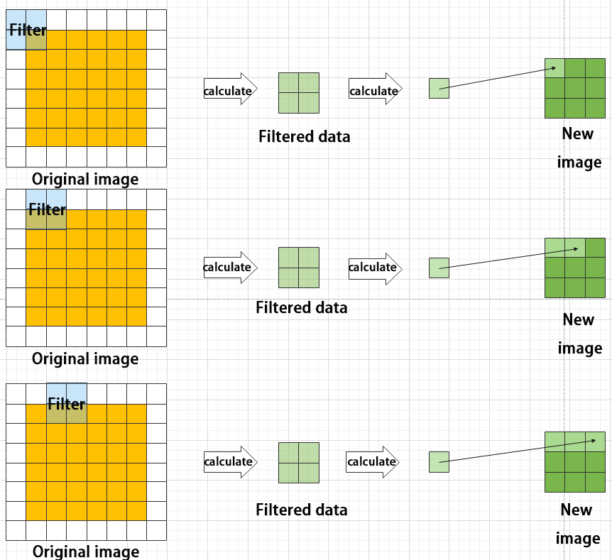

The convolution kernel is the unit region over which the convolution calculation is performed each time. The unit is pixels, and the convolution sums the pixel values within the region. Typically, convolution is done by sliding the kernel across the image, and the kernel size is manually set.
When performing convolution, depending on the desired effect, the image borders may be padded with zeros or extended by a certain number of pixels, then the convolution results are placed back into the corresponding positions in the image. For example, a 6×6 image is first expanded to 7×7, then convolved with the kernel, and finally the results are filled back into a blank 6×6 image.

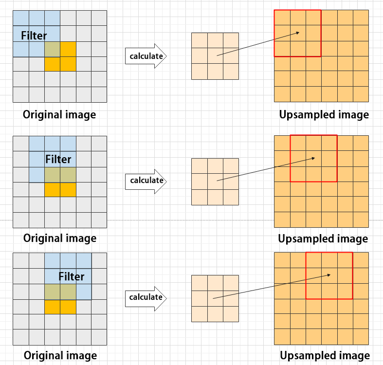

  1. Upsampling Layer: Restoring Image Size
Upsampling can be understood as “reverse pooling.” After pooling, the image size shrinks, and upsampling restores the image to its original size. However, only the size is restored, the pooled features are also modified accordingly.
For example, starting with a 6×6 image, applying a 3×3 filter for upsampling produces a new image.

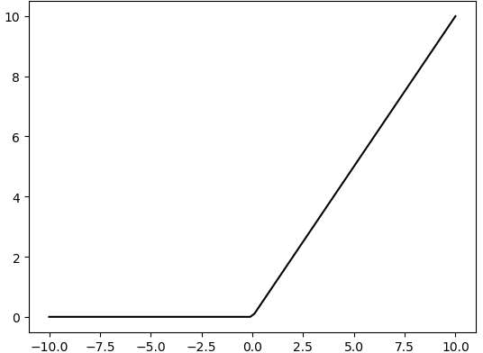

  1. ReLU Layer: Activation Function
Activation functions are added during model construction to introduce non-linearity. Without activation functions, each layer is essentially a matrix multiplication. Every layer’s output is a linear function of the previous layer’s input, so no matter how many layers the neural network has, the output is just a linear combination of the input. This prevents the model from adapting to actual situations.
There are many activation functions, commonly ReLU, Tanh, Sigmoid, etc. Here, ReLU is used as an example. ReLU is a piecewise function that replaces all values less than 0 with 0 and keeps positive values unchanged.

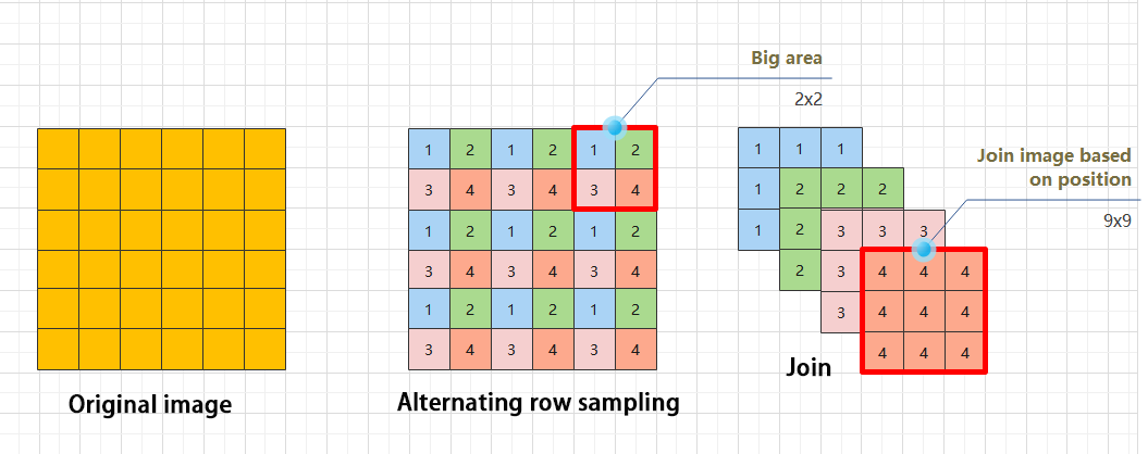

  1. Strided Sampling and Concatenation Unit(Focus)
The input image is first divided into multiple large regions. Then, small image patches located at the same relative position within each large region are concatenated together to form a new image. This effectively splits the input image into several smaller images. Finally, an initial sampling is performed on the images using a convolutional block.
As shown in the figure below, for a 6×6 image, if each large region is defined as 2×2, the image can be divided into 9 large regions, and each contains 4 small patches.
By taking the small patches at position 1 from each large region and concatenating them, a 3×3 image can be formed. The patches at other positions are concatenated in the same way.
Ultimately, the original 6×6 image is decomposed into four 3×3 images.

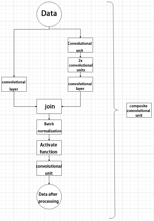

  1. Composite Convolutional Block
In YOLOv11, a key feature of the composite convolutional block is its customizable design, allowing convolutional blocks to be configured as needed. This structure also uses two paths whose outputs are merged.
The first path contains a single convolutional layer for feature extraction, while the second path includes 2𝑥+1 convolutional blocks followed by an additional convolutional layer. After sampling and concatenation, batch normalization is applied to standardize the data, followed by an activation function. Finally, a convolutional block is used to process the combined features.

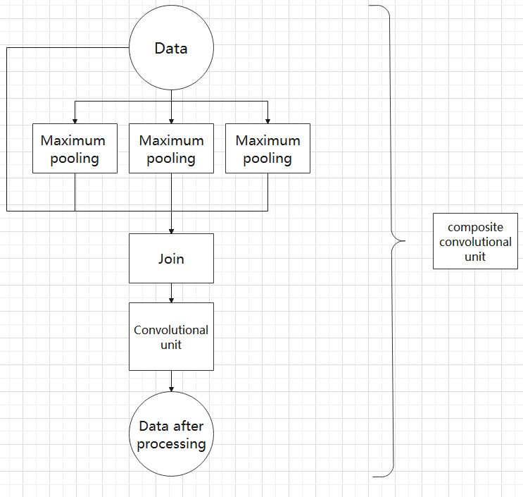

  1. Composite Pooling Block
The output from a convolutional block is simultaneously passed through three separate max pooling layers, while an additional unprocessed copy is preserved. The resulting four feature maps are then concatenated and passed through a convolutional block. By processing data with the composite pooling block, the original features can be significantly enhanced and emphasized.

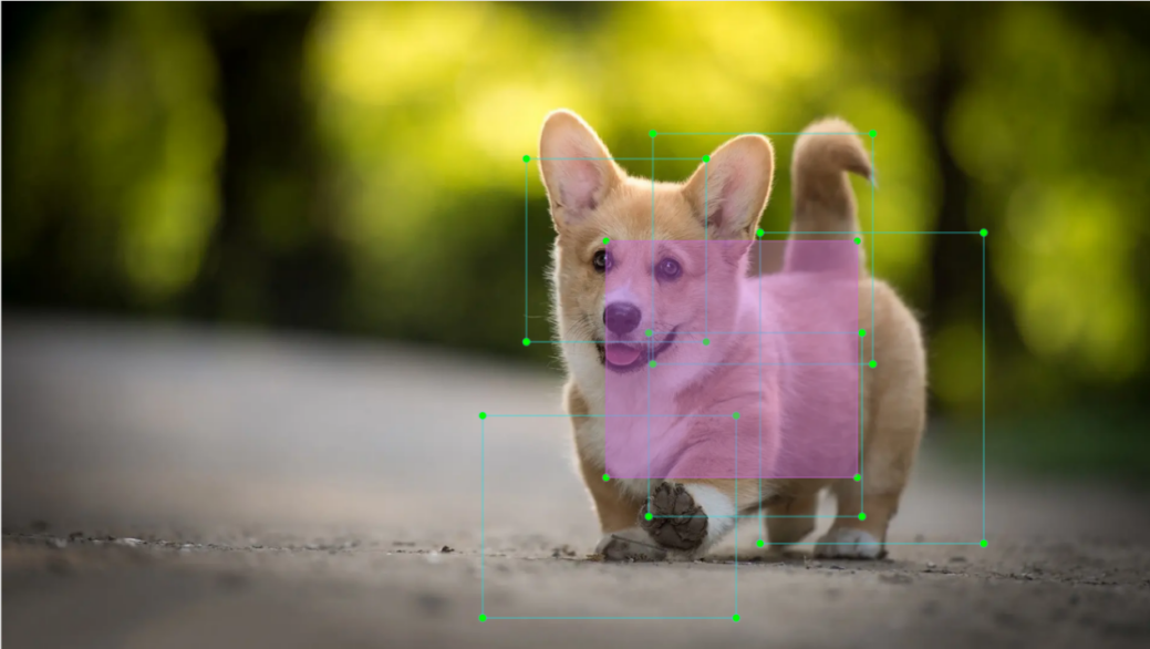

This section explains the model’s processing flow using the concepts of prior boxes, prediction boxes, and anchor boxes involved in YOLOv11.
7.3.4.1 Prior Box
When an image is fed into the model, predefined regions of interest must be specified. These regions are marked using prior boxes, which serve as initial bounding box templates indicating potential object locations in the image.
7.3.4.2 Prediction Box
Prediction boxes are generated by the model as output and do not require manual input. When the first batch of training data is fed into the model, the prediction boxes are automatically created. The center points of prediction boxes tend to be located in areas where similar objects frequently appear.
7.3.4.3 Anchor Box
Since predicted boxes may have deviations in size and location, anchor boxes are introduced to correct these predictions.
Anchor boxes are positioned based on the predicted boxes. By influencing the generation of subsequent predicted boxes, anchor boxes are placed around their relative centers to guide future predictions.
7.3.4.4 Project Process
Once the bounding box annotations are complete, prior boxes appear on the image. When the image data is input into the model, predicted boxes are generated based on the locations of the prior boxes. Subsequently, anchor boxes are generated to adjust the predicted results. The weights from this round of training are then updated in the model.
With each new training iteration, the predicted boxes are influenced by the anchor boxes from the previous round. This process is repeated until the predicted boxes gradually align with the prior boxes in both size and location.

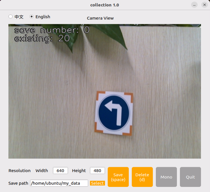

  3. Stop the app auto-start service by entering the following command:
  1. Start the depth camera service with the command.
  1. Open a new command-line terminal and enter the command to create a directory for storing your dataset.
mkdir -p ~/my_data
  1. Then, launch the tool by entering the following command.

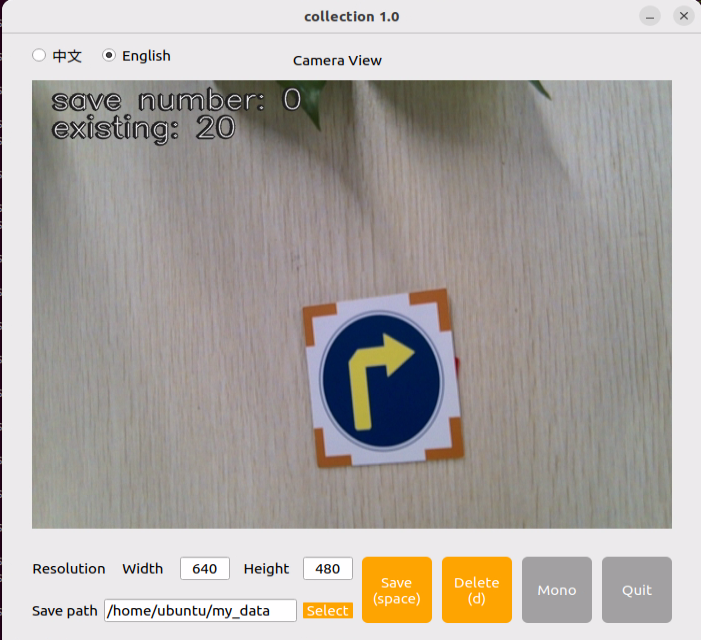

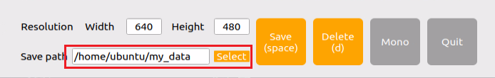

The save number in the top-left corner of the tool interface shows the ID of the saved image. The existing shows how many images have already been saved.

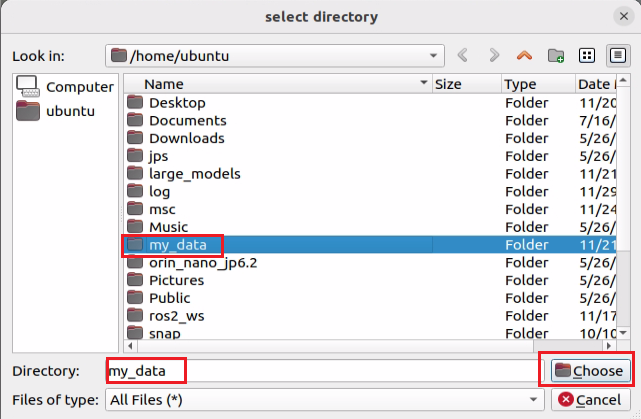

  1. Click Select to change the save path to the my_data folder created before.
  1. After selecting the target directory, click Choose.

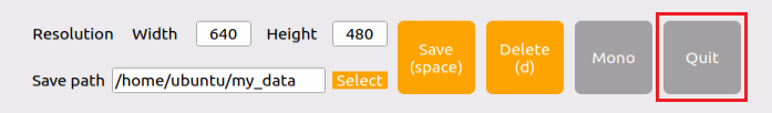

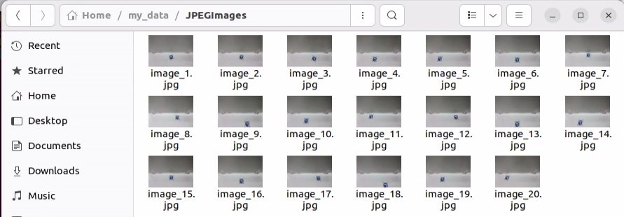

  1. Click the Save(Space) button or press the space key to save the current camera frame. A JPEGImages folder will be automatically created under the directory /home/ubuntu/my_data to store the images.
To improve model reliability, capture the target object from various distances, angles, and tilts.
  1. After collecting images, click the Quit button to close the tool.
  1. Click on the icon in the system status bar to open the file manager, where the saved images can be viewed.
  1. Then press Ctrl+C in all open terminal windows to exit—this completes the image collection process.

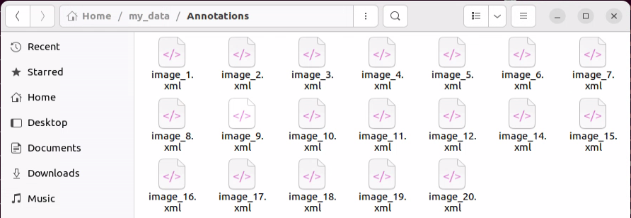

7.3.5.2 Image Annotation

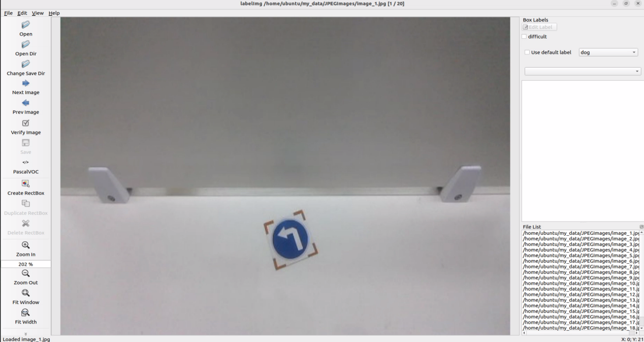

Once the images are collected, they need to be annotated. Annotation is essential for creating a functional dataset, as it tells the training model which parts of the image correspond to which categories. This allows the model to later identify those categories in new, unseen images.
  1. Open a terminal and enter the command to start the image annotation tool:
python3 ~/software/labelImg/labelImg.py
Below is a table of common shortcut keys:
Button Shortcut Key Function
Ctrl+U Choose the directory for images.
Ctrl+R Choose the directory for calibration data.
W Create an annotation box.
Ctrl+S Save the annotation.
A Switch to the previous image.
D Switch to the next image.

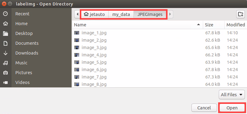

  1. Click the button to open the folder where your images are stored. In this tutorial, select the directory used for image collection.
  1. Click Open to open the folder.

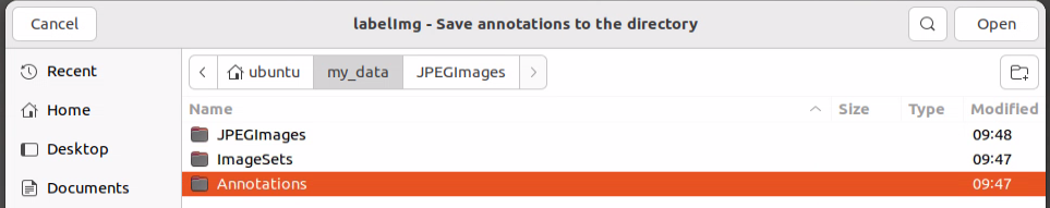

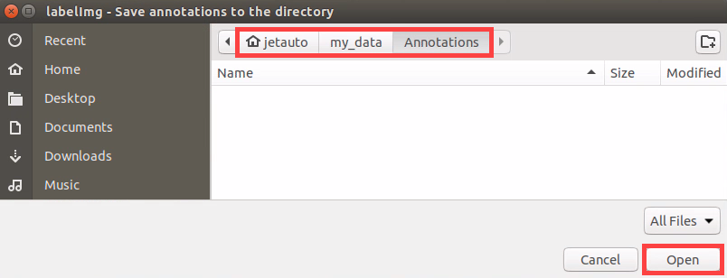

  1. Then click the Change Save Dir button and select the annotation save folder, which is the Annotations directory located under the same path as the image collection.
  1. Click Open to return to the annotation interface.

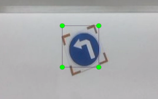

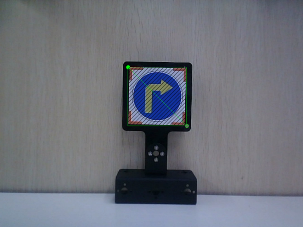

  2. Press the W key to begin creating a bounding box.
  3. Move the mouse to the desired location and hold the left mouse button to draw a box that covers the entire object. Release the left mouse button to finish drawing the box.
  1. In the pop-up window, name the category of the object, e.g., left. After naming, click OK or press Enter to save the label.
  1. Press Ctrl+S to save the annotation for the current image.
  2. Press the D key to move to the next image, then repeat steps 7 to 9 to complete all annotations. Click the close button at the top-right corner of the tool to exit.
  3. Click the icon in the system status bar to open the file manager and navigate to the directory /home/ubuntu/my_data/. The annotation files for each image will be available in this folder.

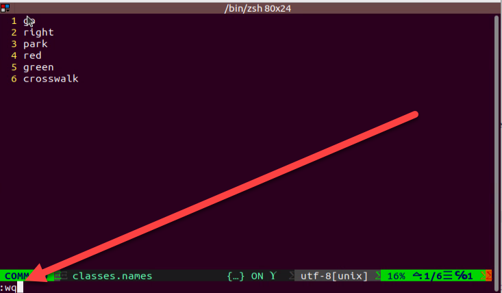

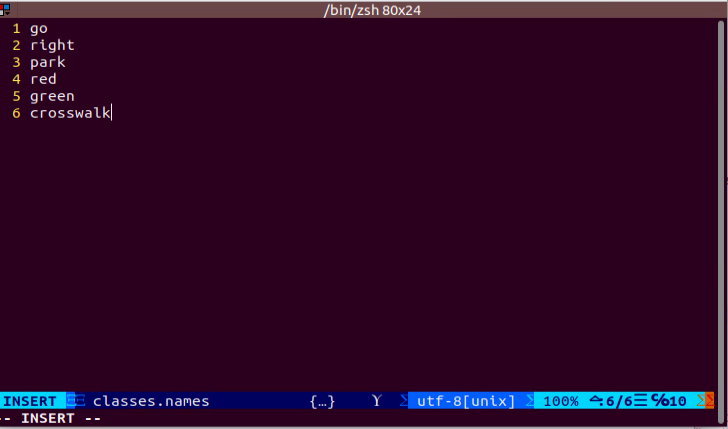

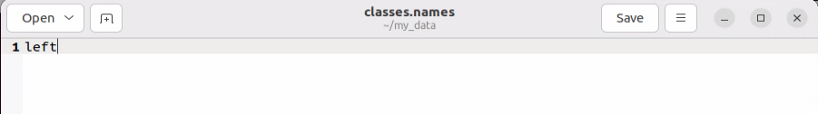

  1. Open a new terminal and enter the following command to open the file: Note: If the file is missing, the related file can be created by entering the following command.
gedit ~/my_data/classes.names
  1. Write the labeled category left into the text file. If there are multiple categories, each one should be listed on a new line.
The class names here must match the labels used in the labelImg annotation tool exactly.
  1. After editing, press Ctrl+S to save and exit.

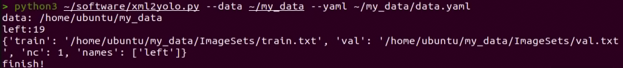

  2. Next, return to the terminal and run the following command to convert the annotation format:
python3 ~/software/xml2yolo.py --data ~/my_data --yaml ~/my_data/data.yaml
Make sure the paths to ~/software/xml2yolo.py and my_data match your actual file structure!
This command uses three main parameters:
xml2yolo.py: A script that converts annotations from XML format to the YOLOv11 format. Make sure the path is correct.

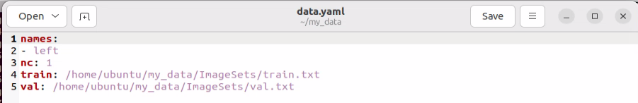

my_data: The directory containing your annotated dataset. Make sure the path is correct.
data.yaml: Indicates the format conversion for the entire folder after the model has been split. From the command, it is clear that the saved directory is within the my_data folder.

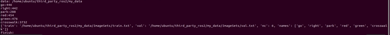

The following image shows the generated data.yaml file.
The items listed after the names represent the types of labels. The nc field specifies the total number of label categories. The train refers to the training set—a commonly used term in deep learning that indicates the data used for model training. The parameter following it is the path to the training images. Similarly, the val refers to the validation set, which is used to verify the model’s performance during the training process, and the path that follows indicates where the validation data is located. It is important to note that the paths need to be filled in or updated according to their actual locations. For example, during the training process, if there is a need to speed up training by moving the dataset from the robot to a local PC or cloud server, the paths corresponding to train and val should be updated accordingly.
Finally, an XML file will be generated under the ~/my_data folder to record the path location of the currently split dataset. Similarly, the last parameter in step 4, ~/my_data/data.yaml, can be changed to modify the save path. This file path must be remembered, as it will be used later for model training.

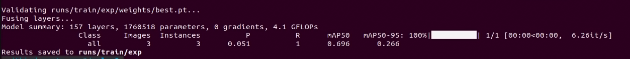

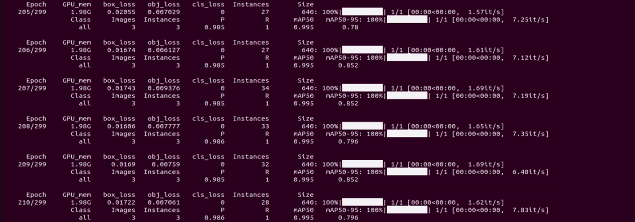

  1. Enter the command to start training the model.
python3 train.py --img 640 --batch 8 --epochs 300 --data ~/my_data/data.yaml --weights yolo11n.pt
In the command, the parameters stands for:
–img: image size.
–batch: number of images per batch.
–epochs: number of training iterations.
–data: path to the dataset.
–weights: path to the pre-trained model.
You can modify the parameters above based on your specific needs. To improve model accuracy, consider increasing the number of training epochs. Note that this will also increase training time.

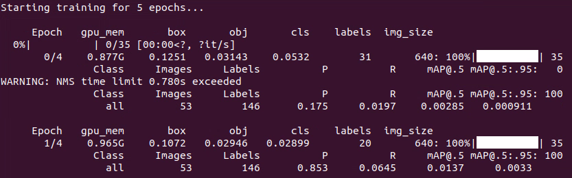

If the following content appears, it indicates that the training is in progress.
After training is complete, the terminal will display the path where the trained model files are saved. The training results are stored in the directory of yolov11/runs/train/exp.
The generated folder name under runs/train/ may vary. Please locate it accordingly.

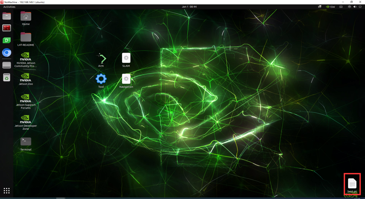

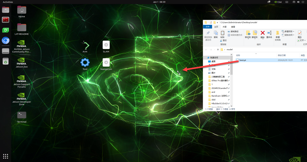

  1. Transfer the trained model file to the Jetson Orin Nano controller using NoMachine software. Simply drag the file from your local machine to the remote desktop, as shown below. The .pt model file, marked in red, should be dragged into the remote desktop.
The screenshot below shows the robot’s remote desktop. The interface may look slightly different depending on the robot type, but the file transfer process remains the same.
After dragging the file, the model will be successfully imported and visible on the desktop.
Next, copy the trained model file, for example, best.pt, to the /third_party/yolo/yolov11 directory.
  1. Right-click on the desktop and select Open Terminal.
  1. In the terminal, input the command to copy the model to the yolov5 folder.
mv ~/Desktop/best.pt ~/third_party/yolo/yolov11

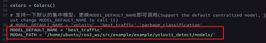

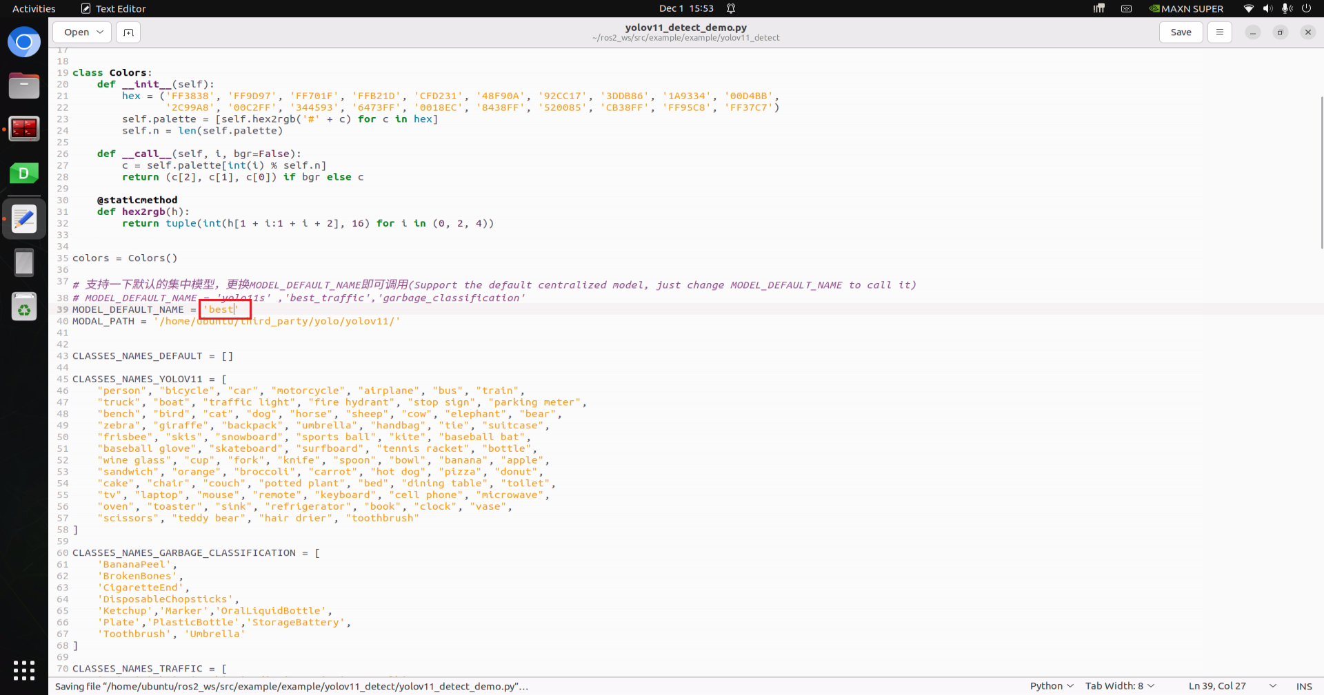

  1. Open the yolov11_detect_demo.py file for object detection.
gedit ~/ros2_ws/src/example/example/yolov11_detect/yolov11_detect_demo.py
  1. Change the MODEL_DEFAULT_NAME parameter to best.
  1. Run the object detection using the corresponding command.
ros2 launch example yolov11_detect_demo.launch.py

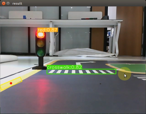

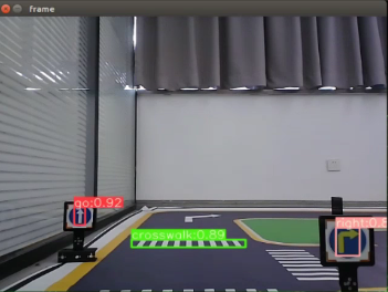

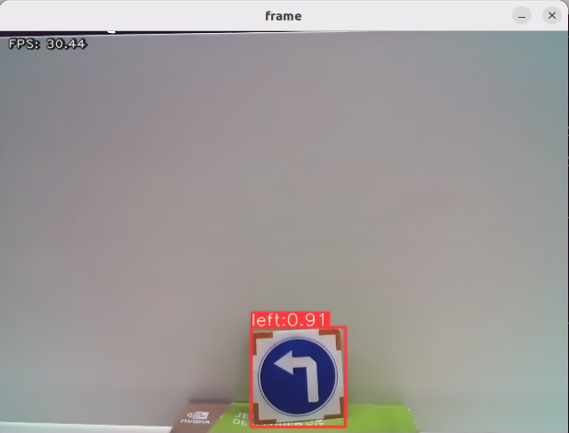

  • Detection Result

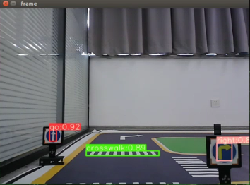

Place a traffic sign within the camera’s field of view. Once the sign is detected, a bounding box will appear in the camera feed, highlighting the sign along with its class name and detection confidence.

  1. Open a new terminal, navigate to the image collection tool directory, and run the image collection script:
  1. Change the Save path to /home/ubuntu/my_data, which will also be used in later steps.
  1. Place the target object within the camera’s view. Press the Save (space) button or the space bar on the keyboard to save the current camera frame. After pressing it, both the save number and the existing counters will increase by 1. This helps track the current image ID and total image count in the folder.
  1. After clicking Save (space), a folder named JPEGImages will be automatically created under the path /home/ubuntu/my_data to store the images.
  • To improve model reliability, capture the target object from various distances, angles, and tilts.
  • To ensure stable recognition, collect at least 200 images per category during the data collection phase.

  1. Use the shortcut Ctrl+U and set the image directory to /home/ubuntu/my\_data/JPEGImages/, then click the Open button.
  1. Use the shortcut Ctrl+R, set the annotation data storage directory to /home/ubuntu/my\_data/Annotations/, and click Open. The Annotations folder will be automatically generated when collecting images.
  1. Press the w key to begin creating a bounding box.
  1. In the pop-up window, name the category of the object, e.g., right. After naming, click OK or press Enter to save the label.

  3. Click the icon in the system status bar to open the file manager and navigate to the directory /home/ubuntu/my\_data/Annotations/ to view the image annotation files. This is the same dataset path where the images were saved during data collection.

  2. Enter the following command to open the file for editing:
vim ~/my_data/classes.names
  1. Press the i key to enter edit mode and add the class names for the target recognition objects. When adding multiple class names, each class name should be listed on a separate line.
  1. After editing, press Esc, then type :wq to save and close the file.
  1. Next, enter the command to convert the data format and press Enter:
python3 software/xml2yolo.py --data ~/my_date --yaml ~/my_data/data.yaml
In this command, the xml2yolo.py file is used to convert the annotated files into XML format and categorize the dataset into training and validation sets.
If the prompt shown in the figure below appears, the conversion was successful.
The output paths depend on the actual storage location of the folders in your robot’s file system. Paths may vary across devices, but the generated data.yaml file will correspond to your annotated dataset.
python3 train.py --img 640 --batch 8 --epochs 300 --data ~/my_data/data.yaml --weights yolo11s.pt
In the command, --img specifies the image size, --batch indicates the number of images input per batch, --epochs refers to the number of training iterations, representing how many times the machine learning model will go through the dataset. This value should be optimized based on the actual performance of the final model. In this example, the number of training epochs is set to 8 for quick testing. If the computer system is more powerful, this value can be increased to achieve better training results. --data is the path to the dataset, which refers to the folder containing the manually annotated data. --weights indicates the path to the pre-trained model weights. This specifies which .pt weight file the training process is based on. It’s important to note whether yolov11s.pt, yolov11n.pt, or another version is used.
The above parameters can be adjusted according to the specific setup. To improve model accuracy, consider increasing the number of training epochs. Note that this will also increase training time.
If you see the following output, it means the training process is running successfully.
Once training is complete, the terminal will display the path where the training data is saved, as shown below.
If multiple training sessions are conducted, the folder name here, such as exp5, may be different and could be renamed to exp2, exp3, etc. Subsequent steps will depend on the specific folder name used in this step.

  1. Move the trained weight file to the ~/third_party/yolo/yolov11/ directory.
cp ~/third_party/yolo/yolov11/runs/detect/train4/weights/best.pt ~/third_party/yolo/yolov11/best.pt
  1. Then, use the command to convert the pt file into an engine file.
python3 export.py --weights best.pt --include engine --device 0 --half --imgsz 480 640
If the generated best.engine file is locked and not readable, as shown in the image below:
To add permissions to the best.engine file, open a terminal in the folder containing the best.engine file, then input the following command:
sudo chmod +x+w+r best.engine

7.4.2 Traffic Sign Detection
This lesson focuses on recognizing traffic signs through programmed commands.
7.4.2.1 Preparation
  1. The traffic sign model in this section is a YOLOv11 trained model. For more details on YOLOv11, please refer to the previous sections.
  2. When performing this feature, make sure the environment is well-lit, but avoid direct light hitting the camera to prevent misrecognition.

cd /home/ubuntu/ros2_ws/src/example/example/yolov11_detect
  1. Open the source code of the feature by entering:
vim yolov11_detect_demo.py
  1. Press the i key to enter edit mode, locate the code highlighted in red, change the MODEL_DEFAULT_NAME weight file name to best_traffic, and update the MODEL_PATH to /home/ubuntu/ros2_ws/src/example/example/yolov11_detect/models/. Press Esc, type :wq, and press Enter to save and exit.
  2. Enter the following command to start the target detection feature:
