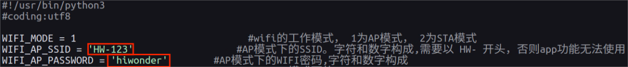

  • Configuring the Leader Robot Network
  1. First, select one robot as the leader, power it on, and then remotely connect to its system desktop.
  1. Open a terminal and input the following command to navigate to the directory where the file is located.
cd wifi_manager
  1. Next, input the command below to open the Wi-Fi configuration file using the vim editor.
vim wifi_conf.py
  1. Press the i key to enter the edit mode. Locate the two lines of code highlighted in the image below and modify the leader hotspot password.
  1. Once the changes are complete, press the Esc key to exit the edit mode. Then input :wq to save the changes and exit.
:wq
  1. Finally, input the command to reboot the leader robot.
sudo reboot
  1. After the leader robot restarts, when reconnecting to the Wi-Fi, enter the Wi-Fi password hiwonder.

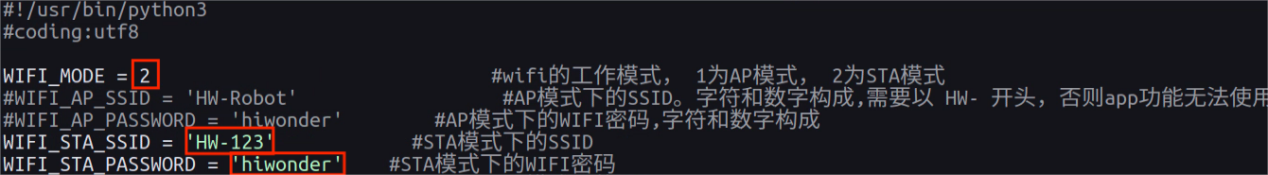

  • Configuring the Follower Robot Network
  1. Power on the follower robot and remotely connect to its system desktop.
cd wifi_manager
vim wifi_conf.py
  1. Press the i key to enter the edit mode, then modify the Wi-Fi name and password lines as shown in the image below. Locate the three highlighted lines of code.
Set the follower robot’s network mode to 2 for LAN mode. HW-123 and hiwonder are the Wi-Fi name and password configured for the leader robot network.
  1. Once the changes are complete, press the Esc key to exit the edit mode. Then input the command to save and exit.
:wq
  1. Finally, input the command to reboot the robot. This step cannot be skipped!
sudo reboot

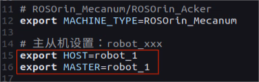

  • For Leader Robot
  1. Select one ROSOrin as the leader robot and power it on. Then, remotely connect to the desktop via NoMachine.
  3. Ensure that the leader robot has a USB receiver for the wireless controller connected.
  1. Input the command to disable the auto-start feature and press Enter.
  1. Input the command to open the file and configure the environment variables for the leader robot.
vim /home/ubuntu/ros2_ws/.typerc
  1. Press the i key to enter edit mode, then set both the leader and follower configurations, setting the leader robot as robot_1.
:wq
  1. Finally, input the following command to complete the leader robot configuration.
source ~/.zshrc

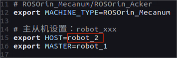

  • For Follower Robot
  1. First, connect to the Wi-Fi network created by the leader robot on the app. Once connected, search for the follower robot. The vehicle icon will appear in the app, and by long-pressing the screen, the follower robot’s IP address will be displayed. Refer to the section 1.5.2.2 LAN Mode Connection (Optional) in the user manual for guidance to use this IP address.
  2. Click the terminal icon on the system desktop to open a command-line window.
  1. Input the command to disable the auto-start service and press Enter.
  1. Input the command to open the file and configure the environment variables for the follower robot.
  1. Press the i key to enter edit mode, then open the leader-follower settings and set the follower robot’s HOST variable to robot_2.
:wq
  1. Finally, run the command to refresh the environment variables.
source ~/.zshrc
