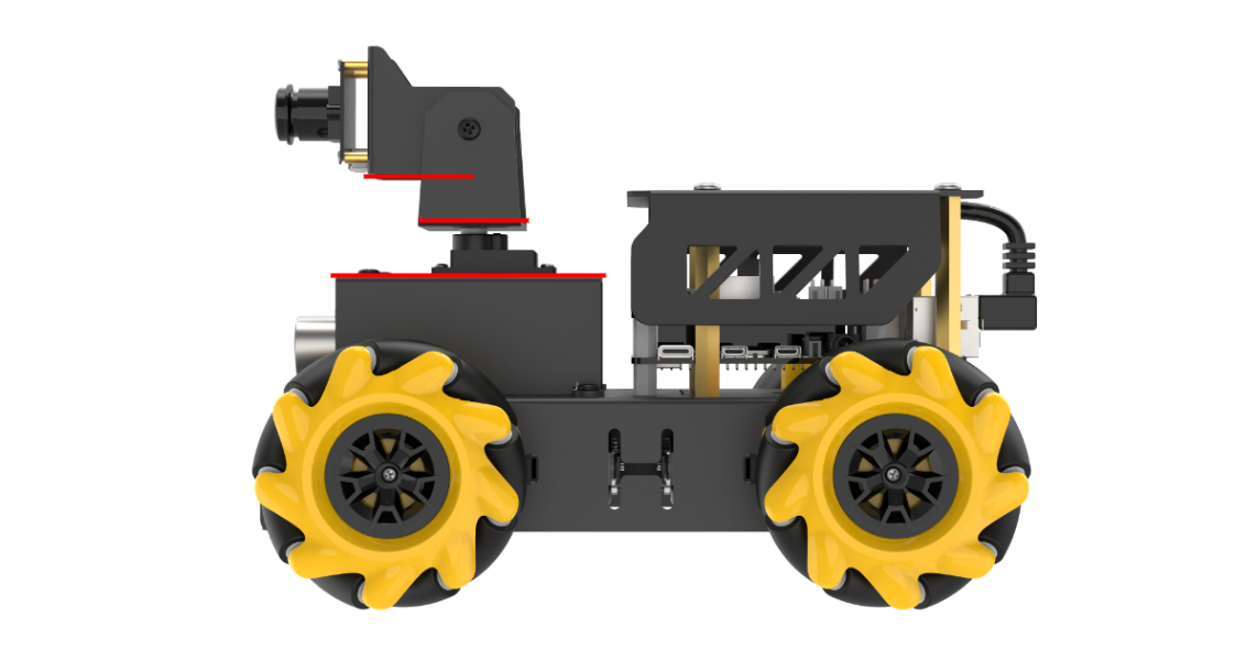

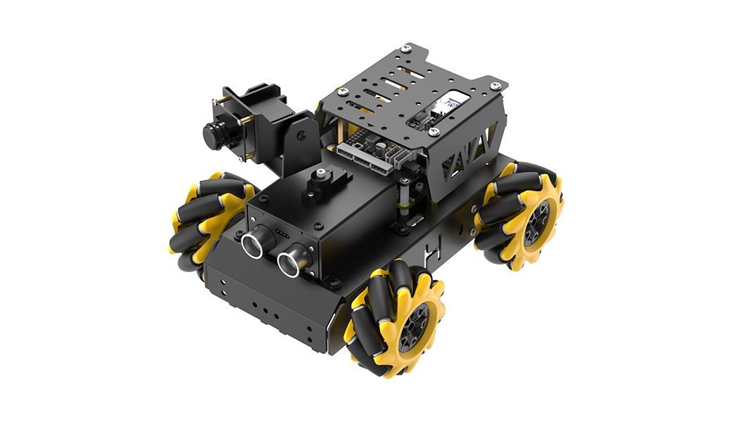

1.1 Introduction to TurboPi
1.1.1 Product Introduction

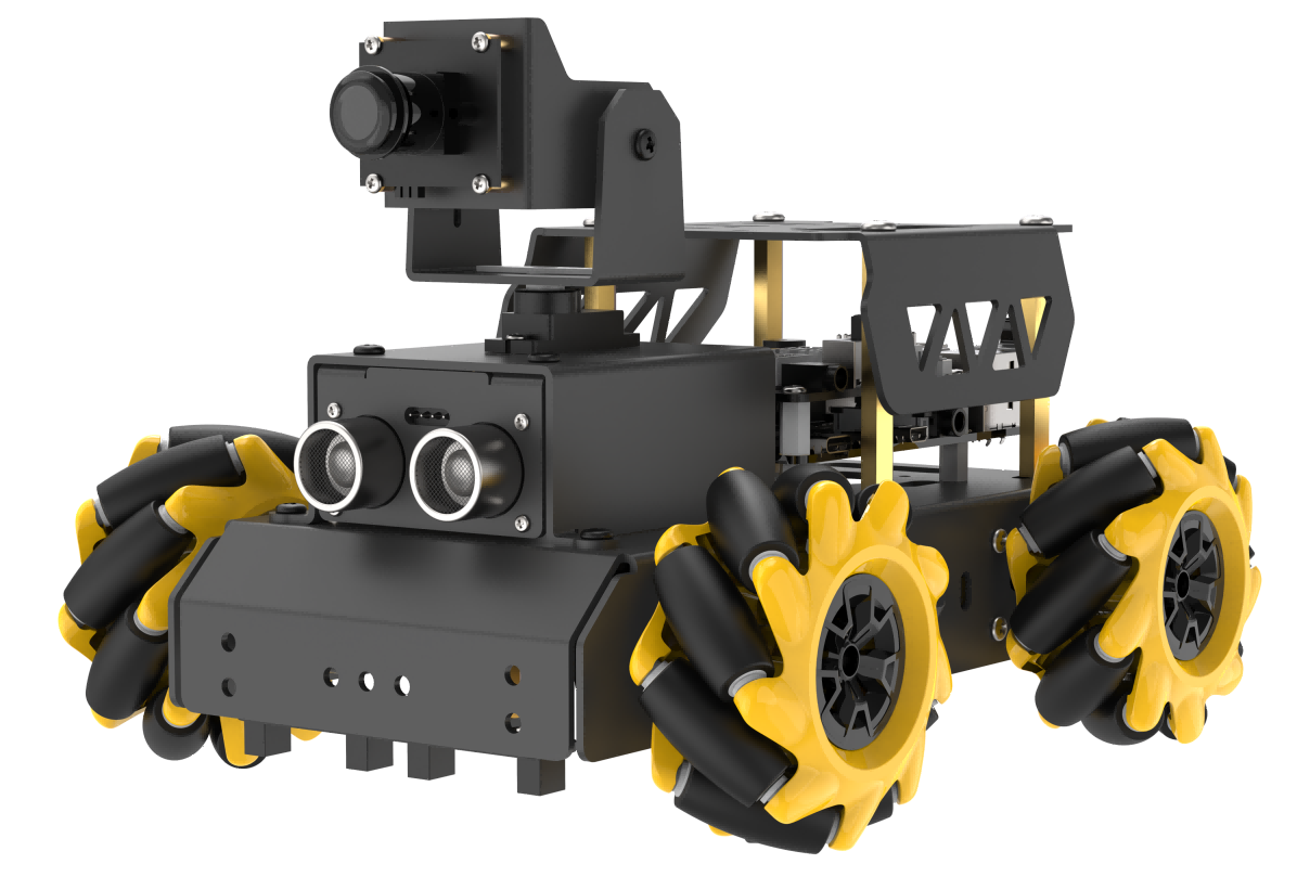

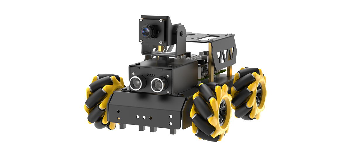

TurboPi is an AI-powered vision wheeled robot developed based on the Raspberry Pi platform. It features a Mecanum wheel chassis and a 2-DOF pan-tilt camera. Supporting Python programming, TurboPi is capable of ultrasonic distance-based obstacle avoidance, AI color recognition, object tracking, visual line following, and more. It serves as an excellent tool for users to explore robotics and AI technologies while enjoying the fun brought by innovation.

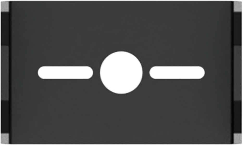

1.2 Package List
(1) TurboPi Standard Packing List

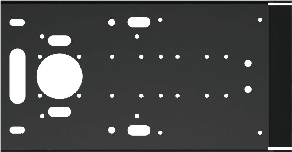

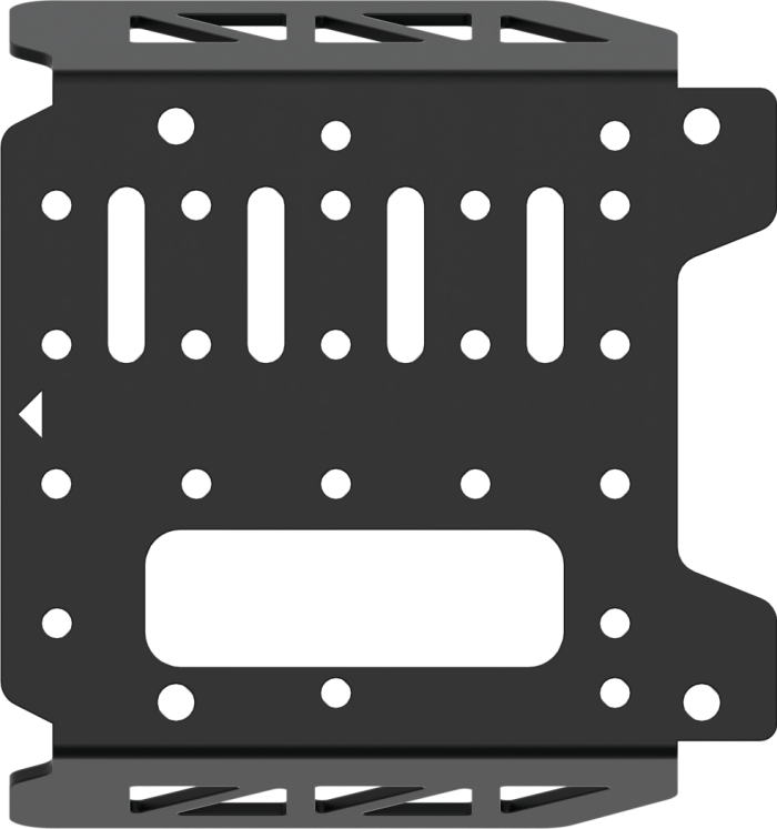

| 1 | Chassis | 1 | ![]() |
| 2 | Base bracket | 1 | ![]() |

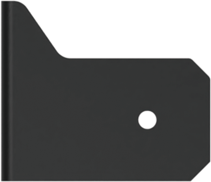

| 3 | Tail extension bracket | 1 | ![]() |

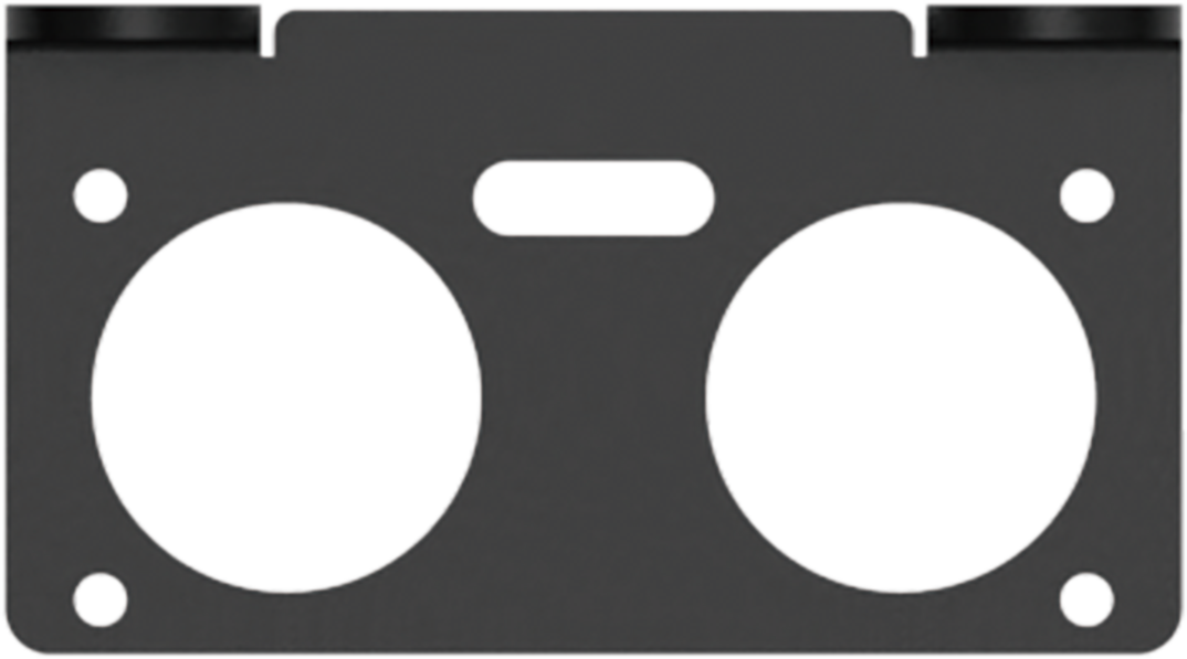

| 5 | Ultrasonic wave bracket | 1 | ![]() |

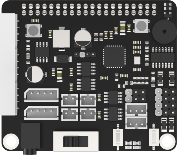

| 8 | Raspberry Pi expansion board | 1 | ![]() |

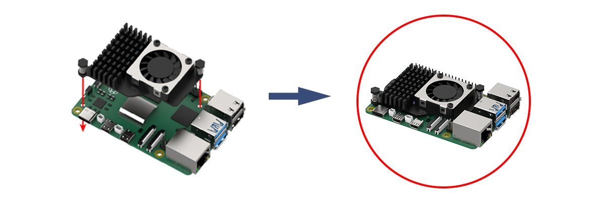

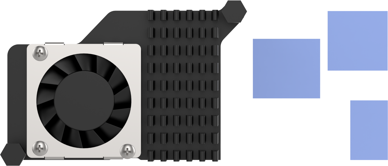

| 9 | Active heatsink + Thermal silicone pads | 1 | ![]() |

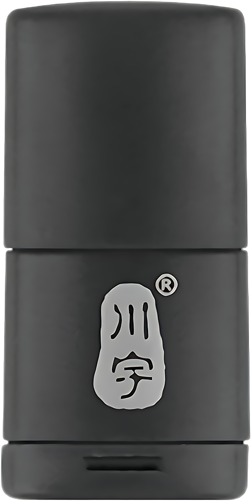

| 10 | Raspberry Pi boardcard reader | 1 | ![]() |

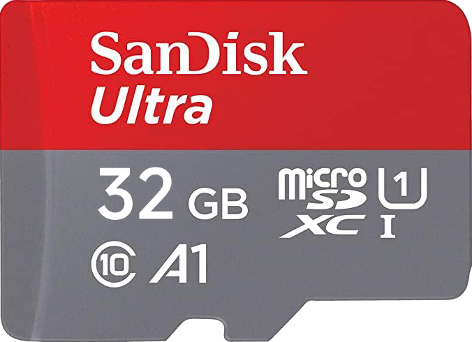

| 11 | 32G TF card | 1 | ![]() |

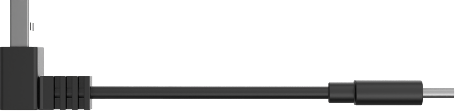

| 12 | USB cable | 1 | ![]() |

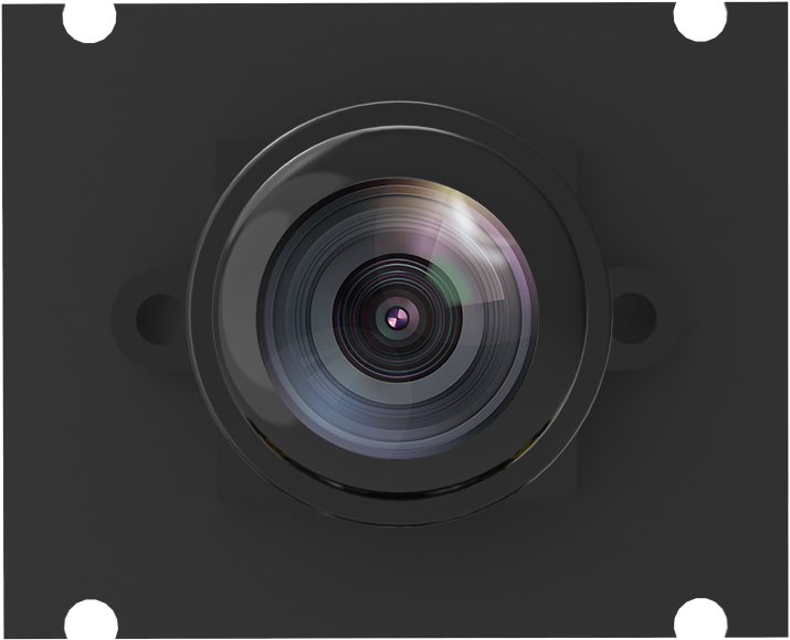

| 13 | HD camara | 1 | ![]() |

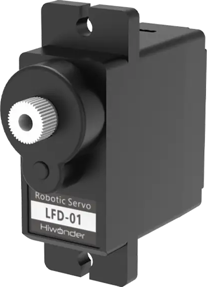

| 14 | LFD-01 micro servo | 2 | ![]() |

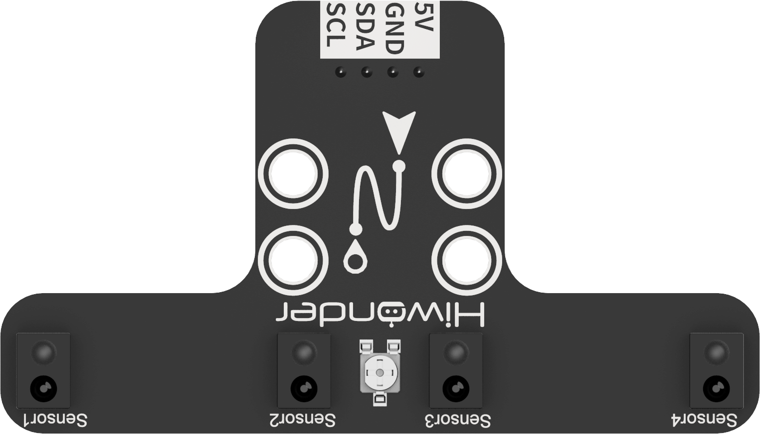

| 15 | 4-channel line follower | 1 | ![]() |

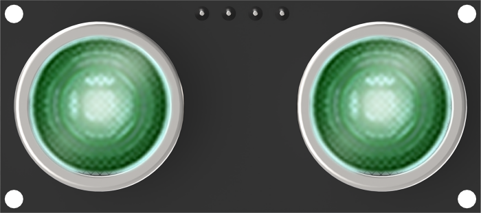

| 16 | Glowy ultrasonic sensor | 1 | ![]() |

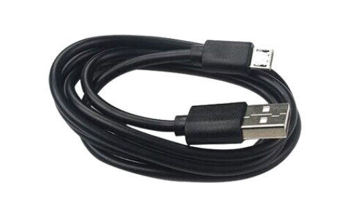

| 19 | Micro USB cable | 1 | ![]() |

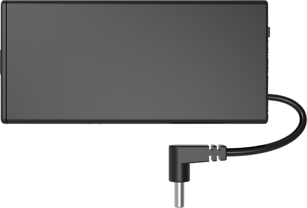

| 20 | Battery charge | 1 | ![]() |

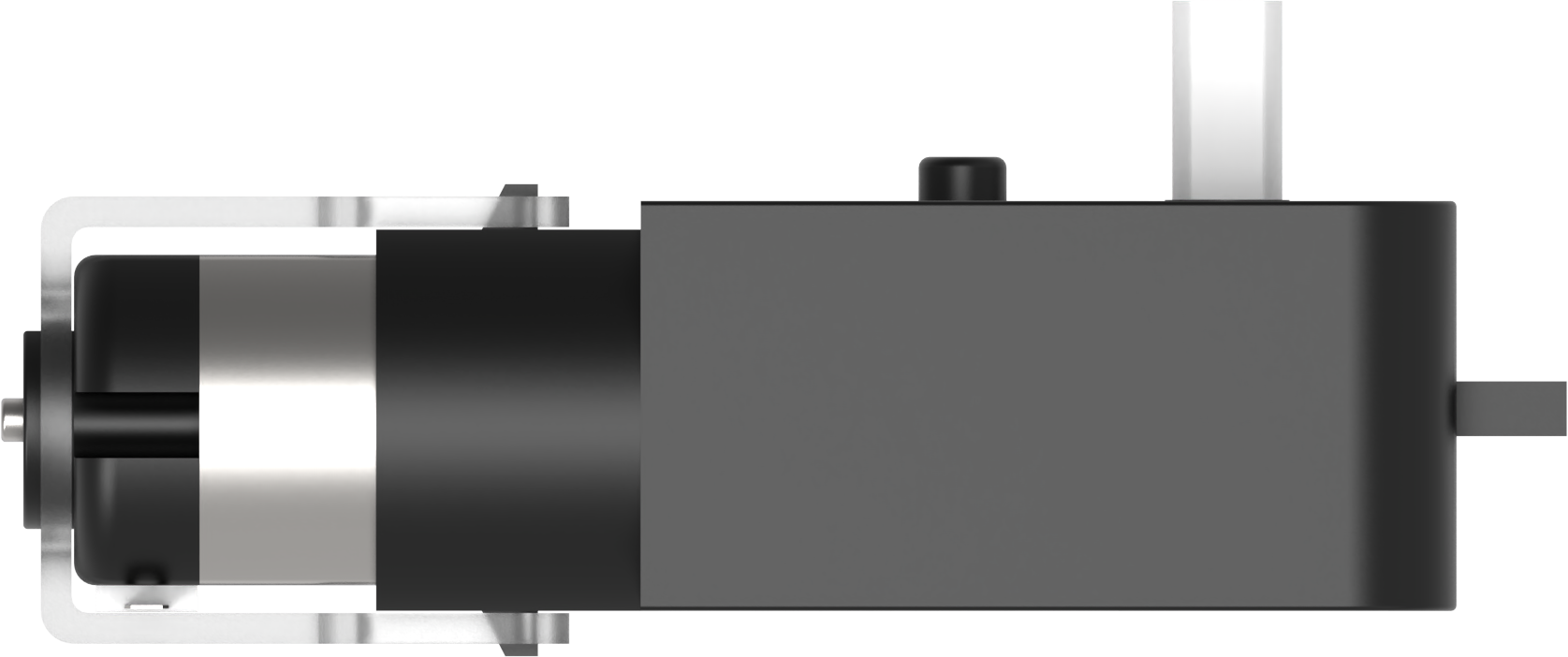

| 21 | TT motors | 4 | ![]() |

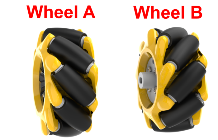

| 22 | Mecanum wheels (Wheel A *2; Wheel B *2) |
4 | ![]() |

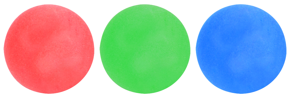

| 24 | Balls | 3 | ![]() |

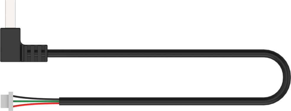

| 25 | 4pin wire | 3 | ![]() |

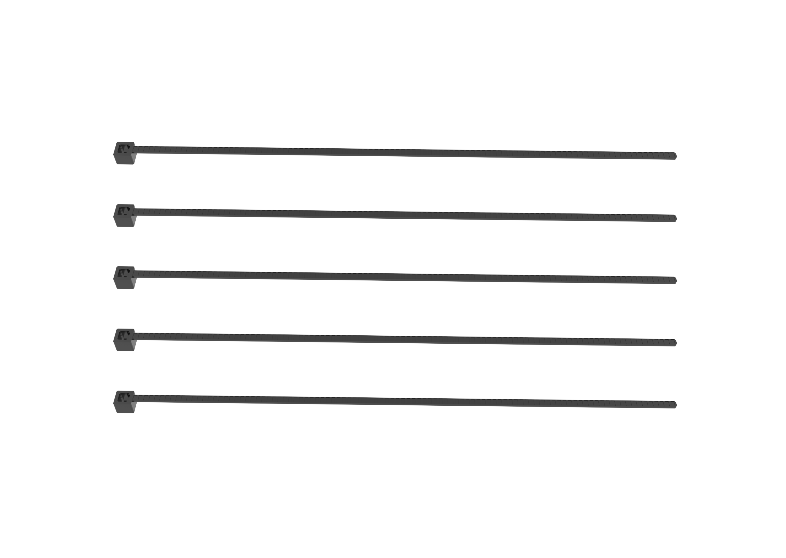

| 26 | Ribbon | 5 | ![]() |

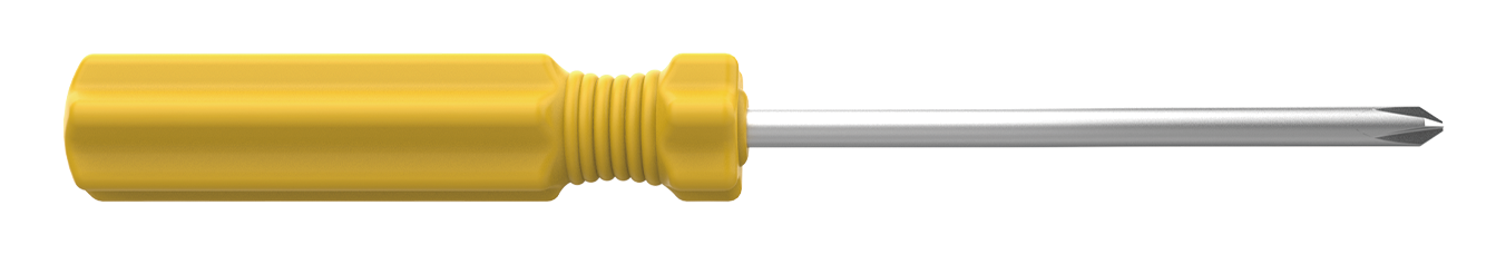

| 27 | Screwdriver | 1 | ![]() |

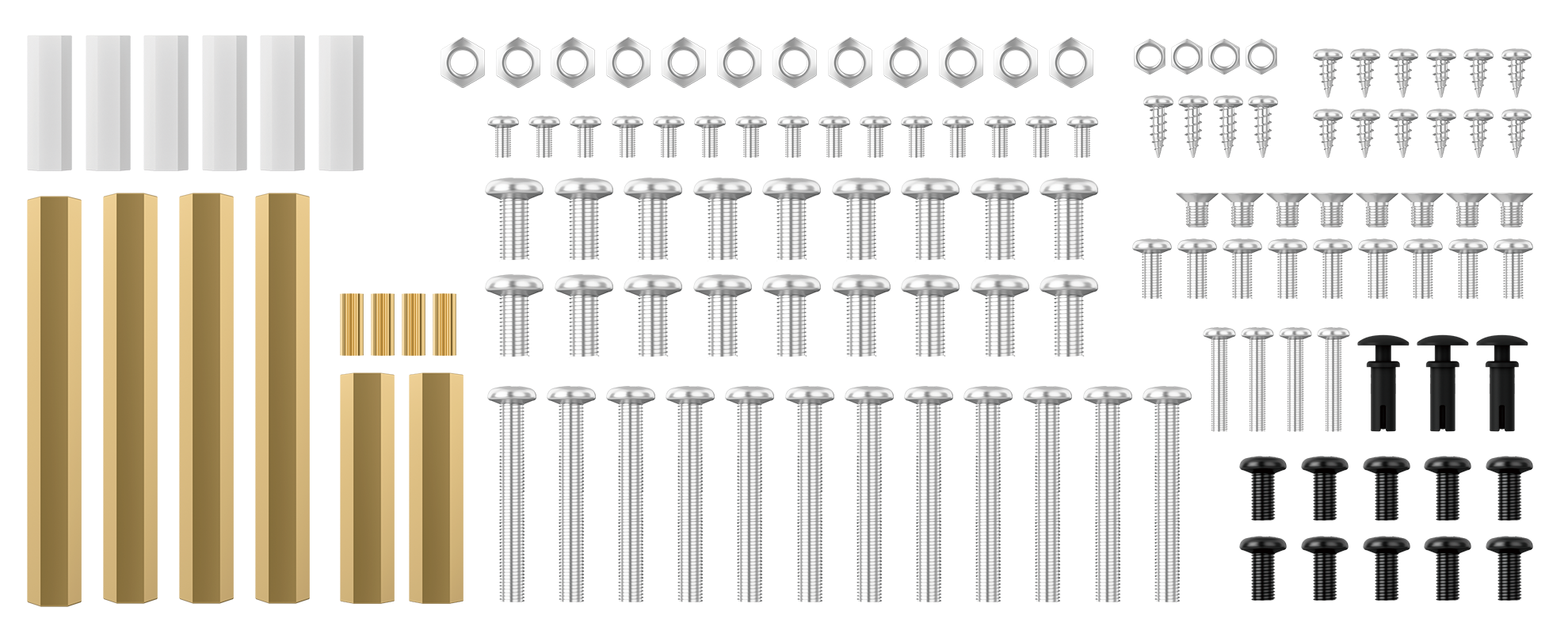

| 24 | Accessory bag (M2*8 Knurled double pass copper column*4 M2*4 round head screw*15 M2*12 round head screw*2 M2.5*6 round head screw*9 M3*25 round head screw*12 M4*8 round head screw*15 M3*6 round head screw*8 M2*4 round head self-tapping screw*12 M2*6 round head self-tapping screw*2 M3*4 flat head screw*8 double-ended nylon spacer*6 single-ended nylon spacer*6 M3 nut*12 M2 nut*4 Nylon rivet*3) |
1 | ![]() |

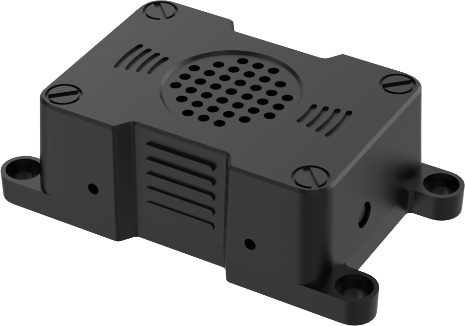

| 29 | WonderEcho Pro AI Voice interaction box | 1 | ![]() |

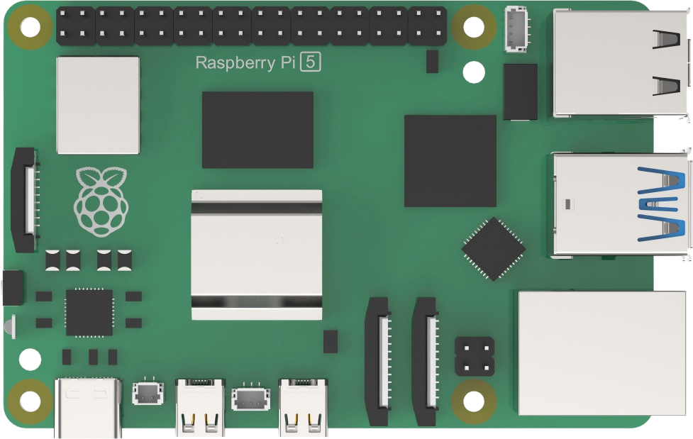

1.3.1 Overview of Raspberry Pi 5
Raspberry Pi 5 features a 64-bit quad-core Cortex A76 processor with 2.4 GHz operating frequency. Compared to the Raspberry Pi 4, the CPU performance has increased by 2 to 3 times. Apart from the significant improvement in graphics performance with the 800MHz VideoCore VII GPU, it also supports dual 4Kp60 display output via HDMI, and advanced camera through restructuring Raspberry Pi Image Signal Processor. It provides consumers with a smooth desktop experience and opens up new applications for industrial customers.
This is the first full-sized Raspberry Pi computer, utilizing chips built internally by Raspberry Pi. RP1 provides the majority of the I/O functions for Raspberry Pi 5 and achieves a significant leap in peripheral performance and functionality. The total USB bandwidth has more than doubled, thus speeding up the transfer rate to external UAS drives and other high-speed peripherals. The dedicated dual-channel 1Gbps MIPI camera and display interface on earlier models have been replaced by a pair of quad-channel 1.5Gbps MIPI transceivers, tripling the total bandwidth and supporting a maximum of two cameras or displays in any combination. By supporting SDR104 high-speed mode, the peak performance of the SD card is doubled. This platform introduces a single-channel PCI Express 2.0 interface for the first time, providing support for high-bandwidth peripherals.

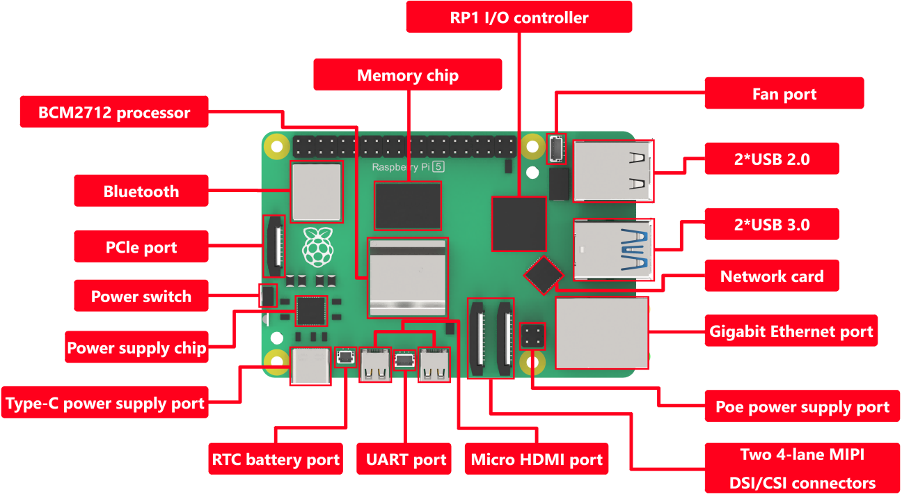

1.3.2 Structure and Features of Raspberry Pi 5
Hardware Layout
Main features
(1) Four Arm Cortex-A76 cores @ 2.4GHz, with hardware AES encryption support, 512KB L2 cache per core, and a 2MB L3 cache;
(2) 4GB or 8GB LPDDR4X-4267 SDRAM;
(3) Dual 4Kp60 HDMI display output, supporting HDR, and a 4Kp60 HEVC decoder;
(4) VideoCore VII Graphics, support OpenGL-ES 3.1、Vulkan 1.2;
(5) Raspberry Pi Image Signal Processor (ISP);
(6) The Raspberry Pi PCIe connector provides one PCIe 2.0 lane and requires an additional HAT for use;
(7) 802.11ac dual-band Wi-Fi and Bluetooth 5.0 with BLE support;
(8) Gigabit Ethernet;
(9) 2 × USB 2.0 ports and 2 × USB 3.0 ports, full bandwidth supported simultaneously;
(10) PoE support, PoE HAT required;
(11) Dual-channel, 4-lane MIPI CSI/DSI transceivers, supporting combinations of 2 × displays, 2 × cameras, or 1 display + 1 camera;
(12) 40-pin Raspberry Pi GPIO header;
(13) Fan connector;
(14) Real-Time Clock (RTC);
(15) Power button;

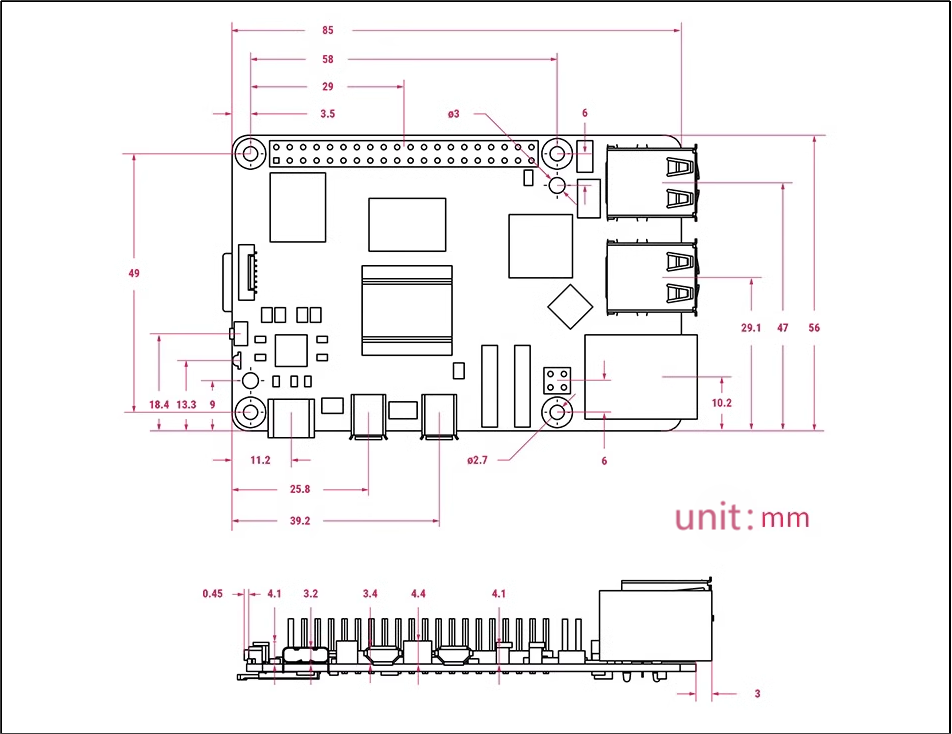

1.3.3 Dimension Diagram (unit: mm)

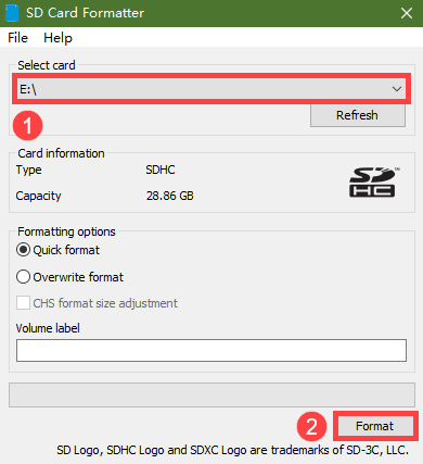

1.4.2 Format SD Card
if SD card is empty, you can skip this step.
(1) Insert SD card to card reader, and then connect it to your computer.
(2) Open SD Card Formatter. Select corresponding card, and then click “Format”.
(3) If window below appears, click “Yes”. It takes time to format. Please be patient!

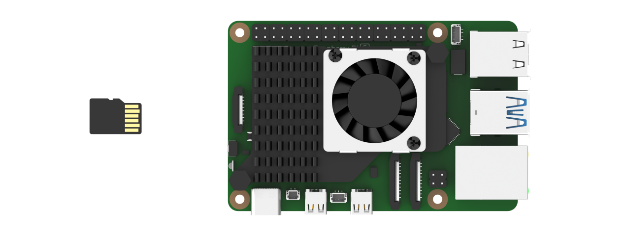

(4) After the image has been successfully flashed, eject the SD card and remove it from the card reader. Then insert it into the Raspberry Pi mainboard as shown in the figure below.

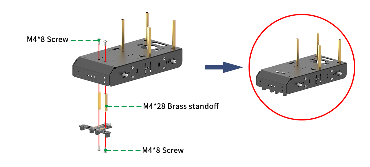

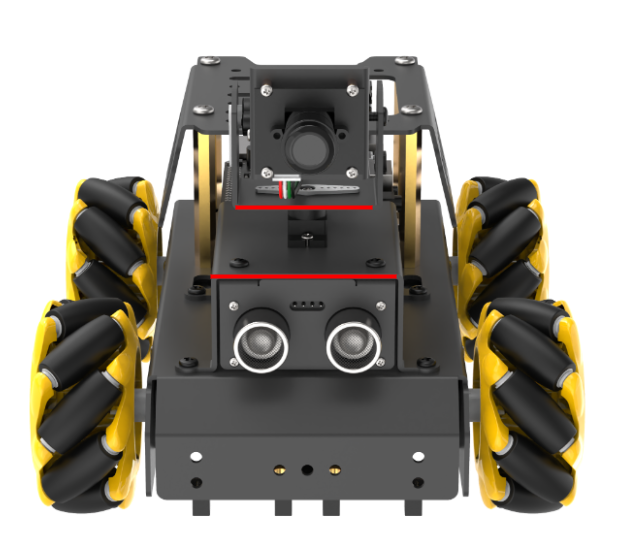

1.5 Assembly

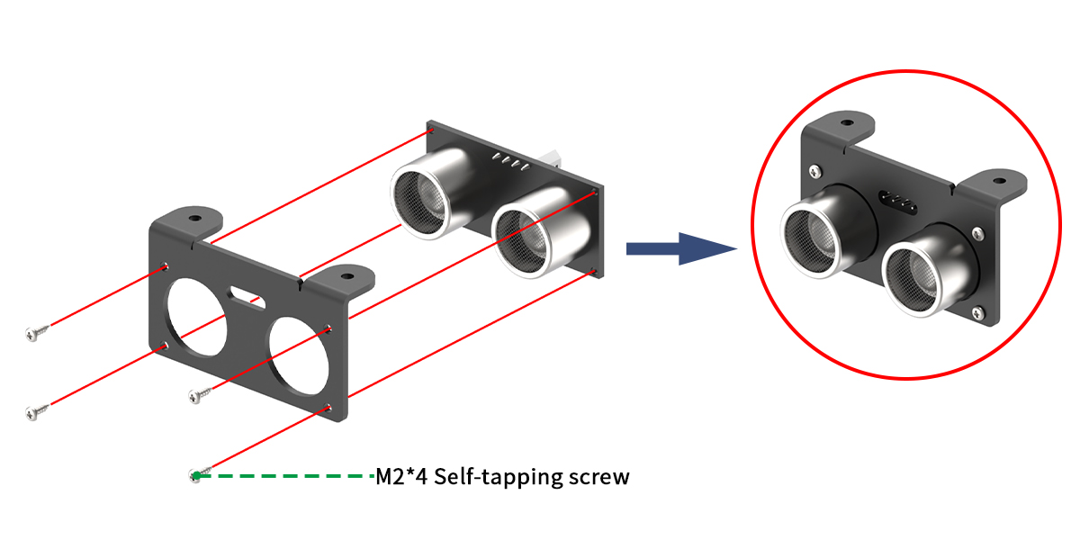

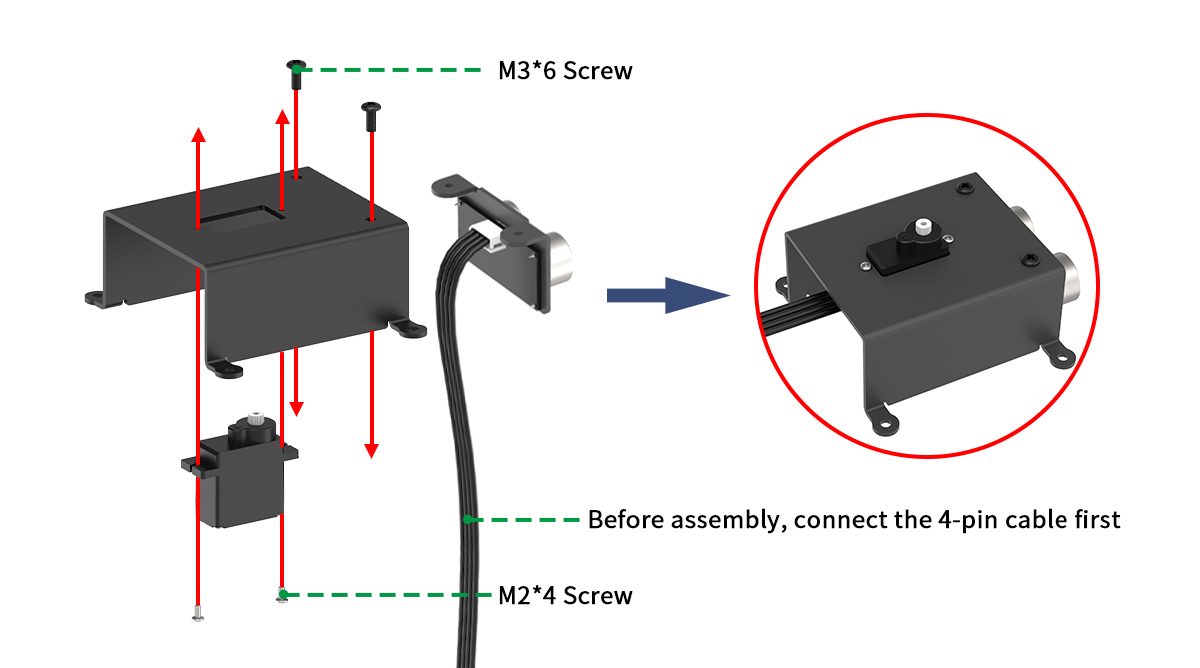

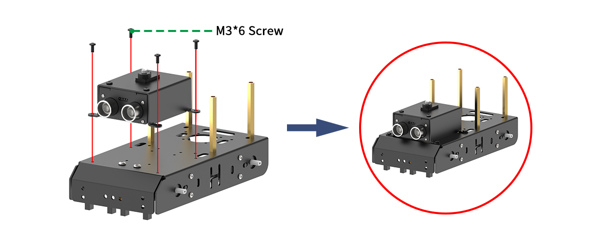

Step1:Install ultrasonic sensor and pan-tilt servo

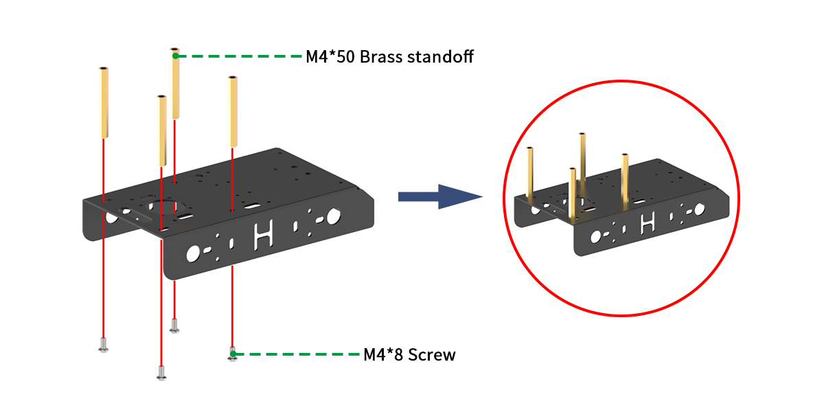

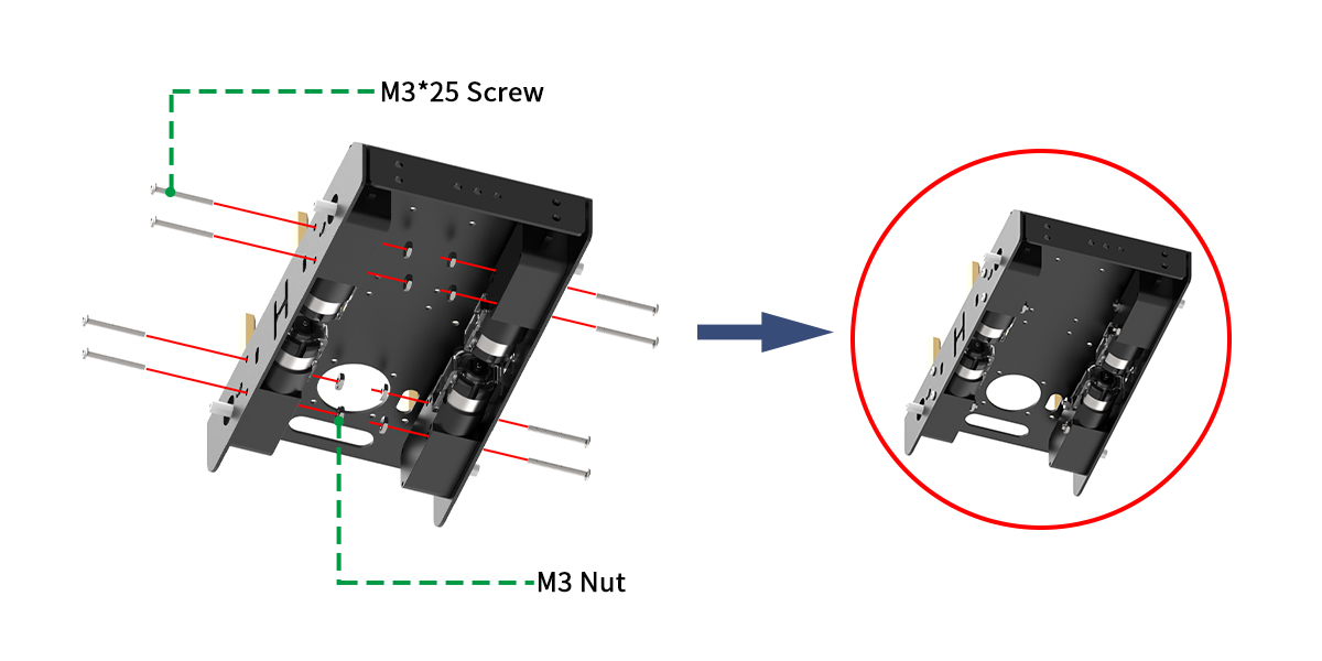

Step2:Install Mecanum wheel chassis

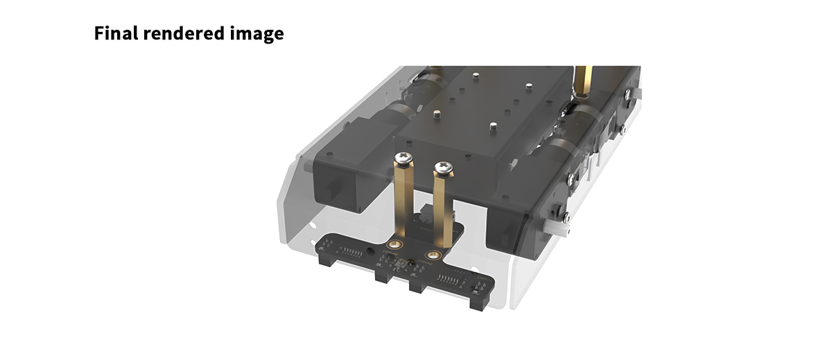

Step3:Install line follower

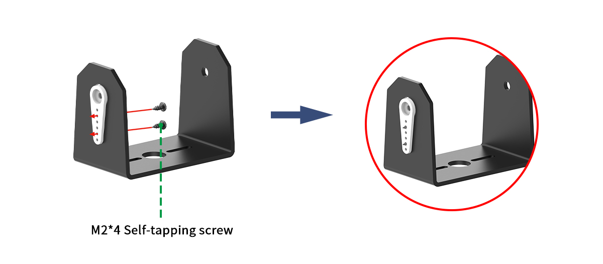

Step4:Install pan-tilt servo bracket

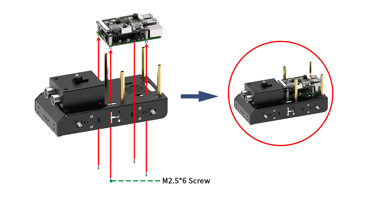

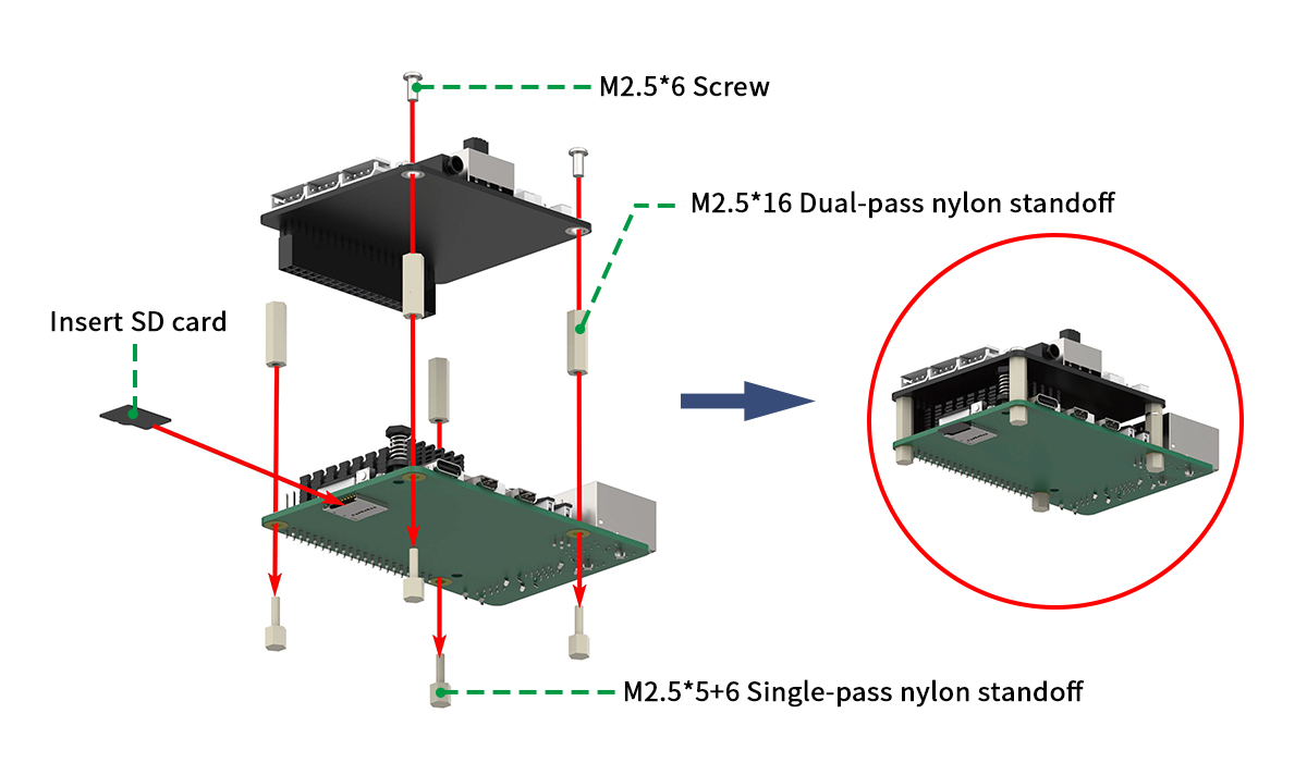

Step5:Install Raspberry Pi 5 and expansion board

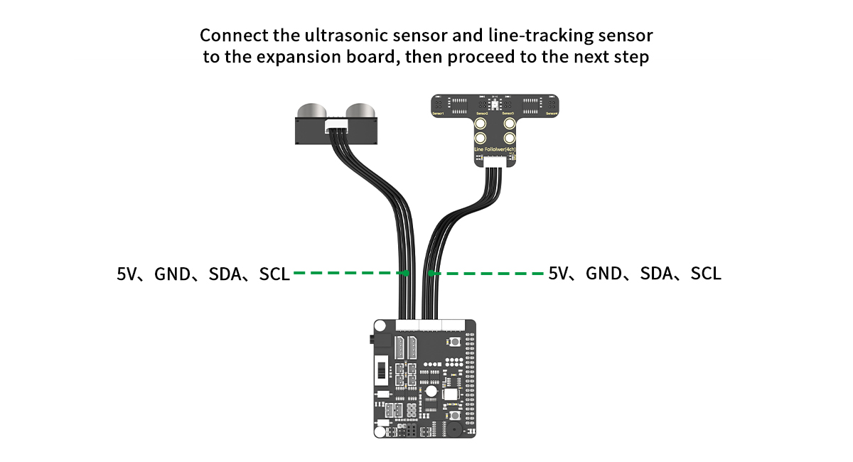

Step6:Ultrasonic sensor and line follower wiring

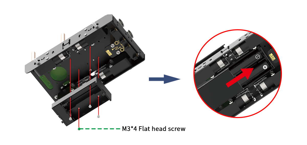

Step7:Install battery box

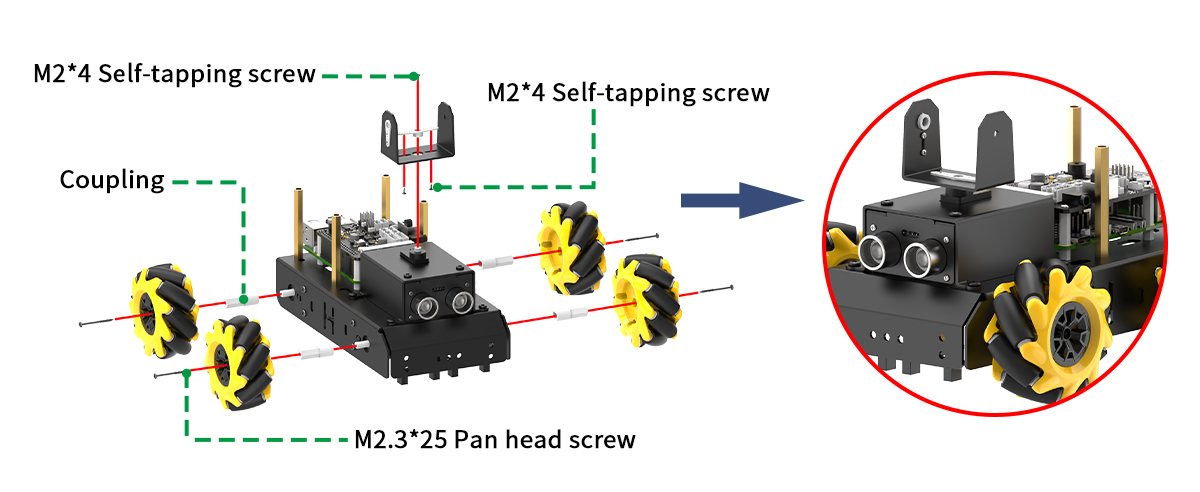

Step8:Install U shaped bracket and Mecanum wheels

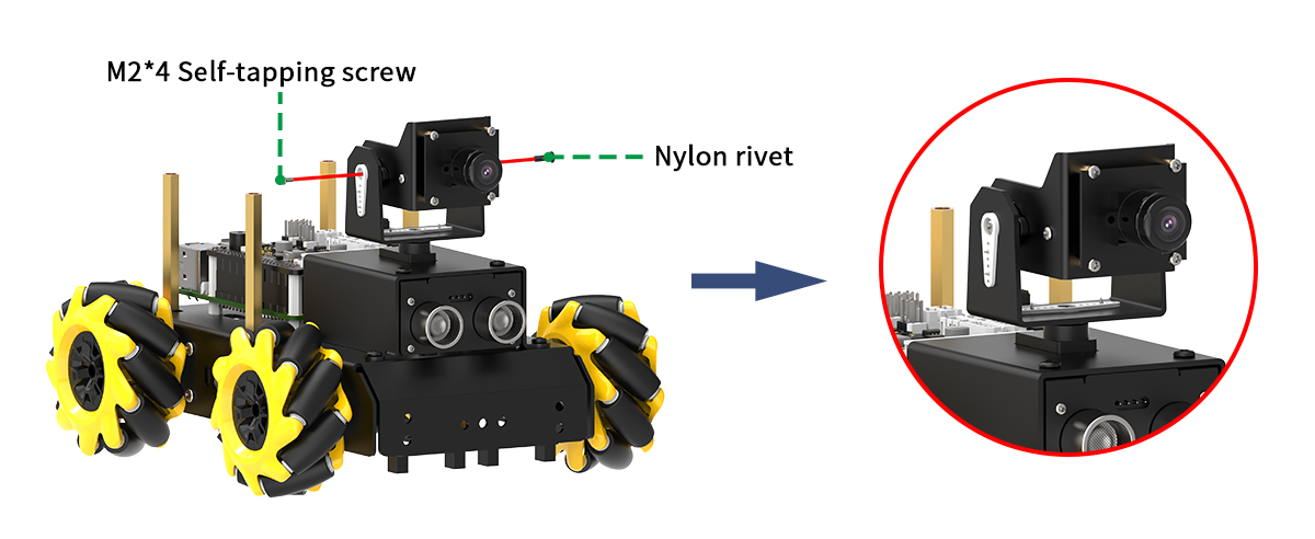

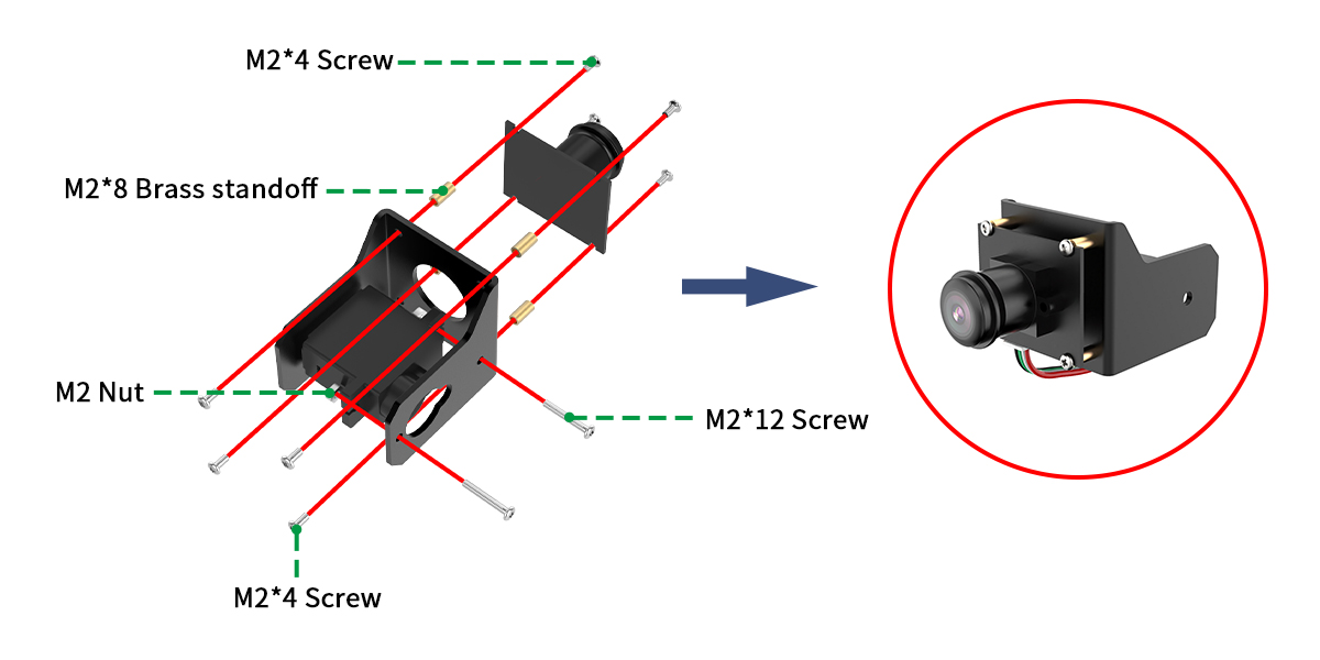

Step9:Install head servo and camera

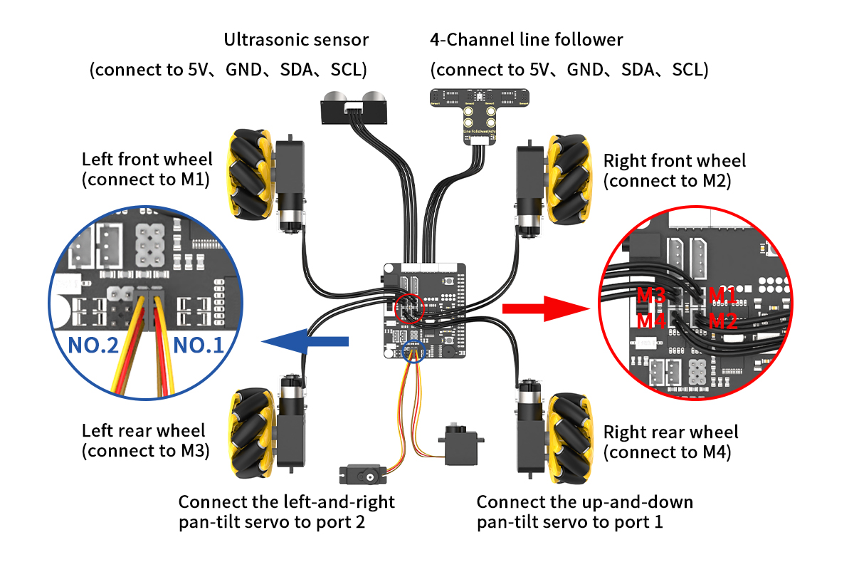

Step10:Wiring Diagram

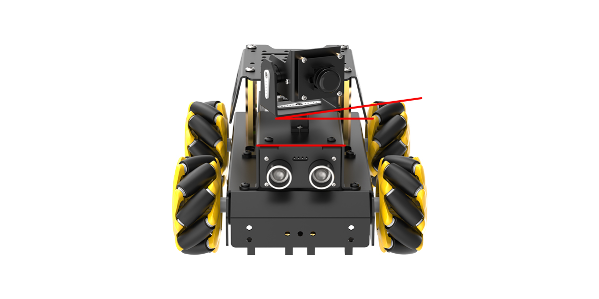

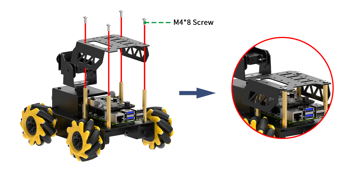

Step11:Install top bracket

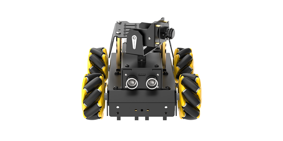

Post installation

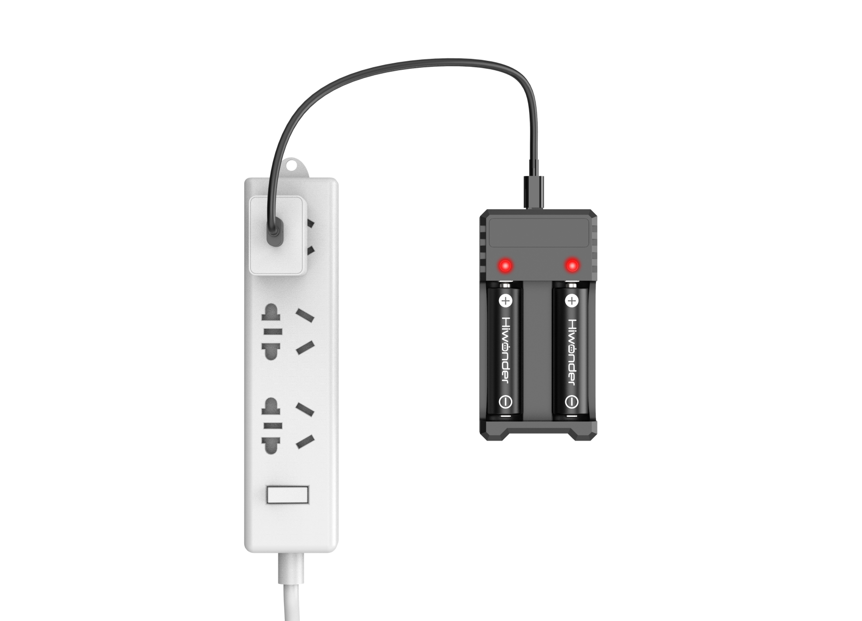

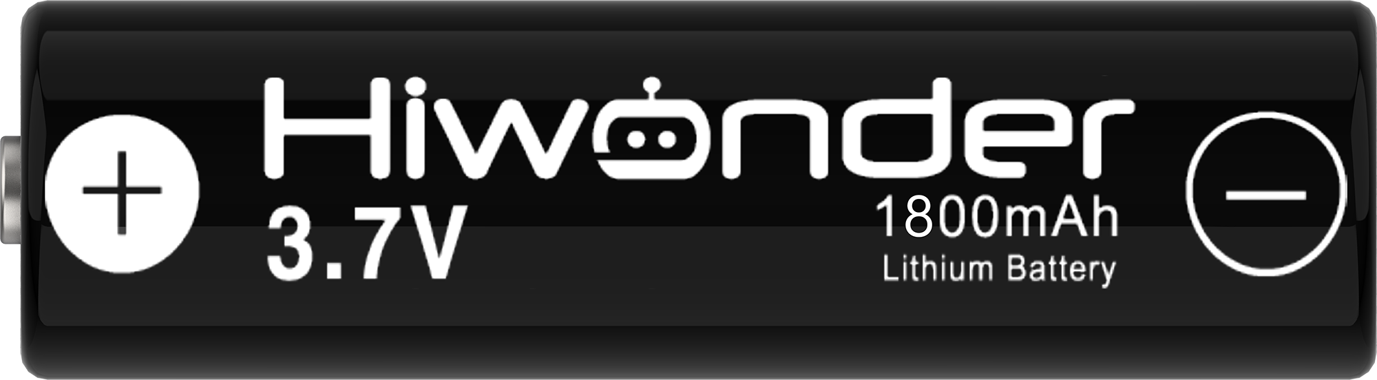

1.6.1 Battery Charging and Installation
Due to transportation restrictions, the battery is not fully charged upon delivery. It is recommended to fully charge the battery before the first use. Follow the steps below:

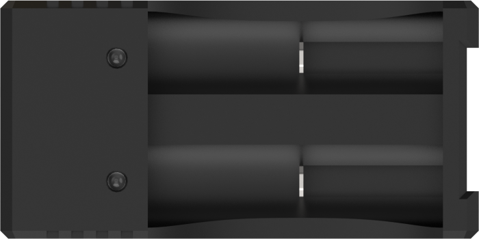

(1) Put two 18650 batteries into the battery charger. Note: Don’t invert battery terminals! Then connect battery charger and charger head of 5V 3A (It is not included, and you need to use your own charger head.) Lastly, plug the charger head into power outlet.
(2) The charger’s indicator light is green when unplugged, and turns red when charging. It takes approximately 3 hours to fully charge the batteries and the light turns green again. Unplug the charger promptly after charging. Do not leave it connected for an extended period.

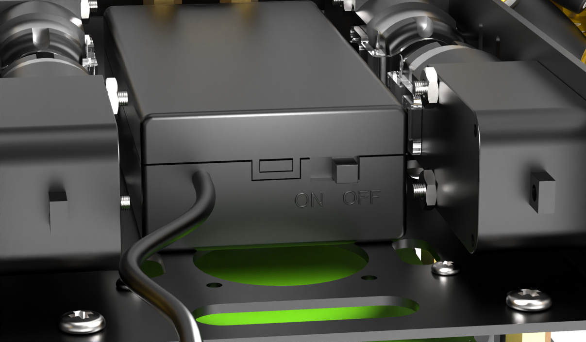

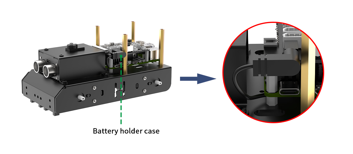

1.6.2 Installing the Battery
(1) Before installing, make sure the switch on the battery case is set to “OFF”.
(2) Insert the fully charged batteries into the battery case and close the battery cover. Caution: Do not reverse the battery polarity!

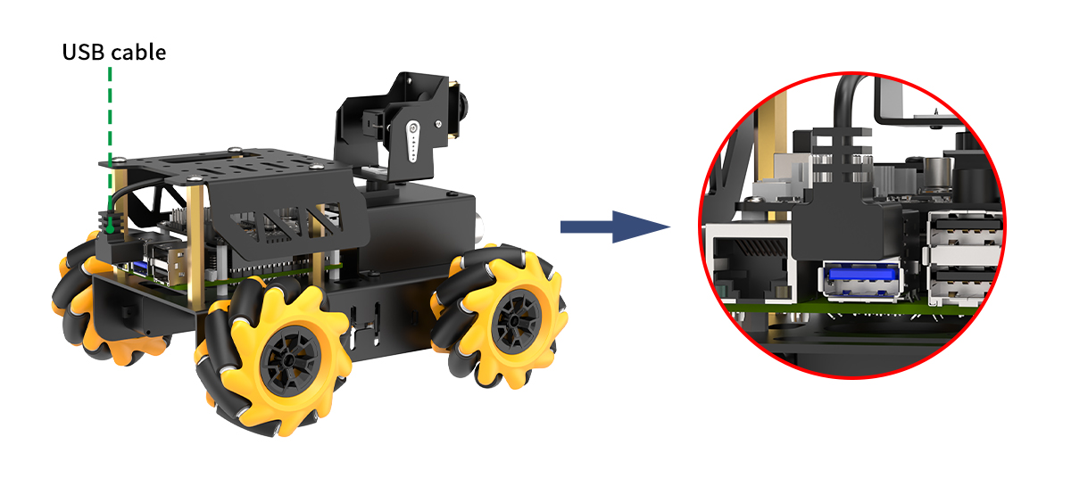

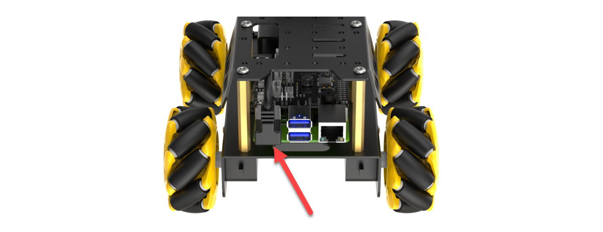

1.6.3 Check Whether Camera is Connected
Before powering on, ensure the camera’s USB cable is securely connected. It can be plugged into any of the four USB ports on the Raspberry Pi controller.

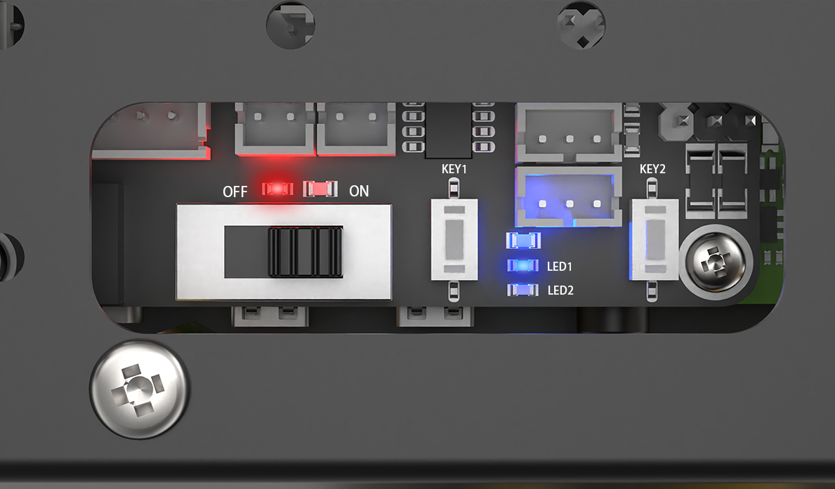

1.6.4 Start TurboPi
(1) Turn on battery case. Then start TurboPi. (The switch is on Raspberry Pi expansion board.) At this time, LED1 and LED 2 on Raspberry Pi keep on. Then LED2 flickers every 1s, pan tilt recovers initial posture and buzzer emits a beep, which means that TurboPi boots up successfully.
The Raspberry Pi is a computer and requires some time to boot. Startup takes around 30 seconds, so please be patient.
LED1 is the power indicator. It lights up when powered and stays on during operation. If it dims, it means the battery is low and needs to be recharged.
LED2 is the communication indicator. By default, the device uses AP (Access Point) mode, where LED2 blinks once every second after boot-up. If switched to LAN mode, LED2 will stay on constantly. For more details, refer to”2.Quick User Experience\2.1 APP Installation and Connection”.
If both LED1 and LED2 are dim and remain constantly on, the battery is low and needs recharging.

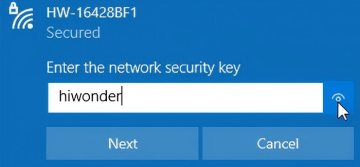

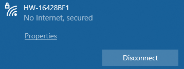

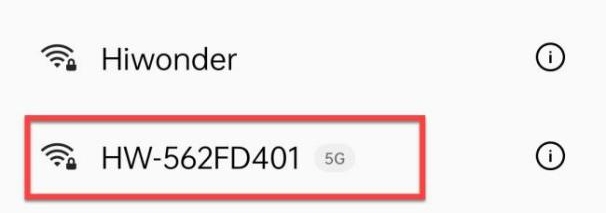

(2) Upon successful startup, the device will automatically generate a Wi-Fi hotspot beginning with “HW” in AP mode.

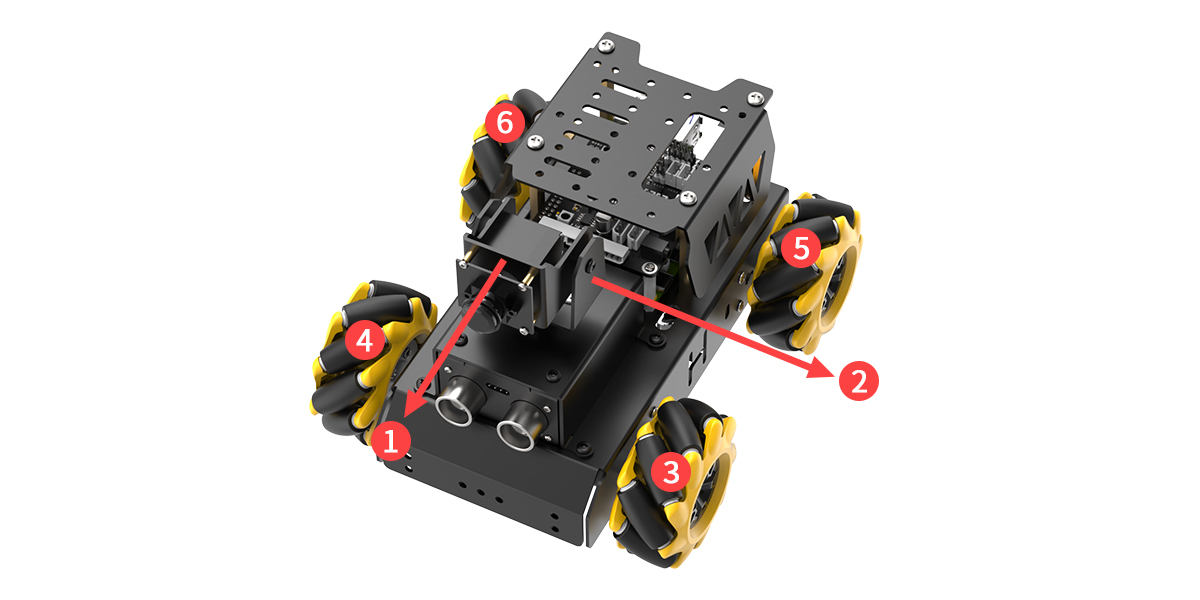

1.6.5 Run Self-detection Program
After robot starts, you can press KEY1 to run self-detection program to detect servos and motors so as to ensure wiring is correct. If robot cannot move as below after self-detection program runs, you need to rewire according to “Read First\1.5 Assembly”.
(1) Press KEY1 on expansion board to start self-detection.
(2) Servos and motors move in the order as pictured.

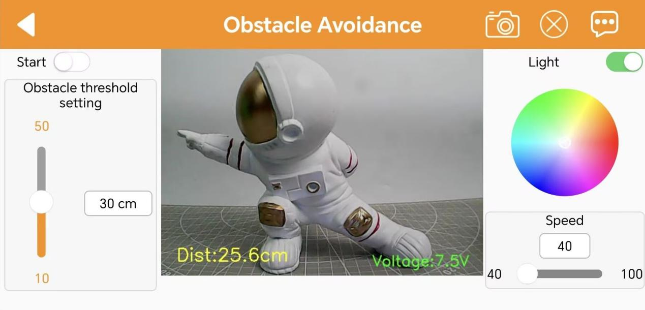

Method 2: App Interface
The real-time battery level is displayed on the video feedback screen in the app. When the voltage drops below 7.1V, a low battery warning is shown and the battery must be recharged promptly. For more on the app experience, see “Play Modes in the App”

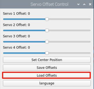

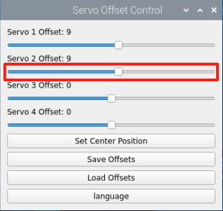

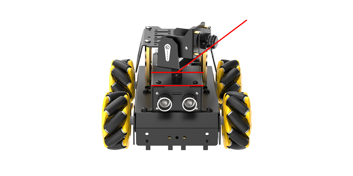

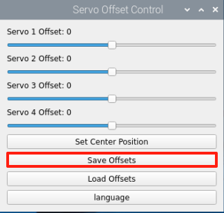

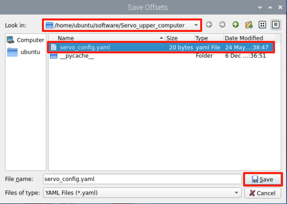

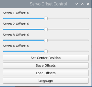

Having completed above operations, calibrate deviation of pan tilt according to “ Read First\1.9 Adjust Pan-Tilt”. Please don’t skip this step.

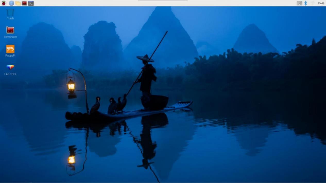

1.7 Remote Desktop Installation and Connection
For this section, you’ll need a laptop. If you’re using a desktop, make sure you have a wireless network adapter. You can refer to the demonstration video in this section’s folder. This guide uses the Windows version as an example. For Mac installation, please search for relevant resources online.
1.7.1 Getting Started

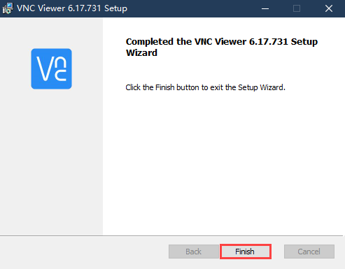

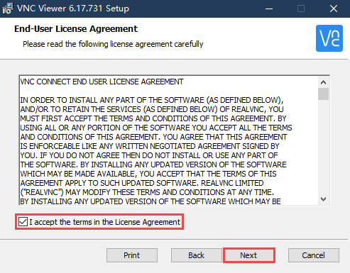

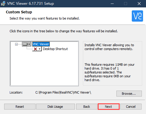

Installing the VNC Remote Tool
If you wish to operate the robot from your computer, view the program logic, or modify the code in the future, you need to install the VNC software by following the steps in this chapter.
VNC (Virtual Network Computing) is a graphical remote desktop control software. By connecting to the Wi-Fi hotspot broadcast by the Raspberry Pi, you can remotely control the device from your computer. The steps below explain how to install and use VNC Viewer.
(1) Double-click the installation program VNC-Viewer-6.17.731-Windows in the same directory as this section. choose the installation language as “English”, then click “OK”.
(2) On the next screen, click “Next”.
(3) Agree to the license agreement, then click “Next”. Keep the default installation path, and click “Next”.
(4) Click “Install” to begin installation.
(5) Wait for the installation to complete, then click “Finish”.
(6) After installation, launch VNC Viewer by clicking its desktop icon
Power on
Follow the previous steps to assemble the hardware and connect the power adapter. Flip the power switch on the Raspberry Pi expansion board to the “ON” position. Wait a few seconds. Once LED2 on the expansion board switches from being constantly on to blinking once every second, the device has successfully powered on.

(1) After the robot is powered on, it will create a Wi-Fi hotspot starting with “HW”. On your computer, open the Wi-Fi settings and search for a network with a name that begins with “HW”, as shown below:
(2) Input password. The password is “hiwonder”.

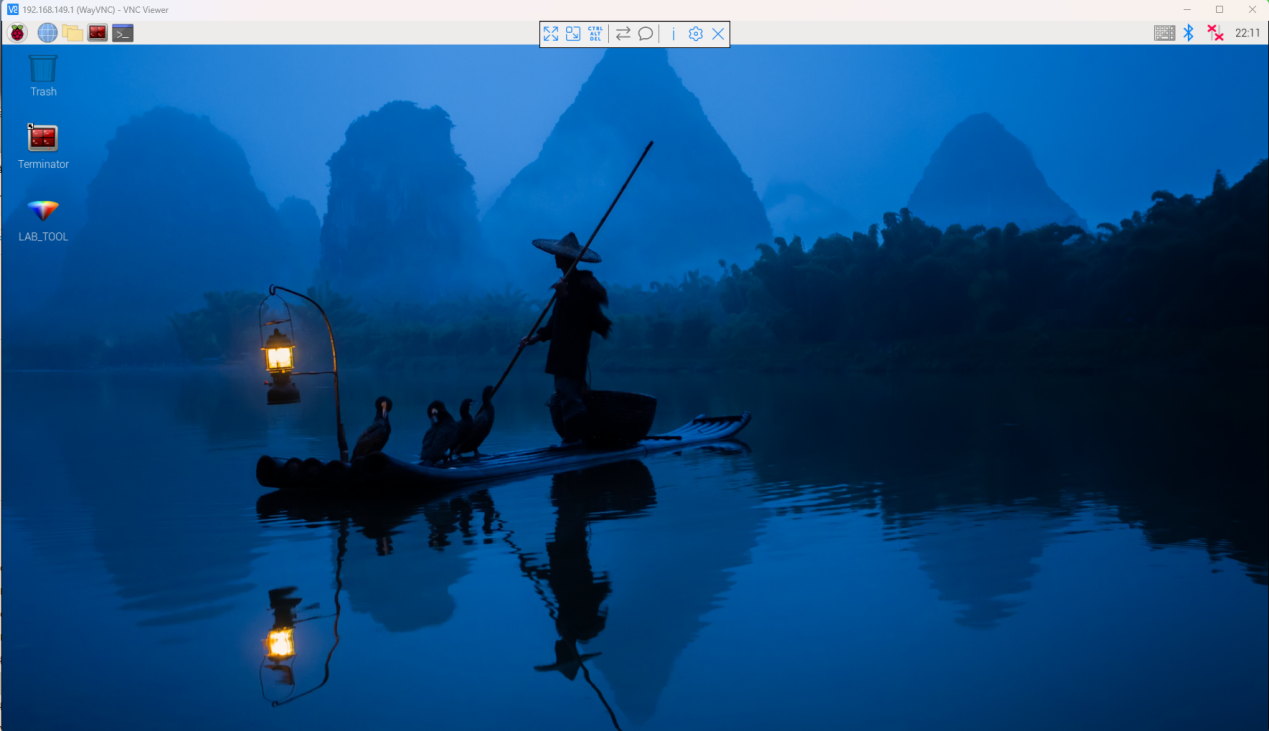

Check the “Remember password” option, then click “OK”. You should now see the Raspberry Pi desktop.
(5) There may be a warning dialog box, which is a standard Raspberry Pi message. Click “OK” to close it. If the screen is black and only a cursor is visible, try restarting the Raspberry Pi.
Each feature experiment will have detailed startup steps in the subsequent course chapters. Please follow them accordingly.
1.7.3 Introduction to Desktop
The desktop is as pictured after connecting Robot through VNC successfully.

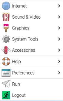

The following table demonstrates common functions:
| Icon | Function |
Application menu. Click to select different applications.
Browser. |
File manager. |
LX terminal. Click to input command line in the opened interface. |
Trash. You can find the files deleted here. |
PC software. You can adjust pan tilt and adjust color threshold on it. |
Full screen or exit full screen.。 |
Exit full screen. |
Shut down, reboot and logout

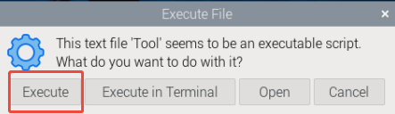

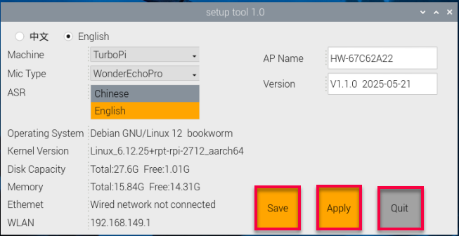

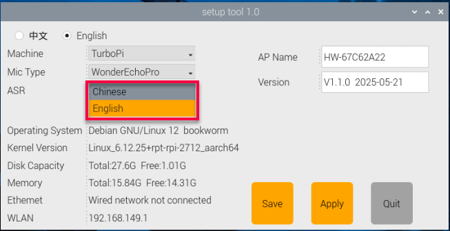

(3) Double-click the “Tool” icon
to launch the robot system configuration tool, then click “Execute”.
(4) and select the appropriate language model in the pop-up interface. This configuration requires setting up the large model according to the selected language version.
(5) After selection, click Save > Apply > Exit to activate the new configuration.
(6) When the buzzer beeps once, it means the robot type has been successfully switched. Open the terminal again
to view the ROS2 environment.

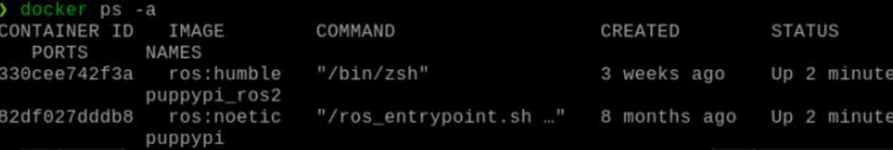

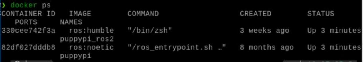

View Containers
The system is preset to enter the container at startup. The following is for your understanding.
Command syntax: docker ps [OPTIONS]
Common options:
① -a: Lists all containers, including running and exited
② -l: Shows the most recently created container
③ -n=?: Shows the most recent n containers
④ -q: Quiet mode, only shows container IDs
This command displays all running and previously run containers. Output includes the container ID, image name, creation time, and current status.
docker ps -a

(2) Use the shortcut key combination Ctrl + P + Q — this will detach from the container without stopping it. You can then enter a command in the terminal to check the running containers.
docker ps

1.9.2 Judge the Deviation Degree
(1) Servos automatically reset as TurboPi starts. If these three parts of robot are parallel, you don’t need to calibrate deviation and skip following operations.
(2) If the angle between servo and center line is less than 13°, you can directly adjust the deviation through PC software since the deviation is minor. For detailed instruction, please refer to “1.9.3 Calibrate Minor Deviation”.
(3) If the angle between servo and center line is greater than 13°, you cannot directly adjust the deviation through PC software since the deviation is large. For detailed instruction, please refer to “1.9.4 Calibrate Large Deviation”.
(1) Click the desktop icon
to open the terminal, then switch to the corresponding directory.
cd software/Servo_upper_computer/
(2) Launch the servo debugging software.
python3 main.py

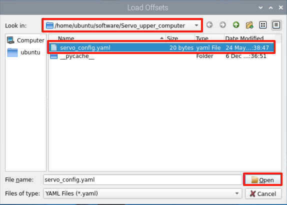

(3) Click the “Load Offsets” button, then select the .yaml file located at: /home/ubuntu/software/Servo_upper_computer to load the servo deviations.
(4) Drag the slider for Servo 2 to adjust the TurboPi’s U-shaped bracket so that it is parallel with the base bracket.
The adjustable range is from 1372 to 1627. If the U-shaped bracket can be aligned within this range, it is considered a minor deviation. If the required adjustment exceeds this range, it is considered a major deviation, and you should follow the section 1.9.4 Calibrate Large Deviation of this document.

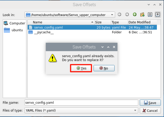

(5) After adjustment, click “Save Offsets”, select the .yaml file under the directory of /home/ubuntu/software/Servo_upper_computer to save the updated deviation values to TurboPi.
(6) In the pop-up confirmation dialog, select “Yes” to complete the saving process.

Before calibrating large deviation, you need to remove the servo from pan tilt. Next, center the servo, and then calibrate the deviation.
(1) Servos automatically reset as TurboPi starts. Obviously, NO.2 servo has deviation. Angle between servo and center line is greater than 13°.
(2) Turn off TurboPi. Never operate when TurboPi is turned on.

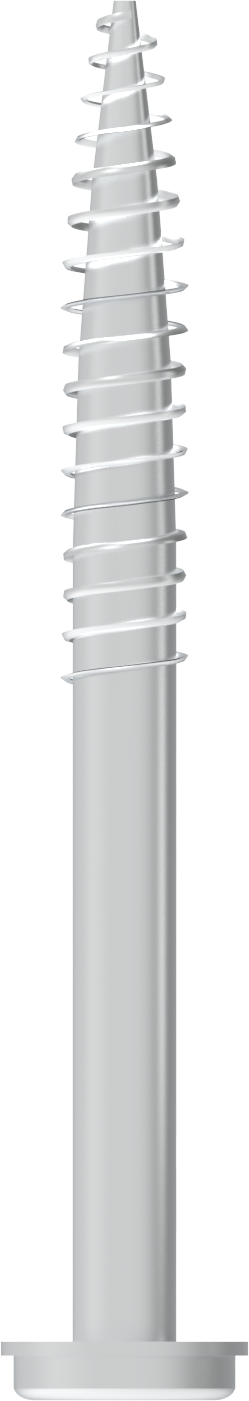

(3) Remove screw on the main shaft of NO.2 servo.
(4) Slightly pull out the U-shaped bracket.
(5) Turn on robot. (The switch is on Raspberry Pi) Robot emits a beep when it starts. At this time, servos are automatically centered. After servos are centered, turn off robot.
(6) Install U-shaped bracket on NO.2 servo as pictured.
Don’t move servo when installing the bracket. If you move the servo accidentally, please repeat Step 5.
(7) Put the screw back. Then make fine adjustment according to “1.9.3 Calibrate Minor Deviation”.
