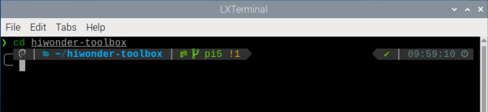

(4) In the terminal, enter the command “cd hiwonder-toolbox” and press Enter to navigate to the Wi-Fi configuration directory.
cd hiwonder-toolbox

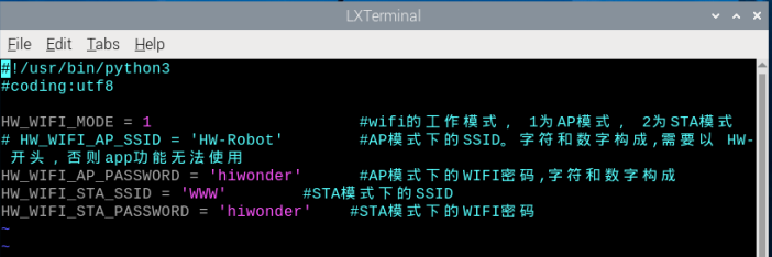

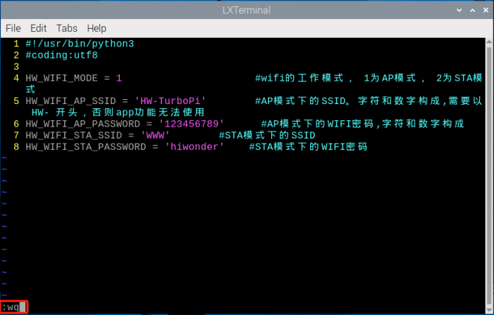

(6) The interface is shown as below:
(7) Enter :set number and press Enter to show line numbers, you can set as needed.
:set number
(8) Press the “i” key on your keyboard, and you will see “–INSERT–” at the bottom left of the screen, indicating that the file is now editable. You can now modify the file according to your needs, referring to the corresponding comments.

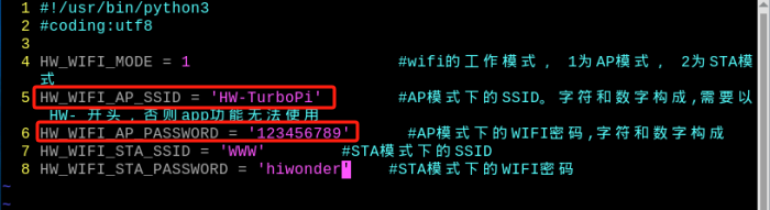

(9) Suppose you want to change the Wi-Fi name of the Raspberry Pi to “HW-TurboPi” and the password to “123456789”, then you only need to modify the program as shown in the figure below.
You can set the Wi-Fi name and password according to your needs, but the following rules must be followed:
① The set Wi-Fi name cannot be the same as any existing router name and must start with “HW”.
② The password must be at least 8 characters.
To restore the original settings, simply reverse the above operations.

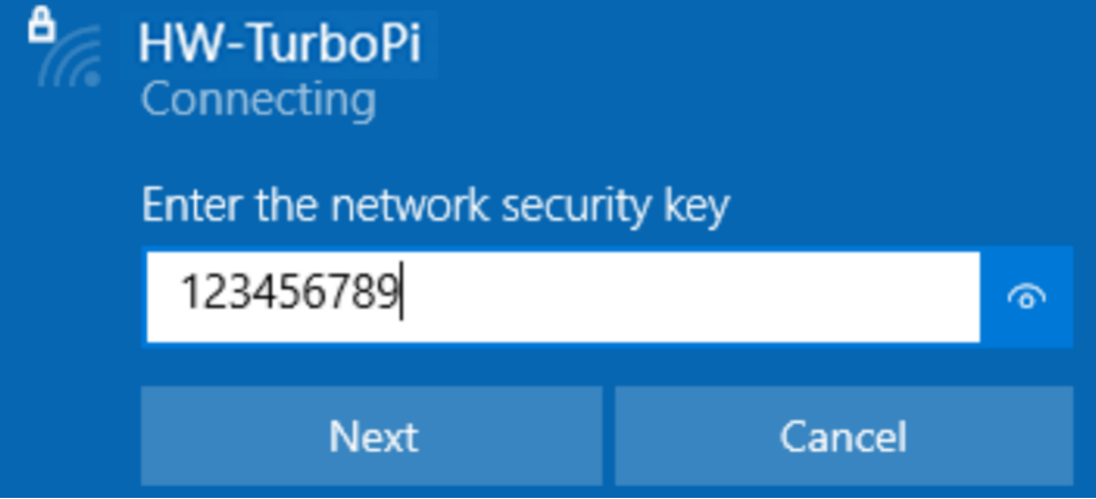

(12) Wait for the device to reboot and connect to the “HW-TurboPi” network, with the password “123456789”.

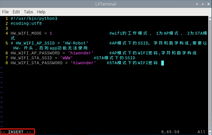

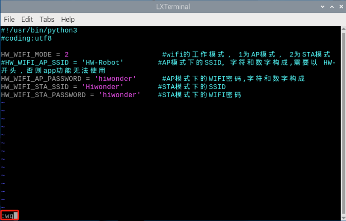

(7) Enter “:set number” and press Enter to show line numbers, you can set as needed.
:set number
(8) Press the “i” key on your keyboard, and you will see “–INSERT–” at the bottom left of the screen.

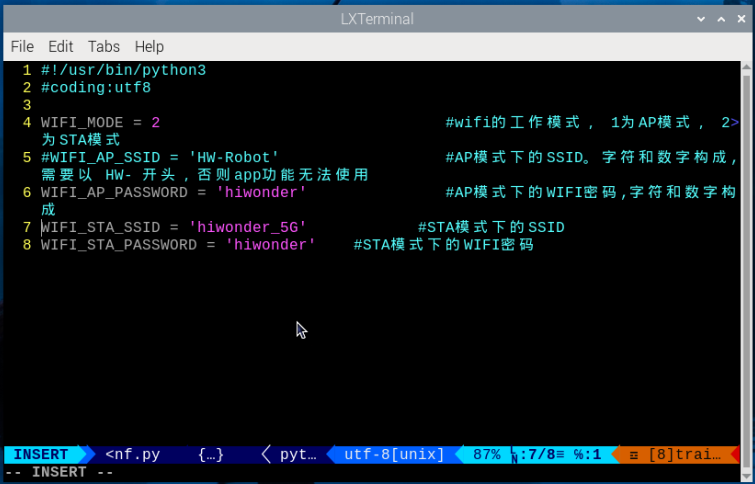

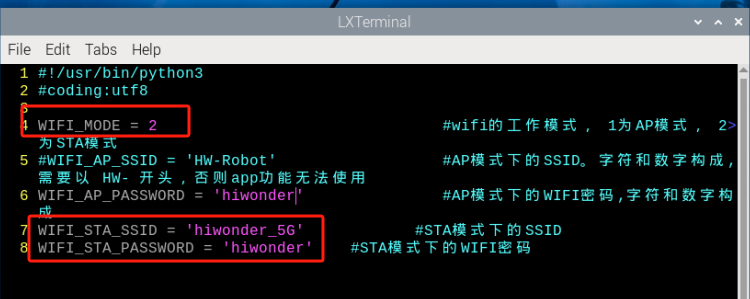

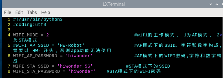

(9) Change the mode to STA (LAN) mode. Modify the program as shown in the example below.
The following uses connection to the “Hiwonder” network as an example. You can modify it based on your need. To revert to the original configuration, change HW-WIFI-MODE = 2 back to 1 to switch the Wi-Fi mode to AP mode.
Avoid using campus networks or Wi-Fi names that contain Chinese characters.
(10) After completing the modifications, press the “ESC” key on your keyboard, then enter :wq to save and exit the file.
(11) Enter the command “sudo systemctl restart wifi.service” in the terminal, and the VNC will automatically disconnect and restart. If the robot’s LED2 remains steadily on, it indicates the mode has been successfully changed to LAN.

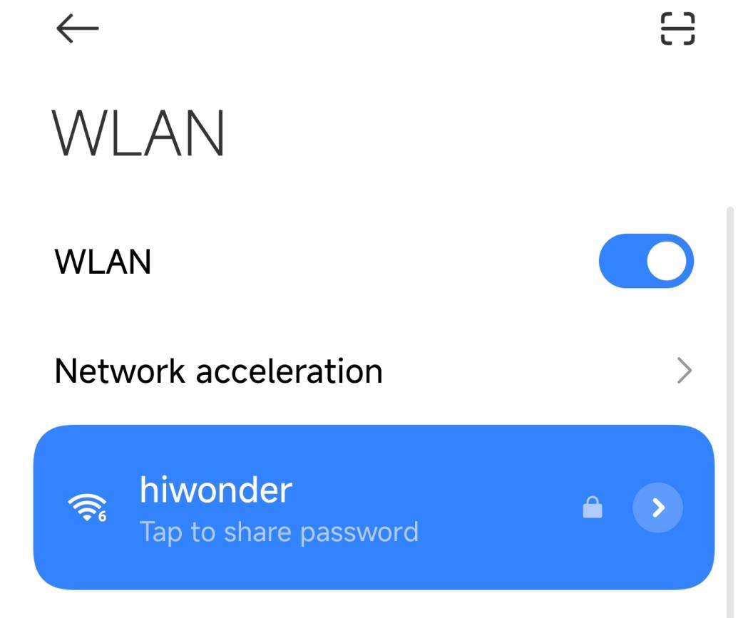

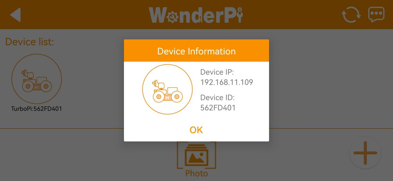

(12) To check the Raspberry Pi’s IP address using the mobile app, first connect your phone to the same LAN, “Hiwonder” in this case.

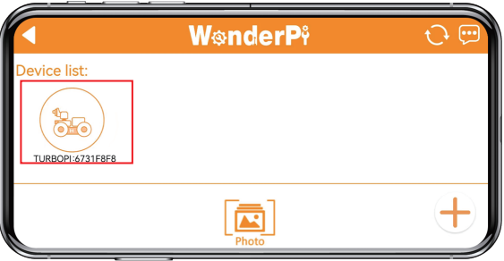

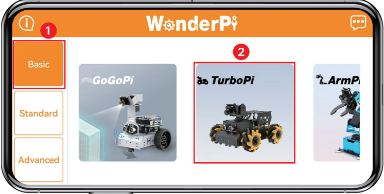

(13) Open the WonderPi app and select “Basic” > “TurboPi”.
(14) Once the app connects to TurboPi, you’ll see an icon like the one below indicating a successful connection.
(15) Long-press the corresponding icon of your robot in the app to view its assigned IP address and Device ID.

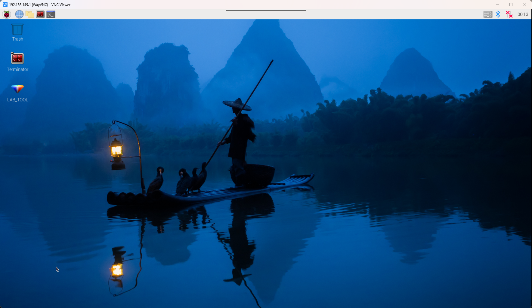

(16) Open the VNC software, enter the IP 192.168.11.109 to connect.
(17) After a successful connection, the VNC remote desktop will display as shown below.
