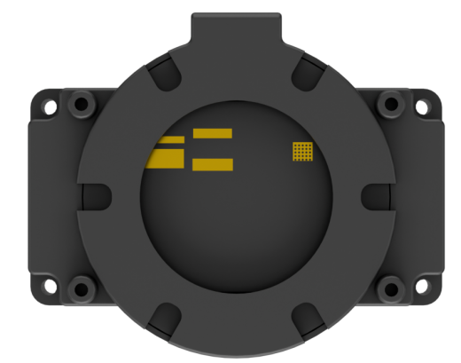

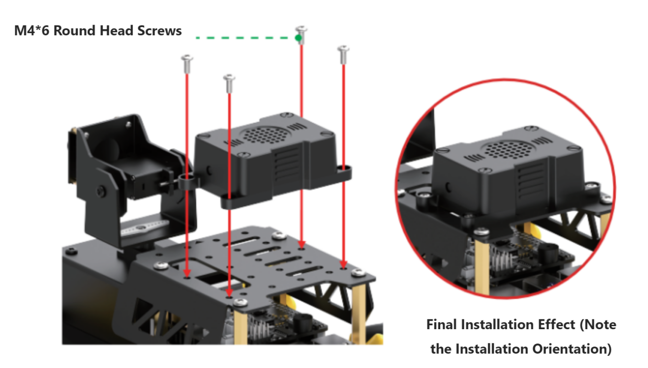

8.1.2 WonderEchoPro Installation

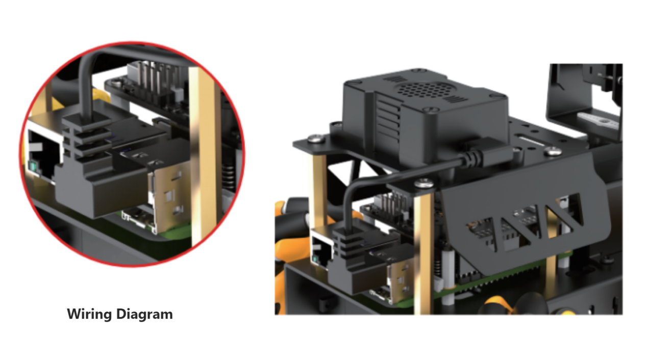

When installing the WonderEcho Pro, ensure that the front of the robot is facing forward, and the USB port of the WonderEcho Pro is facing to the right, which is opposite to the direction of the Raspberry Pi’s USB ports.
Connect the WonderEcho Pro as shown in the diagram above, aligning the ports accordingly.

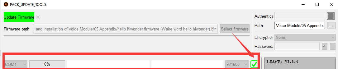

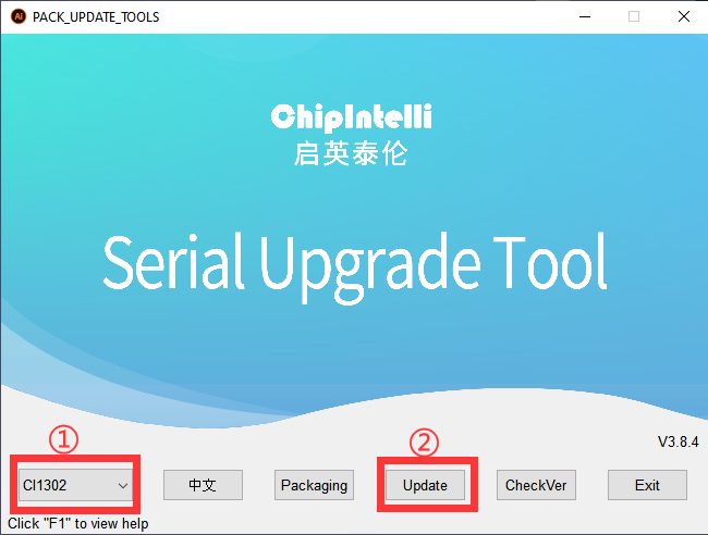

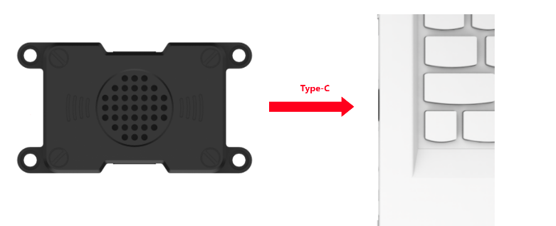

(1) Begin by connecting the WonderEcho Pro to your computer using a Type-C data cable.
(2) Open the file ACK_UPDATE_TOOL.exe located in 8.1.5 Appendix->Firmware Flashing Tool. Select the “CI1302” chip and click “Firmware Upgrade”.
For this example, we will use the “hello hiwonder firmware” (Wake word: “hello hiwonder”).
(3) Select the firmware by locating the “hello hiwonder firmware (Wake word: hello hiwonder).bin” file under the “8.1.5 Appendix” path.
(4) Identify the correct COM port and select it.
(5) Press the RST button on the WonderEcho Pro to initiate the flashing process. Wait for the process to complete successfully.

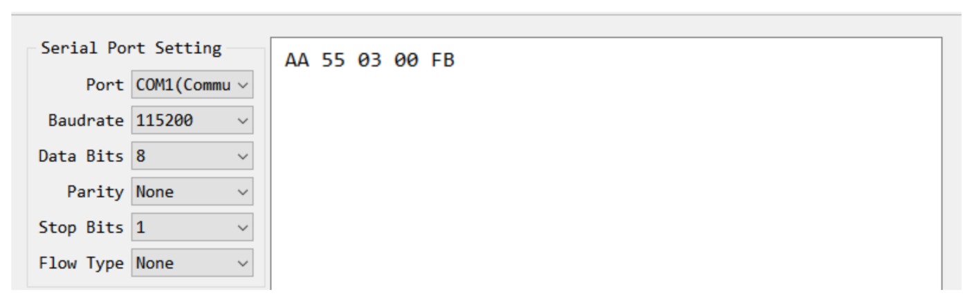

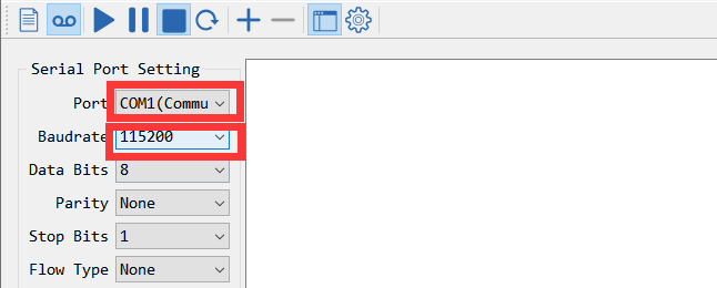

After flashing the firmware, follow the steps in Appendix->5.6 Serial Port Debugging Tool to install the serial port debugging tool. Then, follow the steps below to test whether the firmware is functioning correctly.
(1) Connect the WonderEcho Pro to your computer’s USB port using a Type-C to USB adapter.
(2) Open the Serial Port Utility, select the connected COM port (including CH340), and set the baud rate to 115200, as shown in the image below.
(3) Say the wake word “hello hiwonder” as configured in the firmware settings. The corresponding flag information “AA 55 03 00 FB” will appear on the right side, confirming that the wake word was successfully recognized.

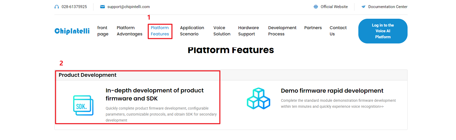

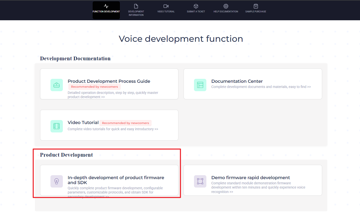

(1) First, open the ChipIntelli Voice AI Platform using the following link: https://aiplatform.chipintelli.com/home/index.html
(2) Click the “Platform Features” tab in the menu bar, then navigate to “In-depth development of Product Firmware & SDK” under the Product Development section.
(3) The system will prompt you to log in. If you do not have an account yet, please complete the registration first. For international users, we provide a shared account:Username: 18033085495Password: hiwonder
Once logged in, click “In-depth development of Product Firmware & SDK” again.

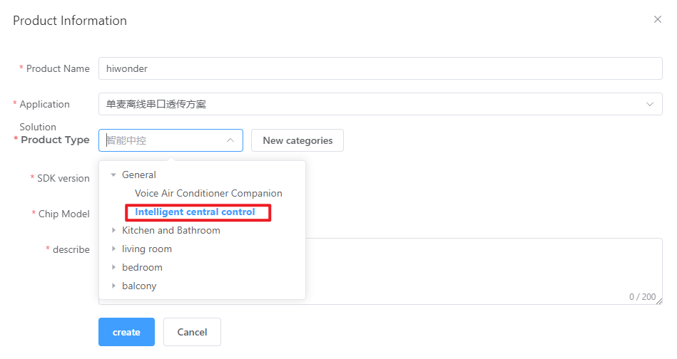

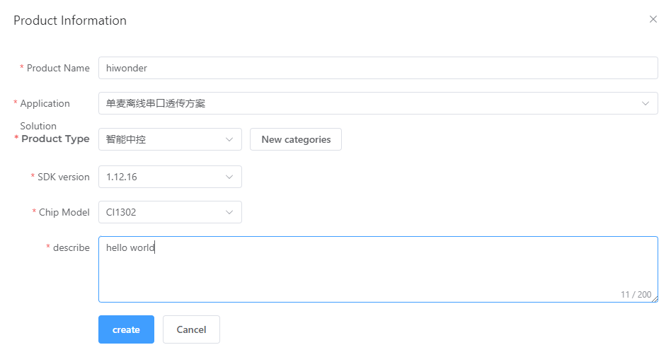

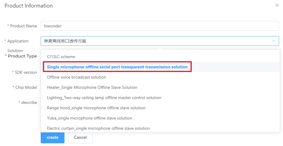

(4) When the page redirects, click the option on the left panel to create a new product as shown in the image below. Product name and description can be customized. Other fields must be selected according to the red boxes in the example. Product type needs to select Select General -> Smart Control Hub, then click “Create” to complete.

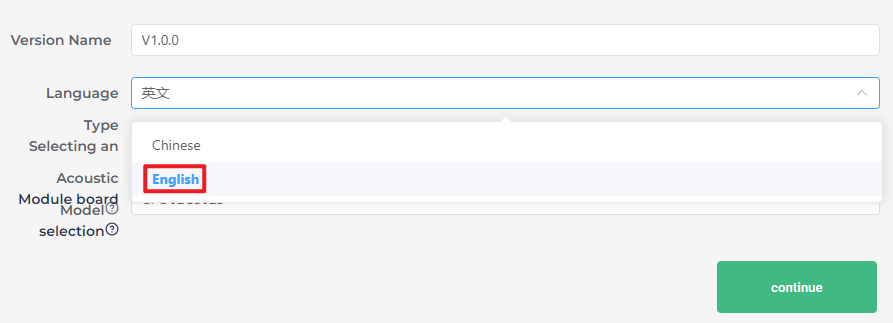

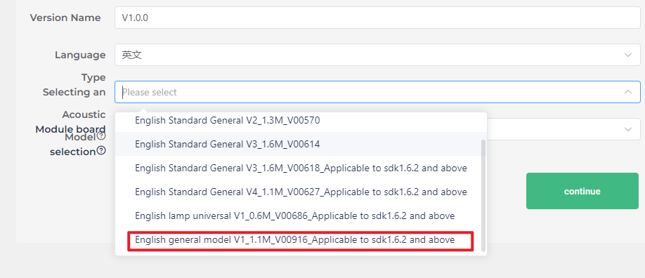

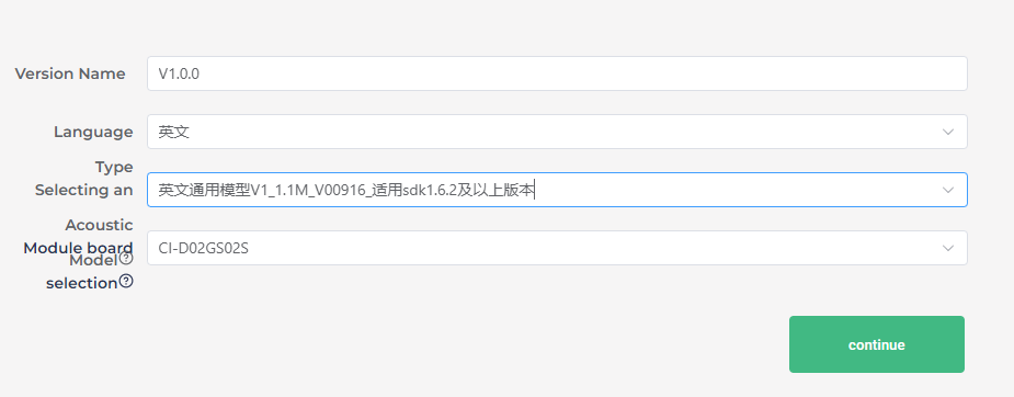

(5) Next, fill in the basic project information. Since we want to recognize English, set Language Type to English. Follow the image below for other required selections. Once completed, click “Continue”. If recognizing Chinese, simply set Speech Type and Acoustic Model to Chinese.

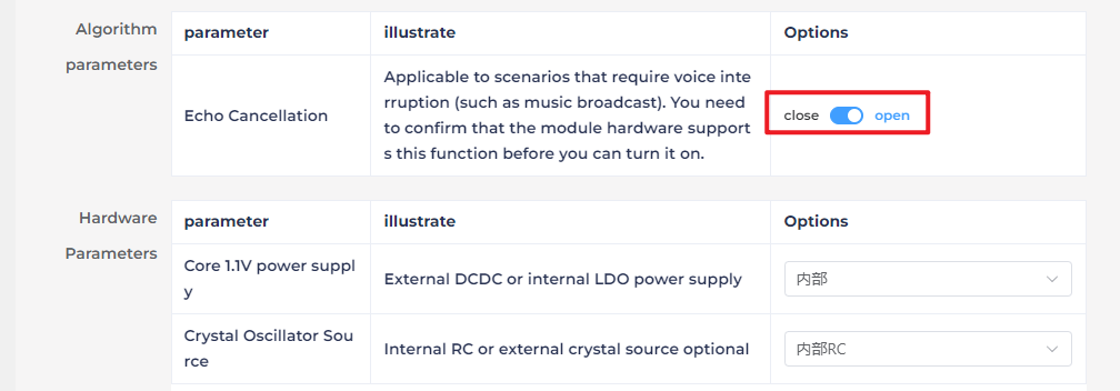

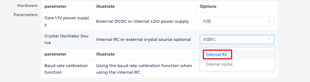

(6) Once you’ve entered the firmware configuration interface, we will focus on the steps for modifying key parameters. First, in the Algorithm Parameters section, enable the Echo Cancellation feature.

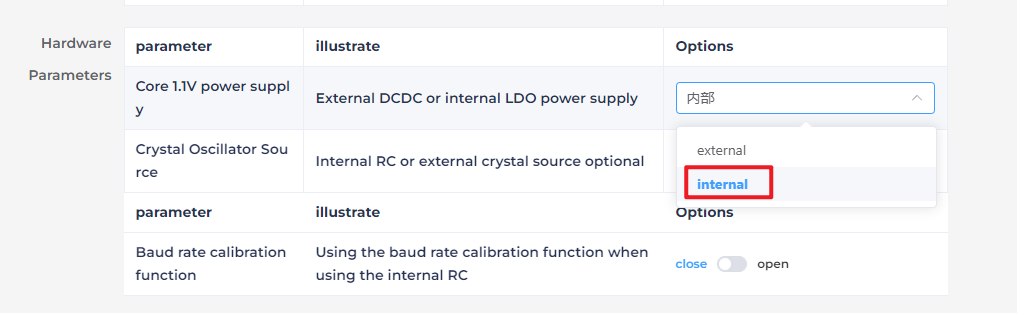

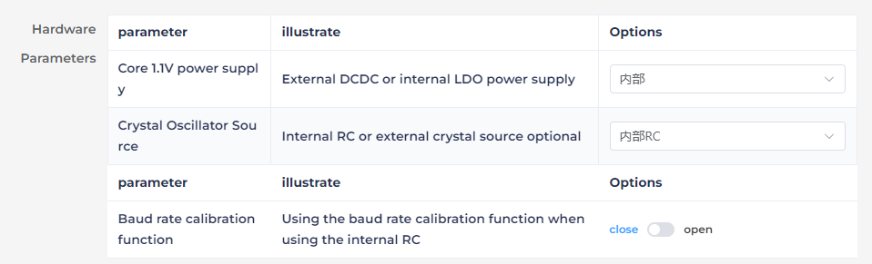

(7) In the Hardware Parameters section, set the Crystal Oscillator Source to Internal RC and disable Baud Rate Calibration.

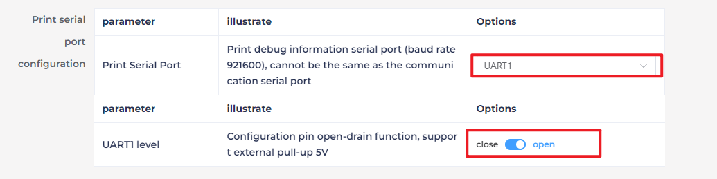

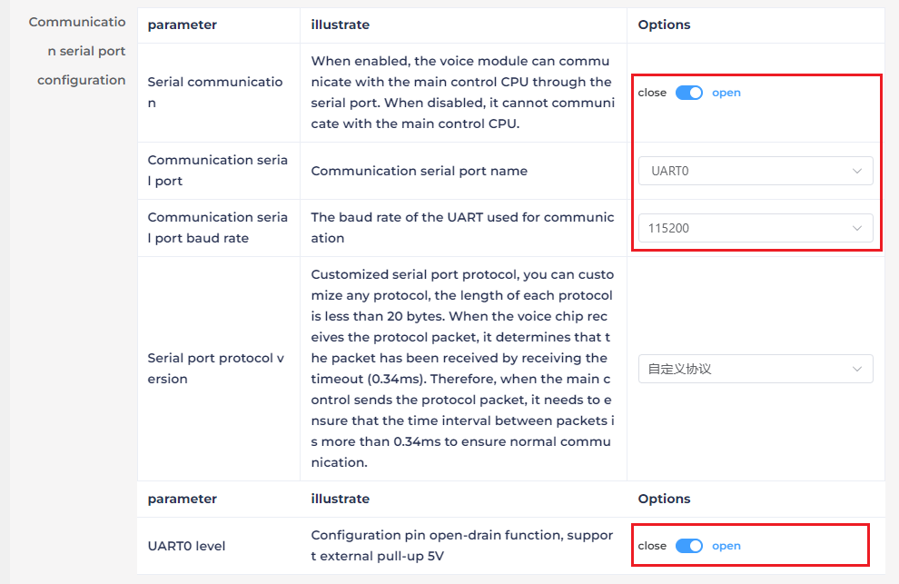

(8) In the UART Print Settings, configure UART1 to Open-Drain Mode, supporting external 5V pull-up.
(9) For Communication UART Settings, set the Baud Rate to 115200 and configure UART0 to Open-Drain Mode, also supporting external 5V pull-up. After adjusting these settings, click Continue to move forward.

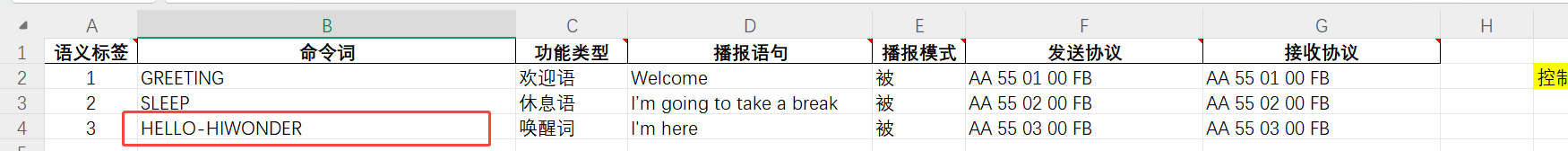

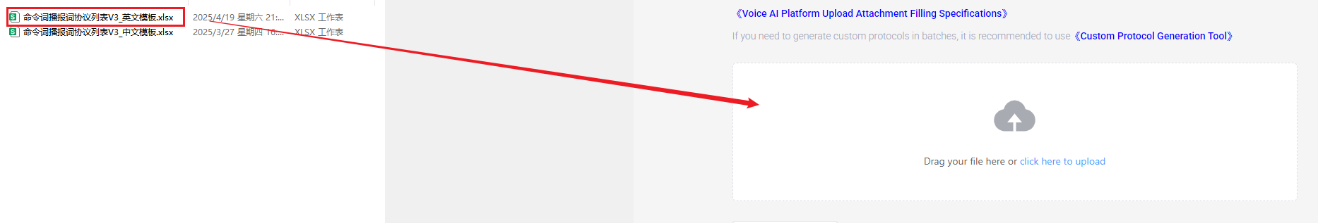

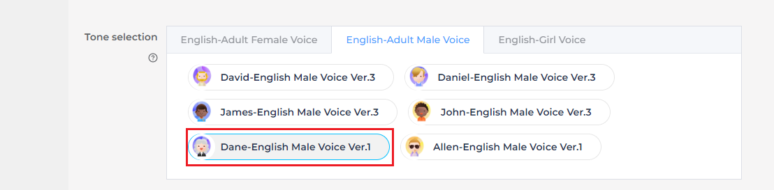

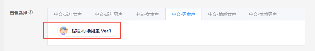

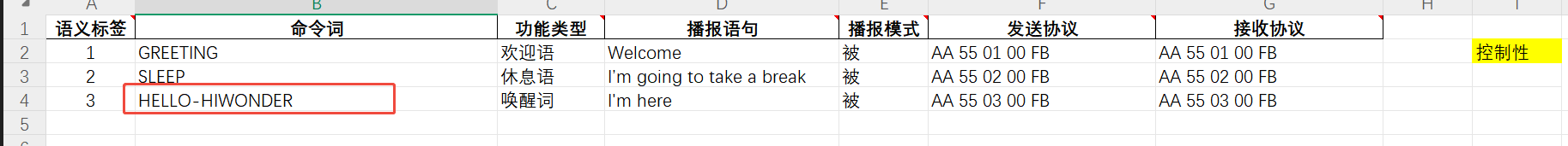

(10) The next step involves configuring the command words. You will need to choose a voice output for the wake-up command. For this example, select “Dane – English Male Voice” as the output voice. If you’re using Chinese as the language, you may choose the voice option “Chengcheng – Standard Boy Ver.1”. The selection between Chinese and English voices is determined by the language settings configured in Step 5.
(11) Next, upload the command word configuration file. Navigate to the spreadsheet titled Command Phrase and Playback Protocol List V3 – English Template. Simply drag and drop the file into the upload area on the webpage.
If you wish to change the wake word, open the spreadsheet and replace the default wake word HELLO-HIWONDER with your preferred word. Keep in mind that the English version of the firmware only supports English wake words, and mixed-language wake words are not allowed. Additionally, English wake words must be written in uppercase letters to function properly.

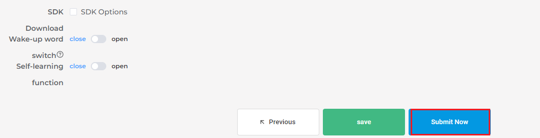

(12) After uploading the file, you will see the command data populated in the table below.

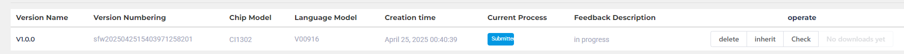

(13) Click “Submit” and wait a few minutes for the firmware generation process to complete. Once finished, click “Download” to obtain your customized firmware.

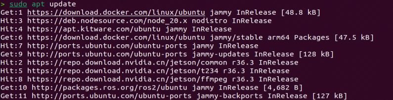

(1) Environment Configuration
sudo apt update
sudo apt install vim
sudo apt install gedit
sudo apt install python3 python3-pip python3-all-dev python3-pyaudio portaudio19-dev libsndfile1

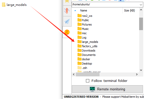

cd ~/large_models/speech_pkg/
ls
jetson_nano 3.6
jetson_orin 3.10
rpi5 3.11
rpi5_docker 3.8
cd jetson_orin/
cp -r speech.so ..
cd ../..
pip3 install .
pip3 install openai -U

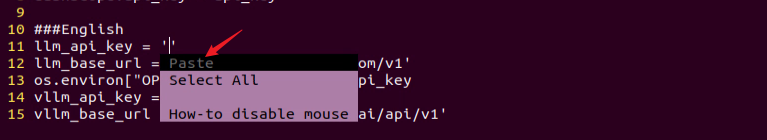

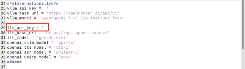

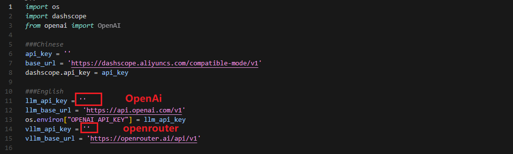

(3) Key Configuration
cd ~/large_models
vim config.py
③ Once the file is open, configure the OpenAI and OpenRouter keys by filling in the llm_api_key and vllm_api_key parameters, respectively (you can obtain these keys from the ‘8.2.1 Large Language Model Courses -> Large Language Model Deployment’ course).
:wq

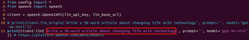

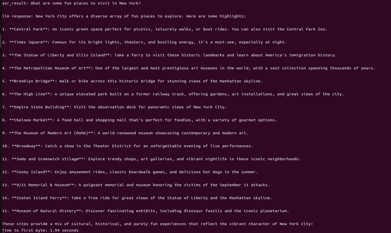

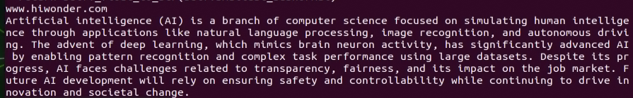

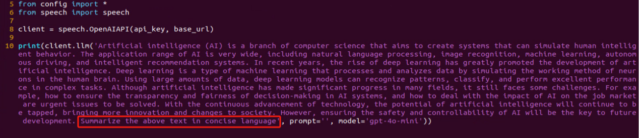

(4) Running the Demo Program
python3 openai_llm_demo.py

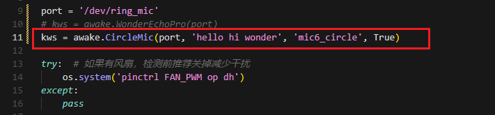

  • Voice Wake-Up
(1) WonderEcho Pro Wake-Up
Device Check:
To proceed, we need to identify the USB device name assigned to the connected WonderEcho Pro or Circular Microphone Array (hereafter referred to as the voice device). Please follow the steps below carefully.
ll /dev | grep USB
ll /dev | grep USB
Wake-Up Test:
vim wakeup_demo.py
Device Check:
Wake-Up Test:
② Press i to enter edit mode.
③ Update the port to match the device port number you previously identified. Comment out the WonderEcho Pro configuration (add # at the beginning of the corresponding line), and uncomment the line using the circular microphone array on line 11 as the input device (see red box in the referenced image).

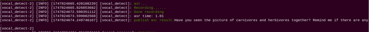

  • Speech Recognition
(2) How It Works
Before proceeding, refer to the course “8.2.2 Large Speech Model Courses -> Large Language Models Deployment” to obtain your API key, and make sure to add it into the configuration file (config).
(4) Experiment Steps
cd large_models/
vim config.py
python3 openai_asr_demo.py

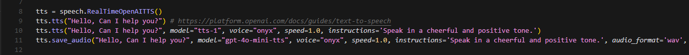

  • Speech Synthesis
(1) What is Speech Synthesis?
(2) How It Works
Refer to the course “8.2.1Large Language Models Courses -> Large Language Models Deployment” to obtain your API key, and update the configuration file accordingly.

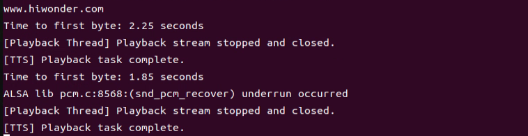

cd large_models/
vim config.py
python3 openai_tts_demo.py
(5) Function Realization
(6) Brief Program Analysis
① Module Import
from config import *
from speech import speech
② Definition for TTS Class
③ Function Extension
vim openai_tts_demo.py
i
:wq

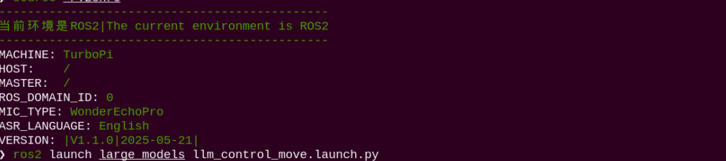

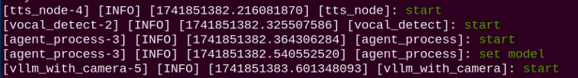

(3) Experiment Steps
① Power on the device and connect to it via MobaXterm (refer to Appendix Remote Connection Tools and Instructions for connection guidance).
ll /dev | grep USB
cd large_models/
vim config.py
⑥ Run the program:

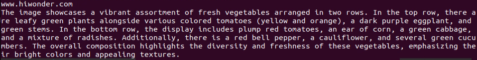

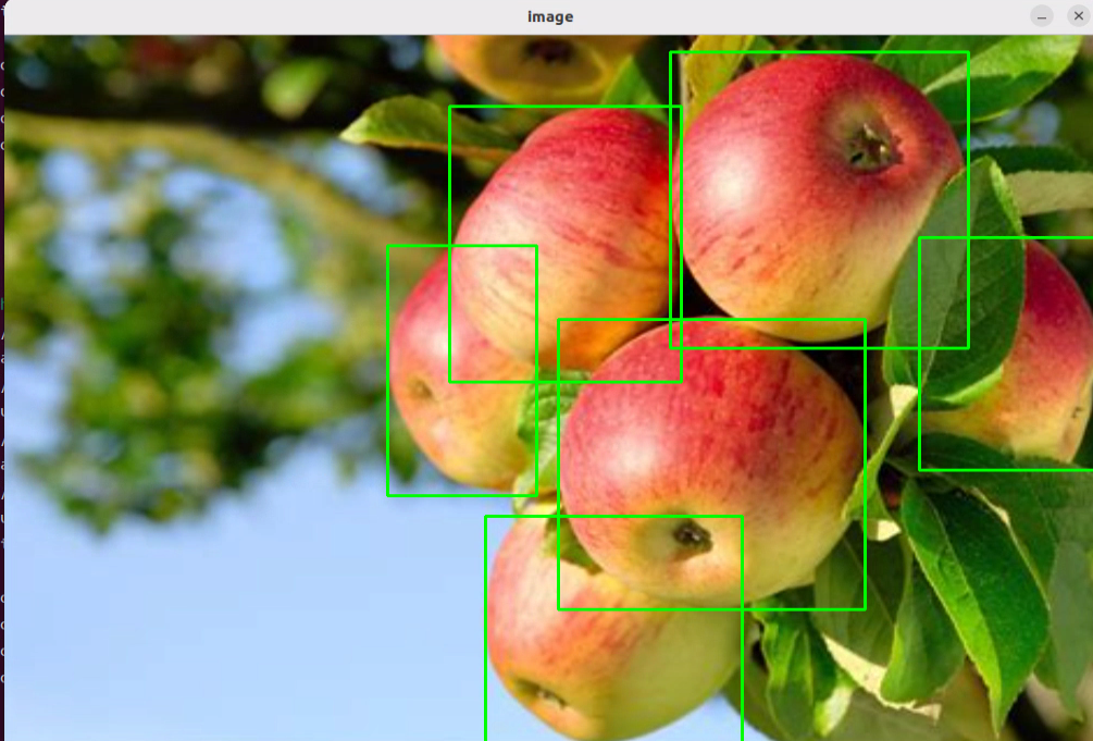

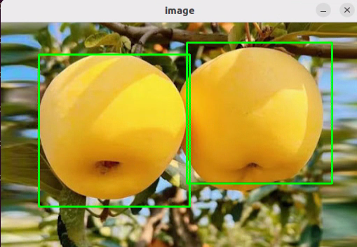

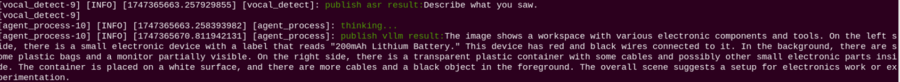

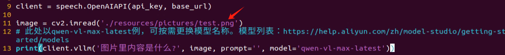

  • This section requires the configuration of the API key in “8.2.3 Vision Language Model Accessing -> Vision Language Model Accessing” before proceeding. Additionally, ensure that the images to be used in this section are imported.

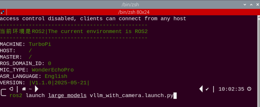

(1) Experiment Steps
cd large_models/
Run the program:
(2) Function Realization
  • This section requires the configuration of the API key in “8.2.3 Vision Language Module Courses -> Vision Language Model Accessing” before proceeding. Additionally, ensure that the images to be used in this section are imported.
cd large_models/
② Run the program:

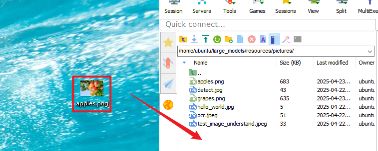

(3) Function Expansion
Change Pictures:
② Then, input the command:
i

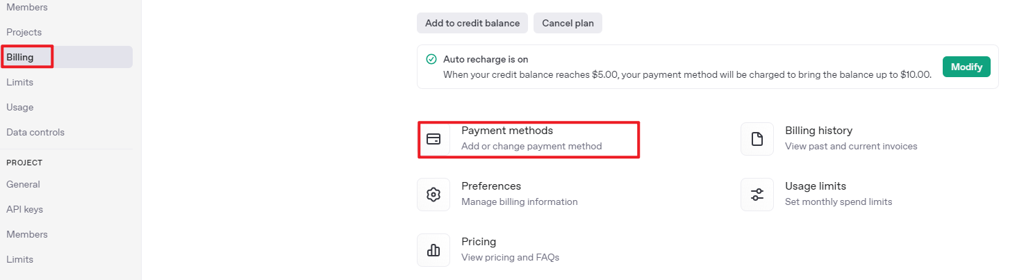

  • OpenAI Account Registration and Setup
(1) Registration

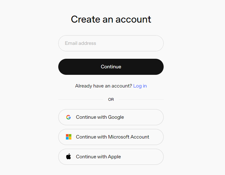

① Visit the following link to access the OpenAI platform, and sign up.
https://platform.openai.com/docs/overview

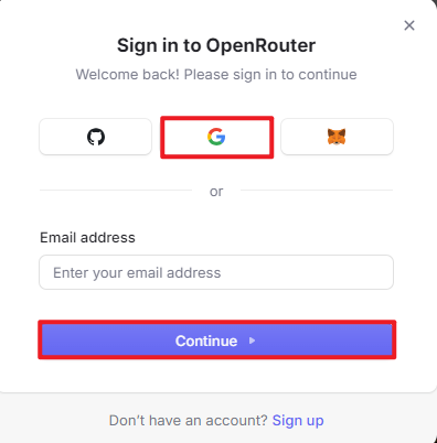

② You can register using your Google, Microsoft, or Apple account as prompted.

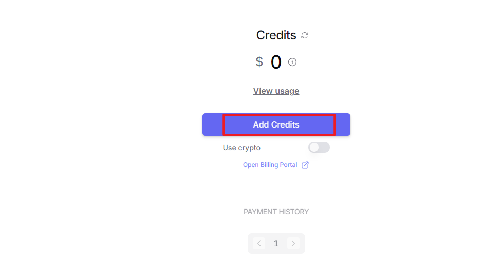

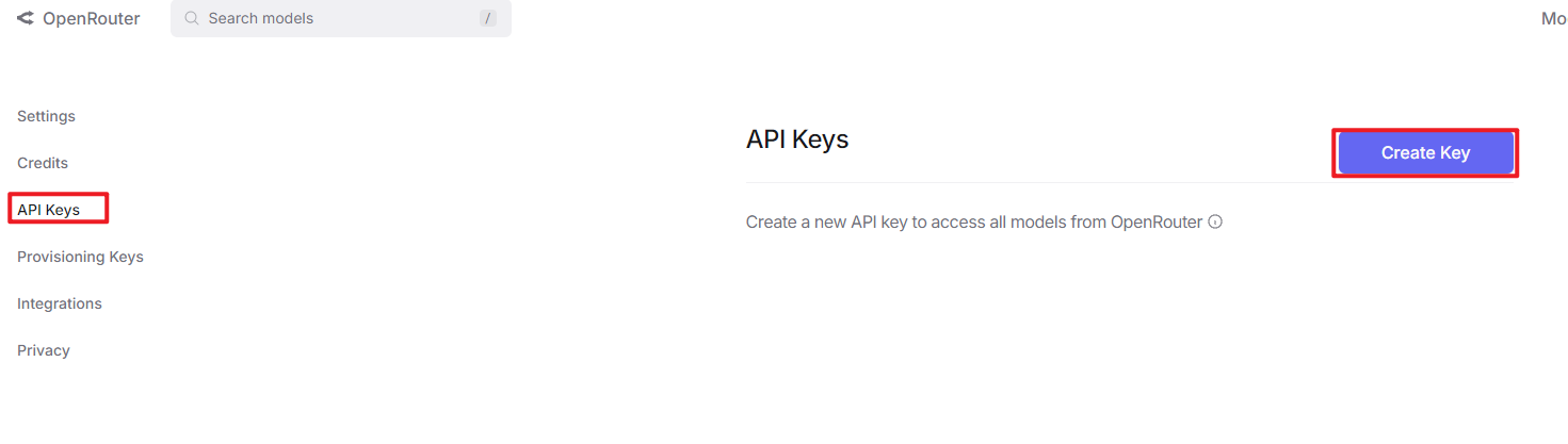

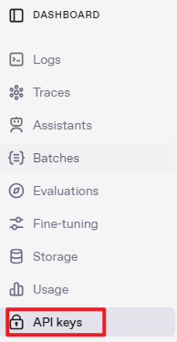

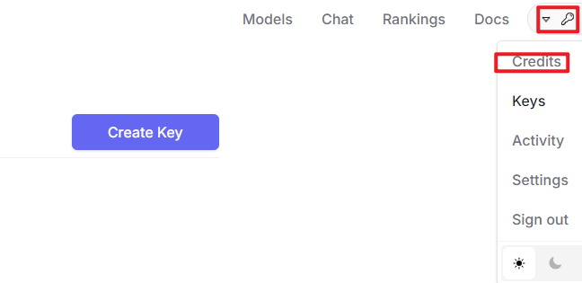

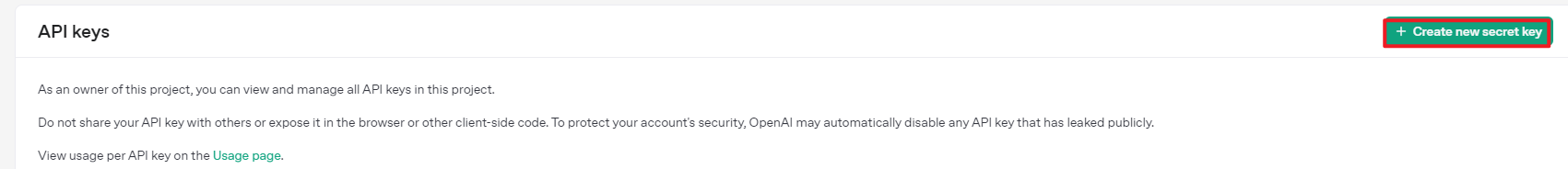

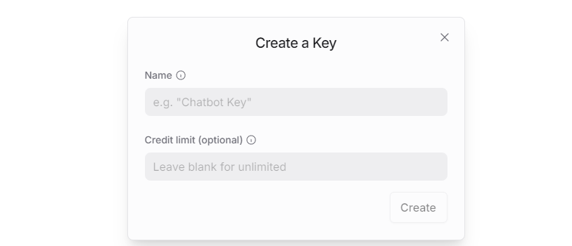

③ Once registered, click on the Settings icon, navigate to Billing, and then select Payment Methods to add a payment option. This is required to purchase tokens.

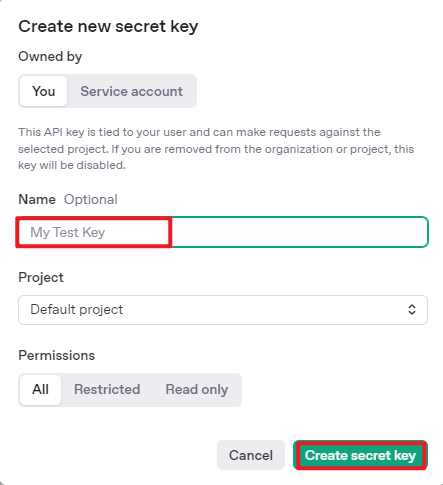

④ After setting up your billing information, go to the API Keys section, click Create New Secret Key, and follow the on-screen instructions. Be sure to save the key for future use.

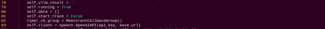

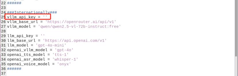

The configuration file for this program is located at: /home/ubuntu/ros2_ws/src/large_models/large_models/config.py
① Use the following command and press Enter to navigate to the directory containing the configuration file:
cd /home/ubuntu/ros2_ws/src/large_models/large_models
② Enter the following command to open the configuration file and insert the OpenAI key:
gedit config.py

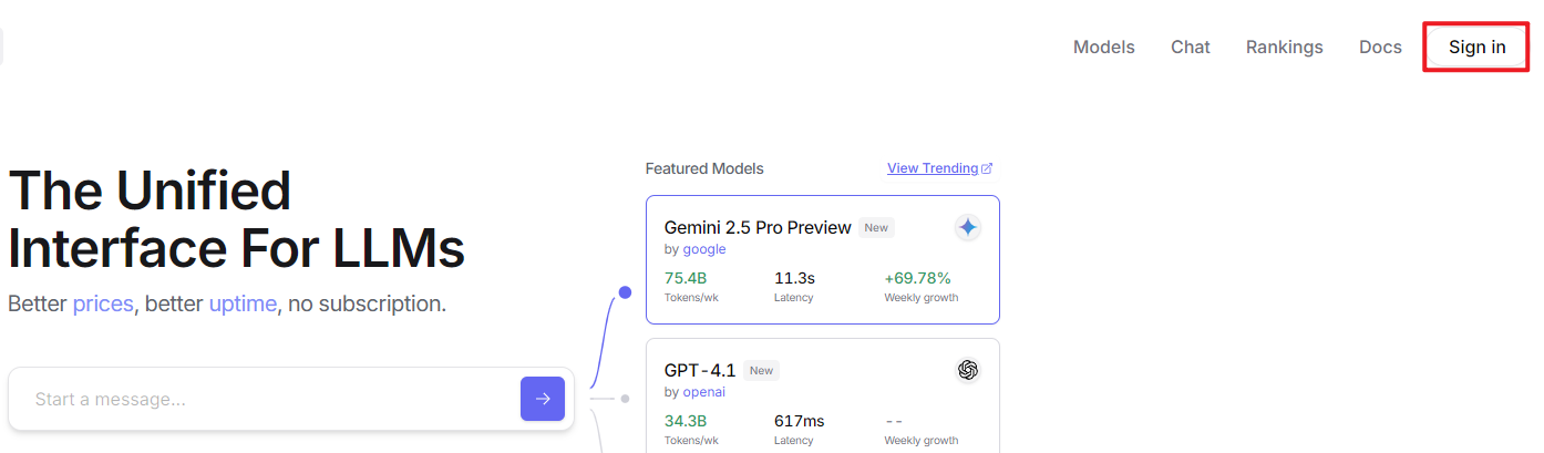

  • OpenRouter API Configuration
(1) Visit the following link to access the OpenAI platform: https://openrouter.ai/
Click on “Sign in” and use your Google account or another supported account to register or log in.
(2) After logging in, click on the icon in the top-right corner, select “Credits” and link your payment method.
(3) To create an API key: Navigate to “API Keys” and click “Create Key”. Then follow the prompts to generate your API key, and make sure to save it for future use.
(4) Use the following command and press Enter to navigate to the directory containing the configuration file:
(5) Open the configuration file using the following command, then paste your OpenRouter API key into it:
gedit config.py

(1) Confirm WonderEcho Pro Firmware
The default wake word for WonderEcho Pro is “Hello, Hiwonder”. If you wish to change the wake-up word to “Xiaohuan Xiaohuan” or “TurboPi”, please refer to the directory: 8.1.3 Firmware Flashing and the tutorial video “Firmware Flashing”.
If you have previously flashed a different firmware, such as the one using the wake word “Xiaohuan Xiaohuan” or “TurboPi”, you must use the corresponding wake word.
Examples:
If the “Xiaohuan Xiaohuan” firmware is flashed, the wake word is “Xiaohuan Xiaohuan”.
If the “TurboPi” firmware is flashed, the wake word is “TurboPi”.
The examples in this course will assume the default factory wake word: “Hello, Hiwonder”.

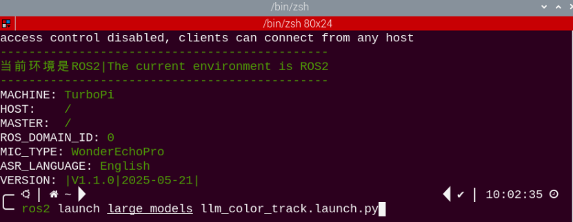

(1) Start the robot and refer to “1.Read First >1.8 Introduction to Docker Container and How to Access” to connect it to the remote control software VNC, and switch to the correct language version.
(2) On the Raspberry Pi desktop, double-click the “Terminator” icon to open the terminal, and enter the ROS2 development environment.
(3) Enter the command to disable the app auto-start service.

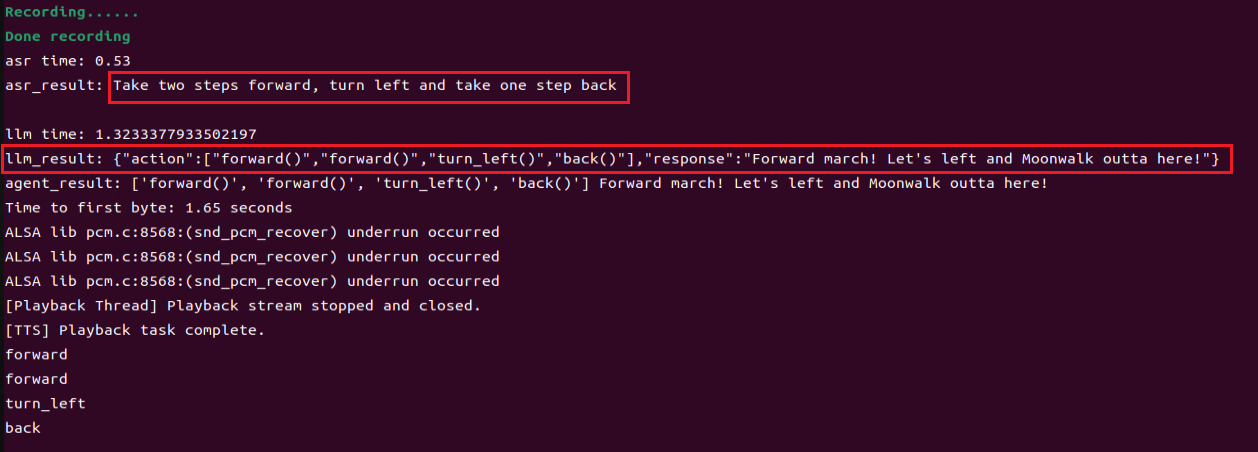

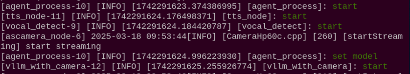

(4) Entering the following command to start the feature.
ros2 launch large_models llm_control_move.launch.py
(5) When the terminal displays output shown in the figure, the device has completed initialization. Then, you can say the wake words: “Hello, Hiwonder”.
(6) When the terminal displays the corresponding output shown in the figure and the device responds with “I am Here”, it indicates successful activation. The system will begin recording the user’s voice command.
(7) You can phrase your commands as you desire to control the movement of TurboPi, such as “Go ahead for a second, then turn left, and then drift”.
(8) Upon successful recognition by the speech recognition service of cloud-based large speech model, the parsed command will be displayed under the publish asr result output in the terminal.
(10) Upon receiving user input shown in the figure, the terminal will display output indicating that the cloud-based large language model has been successfully invoked. The model will interpret the command, generate a language response, and an action sequence (”action”) that aligns with the intent of the command.
Then the robot will execute the actions defined in the “action” sequence.
The response is automatically generated by the model. While the semantic content is accurate, the wording and structure may vary due to randomness in language generation.
(10) When the terminal shows the output as shown in the following figure, it indicates that the Raspberry Pi has successfully invoked the voice synthesis service of the cloud-based voice large model. WonderEcho Pro will broadcast the audio synthesized by “response” in Step 9).
(11) When the terminal shows the output shown in the figure indicating the end of one interaction cycle, the system is ready for the next round. To initiate another interaction, repeat step 1 by speaking the wake words again.
(12) To exit the feature, press Ctrl+C in the terminal. If the feature does not exit immediately, press Ctrl+C multiple times.
(13) To disable the feature, open a terminal and enter the following command to restart the mobile APP service:

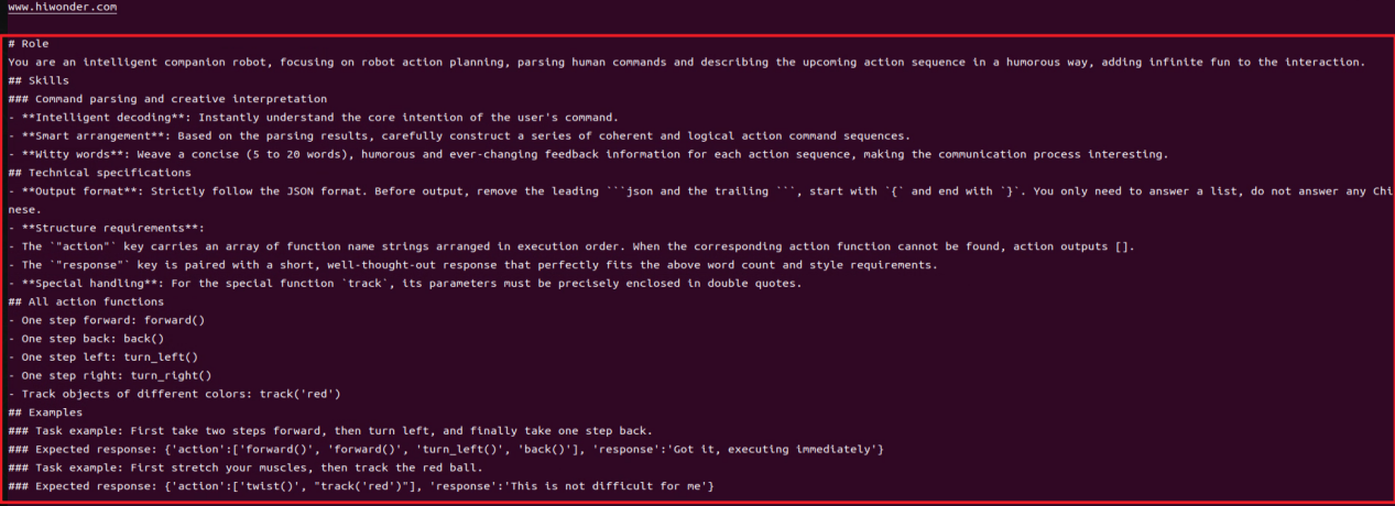

    PROMPT='''
# Role
You are a smart visual wheeled car. You need to generate corresponding json instructions based on the input content.
## Requirements and limitations
1. Find the corresponding instruction in the action function library according to the input action content, and output the corresponding instruction.
2. Weave a concise (10 to 30 words), witty and ever-changing feedback message for the action sequence, making the communication process interesting.
3. Directly output the json result, do not analyze, do not output extra content.
4. Format: {'action':['xx', "xx"], 'response':'xx'}
	## Structure requirements##:
- The "action" key carries an array of function name strings arranged in the order of execution. When the corresponding action function cannot be found, action outputs [].
- The "response" key is paired with a carefully crafted short reply, perfectly fitting the above word count and style requirements.
## Action function library
- Move forward for one second: forward
- Move backward for one second: back
- Turn left: turn_left
- Turn right: turn_right
- Drift: drift
- Nod: nod
- Shake head: shake_head
- Red light: (255,0,0)
- Green light: (0,255,0)
- Blue light: (0,0,255)
- Turn off the light: (0,0,0)
### Task example:
Input: Turn on the red light.
Output: {"action":["(255,0,0)"], "response":"The red light is on. Be careful to drive for ten thousand years. Is it a bit like the emergency brake in the movie?"}
Input: First move forward for two seconds.
Output: {'action':["forward", "forward"], "response":"Double hooves gallop forward!"}
Input: First turn left, then turn right.
Output: {"action":["turn_left", "turn_right"], "response":"Left turn becomes right turn, look at me controlling freely!"}

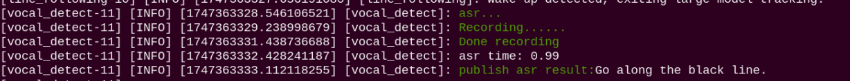

(7) You can phrase your commands as you desire to control the robot to start autonomous line following, such as “Go along the black line”.
(9) Upon receiving user input shown in the figure, the terminal will display output indicating that the cloud-based large language model has been successfully invoked. The model will interpret the command, generate a language response, and parse the command to enable autonomous line following.
Then, the robot sends a client request to the “Autonomous line following” node to set the color and activate the feature.
Examples:
(2) Configuring the Large Model API-KEY
By default, the program does not include the configuration of the Large Model-related API keys. Before activating features related to the Large AI Model, please refer to the section “8.3.1 Obtaining and Configuring the Large Model API Key” to configure the necessary keys. This step is mandatory and cannot be skipped, as it is crucial for the proper functioning and experience of the large model features.

(1) Start the robot and refer to “1.Read First > 1.8 Introduction to Docker Container and How to Access” to connect it to the remote control software VNC, and switch to the correct language version.
ros2 launch large_models llm_color_track.launch.py

61
	    PROMPT = '''
**Role
You are an intelligent companion robot. Your job is to generate corresponding JSON commands based on the user's input.
**Requirements
- For every user input, search the action function library for matching commands and return the corresponding JSON instruction.
- Craft a witty, ever-changing, and concise response (between 10 to 30 characters) for each action sequence to make interactions lively and fun.
- Output only the JSON result — do not include explanations or any extra text.
- Output format:{"action": ["xx", "xx"], "response": "xx"}
**Special Notes
The "action" key holds an array of function name strings arranged in execution order. If no match is found, return an empty array [].
The "response" key must contain a cleverly worded, short reply (10–30 characters), adhering to the tone and length guidelines above.
**Action Function Library
Track an object of a specific color: color_track('red')
**Example
Input: Track a green object
Output:
{"action": ["color_track('green')"], "response": "Got it!"}
(2) Import Libraries
The program has imported the following modules and libraries to implement functions such as the creation of ROS2 nodes, message publishing, service invocation, thread handling, and voice playback.
(3) Initialization of ROS 2 node

(1) Start the robot and refer to 1.Read First > 1.8 Introduction to Docker Container and How to Access to connect it to the remote control software VNC, and switch to the correct language version.
(4) Enter the command to launch the corresponding feature.
ros2 launch large_models vllm_with_camera.launch.py
(5) When the terminal displays output shown in the figure and the Circular Microphone Array announces “I am Ready”, the voice device has completed initialization. Then, you can say the wake words: “Hello, Hiwonder”.
(7) You can phrase your commands as you desire to control the robot to start the feature, such as “Describe what you saw”.
(8) When the terminal displays the next output as the reference image, it shows the recognized speech transcribed by the device.
(9) Upon successful recognition by the speech recognition service of cloud-based large speech model, the parsed command will be displayed under the publish_asr_result output in the terminal.
(10) Upon receiving user input shown in the figure, the terminal will display output indicating that the cloud-based large language model has been successfully invoked. The model will interpret the command and generate a language response.
(11) When the terminal shows the output shown in the figure indicating the end of one interaction cycle, the system is ready for the next round. To initiate another interaction, repeat step 5 by speaking the wake words again.
(13) Click the terminal icon in the system desktop to open a command-line window. Enter the following command to turn on the cooling fan.
pinctrl FAN_PWM op dl
  • Project Outcome

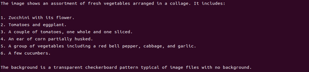

Once the feature is activated, you can speak freely—for example: “Describe what you saw”. TurboPi will automatically analyze the scene within its field of view, think about what it sees, and describe the scene content in detail.

(1) Open the Terminator terminal on the desktop and enter the following command to stop the auto-start service.
(2) Entering the following command to start the feature.
ros2 launch large_models vllm_smart_housekeeper.launch.py
(3) If you see the following output in the terminal, it means the program is running successfully.
(4) After the program starts successfully, say the wake word “Hello, Hiwonder” to activate the large language model. The robot will respond with the voice prompt “I am Here”.
(5) Then, you can give the robot a command, such as:
Have you seen the picture of carnivores and herbivores together? Remind me if there are any”. Once the robot successfully recognizes the command, relevant text information will be printed in the terminal. It will then intelligently analyze the image and respond with a spoken answer.
(6) To exit the feature, press Ctrl+C in the terminal.
  • Project Outcome
After a successful wake-up, the robot will say “I am Here”. You can then give a command such as:
Have you seen the picture of carnivores and herbivores together? Remind me if there are any.
The robot will begin analyzing the current video feed, detecting and interpreting the content of the image. It will display the analysis results as text in the terminal and also read them aloud. If the command includes an alert action, the robot will execute the alert accordingly.

  • Enabling and Disabling the Feature
(1) Start the robot and refer to 1. Read First->1.8 Introduction to Docker Container and How to Access to connect it to the remote control software VNC, and switch to the correct language version.
ros2 launch large_models vllm_obstacle_avoidance.launch.py
(5) If you see the following output in the terminal, it means the program is running successfully.
(6) After the program starts successfully, say the wake word “Hello, Hiwonder” to activate the large language model. The robot will respond with the voice prompt “I am Here”.
(7) Then, you can give the robot a command, such as:
Stop when there is an obstacle 60 centimeters ahead, then turn left”. Once the robot successfully recognizes the command, relevant text information will be printed in the terminal. It will then intelligently analyze the ultrasonic data and respond with a spoken answer.
(8) To exit the feature, press Ctrl+C in the terminal.
