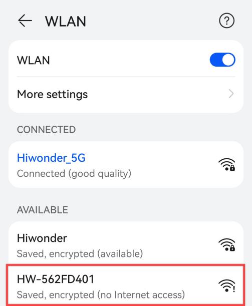

  • Connecting in AP Mode (Recommended First Step)
When TurboPi powers on, it automatically enters AP mode and broadcasts a hotspot starting with “HW”.

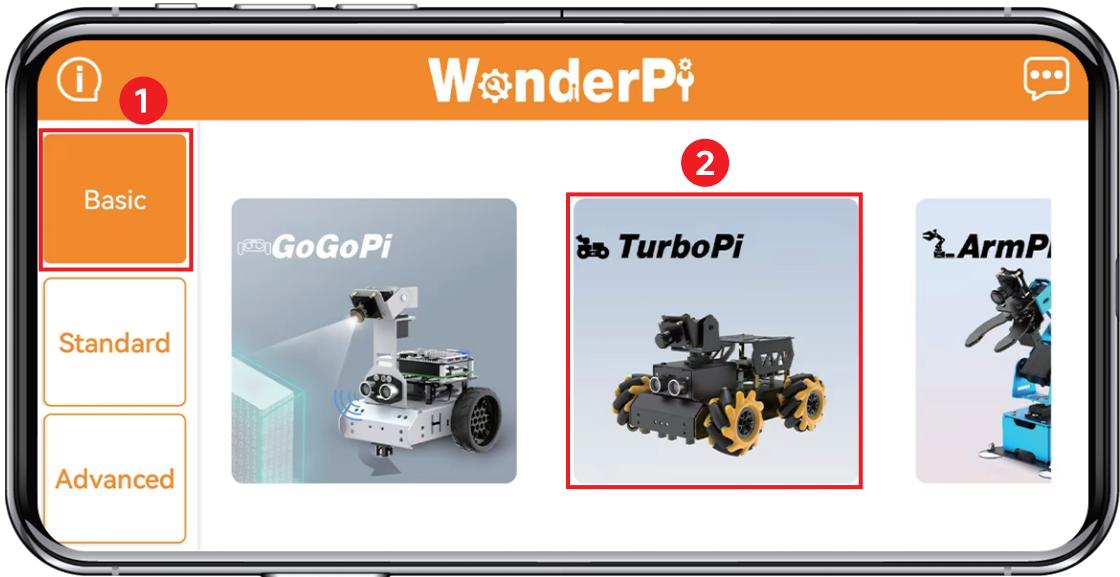

(1) Open the WonderPi app and select “Basic” > “TurboPi”.
(2) Tap “+” in bottom right corner, and then select Direct Connection Mode.

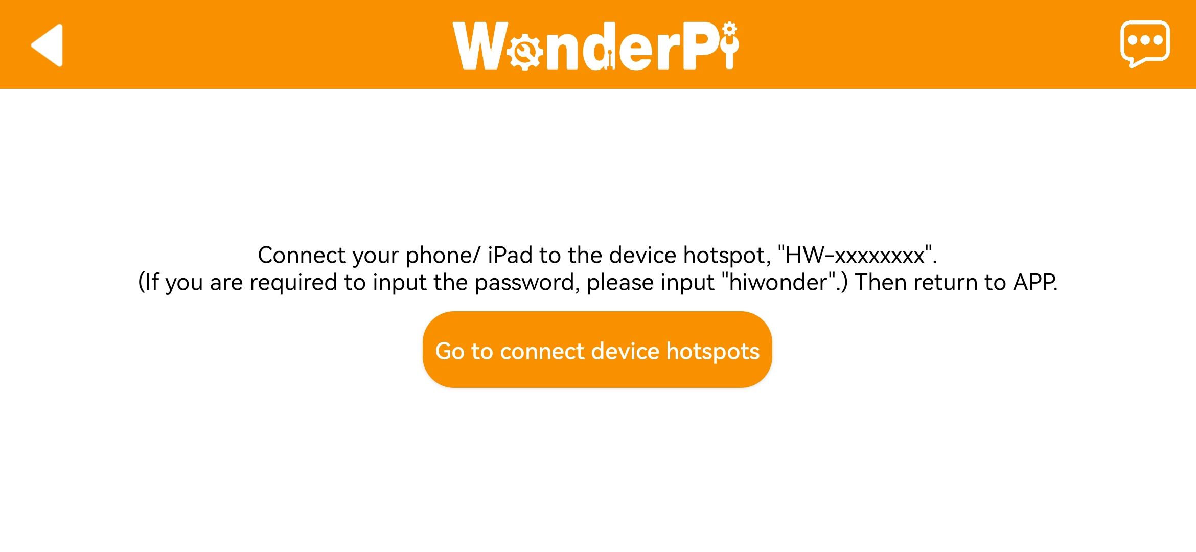

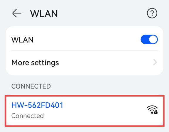

(3) Tap “Go to connect device hotspots”, which will take you to the Wi-Fi settings page. Find the Wi-Fi hotspot that starts with “HW” and connect to it by entering the password: hiwonder.
(4) After connecting, return to the WonderPi app.

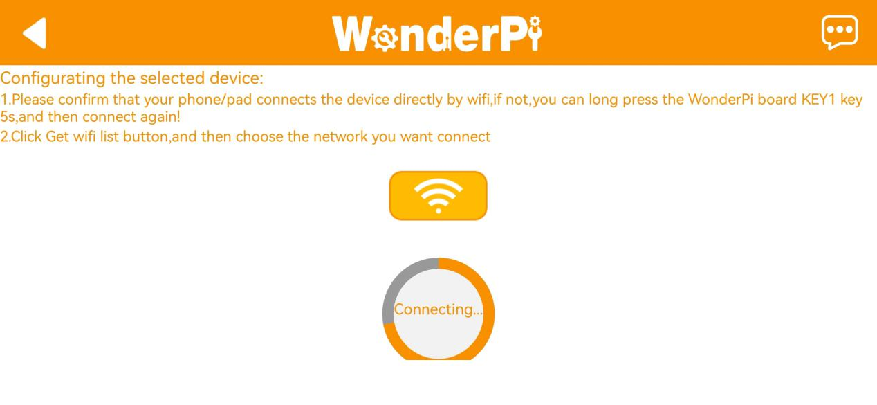

  • Connecting in LAN Mode (STA Mode)

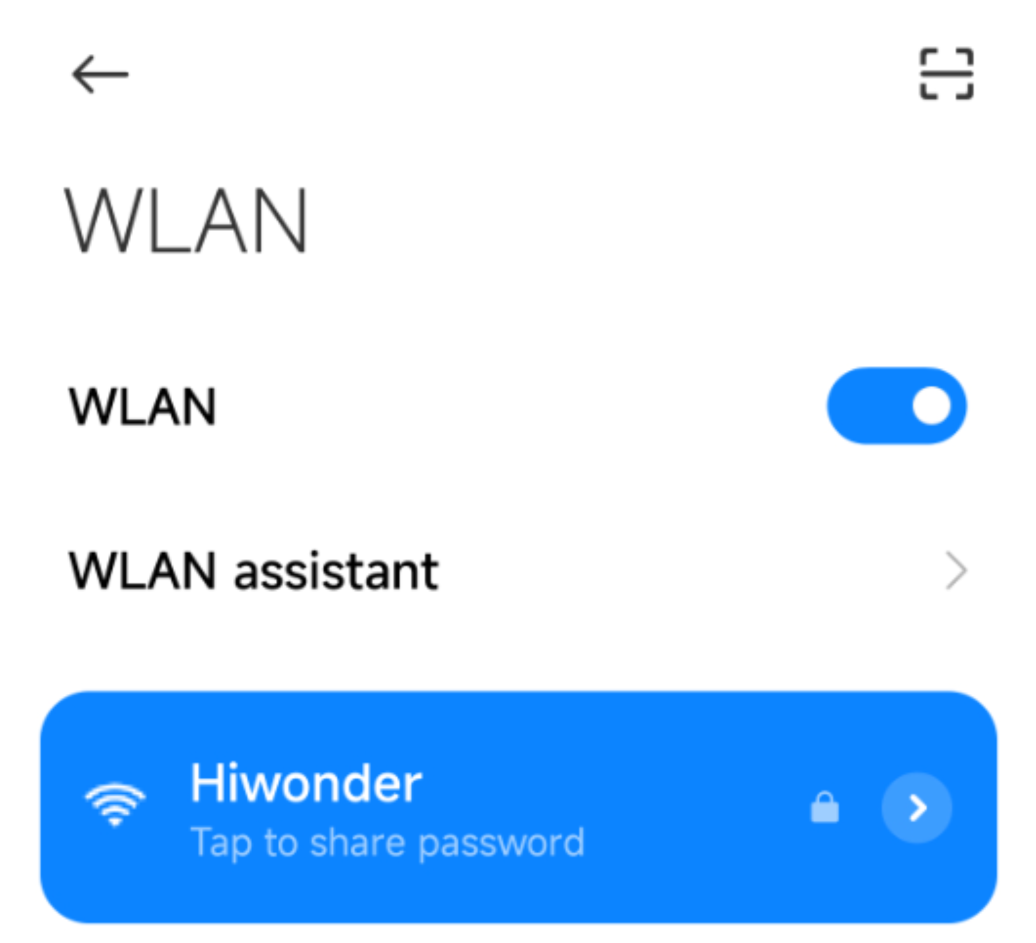

(1) First, disconnect from TurboPi’s AP mode hotspot and connect your phone to a Wi-Fi network. For example, connect to a network named “Hiwonder”.

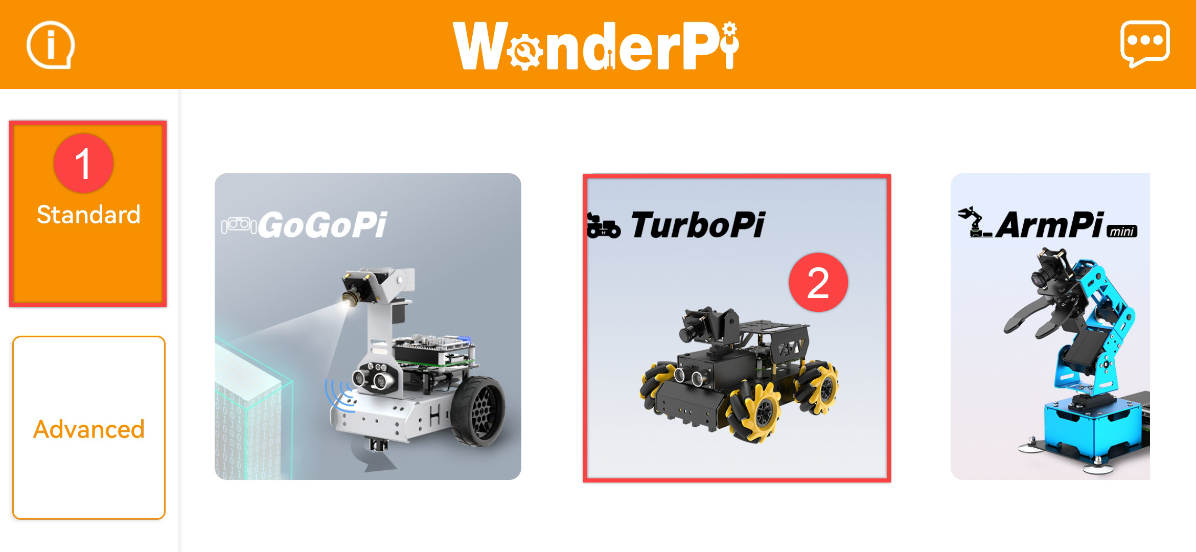

(2) After connection, open “WonderPi”. Select “Standard ->TurboPi” in sequence.

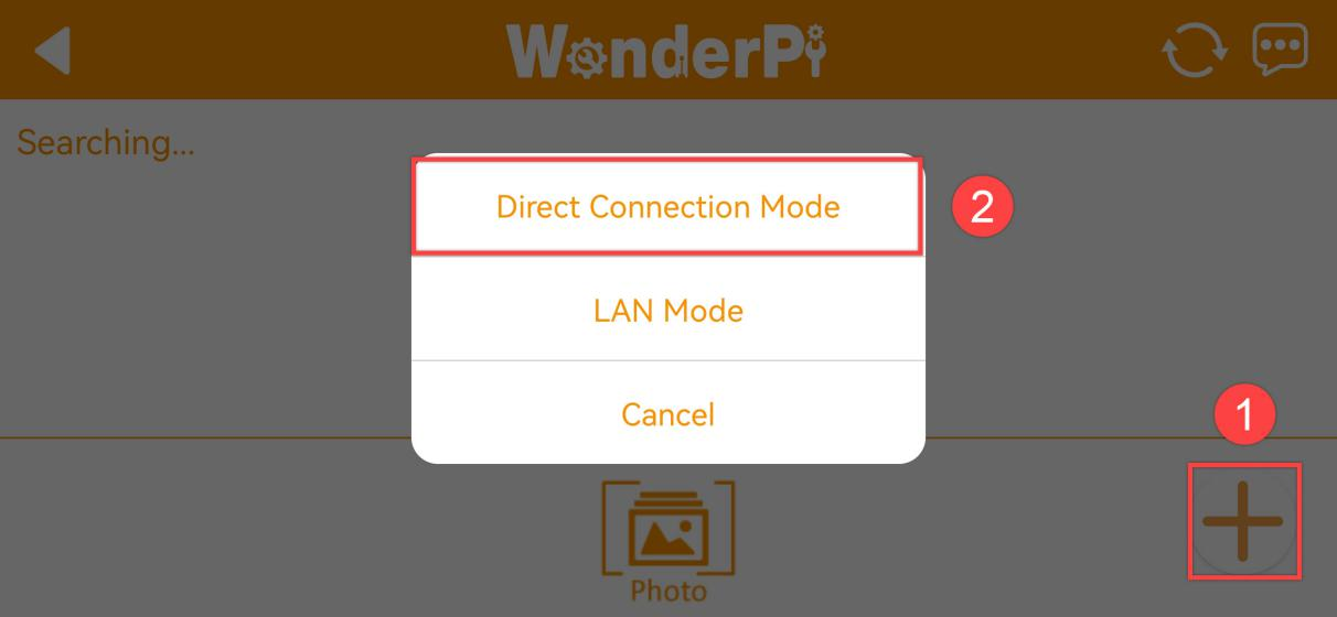

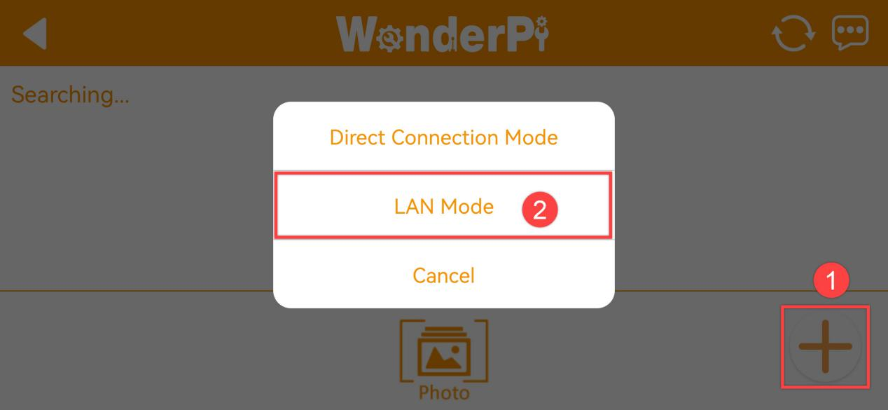

(3) Tap “+” in bottom right corner, and then select LAN Mode.

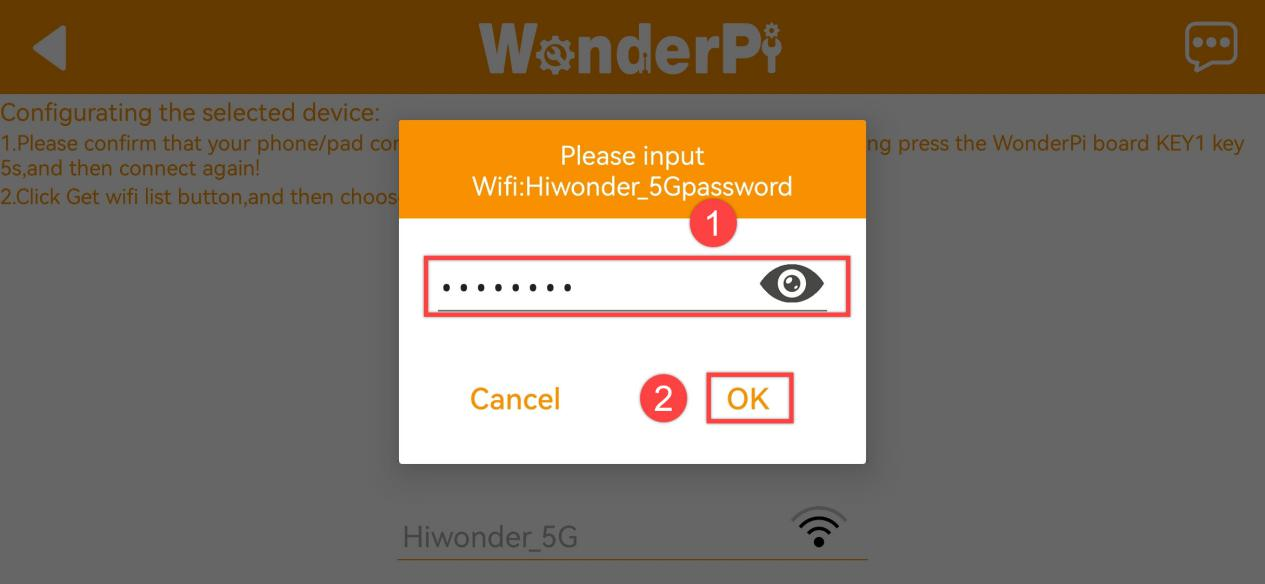

(4) The app will prompt you to enter the Wi-Fi password for the network you’re connected to. Make sure you enter the correct password, a wrong password will prevent the connection. After entering the password, tap “OK”.
(5) Tap “Go to connect device hotspot” to switch to the Wi-Fi settings.
(6) Connect to the TurboPi hotspot (starting with “HW”) using the password hiwonder. After connecting, return to the WonderPi app.
(7) It will begin configuring the network automatically.

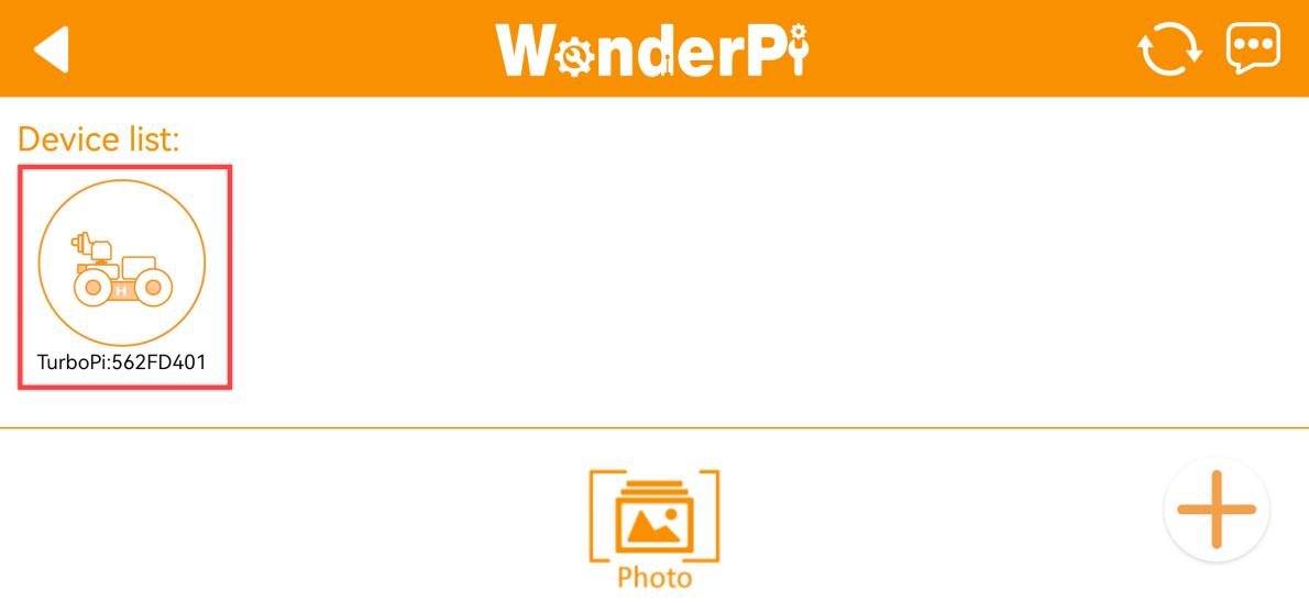

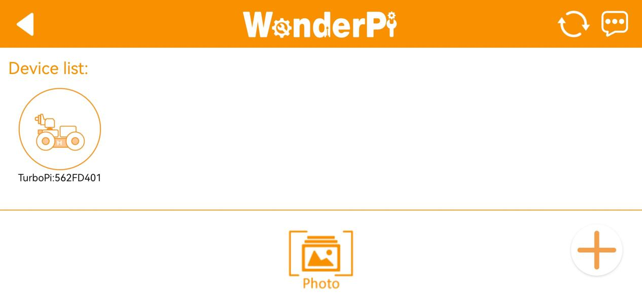

(8) Wait a few seconds. Once the TurboPi icon appears on the main screen and the LED on the expansion board stays on, the setup is complete.

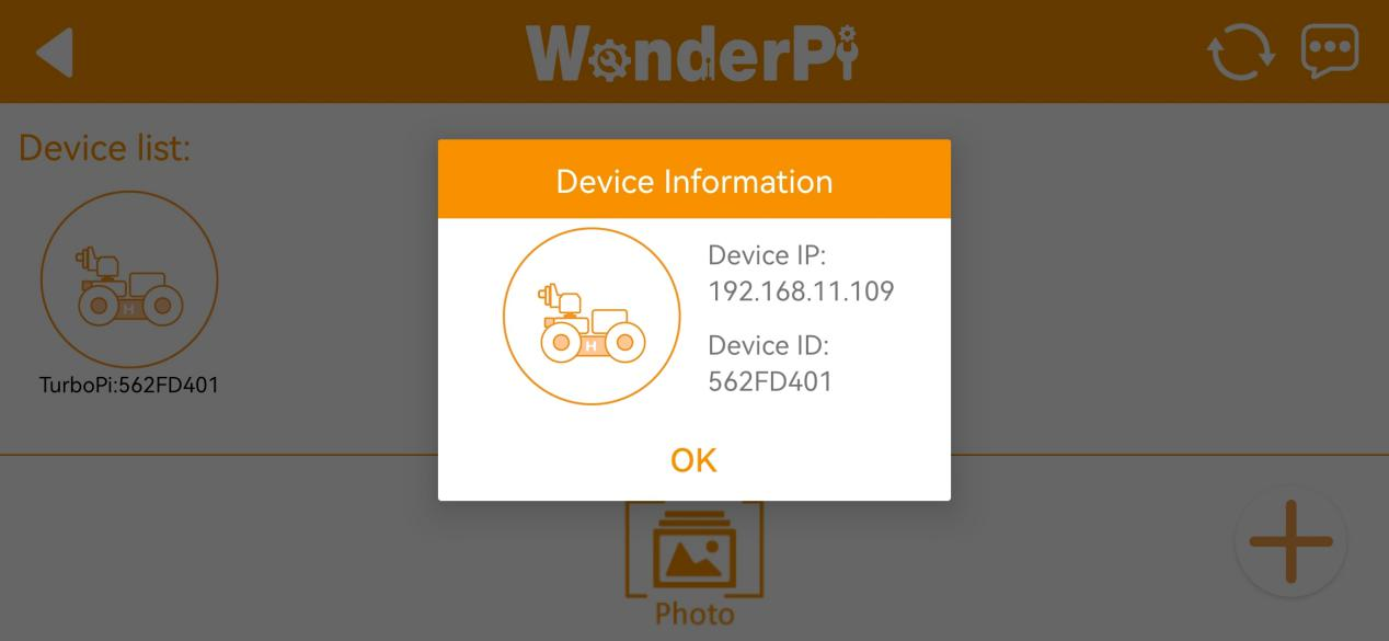

(9) Long-press the TurboPi icon in the app to view its assigned IP address and Device ID.
(10) Tap the TurboPi icon to access the play mode menu.

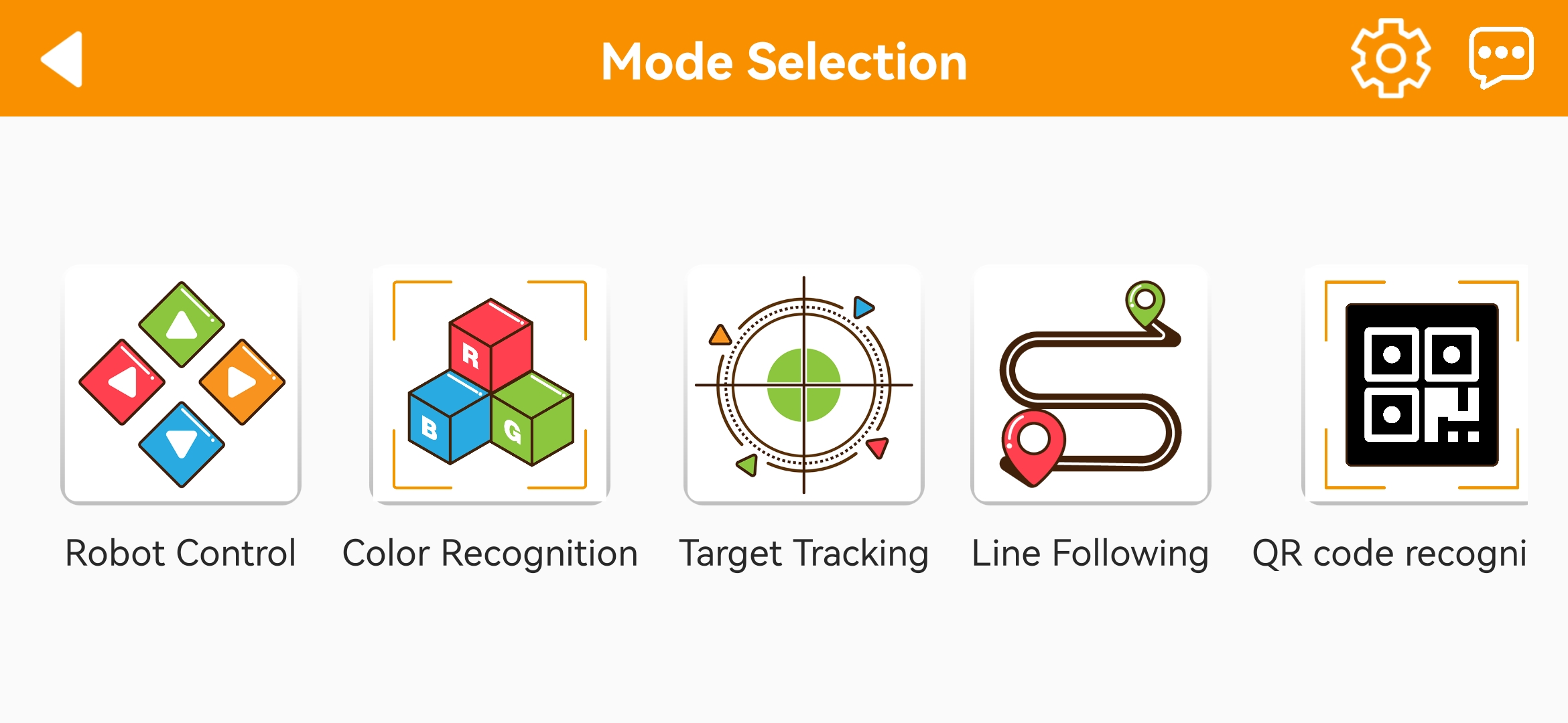

Once the connection is successful, tap the TurboPi icon to enter the mode selection screen. Tap any icon on the screen to enter the corresponding play mode.

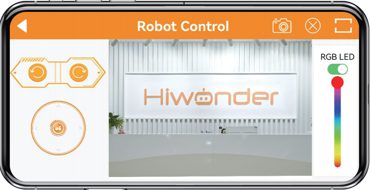

  • Robot Control
Tap “Robot Control” to enter this mode. The robot will automatically reset to its default posture.
This interface is divided into three sections:
(1) Left Panel – Movement Controls: Use the virtual joystick to control the robot’s movements.
(2) Center Panel – Video Feed & Pan-tilt Control: The center displays the real-time camera feed. You can swipe on the screen to adjust the camera angle.
(3) Right Panel – Ultrasonic RGB Light Control: Use the slider to change the RGB lighting status of the ultrasonic sensor module.
The camera Pan-tilt has movement limits. If you reach the limit and continue swiping in the same direction, the phone will give haptic feedback. Please stop swiping in that direction.

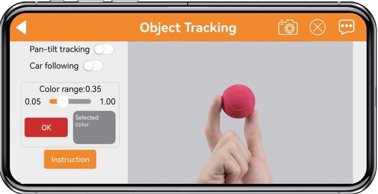

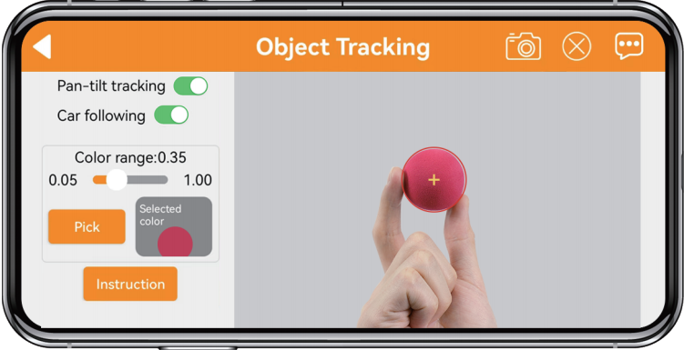

  • Target Tracking
  • The selected color range should be appropriate—not too large or too small. A range that’s too wide may include unwanted colors, while too narrow may cause the robot to lose track of the target.
  • MAvoid having objects with colors similar to the target in the camera view.

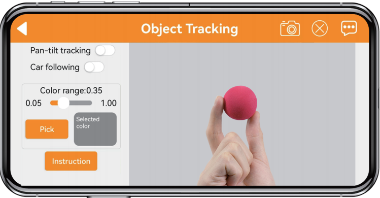

(1) Tap “Pan-tilt Tracking” to enter the mode. In this mode, the robot car will follow an object based on its color.
(2) Drag the red circle in the live camera feed to the object you want to track. Tap “Confirm Color” to set the target color.
(3) The selected color will be displayed under “Tracking Color”.
(4) Choose a tracking mode, then start the feature. When the target object moves, the robot will follow it.

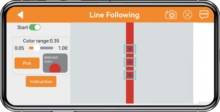

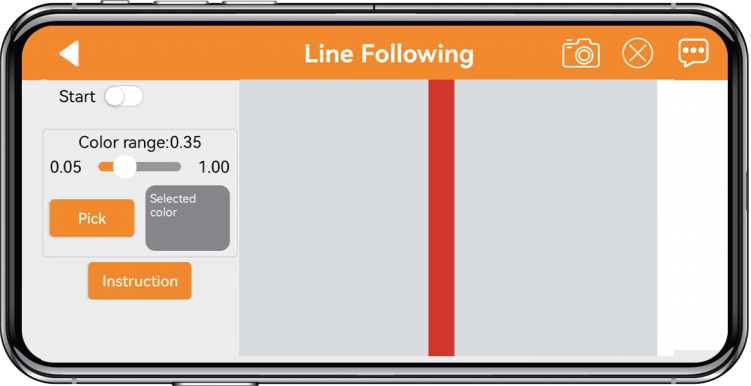

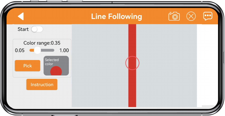

  • Color-Based Line Following
  • You can use colored tape to create a track.
  • Choose a color range that is not too wide or too narrow. Also, make sure no similar colors appear in the camera view.

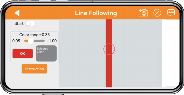

(1) Tap “Start Following” from the mode selection screen to enter this mode. Tap the “Pick Color” button.
(2) Drag the red circle in the camera feed to the track (e.g., red tape) and tap “Confirm Color”.
(4) Tap “Start” to begin. The robot will follow the colored line automatically.

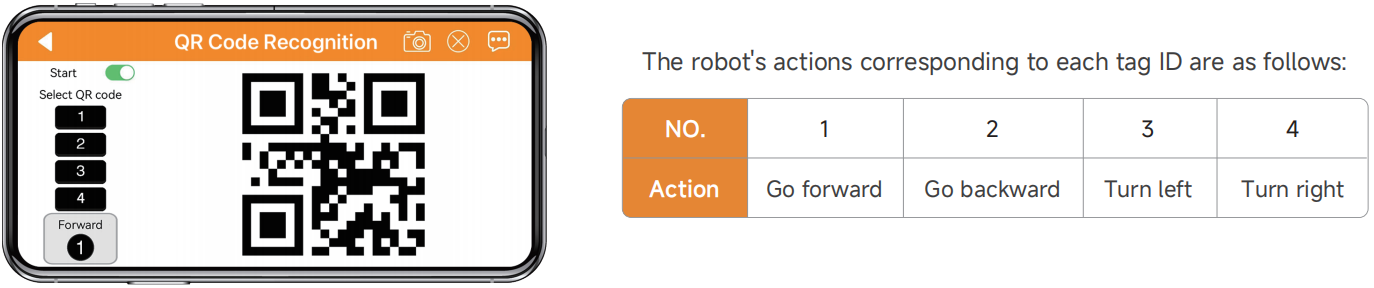

  • QR Code Recognition
  • The maximum recognition distance is approximately 35 cm (13.8 inches).
  • Phone brightness should be neither too dark nor too bright, as it may affect recognition accuracy.
Tap “QR Code Recognition” to enter this mode. Tap “Start” to activate the feature. Select a QR code tag and hold it in front of the camera, one at a time. Once the robot recognizes the tag, it will execute the corresponding action.

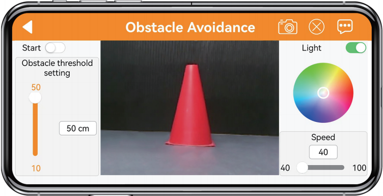

  • Obstacle Avoidance
  • Place the robot on a spacious surface with enough room to move freely.
  • Obstacles should be taller than the ultrasonic sensor for detection.
Tap “Obstacle Avoidance” to enter the mode and tap “Start” to begin. The robot will move forward automatically. When it detects an obstacle, it will turn left until the path is clear, then continue moving forward.
