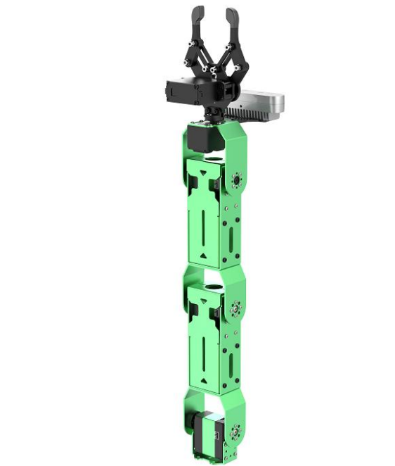

The robotic arm is an automated mechanical device widely used in the field of robotics technology, with application spanning industrial manufacturing, medical treatment, entertainment services, military operations, semiconductor, manufacturing, and space exploration, among others. Despite their varied forms, they share a common characteristic: the ability to receive commands and accurately position themselves in three-dimensional (or two-dimensional) space to perform tasks. Robotic arms equipped with visual systems enhance their functionality. This document will use the example of JetRover with Mecanum wheel chassis to explain the basic structure and motion control of this robotic arm. The control methods for robotic arms with different types of chassis within the same series are similar.
11.1.1 Get to Know Robotic Arm
JetRover is equipped with a 6DOF robotic arm, composed of intelligent bus servos and metal connection components, which can reach any position in feasible space. Six degrees of freedom consist of X-axis movement, Y-axis movement, Z-axis movement, X-axis rotation, Y-axis rotation, and Z-axis rotation, completing actions such as extension, rotation, and lifting. Additionally, it is equipped with a Dabai DCW depth camera, enabling different functions such as hand tracking, color recognition and sorting, color tracking, line following and obstacle avoidance, waste sorting, navigation and transportation.
The below table illustrates the relevant parameters of the robotic arm:
Name Instruction Name Instruction
Servo Composition 35kg*6+20kg*1 High-voltage Bus servo Servo Accuracy 0.2°
Material Anodized aluminium alloy Control Method UART serial port command
Degree of Freedom 6DOF + gripper Communication Baud Rate 115200
Load (gripping and transporting weight) Servo Memory User settings Power-off protection
Wingspan 410mm Read-back Function Support angle value read-back
Effective Gripping Range Radius≤30cm Servo Protection Locked protection/ over-heat protection
Camera Name Dabai DCW depth camera Parameter feedback Temperature, voltage, position
Pixel 200W System Support windows, Linux and Openwrt
Resolution 1920×1080 Frame Rate 60FPS
Connection USB driver-free Focusing Method Auto-focusing
Note:
  • Prior to shipment, our company has completed the debugging of the robotic arm, eliminating the need for users to adjust.
  • This instruction facilitates users in restoring the robotic arm’s status after make modification.
  • The robotic arm is equipped with 6 joints, where the first joint controls the overall horizontal rotation of the robotic arm. During adjustment, it should be ensured that the robotic arm faces forward in relation to the vehicle, avoiding left or right deviation as much as possible.

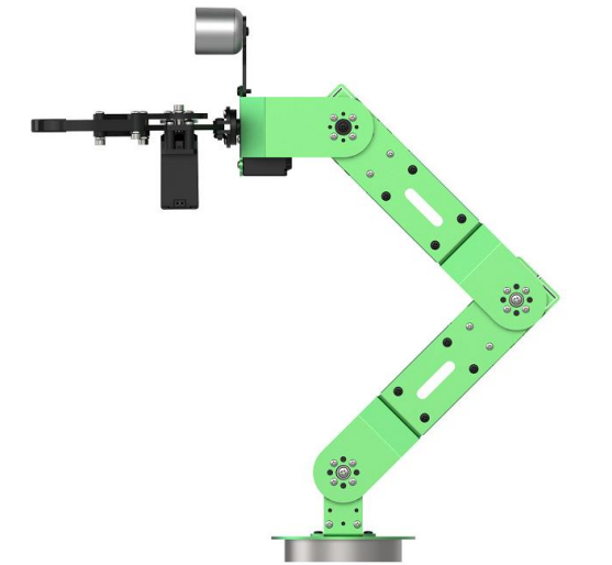

  • Whether there is deviation in the robotic arm servo can be referenced from the side view and top view diagrams provided in this document.

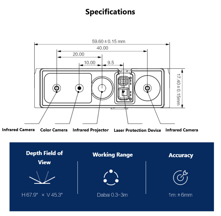

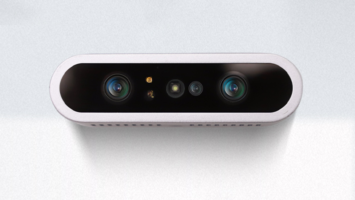

Dabai DCW depth camera is designed for service robot scenarios. Based on self-developed ASIC chips, Orbbec developed the Dabai DCW depth camera, a high-performance binocular structured light camera. The depth image resolution of up to 1920×1080@5/10fps, with an average power consumption of less than 1.2W. With just a USB 2.0 interface, the terminal can obtain high-precision 3D depth information for backend utilization, empowering robots to achieve functions such as perception, obstacle avoidance, and navigation.
Its specification parameters are illustrated below:
The specification of the depth camera:
Parameter Description
Dimension 89.82 ×25.10 ×25.10 mm
Working range 0.2m - 2.5m
Fan Do not support
Baseline 40mm
Power consumption
Average power consumption <2.3W
The maximum power is less than 5.0W (During operation, the duration should be equal to or less than 3ms every 33ms)
Depth FOV
When the camera D2C is not in use, it is H79° V62° D91°±3°.
When the camera D2C is in use, it is H79° V55° D88.5°±3°.
Infrared FOV H79° V62° D91°±3°
Color FOV
16:9: H86° V55° D93.5°±3°
4:3: H64° V55°
Relative accuracy
1.0%(center 81% area) @1000mm
1.1%(center 81% area) @2000mm
Depth resolution @ frame rate 640*400@5/10/15/30fps
320*200@5/10/15/30fps
Operating system Support Android and Windows7/10
Data transmission USB2.0 Type-C
Power Port Type-C
Application scenario Indoor
Safety Class1 laser
Operating temperature 10℃ ~ 40℃
```{note}
Reminder: There may be individual differences in 3D camera products. The product specifications provided are theoretical values and are for reference only. Please rely on actual performance for accuracy.

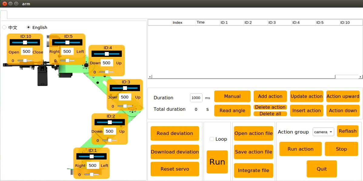

### 11.1.3 PC Software Layout Instruction
* **PC Software Instruction**
The PC computer corresponds to PLC computer, and is used to send instructions to PLC computer (robot) and receive feedback data from PLC computer. In general, we control PLC computer through running software on PC computer.
Only when PC software realizes serial port communication, it can send instructions to and receive feedback data from the robot. Serial port can be considered as USB interface. PC connects to robot through USB interface, and PC software communicate with robot also through USB interface.
The introduction to the PC software functions is given below.
* **Open PC Software**
**1. Open through Robotic Icon**
Click Arm icon to open PC software.
<img class="common_img" src="../_static/media/3/section_95_Robotic Arm Basic Control/media/image10.png" style="width:100px" />
**2. Open through Command**
1. Double click <img src="../_static/media/3/section_95_Robotic Arm Basic Control/media/image11.png" style="width:50px" /> to open terminal.
2. Input the command “**cd software/arm_pc/**” and enter PC software directory.
   ```py
   cd software/arm_pc/
  1. Input the command “python3 main.py” to open PC software.
    python3 main.py
Note: Once the related servo nodes are activated (such as mapping and navigation), PC software or servo tool cannot be opened because the serial port is already occupied.

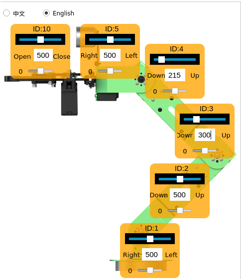

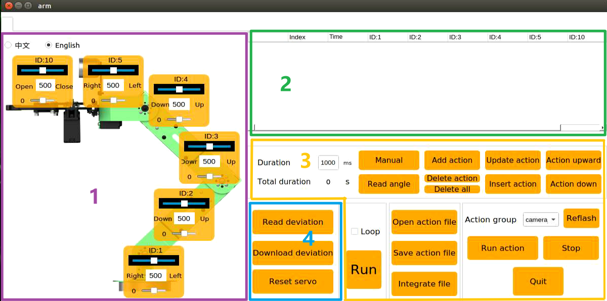

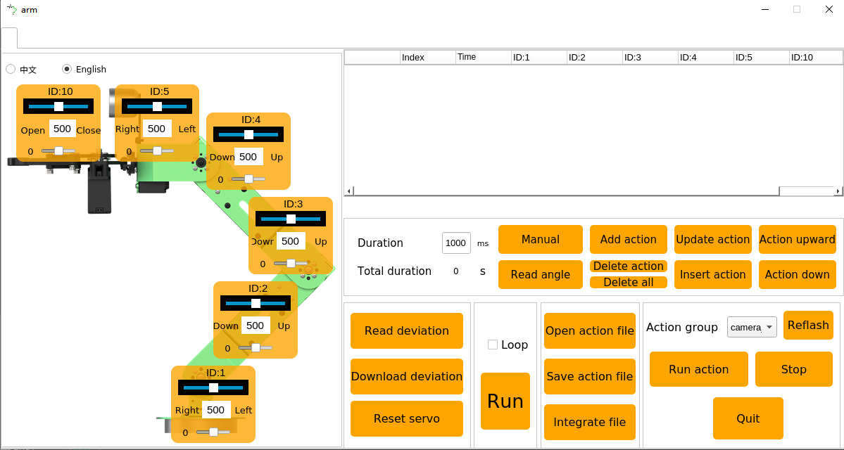

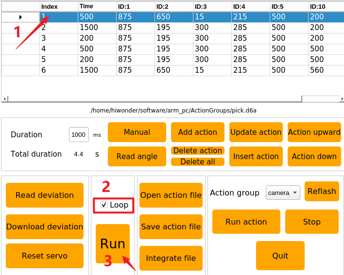

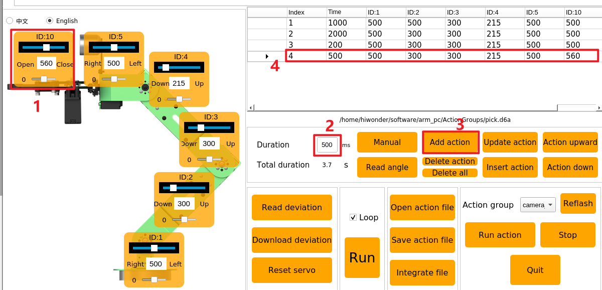

3. PC Software Interface Layout
The interface under “normal mode” is as follow.
You can switch to “Servo Debug Tool” through the options on the upper left corner. Prior to the shipment, all the robots have been debugged, eliminating the need for the user to debug. If any issues require the use of this tool, it is mandatory to operate under the guidance of our support team, as improper use may result in robotic arm malfunctions.
The interface of the normal mode is divided into below areas:
(1):Servo control area
Servo control area displays the icon of the selected servo. You can adjust the servo value by dragging the corresponding slider.
Icon Icon
ID number of servo
Adjust servo position from 0 to 1000.
Adjust servo deviation from -125 to 125.

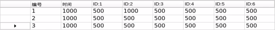

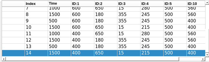

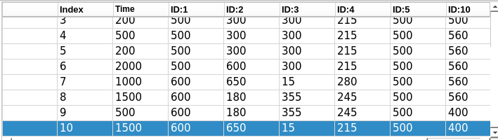

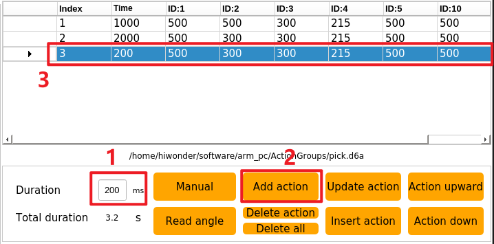

(2):Action list
The running time and servo data of the current action are displayed on the action list.
Icon Function
Action group number
Running time of the action that is time taken to complete this action
Servo value. Double click the figure below to revise.

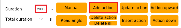

(3): Action group setting
Icon Function
Action running duration time. Directly click to modify.
Total running time taking for all the actions in an action group
If you click this button, joints of robot become loose, and you can drag servos to design any posture
Read the servo angle you have designed before. This button should be used with
Add the servo value as a action to the last line of the action list
Delete action: delete the action selected in the action list
Delete all: delete all the action in action list
Replace the angle value of the action selected in the action list with the servo value in the servo control area. And update the running time as the time set in “Time
Insert a new action above the selected action. The running time of this new action is the time set in “Time” and angle value is the current value in servo control area.
Move the selected action up one line
Move the selected action down one line
Click to run all the actions on the action list once
(If "Loop" is ticked, JetAuto Pro will repeat the action.)

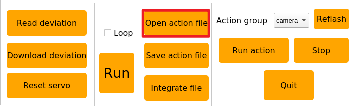

Load the data of the saved action group to the action list
Save the current actions in the action list into the designated path.

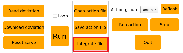

Firstly, open one action group, then click this button, and then open other action group. And these two action groups will be integrated into one.
Display the saved action groups. You can select the action to run.
Refresh action group drop-down menu.
Run the selected action group once.
Stop running the action group.
Exit PC software interface

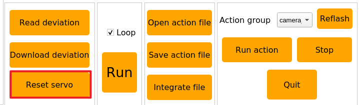

**(4) :Servo deviation setting area**
Icon Function
Click to read the saved servo deviation.
Click to download the adjusted deviation to the robot.
Click to return all the servos to the mid point(500).

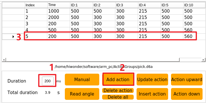

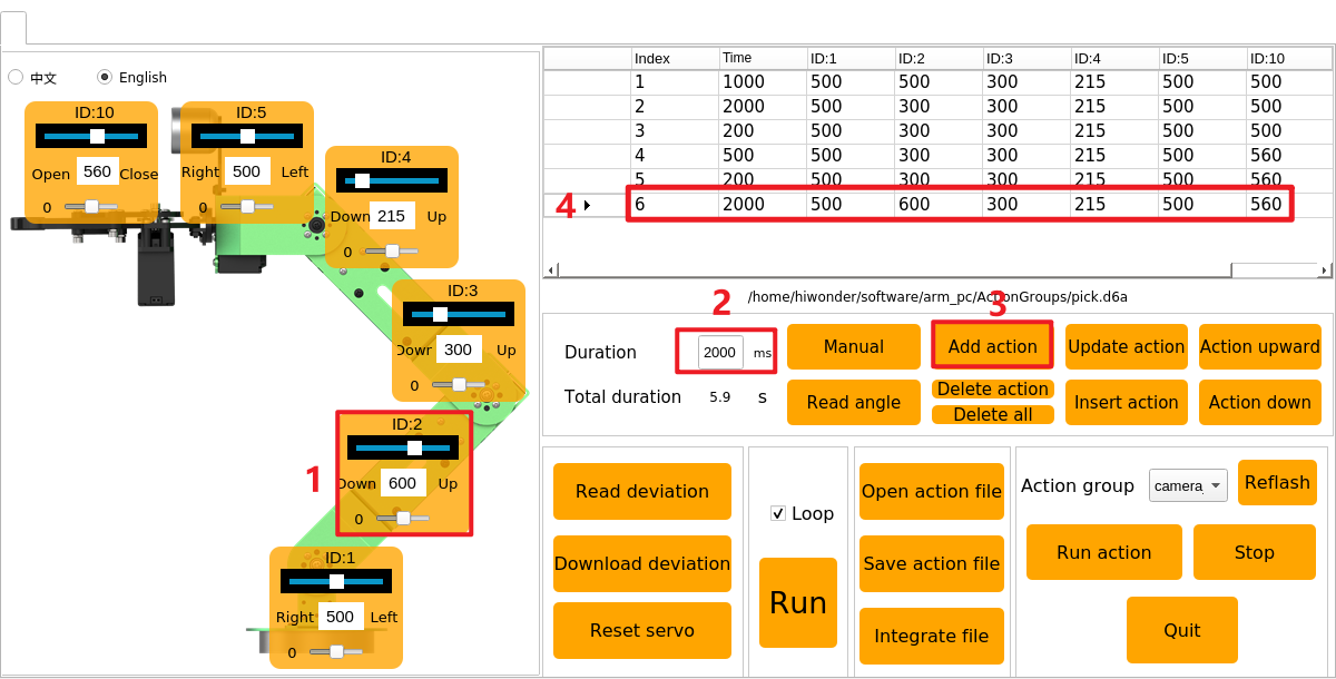

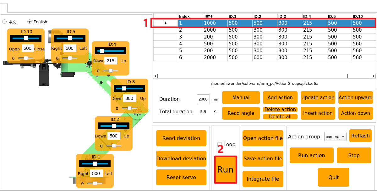

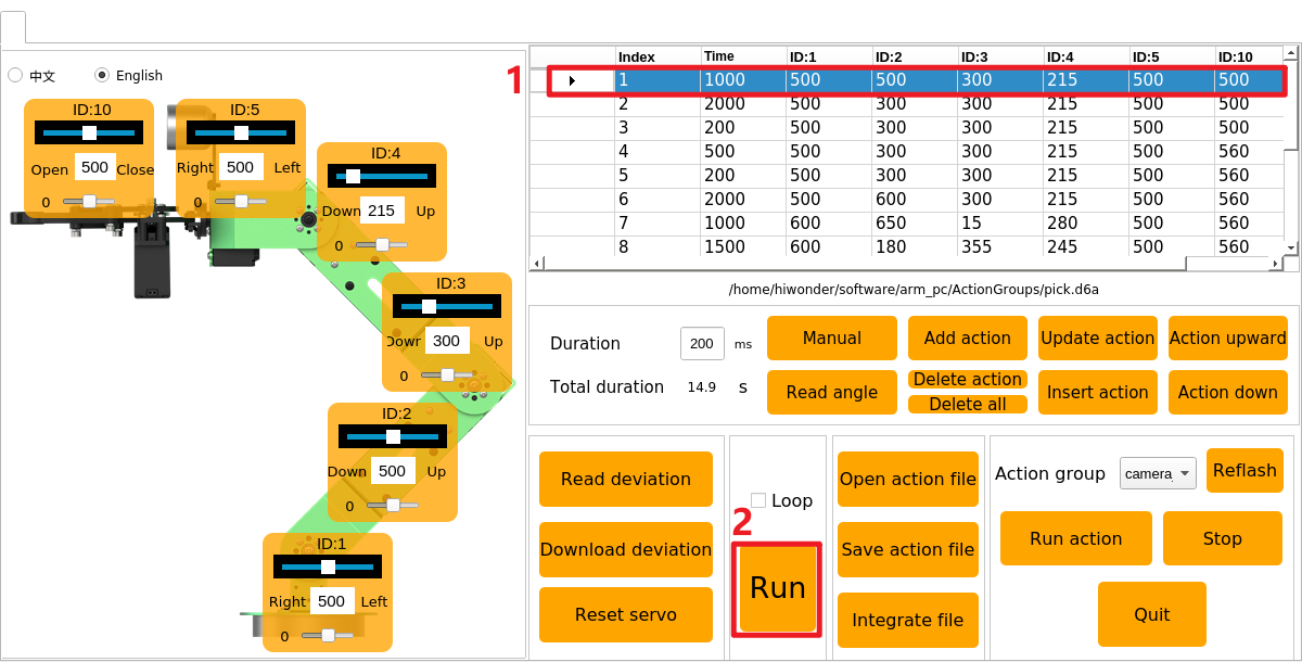

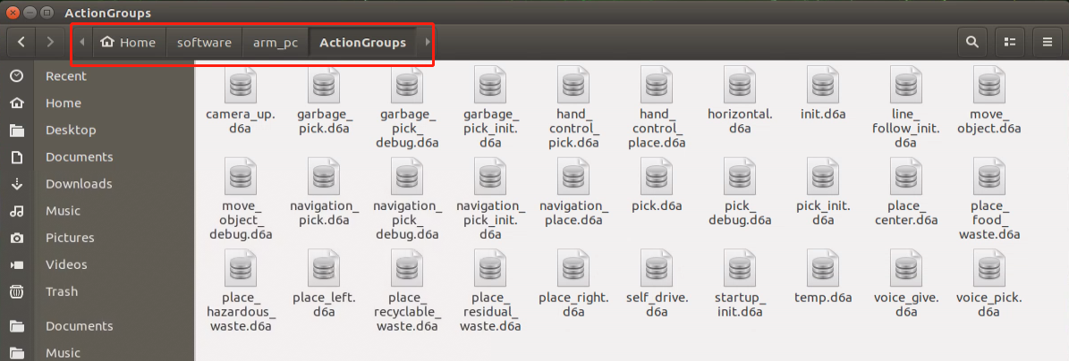

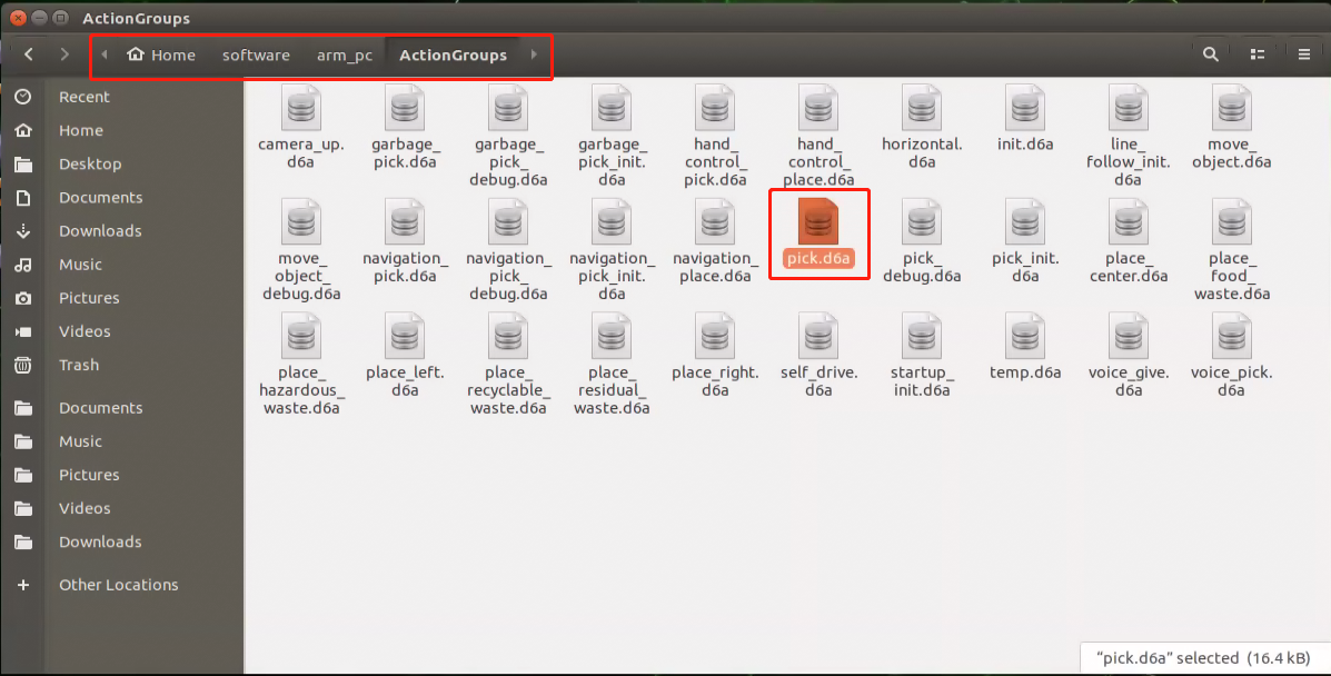

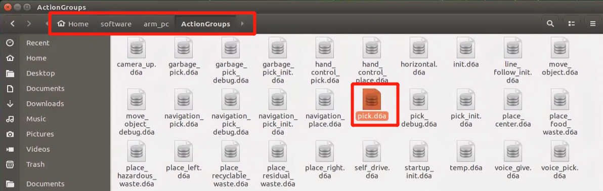

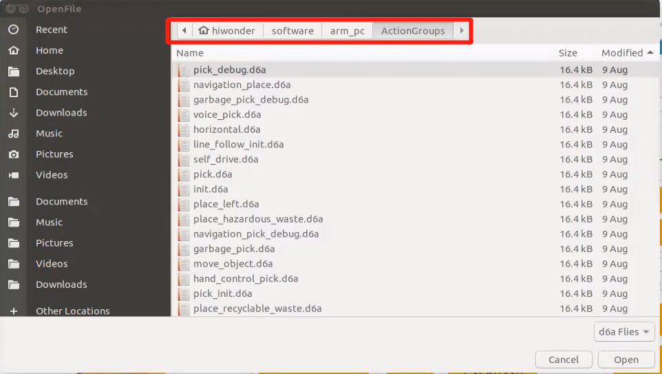

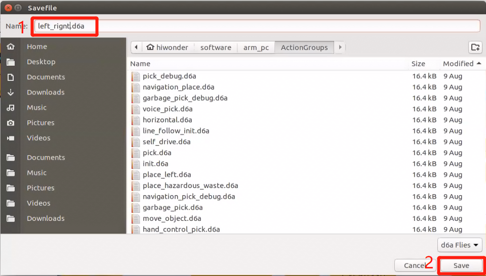

11.1.4 Action Calling
  • What is “Action Calling”

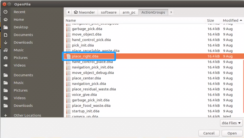

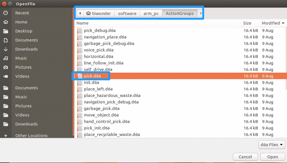

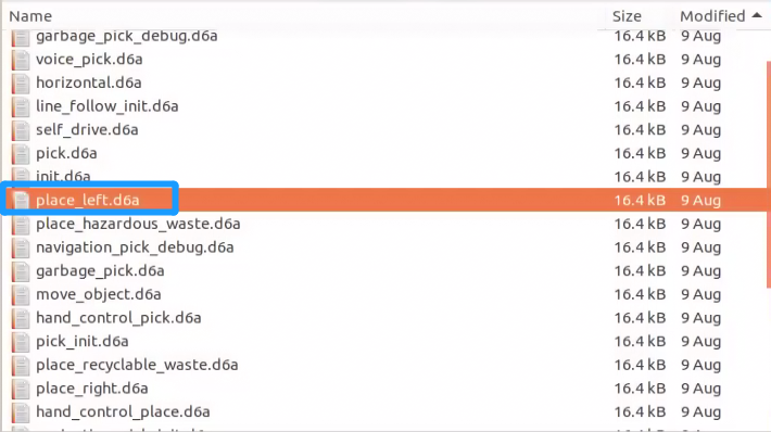

Action calling is to directly call the edited action group via PC software to let robot perform this action.
JetRover has built-in action groups, and its action group files are stored in “hiwonder/software/arm_pc/ActionGroups”. You can check and call built-in actions via PC software or command.
The specific operation steps are as follow:
Note: Only if action files are saved in “hiwonder/software/arm_pc/ActionGroups”, can the files be called
  • Operation Steps
  1. Put down antenna before operation to avoid robot arm of hitting antenna when it is moving.
  2. Double click to enter PC software interface.
  3. Click “Open action file” button.
  4. Select action group you want, then click “Open”.
  5. Running time of each action and servo values are displayed on the action list
  6. You can first select number “1” and click “Run” button to run the selected action in action list. If you want to make robot repeat this action group, you can tick “Loop” and click “Run”.

  • Action Realization
1. Design Action

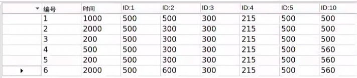

  3. Click “Reset servo” to make servo return back to mid-point.
  4. Drag the slider to set servo values as pictured to make robot arm bend to left.
  5. Click “Add Action” to add current action to action list.

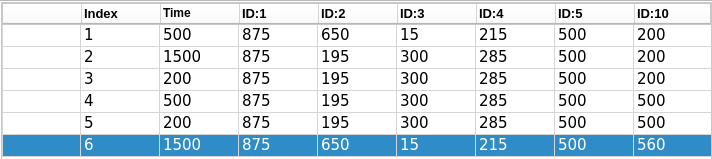

  6. Align robot arm with the block. Adjust value of corresponding servos as follow.
  7. Set the time as “2000ms”. Click “Add Action” to update NO.2 action.
  8. Add another transitional action. Set the time as 200ms and click “Add Action”.
  9. Adjust NO.10 servo to let robot arm pick the block. Set times as 500ms, then click “Add Action
  10. Add a transitional action again. Set the time as “200ms”, and click “Add action” to form NO.5 action.
  11. Adjust servo value to make robot arm pick the block to specific height. Set the time as 2000 ms, and click “Add action
  12. After NO.6 action is edited, action group of “picking block at left” is complete.
  13. Next, let robot arm run the whole action group. Select NO.1 action, then click “Run”. If you want to repeat this action, tick “Loop” box.

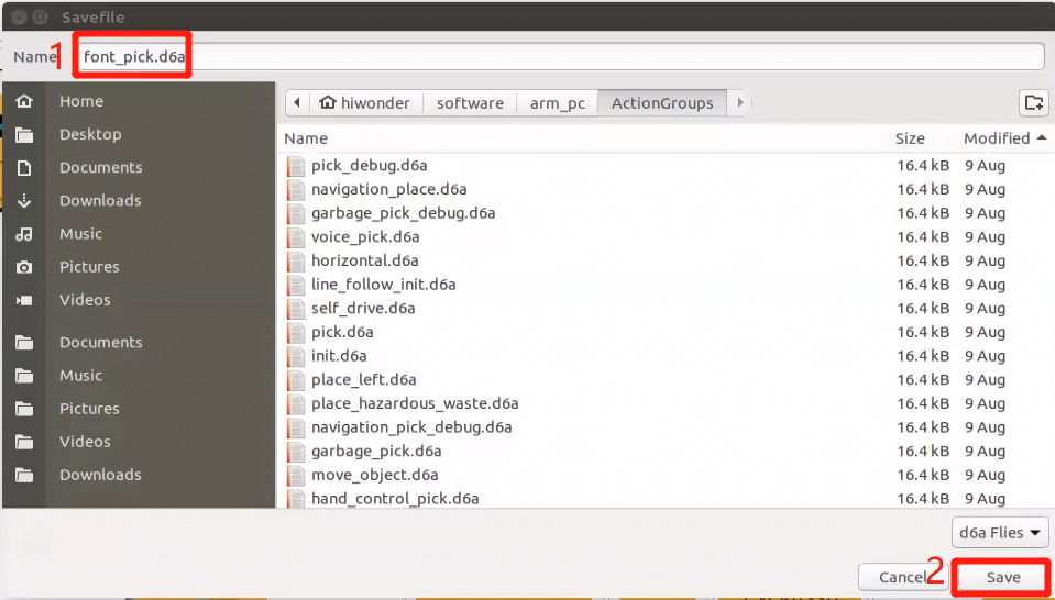

2. Save Action
Note: the name of action group cannot contain “Space”, otherwise the file cannot be saved in later debugging.
In case of future debugging and management, save the edited action group. Click “Save action file” and select this path, hiwonder/software/arm_pc/ActionGroups.
Here takes the name of “font_pick” as example, and then click “Save” to save the action group.

  1. Click “Integrate files” button, and select the following path.
  2. Select and open “place_left.d6a” on the pop-up window.
  3. This action group is added to the action list.
  1. Click “Integrate action files” button again. Select and open “place_right.d6a”. After that, this action group is added to the end of the first action group.
  1. Click NO.1 action, then click “Run” to let robot arm perform this integrated action.
  1. Click “Save action files” button to save this new action group in case of future debugging.
  1. Name this new action group, for example “left_right”.
Note: action group name cannot contain “Space”.
11.1.7 Export and Import Action Files
  • Introduction
Export the action group files edited on PC software, and import them to other devices of the same type.
  • Export Action

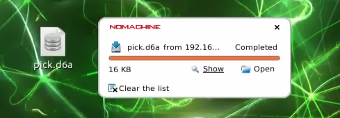

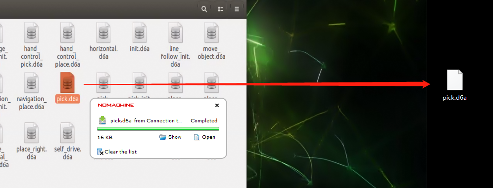

This section illustrates the export and import of the “pick.d6a” action group file as an example.
  1. Click
  2. Find “pick.d6a” file.
  1. Directly drag the action file to the computer desktop to export this file.
  • Import Action
  2. Directly drag “pick.d6a” action file to robot system desktop.
  1. Then directly drag or copy “pick.d6a” file to following path.
  1. Double click to enter PC software interface.
  1. Click “Open action files” button. Find the file you just import, and open it.
Or directly select the imported action group in this drop-down menu.
  1. Click “Run” button to let robot arm execute this action group.

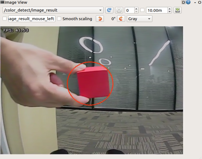

    Input the command “roslaunch jetauto_example hand_track_node.launch use_depth_cam:=true” to start the program and capture the image from the depth camera.
  3. Open a new command line terminal and input the command “rqt_image_view” to check the image.
    rqt_image_view
Note: Capturing images from the depth camera requires you to move the hands up and down in front of the depth camera. It has the same realization effect with monocular camera.

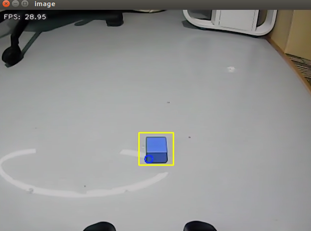

11.2.3 Color Recognition and Sorting
  • Program Logic
With the further development of automation technology, production line in manufacturing enterprises are increasingly moving towards automation and intelligence.As a result, a large number of automated devices are gradually being introduced into the production lines. Among them, in the process if martial color recognition, positioning, and sorting, visual systems are required for tasks such as image acquisition and data analysis to effectively identify and locate the color of the samples. Motion control technology provides effective solutions for visual color recognition, positioning, and sorting to improve the production capacity of enterprises.
The vision detection method using motion control technology features fast detection speed, good reliability, and high efficiency. It can achieve non-contact and non-destructive testing. Machine vision color recognition, positioning, and sorting have good applicability in various industries and have widespread market applications.
First, subscribe to the topic messages published by the color recognition node to obtain recognition color information and images.
Next, invoke the initialization action group file to prepare the robotic arm for the desired posture.
Finally, based on the required color information, match the corresponding sorting actions and then execute the sorting actions to sort the color blocks into the respective areas.
The robot performs sorting tasks after recognizing the colored blocks from its own perspective. Prior to starting, ensure that the blocks required for this game are prepared.
The source code of the program is located in /home/hiwonder/ros_ws/src/hiwonder_example/scripts/hand_track/hand_track_node.py
  • Operation Steps
Note: The entered command should be case sensitive and “Tab” key can be used to complement the key words.
  1. Start JetRover and connect it to NoMachine.
  1. Double click on to open the command line terminal.
  2. Input the command “sudo systemctl stop start_app_node.service” and press Enter to disable the app service.
  3. Input the command “roslaunch hiwonder_example color_sorting_node.launch” and press Enter to start the program.
  4. If you want to exit the game, please press “Ctrl+C” in the terminal. If fail to do so, please try multiple times.
  • Outcome
After the game starts, the robotic arm turns left to prepare itself for the sorting. Place the target block within the yellow box in the middle of the transmitted image. Once the block is recognized, the robotic am will transport them to their corresponding areas.
The red color block will be transported to the position directly in front and center of the robot; the green color block will be transported to the position in front of the robot, towards its left side; the blue color block will be transported to the position in front of the robot, towards its right side.

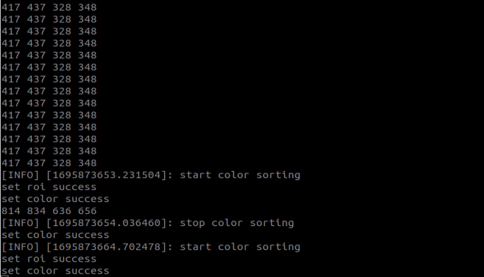

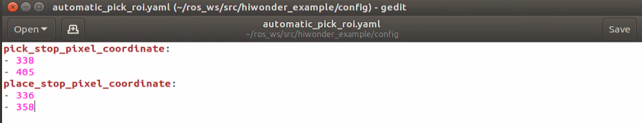

  • Gripping Calibration
The default recognition and gripping area of the program is located in the middle. In normal circumstances, no adjustment is necessary. However, due to differences in camera parameters, there may be situations where the robot arm cannot grip the blocks. This can be addressed by adjusting the position of this area through program instructions. The specific steps are as follow:
  3. Input the command “roslaunch hiwonder_example color_sorting_node.launch debug:=true” to enter the program.
  4. Wait for the robotic arm to move to the gripping position, then place the color block in the center of the gripper. When the robotic arm resets, mark the position of the recognition box. Then the robotic arm will perform the gripping action. After calibration is completed, the pixel coordinates of the color block in the image and completion message will be printed in the terminal.
  5. Run the program according to “11.2.3 Color Recognition and Sorting->Operation Steps”.

  4. Open a new command line terminal and input the command “rqt_image_view” to view the live camera feed.
    rqt_image_view
  5. If need to terminate the game, please press “Ctrl+C” in the terminal. If fail to do so, please try multiple times.
  • Outcome
After the game starts, place the red block in front of the camera. The recognized color will be displayed in the image and the robotic arm will follow the movement of the target block.

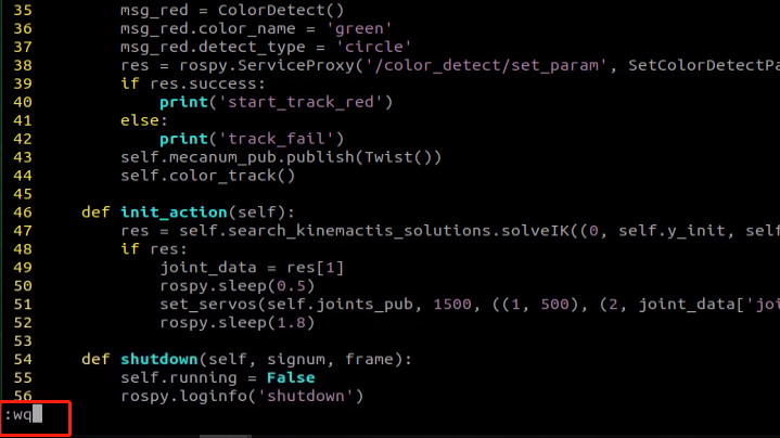

  2. Input the command “roscd hiwonder_example/scripts/color_track/” and press Enter to access the program directory.
  3. Input the command “roscd hiwonder_example/scripts/color_track/” to open the program file.
    vim color_track_node.py
  4. Press “i” key to enter edit mode and modify the assignment of the “msg_red.color_name” parameter to “green”.
  5. After the modification is completed, enter “:wq” to save and exit the program file.
  6. Operate the game based on “11.2.4 Color Tracking->Operation Steps”.

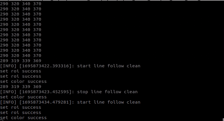

  • Gripping Adjustment
In the program, the recognition and gripping area are located in the middle of the image by default, no need for adjustment. However, due to the discrepancy in camera parameters, there might be cases where the robot arm cannot grip the color black. In such situations, you can adjust the position of this area using commands. Here are the specific steps:
  3. Input the command “roslaunch hiwonder_example line_follow_clean_node.launch debug:=true” to start the test mode.

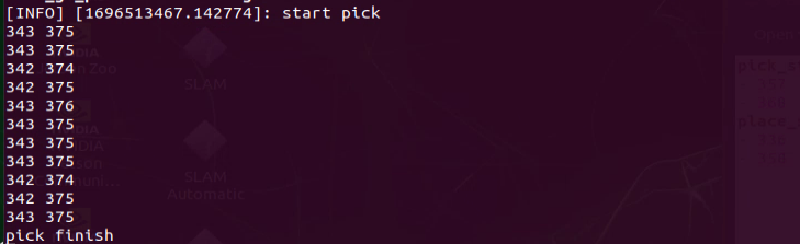

  4. In this mode, the robot will terminate line following but retain the block picking action. After JetRover reaches the gripping position, place the block in the middle of the gripper and wait for robotic arm to restore its initial posture, mark the position of the recognition box, then wait for the robotic arm to perform the gripping action. Once the calibration is complete, it will print out the pixel coordinates of the block on the screen and a completion message in the terminal.
  1. Finally, run the program according to “11.2.5 Line-Following Obstacle Clearance->Operation Steps”.

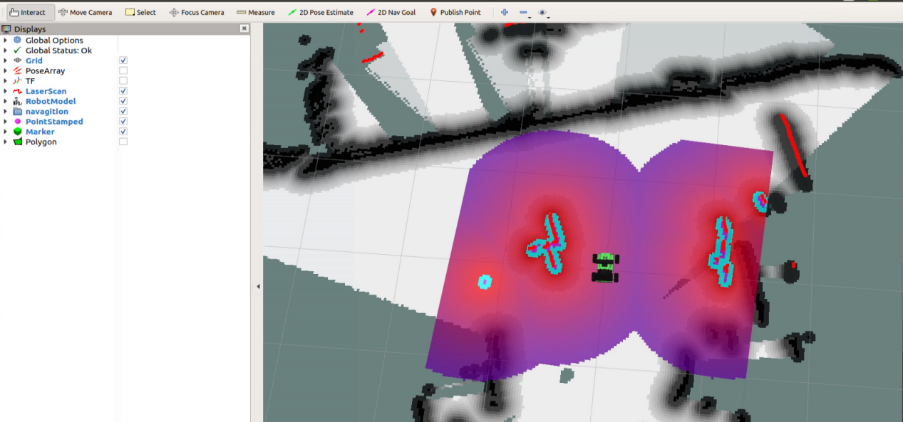

  • Outcome
After opening RVIZ, you need to first check if the position of the robot on the map aligns with its actual potion. If they do not align, manual adjustment may be required. You can utilize the “2D Pose Estimate” tool in RVIZ to perform this adjustment.
There are three tools in the menu bar, including 2D Pose Estimate, 2D Nav Goal and Publish Point.
2D Pose Estimate” is used to set the initial position of JetRover, “2D Nav Goal” is used to set a target point and “Publish Point” is used to set multiple target points.
Click “2D Nav Goal” in the menu bar, and select one point by clicking the mouse as the target destination. After the point is set, JetRover will automatically generate the route and move toward the point.
After navigating to the location with the blue block, the robot will automatically grasp the block upon recognition. Then, it will navigate to the placement area with the red mark. Upon arrival, the robot will automatically place the block, completing the transportation task.
Note: when the program starts, it can merely complete the entire process once. If you need to perform another gripping and placing cycle, you will need to restart the game.
The default recognition and gripping area of the program is located in the center of the image. No adjustments are required for the normal circumstance. If the robotic arm fails to grip the colored blocks during the game, you can adjust the position of this area through the program command. The specific steps are as follow:
  1. Start JetRove and connect it to Nomachine remote control software.
  2. Click on to open the command line terminal. Input the command “roslaunch hiwonder_example automatic_pick.launch debug:=ture”.
  3. After the robotic arm reaches the gripping position, place the colored block at the center of the gripper and wait for the robotic arm to reset before griping again, indicating the calibration is completed. Upon the completion of the calibration, the terminal will print the pixel coordinates of the colored block in the image and the “print finish” prompt message.
    pick_stop_pixel_coordinate” refers to the pixel coordinates of the gripping position in the image. The first parameter represents the x-axis coordinate. Decreasing this value shifts the horizontal position to the left, while increasing it shifts the gripping horizontal position to the right. The second parameter represents the y-axis coordinate. Decreasing this value moves the gripping position closer, while increasing it moves the gripping position farther away. Generally, you can rely on automatic calibration results, but you can also adjust it according to your personal preference.
    place_stop_pixel_coordinate” refers the pixel coordinates of the placement position in the image. The first parameter represents the x-axis coordinate. Increasing this value shifts the placement position to the left, while decreasing it shifts the placement position to the right. The second parameter represents the y-axis coordinate. Decreasing this value adjusts the placement position closer, while increasing it moves the gripping position farther away.
Note: Automatic calibration solely calibrates the coordinates of the gripping position. The coordinates of the placement position are not automatically calibrated. If a placement target is set and the placement effect is not satisfactory, manual adjustment is required.
4) Upon the completion of the modification, please start the game according to “11.2.7 Fixed Point Navigation->Operation Steps”.

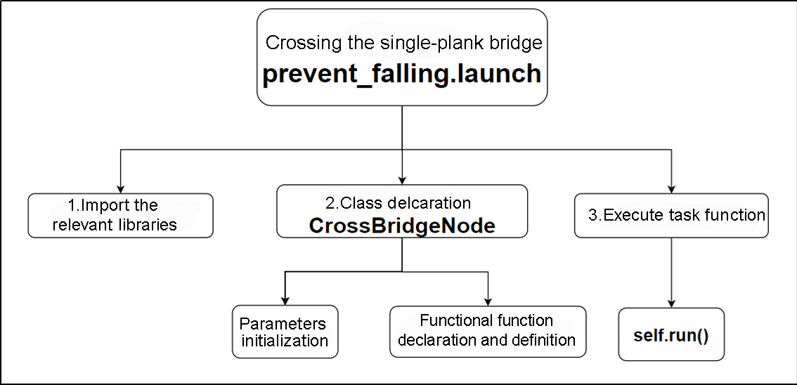

  • Program Analysis
The program of the edge detection will be analyzed in this section. The path to the source code of the program is as follow: ~/ros_ws/src/hiwonder_example/scripts/rgbd_function/prevent_falling_node.py
1. Import Module
#!/usr/bin/env python3
# encoding: utf-8
# @data:2023/12/18
# @author:aiden
# 防跌落

This section will primarily focus on analyzing the program of crossing the single-plank bridge. The path to the source code of the program is as follow:
~/ros_ws/src/hiwonder_example/scripts/rgbd_function/cross_bridge_node.py

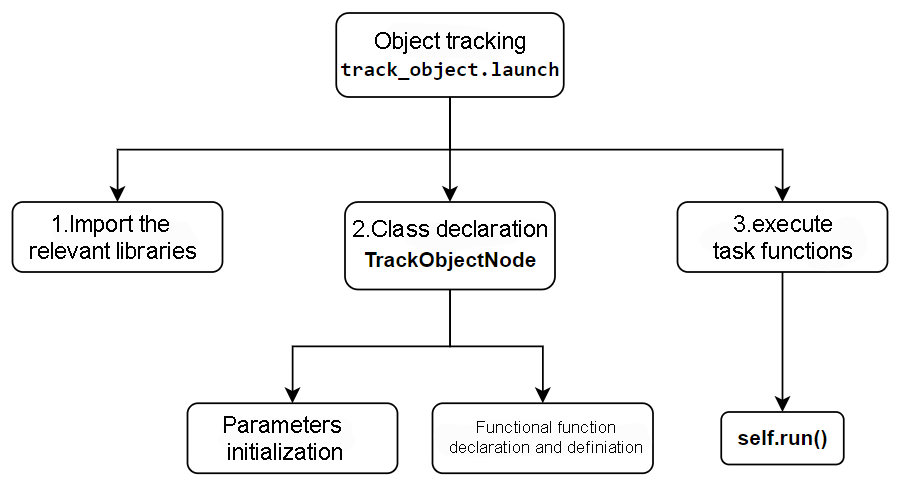

11.3.3 Object Tracking
  • Overview
Object Tracking involves implementing vision-based object tracking and robot motion control. It combines functionalities such as image processing, point cloud processing, PID control, robot motion control, visualization, and interaction. It can be used to guide the robot to automatically track and approach specific objects.
  • Operation Steps
Note: the entered command should be case sensitive, and the “Tab” key can used to complemented the key words.
  1. Start JetRover and connect it to Nomachine remote control system. Regarding the Remote desktop tool installation and connection, please refer to “Appendix->Remote Desktop Software.”
  2. Double click on to open the command line terminal.
  3. Input the command “sudo systemctl stop start_app_node.service” and press Enter to disable the app service.
  4. Input the command “roslaunch hiwonder_example track_object.launch” to start the game.
  5. If you want to exit this game, press “Ctrl+C” in the terminal. Fail to do so requires multiple tries.
  • Outcome
After initiating the game, the camera will track the object and control the robot to move accordingly.
  • Program Analysis
/home/hiwonder/ros_ws/src/hiwonder_example/scripts/rgbd_function/
The track_object_node.py and track_object.launch files.
Initialization function def __init__(self, name):
  1. ROS service and publisher initialization:

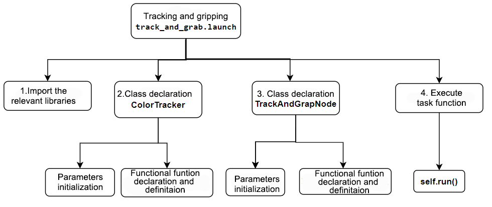

11.3.6 Tracking and Gripping
  • Overview
Combining depth vision and robot control techniques, this system identifies and tracks objects of specific colors, completing precise grasping actions. It utilizes a depth camera to capture images and depth information, employs color tracking algorithms to locate the target object, and uses a robotic arm for object operations. Features include using the OpenCV library to identify objects of specific colors in images, computing the exact position of objects in three-dimensional space using depth information, adjusting the movement of the robotic arm using PID controllers to precisely track and approach the target object. This system can be applied in automated production lines to achieve precise object picking and placing tasks, such as in service robots and automation.
  • Operation Steps
  4. Input the command “roslaunch hiwonder_example track_and_grab.launch” to start the game.
  • Outcome
After initiating the game, the robot will identify objects such as cylinders, cubes, spheres, etc., in the scene, then the robotic arm will track there items and perform gripping action once they are recognized.
  • Program Analysis
track_and_grab.py and track_and_grab.launch files.

  • Class ColorTracker
Class is used for tracking a specific color.
Contains a PID controller used to adjust the position of the colored block in the image, aiming to keep it as close to the center of the image as possible.
Proc method for image processing. It identities regions of specific color and adjust the central position of the colored block using a PID controller
  • Initialization (__init__)
    target_color: the target color to be tracked.
pid_yaw and pid_pitch: these two PID controllers are respectively used for adjust the later (yaw) and vertical (pitch) positions of the object in the image, This allows the colored target object to remain centered in the image.
yaw and pitch: these variables record the current yaw and pitch angles.
  • Image Processing Method (proc)
    Image Preprocessing:
Firstly, the size of the source image is halved to reduce the computational load.
Then, Gaussian blur (cv2.GaussianBlur) is applied to smooth the image, which helps reduce noise.
Lastly, the image is converted from the RGB color space to the LAB color space (cv2.cvtColor). The LAB color space is more suitable for color segmentation.
    def proc(self, source_image, result_image, color_ranges):
        h, w = source_image.shape[:2]
        color = color_ranges['lab']['Stereo'][self.target_color]
        img = cv2.resize(source_image, (int(w/2), int(h/2)))
        img_blur = cv2.GaussianBlur(img, (3, 3), 3) # 高斯模糊
        img_lab = cv2.cvtColor(img_blur, cv2.COLOR_RGB2LAB) # 转换到 LAB 空间
  1. Color Segmentation:
Use cv2.inRange to perform binary thresholding on the LAB image, retaining only pixels within a specific color range.
       mask = cv2.inRange(img_lab, tuple(color['min']), tuple(color['max'])) # 二值化
  1. Morphological Processing:
Perform erosion (cv2.erode) and dilation (cv2.dilate) operations on the binary image. This helps to remove small noise and highlight the main objects.
        # 平滑边缘,去除小块,合并靠近的块
        eroded = cv2.erode(mask, cv2.getStructuringElement(cv2.MORPH_RECT, (3, 3)))
  1. Contour Detection:
Utilize cv2.findContours to detect contours in the processed image. Iterate through the contours to find the most suitable one (typically the contour with the largest area).
        contours = cv2.findContours(dilated, cv2.RETR_EXTERNAL, cv2.CHAIN_APPROX_NONE)[-2]
  1. Target Tracking and PID Control:
If a suitable contour is found, compute its minimum enclosing circle (cv2.minEnclosingCircle) to determine the object’s center position and size.
        for c in contours:
            if math.fabs(cv2.contourArea(c)) < 50:
                continue
            (center_x, center_y), radius = cv2.minEnclosingCircle(c) # 最小外接圆
            if min_c is None:
                min_c = (c, center_x)
            elif center_x < min_c[1]:
        # 如果有符合要求的轮廓
        if min_c is not None:
            (center_x, center_y), radius = cv2.minEnclosingCircle(min_c[0]) # 最小外接圆
Utilize PID controllers to adjust the position of the object, aiming to keep it as close to the center of the image as possible.
The pid_yaw controller adjusts the horizontal position (yaw), while the pid_pitch controller adjusts the vertical position (pitch).
            # 圈出识别的的要追踪的色块
            circle_color = common.range_rgb[self.target_color] if self.target_color in common.range_rgb else (0x55, 0x55, 0x55)
            cv2.circle(result_image, (int(center_x * 2), int(center_y * 2)), int(radius * 2), circle_color, 2)
            center_x = center_x * 2
            center_x_1 = center_x / w
            if abs(center_x_1 - 0.5) > 0.02: # 相差范围小于一定值就不用再动了
                self.pid_yaw.SetPoint = 0.5 # 我们的目标是要让色块在画面的中心, 就是整个画面的像素宽度的 1/2 位置
                self.pid_yaw.update(center_x_1)
                self.yaw = min(max(self.yaw + self.pid_yaw.output, 0), 1000)
                self.pid_yaw.clear() # 如果已经到达中心了就复位一下 pid 控制器
            center_y = center_y * 2
            center_y_1 = center_y / h
            if abs(center_y_1 - 0.5) > 0.02:
                self.pid_pitch.SetPoint = 0.5
                self.pid_pitch.update(center_y_1)
                self.pitch = min(max(self.pitch + self.pid_pitch.output, 100), 720)
                self.pid_pitch.clear()
  1. Return of Results:
The method returns the processed image, current yaw and pitch angles, as well as the coordinates and radius of the object’s center.
return (result_image, (self.pitch, self.yaw), (center_x, center_y), radius * 2)

  • Outcome
Bring the object to be recognized (which can be rectangular prisms, spheres, cylinders, and their respective colors) to the front of the camera. Then, the camera will perform recognition and gripping actions in sequence based on their distance from the center of the camera’s viewpoint, starting from the closest to the farther. After successfully picking up an object, it will sort them according to their different categories and place them in their designated positions.

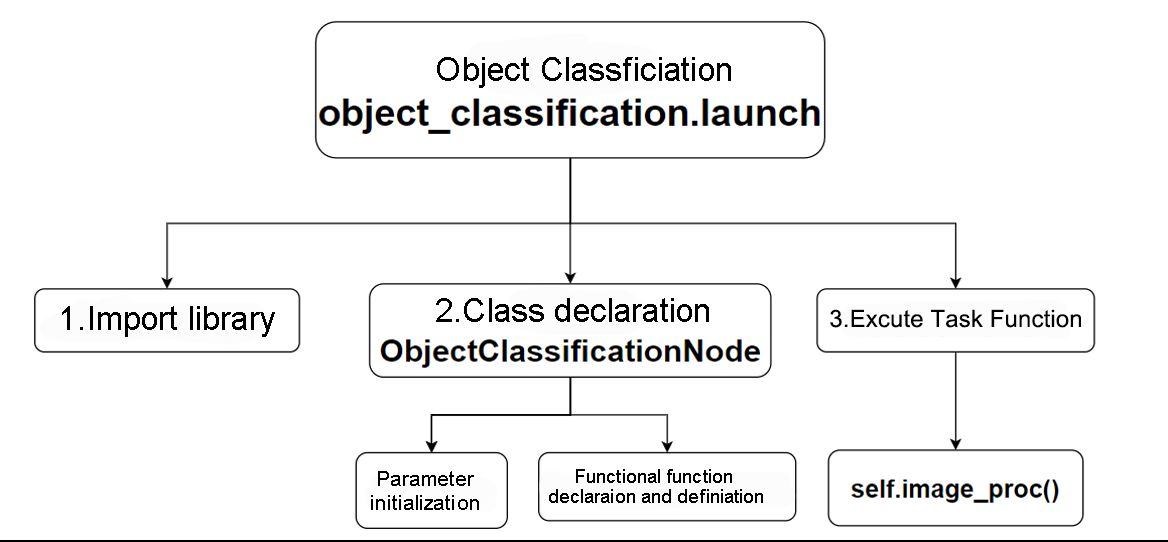

  1. Import the relevant libraries
    import sys
    import cv2
    import math
    import rospy
    import queue
    import signal
    import threading
    import numpy as np
    import message_filters
    from std_srvs.srv import SetBool
    from hiwonder_sdk import pid, common, fps
    from xf_mic_asr_offline import voice_play
    from sensor_msgs.msg import Image, CameraInfo
    from position_change_detect import position_reorder
    from ros_robot_controller.msg import BuzzerState
    from std_srvs.srv import Trigger, TriggerResponse
    from hiwonder_interfaces.srv import SetStringList
    from hiwonder_kinematics import kinematics_control
    from hiwonder_servo_msgs.msg import MultiRawIdPosDur
    from hiwonder_servo_controllers import bus_servo_control
    sys.path.append('/home/hiwonder/software/arm_pc')
    from action_group_controller import ActionGroupController
Import modules: The code first imports some necessaries Python module.
These module includes os, sys, cv2 (used for computer vision), math, rospy (ROS python client library), queue, signal, threading, numpy (for numerical computing), message_filters, and some custom modules.
ROS node:
Using rospy library, this code is part of a ROS node. ROS nodes are independent processes that perform specific tasks, and they interact with each other through ROS communication.
Threads and signal handling:
The code uses the threading and signal modules, indicating that it involves multi-threaded programming and signal handling.
Service calls:
The services imported from other modules, such as SetStringList and Trigger, indicate that this code involves interacting with ROS services.
Data Processing:
By importing various message types such as Image, CameraInfo, BuzzerState, MultiRawIdPosDur, etc., the code involves receiving and processing data from various sensors and devices.
Image Processing:
Since OpenCV is imported (represented by cv2), the code involves image processing, such as capturing, processing, or analyzing images from the camera.
Control Logic:
Importing modules related to robot control, such as pid, common, fps, kinematics_control, and bus_servo_control, indicates that the code involves robot motion control and logic.
Speech Broadcast:
By importing the voice_play module, the code includes functionality related to speech, such as playing pre-recorded audio messages.
Position Detection:
By importing the position_reorder module, the code involves detecting and reordering the positions of objects.

  • Class for Object Classification Execution (ObjectClassificationNode):
    class ObjectClassificationNode:
    Through this class, initialization of relevant parameters for object classification and execution of the object classification function can be achieved.

  • Drawing Result Images and Printing Messages:
                    cv2.rectangle(rgb_image, (self.roi[2], self.roi[0]), (self.roi[3], self.roi[1]), (255, 255, 0), 1)
                    bgr_image = cv2.cvtColor(rgb_image, cv2.COLOR_RGB2BGR)
                    self.fps.update()
                    result_image = np.concatenate([depth_color_map, bgr_image], axis=1)
                    cv2.imshow("depth", result_image)
    Use the cv2.rectangle function to draw the minimum bounding rectangle of the currently recognized object.
    Perform spatial transformation on the BGR image by converting the RGB image to a BGR image.
    Finally, display the image using the cv2.imshow() function.
