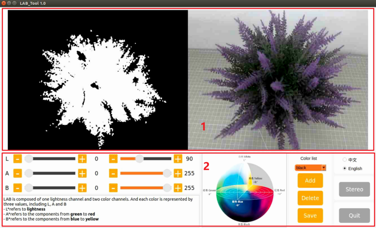

20.1.2 LAB TOOL Interface Layout Instruction
  1. Image display area: the left displays the processed image and the right is the raw image.
Note: if the transmitted image does not display normally, it’s the issue of camera connection. In this case, you need to examine if the wiring is connected properly or reconnect it.

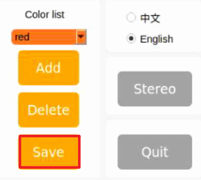

  1. Recognition adjustment area: adjust the color threshold. The function of each button refer to the following table:
Icon Function instruction

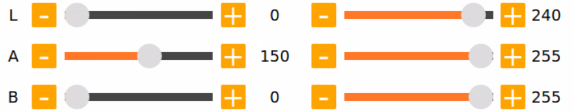

The sliders L, A and B are used respectively to adjust the values of the corresponding L, A and B components of the image.
The sliders on the left are the “min” value for each component while the slider on the right are the “max” value for each component.
Add recognizable color.
Close LAB TOOL.

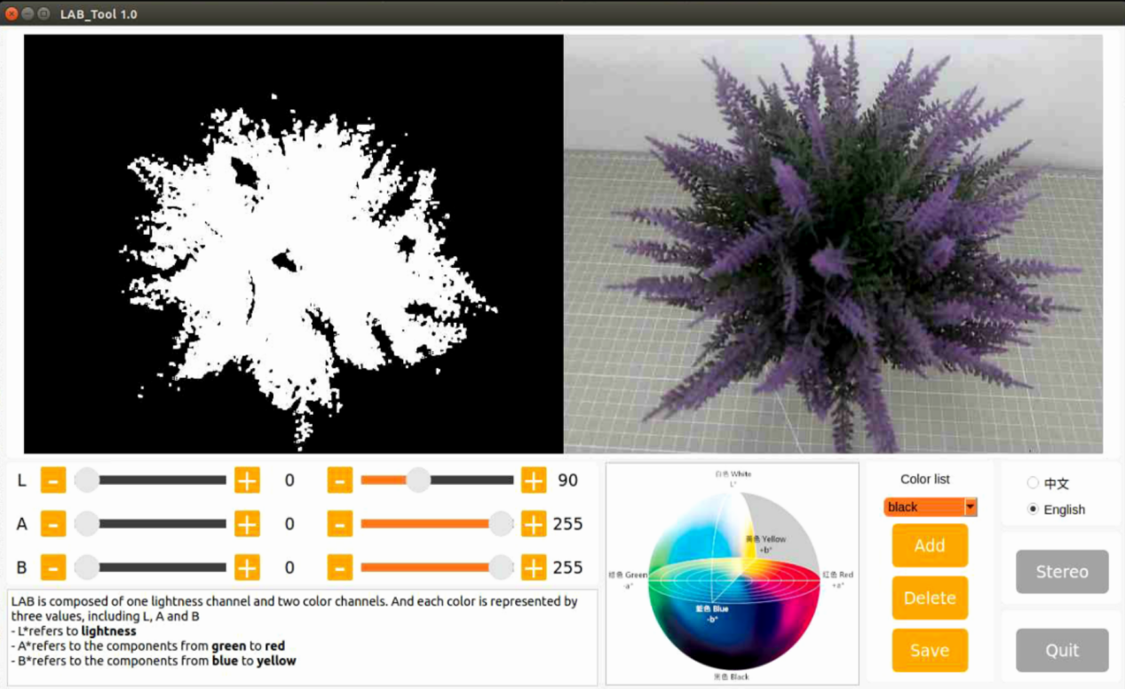

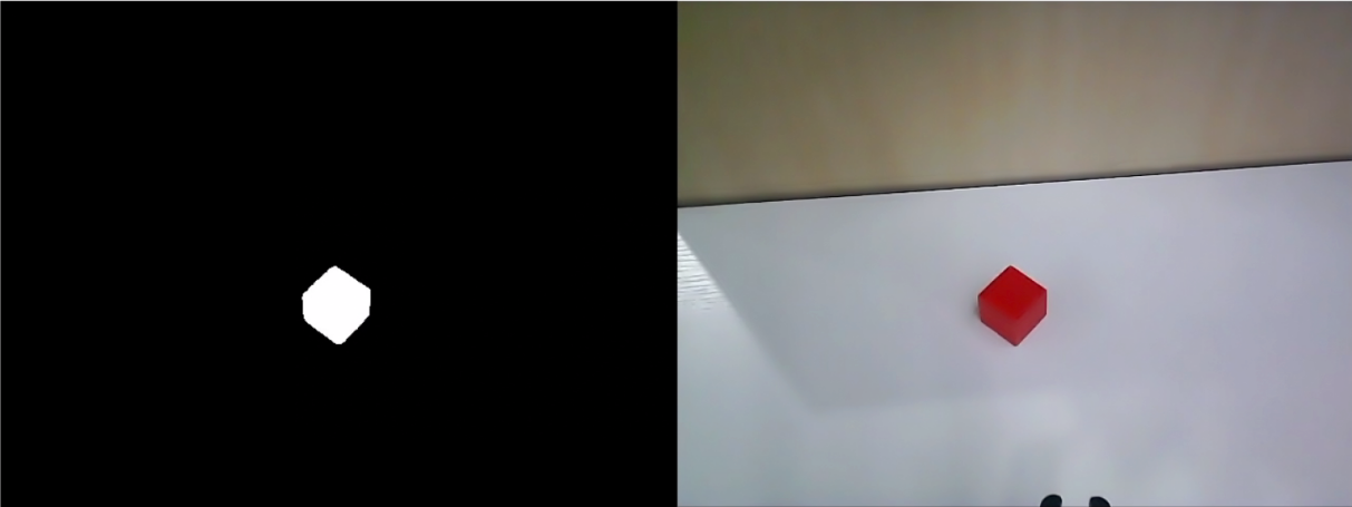

20.1.3 Adjust Color Threshold
  1. Open LAN tool. Choose the color in the color drop-down list of color recognition area. Take a color “red” as example.

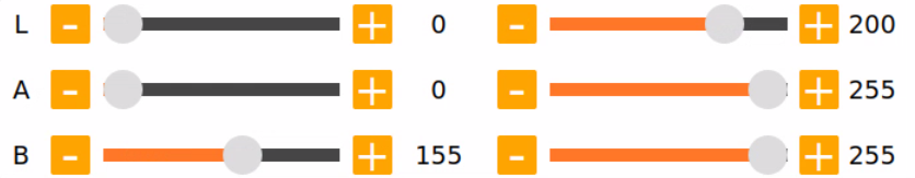

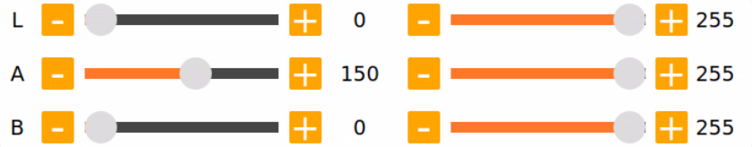

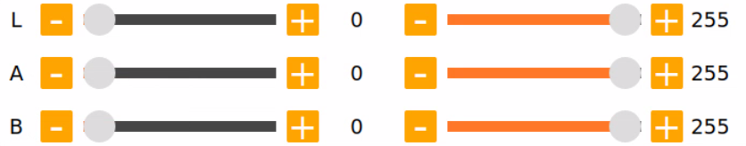

  1. Adjust the “min” values of L, A and B components to “0”, the “max” values to “225”.
  1. Place the target within the camera’s field of view. Adjust the values of L, A and B component towards the interval representing the target recognition color according to the LAB color space distribution chart.
  1. Adjust the L and B components according to your surroundings. If the red color is light, increase the “min” value of the L component; if it is dark, decrease the “max” value of the component. If the red color tends to be warm, increase the “min” value of the B component; if it tends to be cool, decrease the “max” value of the B component.
L 0~255 Black-white (-L~+L)
A 0~255 green-red(-a ~ +a)
B 0~255 Blue-yellow(-b ~ +b)

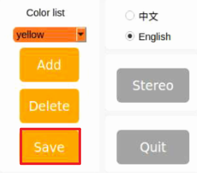

  1. Click “Save settings” button in adjustment area to save the adjustment parameters.

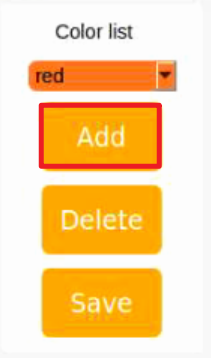

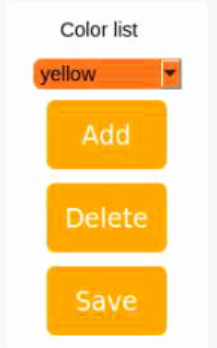

20.1.4 Add New Color

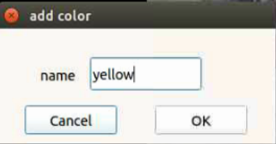

  1. Open LAB tool and click on “add color” button.
  1. Fill in the “name” column with the color name, and click the “OK” button.
  1. Choose the added color in the color drop-down menu.
  1. Place the target within the camera’s field of view, and adjust the threshold by dragging the L, A, and B component sliders until the area of the colored object within the left screen turns white, while the other areas turn black.
Note: the adjustment method of color threshold refers to “20.1.3 Adjust Color Adjustment”.
  1. Click “Save settings” button in recognition adjustment area to save the adjustment parameters of color threshold.

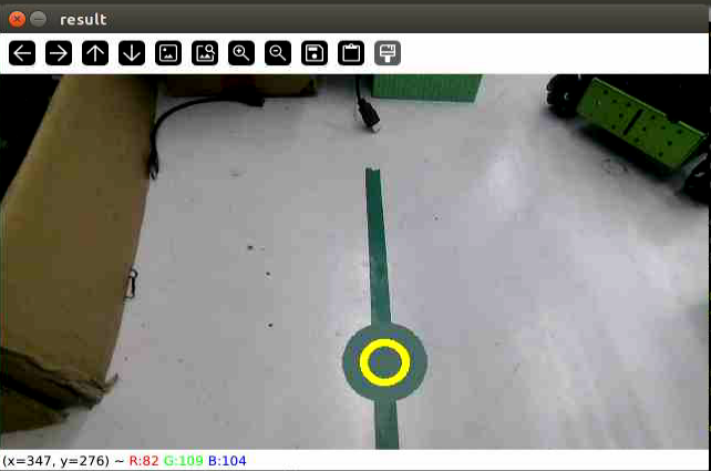

This session will use OpenCV to perform red, green, blue recognition and display the recognition result through transmitted image. Before operations, please prepare one object of red, green and blue.
20.2.1 Recognition Process
Firstly, obtain the RGB image from the camera. Scale and apply Gaussian blur to the image. Convert the image from RGB to Lab.
Next, identify the object color in the circle by using color thresholds, followed by masking of the image portion. (masking is used to hide certain part of the processed image).
Finally, the recognition results are displayed on the screen.

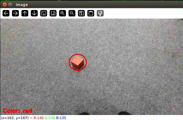

20.2.3 Program Outcome
Note: after the game starts, please ensure that there are no other objects containing recognized colors within the field of view of the camera to avoid affecting the implementation effect.

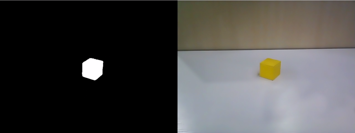

After the game starts, place the target object within the field of view of the camera. When recognizing the target object, it will be circled up in the same color and the color name will be printed in the lower-left corner of the screen. The program supports red, blue and green object recognition.

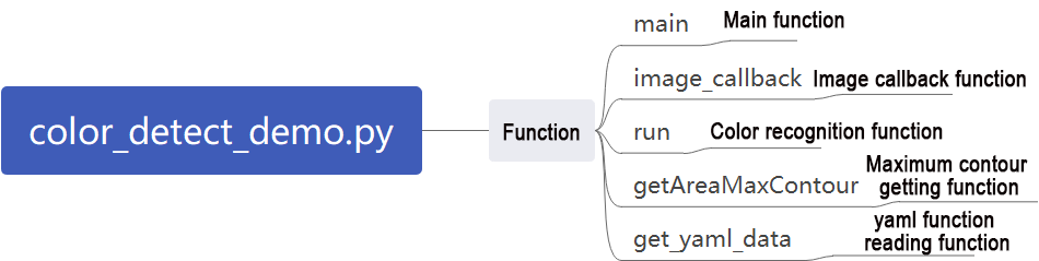

20.2.4 Program Analysis
The source code of the program is located in
/home/ubuntu/ros2_ws/src/example/scripts/color_detect/color_detect_demo.py
range_rgb = {
    'red': (0, 0, 255),
    'blue': (255, 0, 0),
    'green': (0, 255, 0),
    'black': (0, 0, 0),
    'white': (255, 255, 255),
def get_yaml_data(yaml_file):
    yaml_file = open(yaml_file, 'r', encoding='utf-8')
    file_data = yaml_file.read()
    yaml_file.close()
    data = yaml.load(file_data, Loader=yaml.FullLoader)
    return data
  • Main Function
1. Main Function
Initialize the ROS node, create a color recognition node named “color_detect_node”, subscribe to the image topic “/depth_cam/rgb/image_raw”, and set its callback function to “image_callback”. Start the main function for color recognition using multiple threads. Wait for the node to shut down.
if __name__ == '__main__':
    rclpy.init()
    node = rclpy.create_node('color_detect_node')
    node.create_subscription(Image, '/depth_cam/rgb/image_raw', image_callback, 1)
    threading.Thread(target=main, daemon=True).start()
    rclpy.spin(node)
  • Image Processing
1. Camera Callback Function
Primarily used to read the video stream from the topic and enqueue it to ensure real-time display.

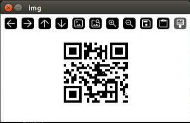

    After start the program, it’s necessary to enter characters in the terminal to generate the QR code. Take the input of “ubuntu” as example.
Press “Enter” to display a QR code image containing the input data.

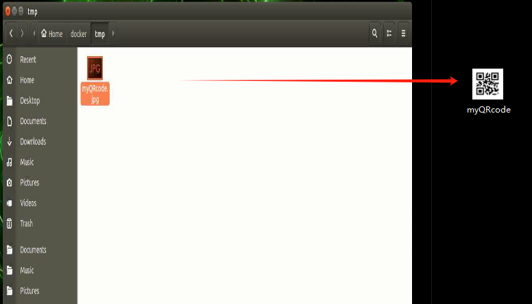

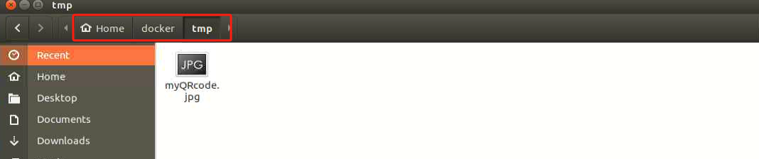

  1. Proceed to enter the command to copy the QR code to the corresponding folder, for exporting to our PC desktop.
    cp myQRcode.jpg ~/share/tmp
  2. Next, we click on on the left side of the system interface, then click to open the file manager, and navigate to the directory highlighted in the red box in the screenshot below. Here, you can see that the generated QR code has been exported to the host system.
  1. Drag the image to your PC desktop using the NoMachine tool’s drag-and-drop feature. Then, you can print it out or transfer it to your mobile phone’s photo album.

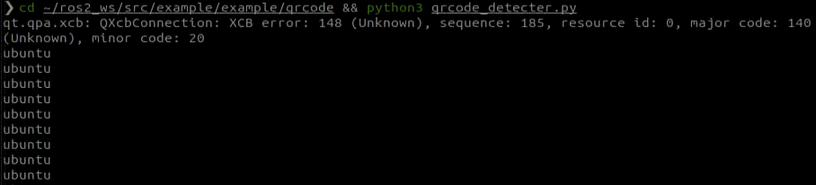

  6. Open a new ROS2 command line terminal, enter the command to switch to the program directory, and start the QR code recognition program:
    cd ~/ros2_ws/src/example/example/qrcode && python3 qrcode_detecter.py
To close this game, press “Ctrl+C” in the terminal interface. If closing fails, please try again repeatedly.

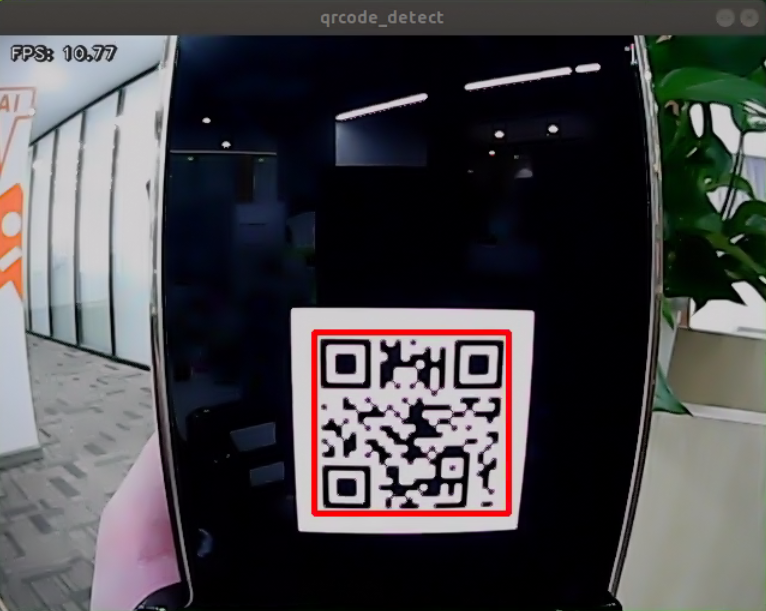

  • Program Outcome
After starting the gameplay, it will recognize the QR code images appearing in the feedback screen, mark them with a red box, and print out the content of the QR code.

The source code of this program is saved in /home/ubuntu/ros2_ws/src/example/example/qrcode/qrcode_detecter.py
#!/usr/bin/env python3
# encoding: utf-8
import cv2
import queue
import rclpy
import threading
import numpy as np
from rclpy.node import Node
class QRCodeDetectNode(Node):
    def __init__(self, name):
        rclpy.init()
        super().__init__(name)
        self.running = True
        self.bridge = CvBridge()
        self.model_path = os.path.join(os.path.abspath(os.path.split(os.path.realpath(__file__))[0]), 'model/detector.tflite')
        self.qcd = cv2.QRCodeDetector()
        if self.image_queue.full():
            # 如果队列已满,丢弃最旧的图像(if the queue is full, discard the oldest image)
            self.image_queue.get()
            # 将图像放入队列(put the image into the queue)
1. Main Function
Initialize the QRCodeDetectNode and set the node name as qrcode_detect. Wait for the ROS node to close, and if it closes, unregister the current node.
def main():
    node = QRCodeDetectNode('qrcode_detect')
        rclpy.spin(node)
    except KeyboardInterrupt:
        node.destroy_node()
        rclpy.shutdown()
        print('shutdown')
    finally:
        print('shutdown finish')
if __name__ == "__main__":
    main()
2. QRCodeDetectNode Class
Initialize the node and define parameters, then start the self.main function.
Parameters:
self.running: Whether the detection is enabled
self.model_path: Model path
self.image_queue: Image queue
self.image_sub: Subscription to read camera feedback images
self.qcd: Initialization of the QR code detection
        rclpy.init()
        self.running = True
    def main(self):
        while self.running:
            except queue.Empty:
                if not self.running:
                    continue
            ret_qr, decoded_info, points, _ = self.qcd.detectAndDecodeMulti(image)
            if ret_qr:
                for s, p in zip(decoded_info, points):
                    if s:
                        print(s)
                        color = (0, 255, 0)
                        color = (0, 0, 255)
                    image = cv2.polylines(image, [p.astype(int)], True, color, 8)
            cv2.imshow('image', image)
            key = cv2.waitKey(1)
            if key == ord('q') or key == 27:  # 按q或者esc退出(press q or esc to exit)
Functions:
The camera callback function reads the camera feedback image and places it in the queue self.image_queue for automatic update and discarding of expired images.
The main function mainly starts QR code detection. It checks whether detection is enabled based on the parameter self.running. If it is True, it reads the image data from the self.image_queue queue, inputs it into the initialized recognition model self.qcd, and finally prints the recognition content and draws the recognition box based on the output data.
    def main(self):
        while self.running:
            except queue.Empty:
                    continue
            if ret_qr:
                    if s:
                        print(s)
                        color = (0, 255, 0)
                        color = (0, 0, 255)

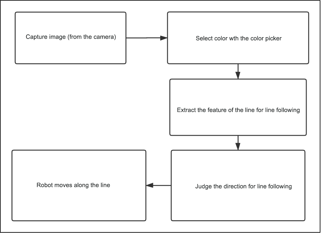

First, obtain the RGB image from the camera and resize it. Apply Gaussian blur to the image and convert the color space from RGB to Lab.
Then, perform color recognition on the objects in the circle using color thresholding. Apply masking to parts of the image. (Masking is used to globally or locally mask the processed image using selected images, graphics, or objects).
Afterward, perform opening and closing operations on the object images. Finally, outline the largest object with a circle.
Opening operation: First, erode the image and then dilate it. Purpose: Used to eliminate small objects, smooth the shape boundary, and not change its area. It can remove small grain noise and break the adhesion between objects.
Erosion: Eliminate the boundary points of the object, causing the boundary to shrink inward, and can remove objects smaller than the structural element.
Dilation: Expand the boundary points of the object, merge all background points in contact with the object into the object, and expand the boundary outward.
Finally, feedback the recognition results on the feedback screen.

  1. Click on the position of the line in the image to select the corresponding color of the track line, and you can start line following by color picking.

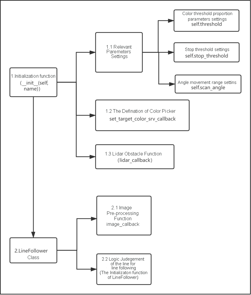

20.4.3 Program Analysis
Launch Analysis:
The program file corresponding to this section of the course document is located at:
/home/ubuntu/ros2_ws/src/app/launch/line_following_node.launch.py
1. Read the Storage Path
    if compiled == 'True':
Use get_package_share_directory to obtain the package path.
3. None
line_following_node: Start line following node.
        IncludeLaunchDescription(
            condition=IfCondition(debug),
Source Code Analysis:
/home/ubuntu/ros2_ws/src/app/app/line_following.py
Note: it’s necessary to back up the original program file before making any modification to the program. You’re forbidden to modify the original source code file to avoid causing robot malfunctions that may be irreparable due to incorrect parameter modifications!
Then, the color picker object is defined (used in the gameplay to pick colors), along with the setting of additional Lidar obstacle avoidance functionality. Next is the implementation of the LineFollower class, which mainly includes functions for image preprocessing and logic for line following.
Function:
Main:
def main():

LineFollowingNode:
        rclpy.init()
Init:
        rclpy.init()
        self.name = name
        self.color = ''
        self.camera_type = 'Stereo'
        self.set_above = False
        self.set_callback = False
        self.is_running = False
        self.color_picker = None
        self.follower = None
        self.empty = 0
        self.count = 0
        self.stop = False
        self.threshold = 0.5
Initialize the required parameters for the program, call the base node, camera node, and start services such as enter, exit, start, set color, get color, set threshold, etc.
