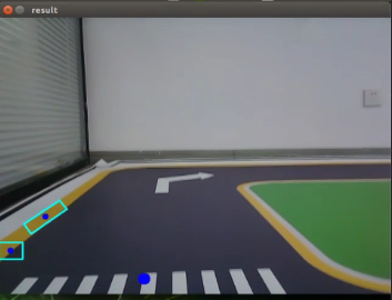

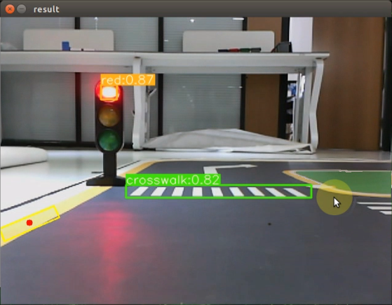

  • Program Outcome
After starting the game, place the robot on the road, and it will automatically detect the yellow line at the edge of the road. The robot will then adjust its position based on the detection results.

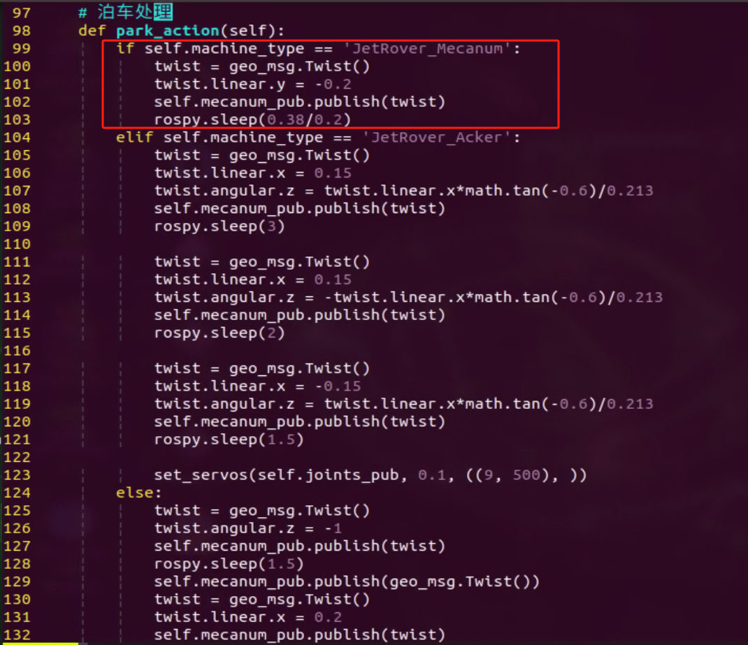

  • Operation Steps
Note: The following steps exclusively activate road sign detection in the return screen, without executing associated actions. Users seeking direct experience with autonomous driving may bypass this lesson and proceed to “Integrated Application” within the same file.
Since ROS2 is located inside a container, it cannot directly access the GPU of the mainboard. Therefore, we need to use ROS1 to start the GPU of the mainboard. Here, starting the YOLO model requires the use of GPU, so it’s better to check the results through ROS1.
Please make sure to enter commands with strict attention to capitalization, spacing, and you can use the “Tab” key to autocomplete keywords.
  1. Start the robot, and access the robot system desktop using NoMachine.
  2. Click-on to open the command-line terminal.
  3. Execute the command, and hit Enter to disable the app service.
  4. Run the command to navigate to the directory containing programs.
    roscd hiwonder_example/scripts/yolov5_detect/
  5. Type the command to open the program source code.
    vim yolov5_trt_7_0.py

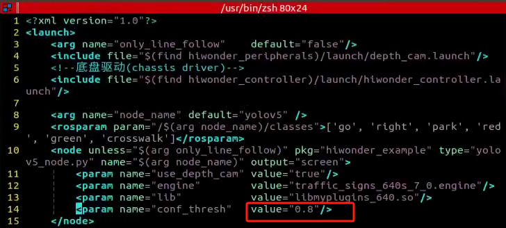

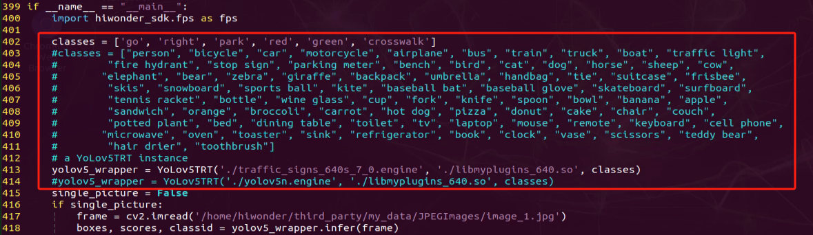

  6. Press the “i” key to enter insertion mode. Find the code enclosed in the red box and toggle commenting by adding or removing comments as needed. Once done, press the “ESC” key, then type “:wq” and press Enter to save and exit.
  7. Run the command to initiate game program.
    python3 yolov5_trt_7_0.py

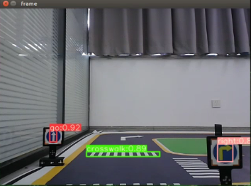

  8. Position the road sign in front of the camera, and the robot will recognize the road sign automatically.
  9. If you need to terminate this game, press ‘Ctrl+C’.
  10. Once you’ve completed the game experience, you can initiate the mobile app service by following the instructions or restarting the robot.
    If the mobile app service is not activated, the associated app functions will be disabled. (The mobile app service will automatically start when the robot restarts).

Note: In the event that the model struggles to recognize traffic-related signs, it may be necessary to lower the confidence level. Conversely, if the model consistently misidentifies traffic-related signs, raising the confidence level might be advisable.
  1. Run the command to navigate to the directory containing programs.
    cd ros_ws/src/hiwonder_example/scripts/self_driving
  2. Enter the command to access the game program.
    vim self_driving.launch
    The red box represents the confidence value, which can be adjusted to modify the effectiveness of target detection.

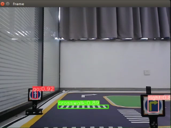

After initiating the game, place the robot on the road within the map. Once the robot identifies landmarks, it will highlight the detected landmarks and annotate them based on the highest confidence level learned from the model.
21.2.3 Traffic Light Recognition
  • Preparation
  1. Before starting, ensure the map is laid out flat and free of wrinkles, with smooth roads and no obstacles. For specific map laying instructions, please refer to “21.1 Autonomous Driving Debugging Lesson” in the same directory as this section for guidance.
  2. When experiencing this game, ensure it is conducted in a well-lit environment, but avoid direct light shining on the camera to prevent misrecognition.
  • Program Logic
Firstly, capture a real-time image from the camera and apply operations such as erosion and dilation.
Next, invoke the YOLOv5 model to compare it with the target screen image.
Finally, execute corresponding landmark actions based on the comparison results.
The source code for this program can be found at:
/home/ros_ws/src/hiwonder_example/scripts/yolov5_detect/yolov5_trt_7_0.py
class YoLov5TRT(object):
    description: A YOLOv5 class that warps TensorRT ops, preprocess and postprocess ops.
    def __init__(self, engine_file_path, plugin, classes, conf_thresh=0.8, iou_threshold=0.4):
        self.CONF_THRESH = conf_thresh
        self.IOU_THRESHOLD = iou_threshold
        PLUGIN_LIBRARY = plugin
        self.engine_file_path = engine_file_path
        # load labels
        self.categories = classes
        ctypes.CDLL(PLUGIN_LIBRARY)
        # Create a Context on this device,
        self.ctx = cuda.Device(0).make_context()
        stream = cuda.Stream()
        TRT_LOGGER = trt.Logger(trt.Logger.INFO)
        runtime = trt.Runtime(TRT_LOGGER)
        # Deserialize the engine from file
        with open(self.engine_file_path, "rb") as f:
            engine = runtime.deserialize_cuda_engine(f.read())
        context = engine.create_execution_context()
        host_inputs = []
        cuda_inputs = []
        host_outputs = []
        cuda_outputs = []
        bindings = []
  • Operation Steps
To restart the mobile app service, enter the command “sudo systemctl start start_app_node.service” and wait for the buzzer to emit a single beep, indicating that the service startup is complete.
  • Program Outcome
After initiating the game, position the robot on the road depicted on the map. Upon recognizing the traffic signal, the robot will assess the color of the signal light and identify frames corresponding to red and green signal lights accordingly.

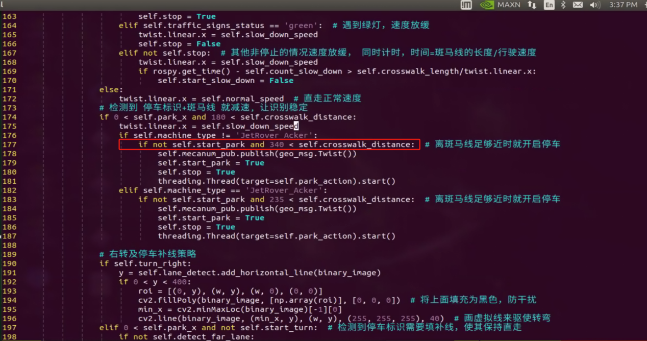

If the robot stops upon recognizing the parking sign and the parking position is not optimal, adjustments to the parameters in the program source code can be made.
  1. Click-on to open the ROS1 command-line terminal.
  2. Execute the command to navigate to the directory containing game programs.
    cd ros2_ws/src/example/example/self_driving/self_driving.py
  3. Run the command to access the source code.
    vim self_driving.py
  4. Press the “i” key to enter insert mode and locate the code within the red box. Adjusting the parameters within the red box allows you to control the starting position for the robot to initiate the parking operation. Decreasing the parameters will result in the robot stopping closer to the zebra crossing, while increasing them will cause the robot to stop further away. Once adjustments are made, press the “ESC” key, type “:wq”, and press Enter to save and exit.
You can adjust the parking processing function to alter the parking position of the robot. Initially, the parking action sets the linear speed in the negative direction of the Y-axis (right of the robot) to 0.2 meters per second, with a forward movement time of (0.38/2) seconds. To position the robot in the ideal location on the left side of the parking space, modify the speed and time accordingly.

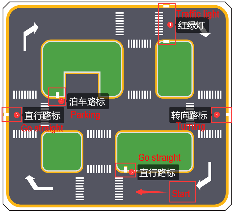

1. Map Setup
To ensure accurate navigation, place the map on a flat, smooth surface, free of wrinkles and obstacles. Position all road signs and traffic lights at designated locations on the map, facing clockwise. The starting point and locations of road signs are indicated below:
Note: Tools required for autonomous driving are available for separate purchase. If you are interested, kindly reach out to us at support@hiwonder.com.

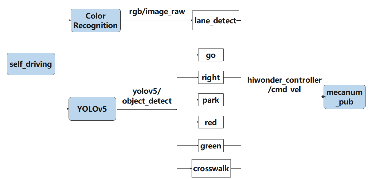

  • Program Logic
Actions implemented so far include:
  1. Following the yellow line in the outermost circle of the patrol map.
  2. Slowing down and passing if a zebra crossing is detected.
  3. Making a turn upon detection of a turn sign.
  4. Parking the vehicle and entering the parking lot upon detection of a stop sign.
  5. Halting when a red light is detected.
  6. Slowing down when passing a detected street light.
First, load the model file trained by YOLOv5 and the required library files, obtain real-time camera images, and perform operations such as erosion and dilation on the images. Next, identify the target color line segment in the image and gather information such as size and center point of the target image. Then, invoke the model through YOLOv5 and compare it with the target screen image. Finally, adjust the forward direction based on the offset comparison of the target image’s center point to keep the robot in the middle of the road. Additionally, perform corresponding actions based on different recognized landmark information during map traversal.
/home/ubuntu/ros2_ws/src/example/example/self_driving/self_driving.py
  • Operation Steps
Note: the input command should be case sensitive, and keywords can be implemented using Tab key.
As ROS2 is located within a container, it cannot directly access the GPU of the mainboard. Thus, it’s necessary to initiate the GPU of the mainboard through ROS1 and then transfer the recognition information for use within ROS2.
Enable the model:
  2. Execute the command, and hit Enter to disable the app service.
  3. Run the command to enable the autonomous driving service.
    roslaunch hiwonder_example self_driving_base.launch
  4. If you need to close the program, simply click on the corresponding terminal window of the program and use the shortcut “Ctrl+C” to exit the program.
    Bridge:
  5. Click-on to start the ROS2 command-line terminal.
  6. Right-click on a blank area, select the option shown in the image below, and then choose “Split”:
  7. Execute the command in the 1st command-line terminal, and hit Enter key.
    source ~/noetic_ws/install_isolated/setup.zsh
  8. Execute the command in the 1st command-line terminal, and hit Enter key.
    source ~/third_party_ros2/ros1_bridge_ws/install/setup.zsh
  9. Execute the command in the 1st command-line terminal, and hit Enter key
    ros2 run ros1_bridge parameter_bridge
  10. Execute the command in the 2nd command-line terminal, and hit Enter key.
    ros2 launch example self_driving.launch.py
  11. If you need to close the program, simply click on the corresponding terminal window of the program and use the shortcut “Ctrl+C” to exit the program.

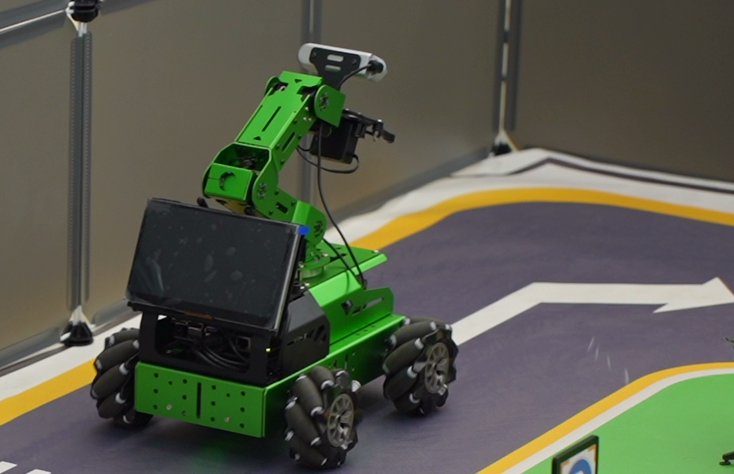

  • Program Outcome
1. Lane Keeping
Upon initiating the game, the car will track the line and identify the yellow line at the road’s edge. It will execute forward and turning actions based on the straightness or curvature of the yellow line to maintain lane position.
2. Traffic Light Recognition
When the car encounters a traffic light, it will halt if the light is red and proceed if it’s green. Upon approaching a zebra crossing, the car will automatically decelerate and proceed cautiously.
3. Turn and Parking Signs
Upon detecting traffic signs while moving forward, the car will respond accordingly. If it encounters a right turn sign, it will execute a right turn and continue forward. In the case of a parking sign, it will execute a parking maneuver.
Following these rules, the robot will continuously progress forward within the map.

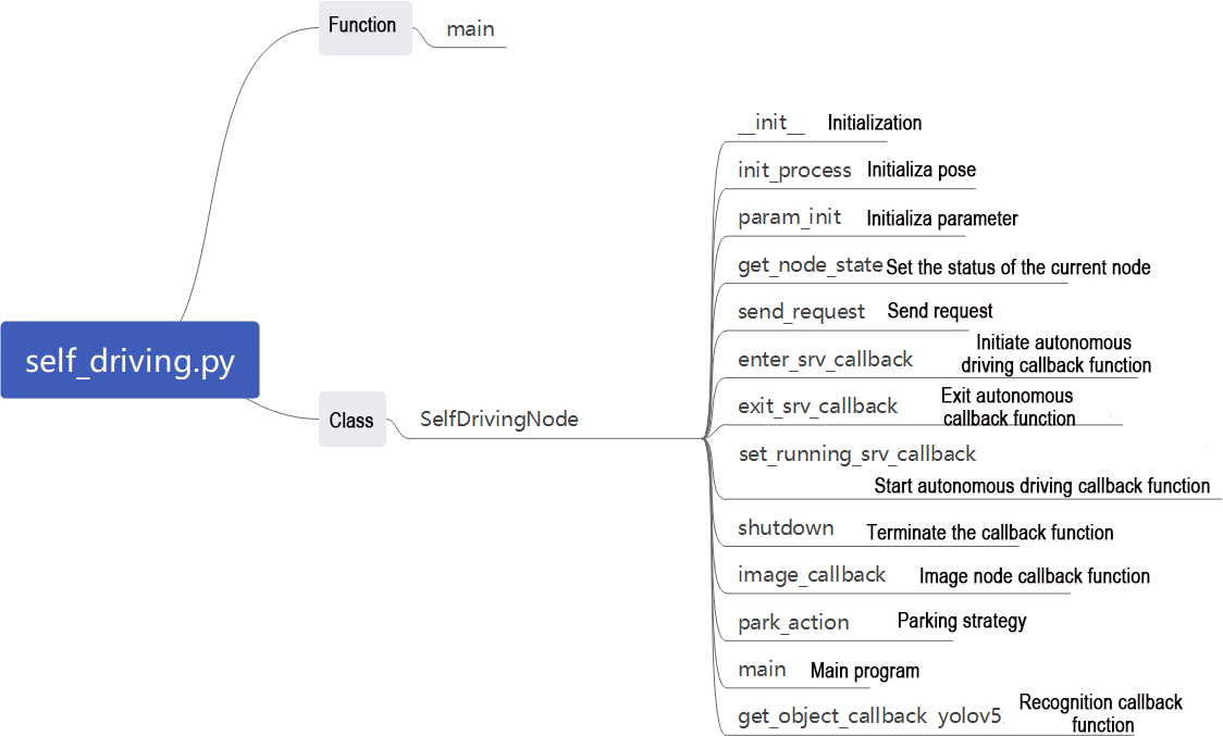

  • Program Analysis
The source code of this program is saved in:
Function:
def main():
    node = SelfDrivingNode('self_driving')
    executor.add_node(node)
    executor.spin()
    node.destroy_node()
Initiate autonomous driving class.
Class:
class SelfDrivingNode(Node):
    def __init__(self, name):
        rclpy.init()
        self.name = name
        self.is_running = True
        self.param_init()
init:
        self.name = name
        self.param_init()
        self.classes = ['go', 'right', 'park', 'red', 'green', 'crosswalk']
        self.dispaly =False
        self.bridge = CvBridge()
        self.lock = threading.RLock()
        self.colors = common.Colors()
        self.machine_type = os.environ.get('MACHINE_TYPE')
        self.lane_detect = lane_detect.LaneDetector("yellow")
        self.joints_pub = self.create_publisher(ServosPosition, '/servo_controller', 1) # 舵机控制(servo control)
        self.create_service(Trigger, '~/enter', self.enter_srv_callback) # 进入玩法(enter game)
        self.create_service(Trigger, '~/exit', self.exit_srv_callback) # 退出玩法(exit game)
        self.create_service(SetBool, '~/set_running', self.set_running_srv_callback)
        # self.heart = Heart(self.name + '/heartbeat', 5, lambda _: self.exit_srv_callback(None))
        self.client = self.create_client(Trigger, '/yolov5/init_finish')
        self.start_yolov5_client = self.create_client(Trigger, '/yolov5/start', callback_group=timer_cb_group)
        self.start_yolov5_client.wait_for_service()
        self.stop_yolov5_client = self.create_client(Trigger, '/yolov5/stop', callback_group=timer_cb_group)
        self.stop_yolov5_client.wait_for_service()
Initialize the required parameters, obtain the current robot category, set the line-following color to yellow, start the chassis control, servo control, and image reading. Set up three types of services: enter, exit, and start, and read the YOLOv5 node.
init_process
    def init_process(self):
        self.timer.cancel()
        if not self.get_parameter('only_line_follow').value:
            self.send_request(self.start_yolov5_client, Trigger.Request())
        if self.machine_type != 'JetRover_Tank':
            set_servo_position(self.joints_pub, 1, ((10, 500), (5, 500), (4, 250), (3, 0), (2, 750), (1, 500)))  # 初始姿态(initial posture)
            set_servo_position(self.joints_pub, 1, ((10, 500), (5, 500), (4, 230), (3, 0), (2, 750), (1, 500)))  # 初始姿态(initial posture)
        time.sleep(1)
            self.dispaly = True
            request = SetBool.Request()
            request.data = True
            self.set_running_srv_callback(request, SetBool.Response())
        #self.park_action()
Initialize the current robotic arm and start the main function.
param_init:
    def param_init(self):
        self.start = False
        self.enter = False
        self.have_turn_right = False
        self.detect_turn_right = False
        self.detect_far_lane = False
        self.park_x = -1  # 停车标识的x像素坐标(the x-coordinate of the parking sign pixel)
        self.start_turn_time_stamp = 0
        self.count_turn = 0
        self.start_turn = False  # 开始转弯(begin turning)
Initialize parameters required for position recognition or usage.
get_node_state:
        response.success = True
        return response
Obtain the current state of the node.
send_request:
        while rclpy.ok():
                return future.result()
Used to publish service requests.
enter_srv_callback:
        self.get_logger().info('\033[1;32m%s\033[0m' % "self driving enter")
        with self.lock:
            self.start = False
            camera = 'depth_cam'#self.get_parameter('depth_camera_name').value
            self.create_subscription(Image, '/%s/rgb/image_raw' % camera, self.image_callback, 1)
            self.create_subscription(ObjectsInfo, '/yolov5/object_detect', self.get_object_callback, 1)
            self.enter = True
        response.message = "enter"
        return response
Service for entering autonomous driving gameplay, start reading images and YOLOv5 recognition content, initialize speed.
exit_srv_callback:
        self.get_logger().info('\033[1;32m%s\033[0m' % "self driving exit")
        with self.lock:
                    self.image_sub.unregister()
                if self.object_sub is not None:
                    self.object_sub.unregister()
            except Exception as e:
                self.get_logger().info('\033[1;32m%s\033[0m' % str(e))
        self.param_init()
        response.message = "exit"
        return response
Service for exiting autonomous driving gameplay, stop reading images and YOLOv5 recognition content, initialize speed, reset parameters.
set_running_srv_callback:
        with self.lock:
            self.start = request.data
            if not self.start:
        return response
Start autonomous driving game, set the start parameter to True.
Shutdown:
    def shutdown(self, signum, frame):  # ctrl+c关闭处理(press Ctrl+C to terminate the process)
        self.is_running = False
Callback function after closing the program, used to stop the currently running program.
image_callback:
    def image_callback(self, ros_image):  # 目标检查回调(target inspection callback)
        rgb_image = np.ndarray(shape=(ros_image.height, ros_image.width, 3), dtype=np.uint8, buffer=ros_image.data) # 原始 RGB 画面(original RGB image)
        if self.image_queue.full():
            # 如果队列已满,丢弃最旧的图像(if the queue is full, discard the oldest image)
            self.image_queue.get()
        # 将图像放入队列(put the image to the queue)
Image callback function, enqueues images and discards expired ones.
park_action:
    # 泊车处理(parking process)
    def park_action(self):
        if self.machine_type == 'JetRover_Mecanum':
            twist = Twist()
            twist.linear.y = -0.2
            time.sleep(0.38/0.2)
        elif self.machine_type == 'JetRover_Acker':
            twist = Twist()
            twist.linear.x = 0.15
            twist.angular.z = twist.linear.x*math.tan(-0.6)/0.213
            time.sleep(3)
            twist = Twist()
            twist.angular.z = -twist.linear.x*math.tan(-0.6)/0.213
            time.sleep(2)
            twist = Twist()
            twist.linear.x = -0.15
            time.sleep(1.5)
            set_servo_position(self.joints_pub, 0.1, ((9, 500), ))
            twist = Twist()
            twist.angular.z = -1
            time.sleep(1.5)
            twist = Twist()
            twist.linear.x = 0.2
            time.sleep(0.65/0.2)
            twist = Twist()
            twist.angular.z = 1
            time.sleep(1.5)
Parking logic, runs three different parking strategies according to three different chassis types.
get_object_callback:
    # 获取目标检测结果(get target detected result)
        self.objects_info = msg.objects
        if self.objects_info == []:  # 没有识别到时重置变量(reset variables when no detection is made)
            self.traffic_signs_status = None
            self.crosswalk_distance = 0
            min_distance = 0
            for i in self.objects_info:
                class_name = i.class_name
                if class_name == 'crosswalk':
                    if center[1] > min_distance:  # 获取最近的人行道y轴像素坐标(retrieve the closest pedestrian crossing y-axis pixel coordinate)
                        min_distance = center[1]
                elif class_name == 'right':  # 获取右转标识(retrieve the right turn sign)
                    self.count_right += 1
                    self.count_right_miss = 0
                    if self.count_right >= 10:  # 检测到多次就将右转标志至真(if detected multiple times, set the right turn sign to true)
                        self.turn_right = True
                        self.count_right = 0
                elif class_name == 'park':  # 获取停车标识中心坐标(retrieve the center coordinates of the stop sign)
                    self.park_x = center[0]
                elif class_name == 'red' or class_name == 'green':  # 获取红绿灯状态(get the state of traffic light)
                    self.traffic_signs_status = i
            self.crosswalk_distance = min_distance
Callback function for reading YOLOv5, obtains the categories currently recognized by YOLOv5.
Main:
    def main(self):
        while self.is_running:
            time_start = time.time()
            except queue.Empty:
                if not self.running:
                    continue
            result_image = image.copy()
            if self.start:
                h, w = image.shape[:2]
The main function within the class, runs different line-following strategies according to different chassis types.

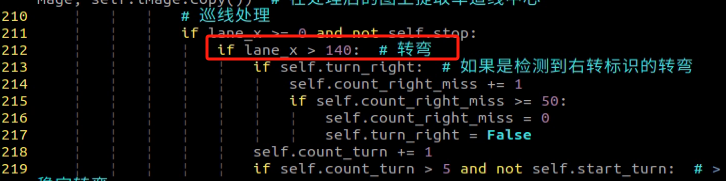

21.2.7 FAQ
  1. The robot exhibits inconsistent performance during line patrolling, often veering off course.
    Adjust the color threshold to better suit the lighting conditions of the actual scene. For precise instructions on color threshold adjustment, please consult “20 ROS+OpenCV Lesson” for detailed guidance.
  2. The robot’s turning radius appears to be either too large or too small.
  3. Ensure correct adjustment of the robot arm deviation. For detailed instructions on robot arm deviation adjustment, please refer to “22 ROS2-Robot Arm Control Course->22.2 Robot Arm Deviation Adjustment (Optional) V1.0” for comprehensive learning.
  4. Modify the line patrol processing code
    Navigate to the game program path by entering the command:
    Open the game program by entering the command:
    vim self_driving.py
    The red box denotes the lane’s center point, which can be adjusted to fine-tune the turning effect. Decreasing the value will result in earlier turns, while increasing it will cause later turns.
  5. The parking location is suboptimal.
    You can adjust the parking processing function or modify the starting position of the parking operation. For detailed instructions, please consult “21.2.5 Autonomous Parking->Parameter Adjustment” for reference and learning.
  6. Inaccurate traffic sign recognition.
    Adjust the target detection confidence. For detailed instructions, please refer to “21.2.6 Integrated Application->Operation Steps” for comprehensive learning.

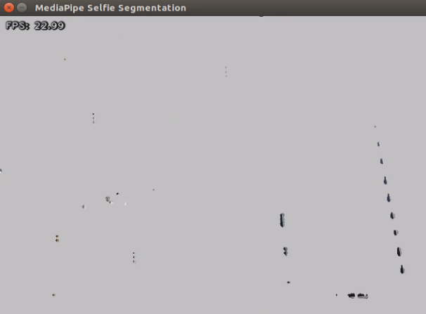

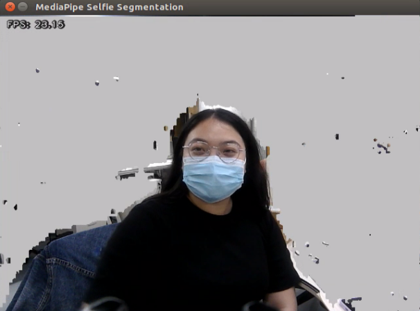

This lesson provides instructions on utilizing MediaPipe’s selfie segmentation model to accurately segment trained models, such as human faces and hands, from their backgrounds. Once separated, you can easily add virtual backgrounds to these models.
  • Program Logic
To begin, import the selfie segmentation model from MediaPipe and subscribe to the corresponding topic to access the live camera feed.
Next, flip the image and apply the segmentation to the background image. For improved boundary segmentation, implement dual-border segmentation.
Finally, complete the process by replacing the background with a virtual background.
  • Operation Steps
Note: the input command should be case sensitive, and keywords can be complemented using Tab key.
  1. Start the robot, and enter the robot system desktop using NoMachine.
  2. Click-on to open the ROS1 command-line terminal.
  3. Run the command to disable app auto-start app service.
  4. Click-on to open the ROS2 command-line terminal.
  5. Execute the command to enable the camera node.
  6. Enter the command and hit Enter key to run the game program.
    cd ~/ros2_ws/src/example/example/mediapipe_example && python3 self_segmentation.py
  1. If you want to exit this game, please use shortcut key “Ctrl+C”. If the game cannot be closed, please retry.
  2. Next, press “Ctrl+C” in the terminal. If it fails to close, please try again.
  • Program Outcome
Once the game starts, the screen will transition to a gray virtual background. As soon as a human figure appears, the program will automatically execute background removal, effectively separating the human from the virtual background.

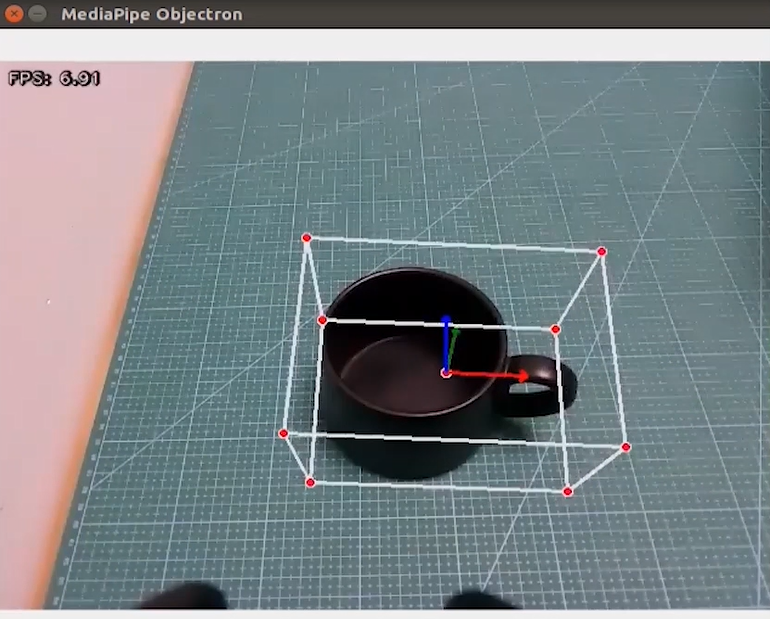

21.3.3 3D Object Detection
  • Program Logic
To get started, import the 3D Objectron module from MediaPipe, and subscribe to the topic message to receive the real-time camera image.
Next, flip the image to ensure proper alignment for 3D object detection.
Finally, draw the 3D boundary frame on the image.
  • Operation Steps
  5. Execute the following command to enable the camera node:
  6. In a new ROS2 command line terminal, enter the command and press Enter to run the gameplay program:
    cd ~/ros2_ws/src/example/example/mediapipe_example && python3 objectron.py
  1. To close this game, press the “Esc” key in the image interface to exit the camera image interface.
  2. Press “Ctrl+C” in the command line terminal interface. If the closure fails, please try again repeatedly.
  • Program Outcome
Once the game starts, the 3D frame will be drawn around the boundary of the recognized object. The system can identify several objects, including a cup (with handle), shoe, chair, and camera.

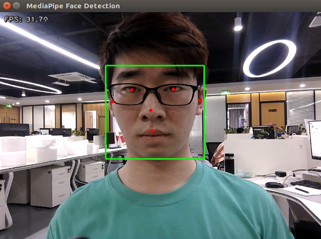

21.3.4 Face Detection
Face detection is realized by face detection model of MediaPipe.
This model offers a swift and efficient solution for detecting faces, equipped with 6 facial landmarks to provide detailed information. It is designed to detect multiple human faces with accuracy and speed. Based on BlazeFace, it has been optimized for mobile GPU inference, ensuring a lightweight and high-performance face detection experience on mobile devices.
  • Program Logic
To begin, import the human face detection model from MediaPipe and subscribe to the relevant topic message to obtain the live camera feed.
Next, utilize OpenCV to flip the image and convert the color space for further processing.
Then, using the face detection model’s minimum confidence threshold, determine whether a human face has been successfully detected. If a human face is recognized, proceed to collect the necessary information about each detected face, including the bounding frame and the 6 key points (right eye, left eye, nose tip, right ear, and left ear).
Finally, frame the human face and mark the 6 key points on each detected face for visual clarity and further analysis.
  • Operation Steps
  2. Click-on to open ROS1 the command-line terminal.
  4. Click-on to start the ROS2 command-line terminal.
  5. Execute the command to enable the camera node:
    cd ~/ros2_ws/src/example/example/mediapipe_example && python3 face_detect.py
  1. If you need to close this gameplay, you need to press the “Esc” key in the image interface to exit the camera image interface.
  2. Then press “Ctrl+C” in the command line terminal interface. If closing fails, please try again.
  • Program Outcome
After the game starts, depth camera will start detecting human face, and human face will framed on the live camera feed.

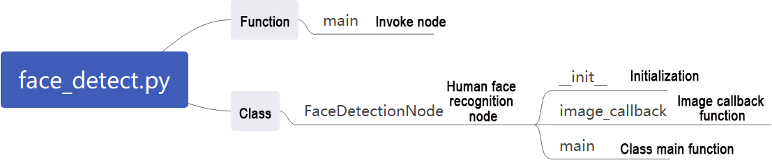

/ros2_ws/src/example/example/mediapipe_example/face_detect.py
1. Function
Main:
def main():
    node = FaceDetectionNode('face_detection')
        rclpy.spin(node)
    except KeyboardInterrupt:
        node.destroy_node()
        rclpy.shutdown()
        print('shutdown')
    finally:
        print('shutdown finish')
Used to initiate face detection node.
Class:
FaceDetectionNode:
        rclpy.init()
        super().__init__(name)
        self.running = True
        model_path = os.path.join(os.path.abspath(os.path.split(os.path.realpath(__file__))[0]), 'model/detector.tflite')
        base_options = python.BaseOptions(model_asset_path=model_path)
        options = vision.FaceDetectorOptions(base_options=base_options)
        self.detector = vision.FaceDetector.create_from_options(options)
        self.fps = fps.FPS()
Init:
        self.running = True
Initialize the parameters required for face recognition, call the image callback function, and start the model recognition function.
image_callback
            # 将图像放入队列(put the image into the queue)
Image callback function, used to read data from the camera node and enqueue it.
Main:
    def main(self):
        while self.running:
            except queue.Empty:
                    continue
            image = cv2.flip(image, 1)
            detection_result = self.detector.detect(mp_image)
            annotated_image = visualize(image, detection_result)
            self.fps.update()
            result_image = self.fps.show_fps(cv2.cvtColor(annotated_image, cv2.COLOR_RGB2BGR))
            cv2.imshow('face_detection', result_image)
            key = cv2.waitKey(1)
            if key == ord('q') or key == 27:  # 按q或者esc退出(press q or esc to exit)
        cv2.destroyAllWindows()
        rclpy.shutdown()
Read the model from MediaPipe, input the image, and after obtaining the output image, use OpenCV to draw the facial keypoints and display the feedback image.

After starting the game, when the depth camera detects a face, it will outline the face in the feedback image.

The source code of this program is located in
/ros2_ws/src/example/example/mediapipe_example/face_mesh.py
1. Function
Main:

2. Class
FaceMeshNode:
class FaceDetectionNode(Node):

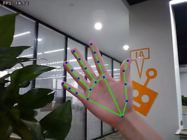

21.3.6 Hand Key Point Detection
MediaPipe’s hand detection model is employed to showcase the key points of the hand and the connecting lines of these key points on the live camera feed.
MediaPipe Hands is an advanced hand and finger detection model that delivers high-fidelity results. Through the power of machine learning (ML), it accurately infers 21 3D landmarks of the hand from a single frame.
  • Program Logic
Firstly, it’s important to understand that MediaPipe’s palm detection model employs a machine learning pipeline consisting of multiple models (including a linear model). This model processes the entire image and returns an oriented hand bounding box. On the other hand, the hand landmark model operates on cropped image regions defined by the palm detectors and provides high-fidelity 3D hand keypoints.
To begin, after importing the palm detection model, we subscribe to the topic message to obtain real-time camera images.
Next, various image pre-processing steps, such as flipping the image and converting the color space, are applied. These steps significantly reduce the need for data augmentation for the hand landmark model.
Furthermore, our pipeline allows for generating crops based on hand landmarks identified in the previous frame. The palm detection is invoked only when the landmark model is unable to recognize the presence of the hand accurately.
Afterward, by comparing the minimum confidence level of the hand detection model, we determine whether the palm has been successfully detected.
Lastly, the hand keypoints are detected and drawn on the camera image to visualize the detected hand in real-time.
  • Operation Steps
  6. Enter the command in a new ROS2 command-line terminal and press Enter to run the game program:
    cd ~/ros2_ws/src/example/example/mediapipe_example && python3 face_mesh.py
Then press “Ctrl+C” in the command line terminal interface. If closing fails, please try again.6.3 Program Outcome
Once the game starts, the depth camera will begin detecting the hand and display the hand key points on the camera image, with the key points connected.
  • Program Analysis
The program file corresponding to this section of the course documentation is located at:
/ros2_ws/src/example/example/mediapipe_example/hand.py

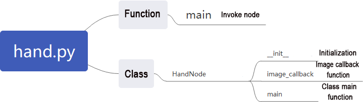

1. Function
Main:
def main():
    node = HandNode('hand_landmarker')
        rclpy.spin(node)
        node.destroy_node()
        rclpy.shutdown()
        print('shutdown')
    finally:
Used to initiate the 3D face detection node.
2. Class
HandNode:
class HandNode(Node):
        rclpy.init()
        self.running = True
        model_path = os.path.join(os.path.abspath(os.path.split(os.path.realpath(__file__))[0]), 'model/hand_landmarker.task')
        options = vision.HandLandmarkerOptions(base_options=base_options,
                                       num_hands=2)
        self.detector = vision.HandLandmarker.create_from_options(options)
Init:
Initialize the parameters required for hand keypoint detection, call the image callback function, and start the model recognition function.
image_callback:
The image callback function is used to read data from the camera node and enqueue it.

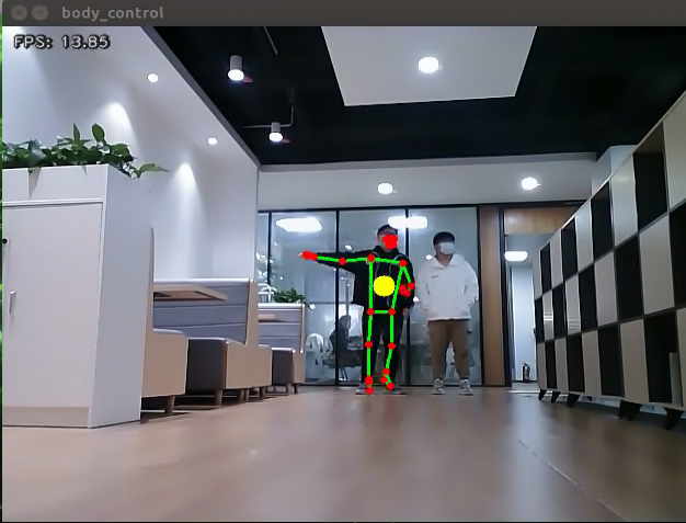

21.3.7 Body Key Points Detection
The MediaPipe body detection model is utilized to detect key points on the human body, which are then displayed on the live camera feed. This implementation incorporates MediaPipe Pose, a high-fidelity posture tracking model that leverages BlazePose to infer 33 3D key points. Additionally, this approach offers support for the ML Kit Pose Detection API.
  • Program Logic
Firstly, import body detection model.
Subsequently, flip over the image and convert the color space of the image. Check whether the human body is successfully detected based on the minimum confidence of the body detection model.
Next, define the tracked posture by comparing the minimum tracking confidence. If the confidence does not meet the minimum threshold, perform automatic human detection on the next input image.
In the pipeline, a detector is employed to initially localize the region of interest (ROI) corresponding to a person’s pose within a frame. Subsequently, a tracker utilizes the cropped ROI frame as input to predict pose landmarks and segmentation masks within the ROI.
For video applications, the detector is invoked selectively, only when necessary. Specifically, it is used for the first frame or when the tracker fails to recognize the body pose in the preceding frame. In all other frames, the pipeline derives ROIs based on the pose landmarks detected in the previous frame.
After MediaPipe body detection model is imported, access the live camera feed through subscribing the related topic message.
Lastly, draw the key points representing the human body.
  • Operation Steps
    cd ~/ros2_ws/src/example/example/mediapipe_example && python3 pose.py

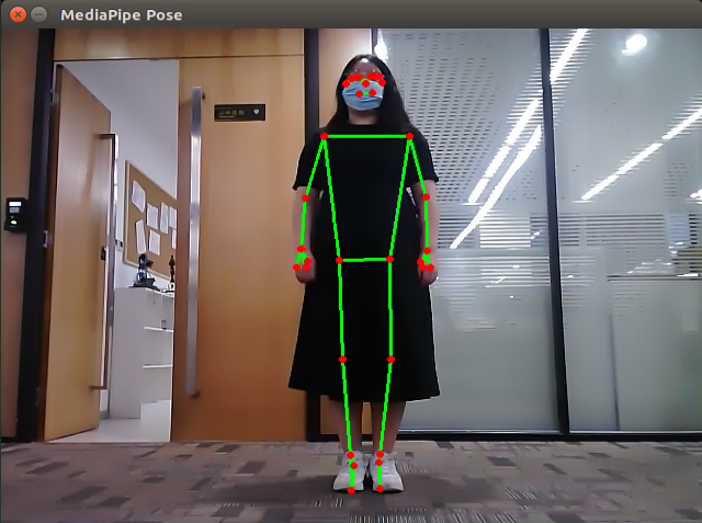

  • Program Outcome
After the game starts, depth camera will begin detecting human pose, and body key points can be displayed and connected on the live camera feed.
  • Program Analysis
The program file is saved in:

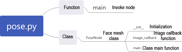

/ros2_ws/src/example/example/mediapipe_example/pose.py
1. Function

PoseNode:
class PoseNode(Node):
        rclpy.init()
        self.running = True
        model_path = os.path.join(os.path.abspath(os.path.split(os.path.realpath(__file__))[0]), 'model/pose_landmarker.task')
        options = vision.PoseLandmarkerOptions(
            output_segmentation_masks=True)
        self.detector = vision.PoseLandmarker.create_from_options(options)

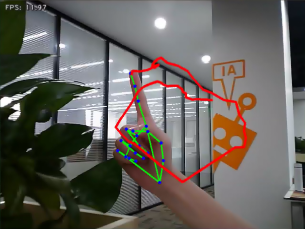

  • Program Outcome
Once the game starts, position your hand within the camera’s field of view. Upon recognition, the hand keypoints will be highlighted on the camera feed.
If the robot detects the “1” gesture, the trajectory of your fingertip motion will begin to be recorded on the camera feed. If it detects the “5” gesture, the recorded fingertip trajectory will be cleared.

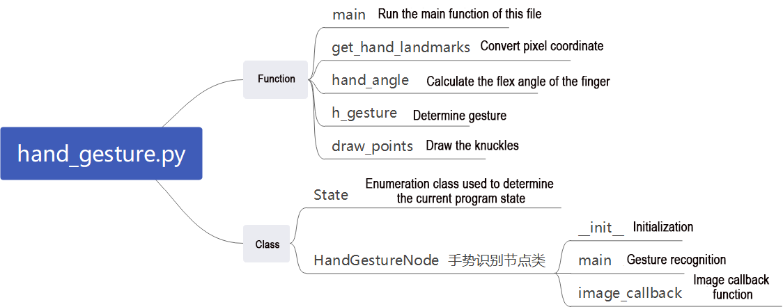

/ros2_ws/src/example/example/mediapipe_example/hand_gesture.py
Note: Prior to making any alterations to the program, ensure to create a backup of the original factory program. Modify it only after creating the backup. Directly editing the source code file is prohibited to prevent inadvertent parameter modifications that could render the robot dysfunctional and irreparable!

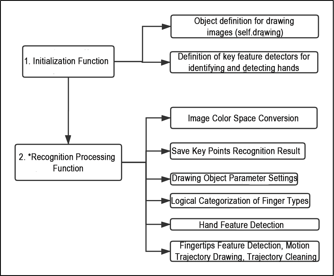

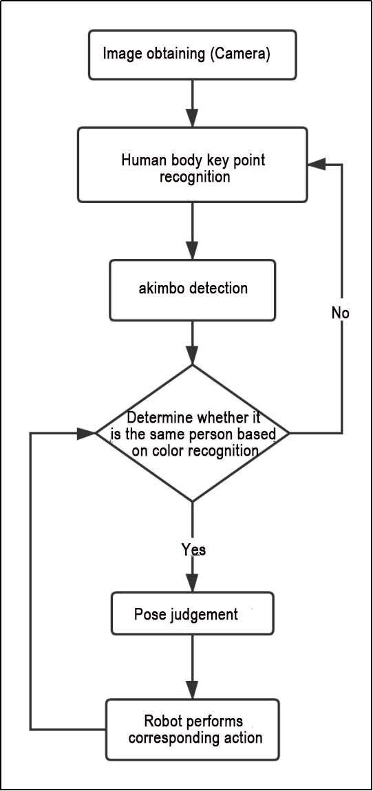

Based on the game’s impact, the process logic of this game is organized as depicted in the figure below:
As depicted in the image above, the purpose of this game is to capture an image using the camera, preprocess it by converting its color space for easier identification, extract feature points corresponding to hand gestures from the converted image, and determine different gestures (based on angles) through logical analysis of key feature points. Finally, the trajectory of the recognized gesture is drawn on the display screen.
The program’s logic flowchart extracted from the program files is illustrated in the figure below.
From the above diagram, it can be seen that the program’s logical flow is mainly divided into initialization functions and recognition processing functions (with Xinghao being relatively important). The following document content will be written according to the program logic flow chart mentioned above.

draw_points:
def draw_points(img, points, thickness=4, color=(255, 0, 0)):
    points = np.array(points).astype(dtype=np.int64)
    if len(points) > 2:
            if i + 1 >= len(points):
            cv2.line(img, p, points[i + 1], color, thickness)
Draw the currently recognized hand shape and each joint point.

HandGestureNode:
class HandGestureNode(Node):
        rclpy.init()
        self.running = True
            static_image_mode=False,
            max_num_hands=1,
            min_tracking_confidence=0.05,
            min_detection_confidence=0.6
        self.fps = fps.FPS()  # fps计算器
        self.state = State.NULL
        self.points = []
        self.count = 0
The HandGestureNode is a fingertip trajectory recognition node that contains three functions: an initialization function, a main function, and an image callback function.
Init:
        rclpy.init()
        self.running = True
            max_num_hands=1,
        self.points = []
        self.count = 0
Initialize each component needed and call the camera node.
21.3.9 Posture Control
The human posture estimation model, trained using the MediaPipe machine learning framework, detects the human body feature in the captured image, identifies relevant joint positions, and subsequently recognizes a variety of sequential actions. This process enables direct control of the robot through somatosensory input.
Viewed from the perspective of the robot, the following actions correspond to specific movements:
  1. If the user lifts their left arm, the robot will move a certain distance to the right.
  2. If the user lifts their right arm, the robot will move a certain distance to the left.
  3. If the user lifts their left leg, the robot will move forward a certain distance.
  4. If the user lifts their right leg, the robot will move backward a certain distance.
  • Program Logic
First, import MediaPipe’s human pose estimation model and subscribe to topic messages to obtain real-time footage from the camera.
MediaPipe is an open-source multimedia machine learning model application framework that runs cross-platform on mobile devices, workstations, and servers. It supports mobile GPU acceleration and inference engines such as TensorFlow and TF Lite.
Next, utilize the built model to detect key points of the human body in the screen. Connect these key points to display the human body and determine the human body posture.
Finally, if a specific action is detected in the human body posture, the robot will respond accordingly.

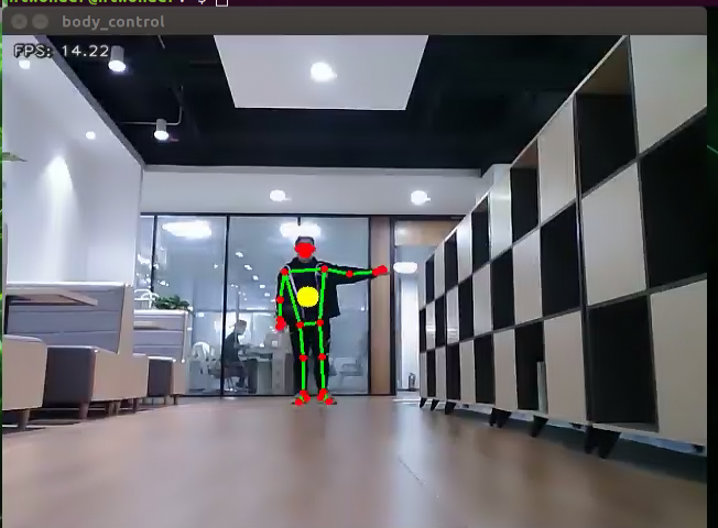

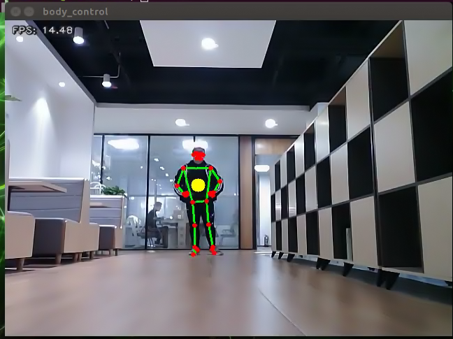

  • Program Outcome
Once the game is initiated, stand within the camera’s field of view. When a person is detected, the screen will display key points of the body and lines connecting them.
From the perspective of the robot, lifting the left arm will cause the robot to turn left; lifting the right arm will make the robot turn right; lifting the left leg will make the robot move forward a certain distance; lifting the right leg will make the robot move backward a certain distance.

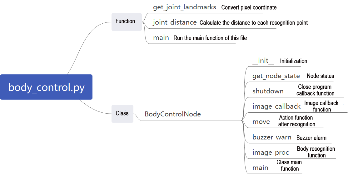

ros2_ws/src/example/example/body_control/include/body_control.py

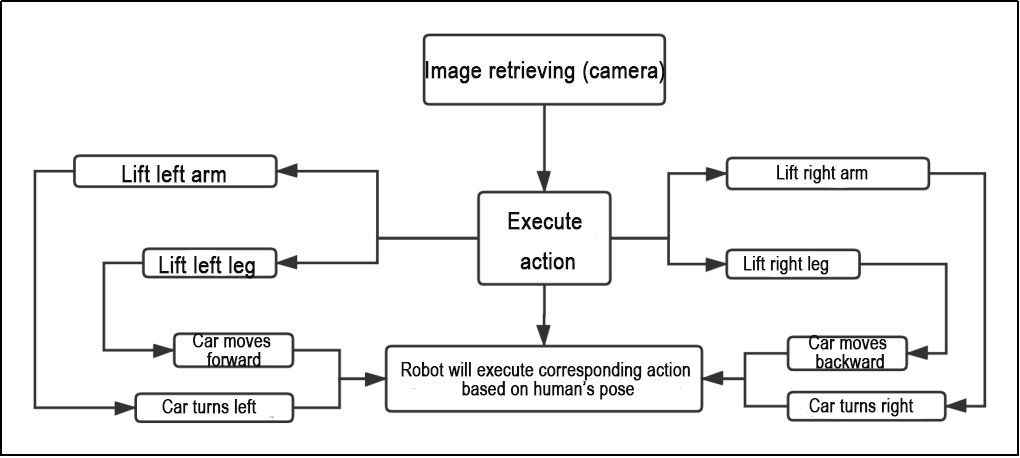

The game process logic is outlined below:
  1. Capture an image through the camera.
  2. After performing a demonstration action, the car will execute the corresponding action.
  3. From the car’s perspective, lifting the left arm will cause the car to turn left; lifting the right arm will cause the car to turn right in a circle; lifting the left leg will make the car move forward a certain distance; lifting the right leg will make the car move backward a certain distance.

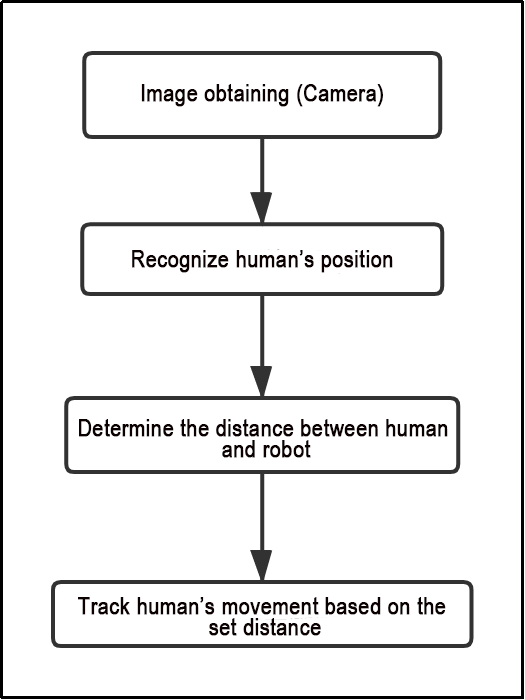

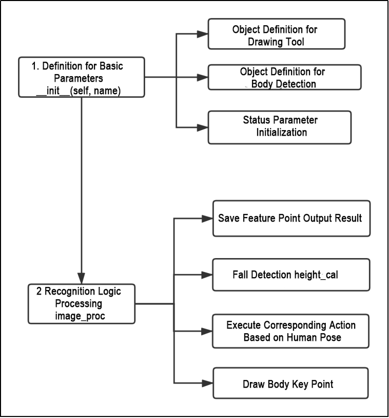

The program’s logic flowchart, obtained from the program files, is presented below:
  1. Initialization function (init(self.name)) defines relevant parameters, including:
  • Definition of the image tool (self.drawing) object.
  • Points used to draw recognized features.
  • Definition of the limb detection object (self.body_detector).
  1. Identified feature points’ output results undergo logical processing for recognition.
  2. Actions are determined and stored based on key point distance conditions.
  3. Finally, the output results are generated, and the car executes corresponding actions.

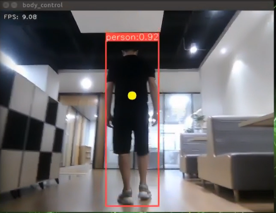

  • Program Outcome
Upon initiating the game, the camera captures the human body within its field of view. Once detected, the center point of the human body is highlighted in the displayed image.
From the robot’s perspective, if the human body is in close proximity, the robot will retreat. Conversely, if the human body is distant, the robot will move forward, ensuring that the distance between the human body and the robot remains approximately 3 meters at all times.

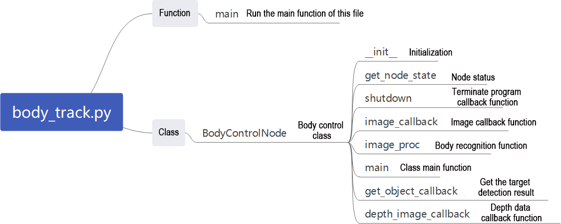

  • Program Analysis
ros2_ws/src/example/example/body_control/include/body_track.py
Based on the game’s effectiveness, the procedural logic is delineated as follows:
  1. The car captures images through the camera.
  2. It identifies the human body’s position in the image and calculates the distance between the human body and the car.
  3. Finally, the car adjusts its movement to follow within the preset distance limit.
The program’s logic flowchart, derived from the program files, is illustrated below:
Initialization Function of the BodyControlNode Class:
Configuration of Linear and Angular Speed: Adjusts the car’s speed based on the detected distance from the human body.
Definition of Chassis Publisher: Publishes the chassis’s position and orientation to control the car’s forward and backward movement.
Yolov5 Human Body Detection: Utilizes the yolov5 single-target detection algorithm to detect human bodies and obtain their positions.
PID Parameter Initialization: Initializes parameters related to the PID controller, governing sensitivity to the distance between the car and the human body.
1. Function
Main:

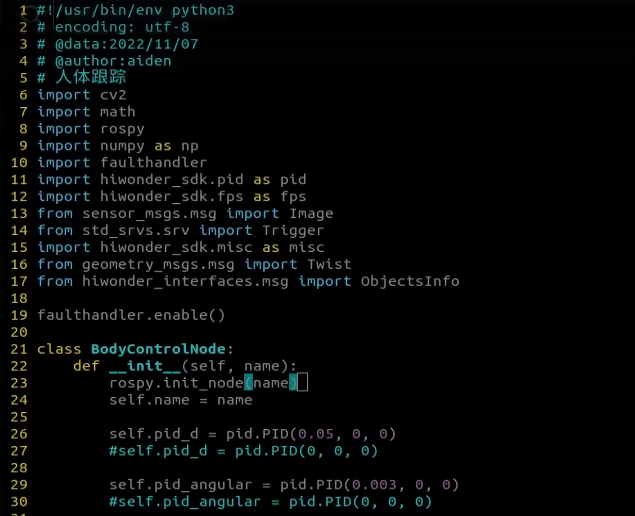

def main():
    node = BodyControlNode('body_control')
    rclpy.spin(node)
    node.destroy_node()
Used to start the human tracking node.
2. Class
class BodyControlNode(Node):
        rclpy.init()
        self.name = name
        self.pid_d = pid.PID(0.1, 0, 0)
        #self.pid_d = pid.PID(0, 0, 0)
        self.pid_angular = pid.PID(0.002, 0, 0)
        #self.pid_angular = pid.PID(0, 0, 0)
This class is the human tracking node.
Init:
        rclpy.init()
        self.name = name
        self.go_speed, self.turn_speed = 0.007, 0.04
        self.linear_x, self.angular = 0, 0
        self.running = True
Initialize the parameters required for human tracking, read nodes such as the camera’s image callback, depth information, chassis, YOLOv5 recognition, etc., and then synchronize the time to align depth information and image information, finally start the main function within the class.

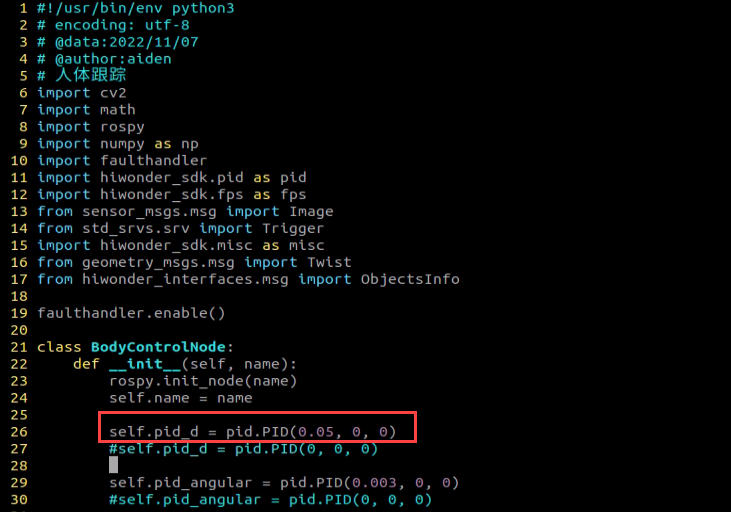

The default tracking speed in the program is set to a fixed value. If you wish to alter the tracking speed of the robot, you can do so by adjusting the PID parameters within the program.
  1. Open the ROS1 terminal, enter the command to navigate to the directory where the program is stored:
    cd /home/ubuntu/ros2_ws/src/example/example/body_control/include/
  2. Run the following command to open the program file:
    sudo vim body_control.py
  3. Locate the self.pid_d and self.pid_angular functions, where the values inside the parentheses are the PID-related parameters. One is for the tracking linear velocity PID, and the other is for the tracking angular velocity PID.
    The three PID parameters are proportional, integral, and derivative. The proportional parameter adjusts the response level, the integral parameter adjusts the smoothness, and the derivative parameter adjusts whether there is overshoot.

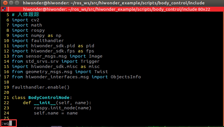

  4. Press “i” to enter edit mode. If you want to increase the robot’s tracking speed, you can correspondingly increase the value. For example, here we set the tracking linear velocity PID to 0.05.
Note: It is recommended not to adjust the parameters too high. Excessive parameters will cause the robot to track too quickly, affecting the experience.
  1. After completing the modifications, press “Esc” to exit edit mode, then press “:wq” to save and exit.
  2. Start the game according to the instructions provided in section 10.2.

The depth camera combines RGB capabilities, enabling both color recognition and somatosensory control. This lesson will leverage color recognition, as discussed in “21.3.9 Posture Control”, to identify individuals wearing clothing of a predefined color (which can be calibrated through operations). The robot’s movements are then controlled based on different body gestures.
If an individual wearing the specified color is not recognized, the robot remains unresponsive, ensuring accurate identification and control over the individual operating the robot.
  • Program Logic
First, import MediaPipe’s human pose estimation model and subscribe to topic messages to obtain real-time camera footage.
Next, utilize the built model to detect key points of the human torso on the screen. Connect these key points to display the human torso and determine the human posture. Calibrate the center point of the human body based on all key points.
Finally, if it is detected that the human body is standing with hands on hips, calibrate the color of the clothes to identify the control object. The robot enters control mode, and when the human body performs specific actions, the robot responds with corresponding actions.

  • Program Outcome
After starting the gameplay, stand within the camera’s field of view. When a person is detected, the screen will display key points of the human torso, lines connecting these points, and the center point of the human body.
First Step: Slightly adjust the camera to maintain a certain distance, ensuring it can detect the entire human body.
Second Step: When the person to be controlled appears on the camera screen, they can assume the posture of hands on hips. If the buzzer emits a short beep, the robot completes calibration of the human body’s center point and clothing color, entering control mode.
Third Step: At this point, with the robot as the primary viewpoint, raising the left arm causes the robot to move to the right; raising the right arm causes the robot to move to the left; raising the left leg causes the robot to move forward; raising the right leg causes the robot to move backward.
Fourth Step: If a person wearing a different clothing color enters the camera’s field of view, they will not control the robot.

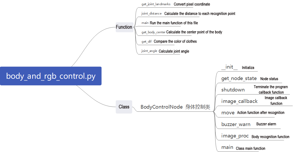

ros2_ws/src/example/example/body_control/include/body_and_rgb_control.py
Retrieve the captured image from the camera, analyze the key characteristics of the human body, initially detect and assess the “akimbo” posture using the designated function. Subsequently, determine if it’s the same individual in the picture based on clothing color. If confirmed, identify specific body movements (raising the left arm, right arm, left leg, and right leg) and instruct the car to execute corresponding actions. Otherwise, reanalyze the key feature points.
As shown in the above diagram, the program first uses the initialization function of the BodyControlNode class to set the default values for the relevant parameters. This primarily includes defining the drawing tool object, the limb detection object, and initializing the posture state and count parameters. After this setup, the program can logically process the incoming images. It begins by identifying and outputting key body feature points, calculating joint angles from the obtained (arm) parameters to mark the hands-on-hips posture. Then, it matches colors based on the recognized key feature points to determine if the person has been previously marked. Finally, the program controls the movement of the vehicle by recognizing demonstration actions (raising an arm, lifting a leg).

image_proc:
    def image_proc(self, image):
        image_flip = cv2.flip(cv2.cvtColor(image, cv2.COLOR_RGB2BGR), 1)
        results = self.body_detector.process(image)
        if results is not None and results.pose_landmarks is not None:
            twist = Twist()
            landmarks = get_joint_landmarks(image, results.pose_landmarks.landmark)
            # 叉腰标定
            angle_list = joint_angle(landmarks)
            #print(angle_list)
            if -150 < angle_list[0] < -90 and -30 < angle_list[1] < -10 and 90 < angle_list[2] < 150 and 10 < angle_list[3] < 30:
                self.count_akimbo += 1  # 叉腰检测+1(hands-on-hips detection+1)
                self.count_no_akimbo = 0  # 没有叉腰检测归零(clear no hands-on-hips detection)
                self.count_akimbo = 0  # 叉腰检测归零(clear hands-on-hips detection)
                self.count_no_akimbo += 1  # 没有叉腰检测+1(no hands-on-hips detection+1)
                # 当连续5次都检测到叉腰且当前不在标定状态(If hands-on-hips posture is detected for 5 consecutive times, and not under calibrated status)
Function for recognizing limbs, which invokes the model to draw key points of the human body based on the recognized information. Then, it performs color recognition based on the position of each limb’s different contours, finally determining and moving according to the recognized posture.

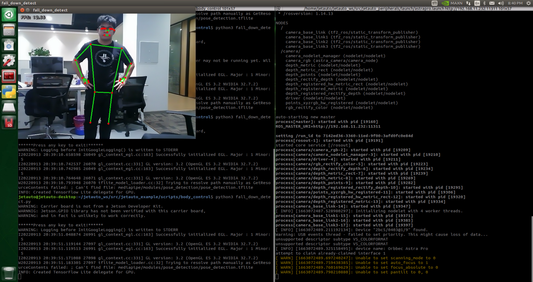

21.3.12 Pose Detection
Through the human pose estimation model in the MediaPipe machine learning framework, the human body posture is detected. When the robot detects a person falling, it will sound an alarm and sway from side to side.
  • Program Logic
First, import the human pose estimation model from MediaPipe and subscribe to topic messages to obtain real-time footage from the camera.
Then, process the image, such as flipping, to detect human body information in the image. Based on the lines connecting the key points of the human body, calculate the limb height to determine the body movement.
Finally, if “falling” is detected, the robot will sound an alarm and move forwards and backwards.
  • Operation Steps
  5. Run the following command and hit Enter key to initiate the game:
    ros2 launch example body_and_rgb_control.launch.py
  1. The program will launch the camera’s image interface. For specific recognition steps, refer to Section Program Outcome.
  2. If you need to close this gameplay, you need to press the “Esc” key in the image interface to exit the camera image interface.
  3. Then press “Ctrl+C” in the command line terminal interface. If closing fails, please try again.
  • Program Outcome
Once the game starts, ensure the human body remains as fully within the camera’s field of view as possible. Upon recognizing the human body, the key points will be highlighted in the returned image.
At this point, the individual can sit down briefly. Upon detecting the “falling” posture, the robot will continuously sound an alarm and make repeated forward and backward movements as a reminder.

The program logic flow chart obtained from the program files is depicted in the figure below.
