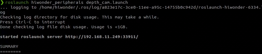

  4. Input the command “roslaunch hiwonder_peripherals depth_cam.launch” and press Enter to enable the camera service.

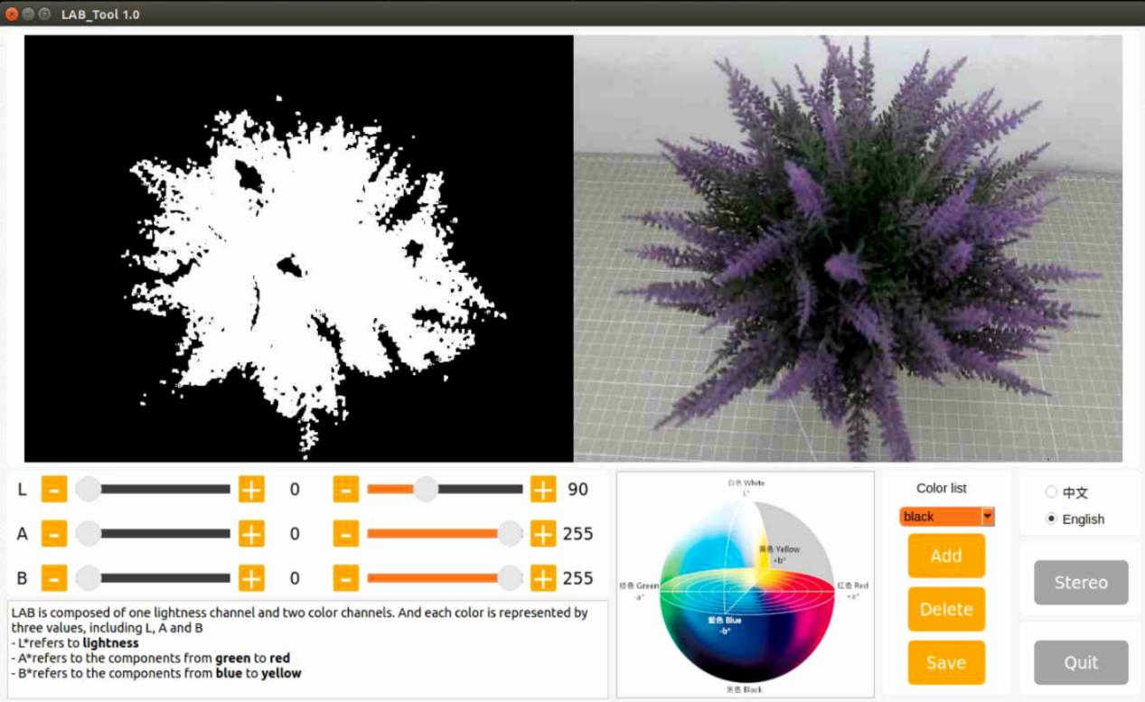

9.1.2 LAB TOOL Interface Layout Instruction

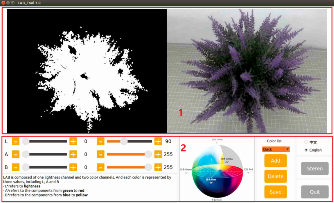

  1. Image display area: the left displays the processed image and the right is the raw image.
Note: if the transmitted image does not display normally, it’s the issue of camera connection. In this case, you need to examine if the wiring is connected properly or reconnect it.
  1. Recognition adjustment area: adjust the color threshold. The function of each button refer to the following table:
Icon Function instruction

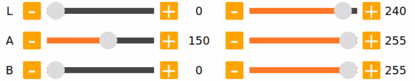

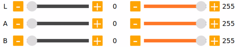

The sliders L, A and B are used respectively to adjust the values of the corresponding L, A and B components of the image.
The sliders on the left are the “min” value for each component while the slider on the right are the “max” value for each component.
Add recognizable color.
Close LAB TOOL.

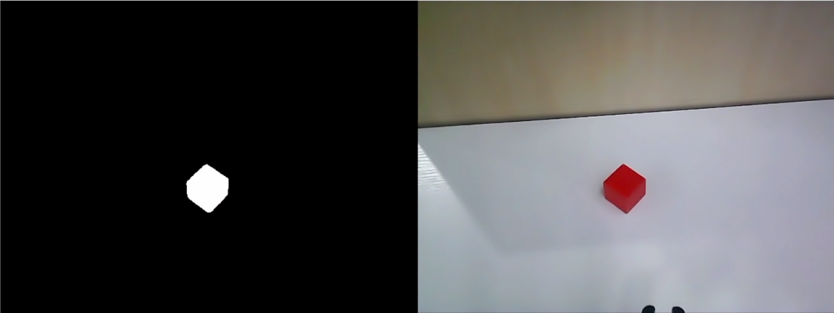

9.1.3 Adjust Color Threshold

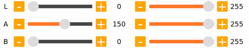

  1. Open LAN tool. Choose the color in the color drop-down list of color recognition area. Take a color “red” as example.

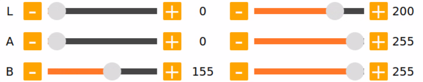

  1. Adjust the “min” values of L, A and B components to “0”, the “max” values to “225”.
  1. Place the target within the camera’s field of view. Adjust the values of L, A and B component towards the interval representing the target recognition color according to the LAB color space distribution chart.
  1. Adjust the L and B components according to your surroundings. If the red color is light, increase the “min” value of the L component; if it is dark, decrease the “max” value of the component. If the red color tends to be warm, increase the “min” value of the B component; if it tends to be cool, decrease the “max” value of the B component.
L 0~255 Black-white (-L~+L)
A 0~255 green-red(-a ~ +a)
B 0~255 Blue-yellow(-b ~ +b)

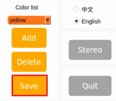

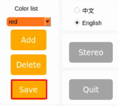

  1. Click “Save settings” button in adjustment area to save the adjustment parameters.

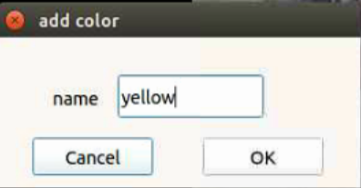

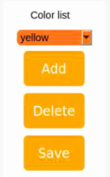

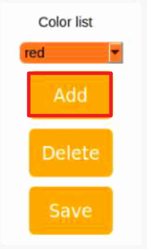

  1. Open LAB tool and click on “add color” button.
  1. Fill in the “name” column with the color name, and click the “OK” button.
  1. Choose the added color in the color drop-down menu.
  1. Place the target within the camera’s field of view, and adjust the threshold by dragging the L, A, and B component sliders until the area of the colored object within the left screen turns white, while the other areas turn black.
Note: the adjustment method of color threshold refers to “1.3 Adjust Color Adjustment”.
  1. Click “Save settings” button in recognition adjustment area to save the adjustment parameters of color threshold.

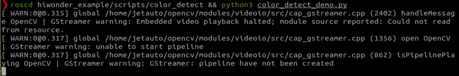

  4. Input the command “roscd hiwonder_example/scripts/color_detect && python3 color_detect_demo.py” and press Enter to access the program directory where the color recognition program is located.
  1. If you want to close this program, press“Ctrl+C. If that fails, please try multiple times.

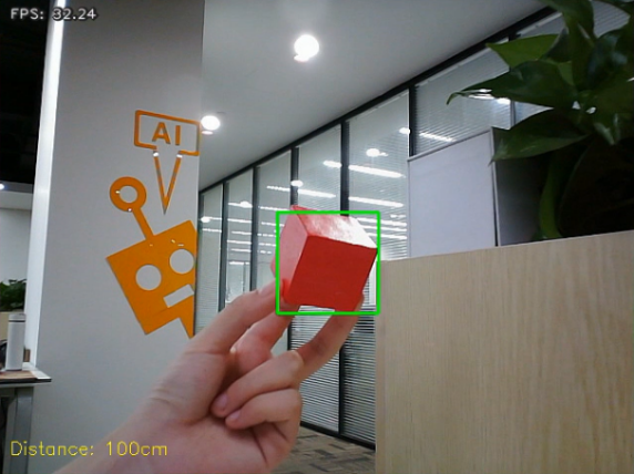

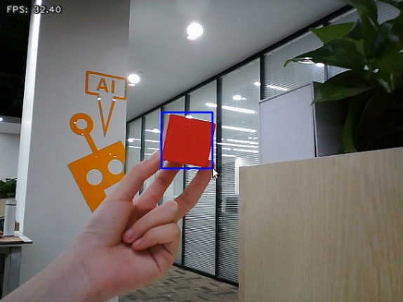

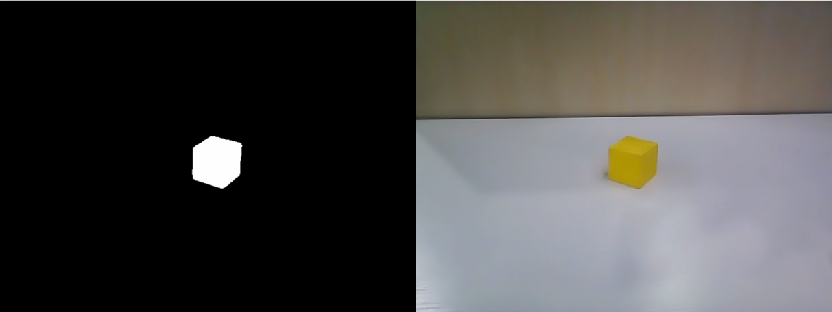

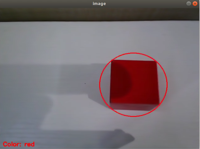

9.2.3 Outcome
Note: after the game starts, please ensure that there are no other objects containing recognized colors within the field of view of the camera to avoid affecting the implementation effect.
After the game starts, place the target object within the field of view of the camera. When recognizing the target object, it will be circled up in the same color and the color name will be printed in the lower-left corner of the screen. The program supports red, blue and green object recognition.

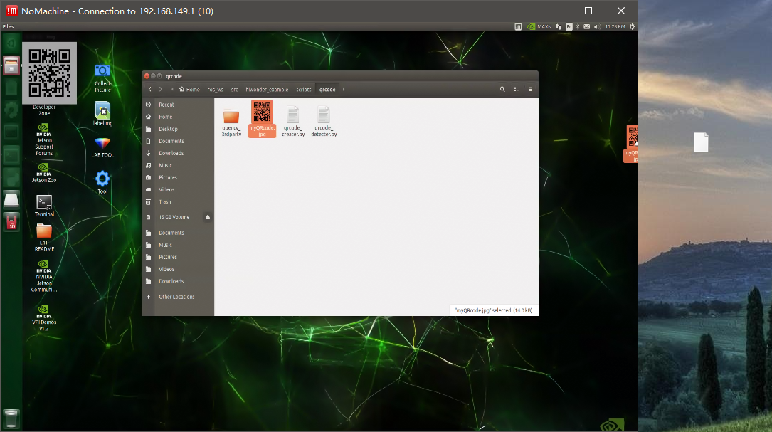

  4. Input the command “roscd hiwonder_example/scripts/qrcode && python3 qrcode_creater.py” to access the program directory and start the QR code creation program.
    After start the program, it’s necessary to enter characters in the terminal to generate the QR code. Take the input of “hiwonder” as example.
Press “Enter” to display a QR code image containing the input data.
  1. If need to close the program, press “Ctrl+C” in the terminal. If this fails, please try multiple times.
  2. After closing the window, the saved content and its path are printed.
  1. The image can be located according to the path. Drag the image to the desktop of your computer using Nomachine tool. Then, print it out or transfer it to the phone album on the phone.

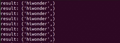

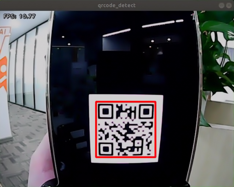

  • Outcome
After the game starts, the QR code image appearing in the feed, mark them with a red rectangular box, and print out the content of the QR code.

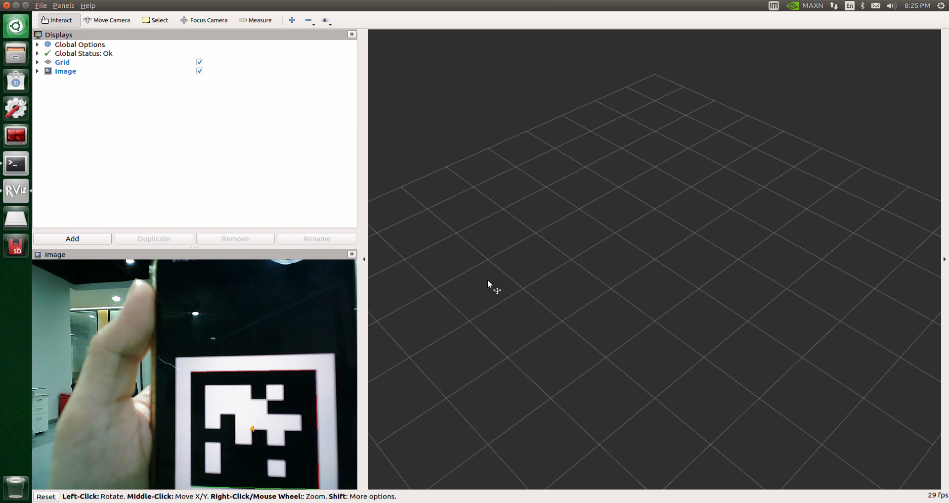

9.4 AprilTag Recognition
Before starting this game, extract the AprilTag package under the same directory. Then you can transfer the tag image to the photo album on your phone.
In this lesson, OpenCV is used to recognize AprilTag, and the transmitted image will display the recognized tag information,
AprilTag, a type of visual localization marker, similar to QR codes or bar codes can quickly detect the maker and calculate relative positions. It can be primarily applied in various tasks, including AR, robotics and camera calibration.
9.4.1 Program Logic
First, subscribe to the topic messages published by the camera node to obtain RGB images and process them by converting to grayscale and scaling.
Next, acquire tag data including tag ID, and coordinates of tag center point and corners.
Finally, perform camera calibration to provide feedback on tag recognition result through the transmitted image.
9.4.2 Operation Steps
Note: the entered command should be case sensitive and the “Tab” key can be used to fill in key words.
  1. Start JetRover and connect it to Nomachine.
  2. Click on to open the command line terminal.
  3. Input the command “sudo systemctl stop start_app_node.service” and press Enter to disable the app auto-start service.
  4. Input the command “roslaunch hiwonder_example apriltag_detect_demo.launch
Note: if an error occurs, try a few more times.
Due to the loading of rviz (a 3D visualization platform), the startup may take some time, please be patient.
    Input the command“sudo systemctl restart start_app_node.service” to enable app auto-start service. After the service is enable, robot arm will restore the initial position.
Note: if you do not enable app auto-start service for the robot, it will affect the corresponding app functions. Restarting robot can also automatically enable the app auto-start service.

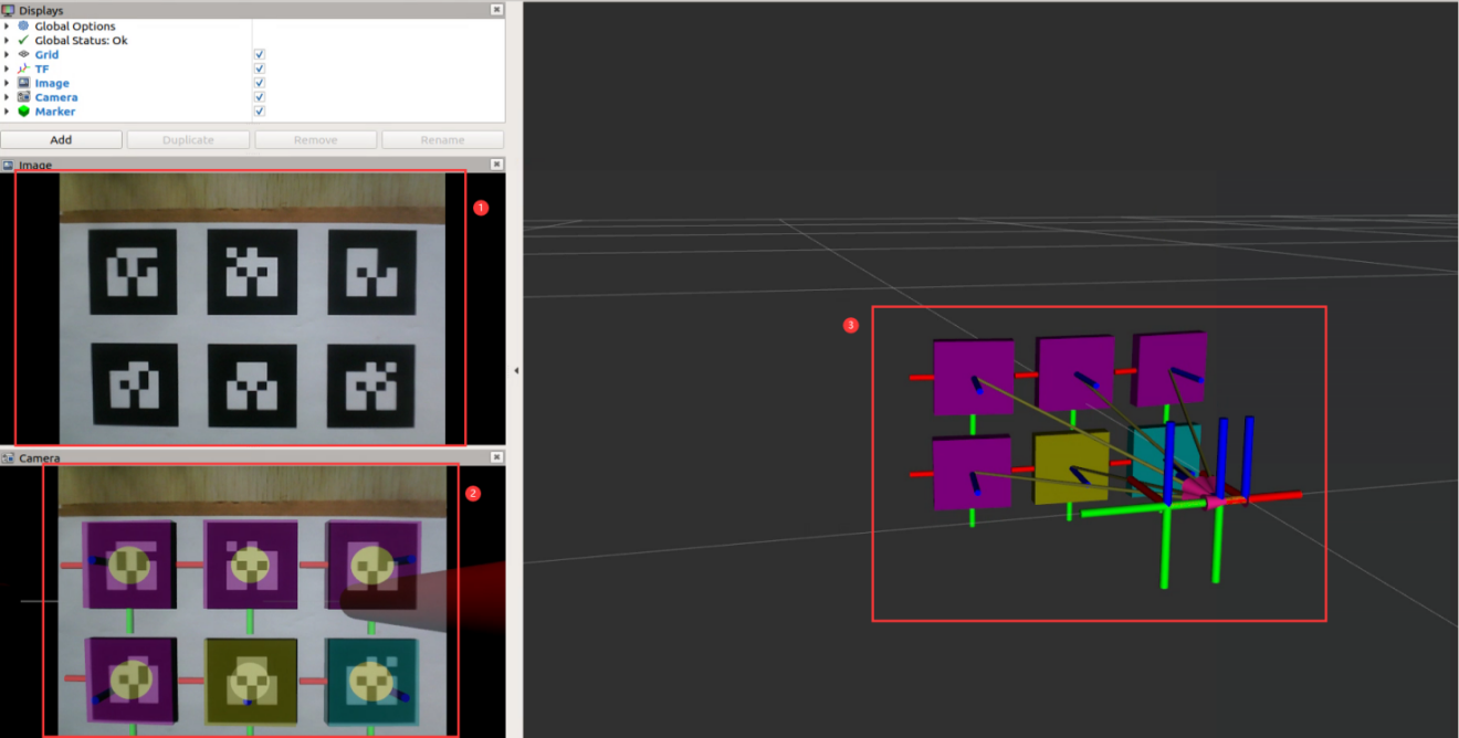

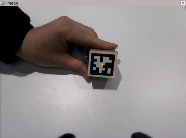

9.4.3 Outcome
After the game starts, place No.1 tag with the field of view of the camera.
The RIVZ tool will display the transmitted image on the left bottom corner. When the tag is recognized, tag ID will be printed in the center of the tag on the image, and the colored line will outline the four edges of the tag.

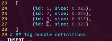

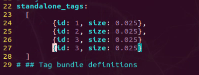

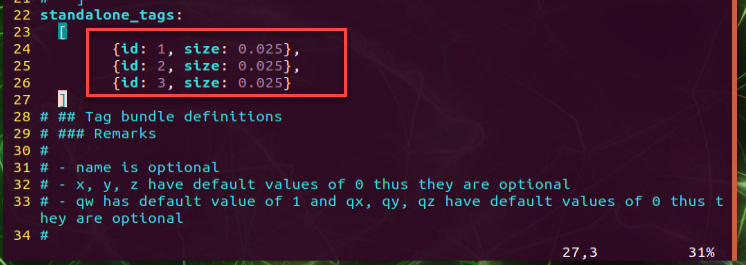

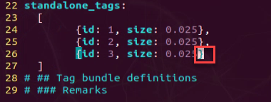

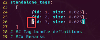

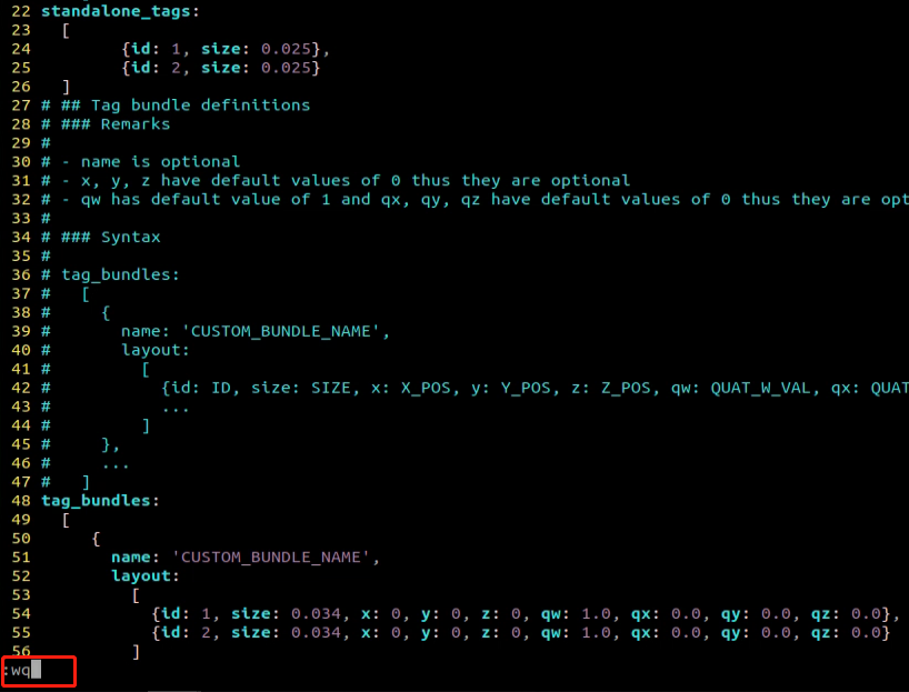

9.4.4 Extension Function - ID Recognition
Reminder: AprilTag package can be located under the same directory. You need extract the package and transfer it to the photo album on your phone.
By default, the program can identify No.1, No.2 or No.3 tags. Therefore, if you need to modify the configuration file, you can refer to the below example of adding No.4 tag. The detailed operation steps are as follow:
  3. Input the command “roscd hiwonder_example/config/” and press Enter to access the configuration directory.
  4. Input the command “roscd hiwonder_example/config/” to open the configuration file.
  1. Locate the code shown in the below red box:
  1. Use the arrow keys to move the cursor position to the front of the 26th line, and then type “1yy”. (“1” indicates copying one line, and you can input the number of lines you want to copy. For example, to copy five lines, type “5yy”.)
  2. Then adjust the cursor to the end of the 26th line and press “p”.
  3. Press the “i” key to switch the cursor to the 26th line and add a comma at the end of line 26 (Note: ensure it’s English punctuation), and then switch to line 27. Modify “id” to “4” while keeping “size” unchanged. The result should be as follows:
  4. After the modification is complete, press “Esc” and input “:wq” to save and close the file. Then follow the operations in “9.4.2 Operation Steps” to restart the program.
  1. After restarting the program, its effect is shown below:

9.5.3 Outcome
The “Image” window in the RVIZ tool is used to display the transmitted image, while the “Camera” window is used to display the AR visual identification. On the left side of the tool interface is the RVIZ model display area.
After the game starts, place the AR card image within the camera’s field of view. In the “Camera” window, the corresponding AR visual effect for each image will be displayed. The model display area will provide feedback on the angle and position of the images.

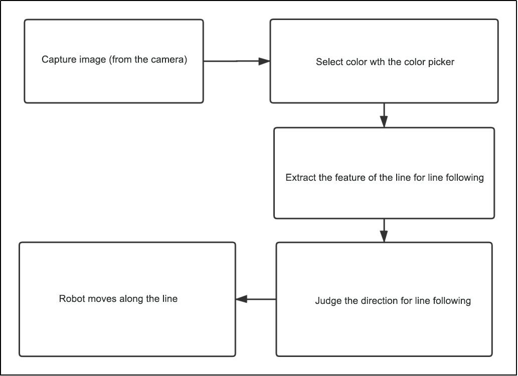

9.6 Line Following
Note: this section is only for program analysis only. For hands-on experience, please refer to “1. Quick Start Guide”.
9.6.1 File Path
The corresponding program file is located in:
/ros_ws/src/hiwonder_app/scripts/line_following.py

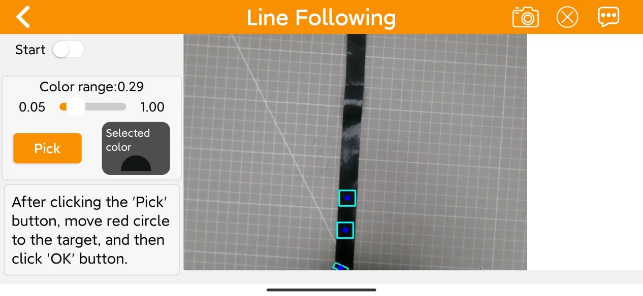

9.6.2 Outcome
The realization effect of this game is shown below. After selecting the color of the target line on the app, JetRover will move along with the track line.

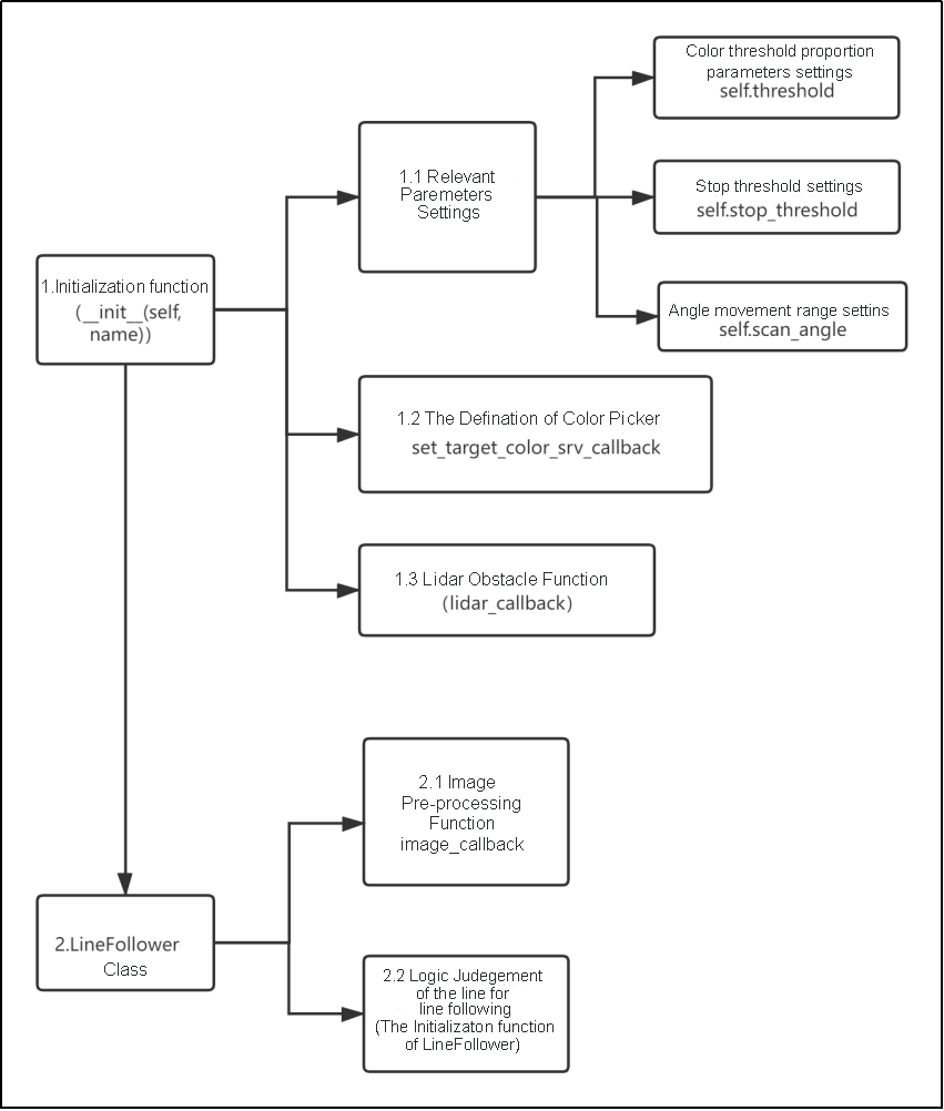

9.6.3 Program Analysis
Note: it’s necessary to back up the original program file before making any modification to the program. You’re forbidden to modify the original source code file to avoid causing robot malfunctions that may be irreparable due to incorrect parameter modifications!
Then, the color picker object is defined (used in the gameplay to pick colors), along with the setting of additional Lidar obstacle avoidance functionality. Next is the implementation of the LineFollower class, which mainly includes functions for image preprocessing and logic for line following.
The initialization function (__init__(self, name)) involves setting up relevant parameters.
The program begins with the initialization function within the LineFollowingNode class, defining some basic parameters. You need to primarily keep eyes on the color threshold ratio, stop limit parameters, and angle swing parameters. All relevant parameters and definitions involved in this section are within the LineFollowingNode class, as shown in the diagram below:

4. The definition of the color picker (set_target_color_srv_callback)
The color picker serves as a tool equivalent to the color picking function in the app. It is defined using the set_target_color_srv_callback function, as shown in the diagram below:

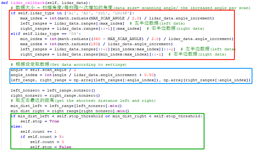

5. Lidar Obstacle Avoidance(lidar_callback):
During line following, the Lidar obstacle avoidance function is also implemented. The specific implementation is in the lidar_callback function, as shown in the diagram below:
The portion outlined in red indicates the setting of the Lidar scanning range. Different scanning ranges are set based on different Lidar types. The parameters here can remain at their defaults.
The portion outlined in blue represents the processing of point cloud data on the left and right sides. ‘Angle’ denotes the boundary between left and right scanning ranges. Angle_index handles the coordinates of the point cloud data, where angle_increment is the angle increment of the Lidar scan. Left_range and right_range represent the point cloud data on the left and right sides, respectively. The parameters here can remain at their defaults.
The portion outlined in green indicates the logical judgment of the distance between the scanned point cloud data and obstacles in relation to the stopping threshold. If the distance is less than the stopping threshold, ‘self.stop’ is set to True to stop the car. Otherwise, logical judgment is performed every 5 frames of data (self.count > 5).

9. Line tracking line logic judgment:
Within the LineFollower initialization function, the calculated line angle will be returned as shown in the diagram below:
center_pos = centroid_sum / self.weight_sum  # 按比重计算中心点(calculate the center point according to the ratio)
deflection_angle = -math.atan((center_pos - (w / 2.0)) / (h / 2.0))   # 计算线角度(calculate the line angle)
defection_angle’ is the calculated line tracking angle, where math.atan is the arctangent function, and center_pos represents the position of the center point of the line tracking block. ‘(w/2.0)/(h/2.0)’ denotes the center point of the image.

9.7.4 Outcome
After the game starts, place the target object to be tracked within the field of view of the camera, and use the left mouse button to select it within the returned image. During the selection process, the selected area will be highlighted with a blue rectangle within the returned image. Releasing the left mouse button indicates the completion of the selection, and the rectangle will turn green.
Note: When selecting the target, ensure that the selection box encompasses the target itself and not the background behind it, as this could significantly affect the gameplay effectiveness.
At this point, when you move the tracking target, the robot’s pan-tilt will follow its movement. Additionally, the green rectangle within the returned image will move accordingly with the tracking target.
If you need to re-select the tracking target, simply right-click within the returned image to clear the selection, and then repeat the above selection process.

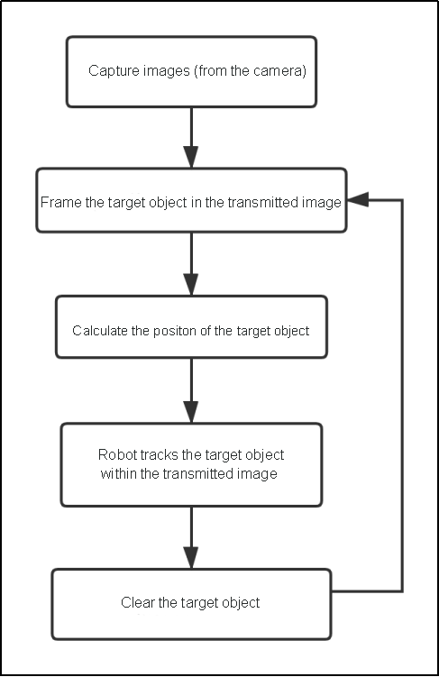

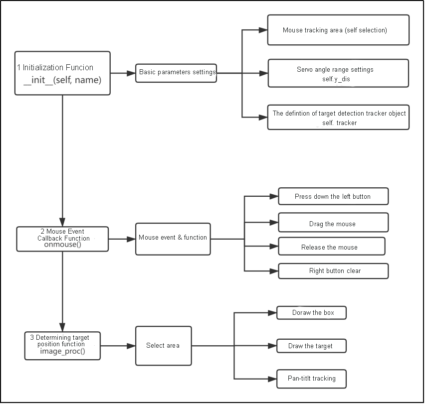

According to the game’s effects, the process logic of this game is summarized as shown in the diagram below:
Subscribe to the topic messages published by the camera node to obtain RGB images, and use the left mouse button to select the target object within the returned image. During the selection process, the selected area will be highlighted with a blue rectangle within the returned image. Releasing the left mouse button indicates the completion of the selection, and the rectangle will turn green.
At this point, when tracking the target, the camera on the robot’s pan-tilt will move accordingly. Additionally, the green box in the transmitted image will move along with the tracking target.
To re-select the tracking target, right-click within the image to clear it, and then repeat the above selection process.
The logical flowchart of the program, derived from the program files, is shown in the diagram below.

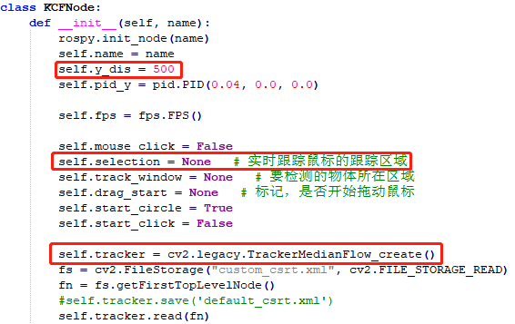

The initialization function is used to define some preset parameters, such as the mouse tracking area, servo angle range setting, and the definition of the target detector object. These parameters can affect the final recognition effect. After setting up the basic parameters, it’s necessary to detect mouse events, record relevant mouse actions in the image, such as left-click, mouse drag, mouse release, right-click to clear, etc. Based on the mouse actions, select the area, use the detector to detect the target object, calculate the object’s angle and position information, and then have the pan-tilt track the object.
  • Initialization Function(init__(self, name) )
1. Basic Parameter Setup:
The program starts with the initialization function within the KCFNode class, defining some basic parameters. The main parameters of interest include the mouse tracking area, servo angle range setting, and the definition of the target detector object. All relevant parameters and definitions involved in this section are within the KCFNode class, as shown in the diagram below:
2. Mouse Tracking Area(self.selection ):
self.selection = None
self.selection is used to store the selected area, i.e., after the user draws a rectangle, it temporarily stores the coordinates of the four corner points of the selected area. These coordinates are used for drawing and tracking the target image.
3. Target Detector Object (self.tracker)
self.tracker = cv2.legacy.TrackerMedianFlow_create()
self.tracker is the definition of the target tracking object detector. legacy.trackerMedianFlow_create is a multi-object tracker in OpenCV. It has separate multi-object tracking functionality, allowing images to be passed into the detector for detection and returning coordinate position messages of the target results.
