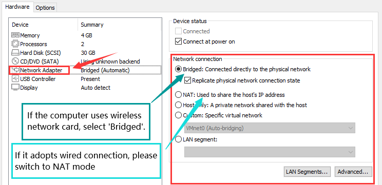

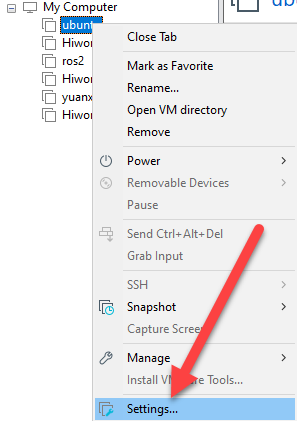

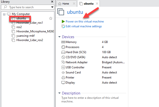

  2. Right click the imported virtual machine “Ubuntu” and select “Settings”.
  3. Click on “Network Adaptor”. If your computer adopts wired connection, select NAT mode. If your computer adopts wireless connection, select bridge mode.
    After the mode is confirmed, click on ‘OK’.
  4. Select the imported virtual machine, then click on ‘Power on this virtual machine’.

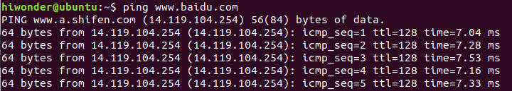

  6. Enter command “ping www.baidu.com” to check whether the network connection is successful.
    ping www.baidu.com
    If the terminal prints following content, that means network connection is successful.

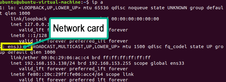

  7. Execute this step only when network connection is failed. Enter command “ip a” to check the ID of network card.
  8. Execute this step only when network connection is failed. Enter command “sudo dhclient ens33” and press Enter. “ens33” is the ID of network card. You need to modify the entered command based to suit the specific case at hand.
    sudo dhclient ens33
    Repeat step 6. If the terminal prints following content, that means network connection is successful.

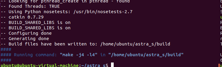

  2. Execute the command ‘catkin_make’ to compile the new workspace. Ensure that the compilation is performed within the ‘ros_ws’ workspace.
    catkin_make
    If the terminal displays the following message, it indicates that the compilation was successful.

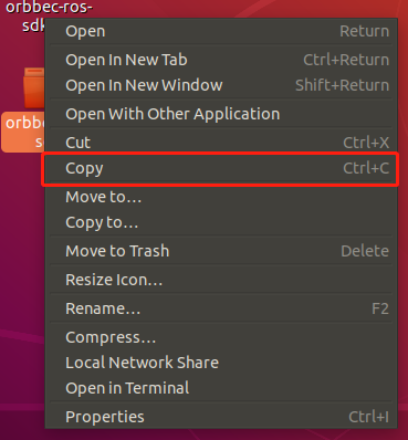

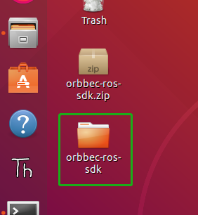

  1. Right-click this folder to select “copy”.

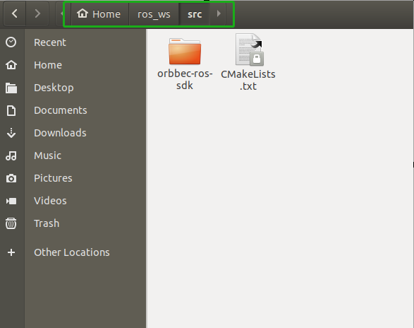

  1. Navigate to the folder as pictured, and paste the folder ‘orbbec-ros-sdk’ to the workspace.

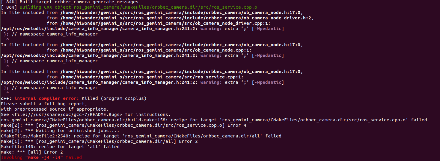

  8. Input the command ‘catkin_make’ to recompile the workspace. Ensure that the compilation is performed within the workspace.
    catkin_make
If the terminal prints the following content, you need to recompile for multiple times.

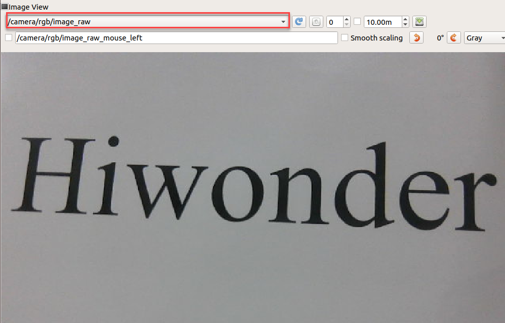

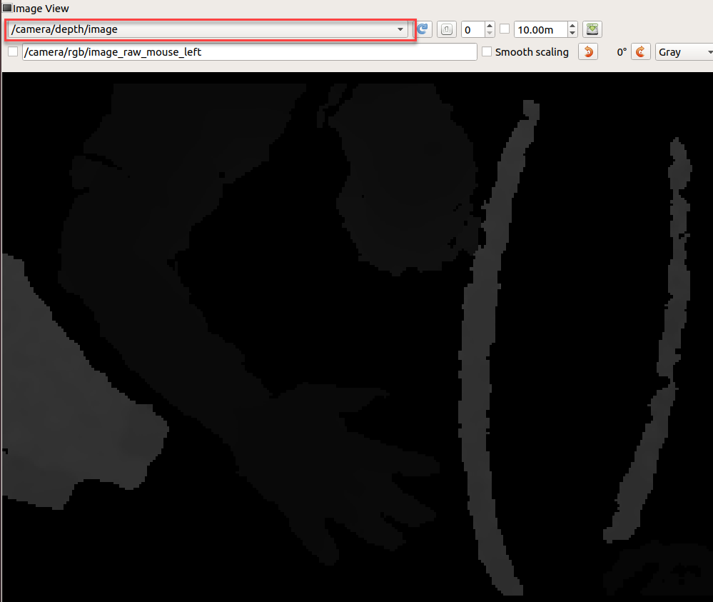

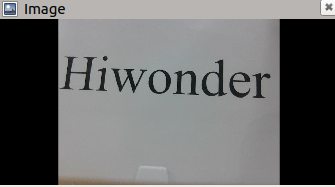

    We offer two approaches for image visualization. One option involves utilizing rqt_image_view to observe 2D images, while the alternative is to employ rviz for visualizing 3D images. Users are free to select the method that aligns with their particular needs. It is crucial to emphasize that during image viewing, the camera service should remain active and not be closed.
  • View Image Using rqt_image_view Tool

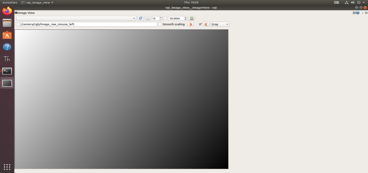

  1. Open a new terminal, and execute the command ‘rosrun rqt_image_view rqt_image_view’ to start the image viewing tool.
When the below interface appears, it means that the tool is started successfully.
  1. To view the image, you need to choose the appropriate tab from the drop-down menu.
  2. To view the infrared image, please select the corresponding topic.

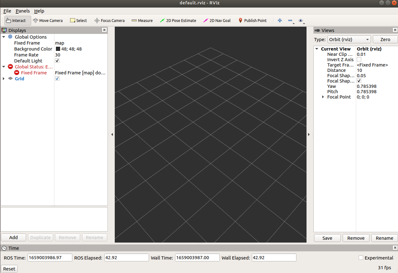

  1. Execute the command ‘rosrun rviz rviz’ to initiate the tool.
    rosrun rviz rviz

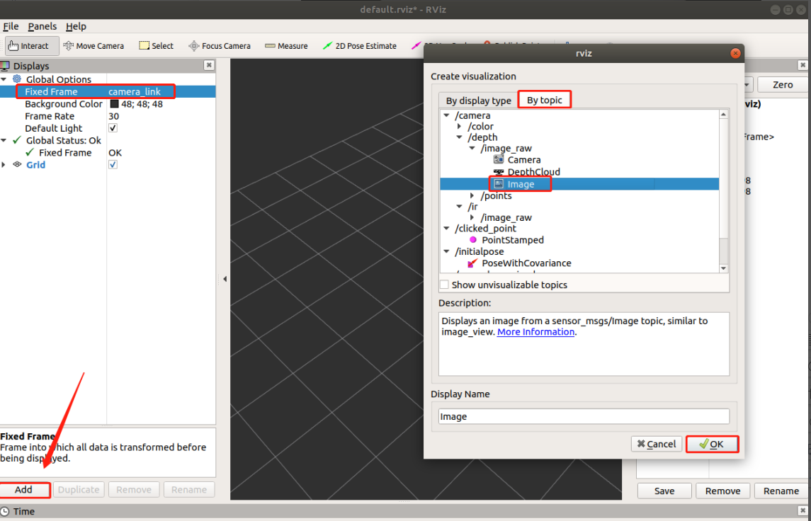

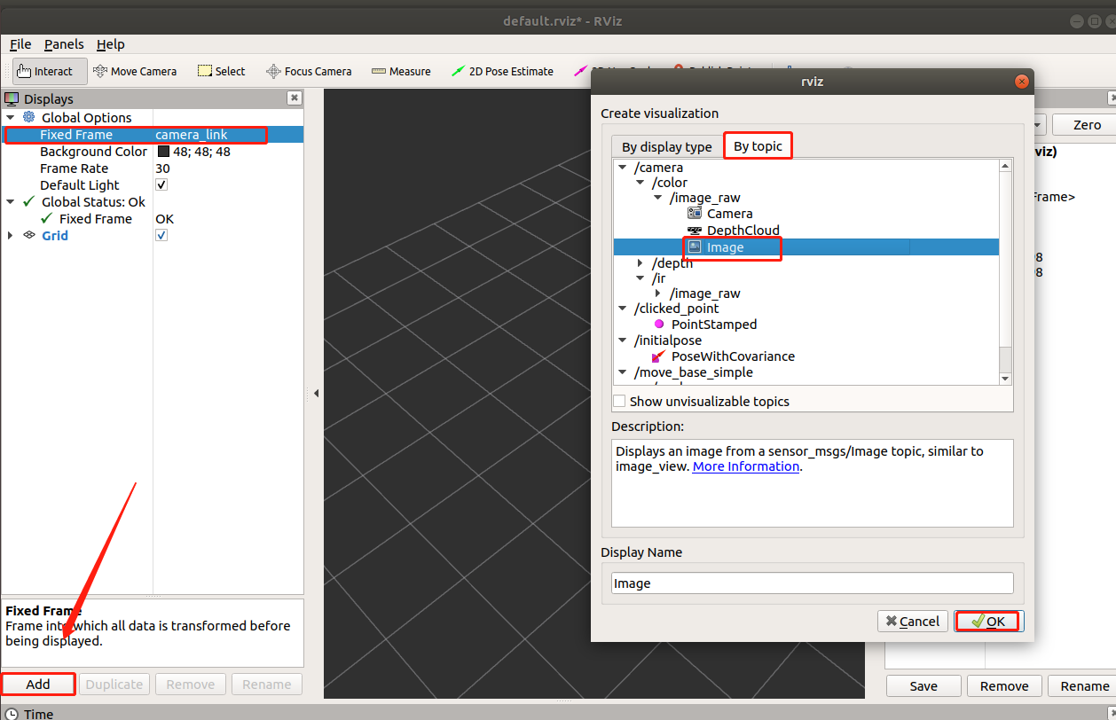

  1. To access the camera feed, start by configuring the “Fixed Frame” to “camera_link.” Then, click on “Add,” select “By topic -> camera -> color -> Image_raw -> Image,” and finally, click “OK.”
When the interface below appears, it indicates that the tool has been successfully launched.
  1. To view the depth map, set ‘Fixed Frame’ as ‘camera_link’, then click-on ‘Add’ to select ‘By topic ->camera->depth->Image_raw->Image’, and click-on ‘OK’.

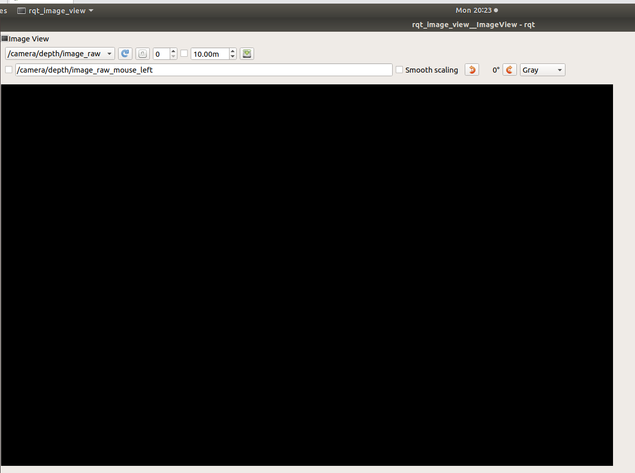

  2. Open a new terminal, and execute the command ‘rosrun rqt_image_view rqt_image_view’ to initiate the image viewing tool. Then choose the corresponding tap in the drop-down menu.
When the object reaches a certain distance from the camera, the depth map will transition to black.

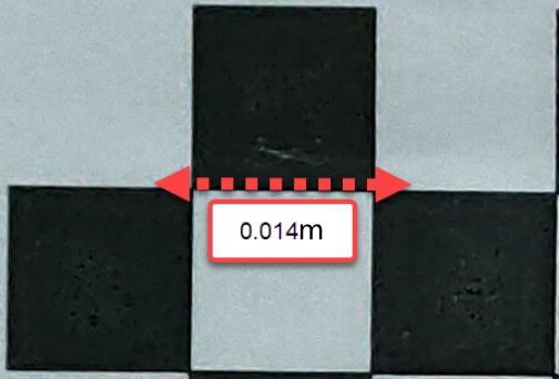

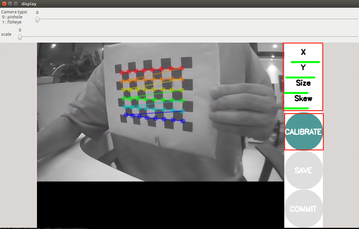

Before calibration, please ensure the size of the chessboard and the length of the square you input are correct. There are 8 squares on the first row except the first one, and 6 squares on the first column except the first one also, so the size of this chessboard is 8 x 6.
You can measure the side length of the square with rule, and the unit is meter. And this side length is 0.014m.

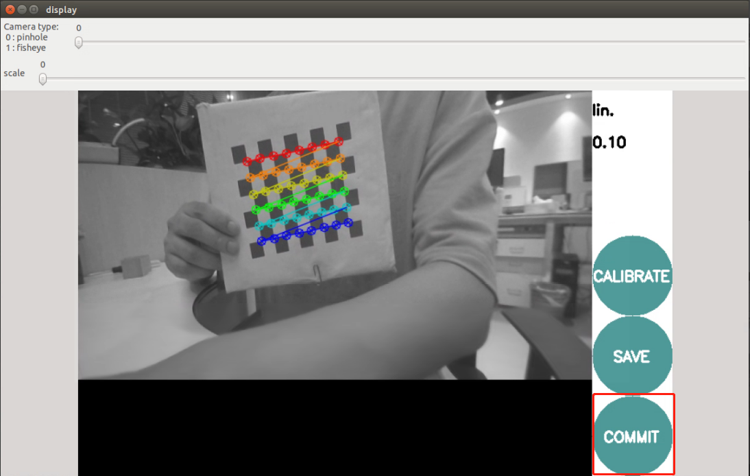

  1. Face the chessboard picture horizontally to the camera, then quickly move and tilt the picture till the parameters of x, y, size and scale at right all turn green. Then click “calibrate” to start calculating the calibration.
Note: please always hold the chessboard picture horizontally. The time taken to calculate the calibration depends on the quantity of the pictures to be calibrated. The more pictures, the longer it takes.
Parameter “x” represents the right and left zone of the camera field of view, and you need to move the chessboard left and right. Parameter “y” indicates top and bottom zone of the camera field of view, and you need to move the chessboard up and down. Parameter “size” is the distance between the picture and the camera, and you need to move the picture away from or close to the camera. Parameter “skew” stands for the tilt of the picture, and you need to tilt the picture at any angle while keeping the chessboard horizontal.
  1. After the program has finished calculated the calibration, you can move the picture within the camera frame to check whether the picture is displayed normally without Fisheye effect. If the displayed picture is normal, click-on “commit” button to save the calibration data which can be checked in this folder: vim .ros/camera_info/camera.yaml
    Click “save” button, and then the picture and calculation data will be saved in “tmp” folder. You can enter “cd /tmp” command to open “tmp” folder to find the related file.

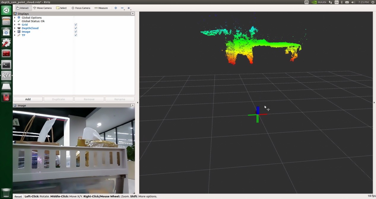

  4. Open a new terminal, and execute the command ‘roslaunch hiwonder_example depth_cam_point_cloud_view.launch’ to open depth camera point cloud.
When the following interface pops up, you can view the point cloud. The colored parts are the point cloud data of the depth camera which are obtained by the infrared sensor on the depth camera.

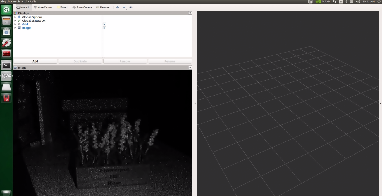

  4. Open a new terminal, and run the command “roslaunch hiwonder_example depth_cam_ir_view.launch” to open depth camera infrared map.
  1. The appearance of the interface below signals a successful initialization. The colored content within the yellow box in the image represents the point cloud data from the depth camera, obtained through the infrared sensor on the depth camera.

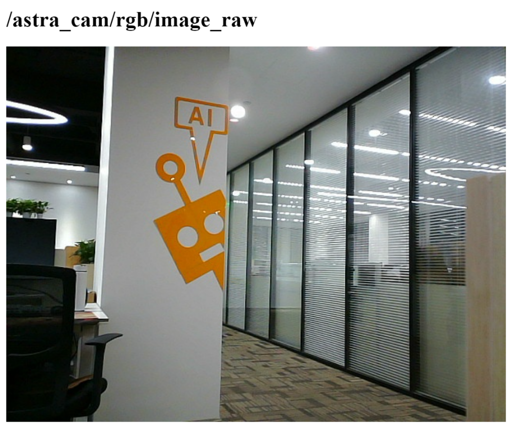

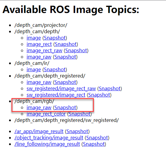

  1. Open any web browser, and input the IP address ‘http://192.168.149.1:8080/’, then hit Enter.
Note: if the prompt ‘This site can’t be reached’ occurs, please restart the app auto-start service.
  1. Click-on ‘image_raw(Snapshot)’ to access the live camera feed.
